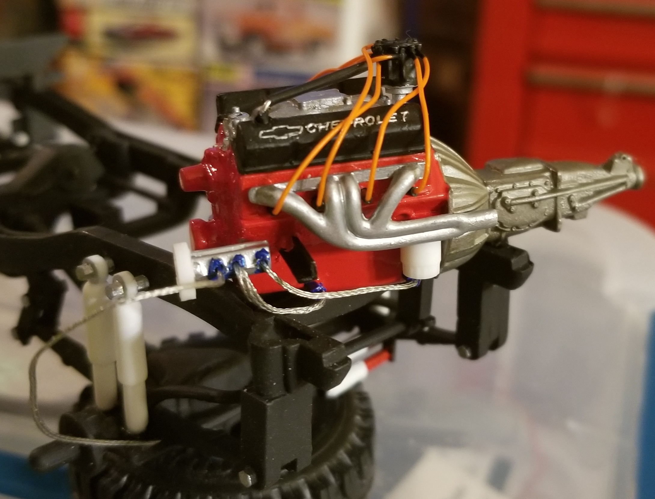

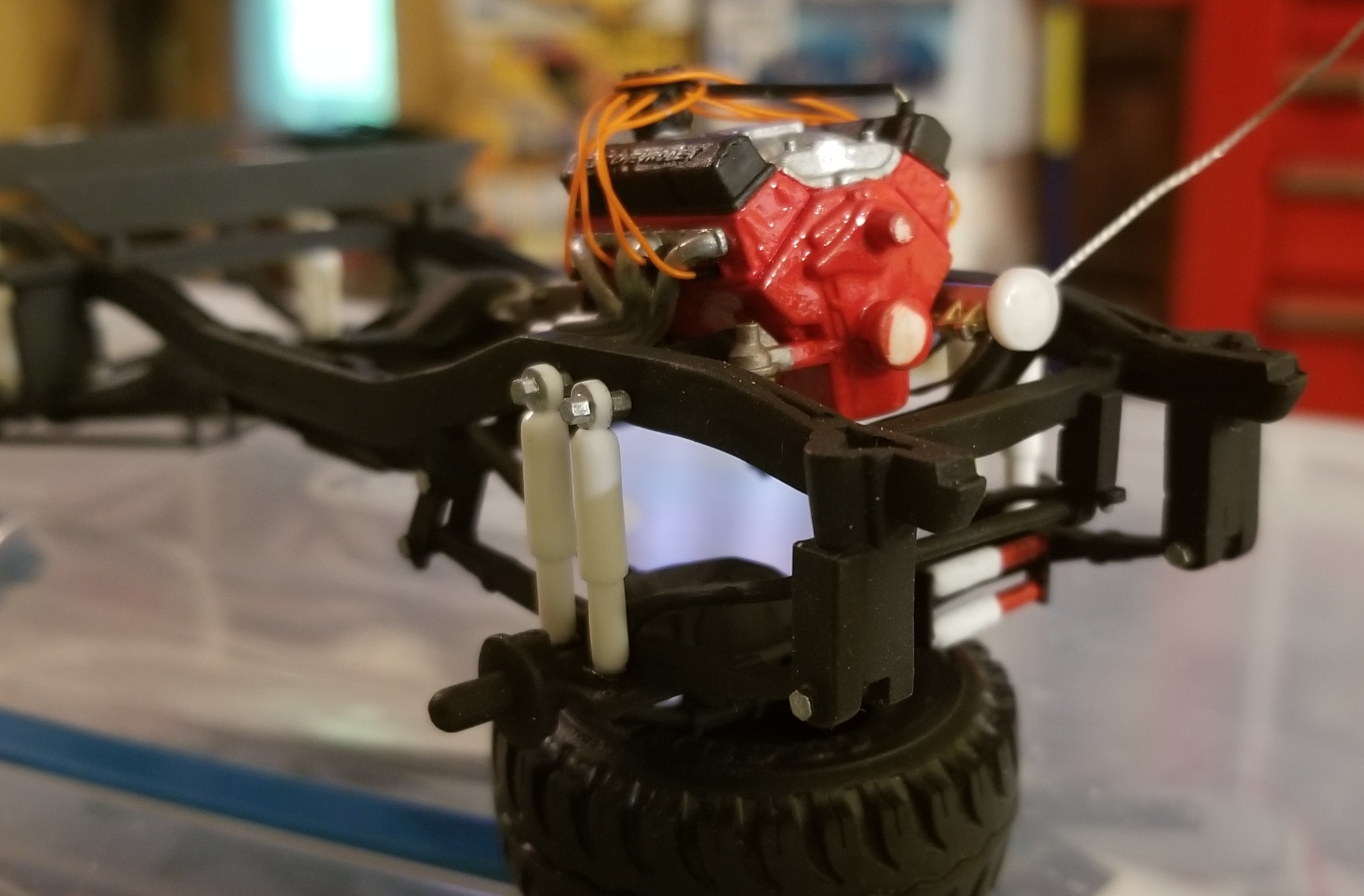

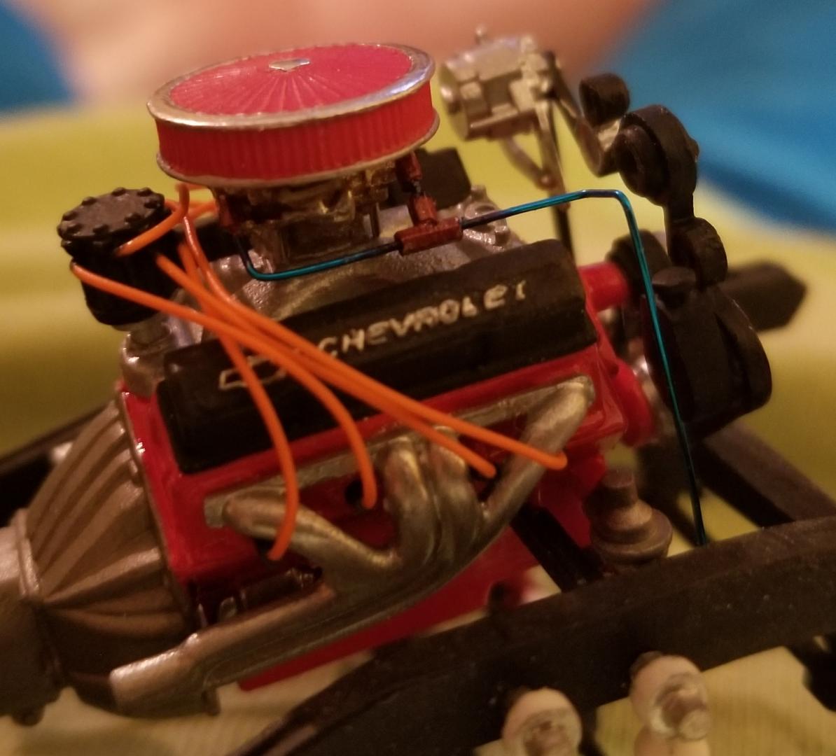

I've been working on the frame and getting the engine together. I've got the shocks on and added a steering stabilizer. I took the engine from a mid 2000s NASCAR kit and am building it to look like a small block crate motor. It's been a while since I plumbed an engine and it felt nice to flex those muscles again.

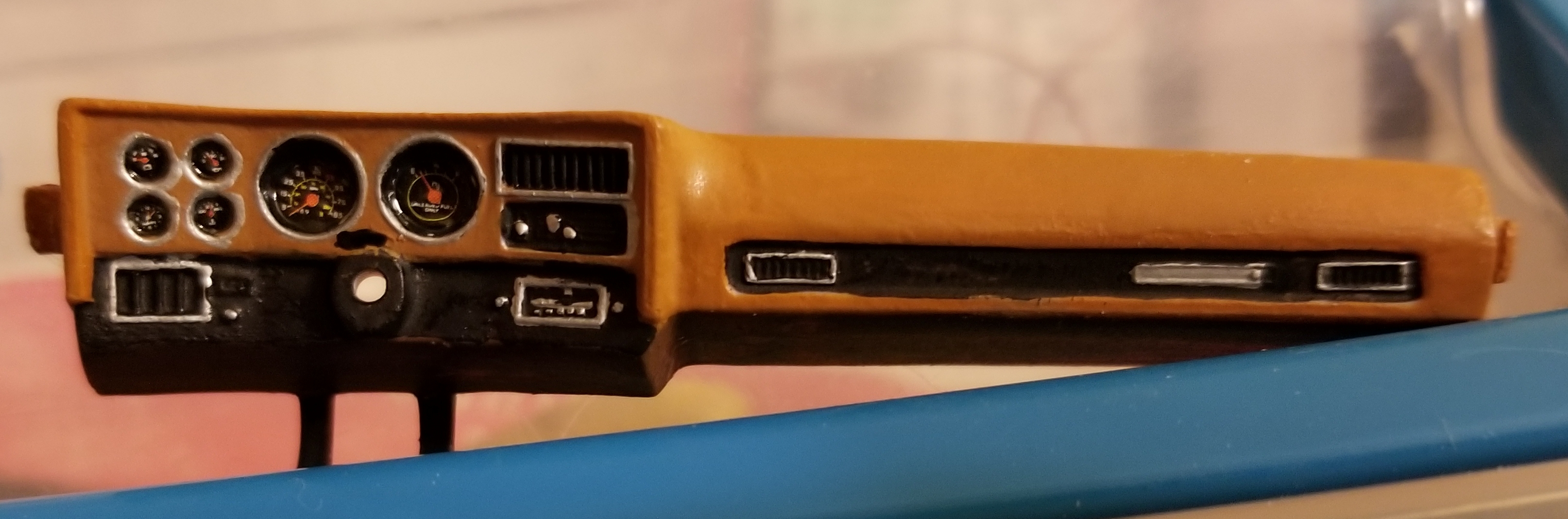

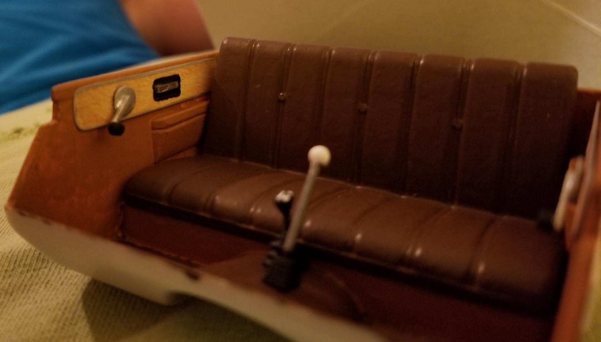

The interior of the GMC is very weak and the door panels are almost completely flat. I'm going to be building a few of these kits eventually so I figured I'd try my hand at dressing it up a bit. I cut the seat out and built an actual tub for the interior. Then I added the arm rests and wood trim along with the door handles and window cranks. I also added a floor shifter and removed column one. The dash is stock but I robbed the gauge decals from the Camo truck. I went with a brown two tone figuring it would hide dirt better than other colors.

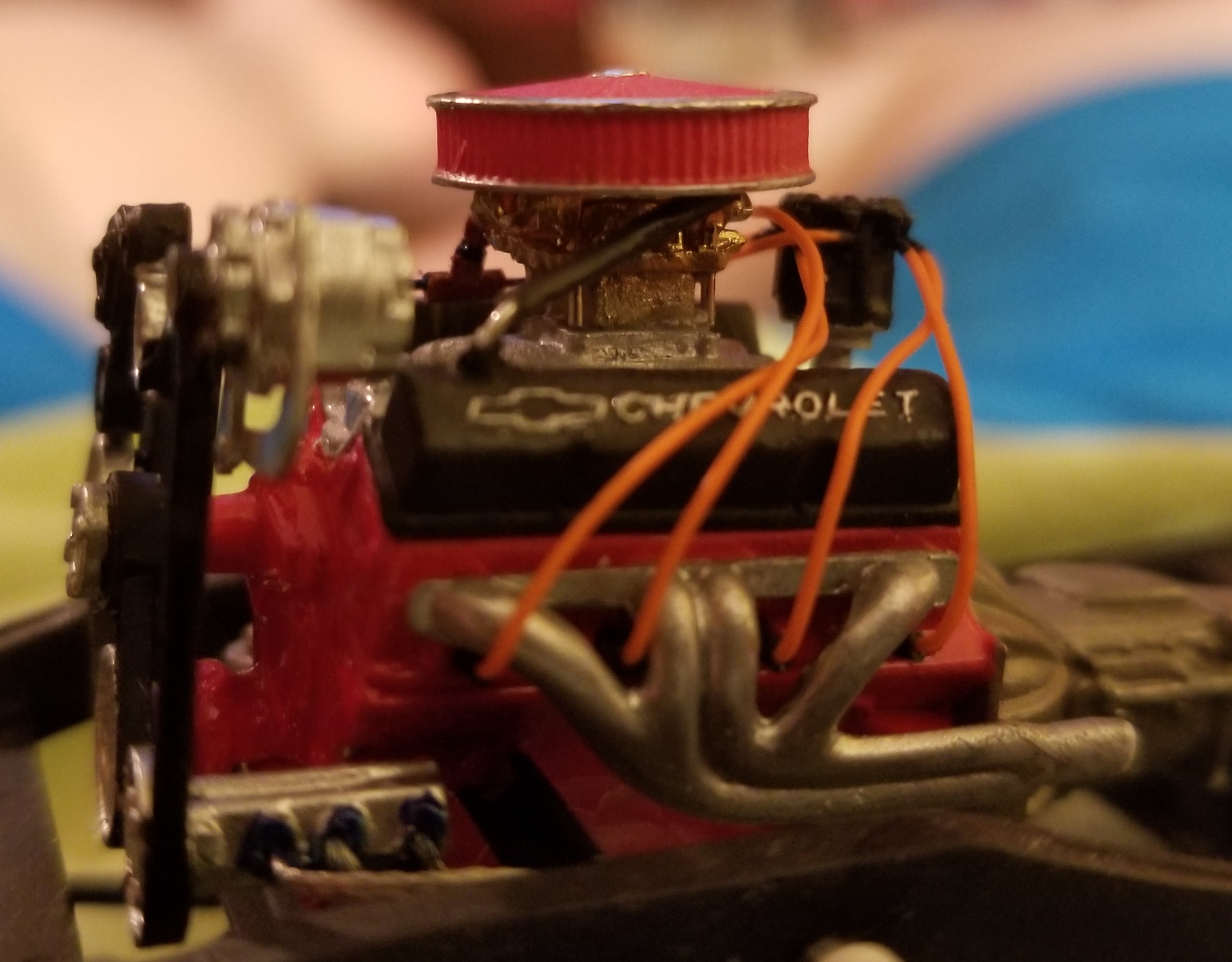

I finished the top end of the motor with a Holley carb and an air cleaner from Kris Morgan at M.A.D. I added the fuel line with anodized aluminum wire and the connectors are drilled out hexagonal rod. I also made a carb spacer from Evergreen stock and used wire from the bolts.

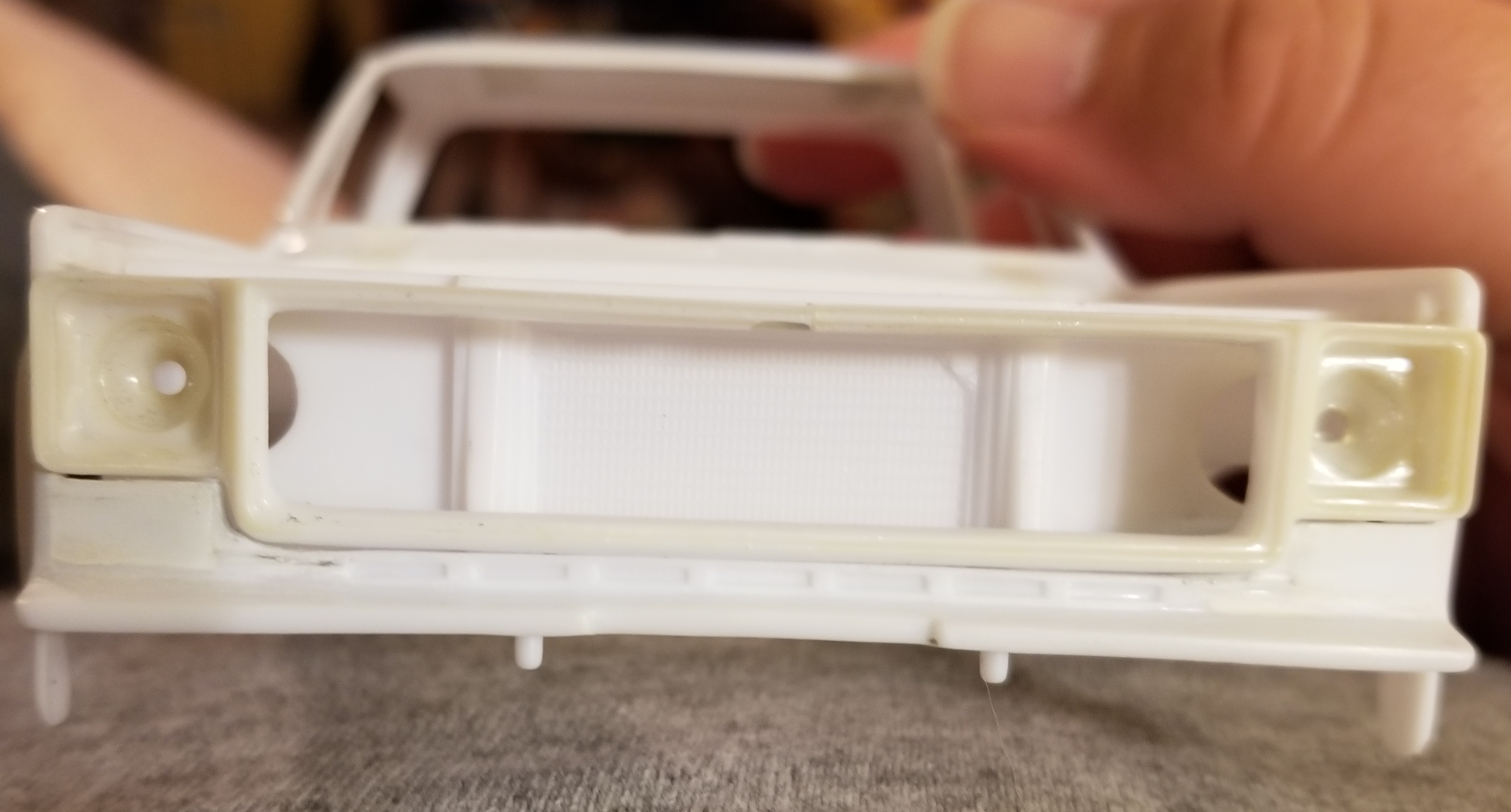

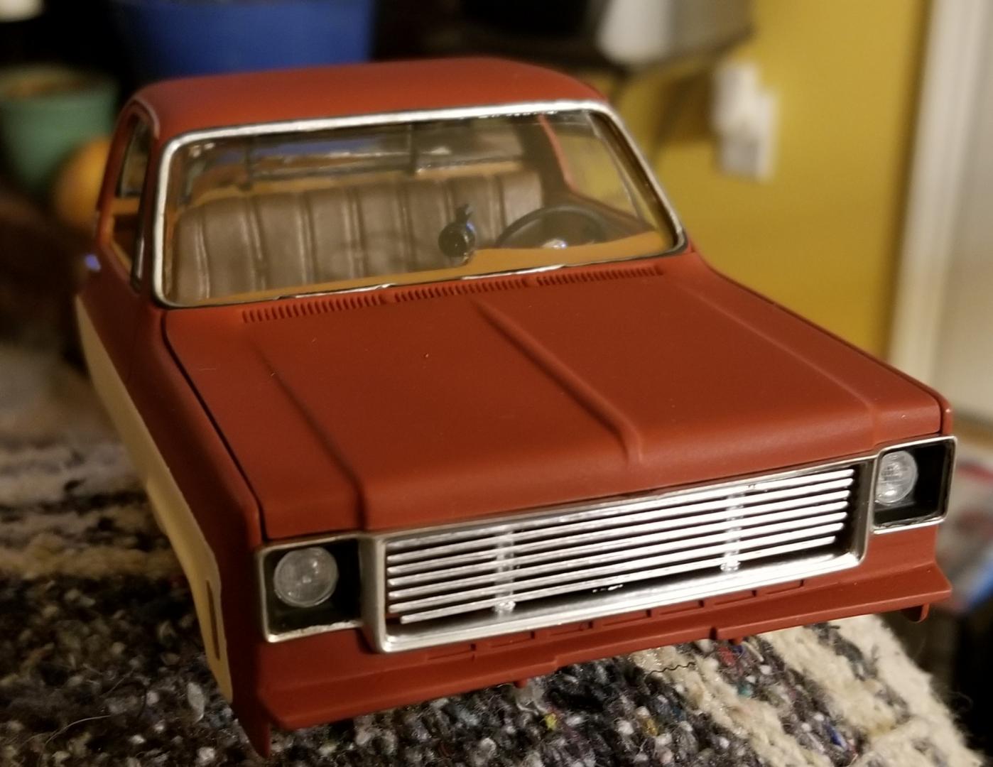

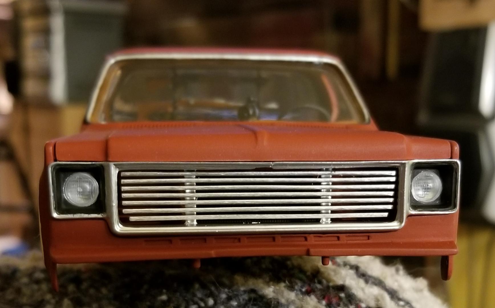

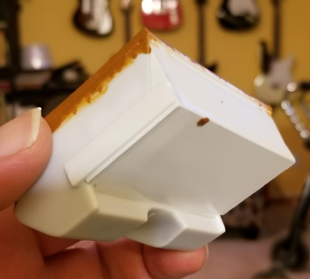

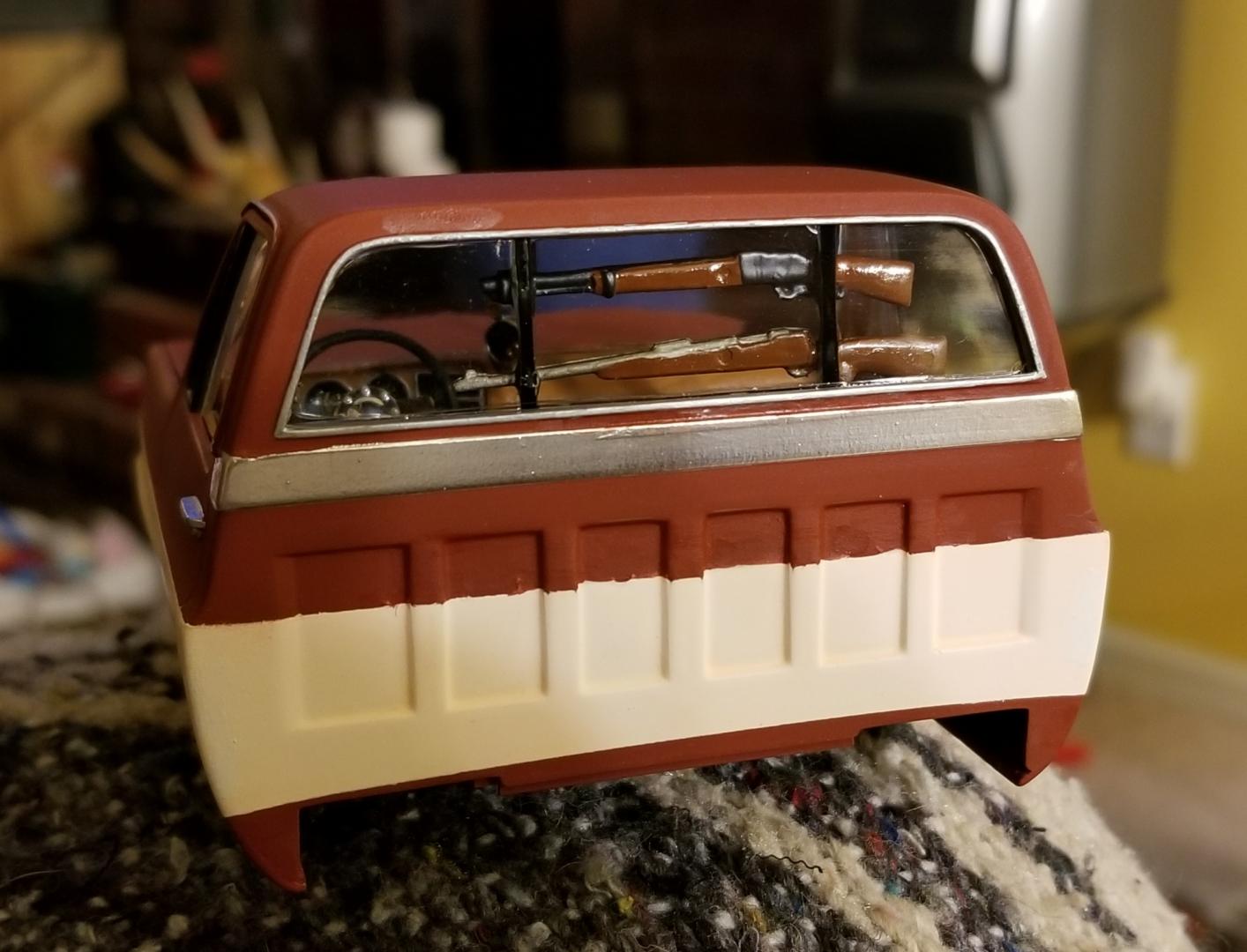

The cab is about ready for paint, I reworked the grille area because I hate how the kit treats the front turn signals. I cut the turn signals off the grille and filled the resulting hole with sheet stock. I saved the signals and sanded them down and reshaped them a bit and will add them back after the paint is done. I also added drip rails to the cab.

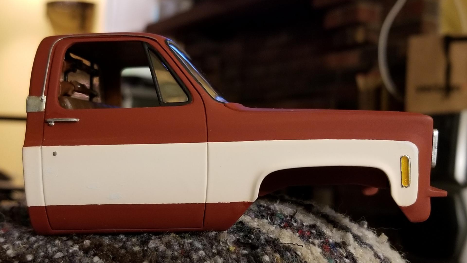

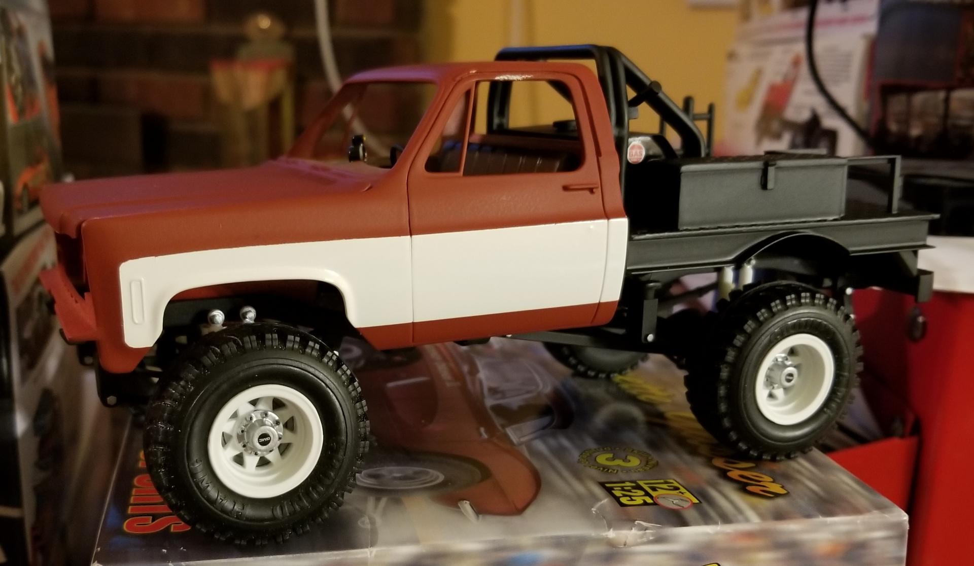

My sealer coat wrinkled so I've got to strip the cab but I still wanted to post a shot of the color combination.

Nice Brian !! I cant see any wrinkles....

They're mostly on the other side and roof. By the time everything was dry they weren't as visible but it still looked pretty bad.

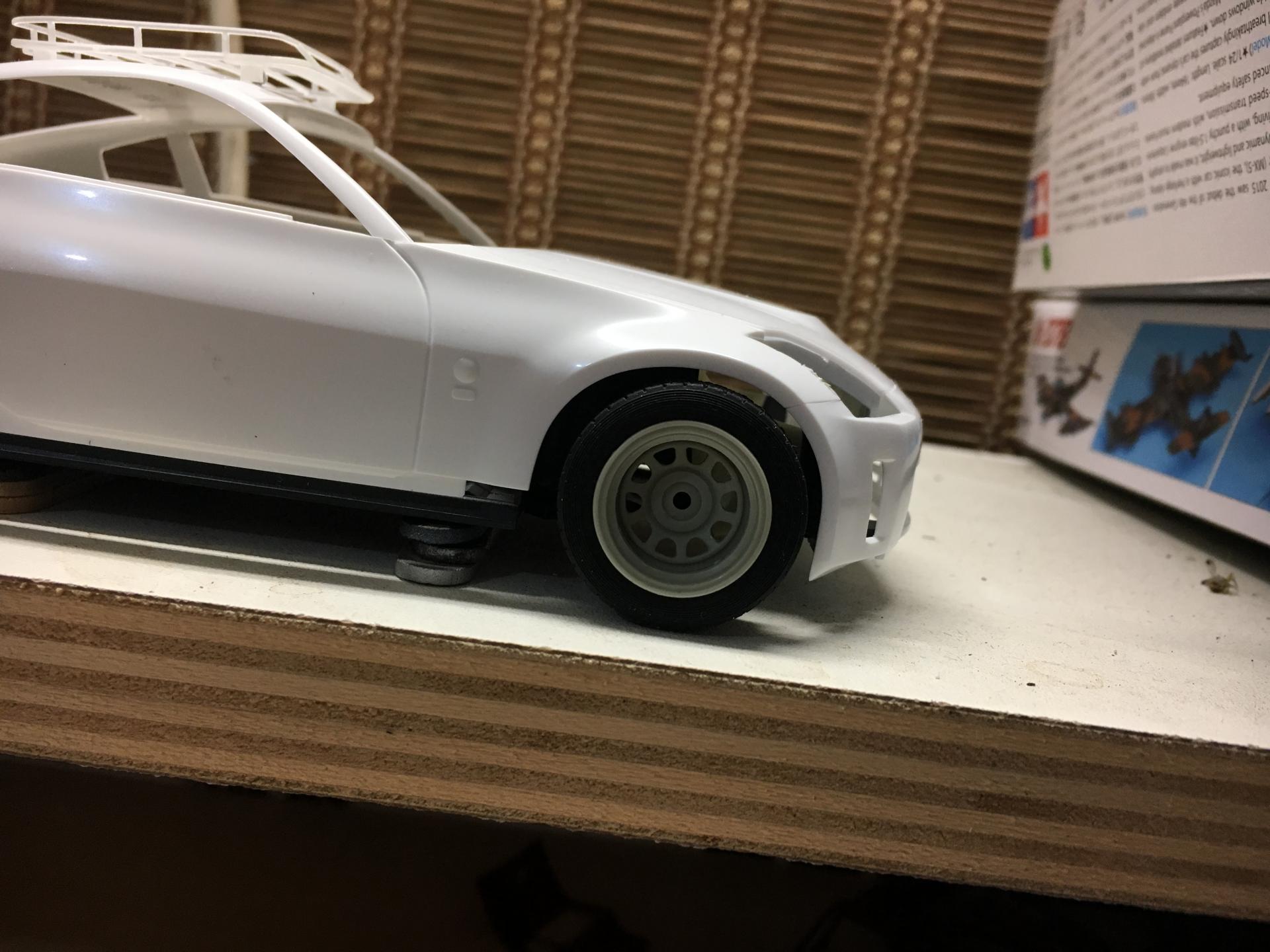

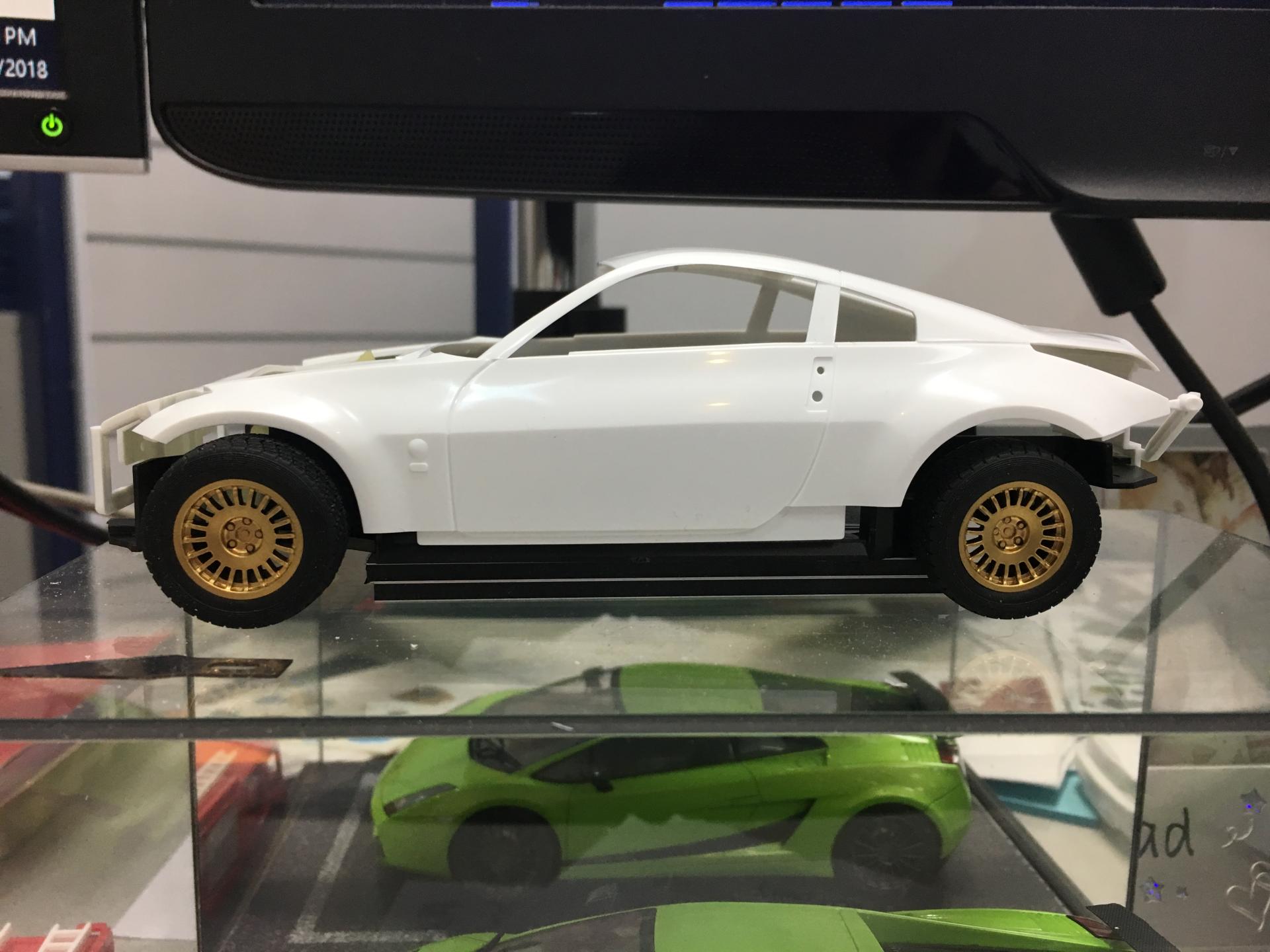

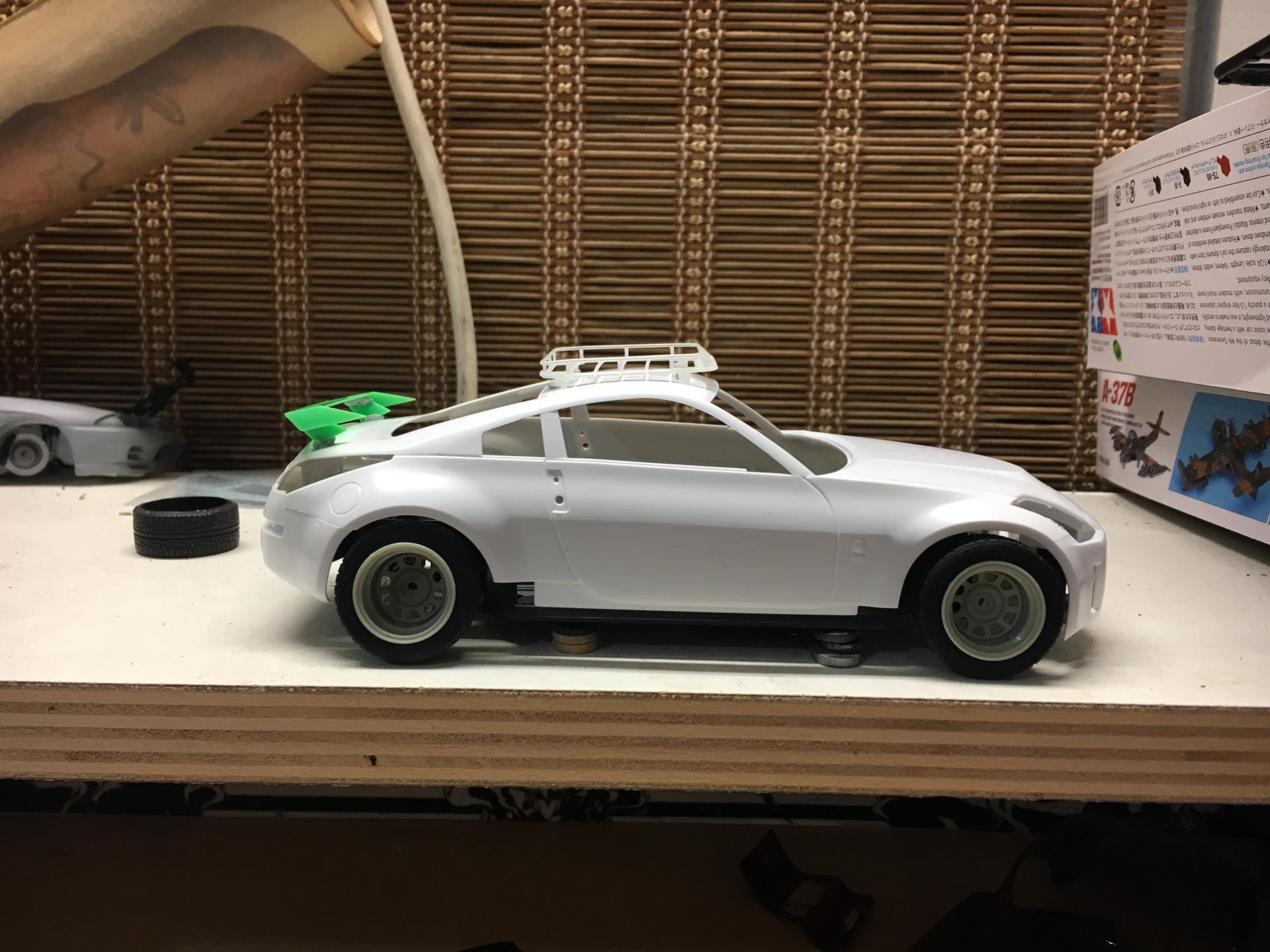

My Kit finally arrived! Not bad for $16usd! Gonna have some fun with this one!
Stay Tuned! more soon!

Yip! Rally wheels arrived today, dont think I'll use the rim though.

All good, yeah should be a bit of fun, something a bit out of left field & different for a change!
Its not going to have an engine though, just a nice simple curbside. Will add a front diff & driveshafts for the He'll of it
