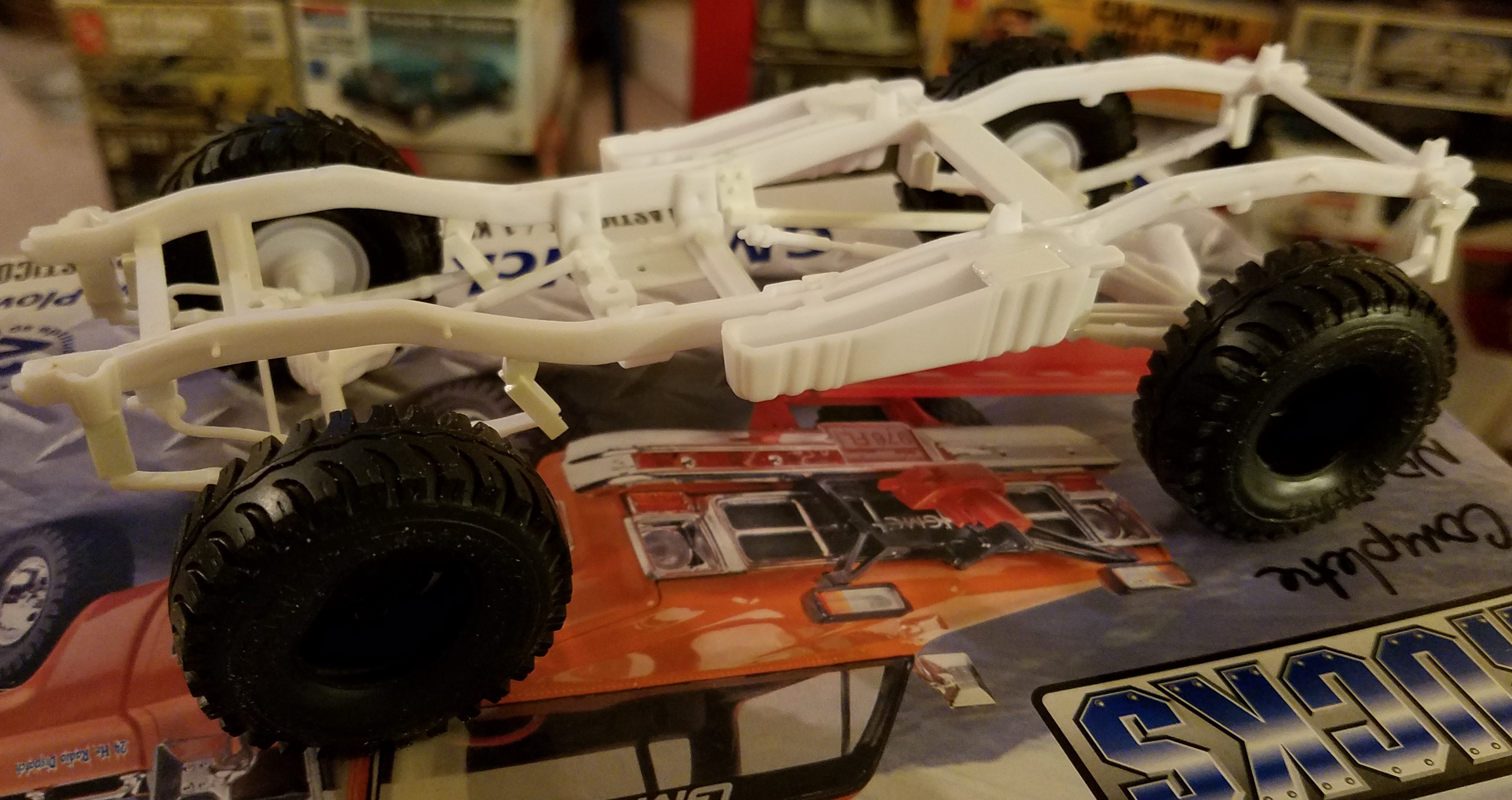

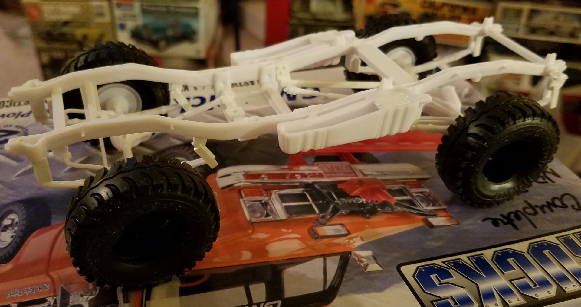

This is my entry in the Ultimate Weekend Warrior GBP. I'm starting with the Monogram plow truck. I was going to use American Satco Super Swampers but the dudnt feel quite big enough so I borrowed the tires out of a Mad Murder kit. I was going to use it's axles too but they're a bit wide and the truck looked like a roller skate. I ended up using the stock axles and making my own spring perches and shackles. The chassis is almost done, just a few more bits before it's time for the body work.
20180409_092223.thumb.jpg.7acb9cb31b3285281ce5efa95136cb65.jpg20180412_223507.thumb.jpg.f38708de7736463702ad083719aea833.jpg20180412_223432.thumb.jpg.c0ec860f69c9d655e824c1b97bcaf61f.jpg

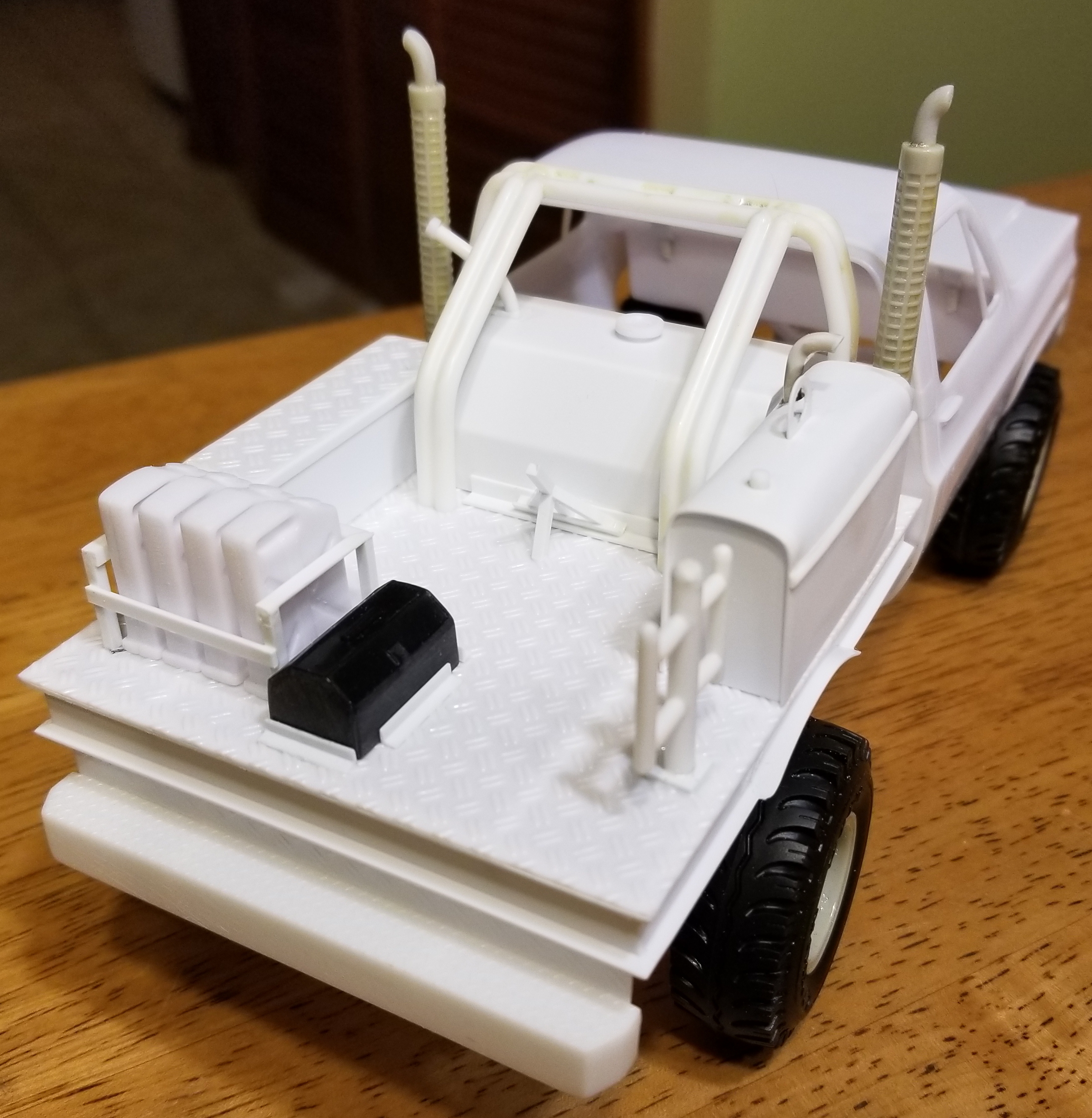

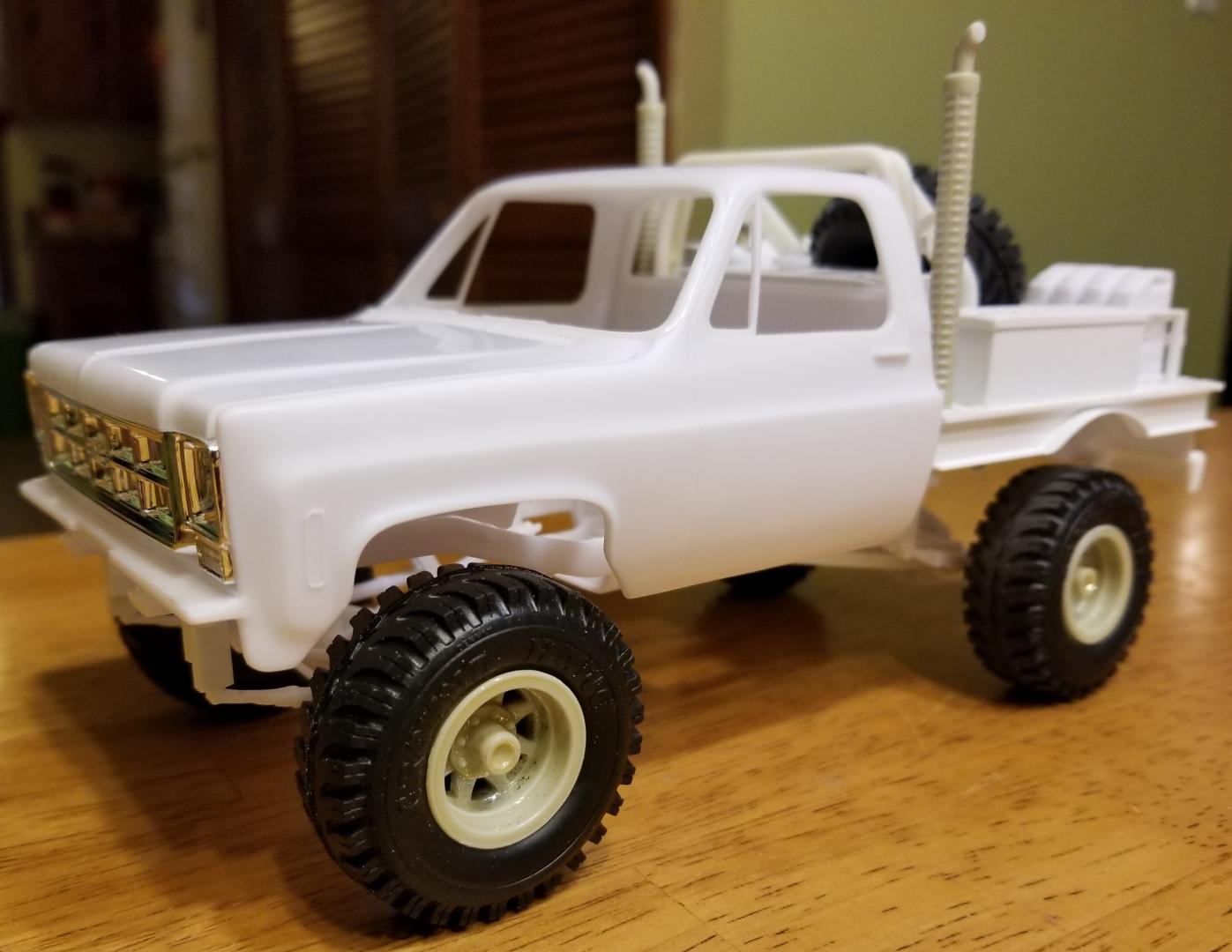

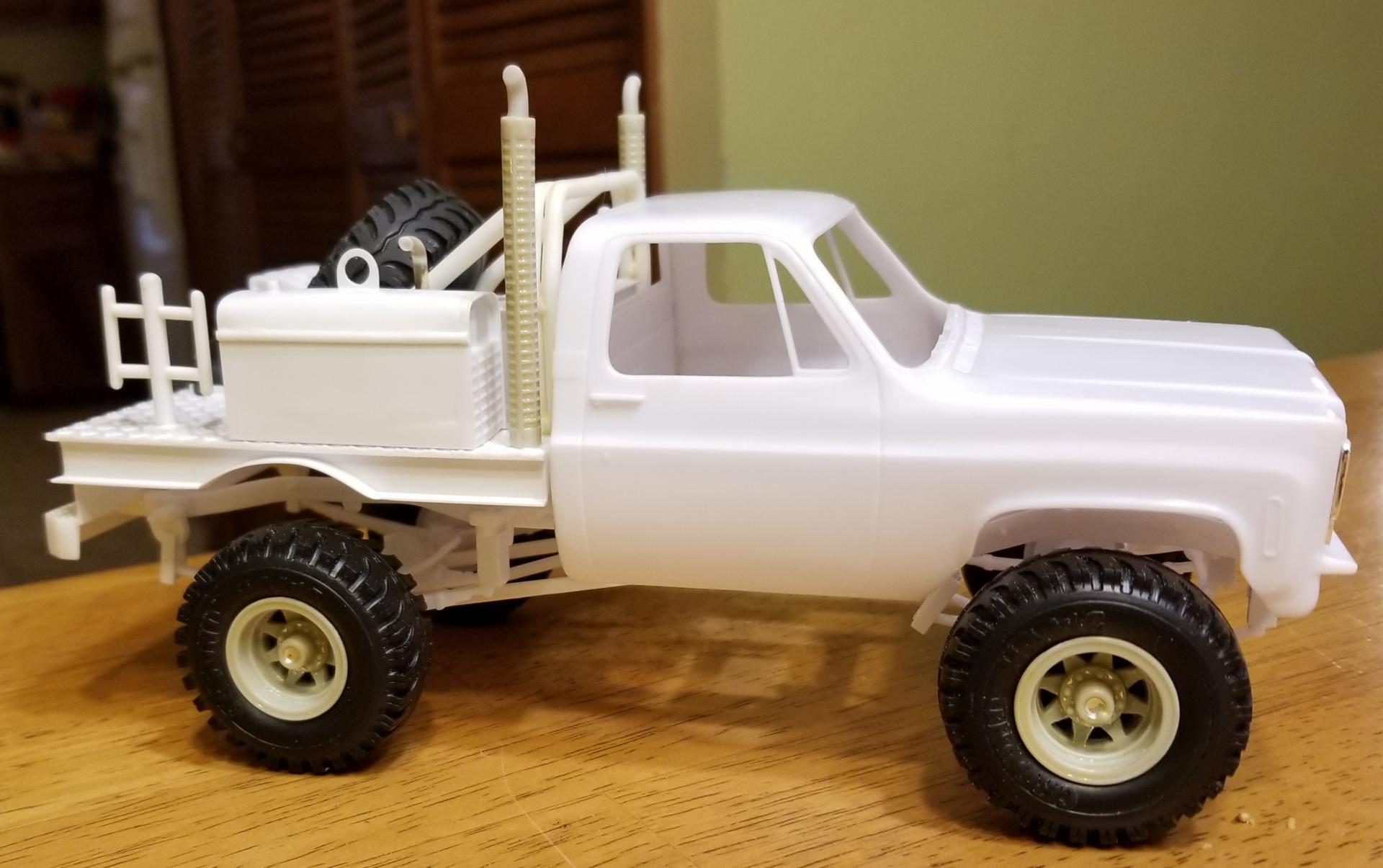

I'm a bit late with the update but I think it was worth the wait. The part I robbed from this kit was the bed so I had to replace it with something. I built the flat bed from Evergreen and some diamond plate. Once I had the bed I needed to populate it with something. I added the roll bar, a storage box on the driver's side, a jerrycan rack, a bed mounted fuel tank, a tool box, a spare tire mount, and a welding machine with a post for the leads. I cut the front fenders for more tire clearance and used the rims from the Deserter truck.
20180417_200947.thumb.jpg.5adba5f678526cf15cf49c54e612ecda.jpg20180417_200809.thumb.jpg.3d10da884ab00c0ed97ff923c3f48e18.jpg20180417_200717.thumb.jpg.04a1dd15d72d451c75d166a7366ab7bf.jpg

Love that bed, looks spot on and useful.
Thank you, I think I might shorten the stacks in the final assembly. They're just tacked on so I could snap some pics and get a feel for the look of it.

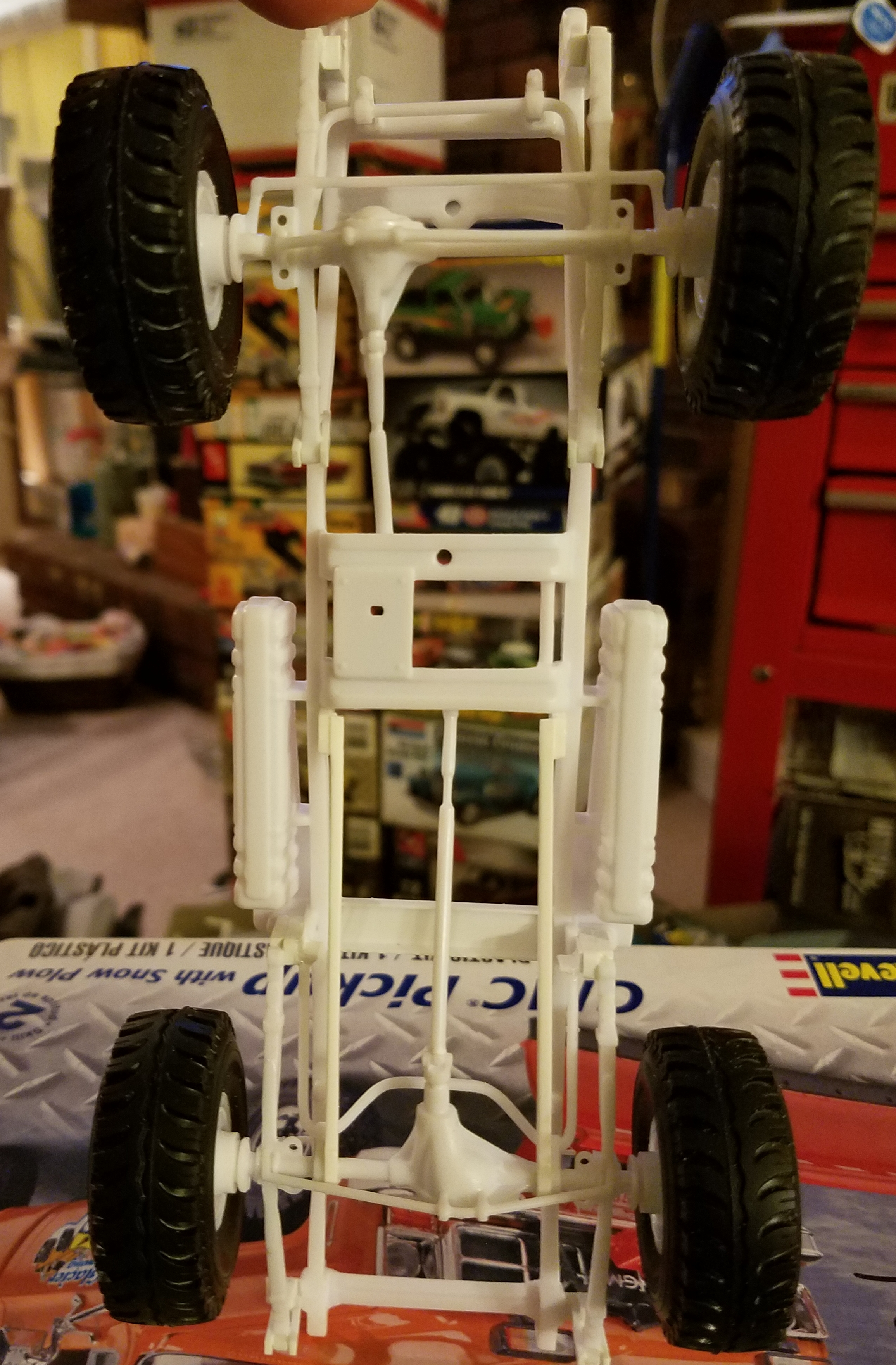

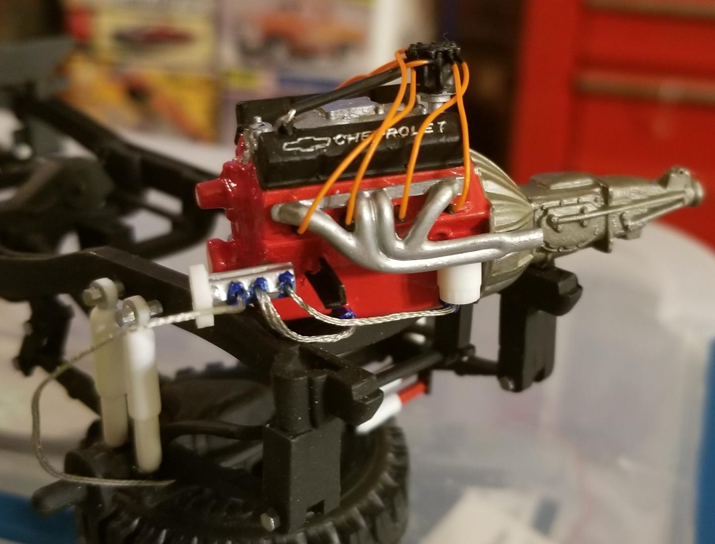

I've been working on the frame and getting the engine together. I've got the shocks on and added a steering stabilizer. I took the engine from a mid 2000s NASCAR kit and am building it to look like a small block crate motor. It's been a while since I plumbed an engine and it felt nice to flex those muscles again.
20180424_181928.thumb.jpg.ec032ebf95a415e94f0d5b4663350669.jpg20180424_182027.thumb.jpg.1ff0fd4d04c6945d9b3156e00c633a8c.jpg

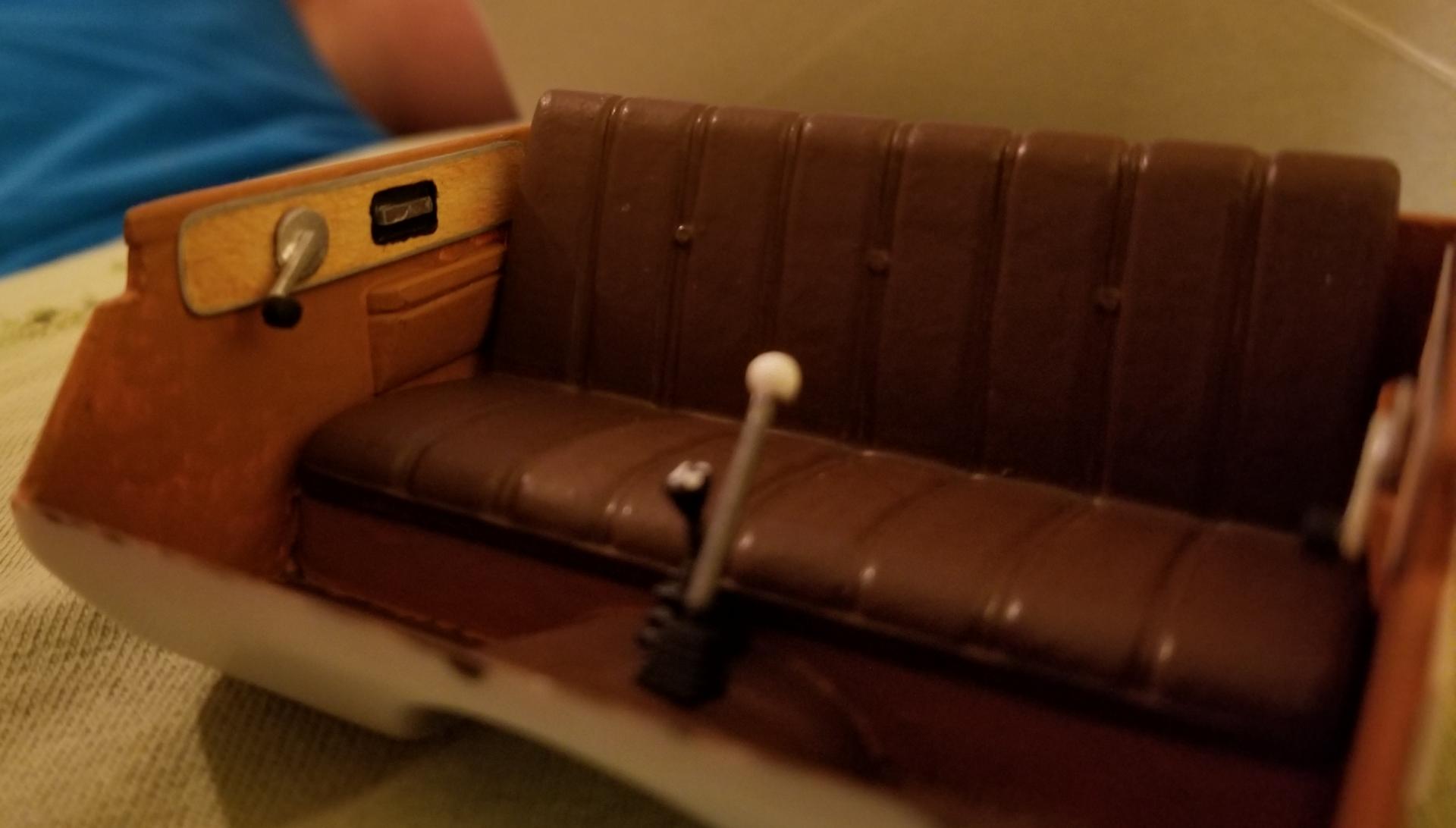

The interior of the GMC is very weak and the door panels are almost completely flat. I'm going to be building a few of these kits eventually so I figured I'd try my hand at dressing it up a bit. I cut the seat out and built an actual tub for the interior. Then I added the arm rests and wood trim along with the door handles and window cranks. I also added a floor shifter and removed column one. The dash is stock but I robbed the gauge decals from the Camo truck. I went with a brown two tone figuring it would hide dirt better than other colors.
20180429_030328.thumb.jpg.76b060837ce0b87032577b3cf20c57b3.jpg20180429_030237.thumb.jpg.38326ae0f7a14ed47c28519514fbe451.jpg20180429_031121.thumb.jpg.6b19dcf1548c067adb08cfc5c3fcabbe.jpg

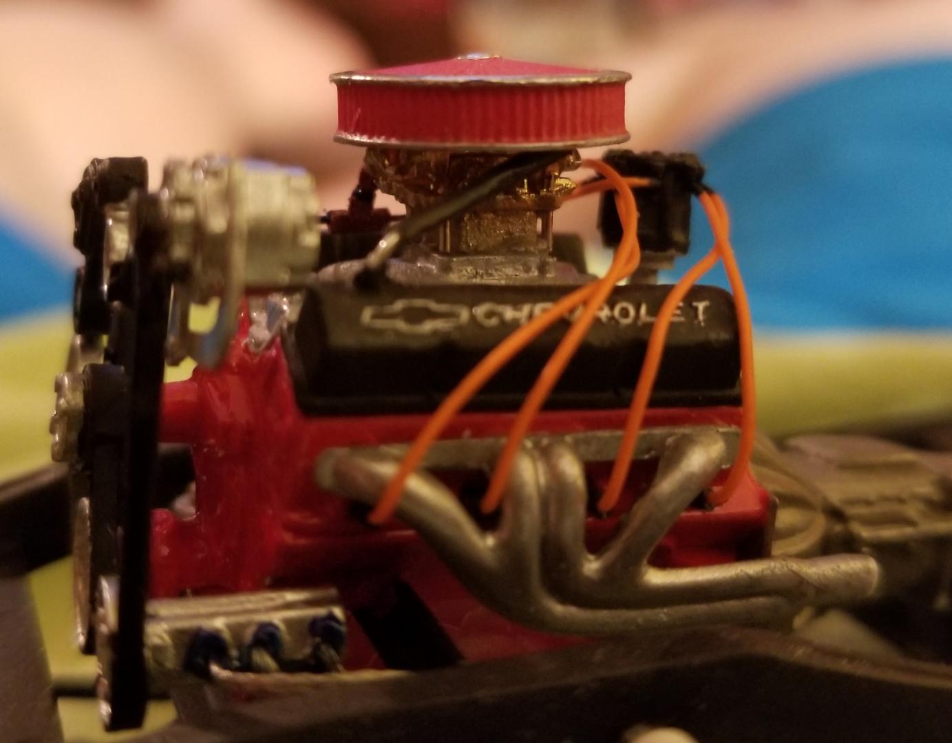

I finished the top end of the motor with a Holley carb and an air cleaner from Kris Morgan at M.A.D. I added the fuel line with anodized aluminum wire and the connectors are drilled out hexagonal rod. I also made a carb spacer from Evergreen stock and used wire from the bolts.
20180430_013609.thumb.jpg.060bd525f3e8b373a3b89a8da168d0b0.jpg20180430_013531.thumb.jpg.ae744695dadcf24e52b79fc95bed28cf.jpg

Don't forget the A/C compressor, that pulley is suspended in air!
Looking good, nice details.

I ain't forgot it, I just can't figure out which part it is so I've got to dig out the USA-1 instructions to check. It'll be on there next time I promise.

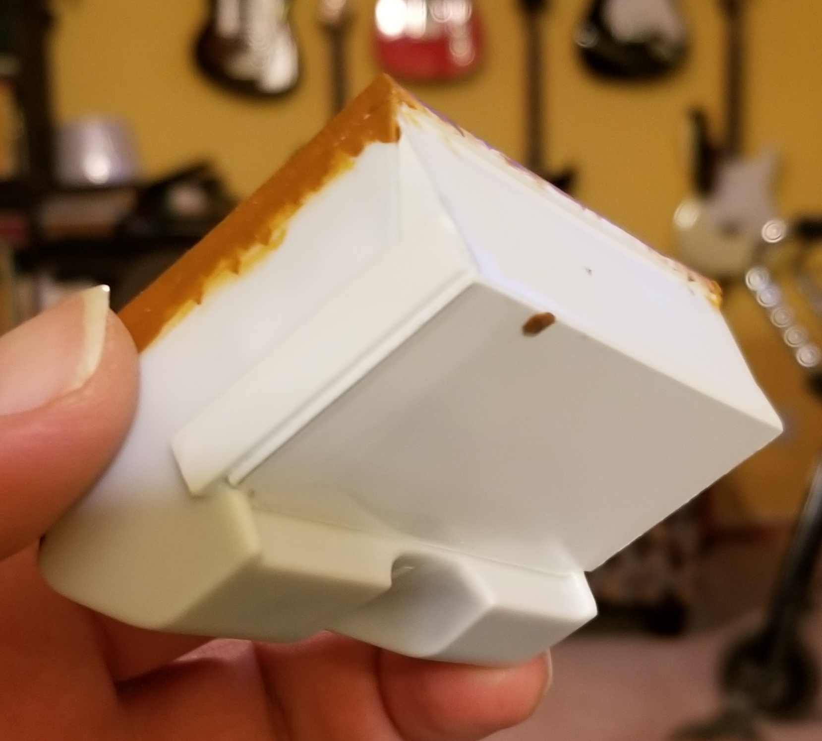

The cab is about ready for paint, I reworked the grille area because I hate how the kit treats the front turn signals. I cut the turn signals off the grille and filled the resulting hole with sheet stock. I saved the signals and sanded them down and reshaped them a bit and will add them back after the paint is done. I also added drip rails to the cab.
