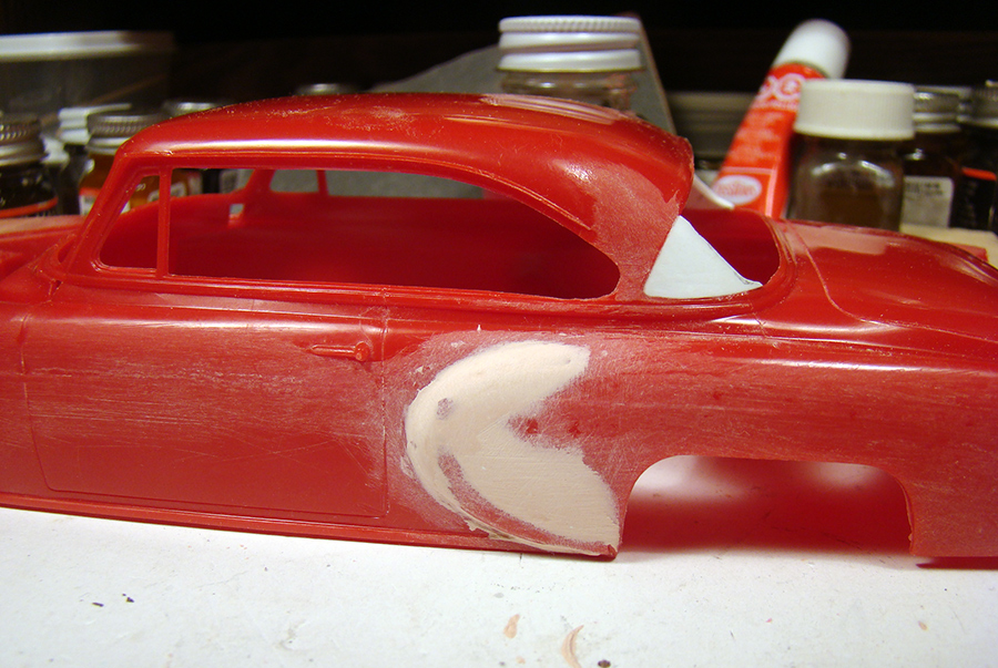

Side reshaped....
Sorry guys! :lol:  I committed to the hideous headlight buckets. Per recent suggestions I might still knock down some of the pointiness. No pics yet, but I've finessed the rear window and added window trim. New side trim is almost done. Getting ready for primer.
