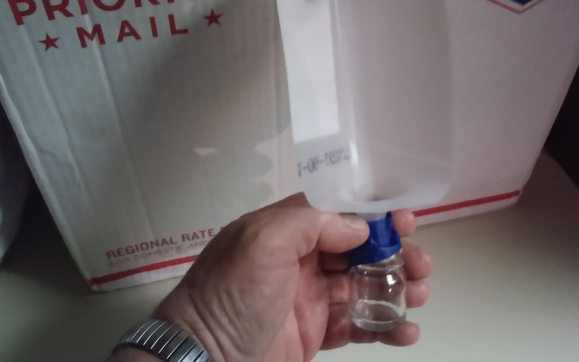

This is how I do it Dan....translucent milk container handle cut out ......also helps speed up in Degassing before using thru the airbrush.   I buy all basic common regularly used colors in the big rattle can & decant as needed.  Cheap, renewable & it works.

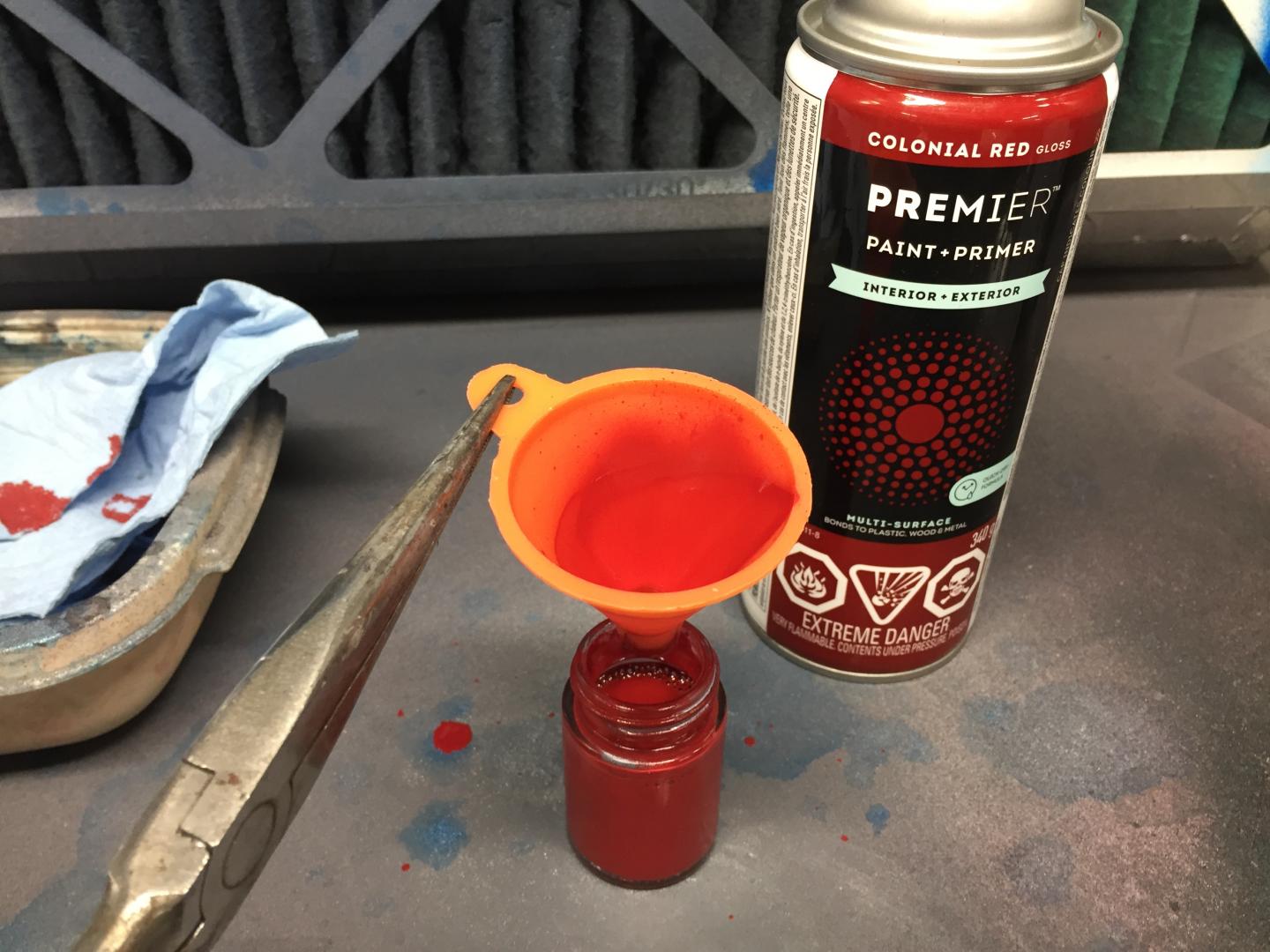

I read somewhere on here about someone spraying into a funnel. Thank You whoever that was! The milk jug handle trick above would also work great I think.
