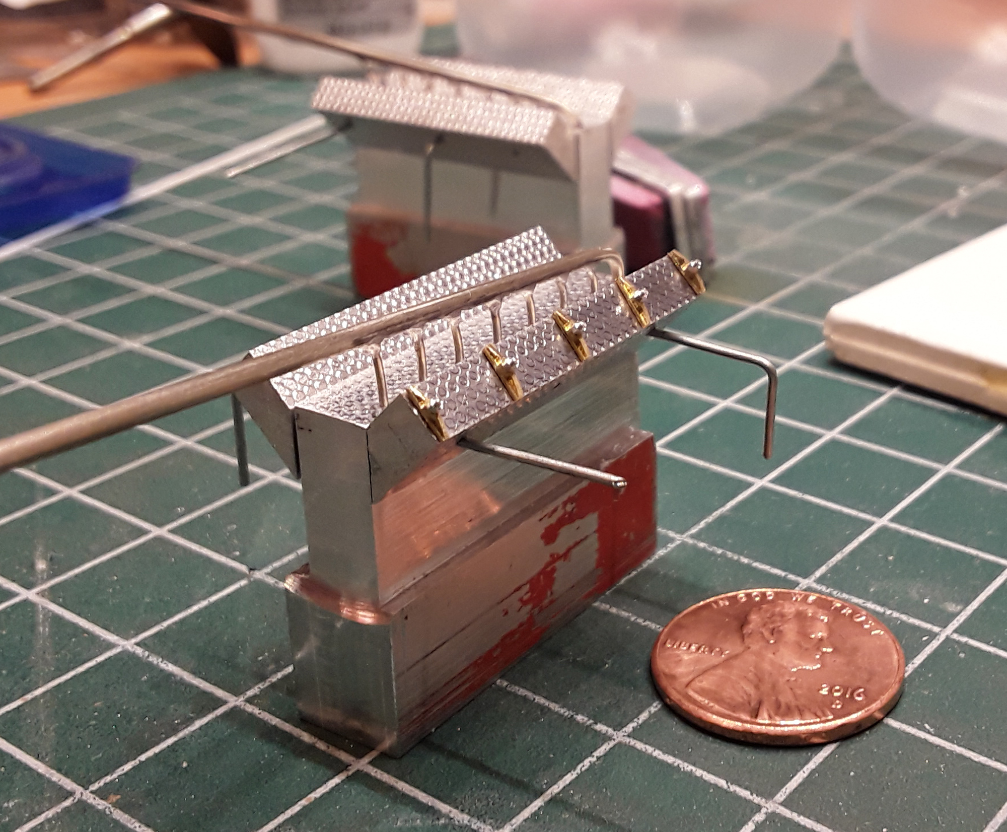

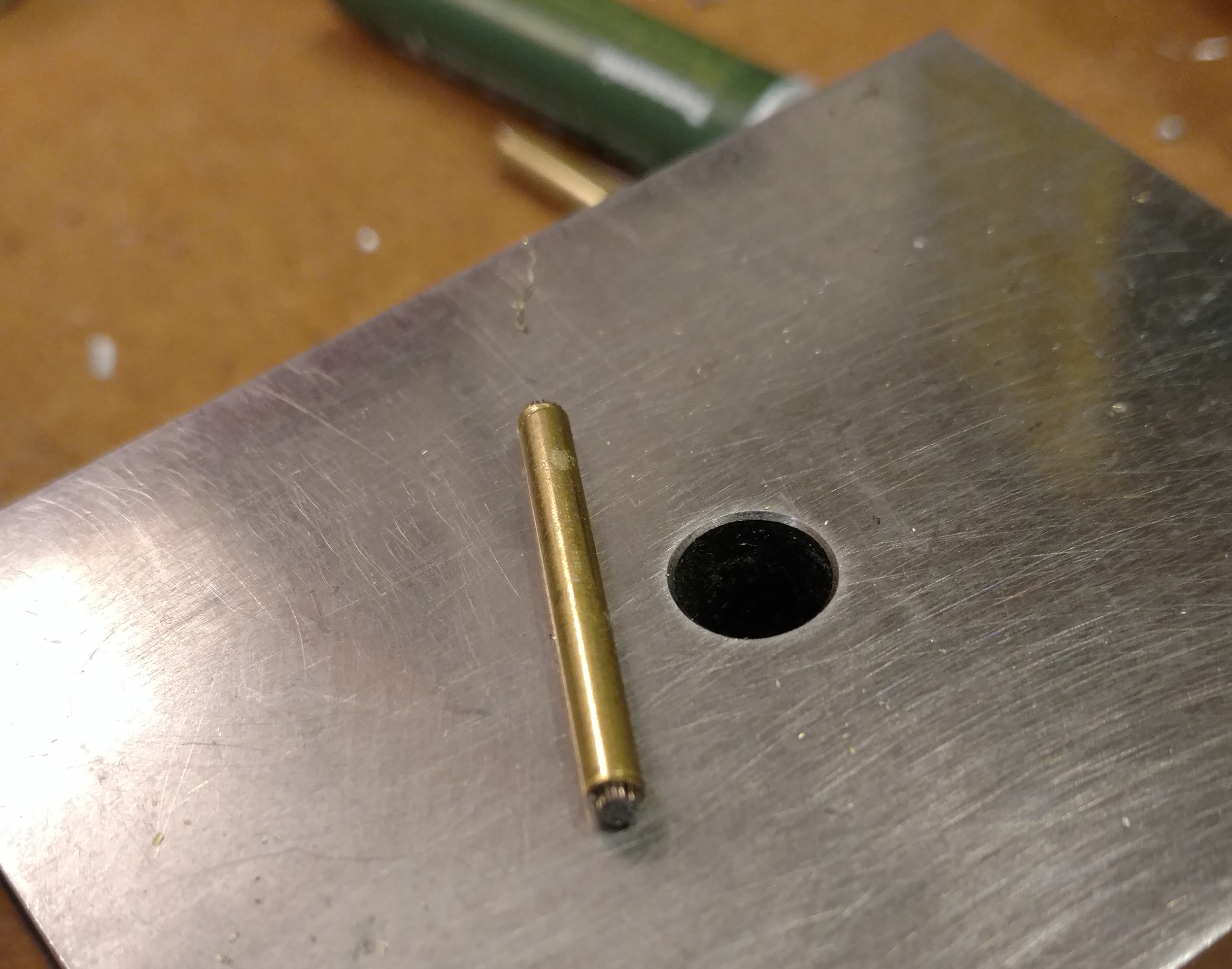

Since you mentioned Bugatti, here is a shot of an engine I am working on.  The engine turning is done with the wire brush in the photo.   I made it by taking brass tubing and stuffing it with stainless wire and super gluing it in place.  I then put it in my Sherline mill and had at it.  Tedious as all get out.  I had to stop frequently just to uncross my eyes.

4 hours ago, Pete J. said:
Since you mentioned Bugatti, here is a shot of an engine I am working on.  The engine turning is done with the wire brush in the photo.   I made by taking brass tubing and stuffing it with stainless wire and super gluing it in place.  I then put it in my Sherline mill and had at it.  Tedious and all get out.  I had to stop frequently just to uncross my eyes.
Nice work.
Very nice indeed. Being able to raise and lower the rotating brush precisely, and accurately advance and position the work on the mill table makes such evenly spaced results more consistently achievable. I'll have to give that a shot on my old Unimat.
