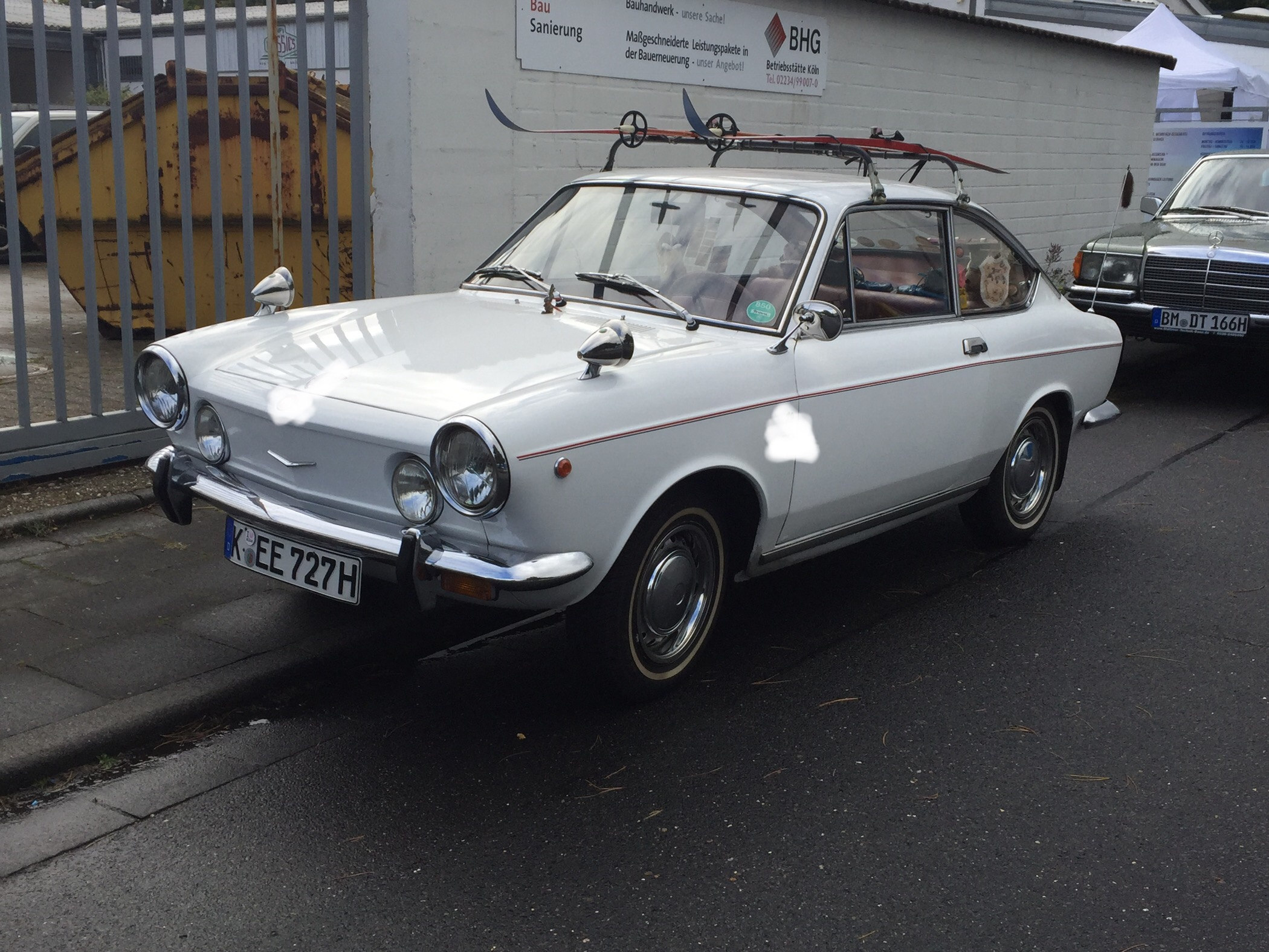

All I'll say about that car is that is one real oddball------one that's not often seen anymore..........anywhere! ;)

The owner of this one obviously likes to see what's behind them!
Don't think it is Japanese, but all Japanese cars have the forward fender mirrors. I spent two years in Japan, and those mirrors are wonderful! You have no blind spot and can see both mirrors thru the windshield. I wish they would mandate them here.

Thanks Tom
Interesting info - I'm just questioning the use of a door mirror as well, which seems like overkill...

This the following members sent in the correct answer
Earl Marischal
otherunicorn
ChrisR
sjordan2
VW93
Matt Bacon
dw1603
Ace-Garageguy
MrObsessive
DonW
blunc
Red318
matthijsgrit
Well done

Totally couldn't find this one!  You really messed me up with the cross country ski's on the roof, the german sign and the Mercedes behind.  Spent way to much time looking as obscure German auto manufactures. :lol:
