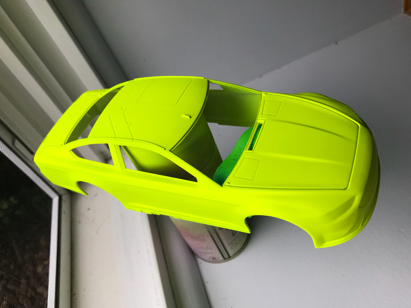

Laid some paint down yesterday. Testors/Pactra Fluorescent Yellow over Tamiya white primer. Three coats. Waiting a week before I clear it. Can anyone confirm that Testors or Tamiya lacquer clear will work over this polycarbonate paint?

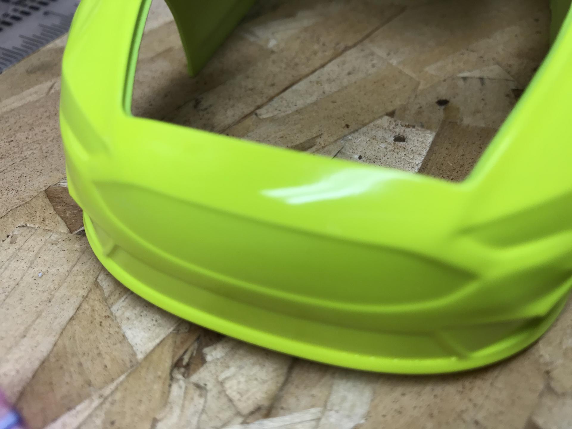

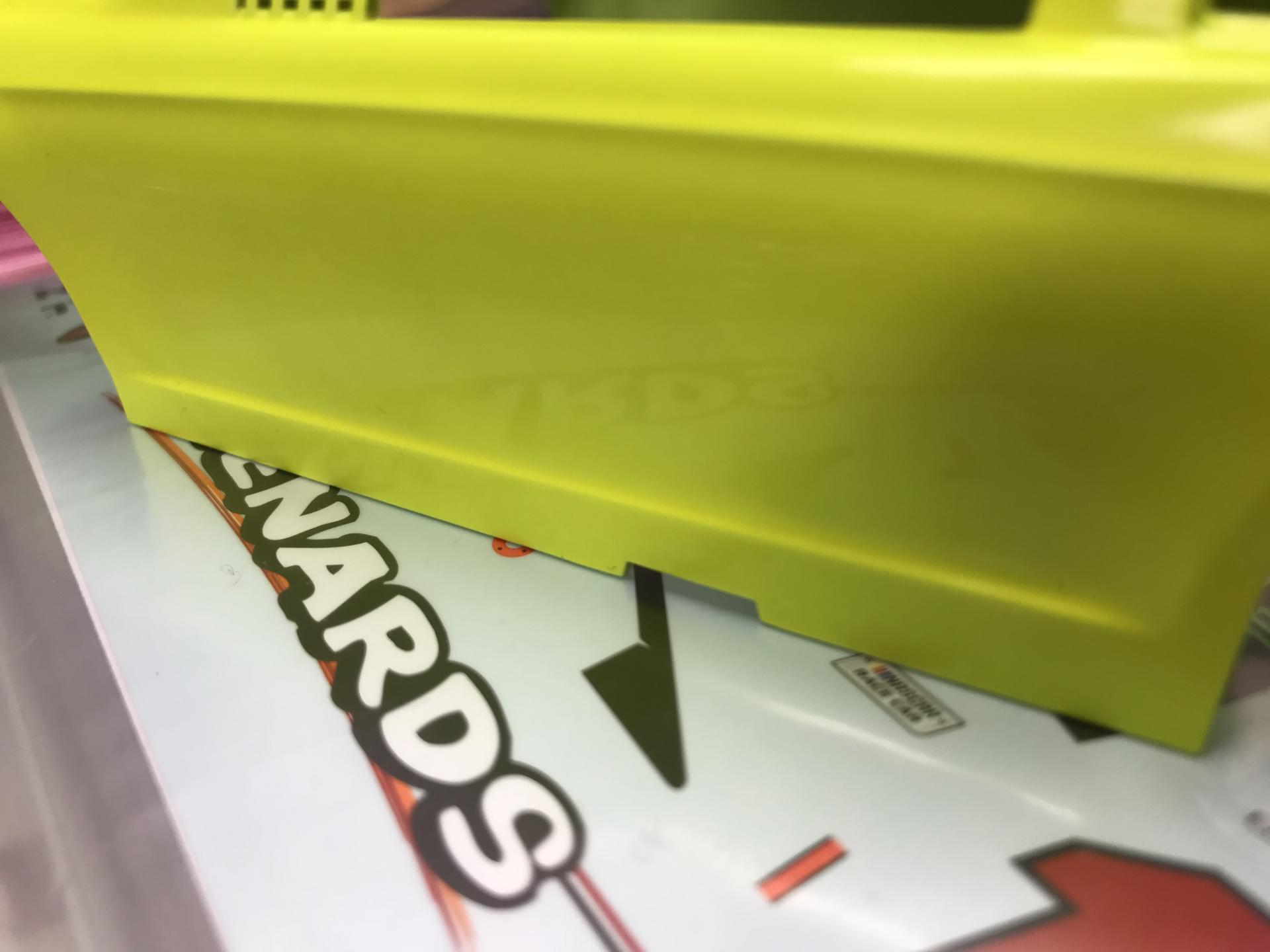

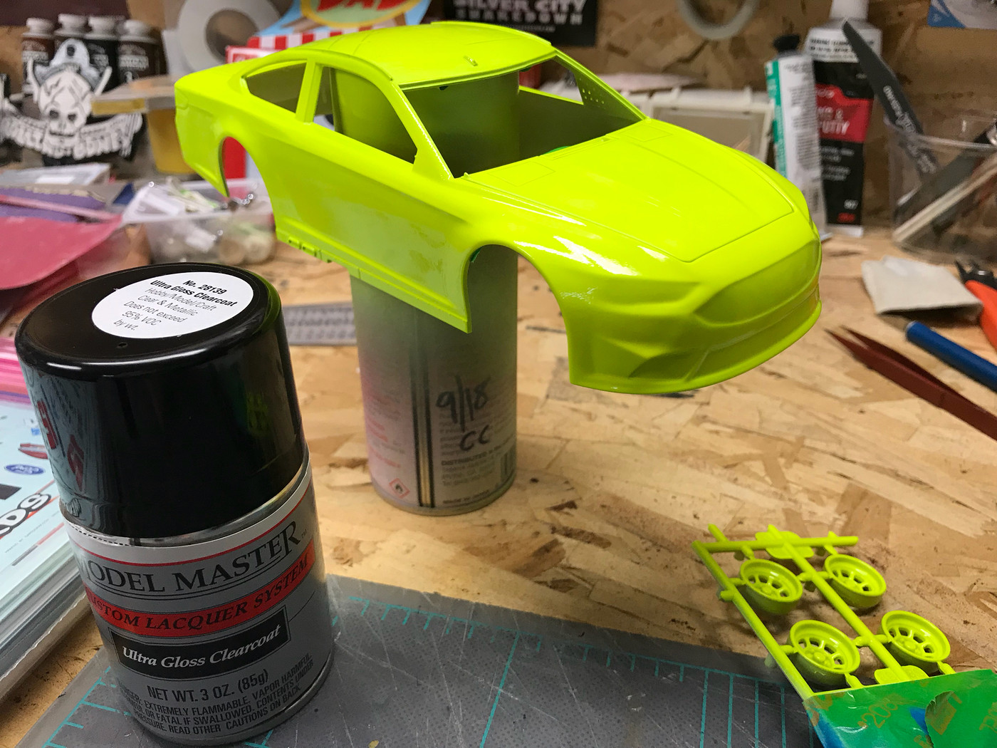

I tested Model Master High Gloss Lacquer Clear on the spoon and it went well. So, per the can's instructions, I laid down two wet coats of clear (plus one more) a few minutes apart. Should be plenty to polish to a nice shine. I read on the Pactra Polycarbonate paint can that the paint is resistant to fuel, solvents, etc. So it's tough stuff. Didn't change its hue or shade with the clear over it either. Highly recommend.

Matt,  from the looks of that front fender, it doesn't look like you need to polish it at all. Looks Awesome.

Thanks Mark. That photo is about 10 mins. after spraying. It has since shrunk enough to lose that wet look. But I've used this clear over the automotive colors before, and it polishes nicely.

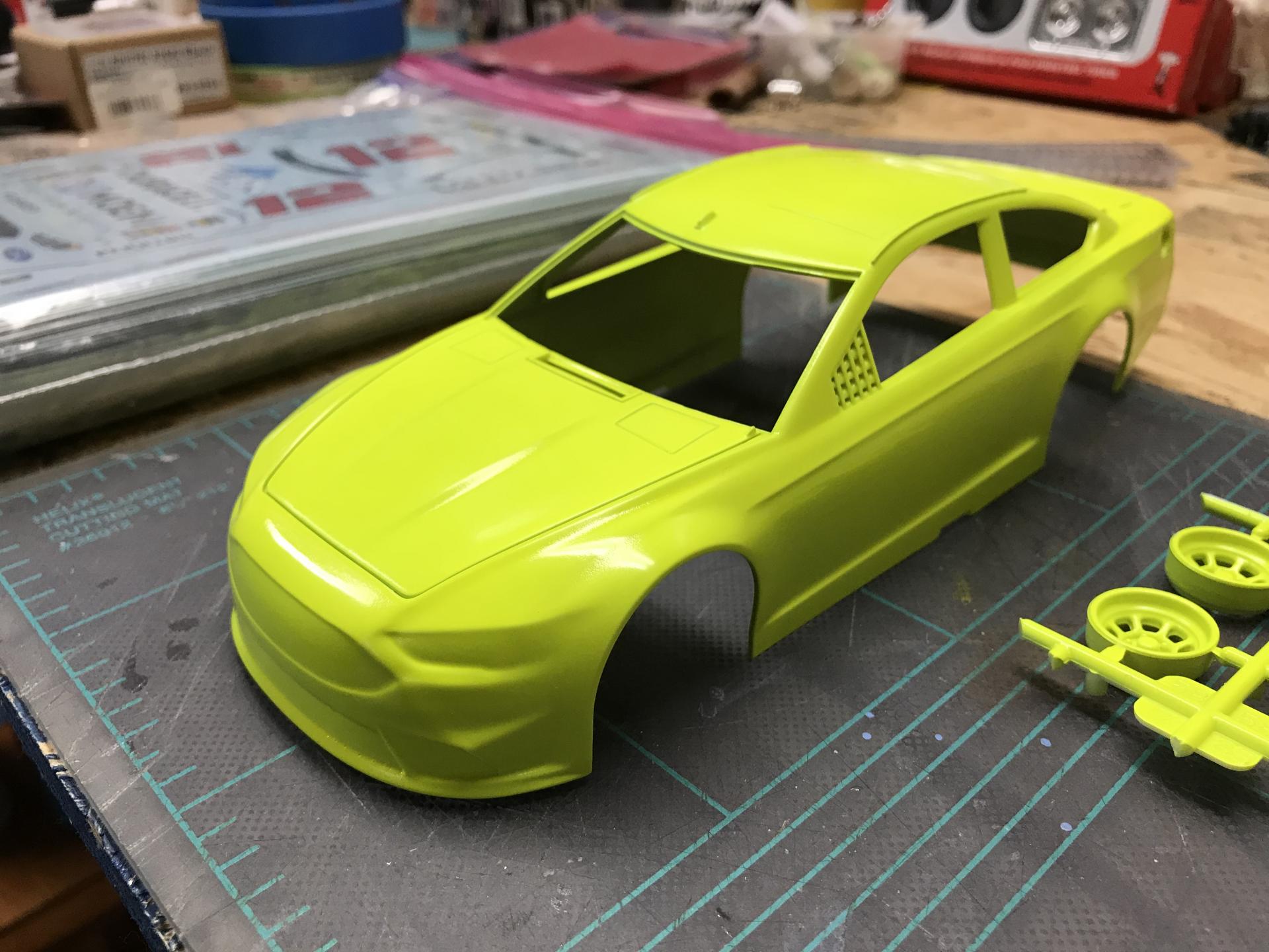

As expected, the Testors clear polished up nicely. I used 3,200 - 12,000 grit cloths, followed by Tamiya Finish Compound.
Next up, decals ...
