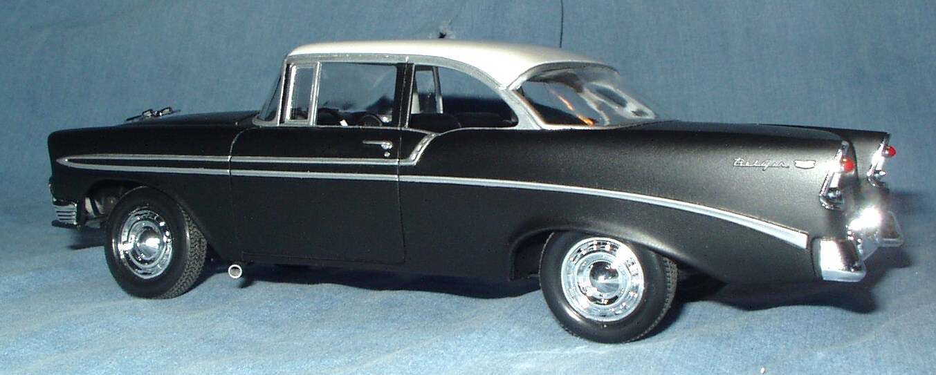

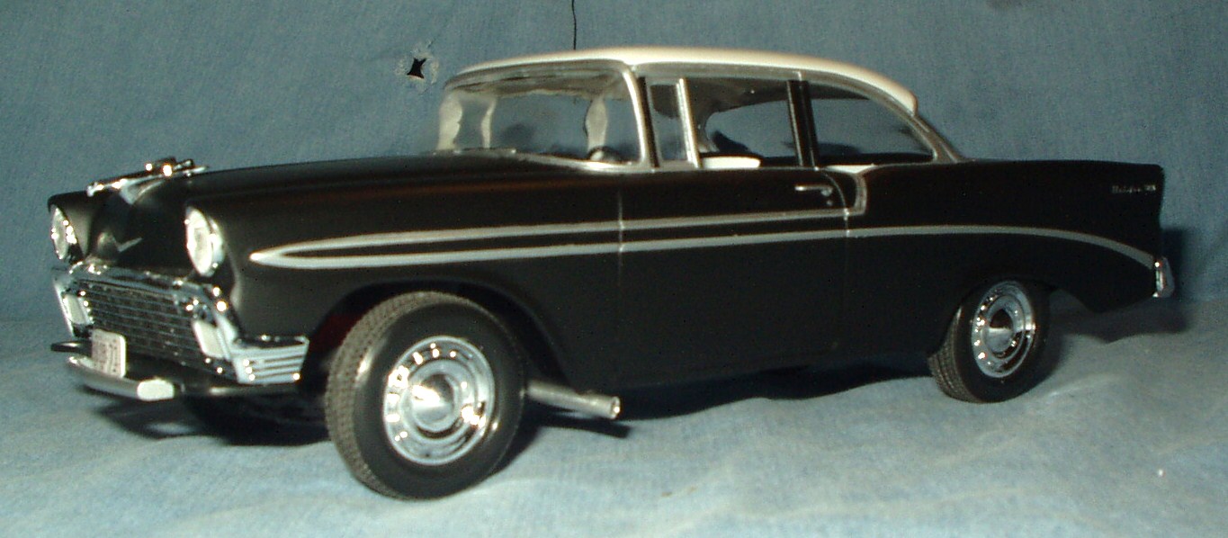

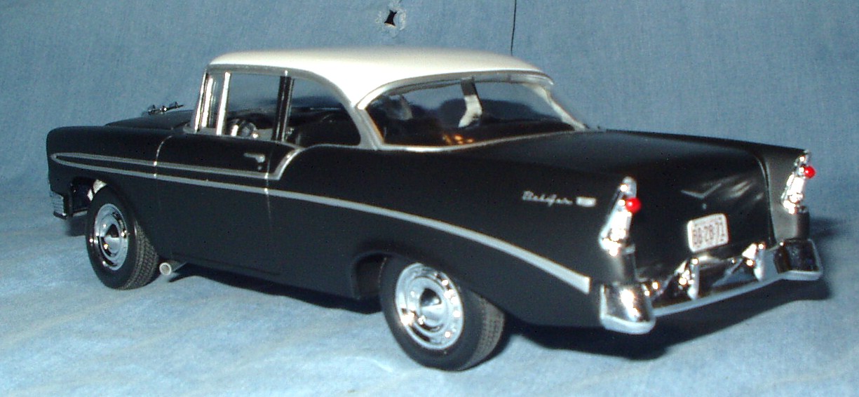

On 6/7/2018 at 1:01 PM, StevenGuthmiller said:
I asked for some photos a while back on a different thread of some side spears or other long trim on a model done with the pens & an explanation of how it was done & have never received a response.
Steve, tell me what you think of the side trim and window trim on this '56 Bel Air.
Well, I will be honest an blunt and say that it is very straight and well done, but it doesn't look a lot like chrome to me.
I don't want to offend you, but you asked for my opinion.
Was it done with the Molotow pen, paint or a Sharpie?
Steve
Steve
It's Testor Chrome Silver, airbrushed BEFORE the main paint and masked with my homebrew liquid mask, applied by hand with a brush. Seemed like the best way to do this particular job.
I thought it did a pretty good job of portraying the trim on the real car, which wasn't SUPER bright chrome.
It doesn't match the chrome on the bumper but neither does the real car.  I think it looks great and just like the real thing.  Perfect execution.
What is the recipe for your homebrew liquid mask?  That turned out to be a perfect masking job.
