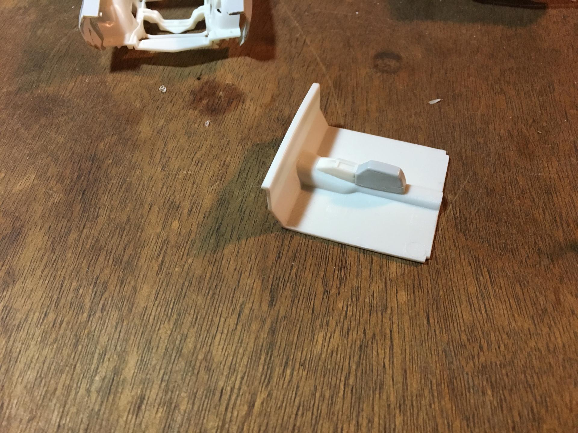

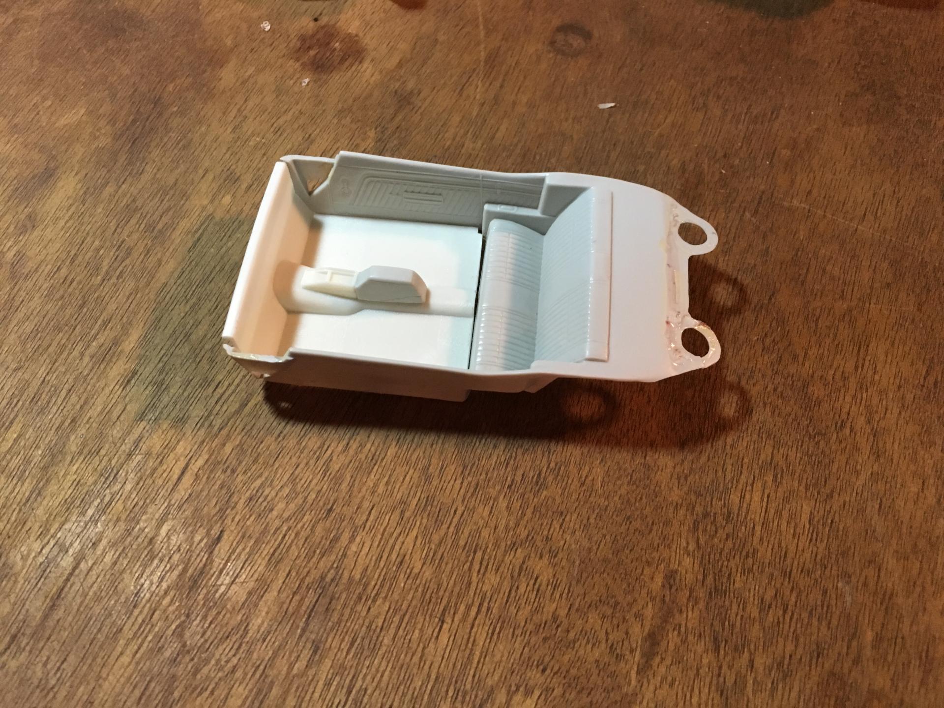

Here is the interior bucket I have been working on for the GTO.

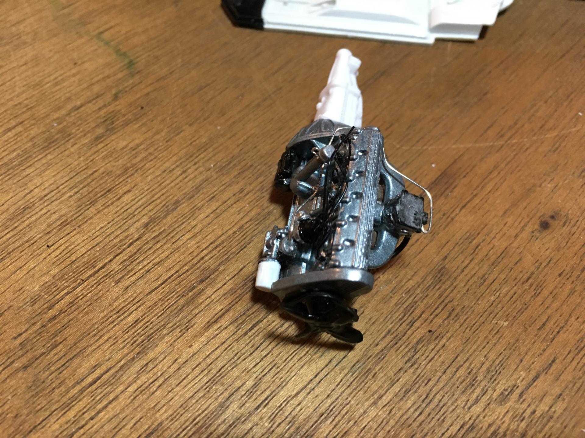

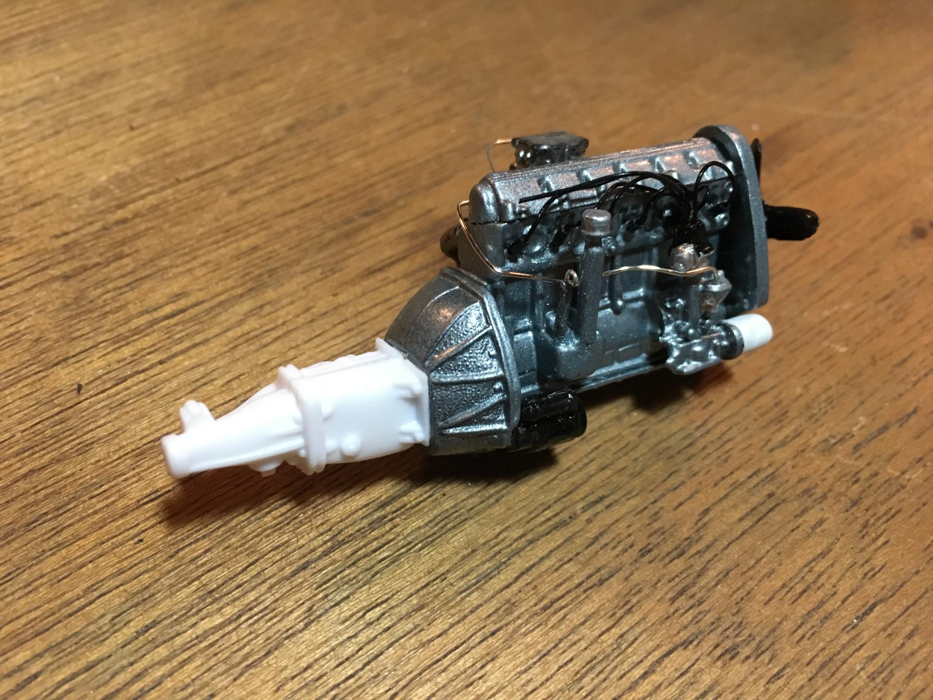

Snake, this 6 cyl builds up pretty nice, but needed to be sanded flat to fit together nicely.    Do some test fitting before you paint.

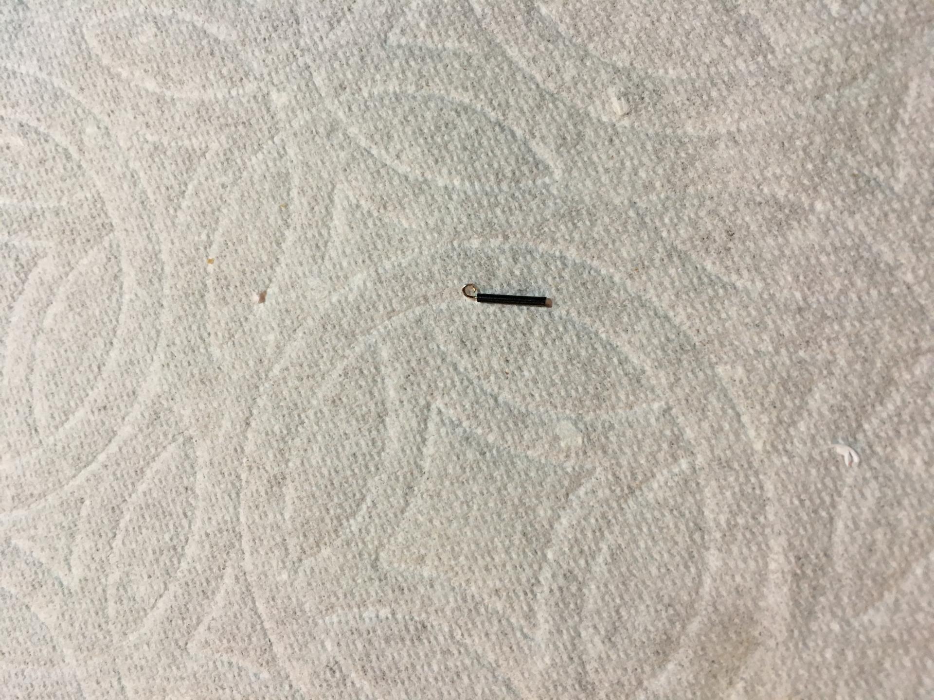

I added a few more details to it.  Fuel line, vacuum line, and a dipstick.

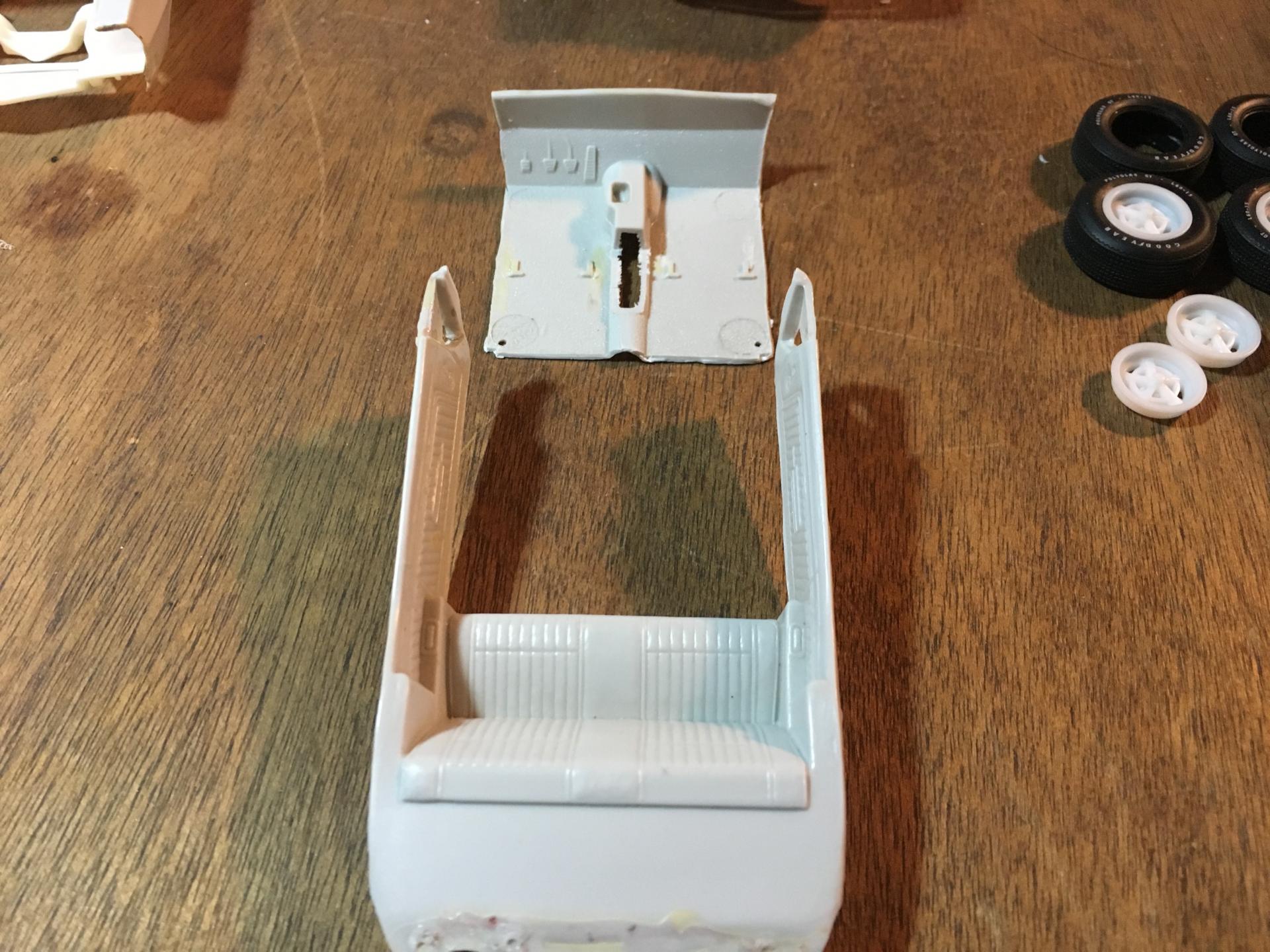

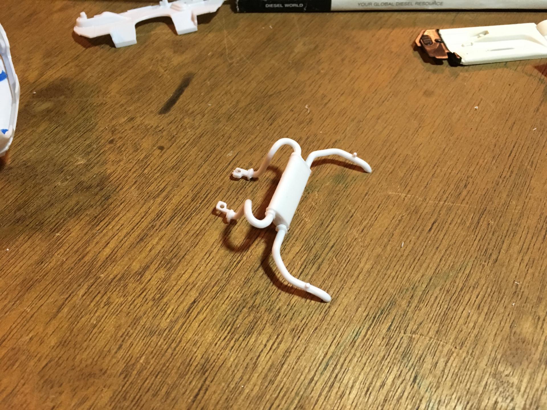

Interior is started.  Does anyone know what the exhaust on a 6 cyl looks like?  Are they dual tips or single?  I can't find any pictures of the underside of these cars.  Are the chassis black?   Overspray?  I can't believe how few pics I could find.

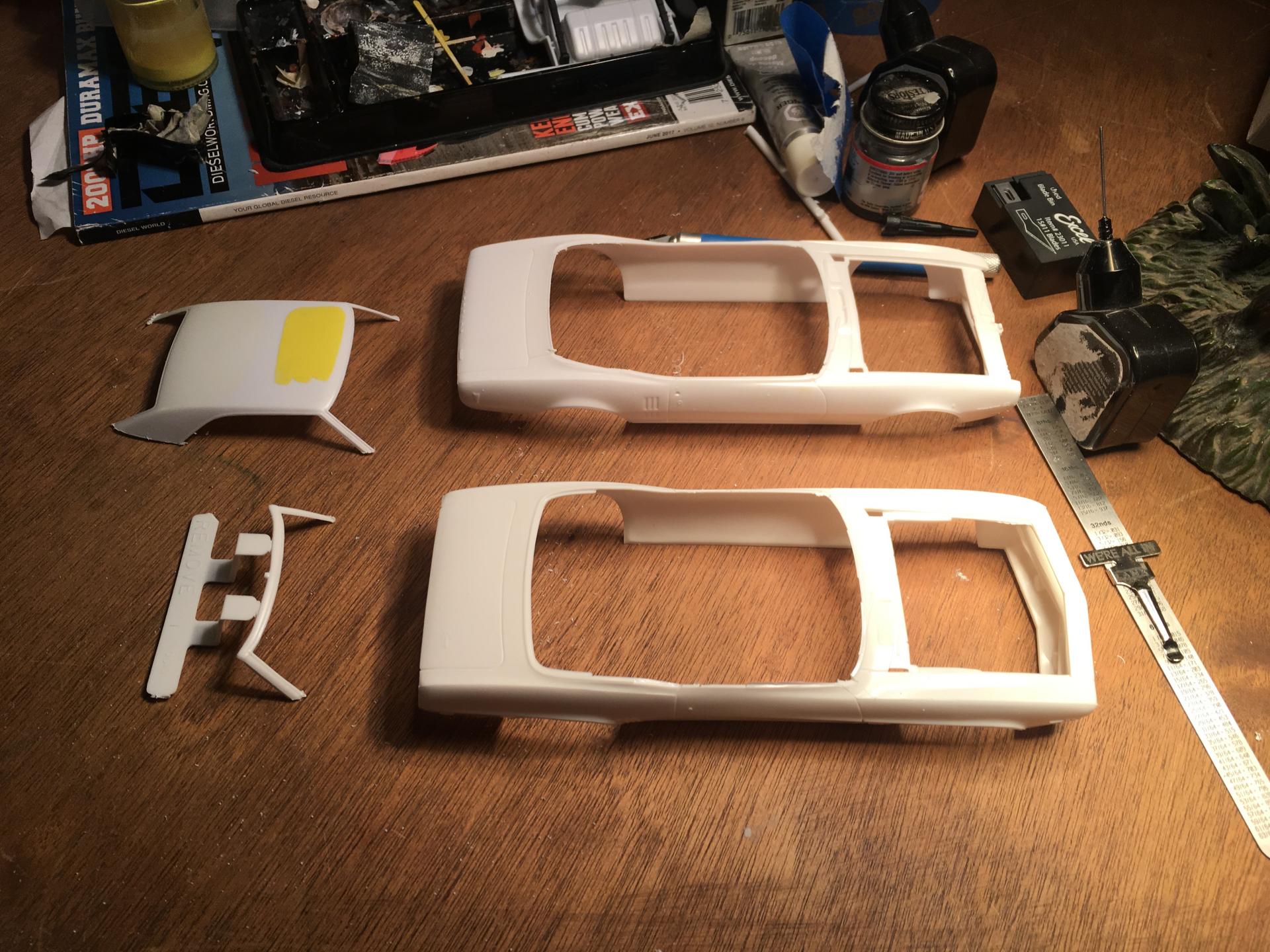

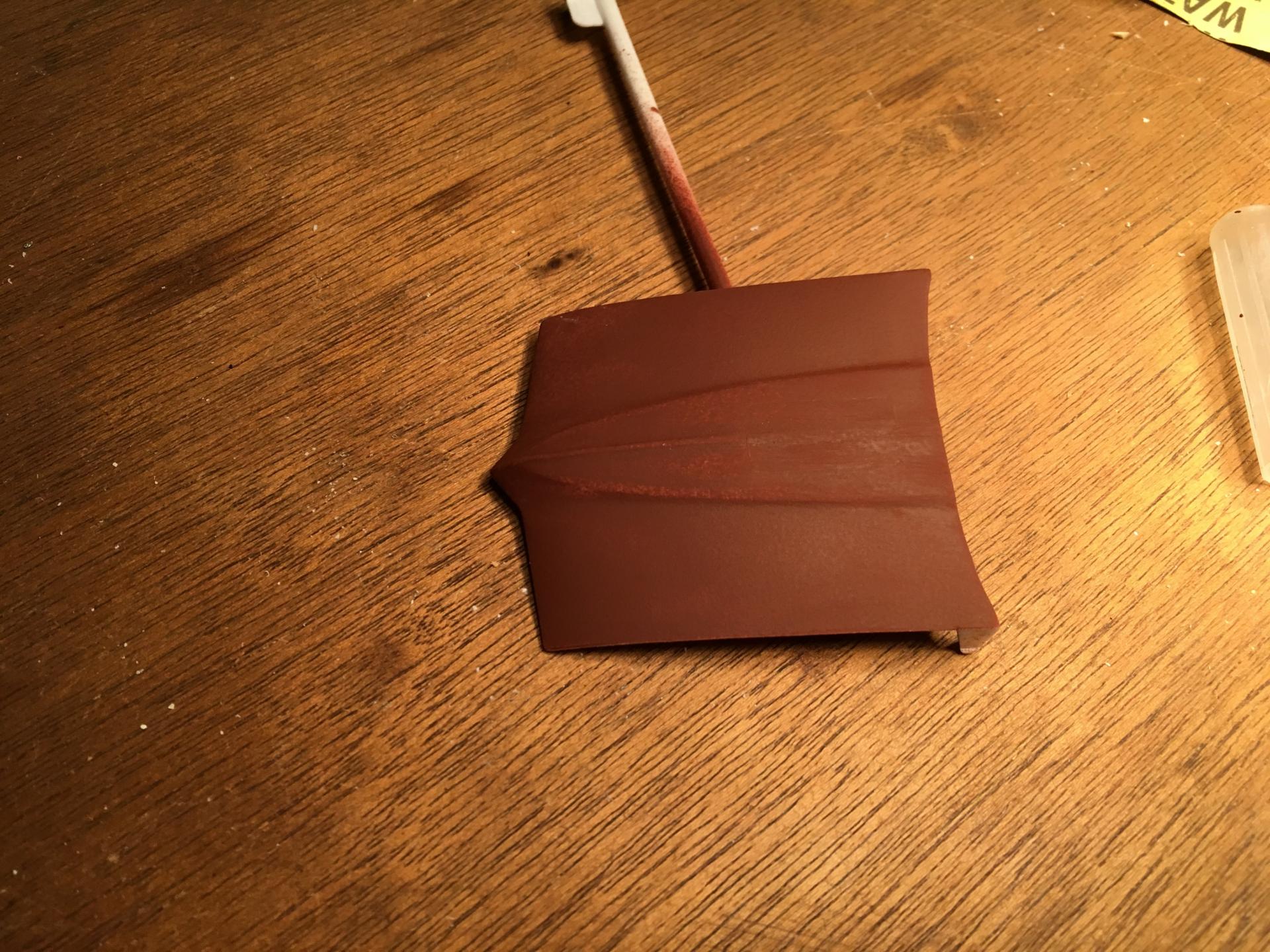

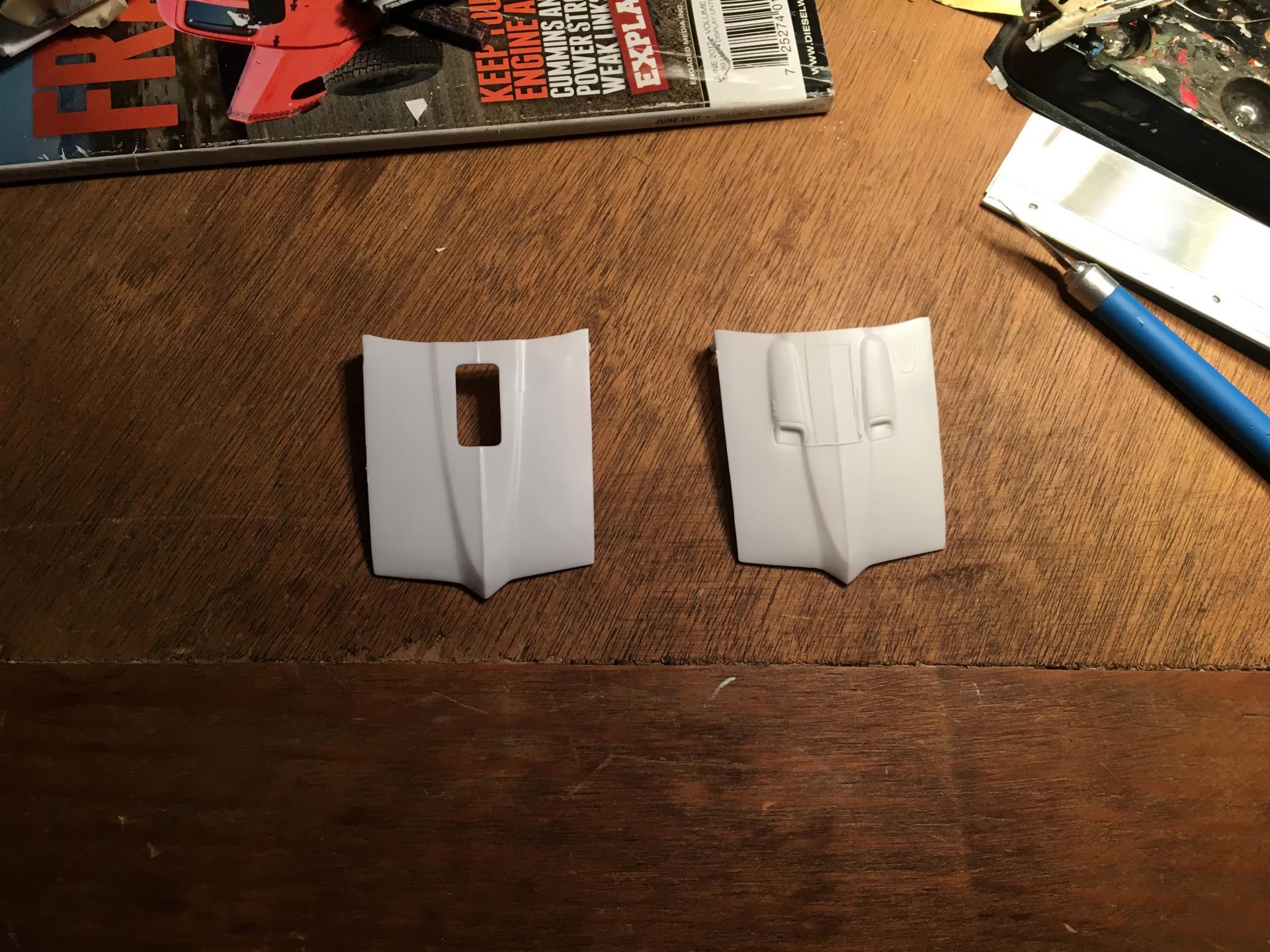

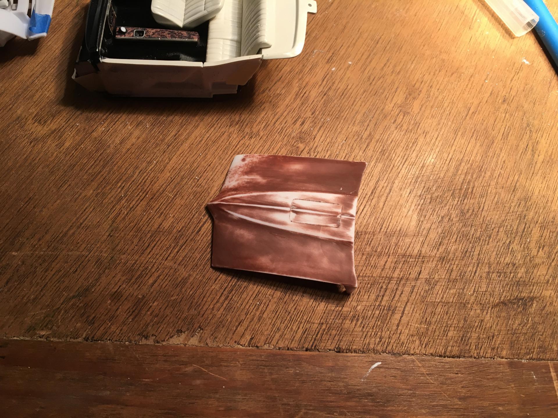

I am attempting to make the correct hood by combining the two in the kit.   Its getting better, but its not quite seamless yet.  The Ram Air hood that I cut the center out of has a less prominent, or lower, seam in the middle, so there is some inconsistency there.  I may just knock down the seam on the front portion to make it even.  not sure yet.

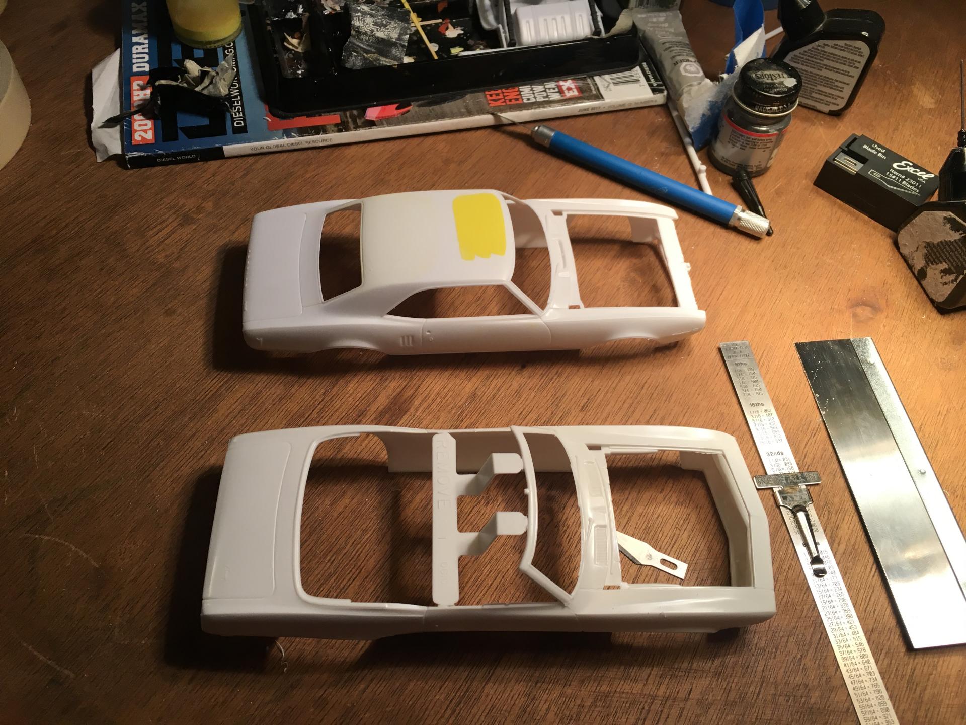

The interior on this car is so nice, that I decided it should be a convertible.  I am using the 69 Camaro convertible for the parts.  Here goes.

If your hood is still not to your liking consider something I have done in the past. First the hood should be sanded smooth with little or no sign of the raised ridge. Second, glue a strip of Plastruct half round in the desired diameter to the hood. You would need little if any body filler if it is glued down perfectly flat. Next just a very light sanding and then primer. The primer should fill any parting line, and again light sanding until you get the desired look. Then prime and paint the finish color. Hope this will help.

The MPC Firebird kit that gave up the OHC six engine will have a one-piece single exhaust included with it.  The piece probably won't fit the Revell kit as-is, but it should give you a good idea of what the stock exhaust looks like.
