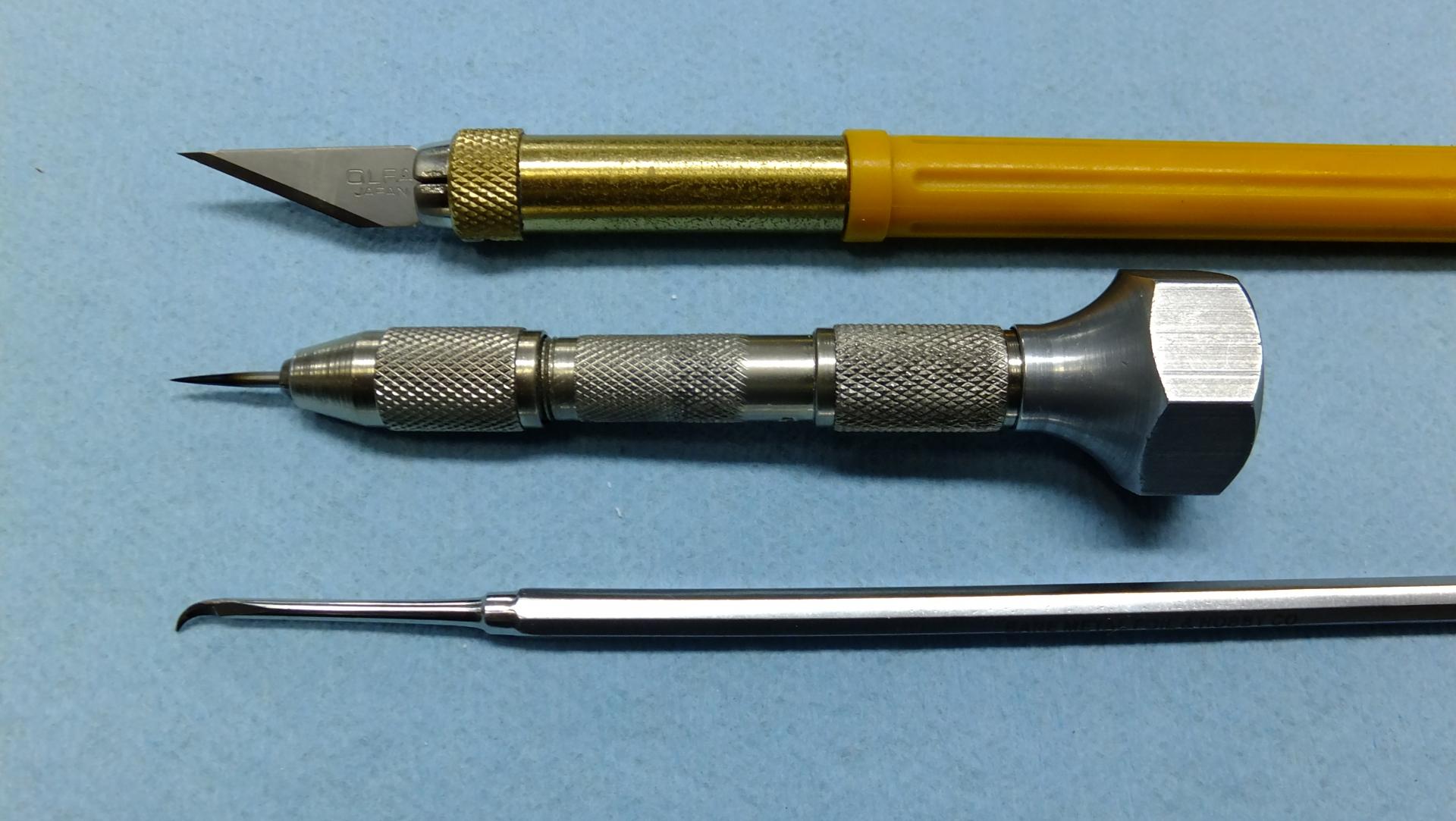

Dann Tier Posted September 16, 2018 Author Share Posted September 16, 2018 5 hours ago, Funkychiken said: Hey Dann, great progress on this. What did you scribe the seats with, just a scalpel? And how did you do that piping? Did you glue it in? Thanks, Atin!, here is how I scribe, and pipe my interiors..... -Photo 1; I first start by making a few passes wth my #11 where I want to scribe, and this gives either one of my next two scribing tools, a line to stay in. For interior scribing, I only use the top two. The Hardened steel punch in the pin vise works EXTREMELY well!!, and can go through curves and turns WAAAAAY better than designated tools!! -Photo 2; I started off using this Tamiya cement, after bending it where it needed to go, then I flooded the solder in place with it. This worked really good, but I think its only because I had the trim in a groove, because while final sanding a few days later, I popped one out by accident. That's when I decided to go over one side of all of the pipping with my Plasti-Zap. It has a bit of capillary flow, but not much. If you carefully add glue, then wipe with your fingers along the trim quickly, then it works a treat, without the glue showing.....since it dries fast, and hard. Note: I know its a lot more work, but I think I will keep doing it this way, since it worked so well, and I know that most people just glue wire straight to the part without the groove, but to me this is less stressful...harder to screw up, and looks more realistic to me. I will still be starting with the Tamiya quick set, since it gives you more time to position it, then, i'll hit it with the Plasti-Zap to seal the deal. If you start off using a super glue, its there , and when you try to straighten it, it will only bend at sharp angles, which looks wrong. Also, DONT try to be perfect when scribing, and pipping!!...it looks far more realistic when its NOT perfect! -Hope this helps! Quote Link to comment Share on other sites More sharing options...

Codi Posted October 28, 2018 Share Posted October 28, 2018 Haven't followed this in a bit Dann but I'm glad I got caught up. The insights you shared on your techniques are fantastic. That scratch built steel awl you made up in the pin vise has the potential for multiple applications on my bench. Good tips and the results to match. That interior piping is phenomenal. cheers Quote Link to comment Share on other sites More sharing options...

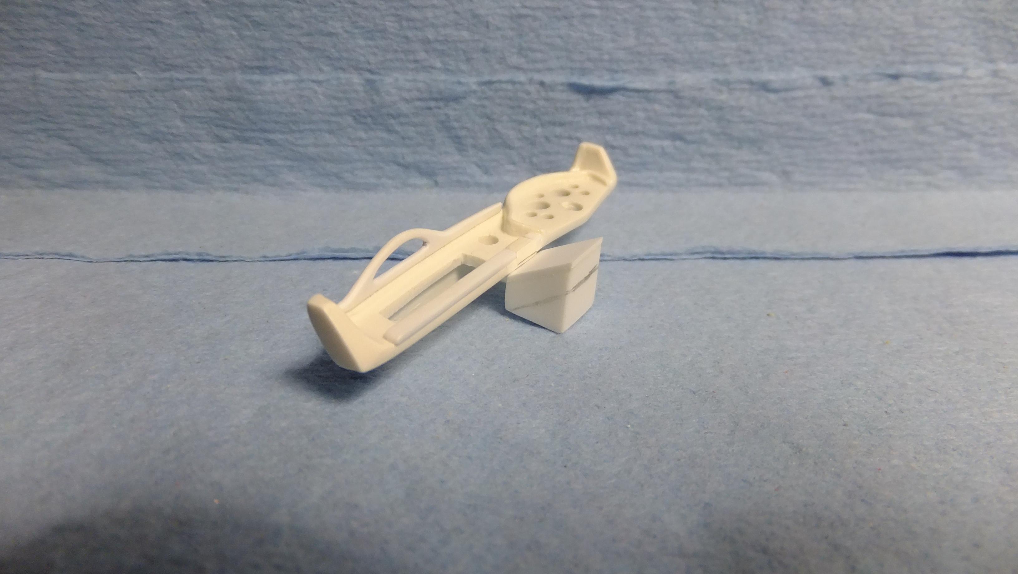

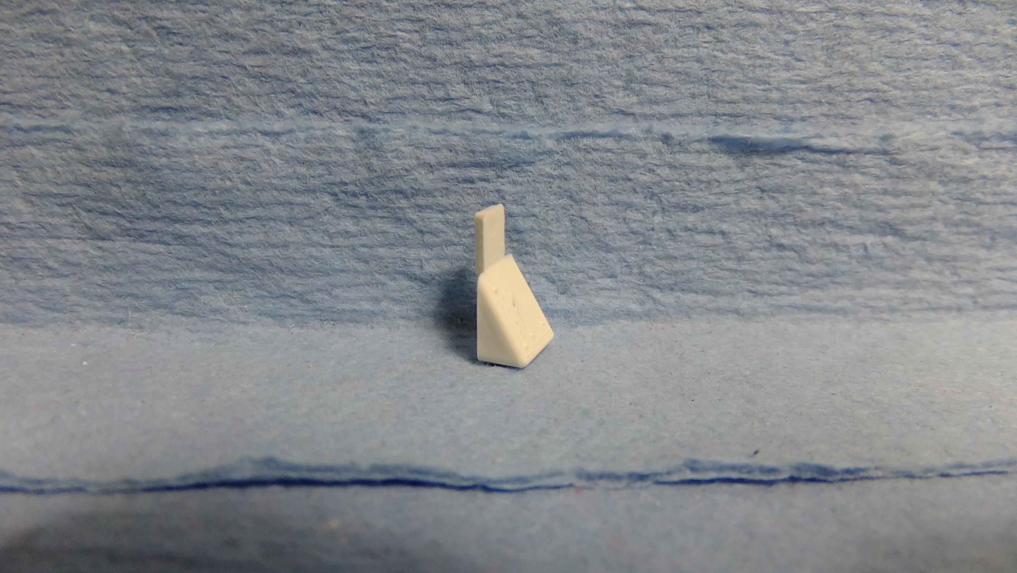

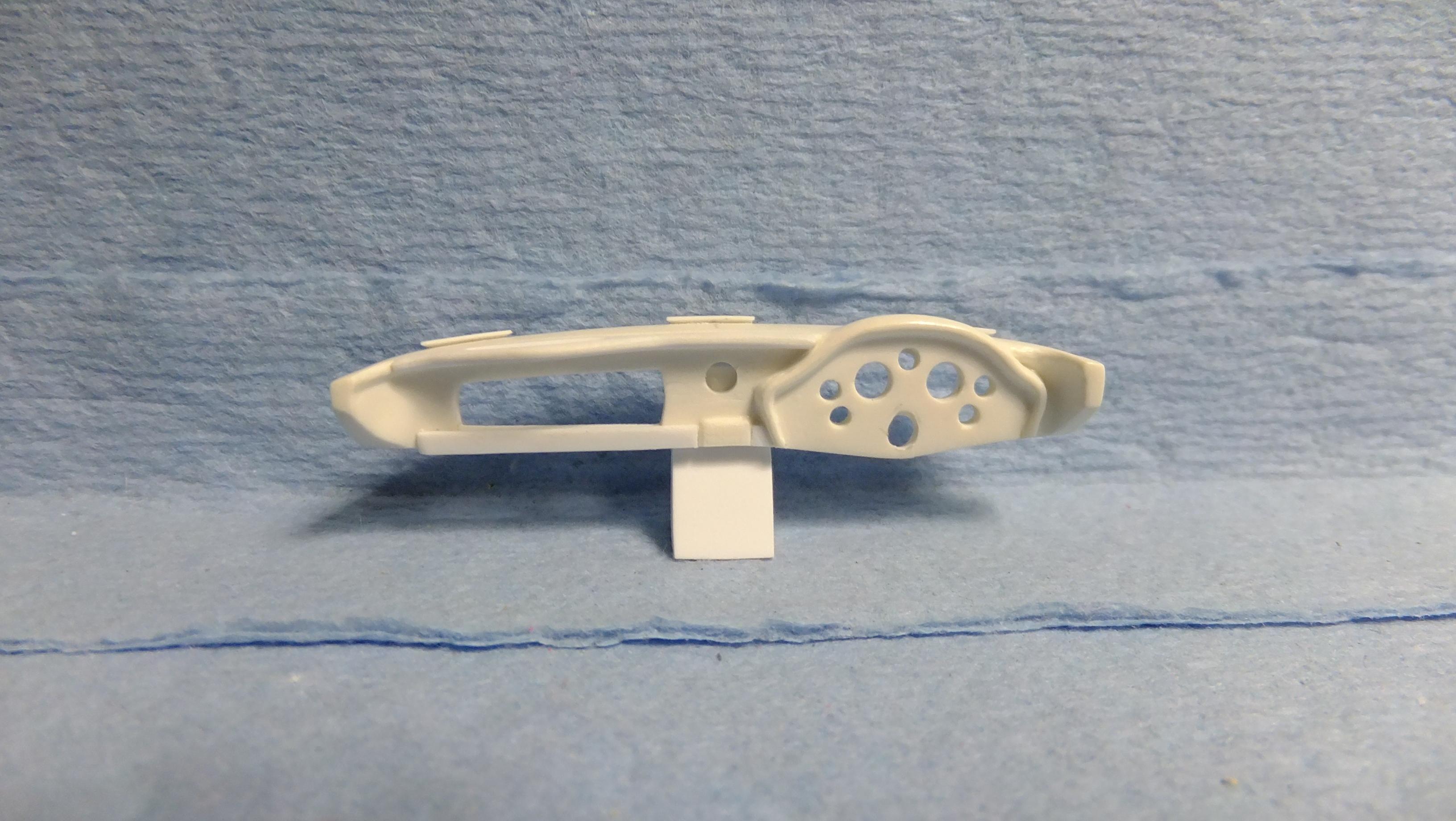

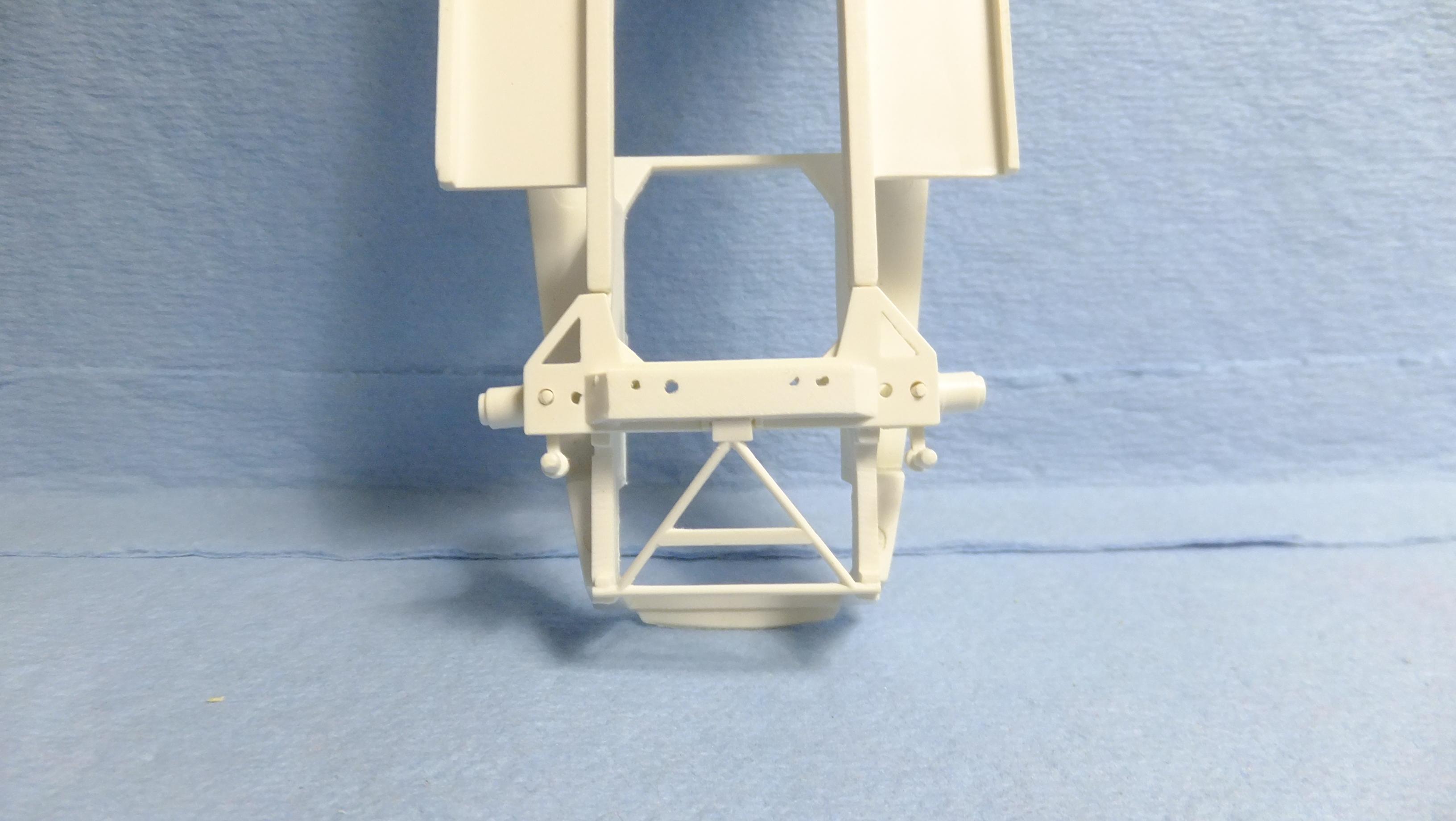

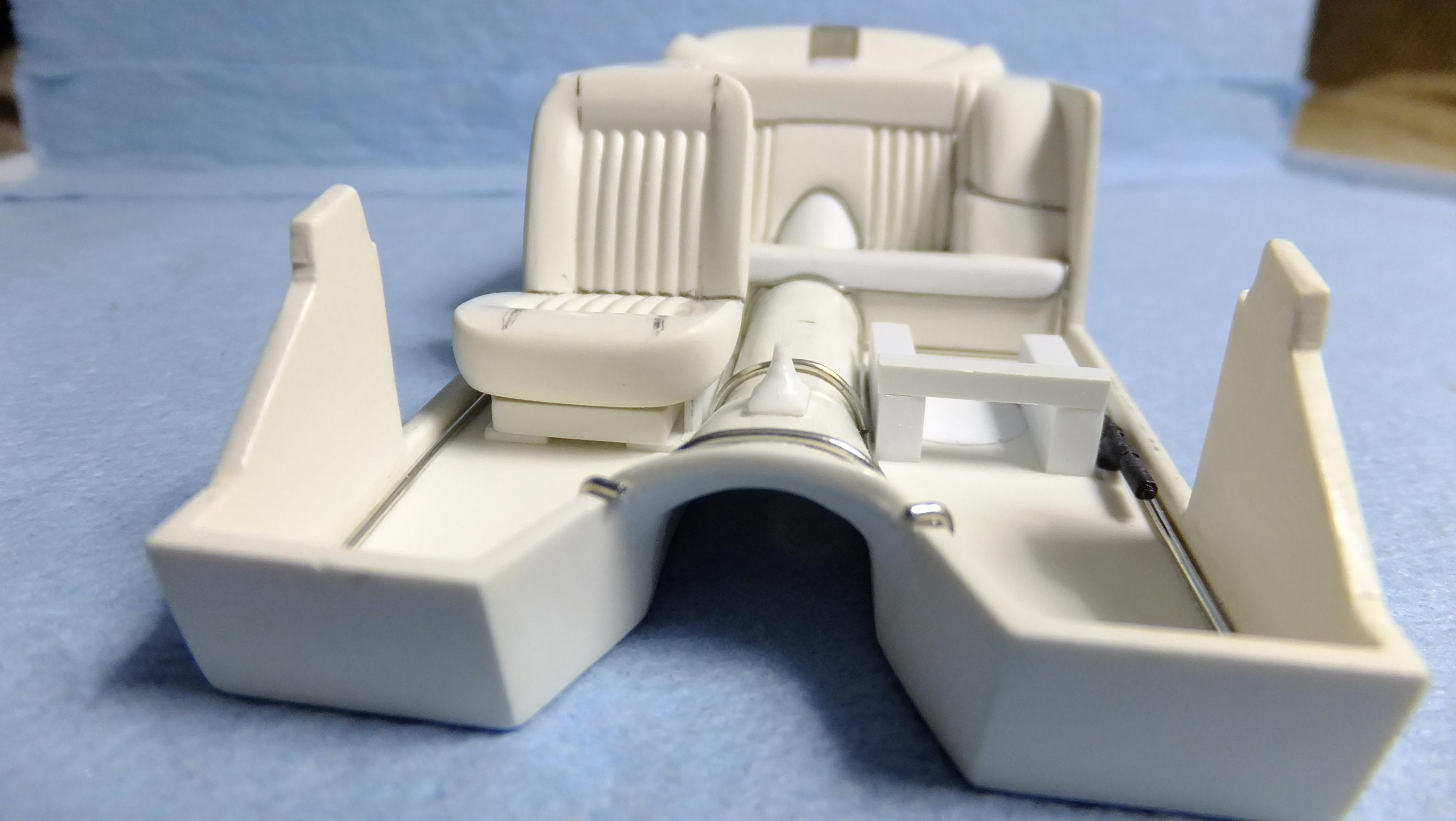

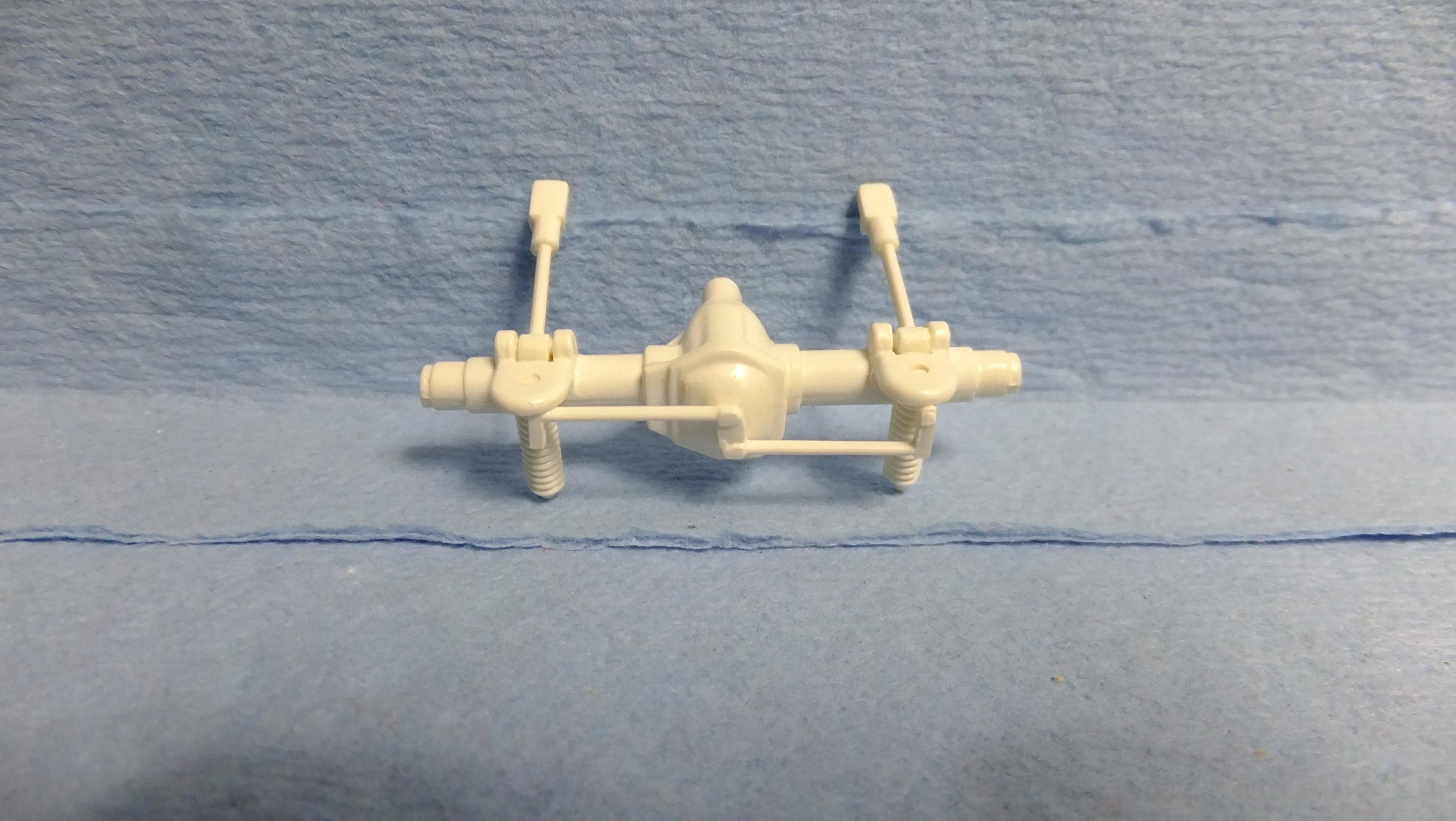

Dann Tier Posted January 3, 2020 Author Share Posted January 3, 2020 (edited) Hey, everyone!, got quite a bit done today! -Photo 1-3; This photo shows the new...larger guage solder for the carpeting, a kit-bashed hand brake (just noticed i put it on the wrong freaking side...LOL) -'ll fix that. I made the seat brackets...the drivers side has the weapons tray under it where it should be. -Photo 4; The seats, and weapons tray fit perfectly! The pencil lines on the seat shows where i need to scribe them. -Photo 5&6; Here is the kits radar piece...barely detailed, and the wrong shape... -Photo 7&8; ...heres the start of mine. The pencil line shows where i need to cut off a bit. -Photo 9-11; Here i have started to pre-assemble the chassis bits... -Photo 12;...so far, the rear suspension is the only bit that hasnt fit that great. There seems to be too much play in the whole assembly. In order to center the axle in the wheel well, i had to lean the springs forward.....this may have to change, but its my starting point at least. If i make longer control arms, it will make the springs go where i think they should -at a 90* angle, but then it puts the axle too far back. Edited January 3, 2020 by Dann Tier Quote Link to comment Share on other sites More sharing options...
Pete75 Posted January 4, 2020 Share Posted January 4, 2020 Ecshellent work, Mishter Tier: Dann Tier... Love this solder-piping technique - looks cool even before the paint! Quote Link to comment Share on other sites More sharing options...
Dann Tier Posted January 4, 2020 Author Share Posted January 4, 2020 5 hours ago, Pete75 said: Ecshellent work, Mishter Tier: Dann Tier... Love this solder-piping technique - looks cool even before the paint! Thanks, Peter!!, much appreciated!! Quote Link to comment Share on other sites More sharing options...
