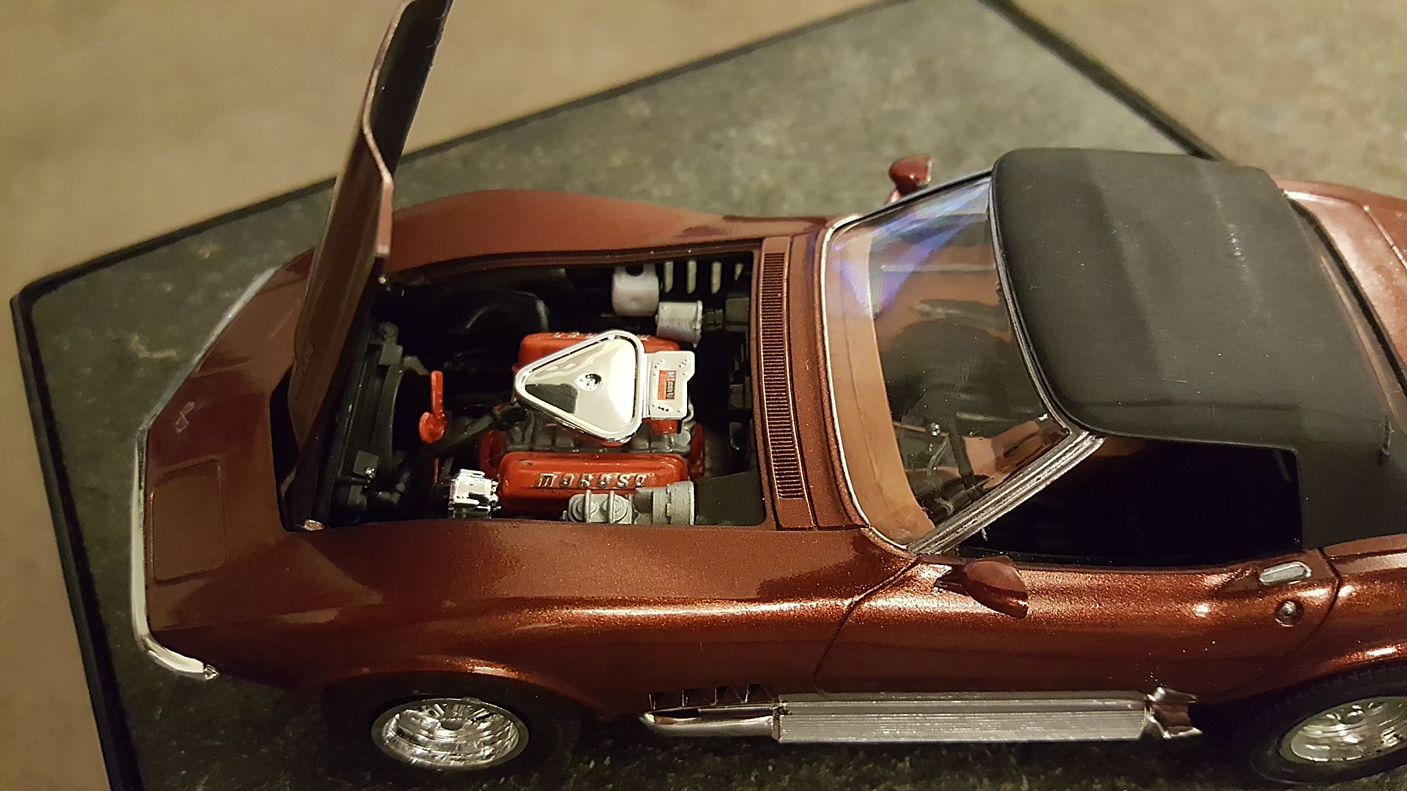

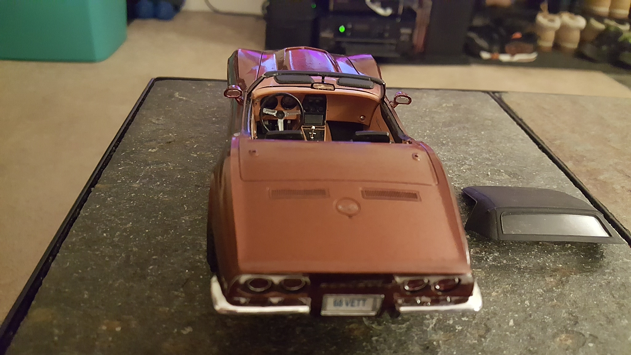

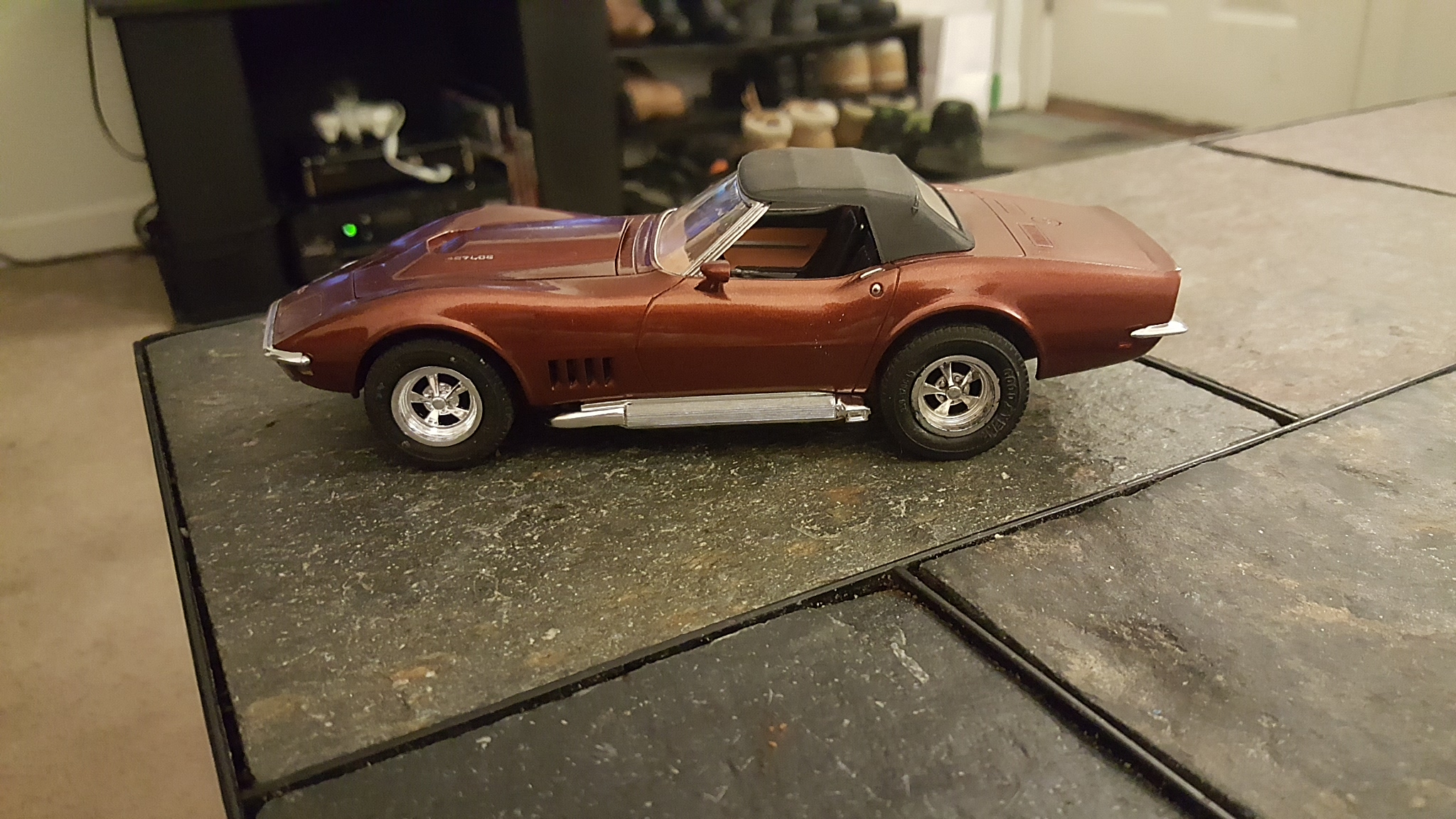

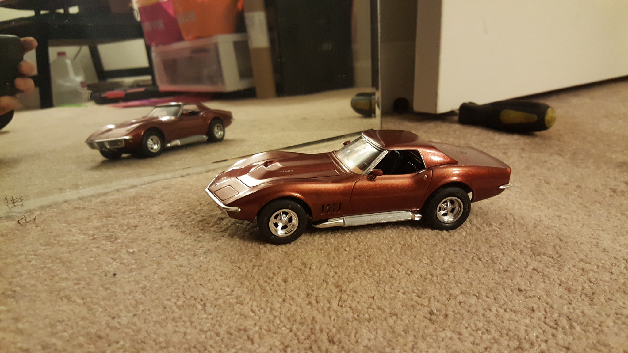

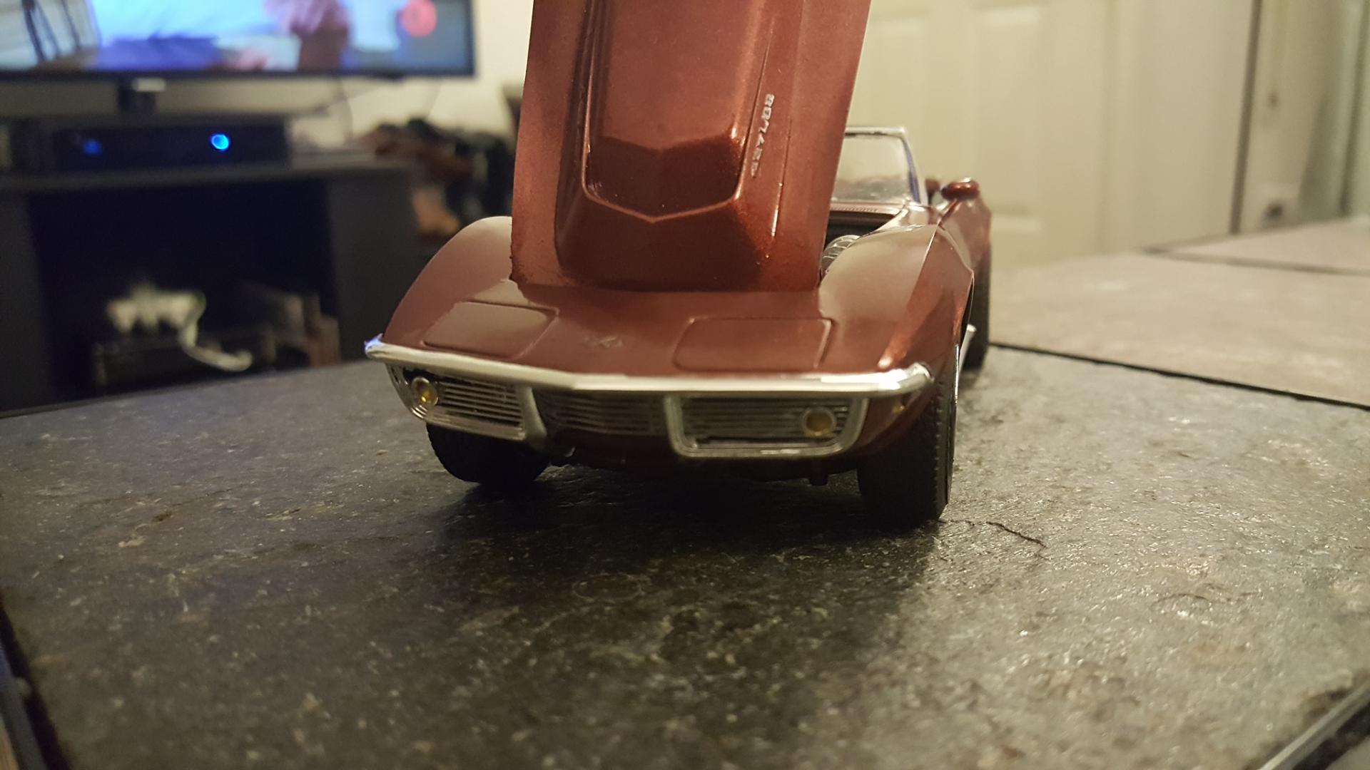

Also I like where this is potentially going. You'll find out things as you go. No need to rush. I havent built anything in about a year but have many projects going. I wasnt sure where yo even begin with this.... but... this is how mine turned out... keep in mind I sprayed this in my basement and have 2 cats...

I like the color choice! Makes me think of chocolate :) Also that paint job is impressive considering the conditions of your painting environment. Well done.

Great color! What is that paint?

Man it's super annoying that it does that... when I have my phone in landscape it takes away the text box... anyway. I was just going to say you dont necessarily need a booth. It more about your prep work. Get a decent primer. I usually use 2 coats of primer. Light first then cover but obviously dont drench. Then I dry sand with 1000 grit lightly. Remove any mold lines as @Snake45 was saying. Btw Snake, that's a mix of aztek airbrush blue pearl metallic, a bunch of aztek airbrush red pearl metallic and a couple drops of testors gloss black all acrylic. Sprayed threw a knock off chinese iwata. @Justin Dodson after you've removed your mold lines and sanded and all that jazz wash your car and put it in some Tupperware overnight somewhere warm. This is to make sure it's completely dry and lint free. After that I set up my area. Try not to disturb things in your environment. Also limit traffic in that area. I use an empty spray can for my bodies. Put your body on over the cap with the cap edges sticking out the side windows. Spray the bottom of the car first. Then do the rest. Be careful how far you tilt your can. The car .at fall off. But itll also act as a drying stand so you don't have a run in your paint at the bottom/ the car wont stick to the paper you spray on. For clearcoat I used to use actual clearcoat. But I've ruined a few sweet spray jobs doing suck. Super wrinkles in the paint. No more.... now i use pledge floor polish. 3-5 coats depending on the shine all brushed on with a soft brush(its self leveling(for the most part)As for your dash... if you have a small drill bit... carefully drill out your gauges. Get a pic of gauges online and scale it down. Print cut scotch tape over them and glue them behind your dash. The gauges in my pic are a pic of actual after market white faced gauges. I scaled them down as I said and used the tape over them(each side)
