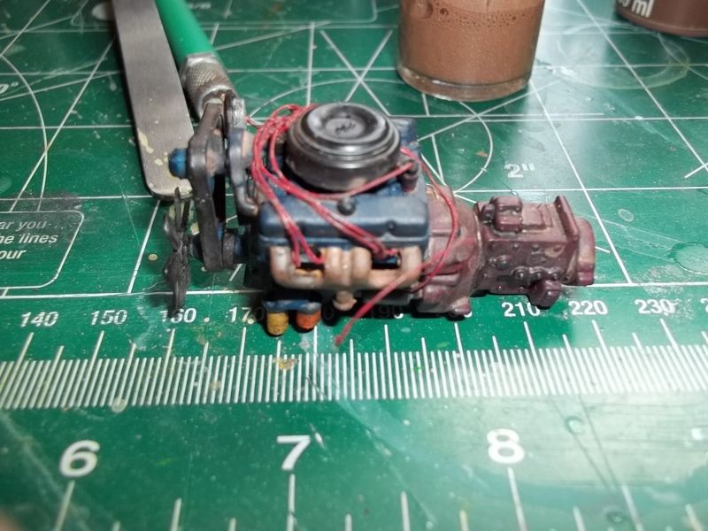

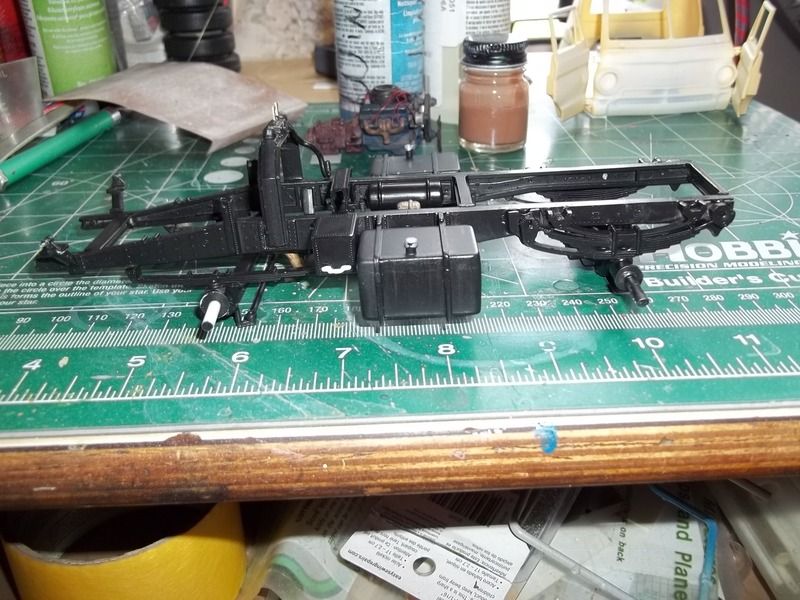

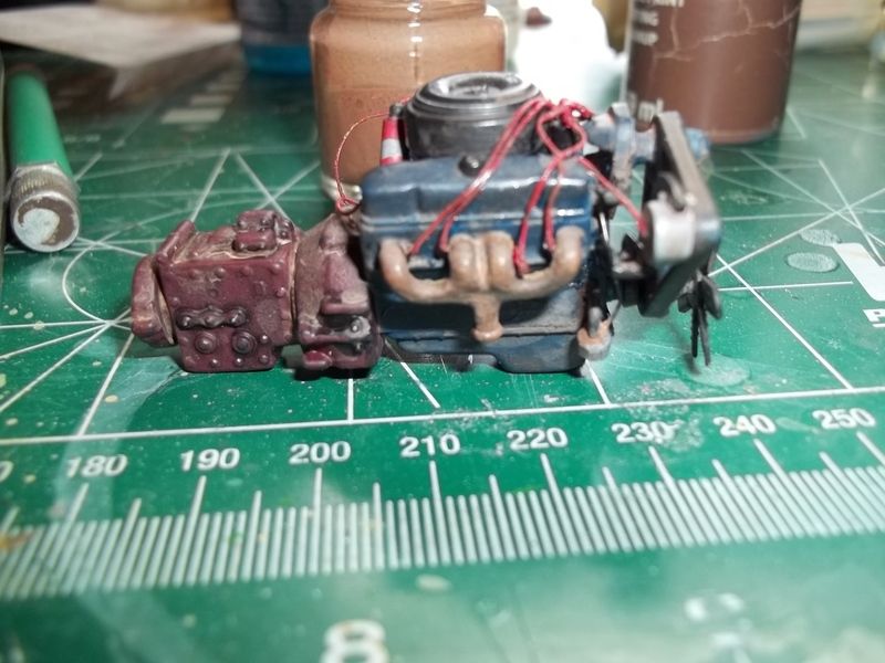

starting with the engine I added ignition wires made from 30# braided fishing line, I made an ignition coil, added starter wiring, added an alternator mount so it doesn't have to float in the air and wired it and then I built a fuel pump and ran a fuel line to the carb.

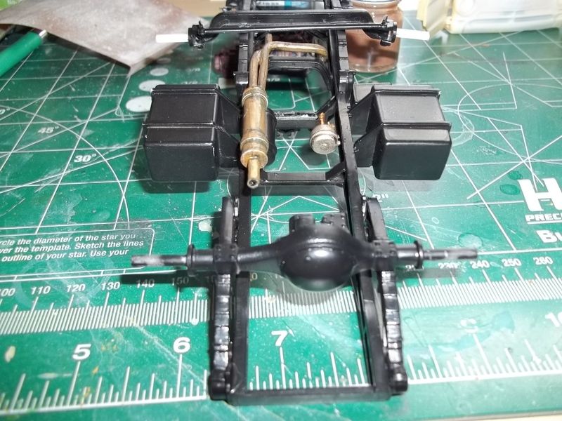

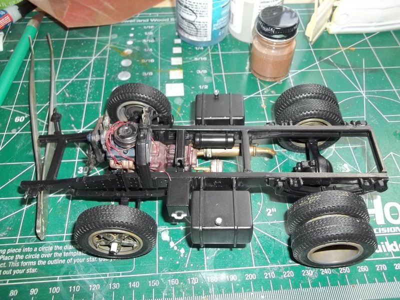

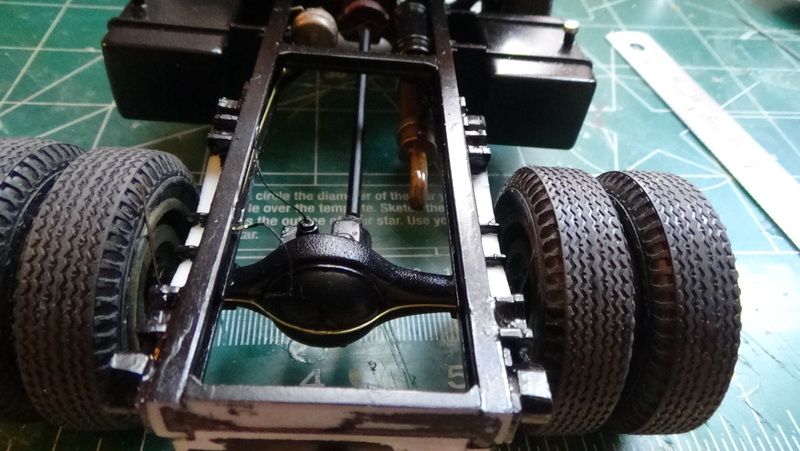

Then came the chassis. I moved the rear axle back as far on the frame as it would go. I wish I would have taken pictures along the way as I modified the rear suspension to lower the rear. I'll try to explain.  I also the blocks out that separate the upper load springs from the main lower springs then I cut the tops off of the main spring shackles, this was done so that the tops of the load spring shackles are flush with the top of the frame and the tops of the main shackles are slightly below the top of the frame. While I'm no expert on this style truck. I know the 1;1 did not have this severe of a rake when empty. In fact, they had very little rake.
I added a crossmember over the rear of the trans for the hoist cylinder and added a rear bumper plate for lights and a pintle hook.

Sprueslayer, For the front spindles you can make 2 more pieces to capture it on the bottom like what the kit supplies for the top. I don't know why the kit omits them. Or just glue them fast, that's my method. The tiny pins on the axle are too weak to hold up and if you want to be able to pose the front wheels for years to come then I suggest steel or brass rod be used to replace the pins on the front axle. The original pins will either fatigue or become brittle with age. Also when you lower the rear ride height on this kit and you use it with a trailer you need to shim up the fifth wheel and or add a shim between the trailer and kingpin plate.

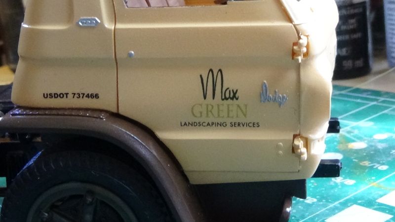

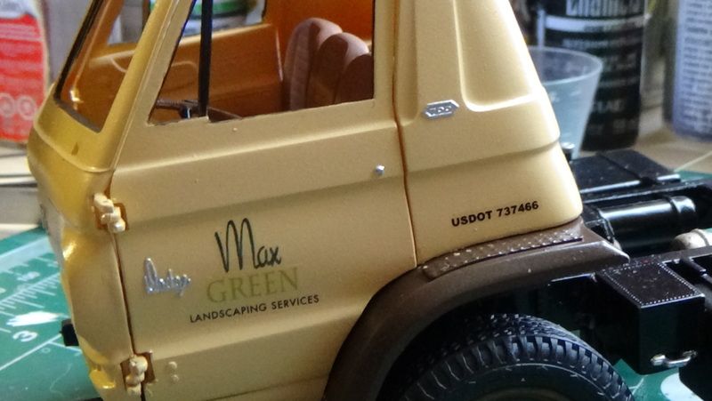

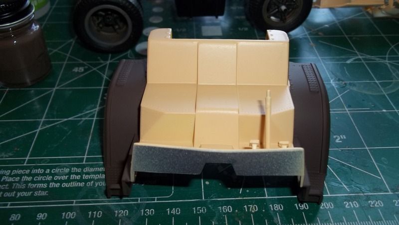

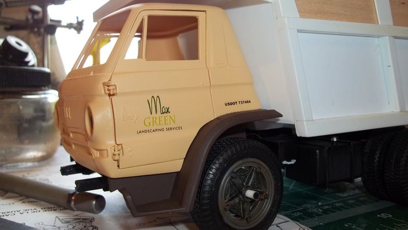

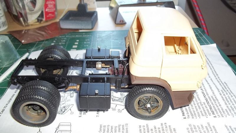

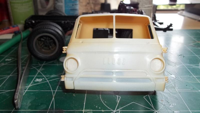

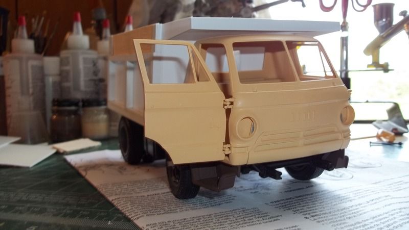

Next was the body. I'm terrible at picking colors. Too many of my builds are monotone and I'm trying to change that. My original plan was white cab and red bed.... After sleeping on the idea a few nights and attending a local car show while keeping an eye out for inspiring colors I decided a tan color cab with brown fenders and step would look perfect on this truck. The bed will be painted to match once it's finished. The bed will have the flat panels painted tan and the tube framing painted brown.
Now with the decals and some Model Master gloss clear acryl. It will get cleared again once the silver work is done on the badges and such. I'm doing the silver work in Model Master silver chrome enamel and mistakes are easier to clean off of clear than off of raw paint.

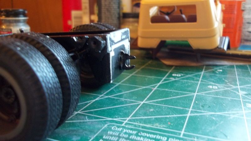

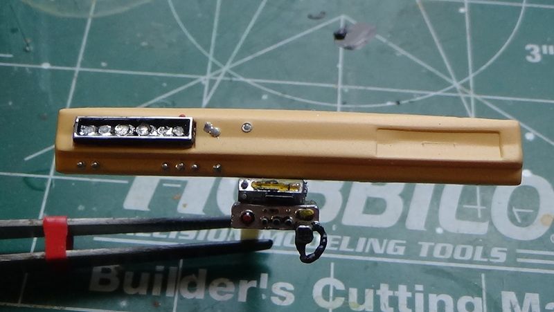

The rear of the frame got a bumper plate mentioned earlier for a pintle hook and lights. I have a home built triaxle beaver tail equipment trailer that will look good behind this with either the JD 310 backhoe or the diecast Bobcat V518 Versahandler.

Great work on your Dodge dump truck. I like your color selection it’s different but it looks like a landscapers truck.

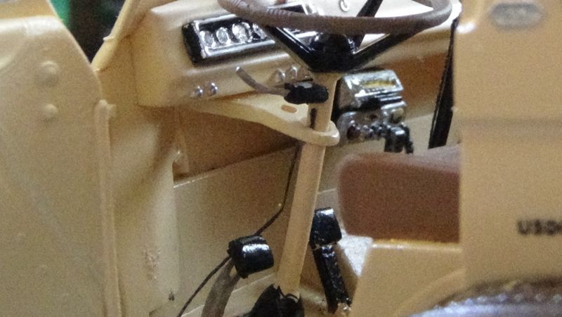

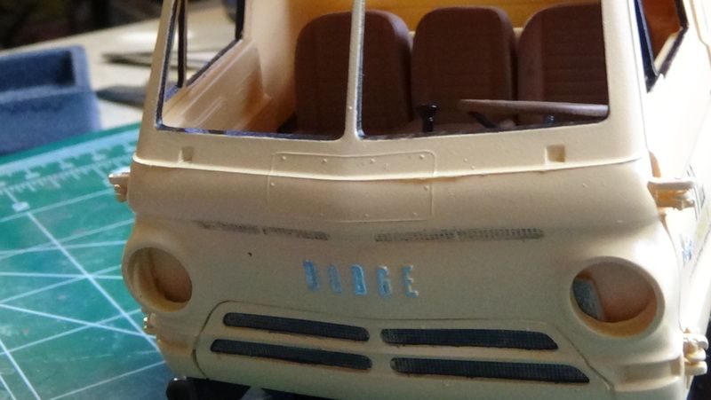

I have only made a little progress in the last couple days. I painted the badges on the cab with Model Master silver chrome enamel. They will be cleared with Model Master gloss clear acryl so I want them to dry for a few days before the clear. I also painted the window surrounds black to help simulate weather stripping. Then I detailed the dash, adding a CB radio and an AM radio. The grills got a wash of dark granite color.
These pics were taken with my Sony Handycam, I think it does a better job on close ups than my old Kodak.

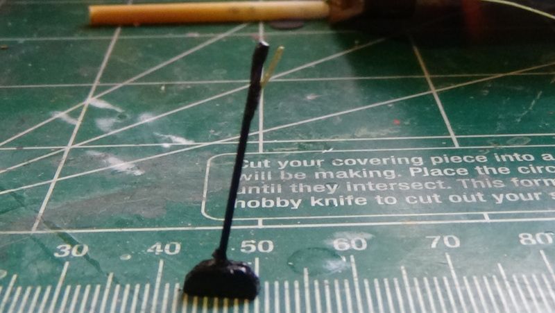

I've been working on this pretty steady but with not much perceivable progress. I've done some chassis plumbing and wiring and made a passable representation of a signal stat turn signal switch.
I've also made a parking brake lever but haven't mounted it yet.

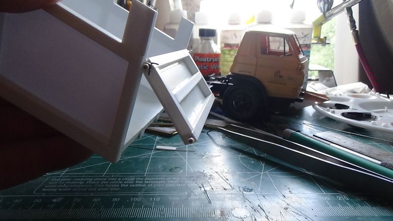

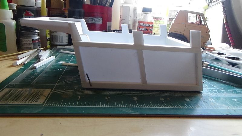

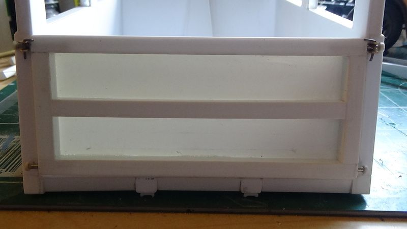

Then I finally made it to my local hobby shop and picked up the rest of the Evergreen styrene I needed for the bed. Now I can make some progress on it. The most tedious part was the tailgate hinges/latches. I've got the top one done. The hinge pins are .050" steel rod with 3/32" od styrene tube to simulate the cap on the end, the clevis is .017" brass and the hitch pins are .025" steel wire. Next up is to make the lower hinge/gate release then I'll start the bed hoist, hydraulic tank and bed hinges. I'm not sure yet if I want to build a transmission mount pto, a frame mount pto or an electric pump for the hydraulics or just omit the pto all together.
