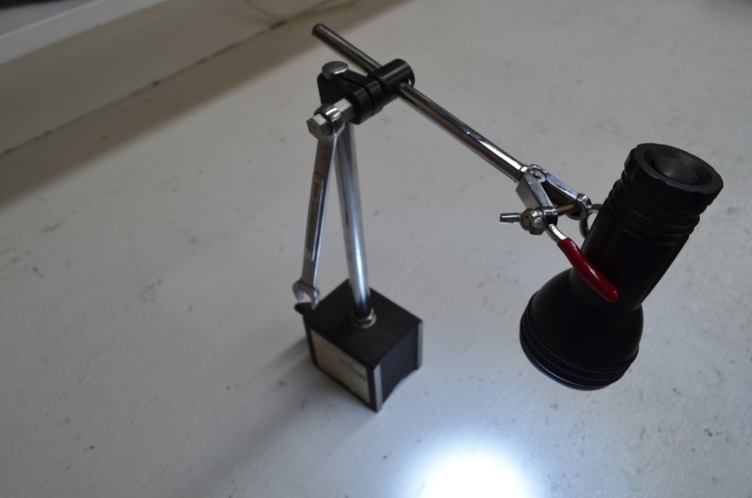

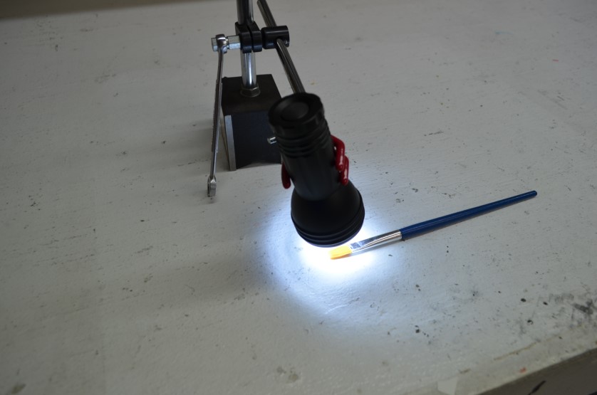

I'm always struggling to get some more light on a part and I think I've found a way. Works for me.
I used the Multi-Position Magnetic Base that I already had. It's got some heft to it and won't just fall over.
https://www.harborfreight.com/multi-position-magnetic-base-with-fine-adjustment-63663.html
I bought a clamp on eBay. I paid a little more ($7) and bought it in the US.
https://www.ebay.com/itm/Chemistry-Lab-Single-Three-Prong-Extension-Flask-Clip-Clamp-for-Stand-GXFH/153085779409
Just remove the arm that comes on the magnetic base and insert the clamp. I leave the wrench hanging on it for quick adjustment.
The flashlight is a 32 LED from Harbor Freight ($4). I count about $26 + tax for all of it.
