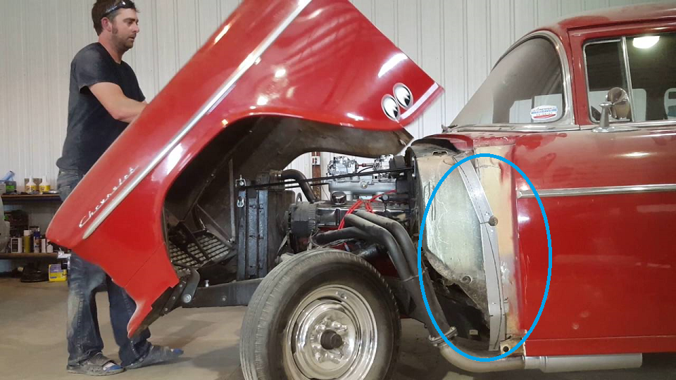

Yep, Rob is exactly right. To make a flip front end work you have to find a way to connect the firewall to the kick panel area of the interior. But, if you're willing to wait a bit you might be in luck. They're reissuing a flip nose 57 Chevy that has most of this work done for you right out of the box. The scales are different but the firewall needs to be a bit smaller to clear the fenders anyway.
