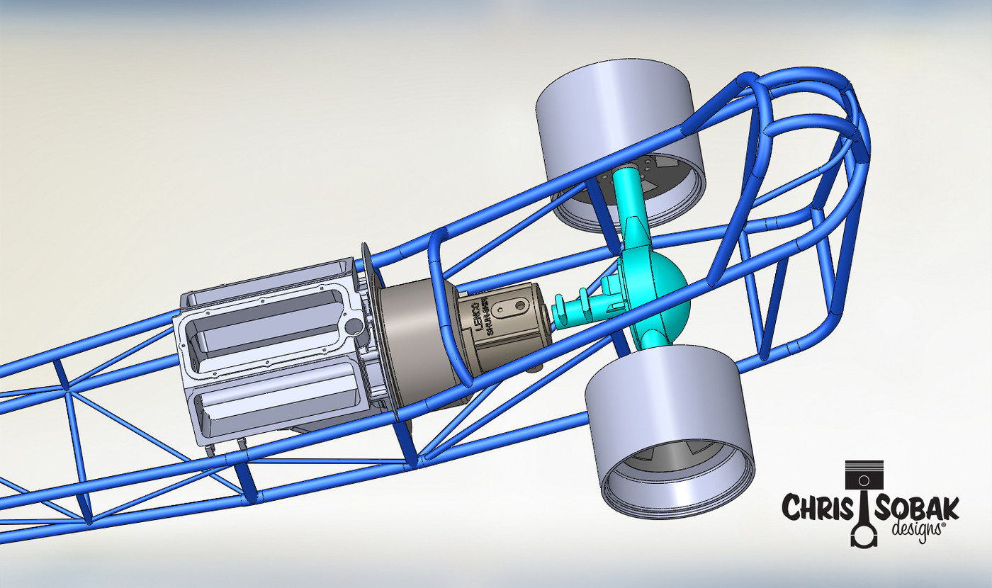

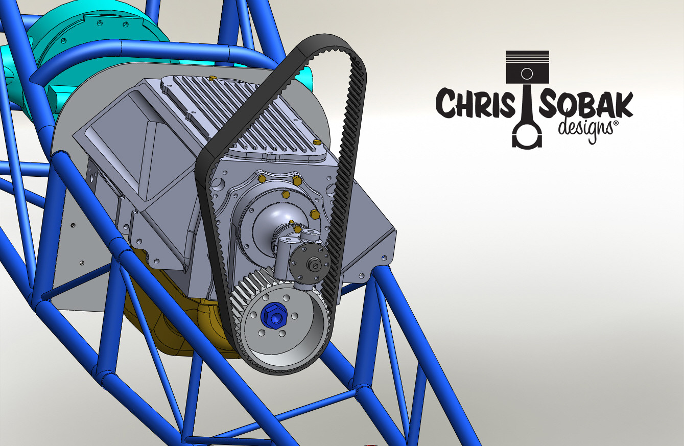

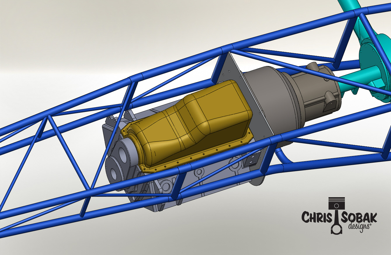

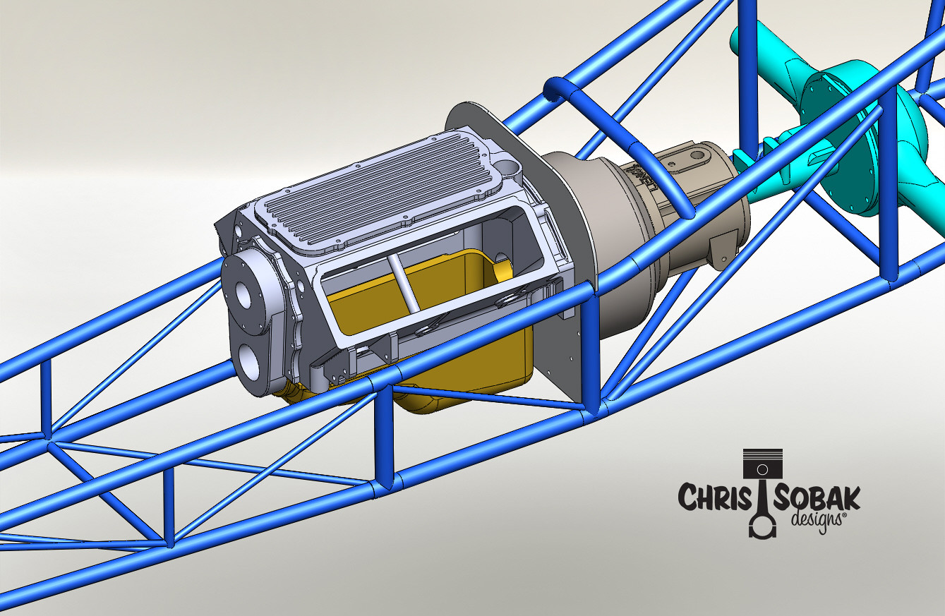

Hello Fellas... I figured it was time to knock the dust off of this build and post an update. Work at the bench has been slow for me lately and haven't had as much time at the bench lately as I would like. I have gotten a little more design work done for this build and wanted to share what I have done so far with getting more parts drawn up for the 392 Engine and the start of the rear end. I had also sent a few of the engine items off to Shapways to get back some test articles so that I could use them when I start the fabrication of the chassis. Here are some pics. Hope you guys enjoy.....
Here is the start of the Rear End:

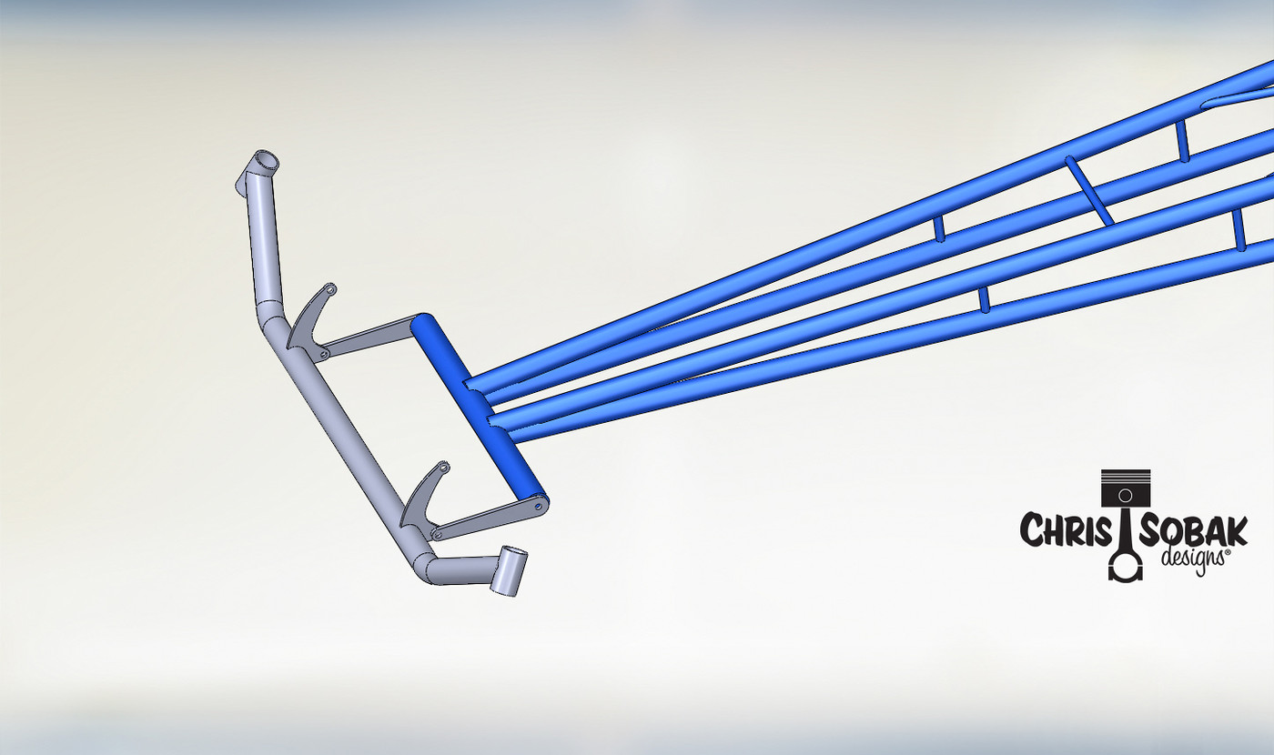

Start of the Front Axle:

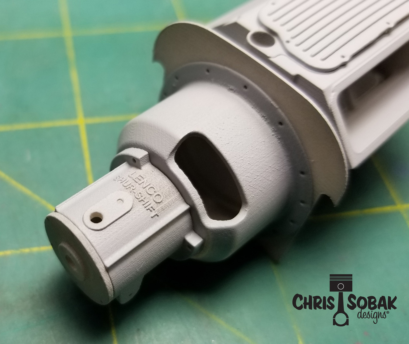

Here is the Bell Housing along with the Lenco 2 Speed shifter. The Bell housing still needs the inspection plates designed for it:
Then on the Engine I was able to get the Timing Plate, Oil Pan and Valley Cover completed:
Here is the bottom side so you can see the Oil Pan:

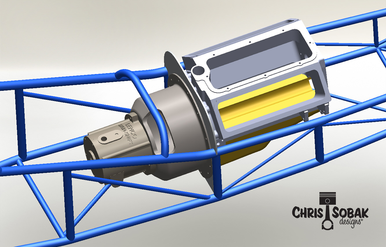

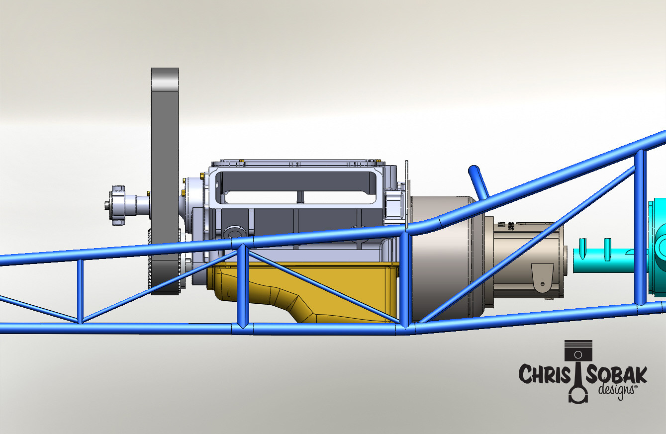

I then got the extension for the fuel pump designed for the Timing plate and added some of the details I had drawn up for the Army F/C to the engine just to get an idea of how things looked
Here is a side view of everything:

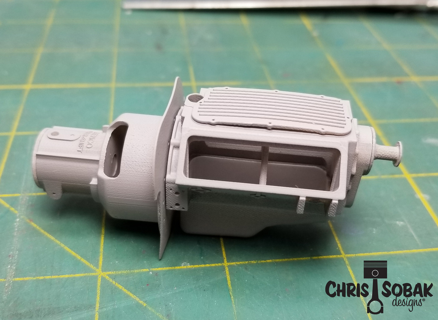

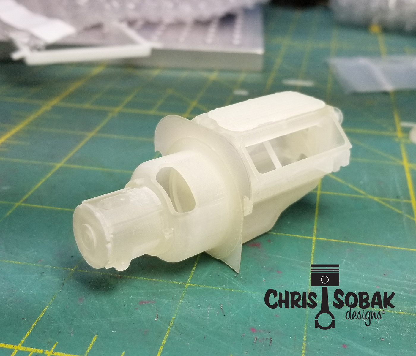

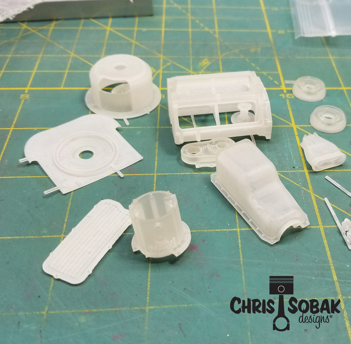

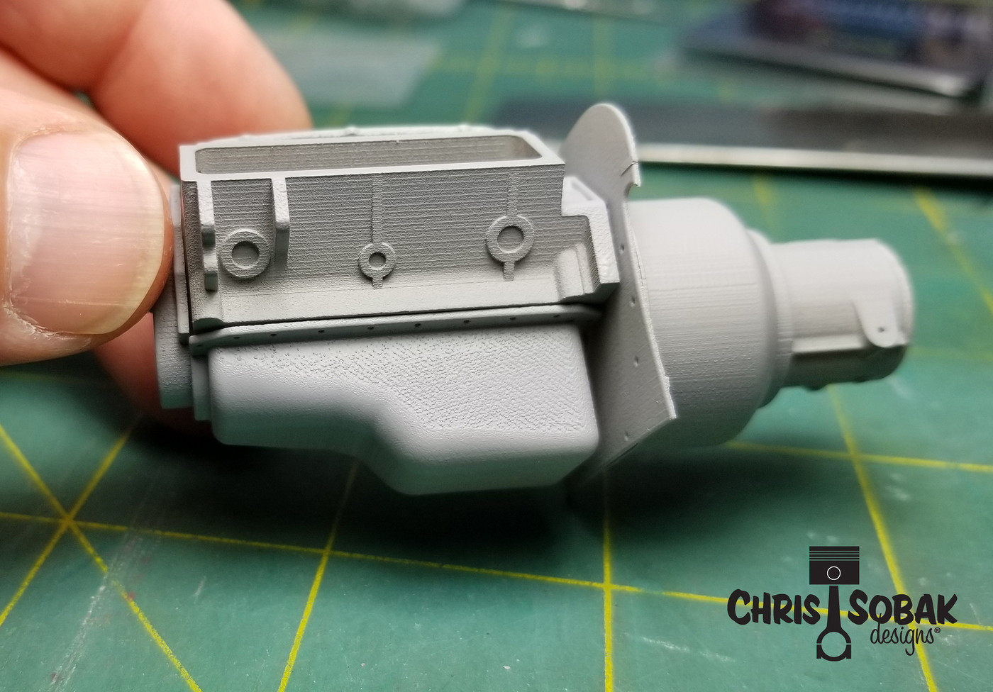

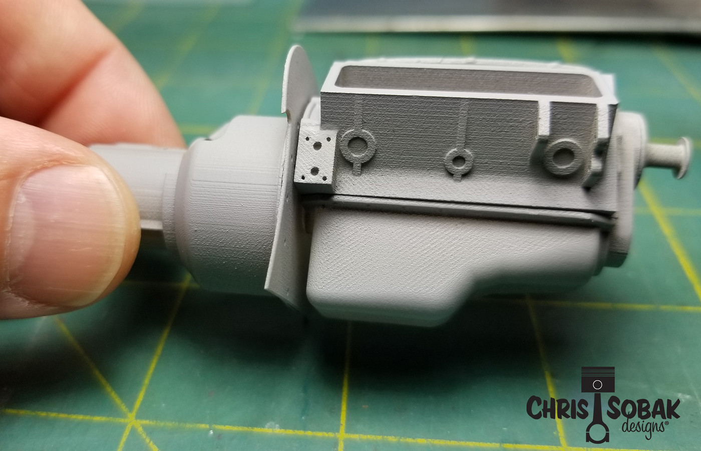

I had sent the parts to Shapeways to have them printed for me and here they are after I got them back:

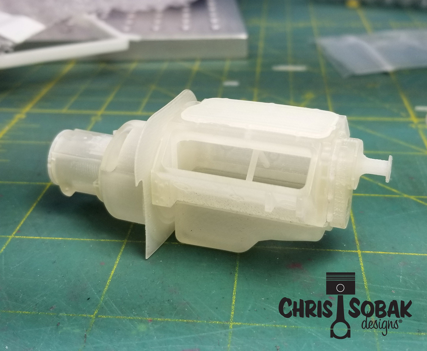

I then had to test fit the parts to check the parts fitment:
Share this post
Link to post

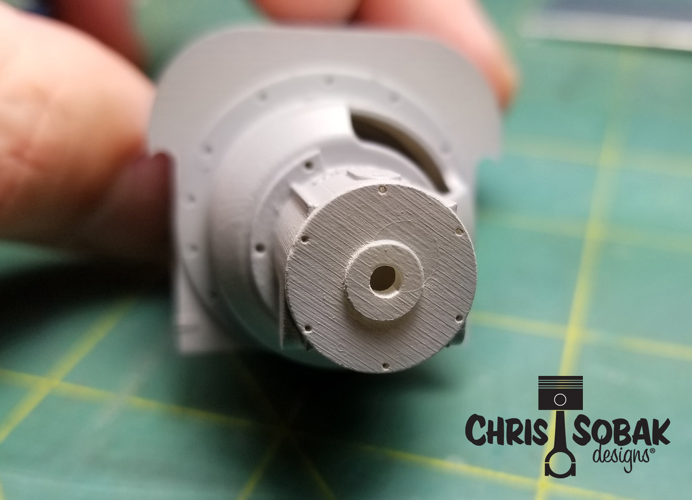

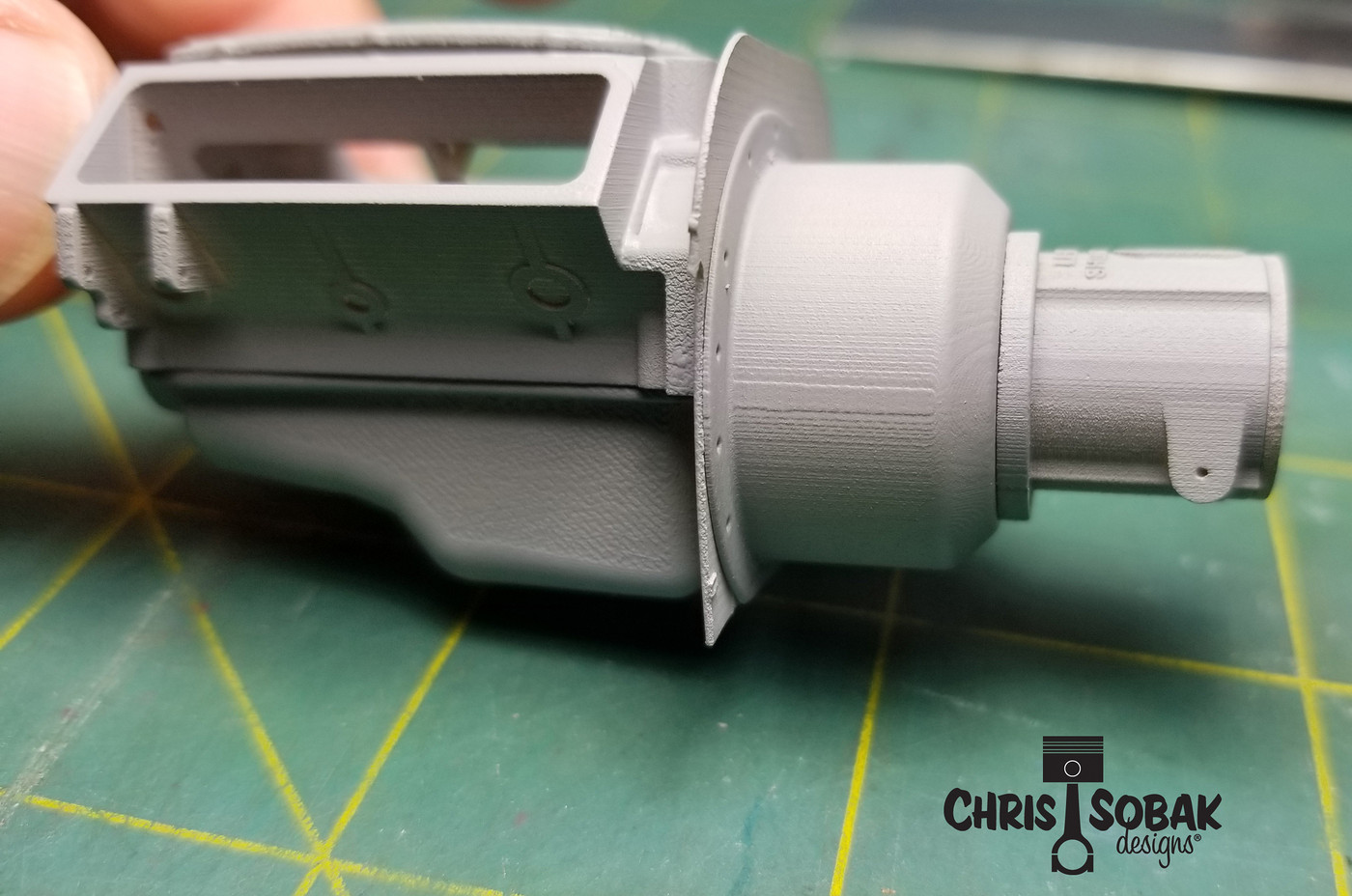

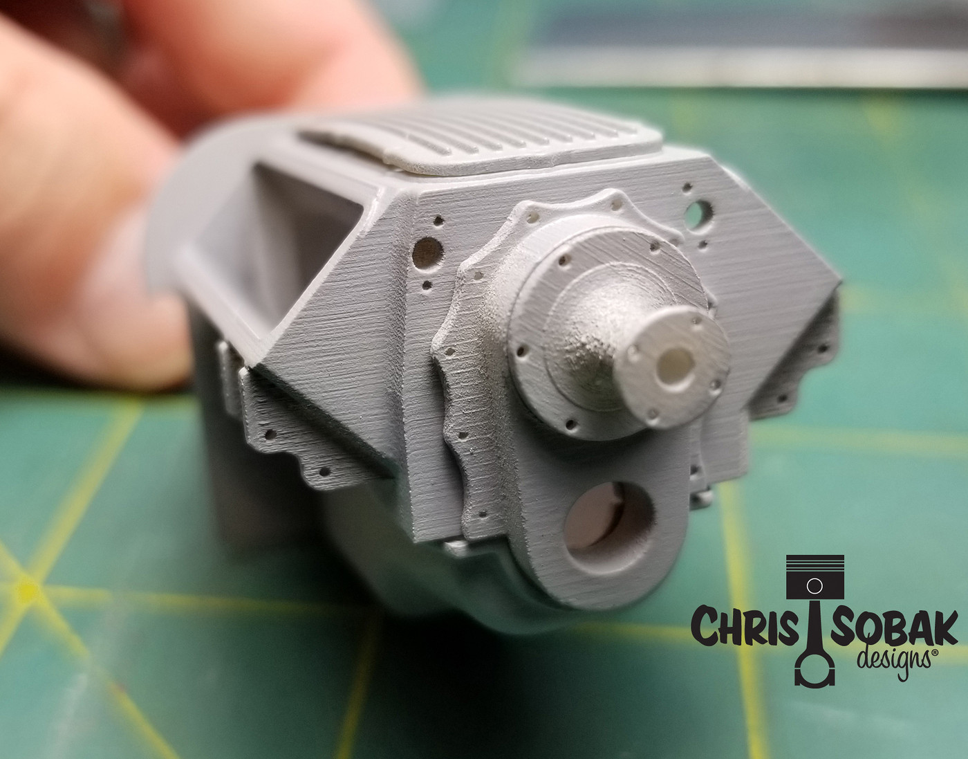

The next step was to get some primer on the part to check out they actually turned out.  With the way I laid the parts out in the file I was not able to have the parts printed at the smoothest resolution since it was a little bigger than the volume of the print area. I am sure I could of rearranged the parts to fit in the build volume but I was too anxious to have these test printed. My plan is to sand these parts and you will never see the print lines in them. But then again I noticed some things on the block where I want to go back and add some radius to a few of the areas to have smoother transitions. I was pretty excited to see the parts and that they had fit like I expected. I still need to draw up the heads, valve covers and Manifold:

The day will come when you start doing your own printing.  You can design and print fixtures to hold all of your brass tubes in exact position for soldering.
I use dental scrapers on layer lines to shave them down.  Works better than sanding or filing for me because I can see where the cutting edge is cutting.

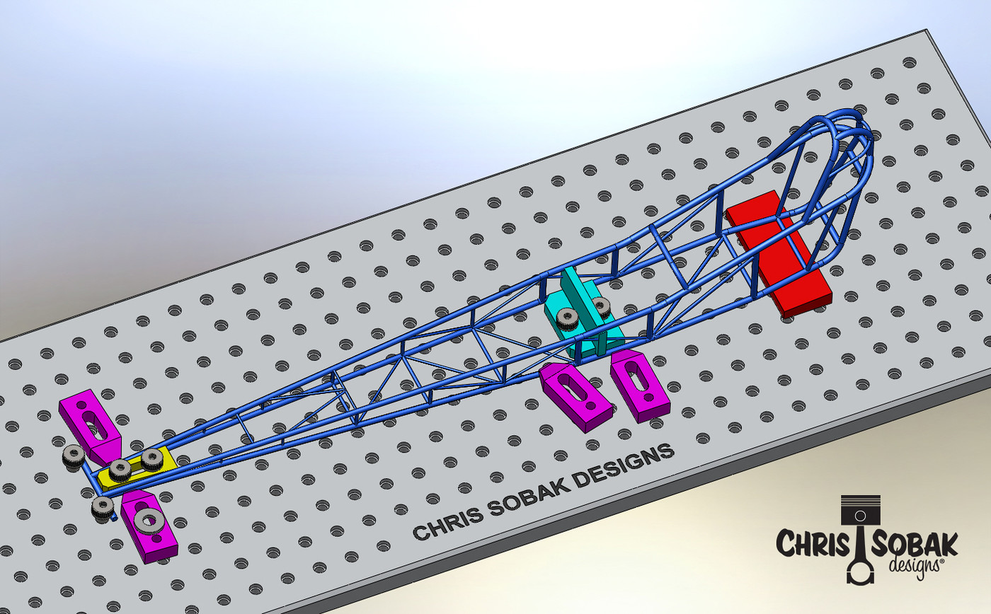

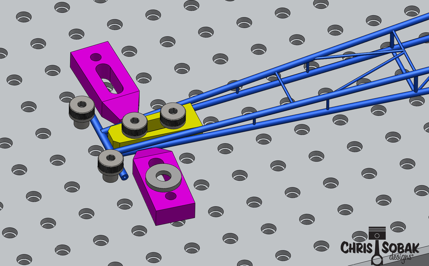

Ok Fellas.... So as mentioned I haven't been to the bench so to speak for a while but I have been working on some design work and spending time here and there at the computer. I have been working on designing components for a chassis jig for this project so I can keep the frame square when I build it. I have designed miniature clamps which is somewhat of a scaled down version of clamps I use on fixtures at work that I design. I know some of you may think I am nuts for doing this but I thought that I could approach this like I do with some projects at work on how we bank parts and hold them down in fixtures while they get machined. So far I have gotten a couple of the clamps and components for the fixture drawn up, I still have more to do there. But I did start to Machine a few of the clamps and let me tell you that it gave me a much more respect for guys like Tim (Codi), Dave (Comp1839, Mark Jones (Scale Master) and all the others out there that machine parts. I didn't realize how much time goes into setting up a part prior to machining. While I am having a blast making chips, I know I am going slower than those who have been doing it for a while but I am also taking my time to learn and not screw things up. I am taking lighter cuts while I am learning my machine and am sure when I am more comfortable I will be taking heavier cuts to rough the part out and come back with a light finish cut. Anyway let me share with you a few pics of what I have been working on the past few weeks.
Here is my Chassis Jig Plate, the Hold Down Clamps and supports. I still have more items that I need to design for the fixture:
Here is an up close shot of the hold down clamps:

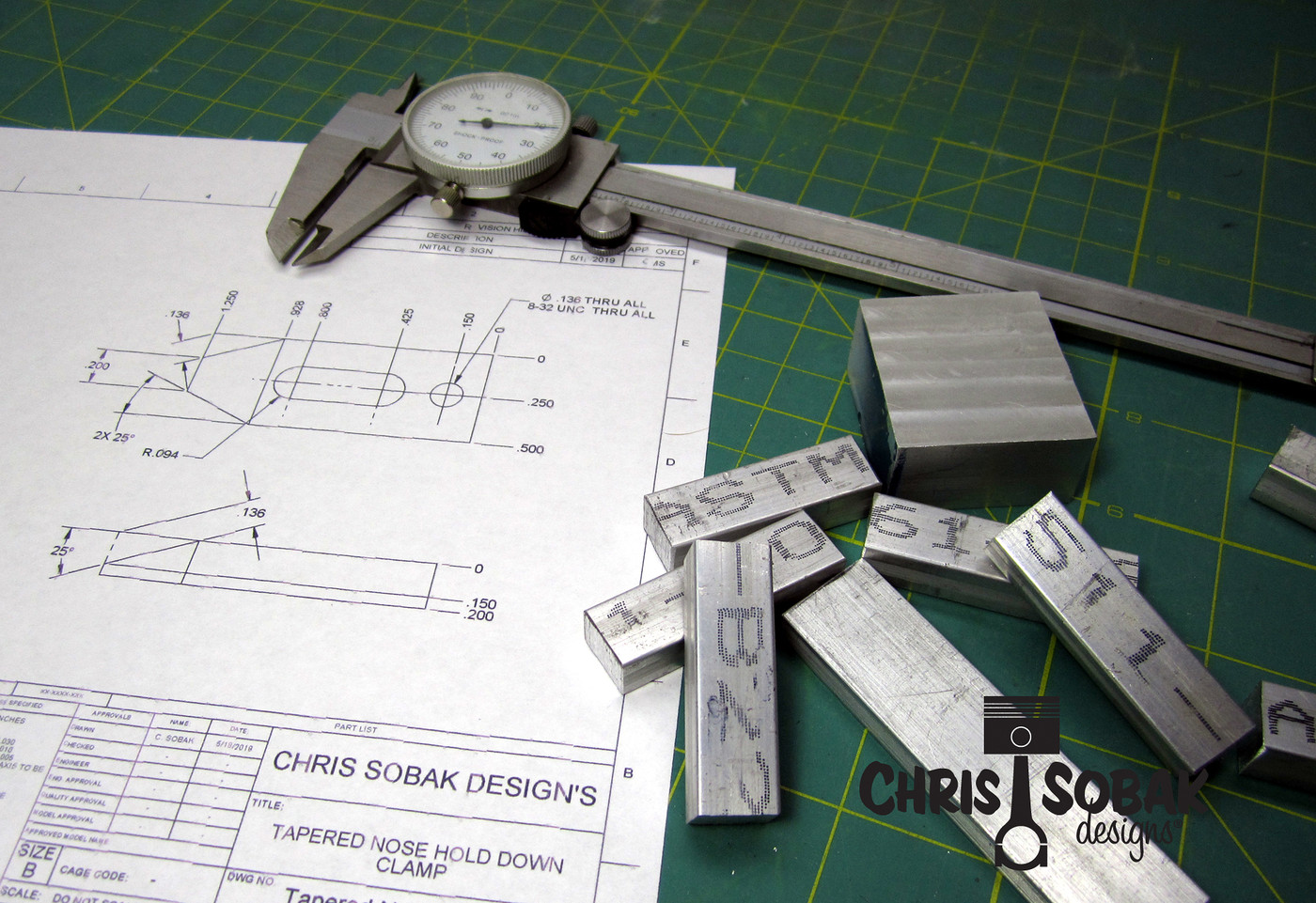

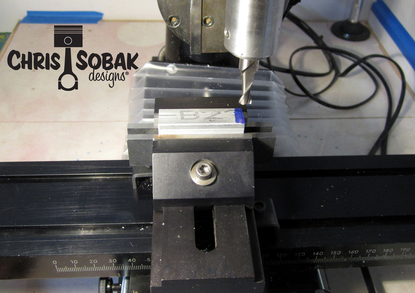

Here is the drawing of my clamp along with some 6061 Aluminum to make them from:

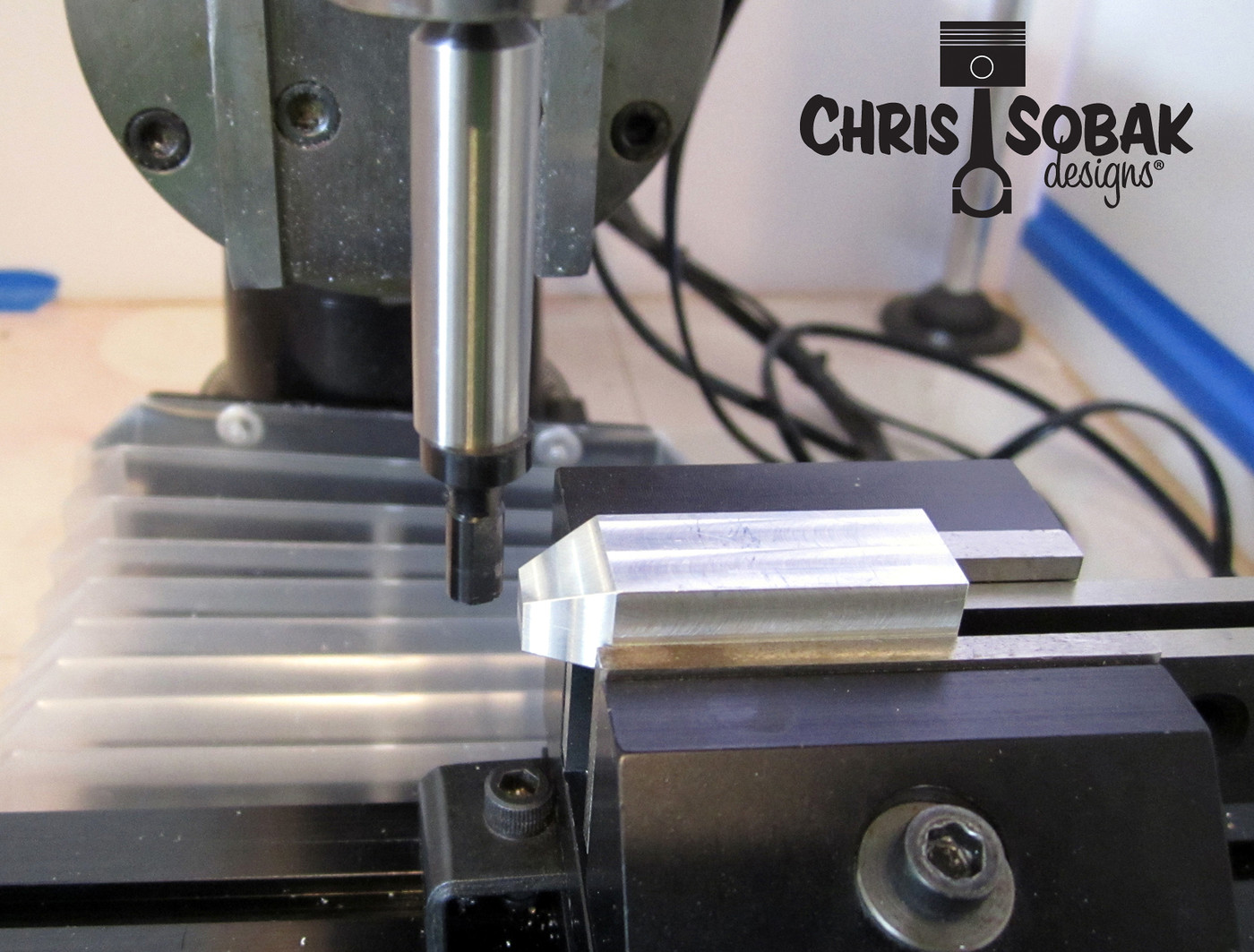

I started out first with squaring up my material:

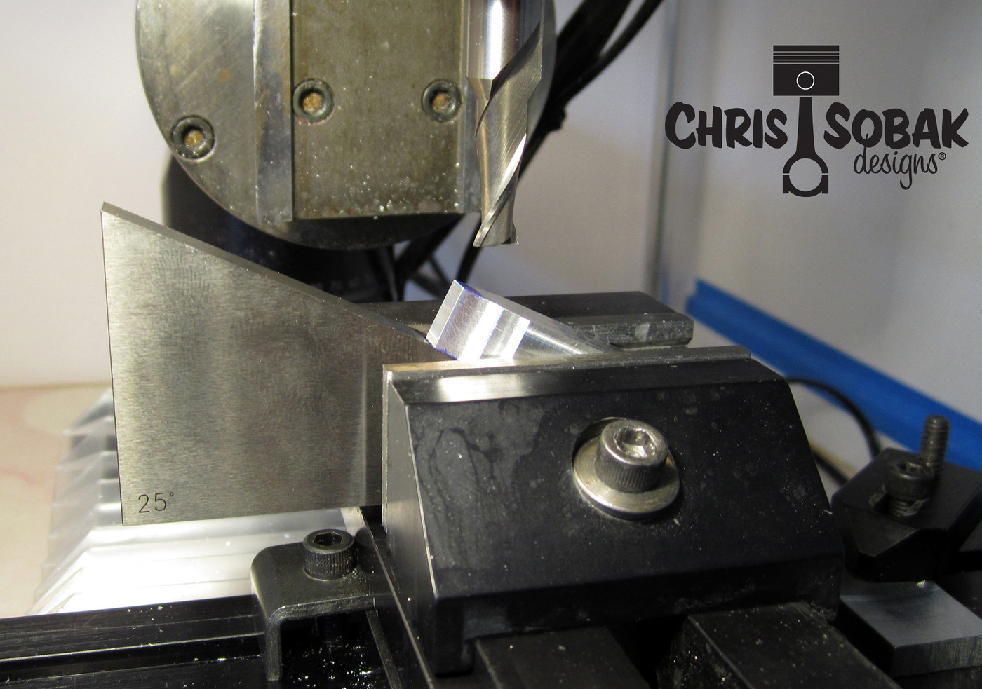

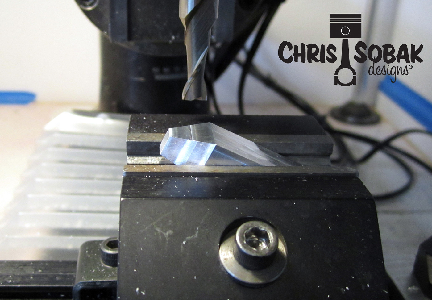

Once I got the block squared up  I used and angle guage to cut the angles into the part:
Share this post
Link to post

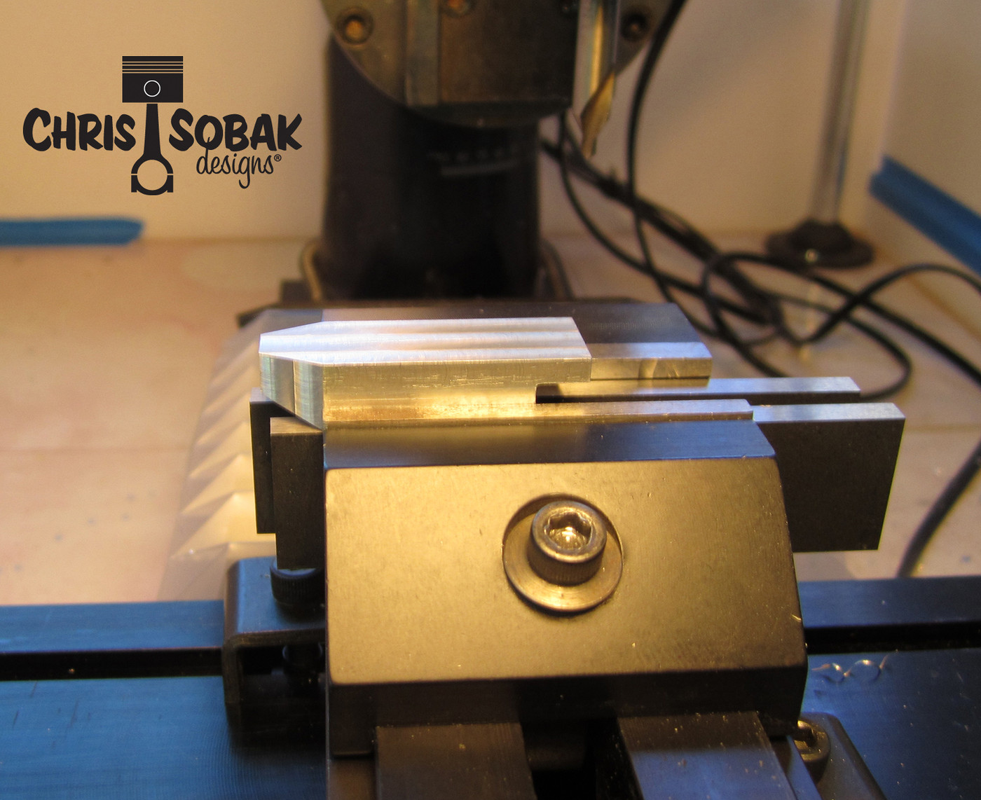

Here is what it looked like after cutting the angle:

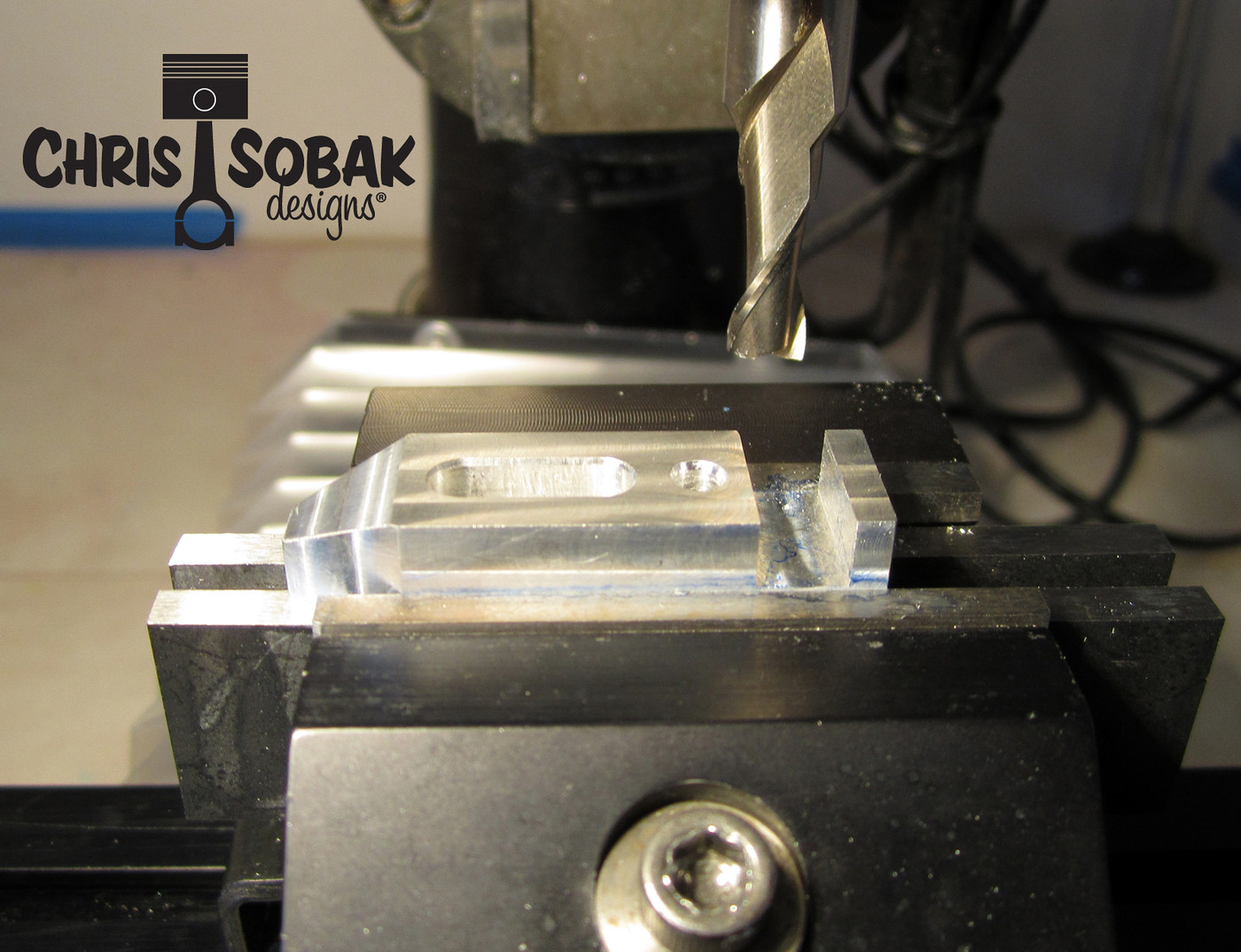

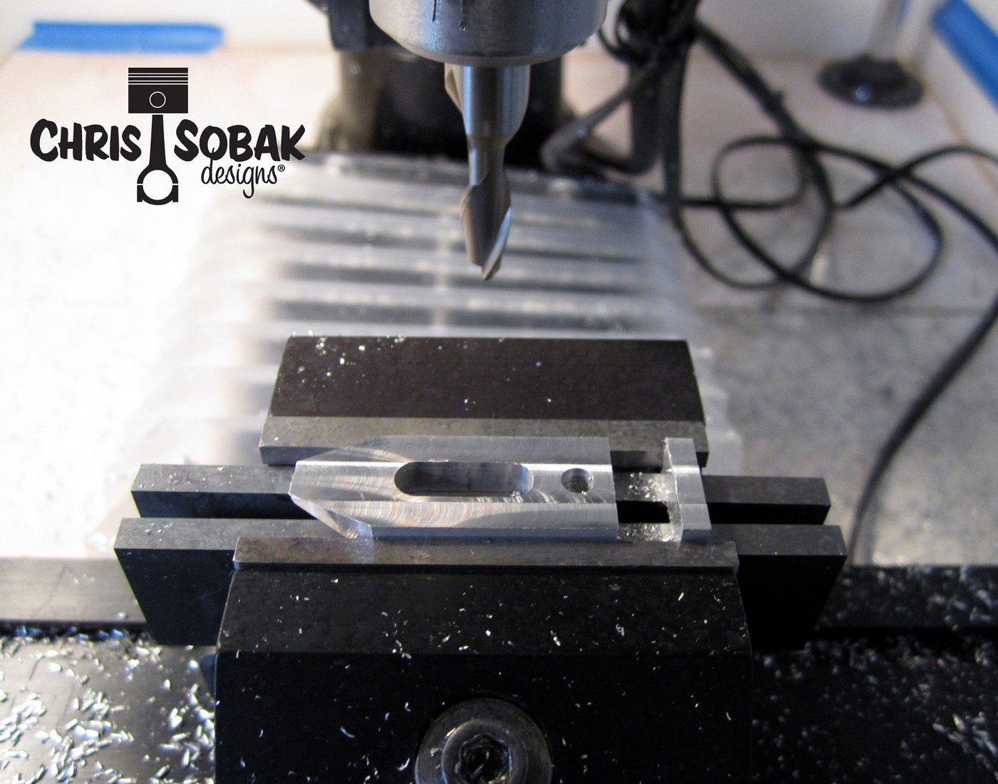

After cutting the Angle's on the part, I put the part back in the vise and indicated the part in and set my X and Y zeros on the DRO with an audible edge finder:
I then machined the part to length and added the hole and slot to the part:
Next I flipped the part over and faced it off to size (yes these are two different parts, Top pic part #1, Bottom Pic part #2, I forgot to take pics of the 2nd part after I flipped it over to face it):
