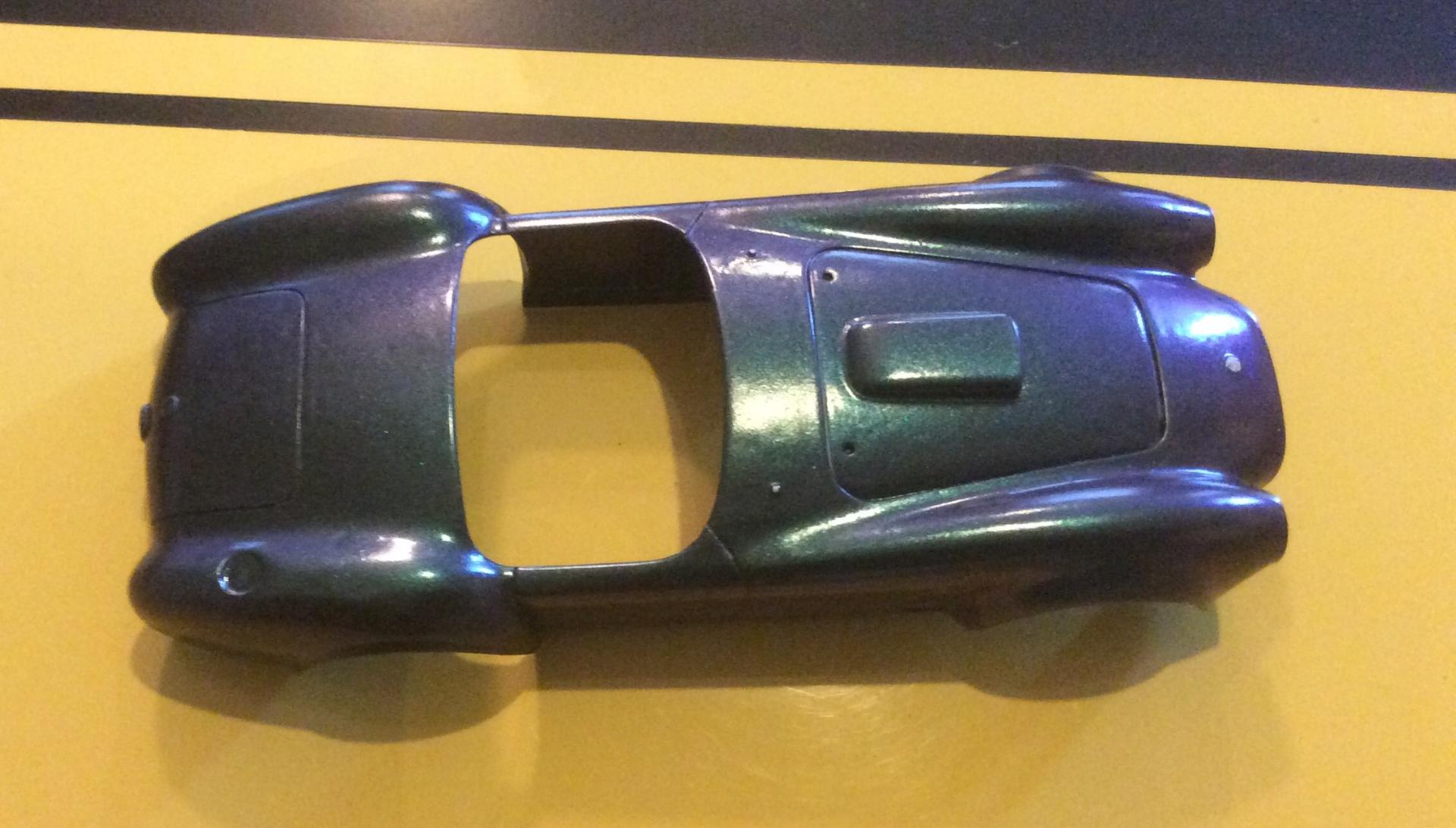

I decided to test it out on a spare Cobra body.  What do you all think?  This was an extra body so I did not worry much about it being perfect - it was just to see how it would look.
