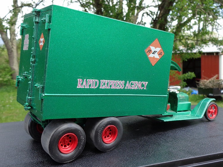

Don't wait on a new kit either. Order the needed plastic from Plastruct and start cutting.....looks like a easy build. I just started a 40's era round nose 30 foot trailer.......the Coke trailer is lots of 90 degree cuts.
This box van body toke a few minutes to cut and fit......

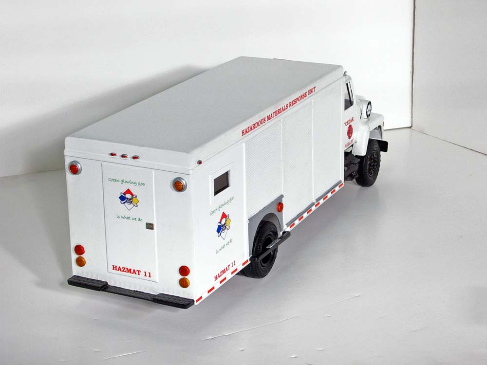

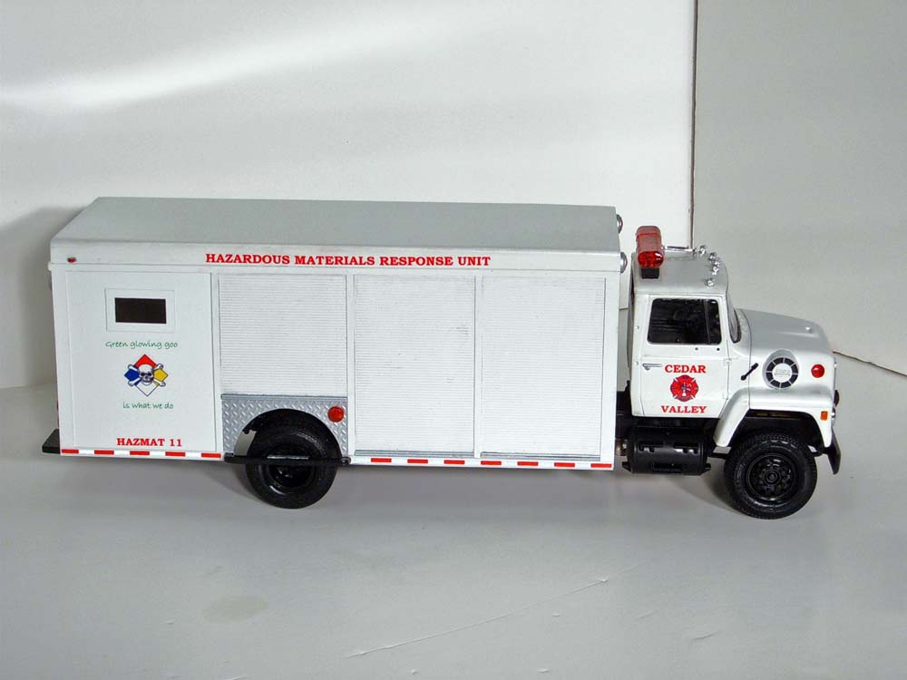

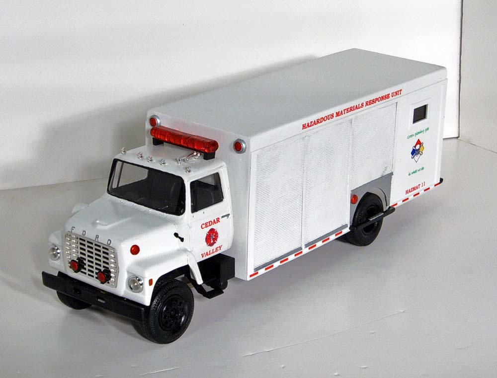

I built a beverage body years ago, it really is a very simple project, just a box with stuff glued to the outside. A trailer would be little different, but you just need to find an appropriate trailer chassis to base it on.
I based this one on a Hackney body. In the 1990s retired beverage trucks were popular with fire departments who would convert them into hazardous materials response trucks. The last section of doors was often converted into a room for a computer and reference books as I did on this one.
The body is just styrene sheet, the drip rails, door hardware and such is just various styrene shapes. The doors themselves are formed from V groove sheet.

Aaron is on to something with his build- the Charlotte Fire Dept uses a beverage body trailer to haul it's Haz Mat equipment to the scene here. A lot more work to make the doors roll up and functional as you would have to build the inner body structure too, but I am sure there are some builders here up to the challenge.
