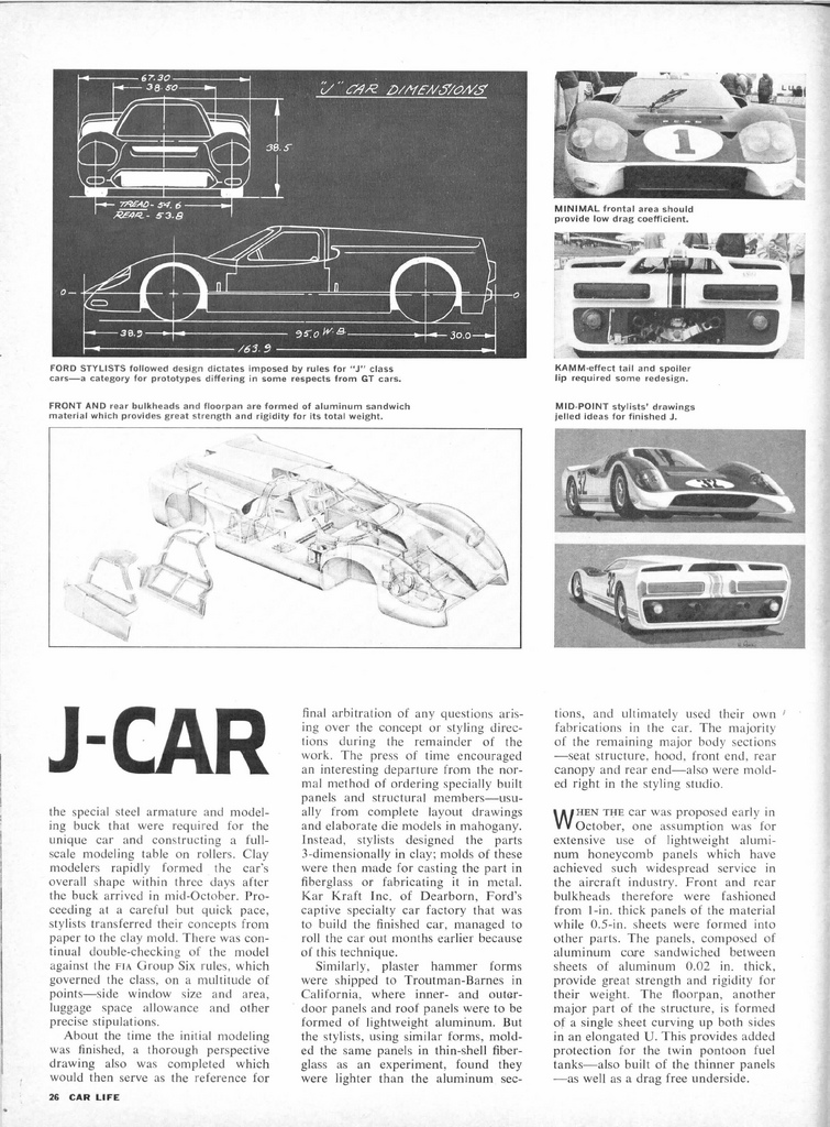

12 hours ago, Gramps46 said:
I am a little late to the party but you might like to have this art work.
And these articles for background.
Better late than never!  I saw the art drawing before, that has to be a conceptual rendering.  Note the side strip continues both ways, I did to the rear.  The engine bay, Weber carbs, oil cooler position, more complicated header routing, so many other cool details that would have guaranteed I never finish it.  Thanks for posting all this!

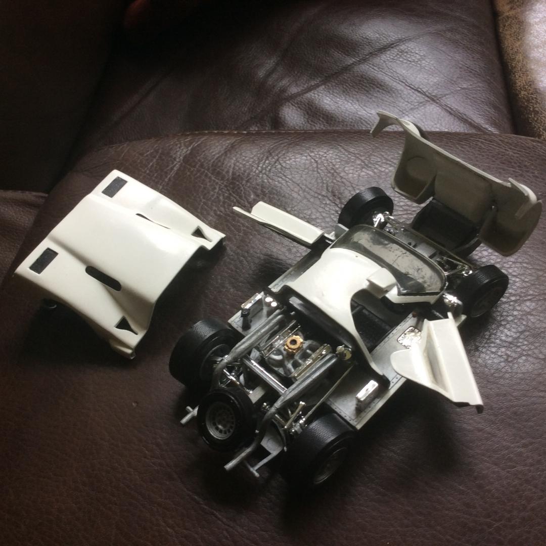

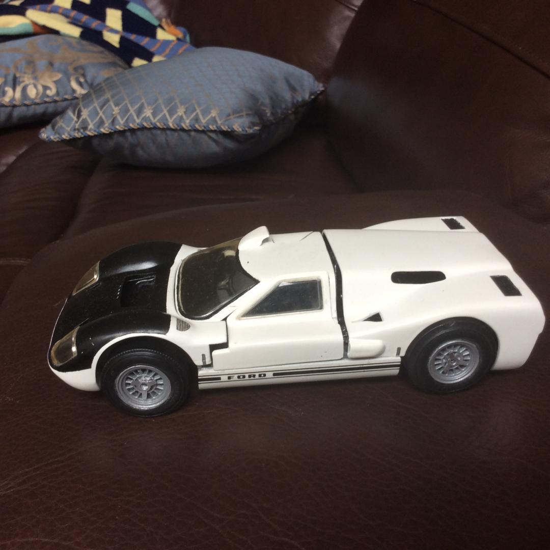

I have had a wild hair to finish this for some reason.....
Final assembly was a trick, considering you can't dry fit the body until everything else is glued together.  I found most parts needed adjustments.  The closest to detailing anything, was creating headlight lenses with clear epoxy.
IMC: Ford GTP J-car
The glass fit was either huge gaps, or file/sand the edges.  I painted all edges flat black, glued on with Elmers clear glue.  Headlights interfered with the covers, oh well.  The engine bonnet hinge is a problem, would need to cut and reposition, not going there.
IMC: Ford GTP J-car
With everything open, can't tell the fit is bad.  I know if the previous owner had tried to built this, the hammer would have been used.
