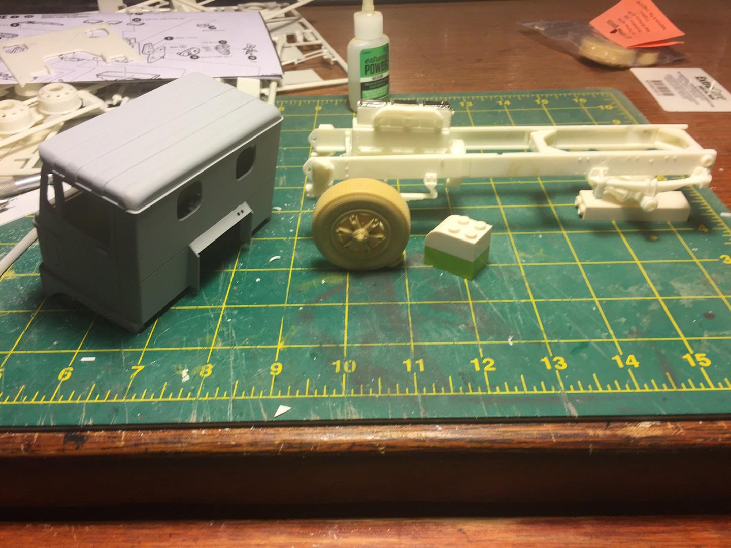

dshue76 Posted August 26, 2018 Share Posted August 26, 2018 (edited) The AMT Louisville LN8000 Delivery truck has a 19' 9" bed length. It would be a viable kit for this and that's exactly what I'm using for the same type build, Although I'm using an F-350 cab with the LN8000 hood I needed a longer frame so I think I used the optional long frame from the AMT Mack DM 800. Edited August 26, 2018 by dshue76 Quote Link to comment Share on other sites More sharing options...
