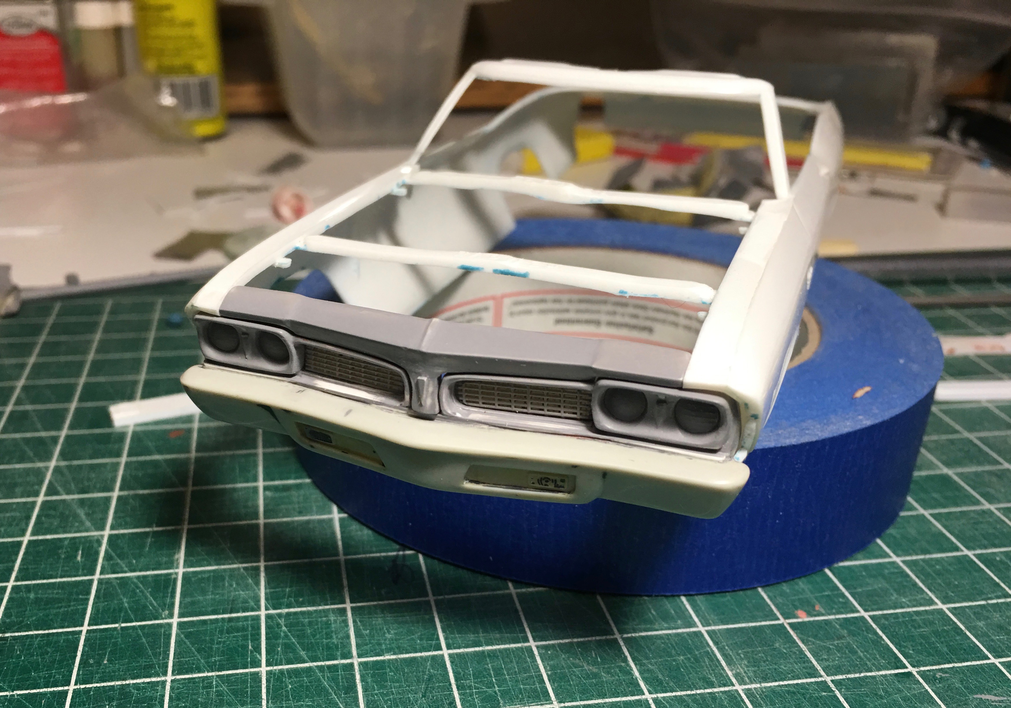

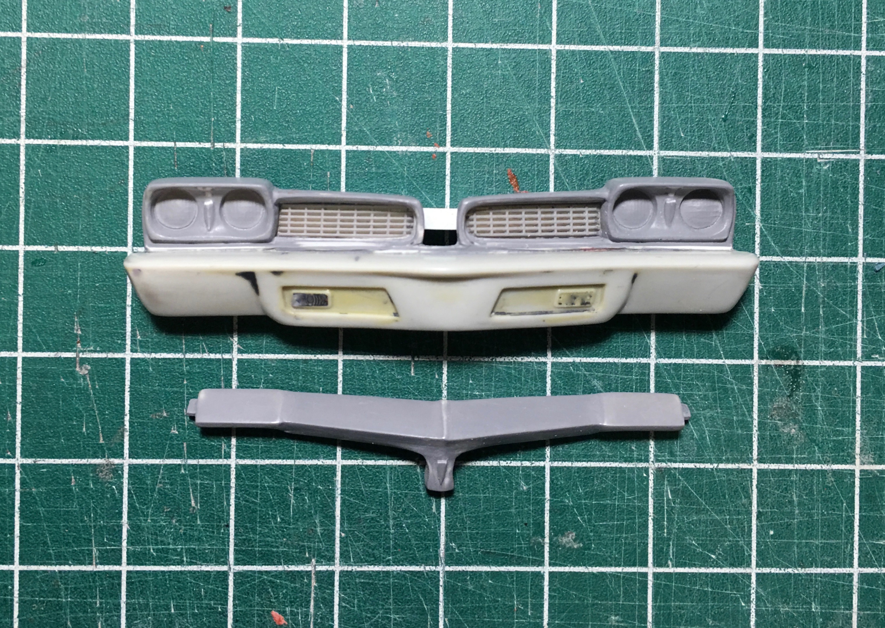

I've been slowly re-working the MCG resin part to get it more accurate. The grille openings were too small and the outer ends were completely wrong. This is what you'd call a "long term project", last time I worked on it was about 5 years ago. LOL

Years ago, I started making this grille. I'd always liked the Canadian versions of US cars with their often wild looking details, and the plan here was to build a Beaumont and bask in contest table glory; because who else would have thought of doing that? Well, when I was about half way through the grille, MCG announced their resin Beaumont conversion, complete with photoetch scripts, which took the wind out of that sail. So I put it away, and never thought about it again until I ran across it a few weeks ago. By then, MCG no longer offered their resin version, and the one that I'd seen looked pretty far off anyway - like someone stuck some GTO grilles in there and called it good, so I figured that now would be a good time to finish it.
2 hours ago, Can-Con said:
Looks like your going to cast it as all one piece?
It's two pieces, the grille and the header panel. Cut the stock header out and replace it with the modified panel.

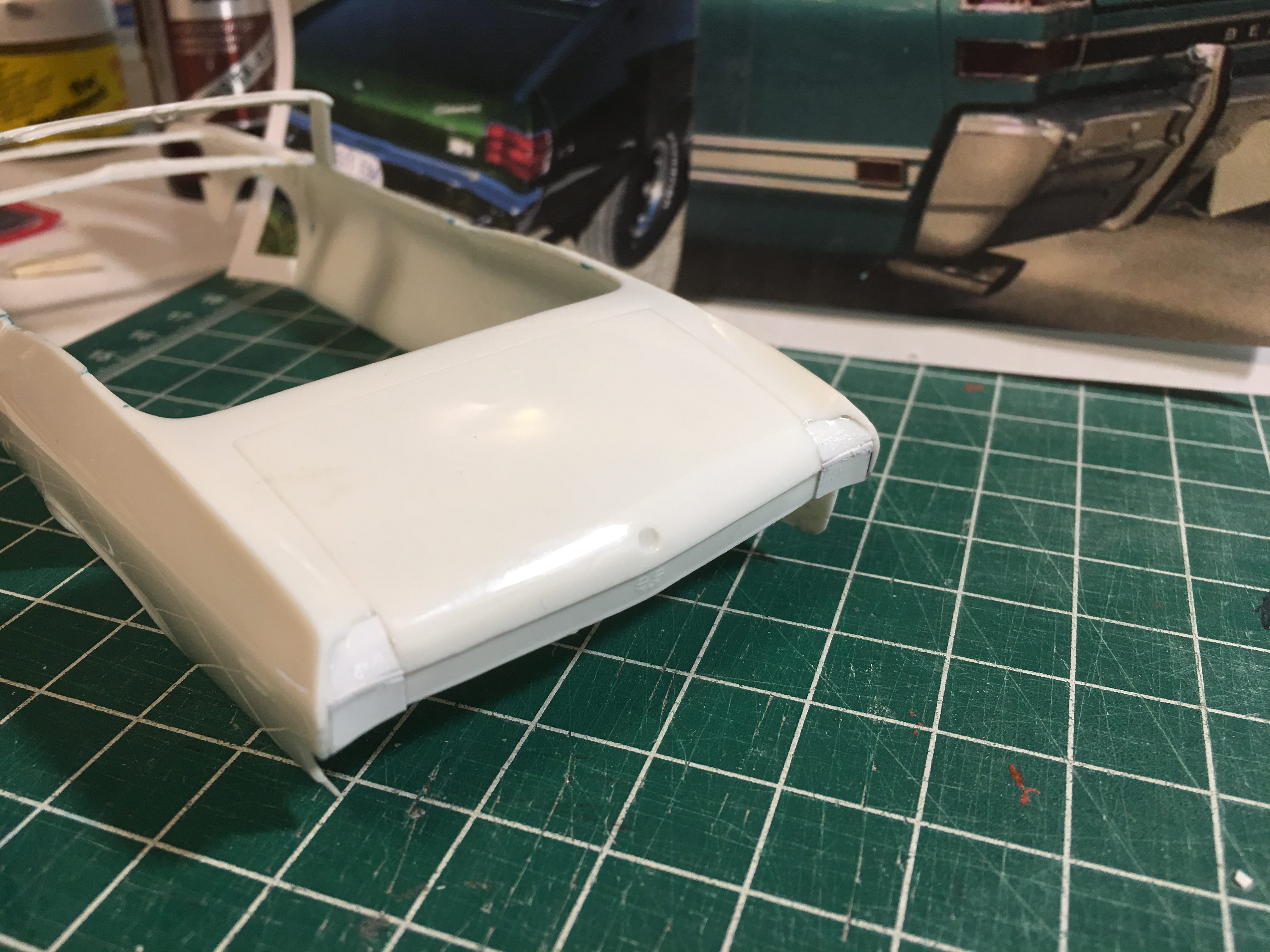

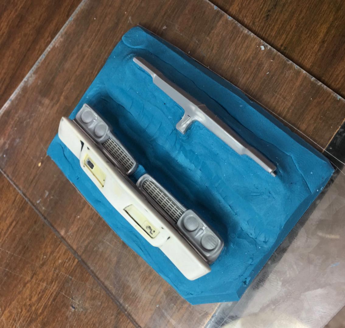

I got the front parts clayed up for the mold, and started filling in the 1/4s to start on the taillights.
20 hours ago, Superbird McMonte said:
Very nice work! I look forward to seeing it done. Sounds like you will be selling this as a trans-kit?
Yes, it will be offered by Greg Wann, the Master Caster. The front parts will be available first, the taillights and 1/4 extensions later.
