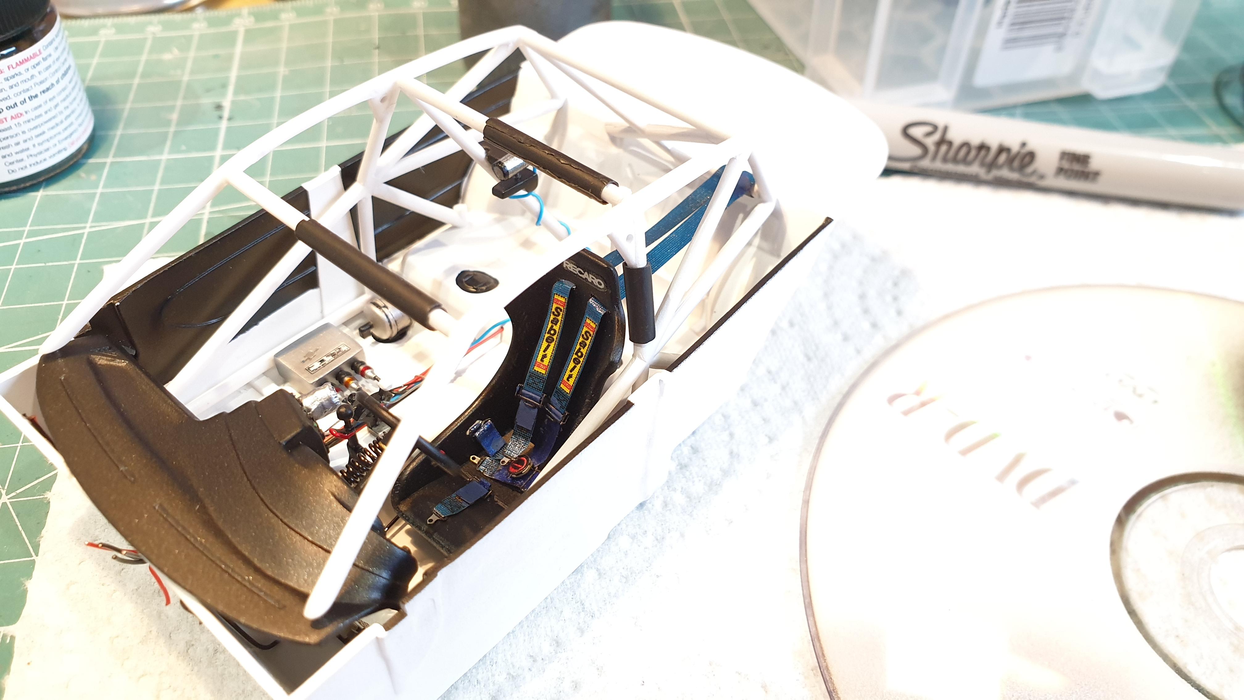

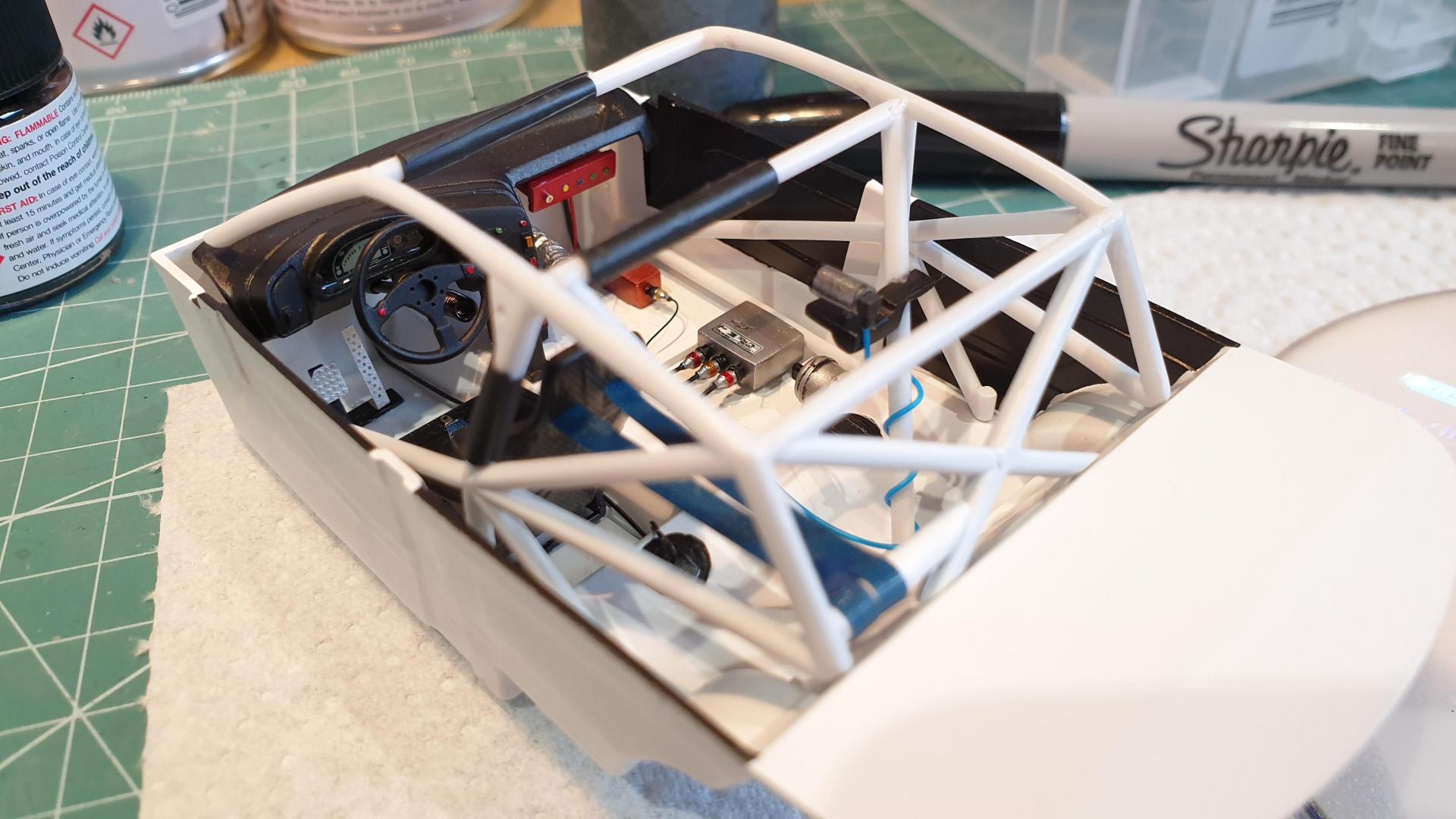

The seat is now finished, just need to add PE belts
 Iv'e SB'ed a camera, the lens is made from PVA glue
SB'ed some electronics
 the Seat belts will be Sabelt by Eduard
the interior tub is taking shape

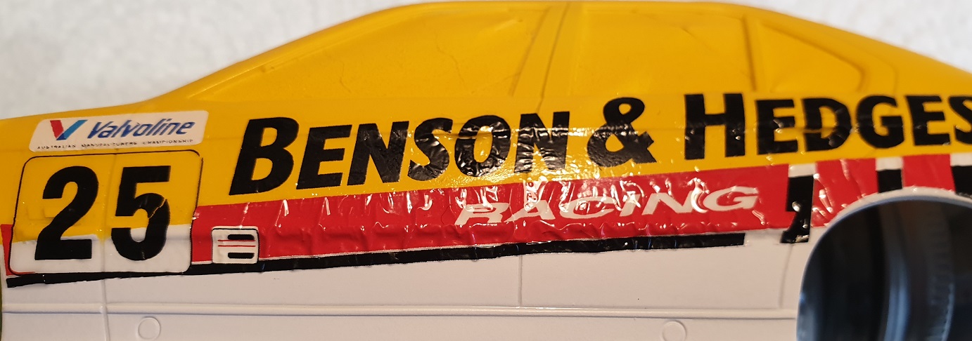

Unfortunately, the Microsol was not able to make these after-market decals conform. I've got wrinkles & air pockets near raised moulding detail.
Now, I'll admit I did apply them over the Zero Base coats - and not over a clear. How ever, I've done that before with no issue.
I have used soooo much microsol, and sooo much hair drying - that I managed to warp the body (because I left the body in the spring-loaded tamiya paint stand, and it bowed out!) However, I plan to cut the bubbles and have another go at it with microsol
Some of you may notice that I also messed up with the positioning of the transition from white to yellow. Now the racing number is half yellow & half whit - it should be all yellow, I think I'll make up for it by adding a decal over it that's yellow...
Need some advise though - what do you reckon - paint the clear first then add te 2nd side's decal? or just try the same with the other side? Also - does anyone know of a stronger decal conforming product? thanks!

Mr Mark Softer may help - the stuff is very strong, however if the decals are dry it might be hard to right them from here. I think its probably not so much the paint finish that is the problem here, but more the decal not conforming very well to the curved surfaces and the decals too thick too.

Thanks for the tip, but I couldn't find any. i went with "DACO PRODUCTS" Decal Setting solution STRONG. I then tried to get the other side done... and failed miserably! the 2nd side is worse, so I'm going to have to strip them. I might try and print my own decals, I always take a scan of decal sets prior to use (just in case) but this is the first time I've really messed up a set!

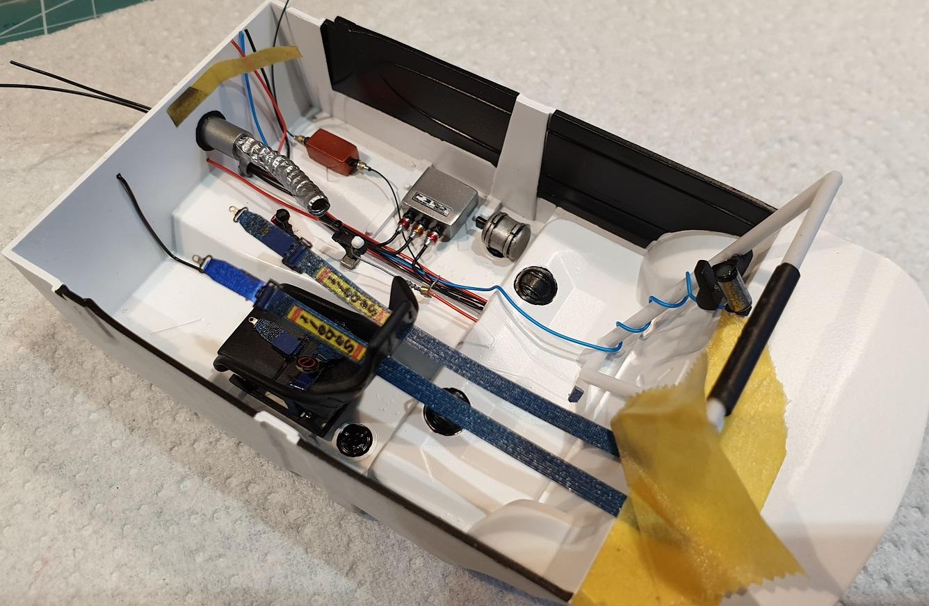

If the paint get damaged, I may respray for some decals I can get here. Regardless, the interior is back on the bench! Electronics are in & belts are getting added to the seat, just the frame and camera to add with a bit of cable tidying to do...

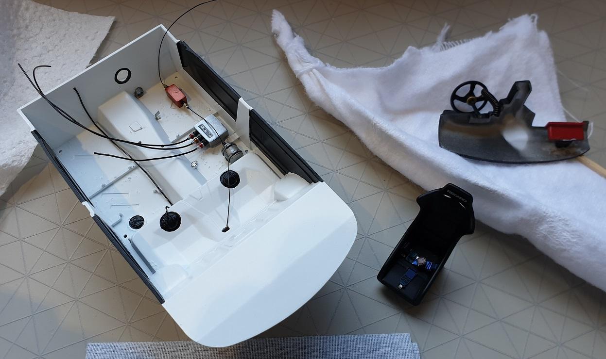

Thanks to Dr Trevor, I should be getting a replacement set of decals, the interior does not look like much, but its many hours of tedious time at the bench!
I'm tring to soak off the old decals, they are being tough, hours, and not bugding. I did some research, and they may come up with decal softener...

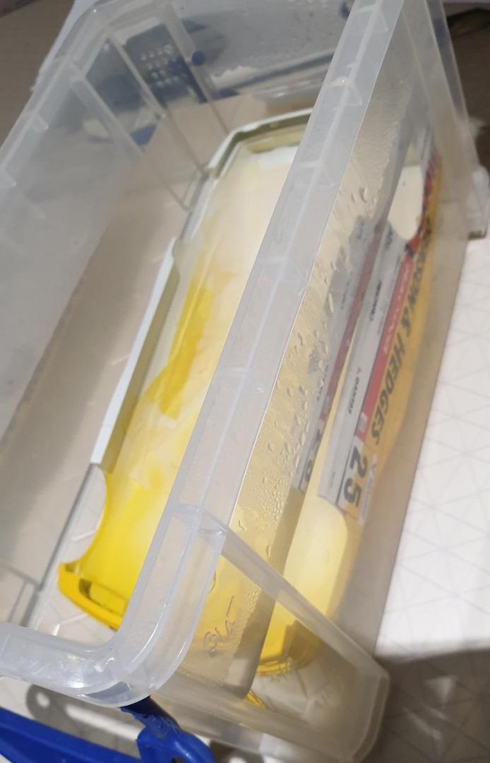

I've struggled to ge thtese decals off:
I've soaked on tissues - didn't wort
I've soaked with daco stronc decal softening solution - no movement
I've soaked for 48 hours in water - nothing
and with oven cleaner (Mr muscle) all it did was bleech out the print, the actual decal substrate remained...
so I'm going to have to sand and respray!
