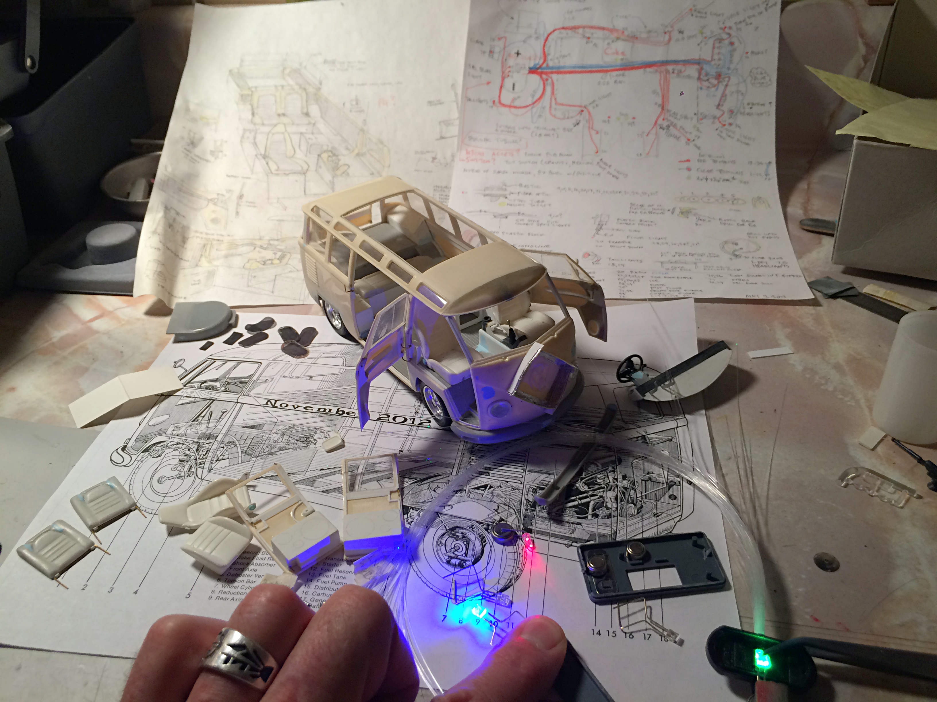

I was checking out some junk mail, car dealer promotion with a light fob that showed you got the winning number (yea right).  I pulled the unit apart, it's just one LED light, but am contemplating the use of fiber optic that came from a party accessory.
Nevertheless, will keep an eye on this topic.

If you want to use the original circuit, just with a white LED, you can easily substitute the green or blue ones for white.  There are thousands of cheap LEDs available on eBay, in many sizes and colors.  Your LEDs look like T-1 (3mm diameter) size.  I also assume that you want the "warm white" LED to simulate incandescent lamp headlights.  Just go to eBay and search for "3mm warm white LED" and you'll find lots of choices.  Here is one:

Those freebies are molded square.  I'm not electronic savvy, those eBay ones only need the tiny batteries?

Looks like there are 3 small button-size batteries there?  Yes, those LEDs will work directly with those batteries.  I would add a 100 or 200 ohm resistor in series to limit the current,  but since these small batteries cannot provide much current to begin with, they will self-regulate.
As for the LED shape, you can file the clear resin LED case to any shape you need, as long as you don't get too close to the internal parts.  Or you can buy much smaller LEDs (smallest available LED has a footprint of 0.020" x 0.010"). That is smaller than a head of a pin.
If you are not into electronics and want ready-to-use lighting kits, check out https://lights4models.com/ .  These are not for free, but they work well.  Select Vehicle or Vehicle Modern (or any other types you like) on the left side of the Web page.
