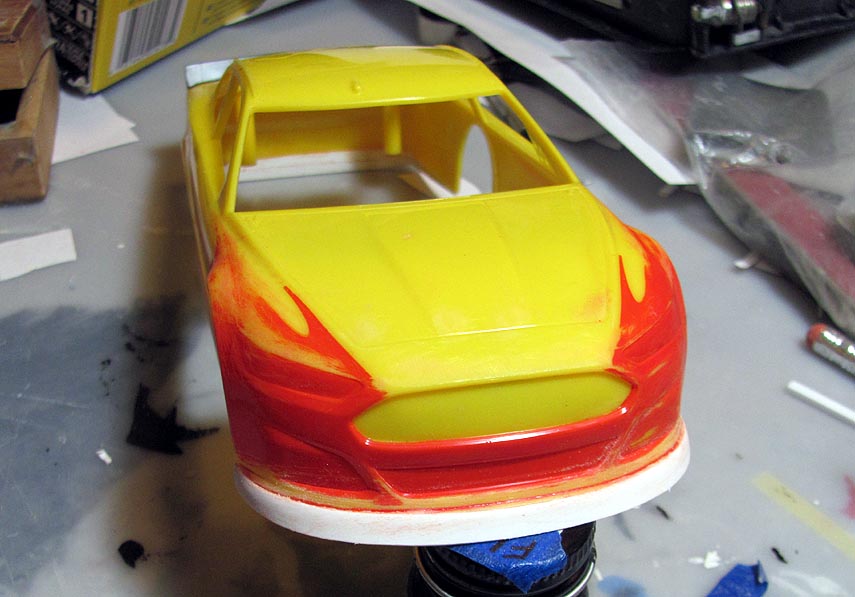

MarkJ Posted September 20, 2018 Author Posted September 20, 2018 11 hours ago, iBorg said: Curious as to the differences between the snappers and the glue kits. Snappers are a lot easier. But I still use glue to assemble them. Also you have to do some mods to the body to get them to look right.

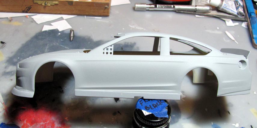

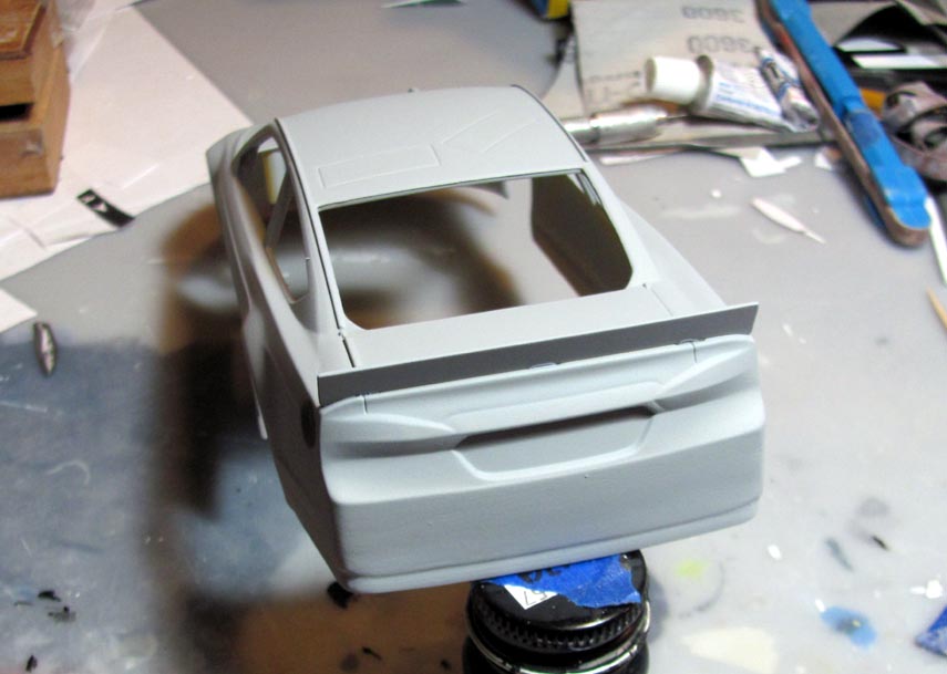

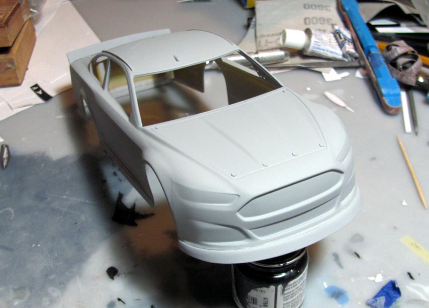

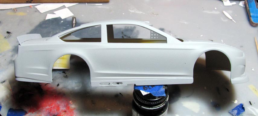

MarkJ Posted September 28, 2018 Author Posted September 28, 2018 I think I have the body work done and the first coat of primer.

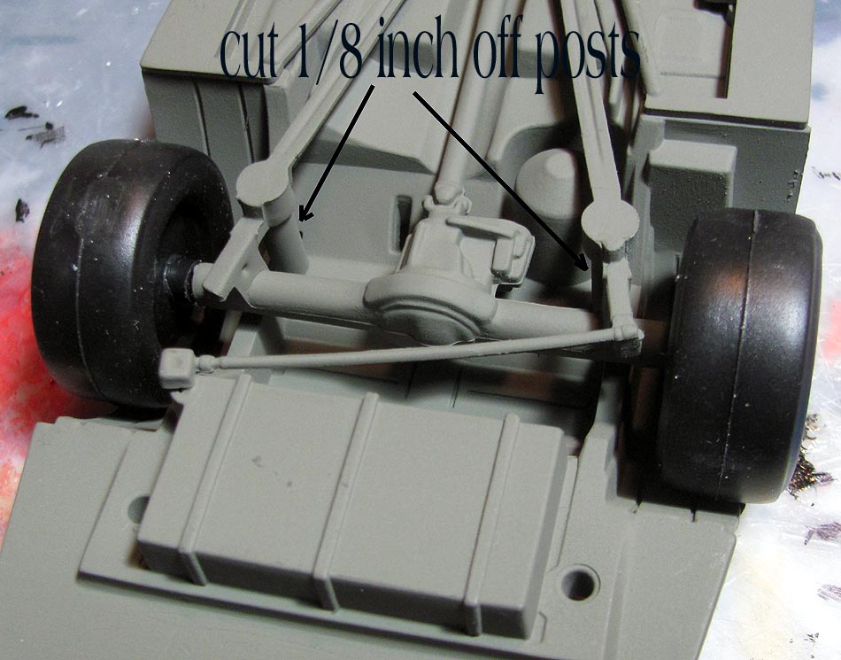

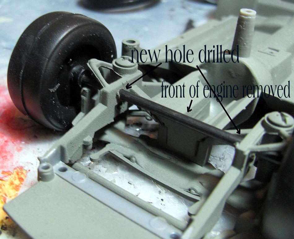

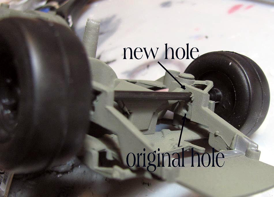

MarkJ Posted October 7, 2018 Author Posted October 7, 2018 Somebody asked me once how I lowered these kits. What I do is drill new holes in the frame 1/8 inch higher than the original holes and remove the front of the engine. Cut 1/8 inch off the metal axles. In the back you cut 1/8 inch off the posts that represent the rear springs. That's all you have to do. It lowers the car and sucks the tires in under the fenders.

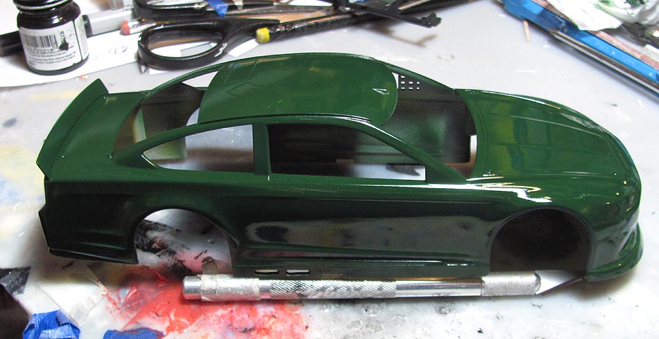

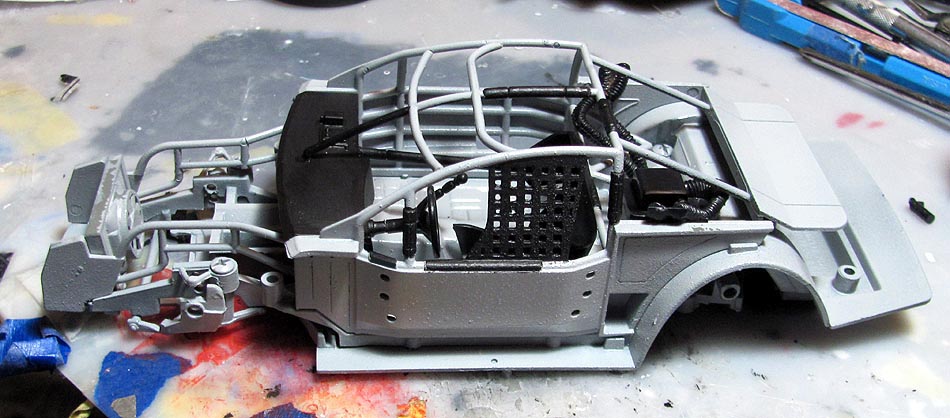

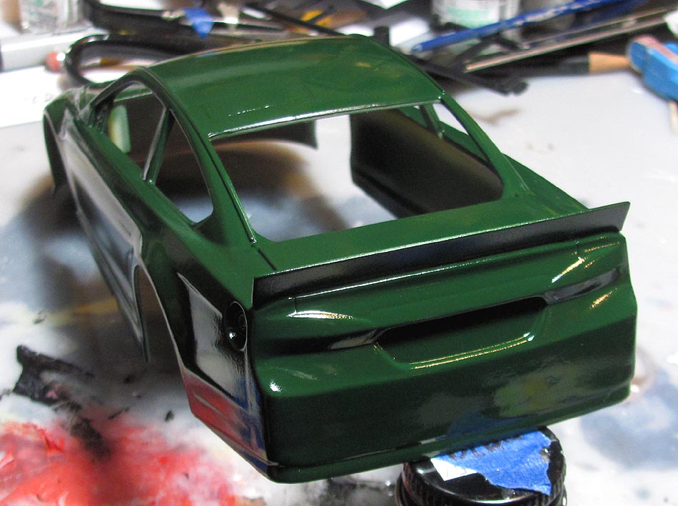

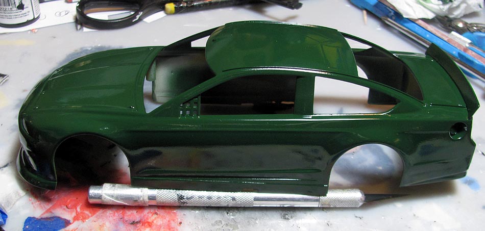

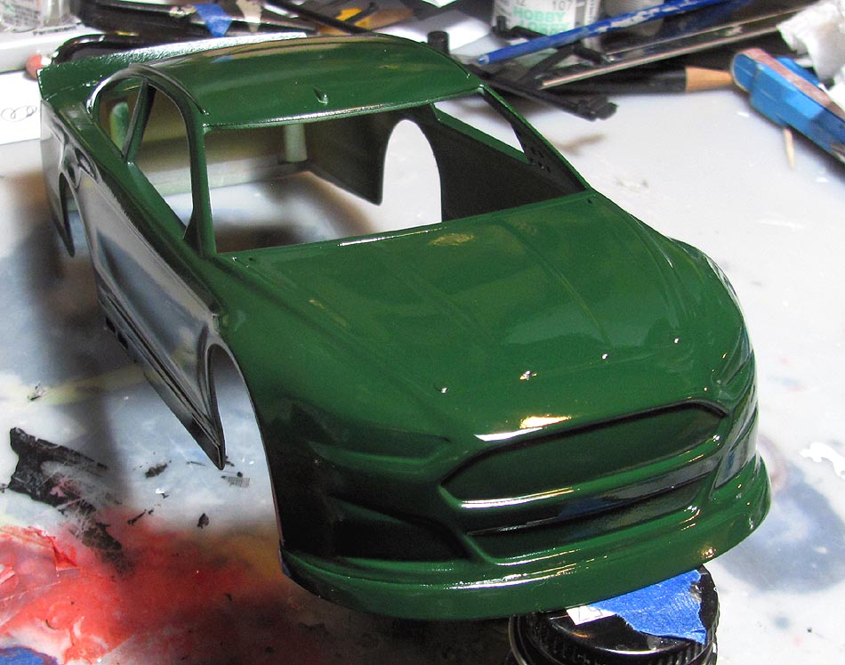

MarkJ Posted October 12, 2018 Author Posted October 12, 2018 Got the chassis pretty much finished. Got the body painted but don't know if I should just leave it or polish it. Thoughts?
bbowser Posted October 13, 2018 Posted October 13, 2018 Looks great! I vote to leave it, most race cars aren't that shiny unless they're show cars.
MarkJ Posted October 13, 2018 Author Posted October 13, 2018 Thanks, Bruce. I agree, its shiny , just not mirror shiny, which it doesn't need to be.

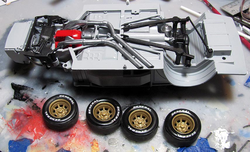

MarkJ Posted October 18, 2018 Author Posted October 18, 2018 (edited) Got the chassis and tires finished. Just need to paint the center hubs after the car is complete. Also, I have learned not to install the shark fin until the decaling is finished. I usually knock it off the car if I do it before. The tires wont be that shiny when the car is complete. I just finished applying the dull coat with a brush and they have not dried yet. Edited October 18, 2018 by MarkJ
Jim N Posted October 19, 2018 Posted October 19, 2018 Great work Mark. I agree with Bruce, I don't think I would polish the body.
