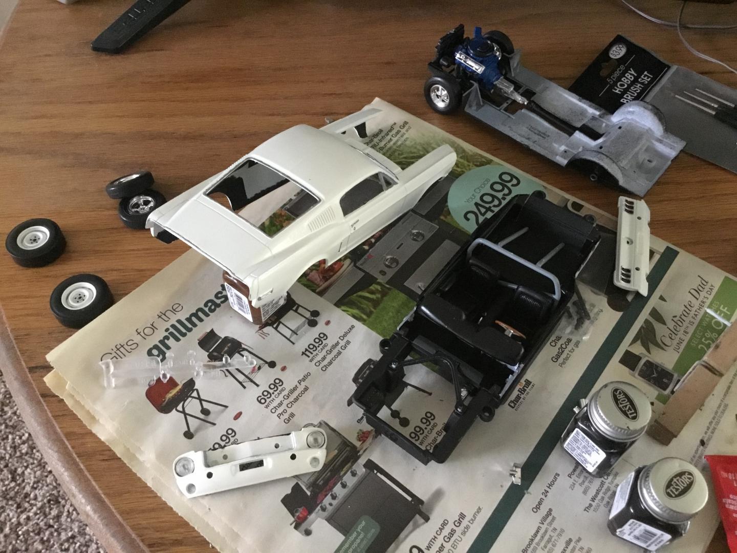

I just did this kit. you definitely want to get that front and rear on first. the fit is kinda crappy and you can tweak it to fit right this way. body fits on just fine as its based on the die cast version. this is the fit after pre assembly and sanding. the front seemed like it came from another kit it fit so poorly and the rear was about 1/16th wider than the body. this has always been the case as far as I've ever seen on several mustang kits over the years
