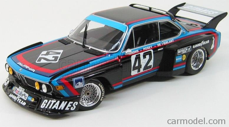

Rider Posted October 10, 2018 Posted October 10, 2018 (edited) 3 hours ago, robdebie said: Yep, it looks strange. I will try to find a better photo. Rob I found this. From this photo the c-pillar transition area looks smaller on the kit, also the door looks shorter. The rear side pod also looks shorter, the wheel openings are a different shape too. The more you look at the two pics the more you can find. Although as with many race cars teams often did their own tweaking for one reason of another. Most of the differences seen here can be changed and or tweaked. Regardless it's still a cool model worth building. Edited October 11, 2018 by Rider

robdebie Posted October 13, 2018 Author Posted October 13, 2018 On 10/11/2018 at 12:55 AM, Rider said: I found this. From this photo the c-pillar transition area looks smaller on the kit, also the door looks shorter. The rear side pod also looks shorter, the wheel openings are a different shape too. The more you look at the two pics the more you can find. Although as with many race cars teams often did their own tweaking for one reason of another. Most of the differences seen here can be changed and or tweaked. Regardless it's still a cool model worth building. Thanks for the photo comparison! I still haven't figured out how many body styles there were. The green one is a 1976 version I think, with a different air dam, rear wing and louvers in the rear fender. But the doors should be identical as you suggest. Rob
robdebie Posted October 13, 2018 Author Posted October 13, 2018 On 10/11/2018 at 5:03 PM, espo said: I think the body looks fine and I would just build it, your way. From the pictures you can see that there were many different configurations as far as the body goes. As mentioned some of this may be dependent on the different race teams and some may be because of the race sanctioning bodies rules. I wouldn't mess with the roof at all. I would look at as many pictures of this model BMW as you can find on the internet and use what ever ideas you see that you like and incorporate those ideas into your build. The roof modification could be tricky indeed. Especially since the rear window and rear 3/4 windows will not fit anymore. Here's a summary of what is not correct. I can add that the wheel openings are too circular, and the trim line should be removed. Maybe my 'problem' is that I like to tweak a model, to make it really mine :-) For example, I've been fiddling for years with a Monogram 83-85 T-bird to make a speedway version with reduced wheel track. The front model is the original, the rear one my modified body. It's still not ready, there's more to change :-) Rob
