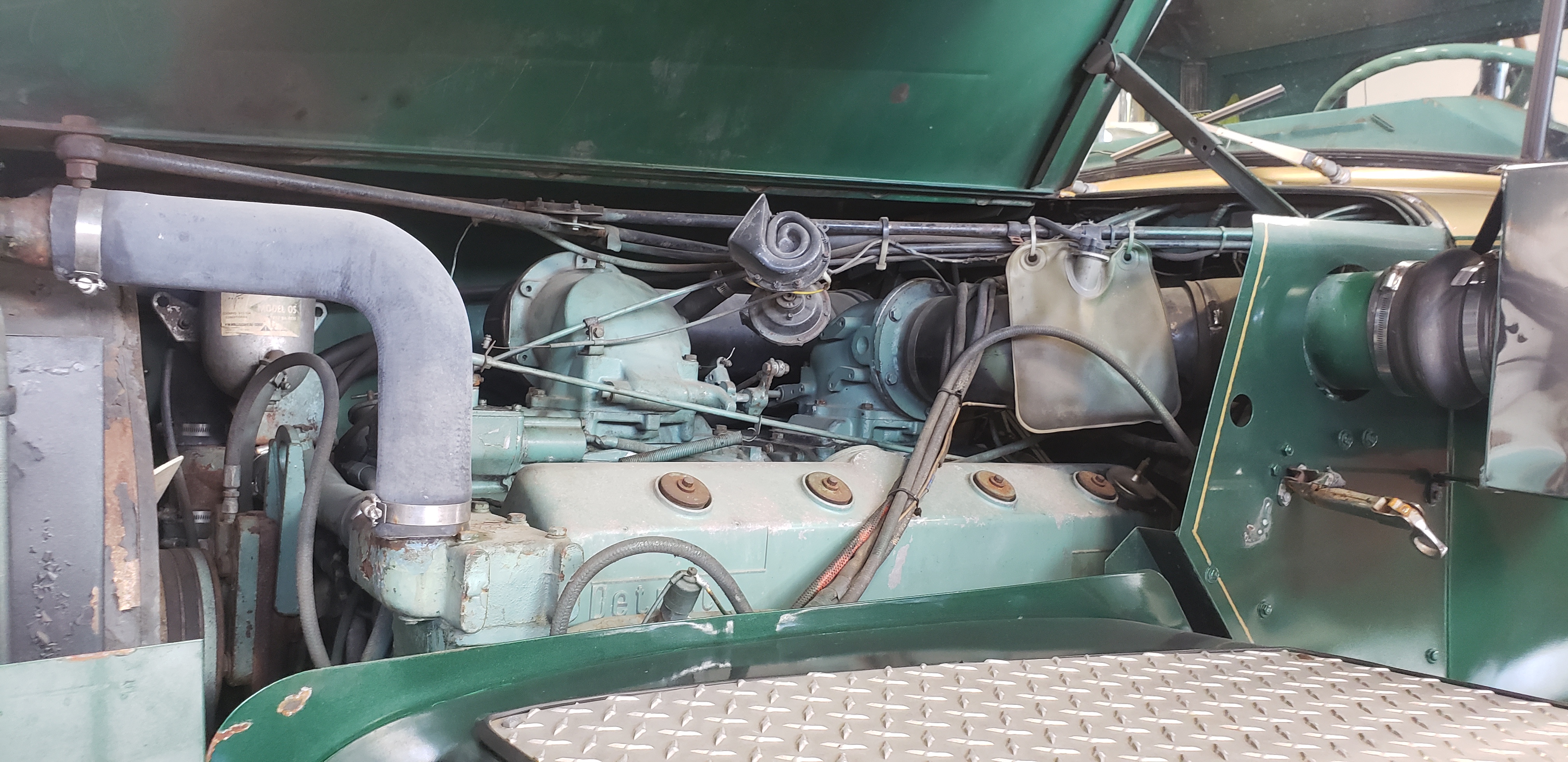

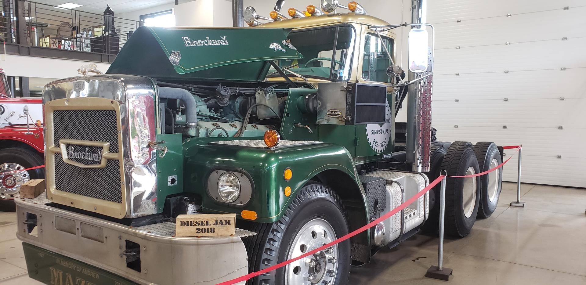

Ok I'll follow up on what jim mentioned.  The 361 was offered w the 12v 71, and theres one currently in the museum on display.   Heres a photo of that truck I took during our car show this year.
20180915_135616.thumb.jpg.0c65b8e3832f683b196059cdc958a38c.jpg20180915_135602.thumb.jpg.ae2e273ab1f32ef095349372665e23d6.jpg

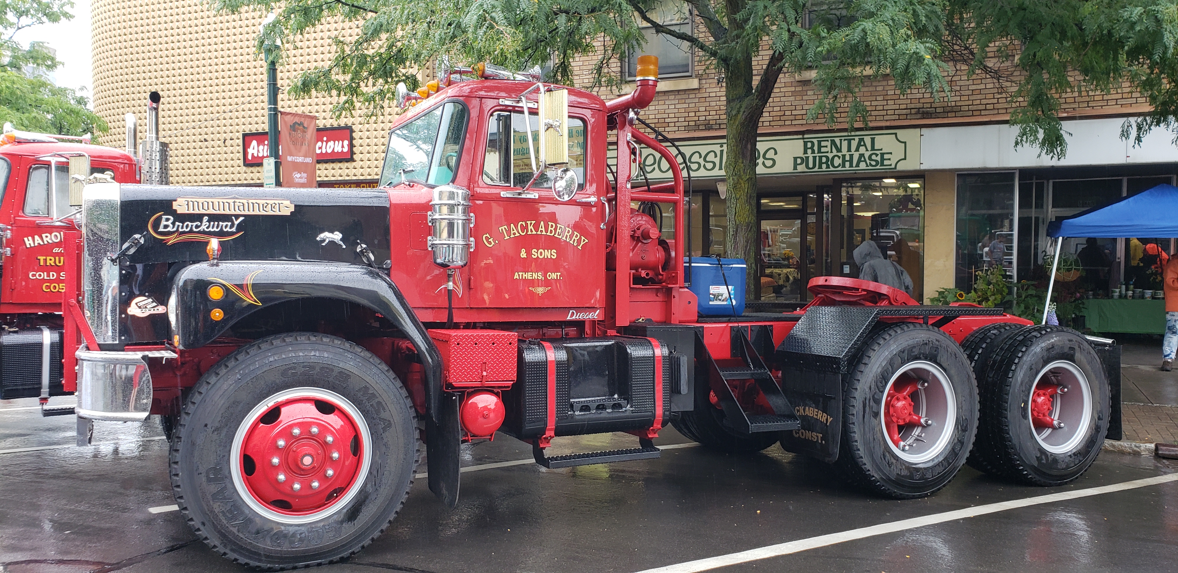

Theres a great example of a 361 winch truck on aitm website showing what the cab can be turned into. It's a stunning replica of the Mountaineer owned by Tackaberry construction/hauling  in Canada .This is the Mountaineer..
The photo also shows how the hoods opened, their a butterfly hood. The fenders are held closed ..they swing out..by a bolt in the back, and a pin in the front by the radiator grill. This allows easy access to the engine . To open the resin hood only requires careful cutting then adding support inside for it to rest on..
