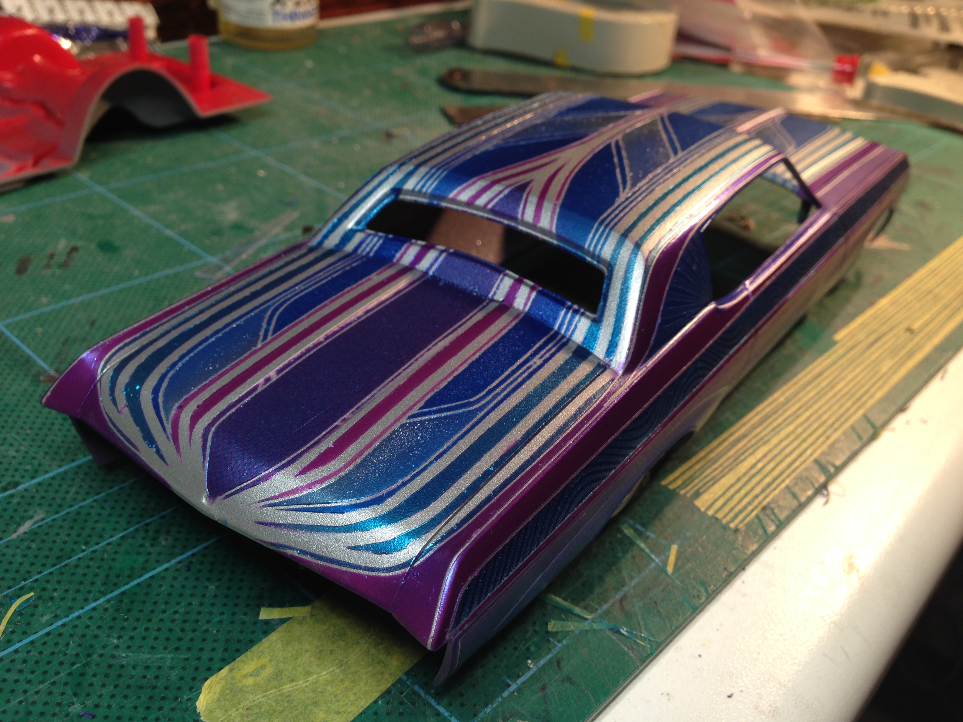

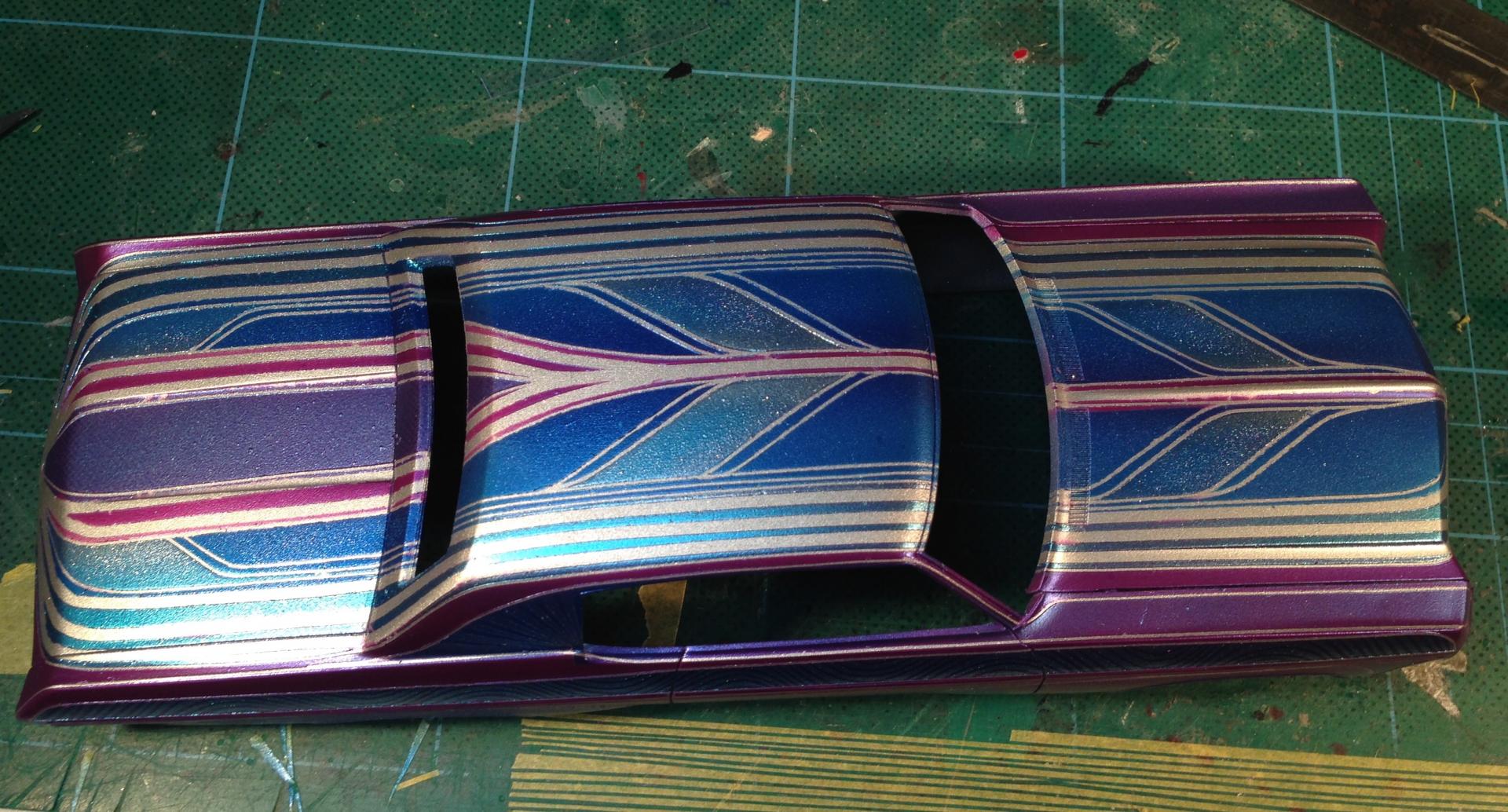

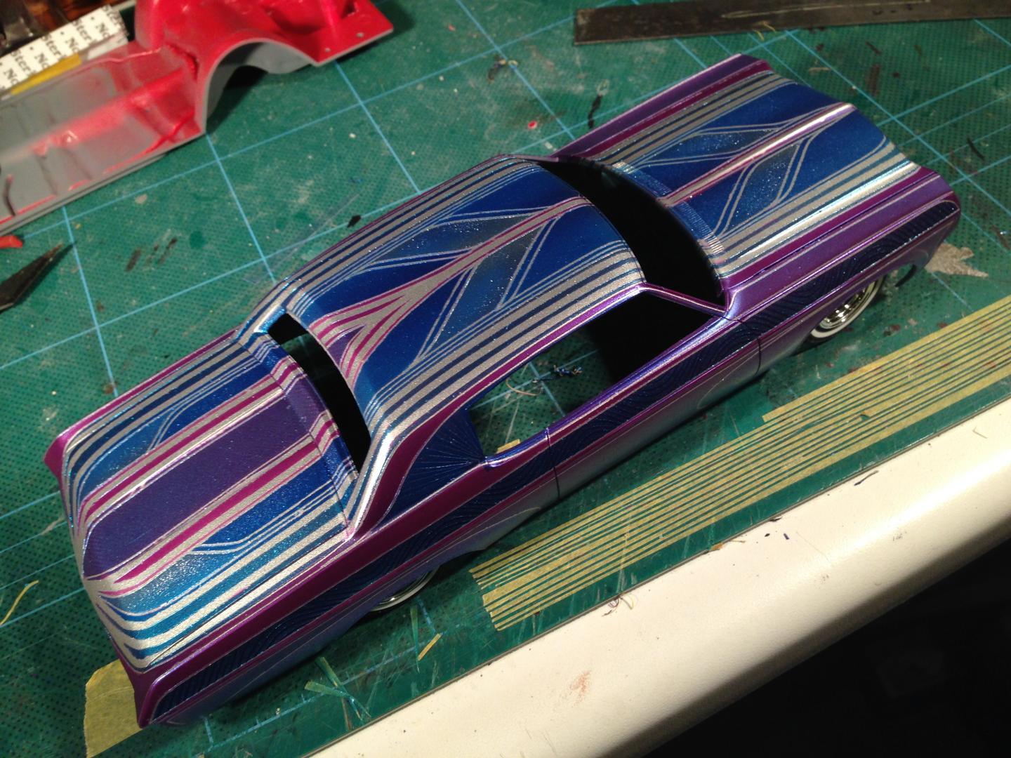

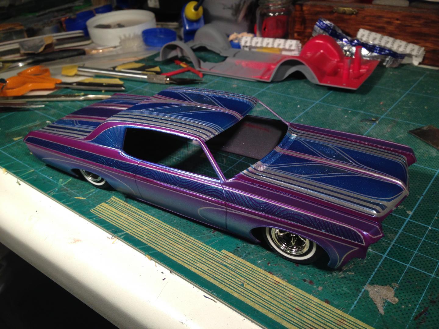

Finished applying the colours and peeled off the tape, today.
Gonna let it all dry and harden properly, before it gets a light wet sanding and a clearcoat.
 I think I'm going to do another wild paint job on my next one. I really like the experiments in colour etc.

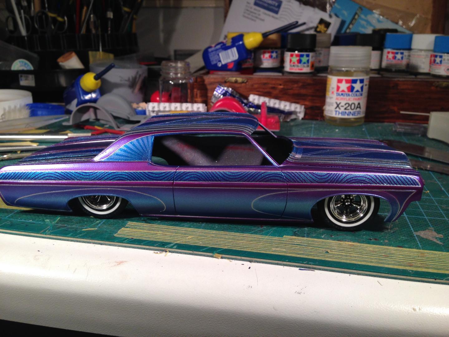

Thanks everybody! I'm glad you approve.
I have two 59 Impalas and a 62 Catalina in my stash, awaiting similar treatment. I'm itching to get started on the next (or maybe a wild paint job on a slammed BMW Isetta? Yes, really. It's next)
This paint session taught me a lot and there's still more techniques to try. This was my first attempt with nail polish. I'm very pleased with how it flows in the airbrush.
I mixed it about 1.5 thinner to 1 colour. Coarser metallic colours need about 2:1 or the needle clogs up. I sprayed at about 12 psi.
if you haven't tried airbrushing nail polish, I urge you to have a go!
It's SO much better than rattle can paint. It goes on thin, dries fast, and you can get some amazing pearls and flakes. I got two bottles for £3 at the local pharmacy. 👍

The question everyone has......how did you prevent the tape from lifting the paint?
Share this post
Link to post
It did break up a tiny bit with the candy paint. But that's probably because I decanted it from a rattle can and it goes on a bit thicker than nail polish. I left it a bit too long before I removed the tape.
But the nail polish is a thinner layer, so dries very quickly and the tape can be removed easily after a few minutes, leaving a clean line. Also, the angle which you pull the tape, makes a difference. I pulled it flat along the line, rather than up and away from the surface.

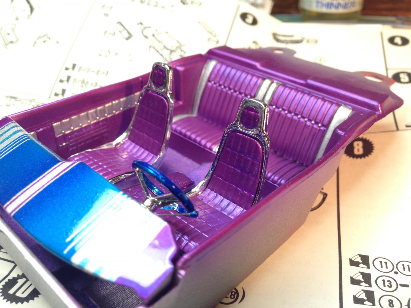

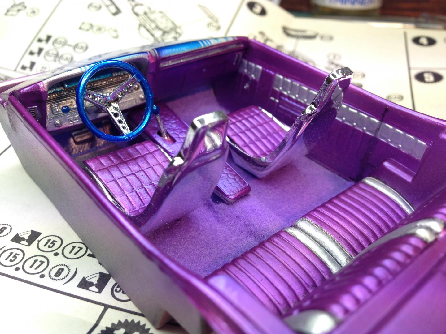

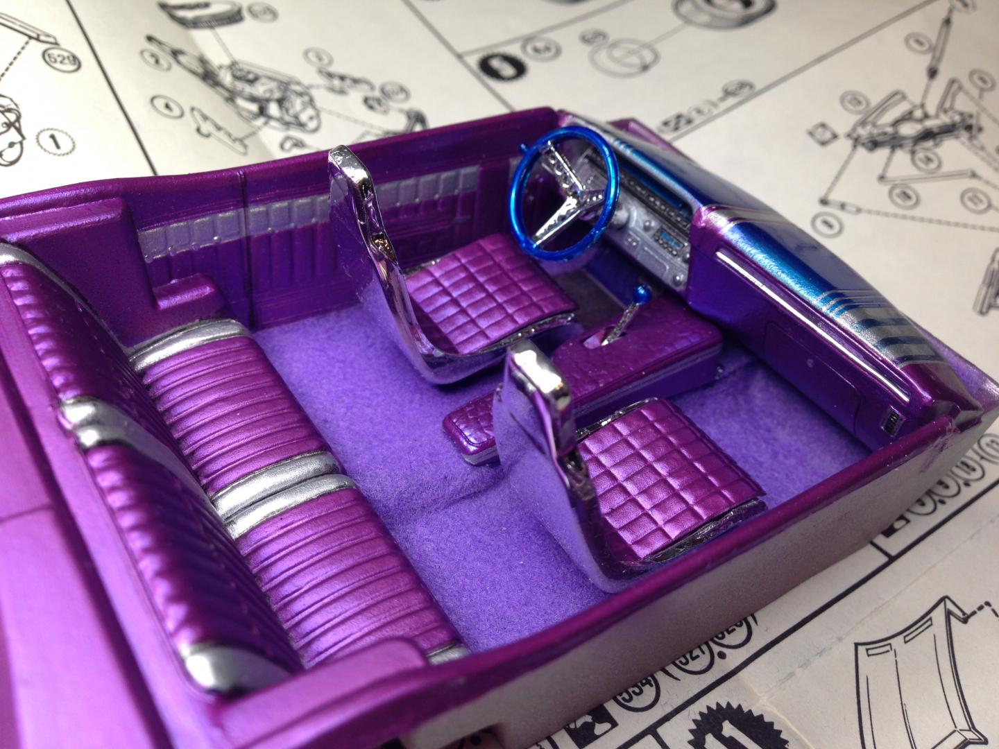

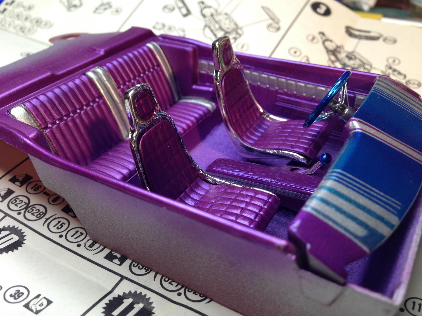

Thanks again for the interest in this build, guys!
Found some nice custom seats from the extra parts in the 65 Pontiac GP kit, along with a centre console.
Flocked the carpet and replaced the kit wheel with one from the parts box. Added a turn signal stalk and chromed the column with a molotow pen
