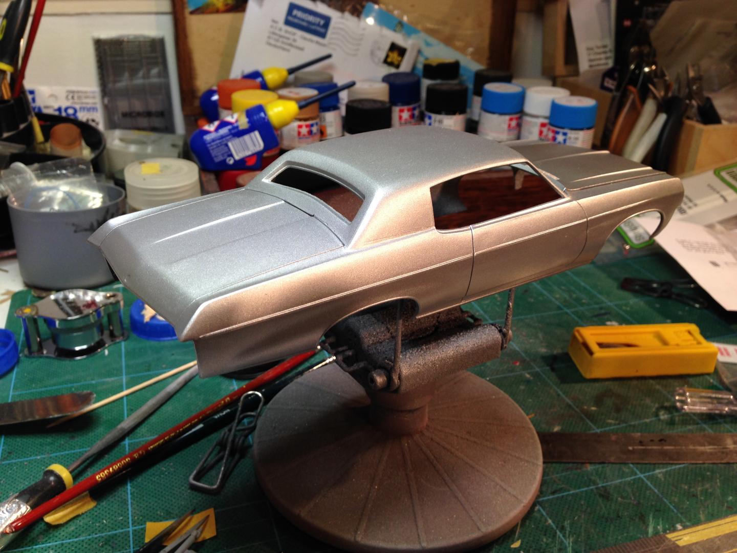

 I removed all the scripts and door handles. The mould seams n the body were feint but there were a few sink marks to deal with.
I used the custom rear window and filled the gaps
After a fruitless search for Pegasus wheels online, I opted for some nice rims from the AMT 60 Starliner kit, shod with narrow whites from the sorely missed Modelhaus..

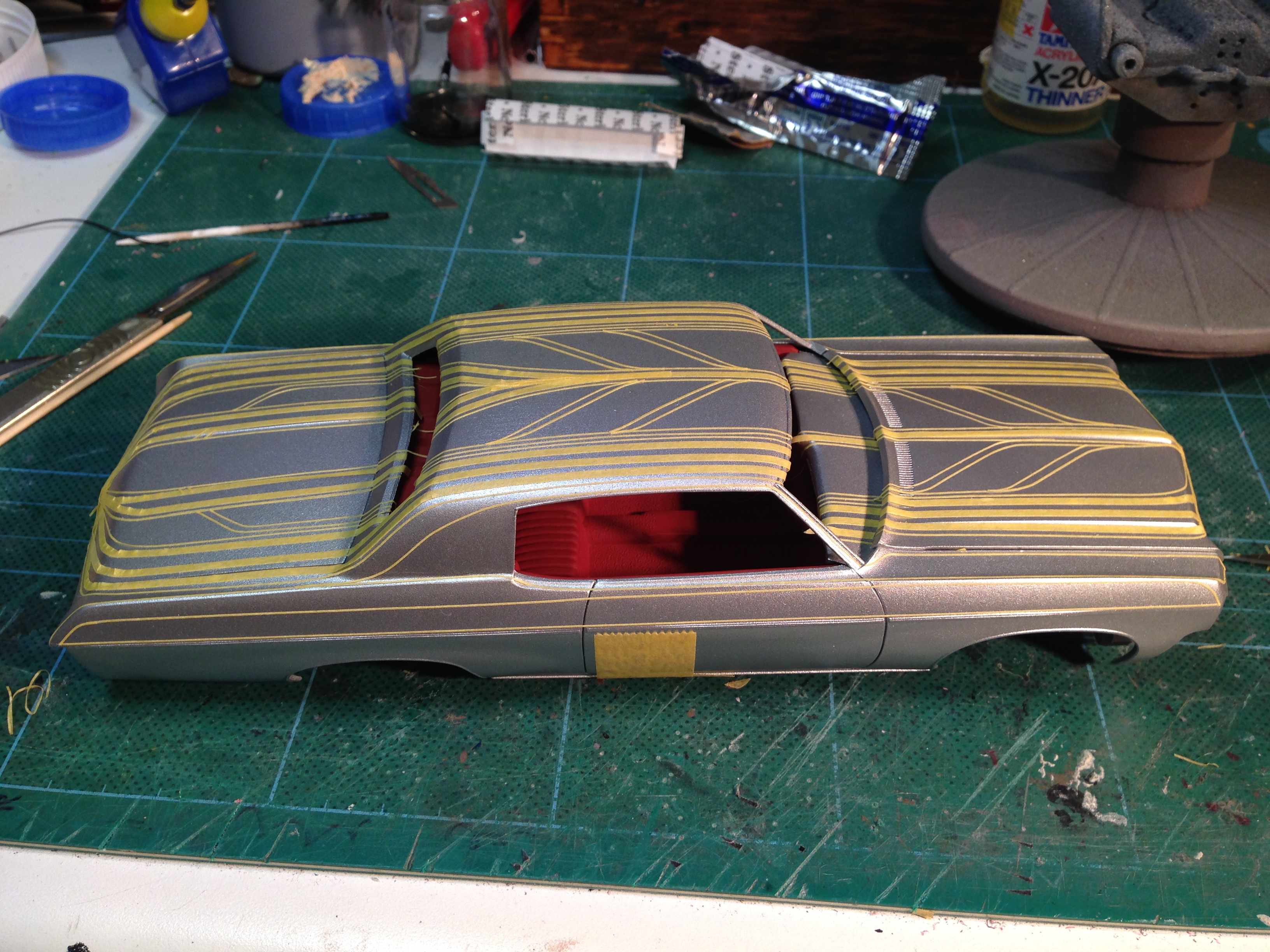

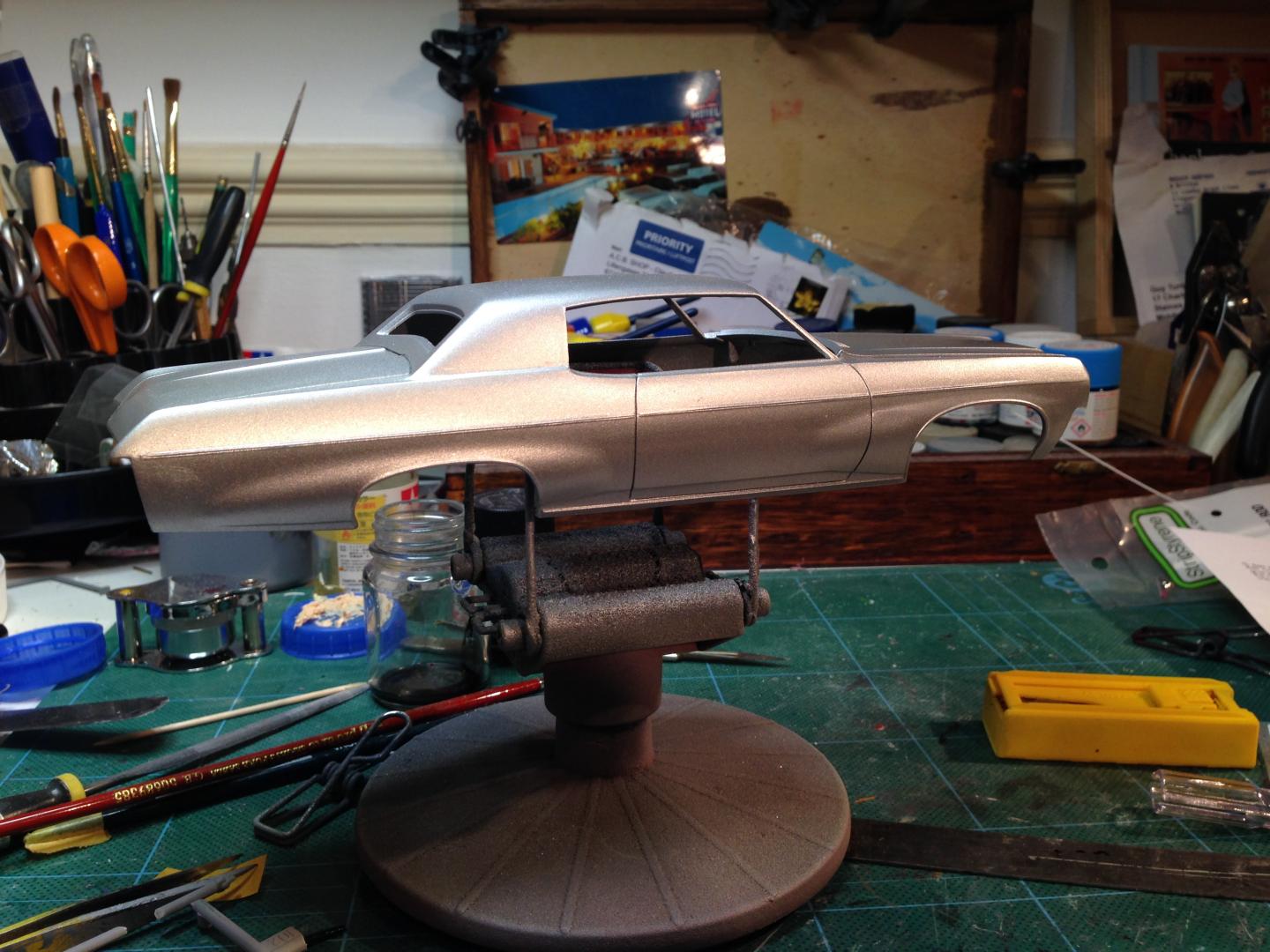

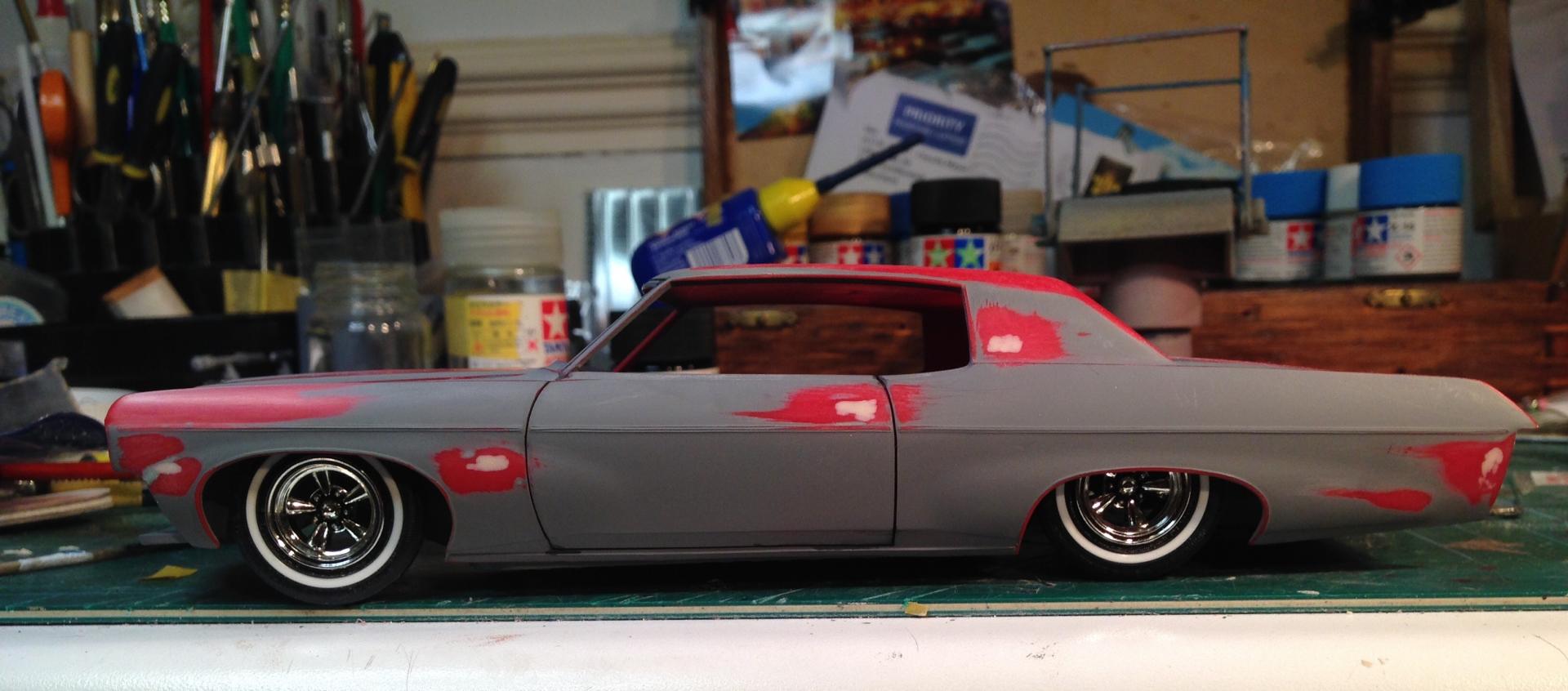

I've now given it a silver base coat, which will outline the patterns.
 I have some decals I want to try and involve in the design, too.

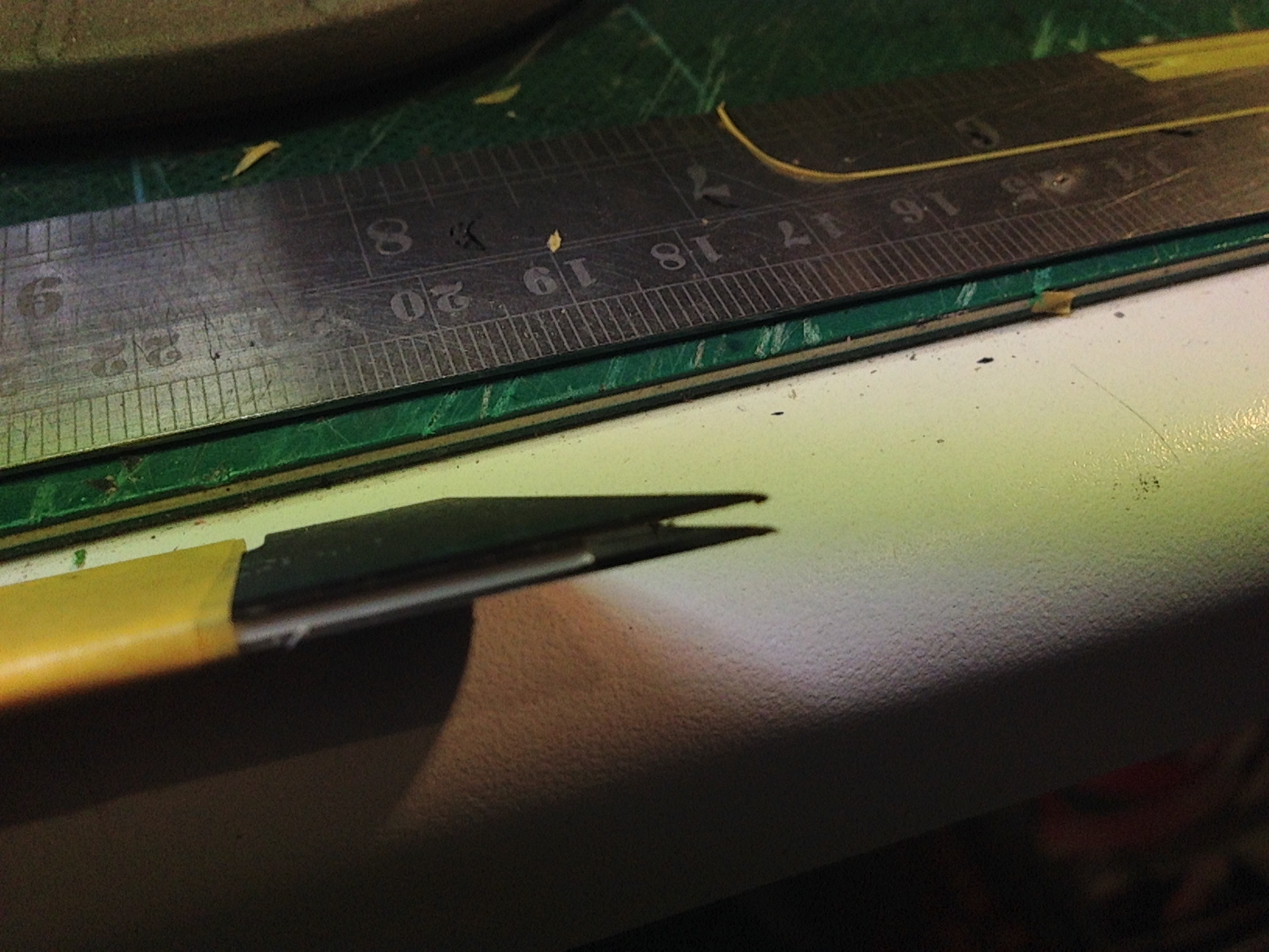

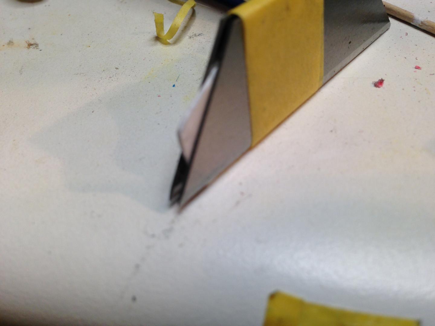

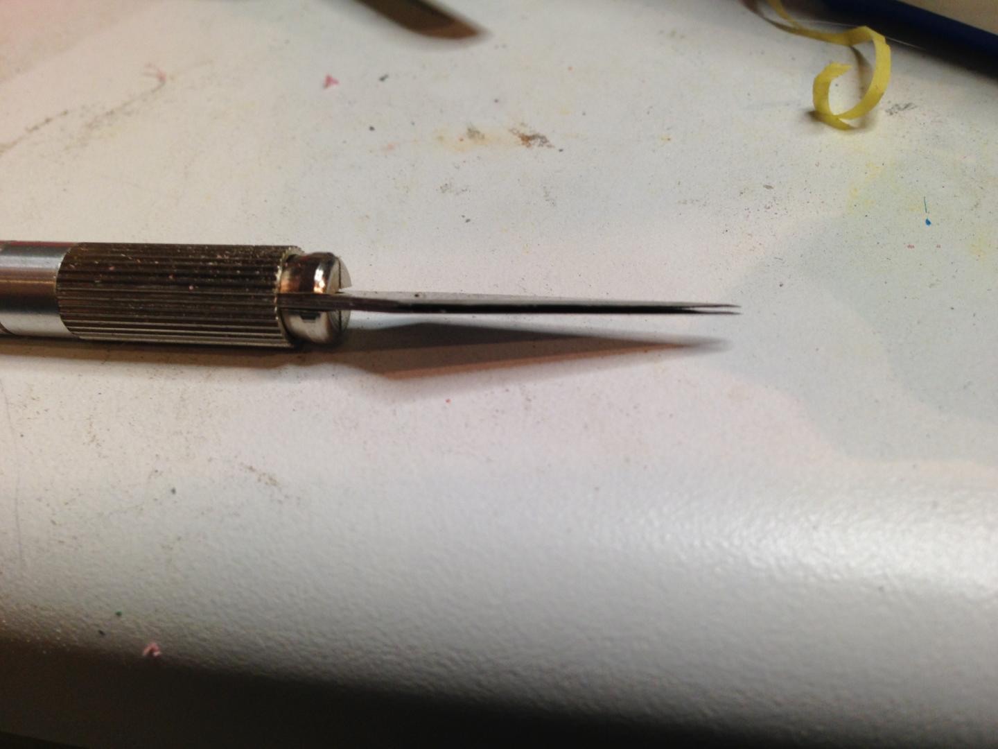

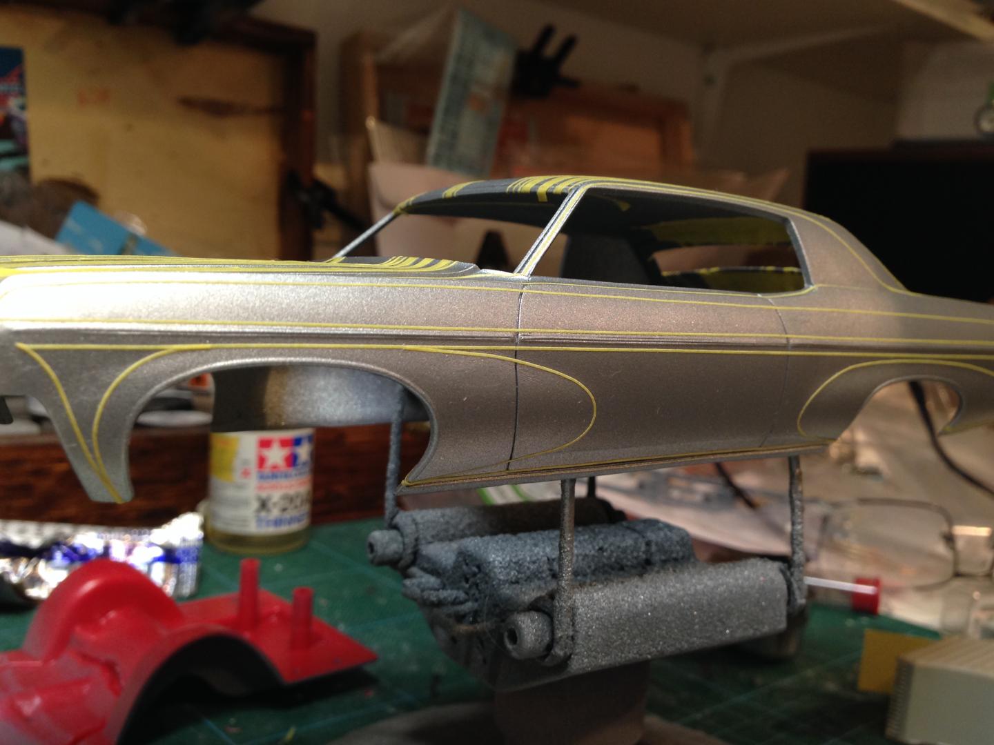

I made two line tape knives.
I cut the chuck with a disc in my Dremel, so two blades fit side by side
Also sandwiched a piece of 1mm card between two Stanley blades, for slightly wider lines.

Cool, think I'm going to have to copy your blades idea too, i've been using a ruler and blade but your way looks much better

I like where you're going with this project. Step-by-step on those tape cutters will help a bunch of us!!
Bucky took the words right out of my mouth. Cool project and I also like that blade tip. Looking forward to seeing it finished!

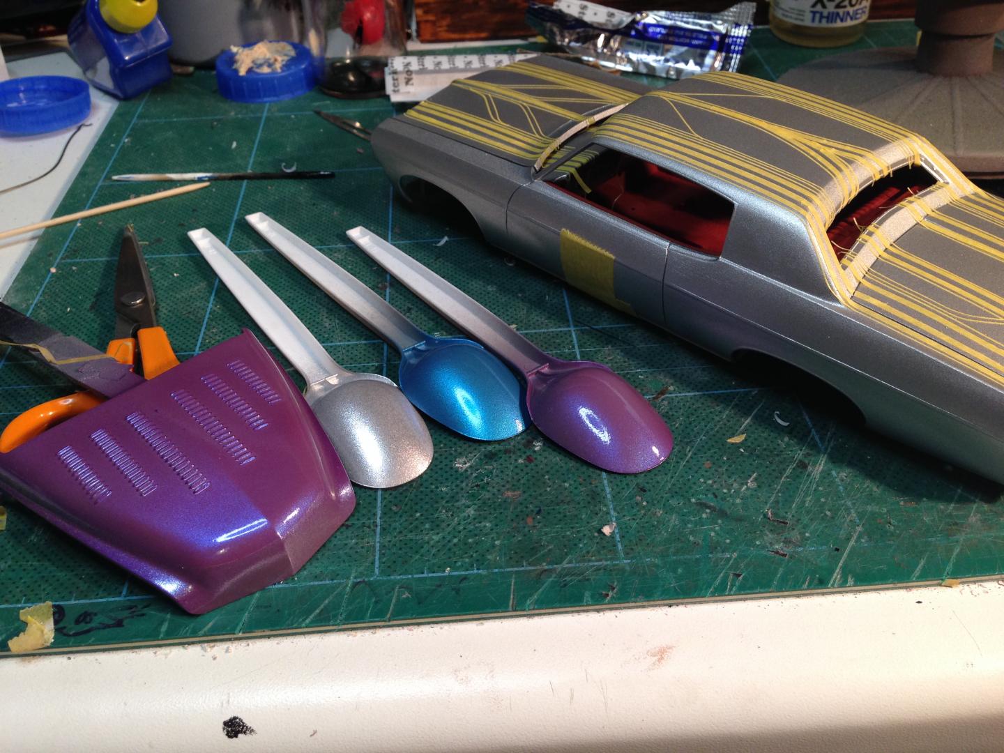

I thought I'd try out nail polish on this build. Never used it before, but it's proving to be very nice to work with.
and it's cheap.
Plus, the metallic particles are a much better scale than automotive paint. I just thinned it 2 parts thinner, 1 part colour. It's touch dry within a few minutes and goes on really smooth 👍

Very impressive design. Reminds me of some of the designs you see in the Low Rider Magazines. With the colors you have on the spoons this should be really exceptional looking.

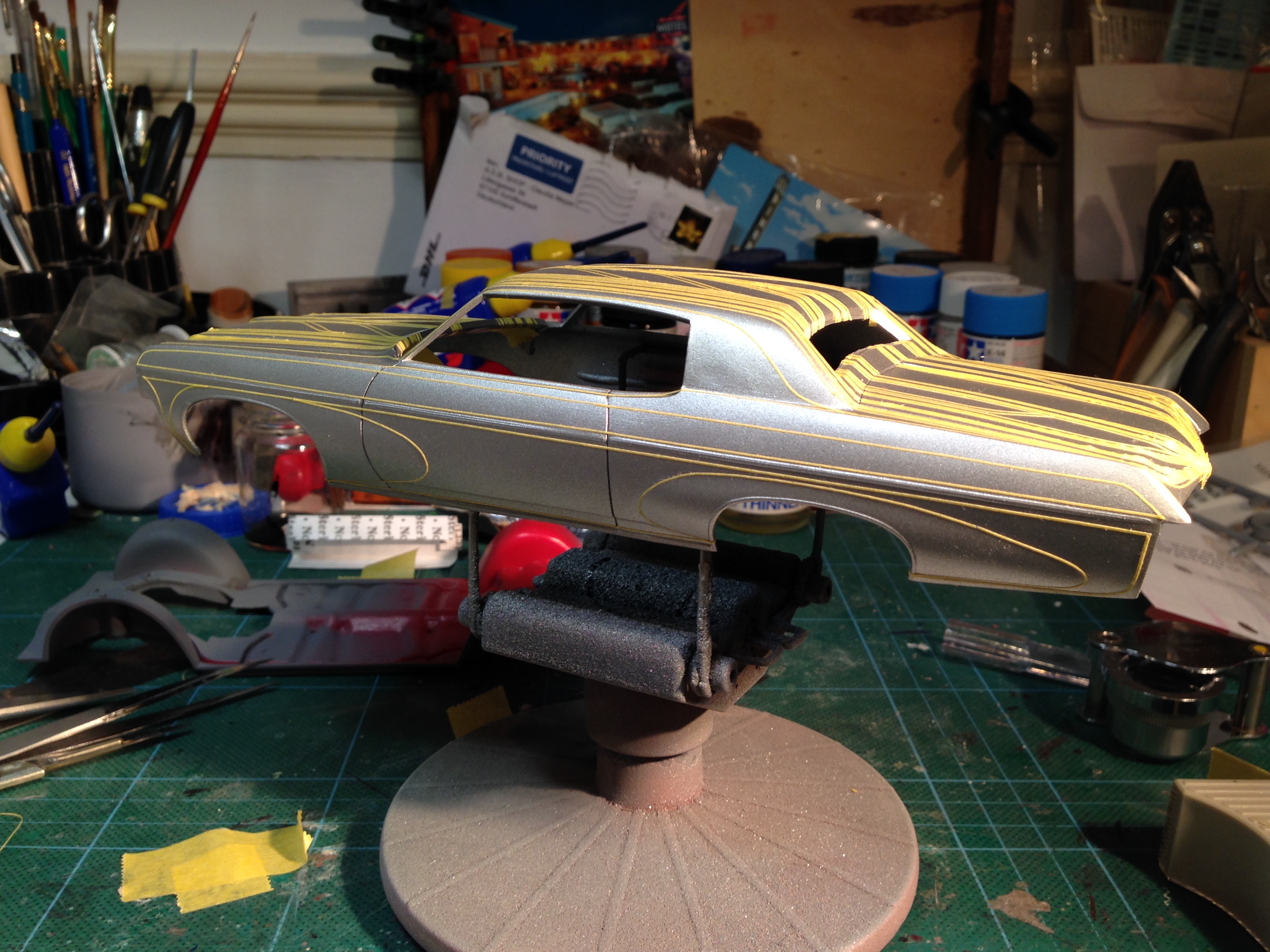

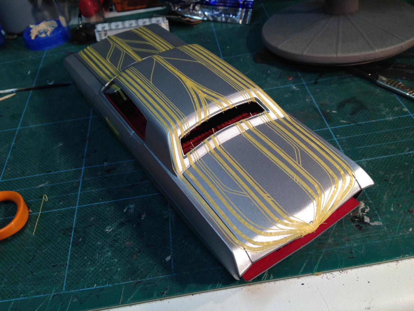

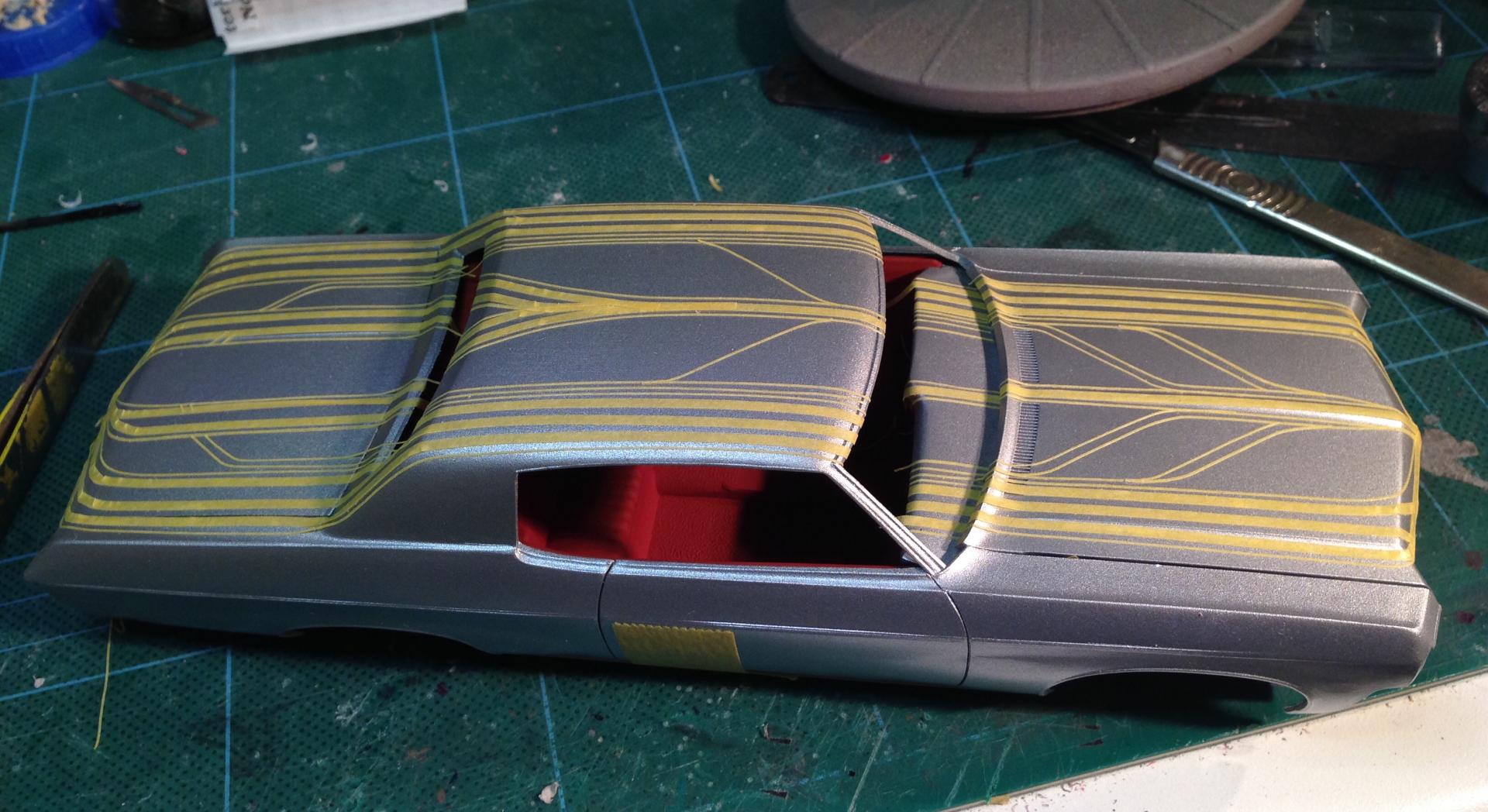

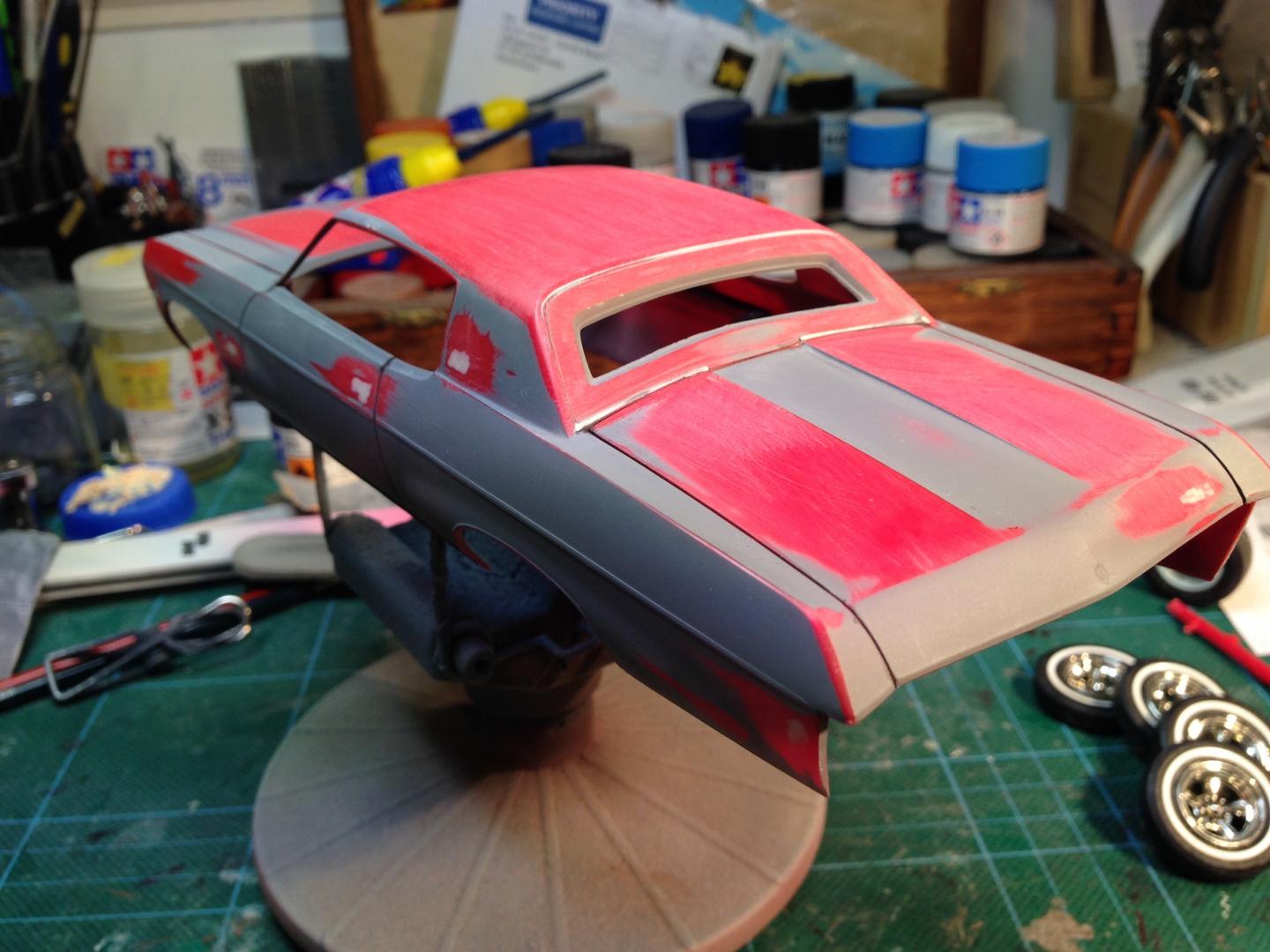

Got a bit more done. Finished the roof and started the sides.
 I'm freestyling the design. Sometimes I go back and change it a bit. I'll add colour soon, then lay down more tape to make lines in different colours.

I'm enjoying watching this one come together,  paint design looks outstanding !
Can I ask what type of tape you use ?  And once sprayed, do you remove the tape straight away ?

Dual blades. What a great idea for the tape lines. I'm totally going to borrow that idea in the near future!
Tamiya tape. It's the best I've found. I tried their flexible tape, but it kinks on tight radius curves.
 The tape so far, is for the silver lines and will mostly stay put until the end. I've got to finish the silver lines, hit it with another colour and mask again. I'm hoping the nail polish will go down thinner than auto paint and avoid the stepping of layers.
thanks for the kind comments everyone
Looking forward to seeing your finished paint job. I've had good luck with flexible tape both on models and 1:1 cars by stretching the tape around tight curves.

Great work here.
I've used that techniche with the blades to trim BMF also.
