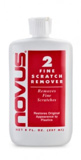

berr13 Posted November 8, 2018 Share Posted November 8, 2018 I've got a body that I painted with Tamiya lacquer and polished with Novus #2, but I now want to repaint it. I've read somewhere that soap and water will remove Novus polish, but can anyone confirm that? And if so, what kind of soap? Thanks, Jim Quote Link to comment Share on other sites More sharing options...
BigTallDad Posted November 8, 2018 Share Posted November 8, 2018 You might want to try garden-variety Windex. Unlike automotive polishes/waxes, Novus #2 is a polish, but not a protectant. Quote Link to comment Share on other sites More sharing options...
StevenGuthmiller Posted November 8, 2018 Share Posted November 8, 2018 If you are going to repaint it, aren't you going to strip the old paint? Steve Quote Link to comment Share on other sites More sharing options...
berr13 Posted November 9, 2018 Author Share Posted November 9, 2018 2 hours ago, StevenGuthmiller said: If you are going to repaint it, aren't you going to strip the old paint? Steve I wasn't going to strip it if I could avoid it. The current paint is smooth (except for one deal-breaking blemish) and thin, with plenty of trim detail present. If there's no efficient way to remove the polish, then yeah, I guess I'll strip the current paint job. Prefer to get around it if I can, though. Quote Link to comment Share on other sites More sharing options...
Can-Con Posted November 9, 2018 Share Posted November 9, 2018 If this is the product you mean,, Then it shouldn't be a problem removing it because there shouldn't be anything to remove. "Polishs" work by using super fine abrasive to remove texture in the paint, making it shinier. There shouldn't be anything in that to stop the paint from sticking properly unless you waxed it also. "POLISH" is NOT a coating like wax is and after it's wiped off there shouldn't be anything on the surface but paint. BUT, all you need to do is go over the body with some fine sandpaper, 800 or 1000 grit, to give the new paint some extra "bite" just to make sure . Personally, I'd strip it first too though. Quote Link to comment Share on other sites More sharing options...

SteveG Posted November 9, 2018 Share Posted November 9, 2018 (edited) Unfortunate Novus #2 contains silicone or similar type materials that will create "fisheyes" if there's even a microscopic spec of residue remaining on the surface. If you sand it before thoroughly cleaning it you'll embed that residue and game over. I one tried to use Novus #2 to clean off BMF residue before clear coating a body. It looked perfectly clean but I soon as started apply the clear it was a disaster. I tossed the Novus #2 out and now I only use true Automotive grade polishes that specifically say they are safe for paint and can be painted over right on the label. I strongly suggest you thoroughly wash the body several times with a grease removing detergent like Dawn before doing anything else. -Steve Edited November 9, 2018 by SteveG Quote Link to comment Share on other sites More sharing options...
Don Wheeler Posted November 10, 2018 Share Posted November 10, 2018 According to the safety data sheet on the Novus site, it contains 4 to 8% Polydimethyl Siloxane. According to Wikipedia, this is a silicone. I left a message on the Novus site asking for some feedback. If I learn anything I'll post it here. Don Quote Link to comment Share on other sites More sharing options...

935k3 Posted November 10, 2018 Share Posted November 10, 2018 I have learned the hard way that Novus has silicone. AS others said a good scrub in soap and water will remove it. Ammonia will work to. I would not use Windex it has some alcohol that will affect lacquers. Quote Link to comment Share on other sites More sharing options...

Don Wheeler Posted November 12, 2018 Share Posted November 12, 2018 I got a reply from Novus. Here's what he wrote: Hi Donald, Thank you for your inquiry from our website. Yes, NOVUS #1 and #2 do contain some silicone. Most polishes on the market will contain some silicone because that will give the surface a shine. Please let me know if you have any questions. Thanks, Dean Trocke NOVUS Polish Sales Manager So, here was my response: Hi Dean, Thanks for responding. Novus is a great polish, but don't you think you should warn people about the silicone? I have heard of guys trying to do touch-ups on models after polishing and having a mess. That can be really frustrating after spending many hours building and painting. Is there good way to remove the silicone if touch-up is needed? Best regards, Don If he answers I will post it here. Don Quote Link to comment Share on other sites More sharing options...
Don Wheeler Posted November 12, 2018 Share Posted November 12, 2018 I heard back from Novus: Hi Don, Thanks for your email. We do have it listed on our SDS online but just about any polish you will find will have a silicone in it. We do have a silicone free polish of the #1 and a silicone and wax free polish of the #2 that is available on a special order. We keep a small inventory in the warehouse because every once in a while silicone can be an issue for auto detailers or customers trying to silk-screed on acrylics. Our chemist normally recommends Mr. Clean to remove the silicone off the surface. That will usually do a pretty good job and it is safe for plastics. Thanks, Dean Trocke NOVUS Polish Sales Manager So, I guess you can get Novus without silicone if you special order it. Quote Link to comment Share on other sites More sharing options...
