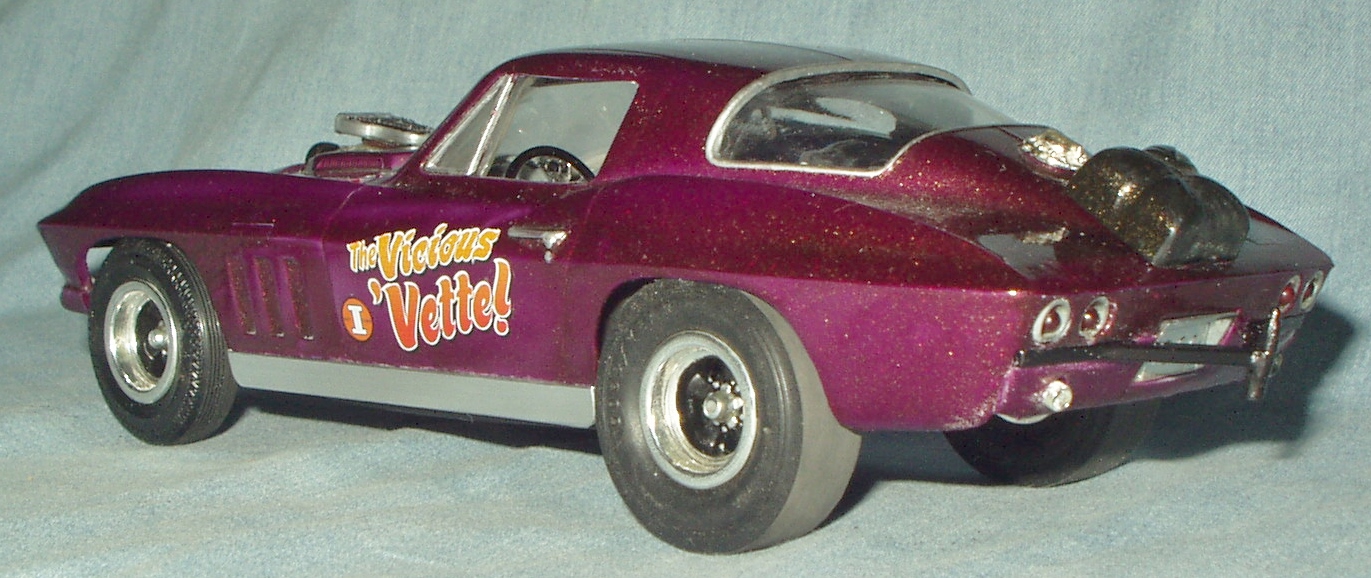

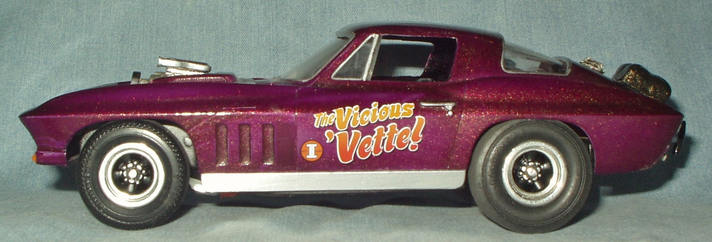

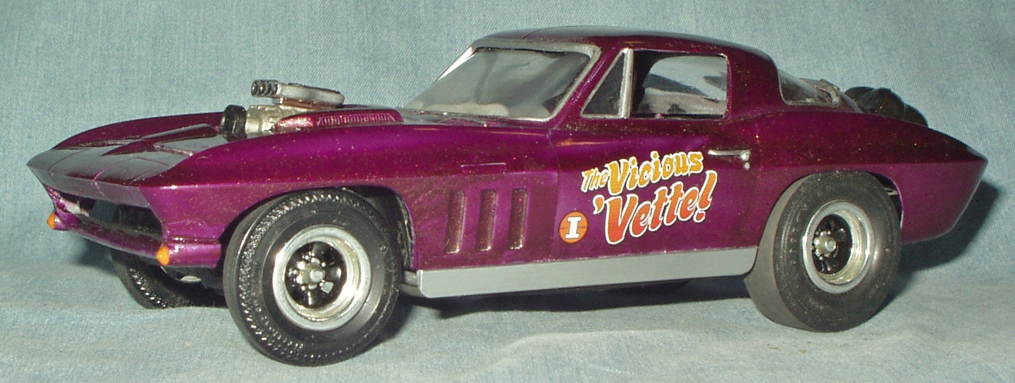

If it helps, here's a survivor MPC '66 Vette drag car I recently restored/rehabbed. The body is very, VERY close in size and shape to the AMT body. As you can see, I didn't radius the rear fenders (and neither did the original builder). So that's what it'll look like. You could always go with a slightly shorter slick, or raise the body on the frame slightly if you think the clearance is too tight.
