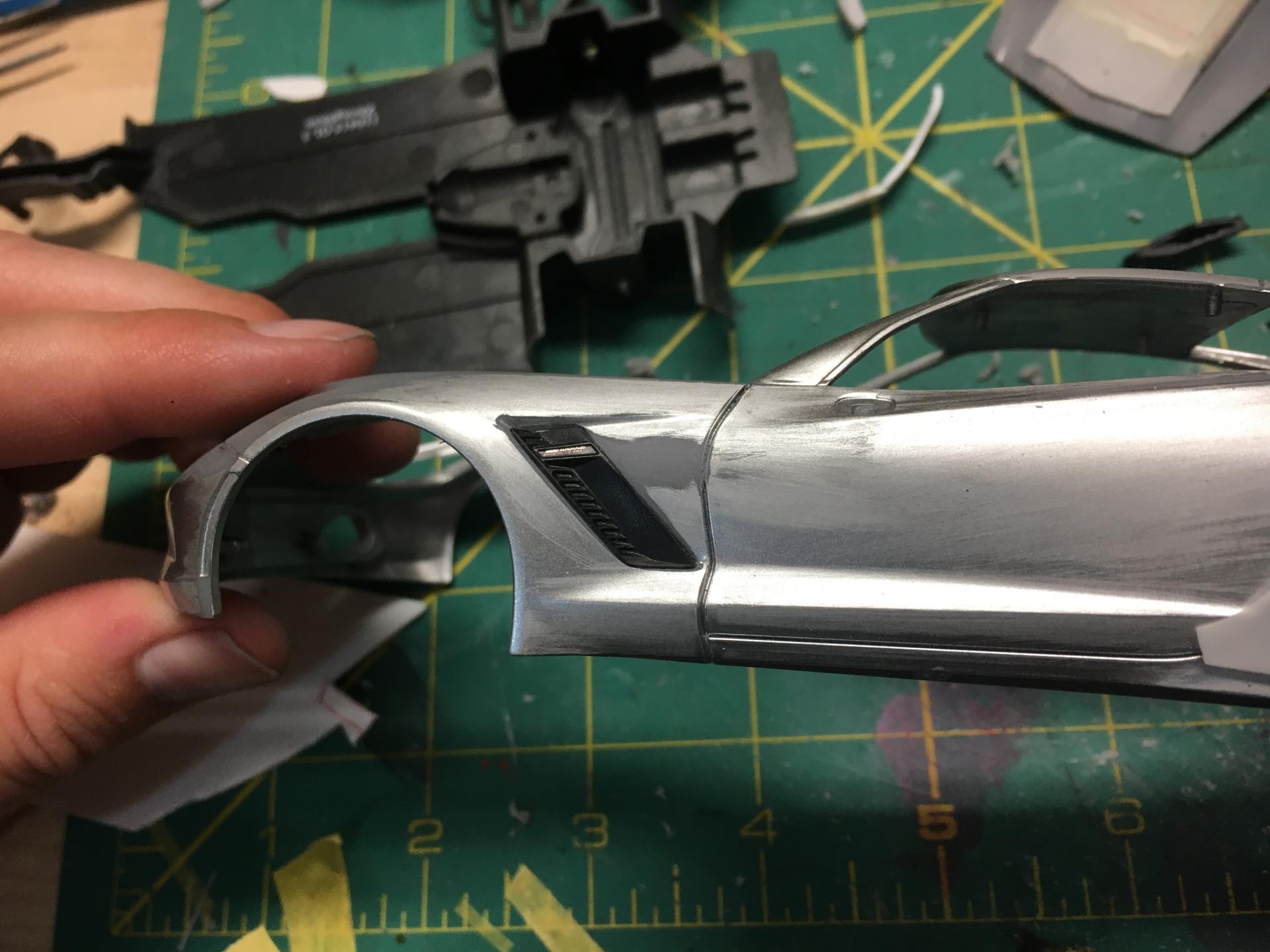

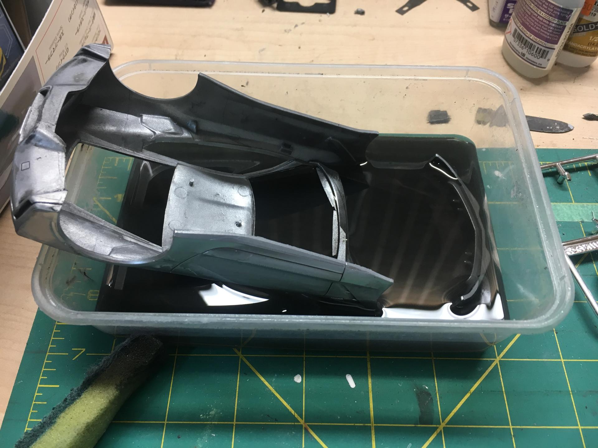

First up was stripping the paint, I thought the body was black & painted silver, turned out I was wrong, the black paint came off easy az, the Silver is actually painted but isnt budging so will paint over it.

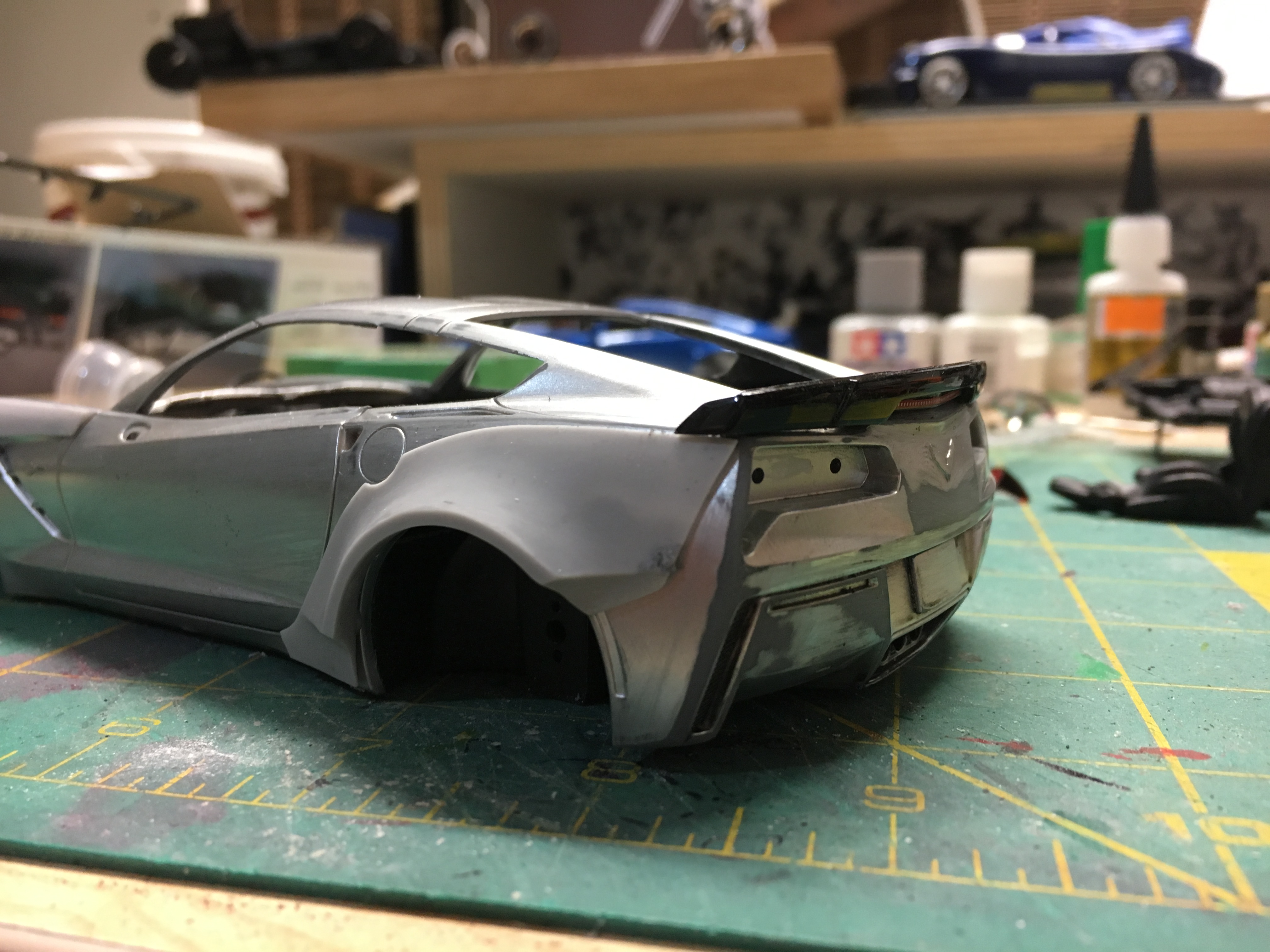

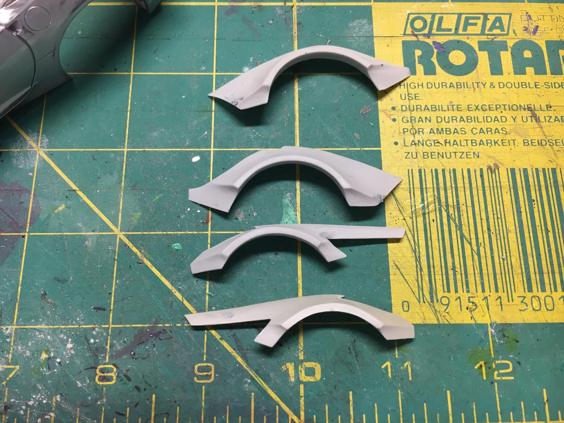

C1 Models Fender Flares - need a few bubbles popped & filled.

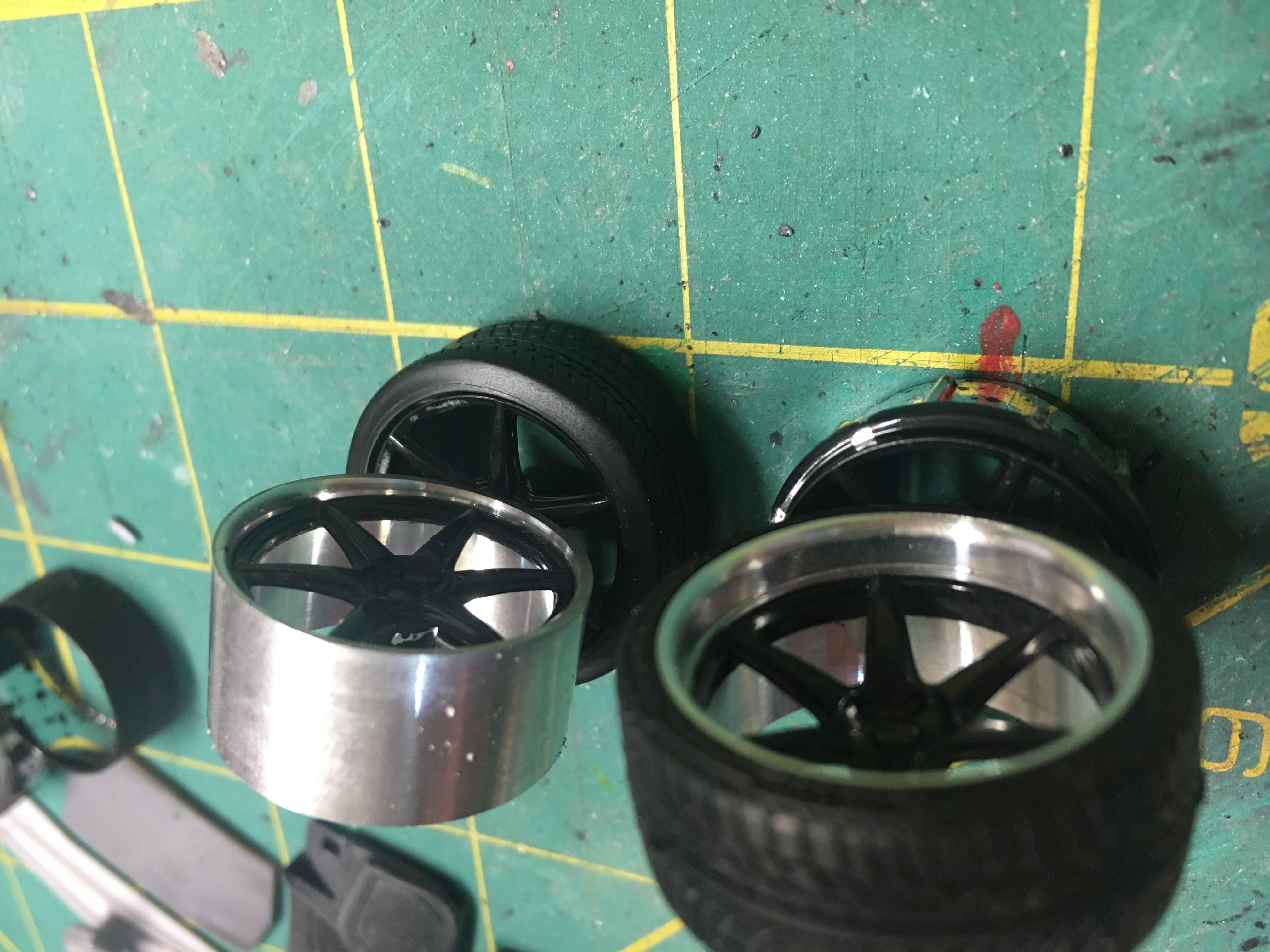

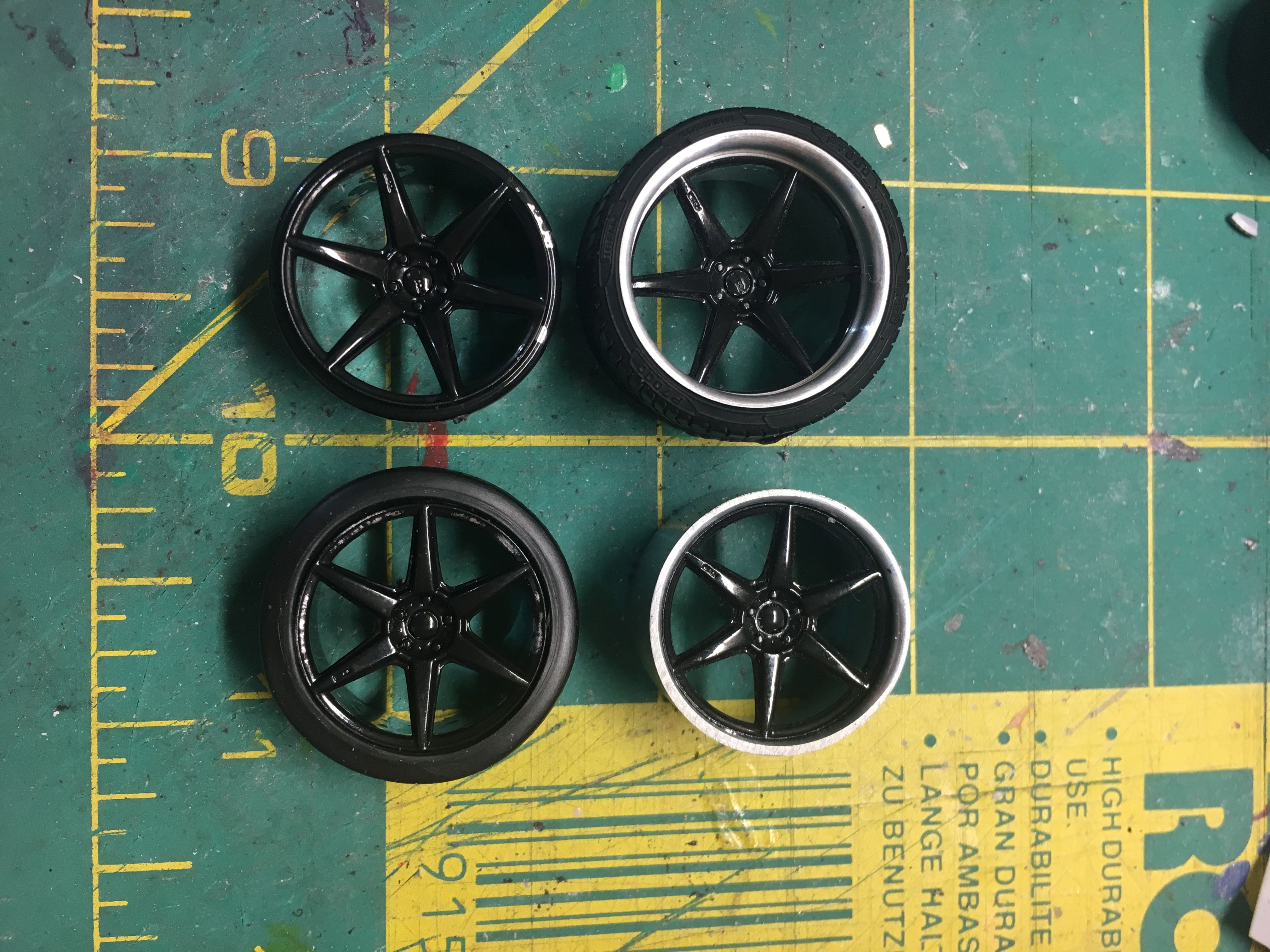

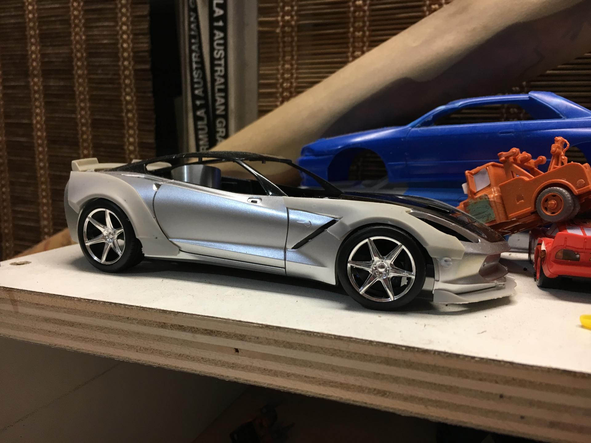

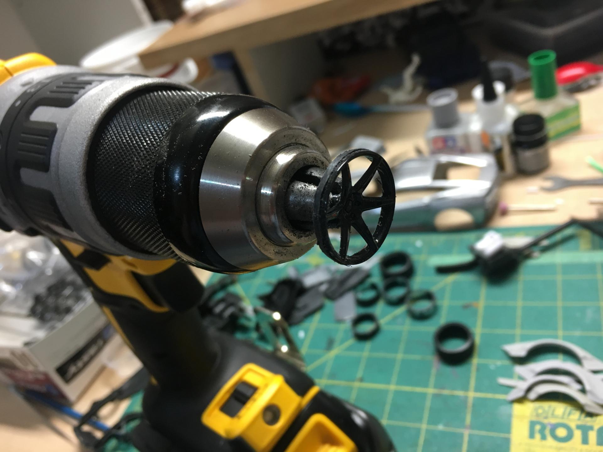

The Wheels - The Foose specific wheels are awesome, they look great on his GT40!!! But I wanted a bit of dish for the widebody kit. So I used Tuner Model 20" wheel rims.
Lots of sanding & cutting was required, & this is how I did most of it!

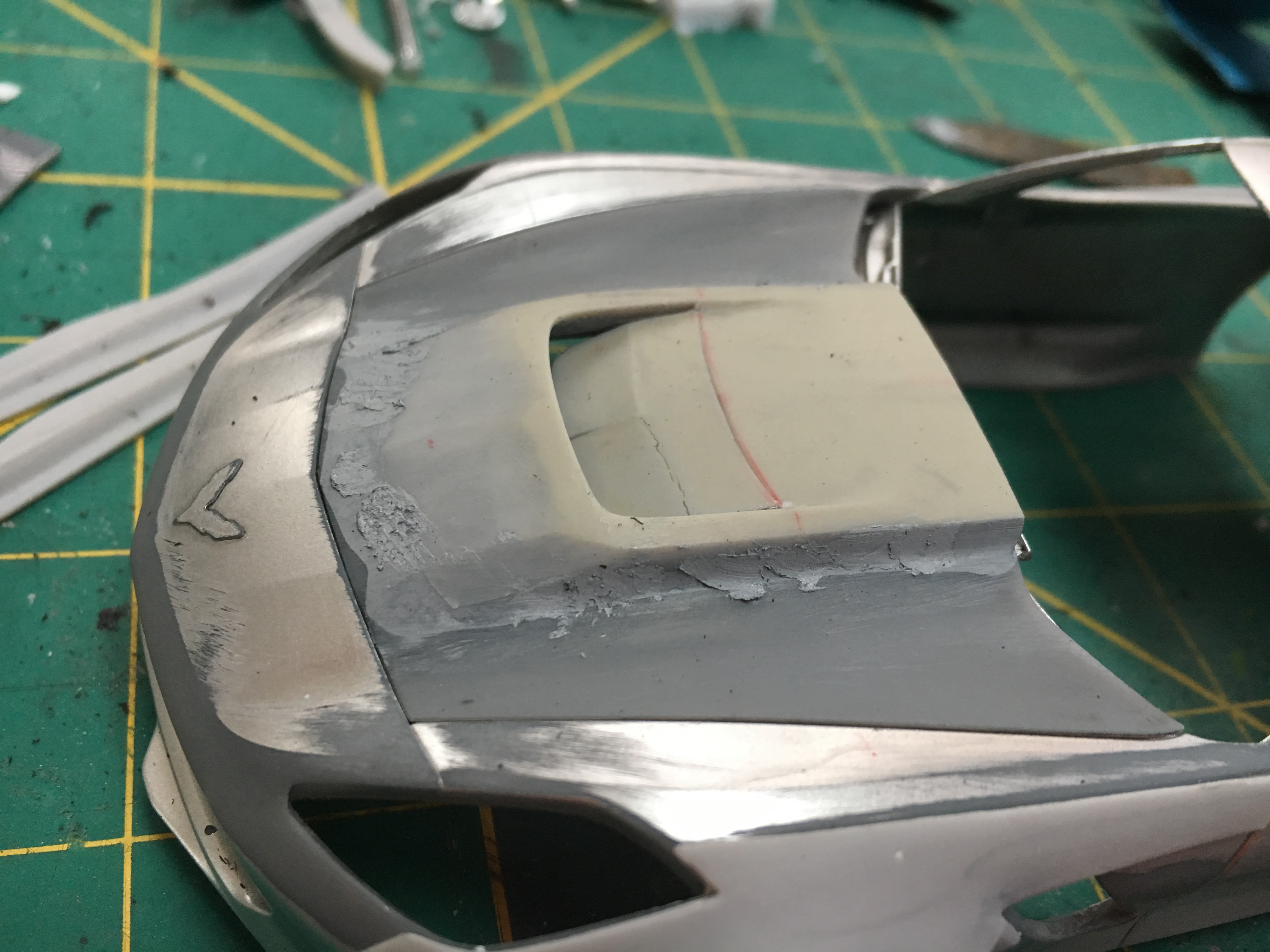

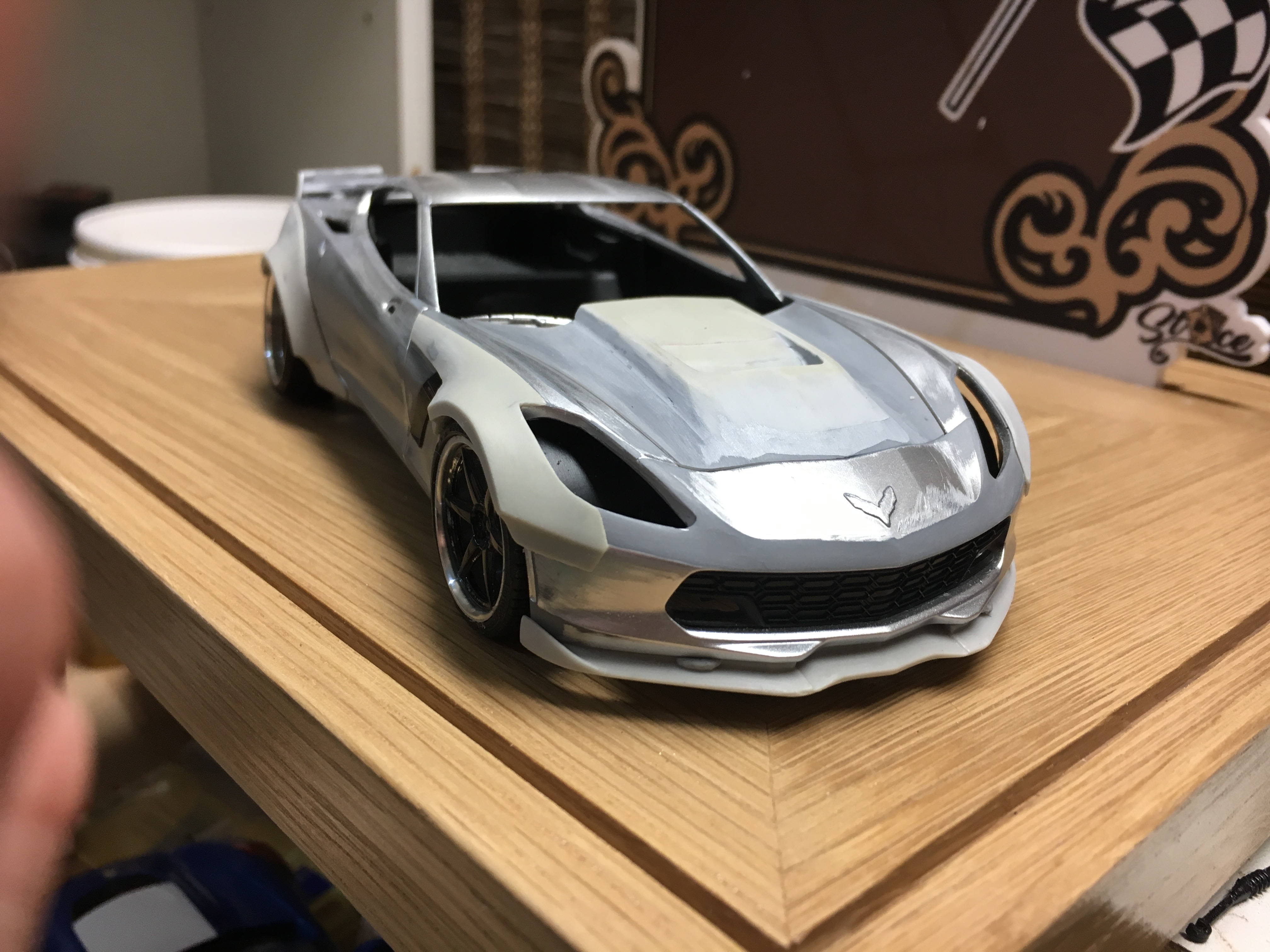

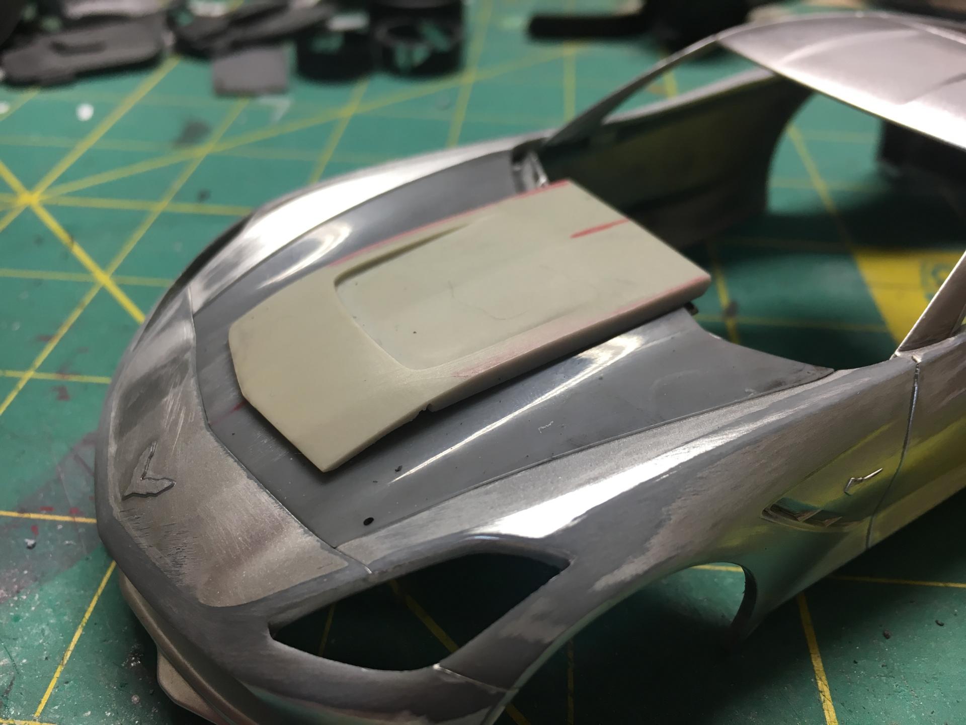

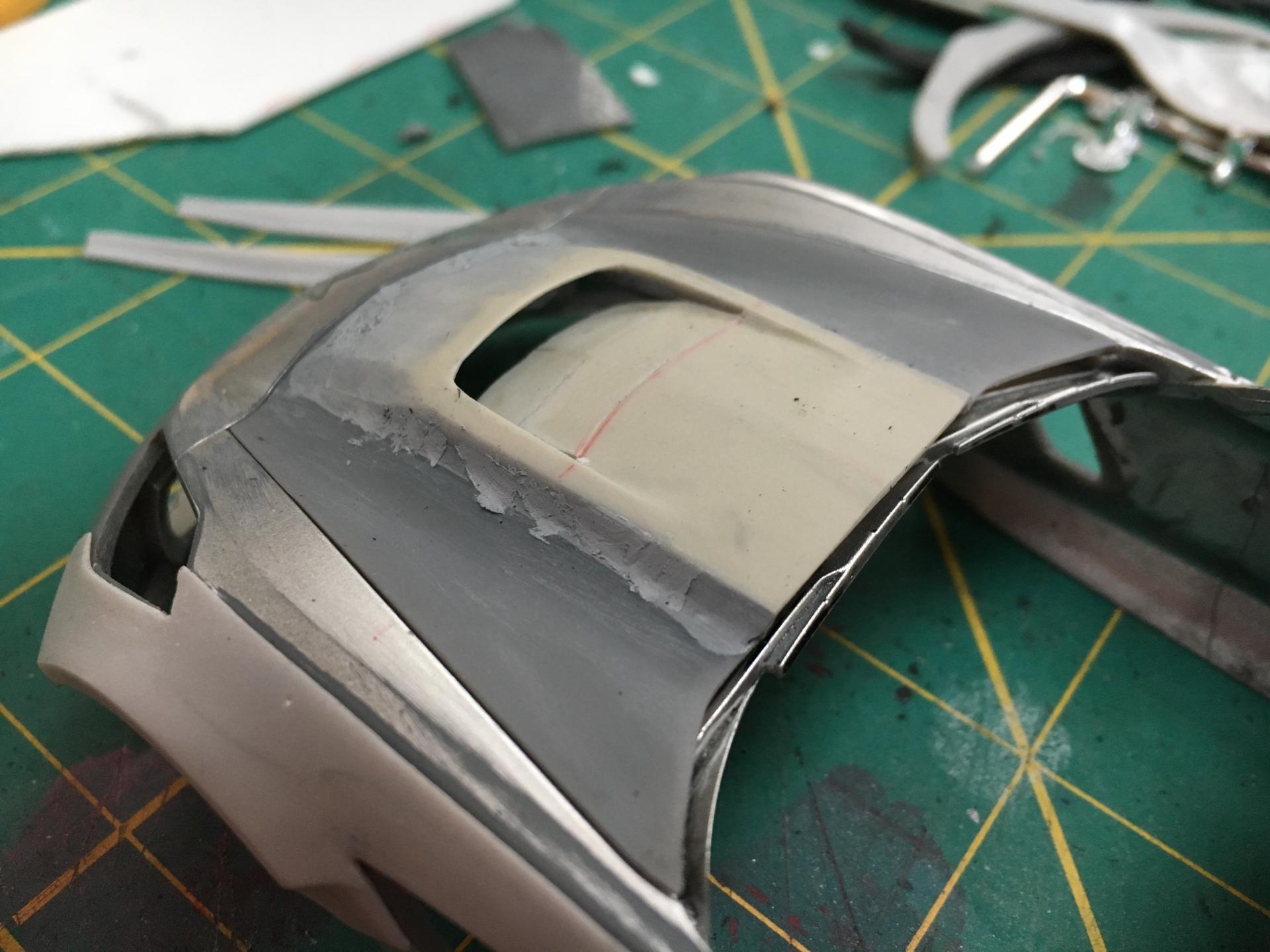

Wasnt a huge fan of the hood, needed to be higher so modified that too.

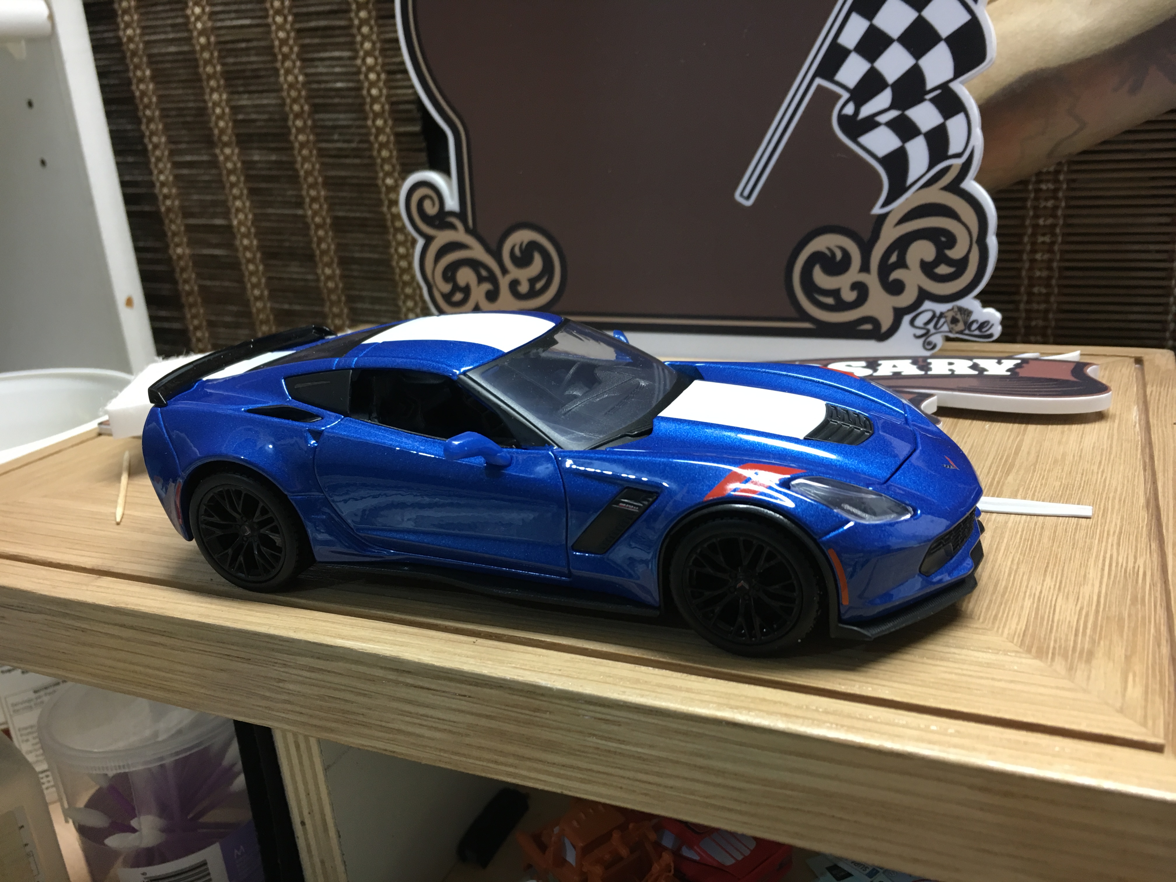

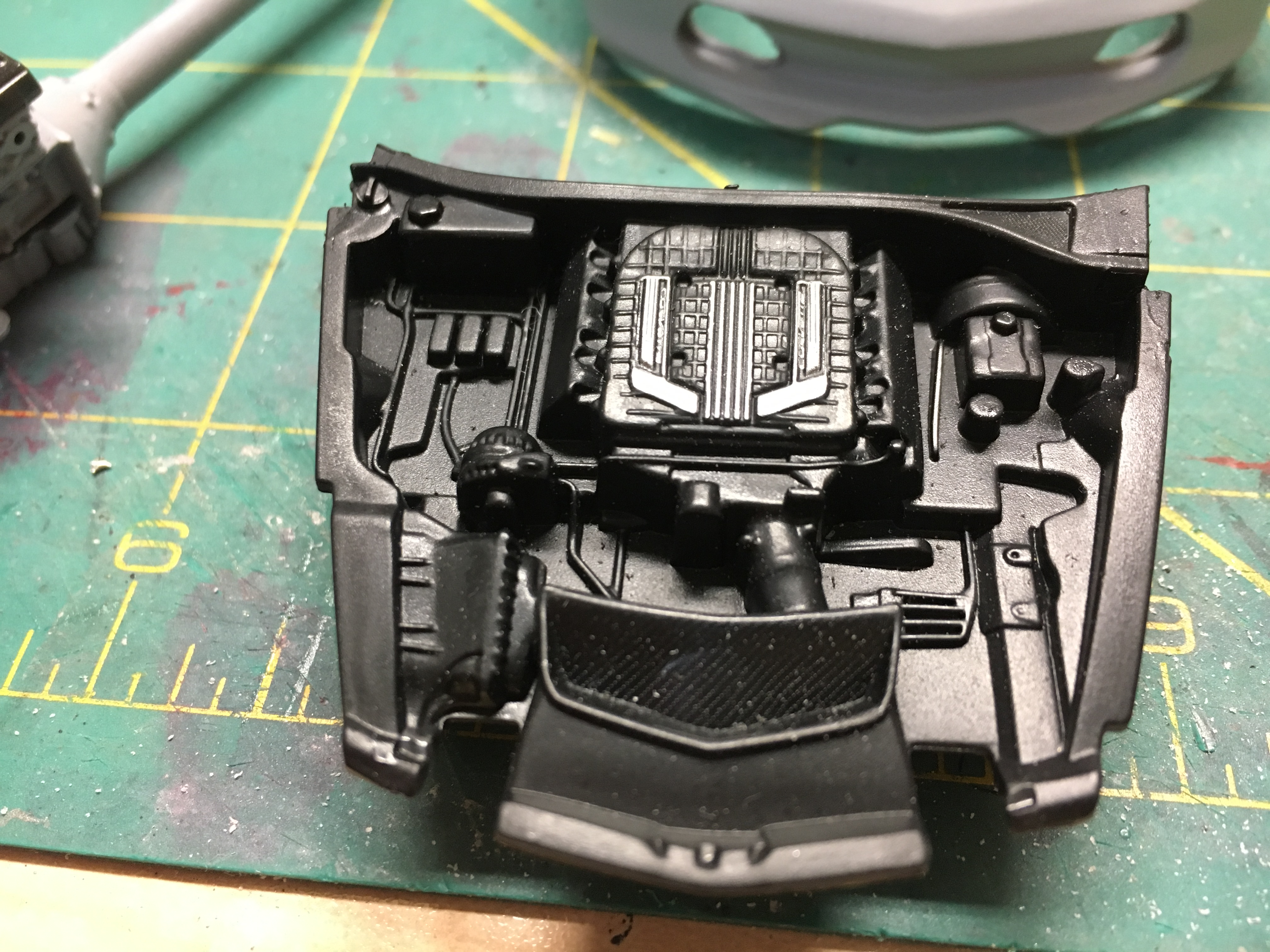

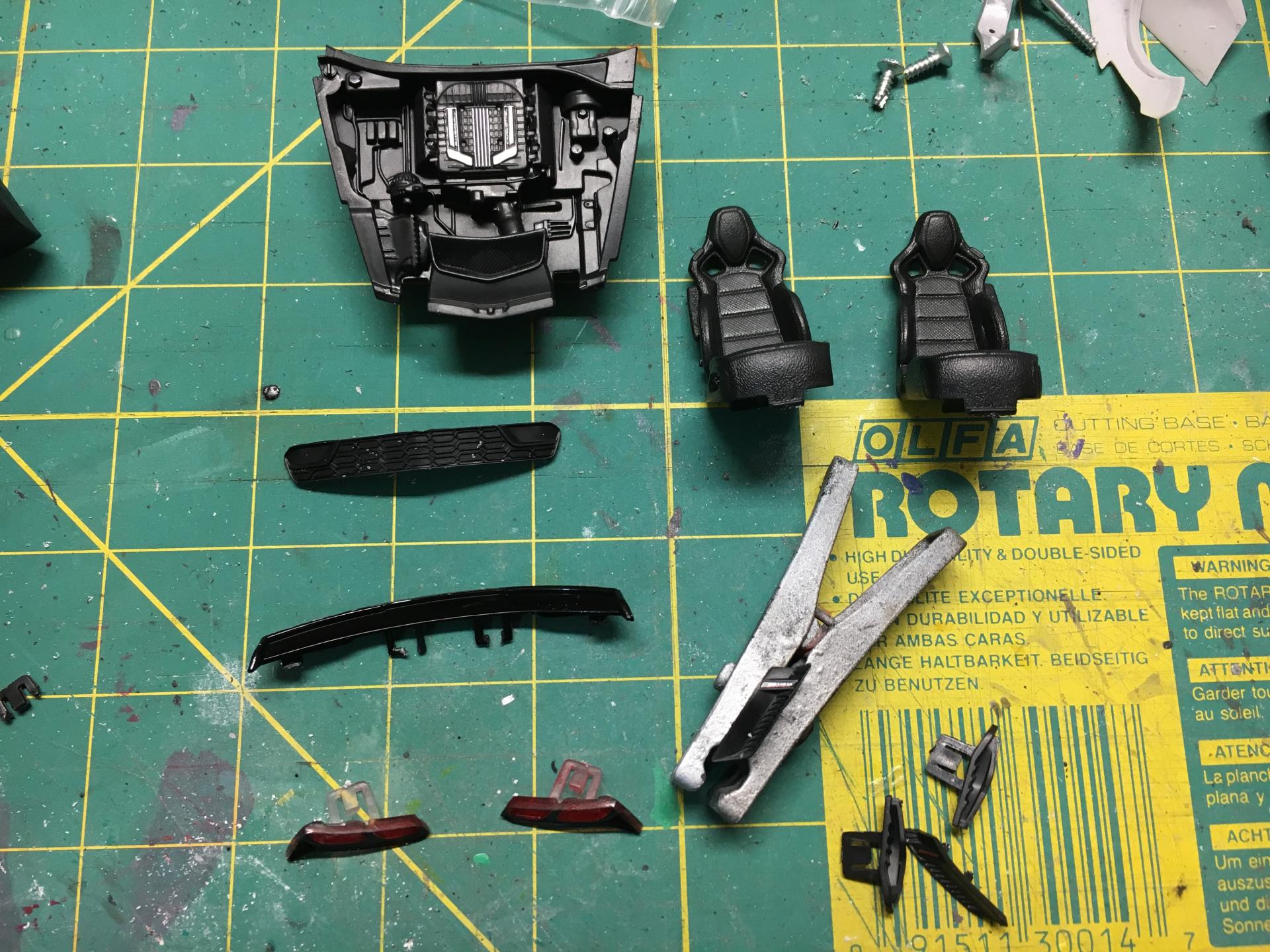

The Maisto Z06
5mins later, it was in lots of pieces!
I'm working on getting the Z06 parts mounted to the Revell body.

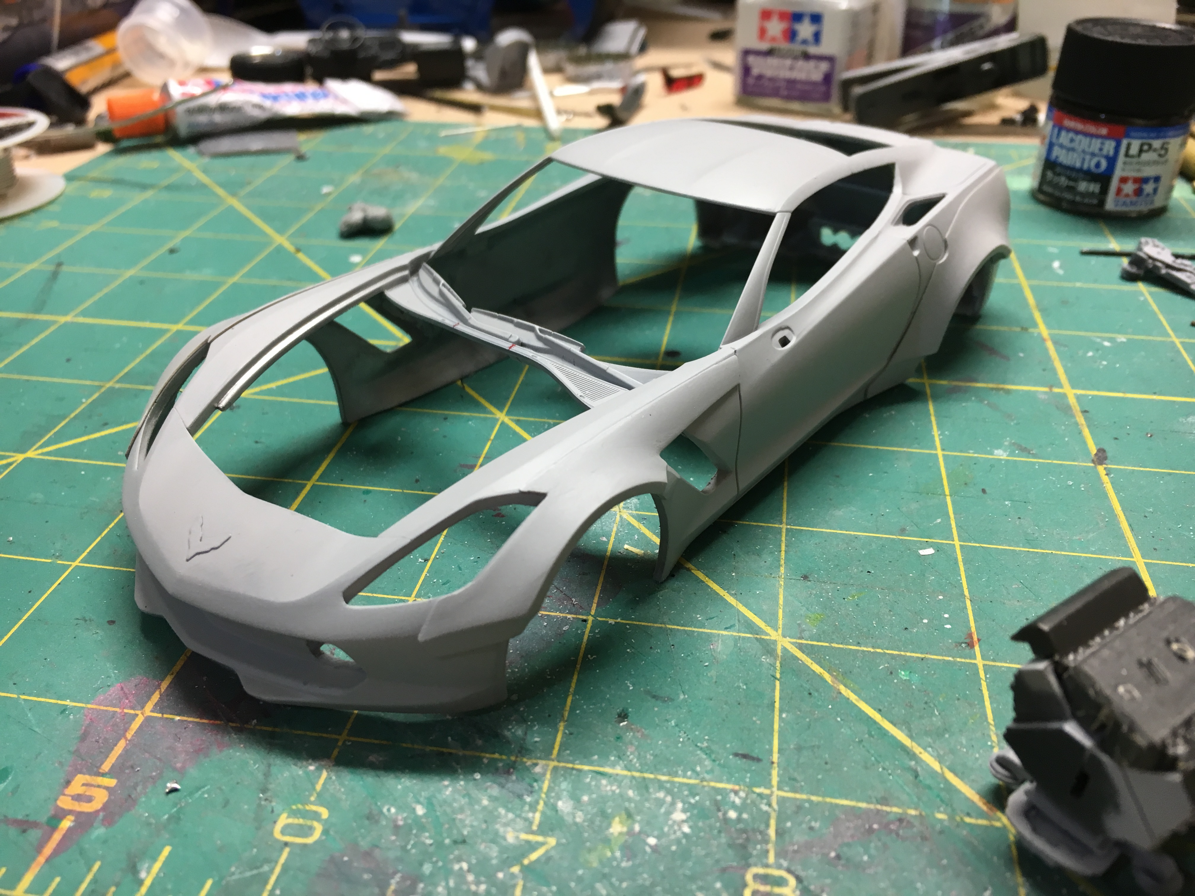

Hey Guys

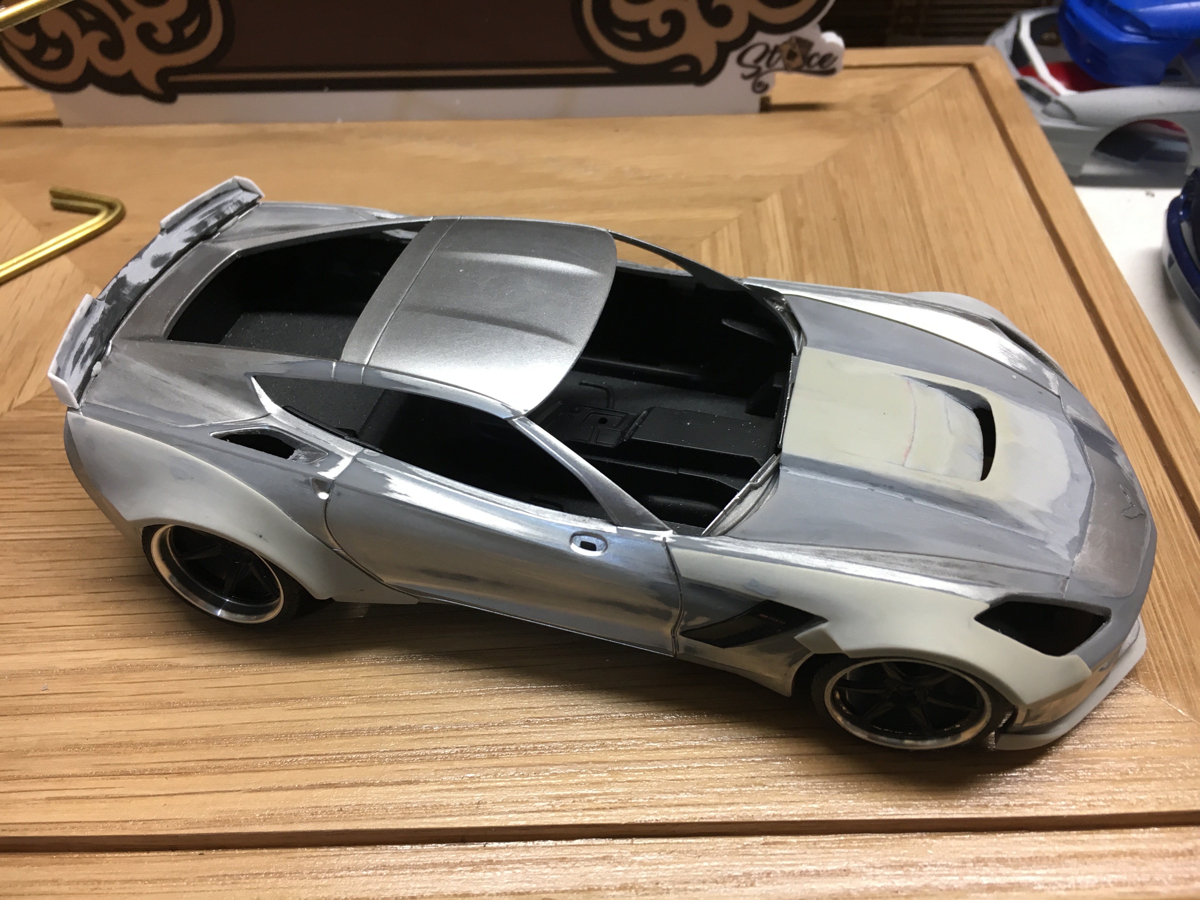

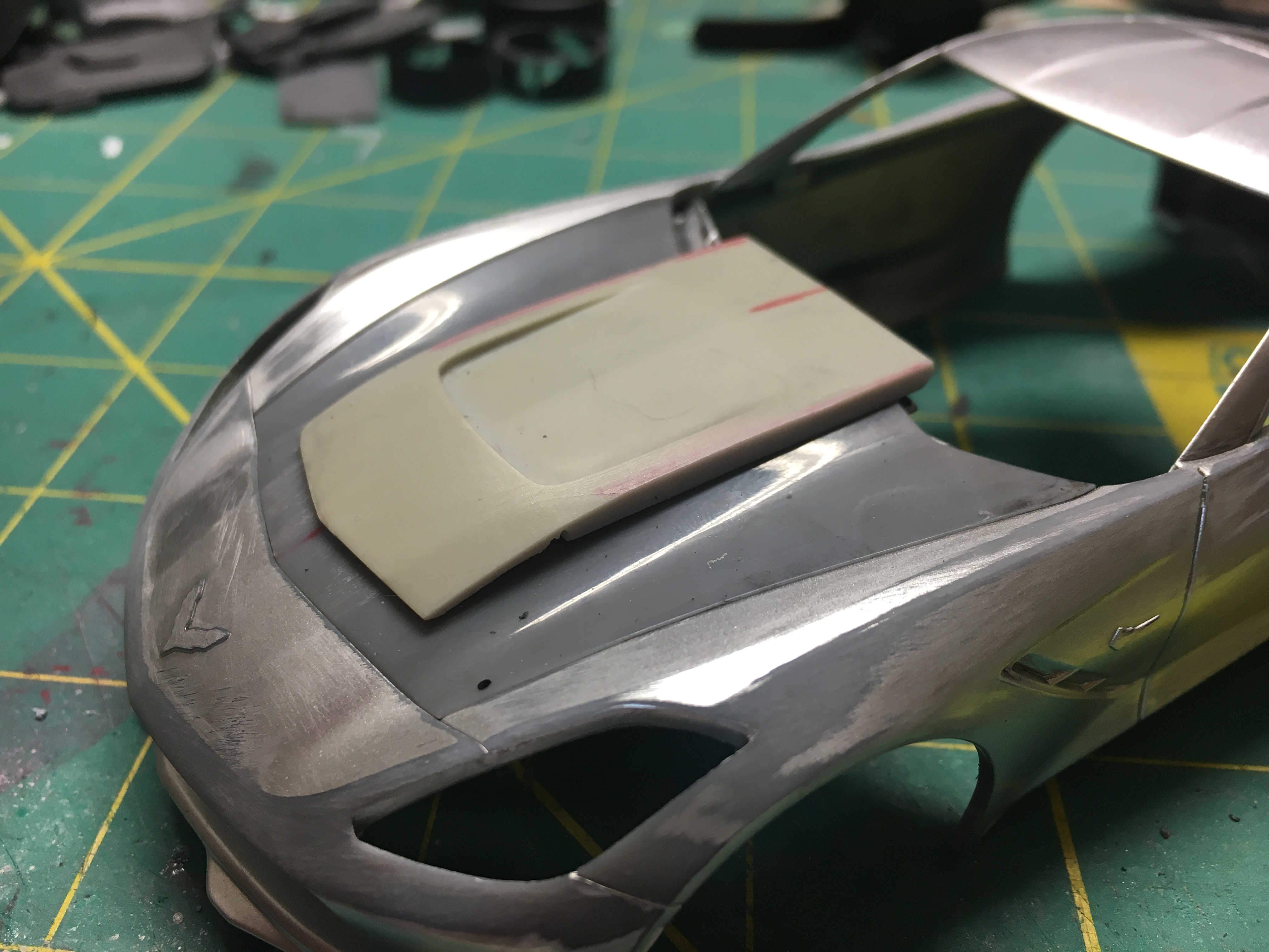

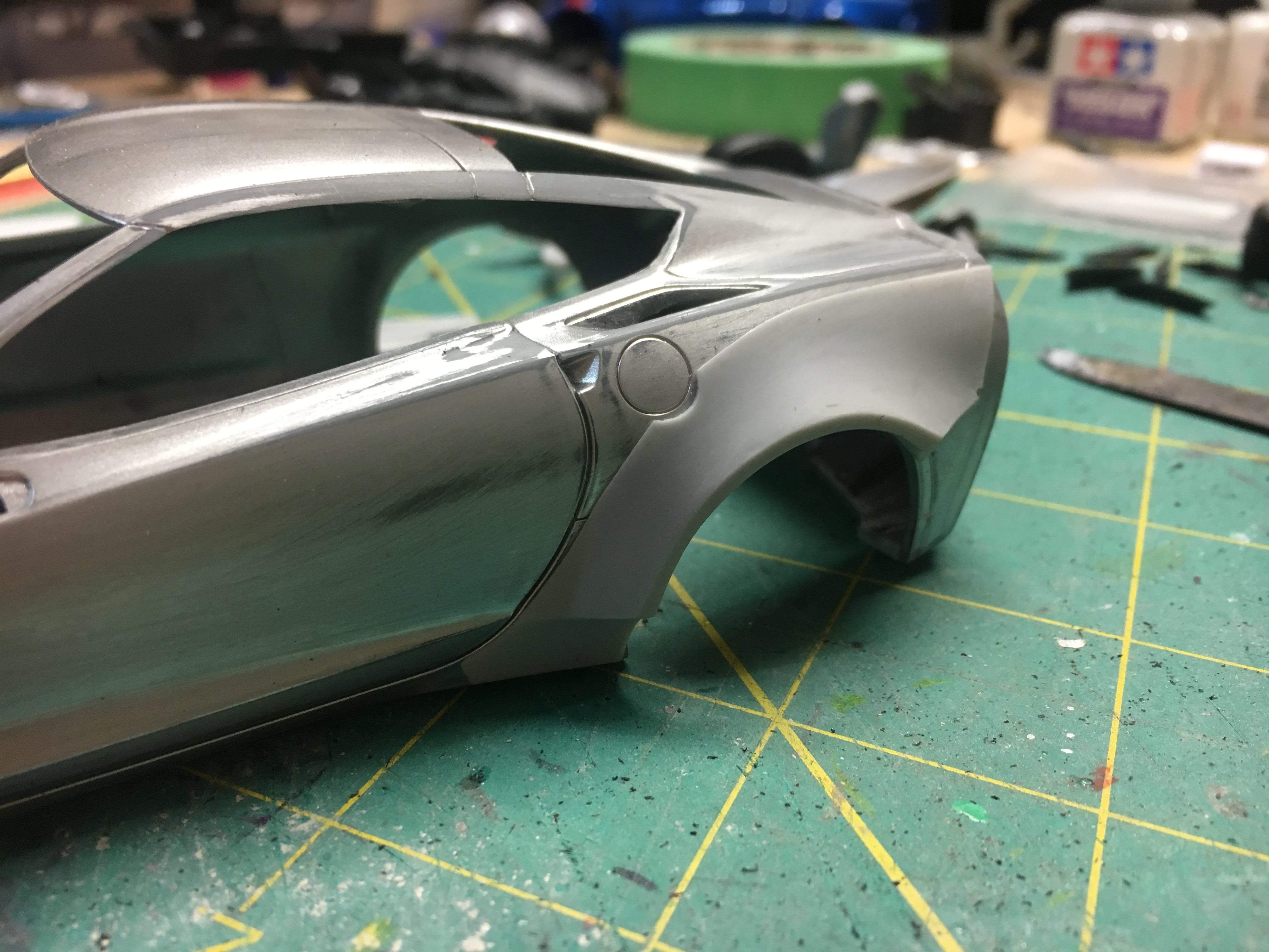

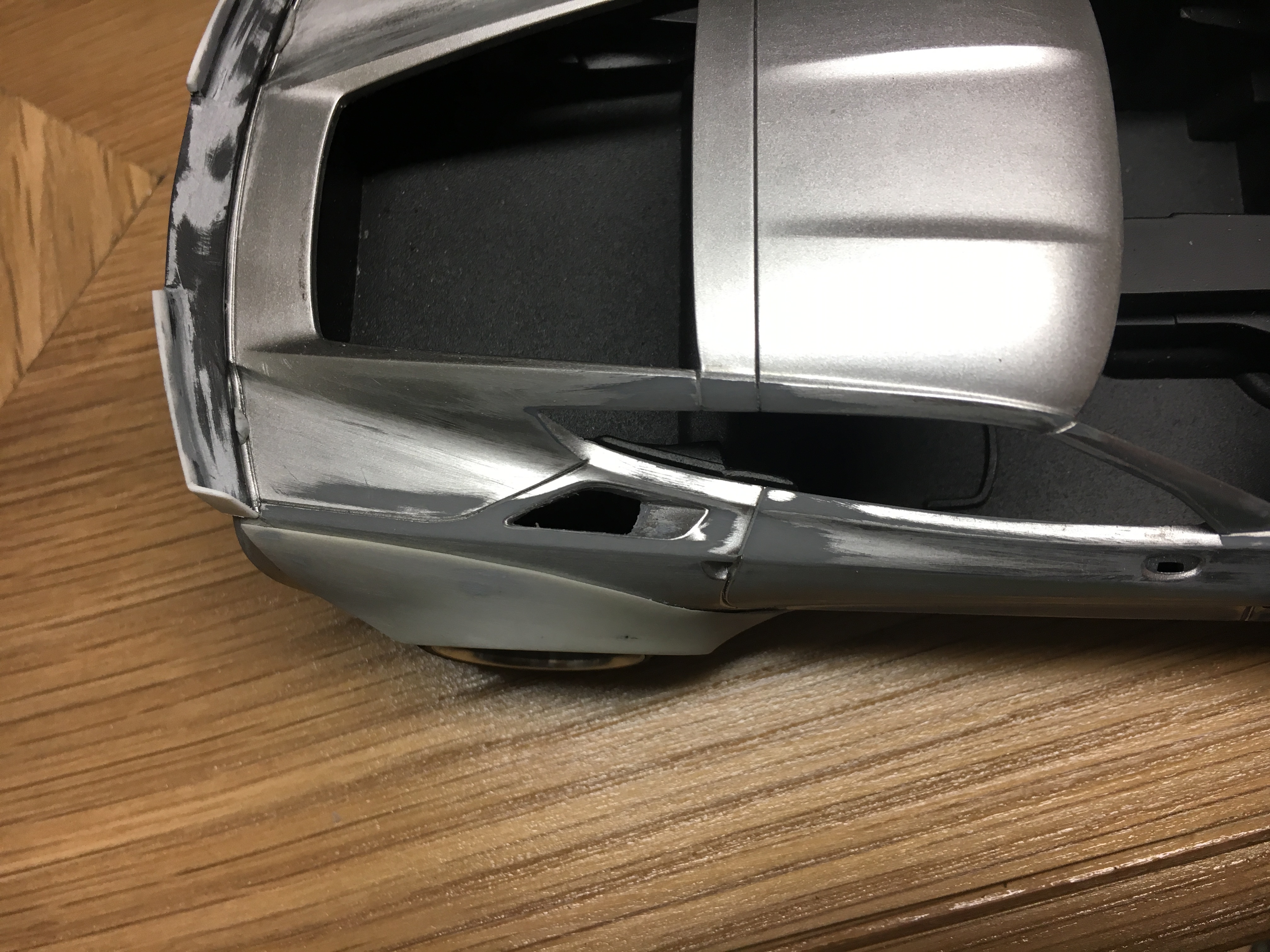

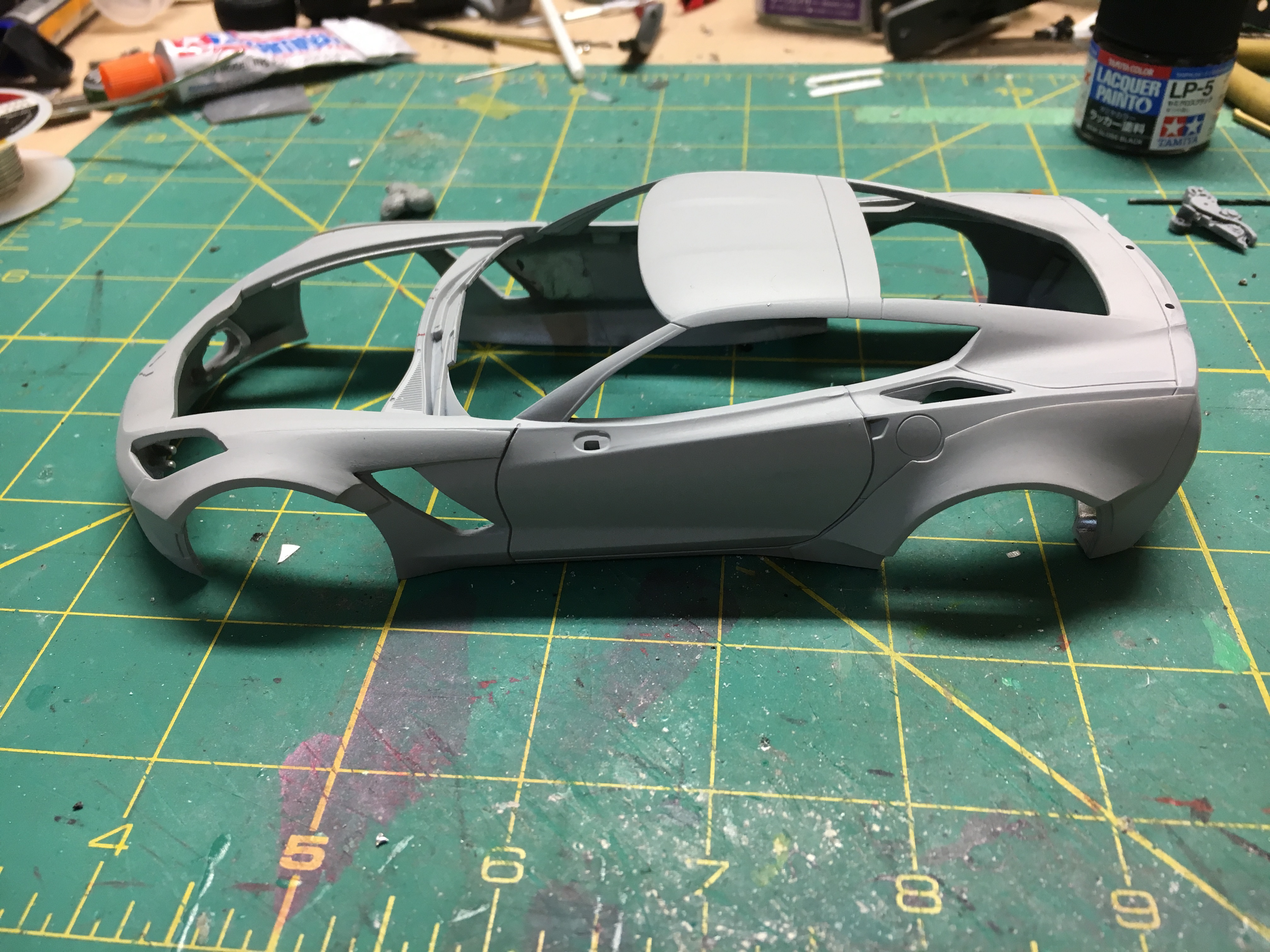

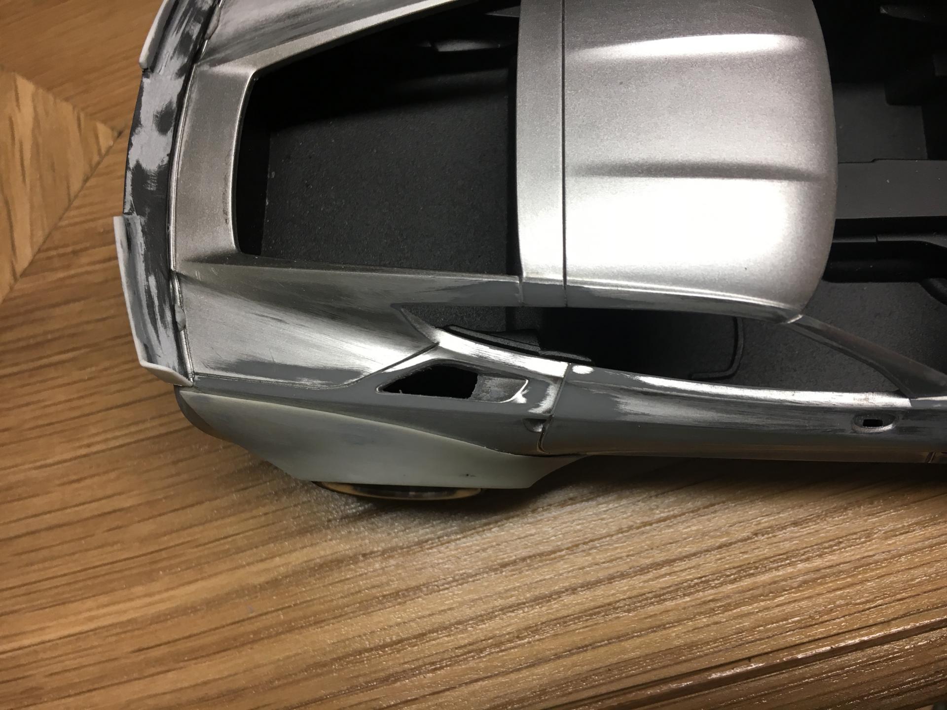

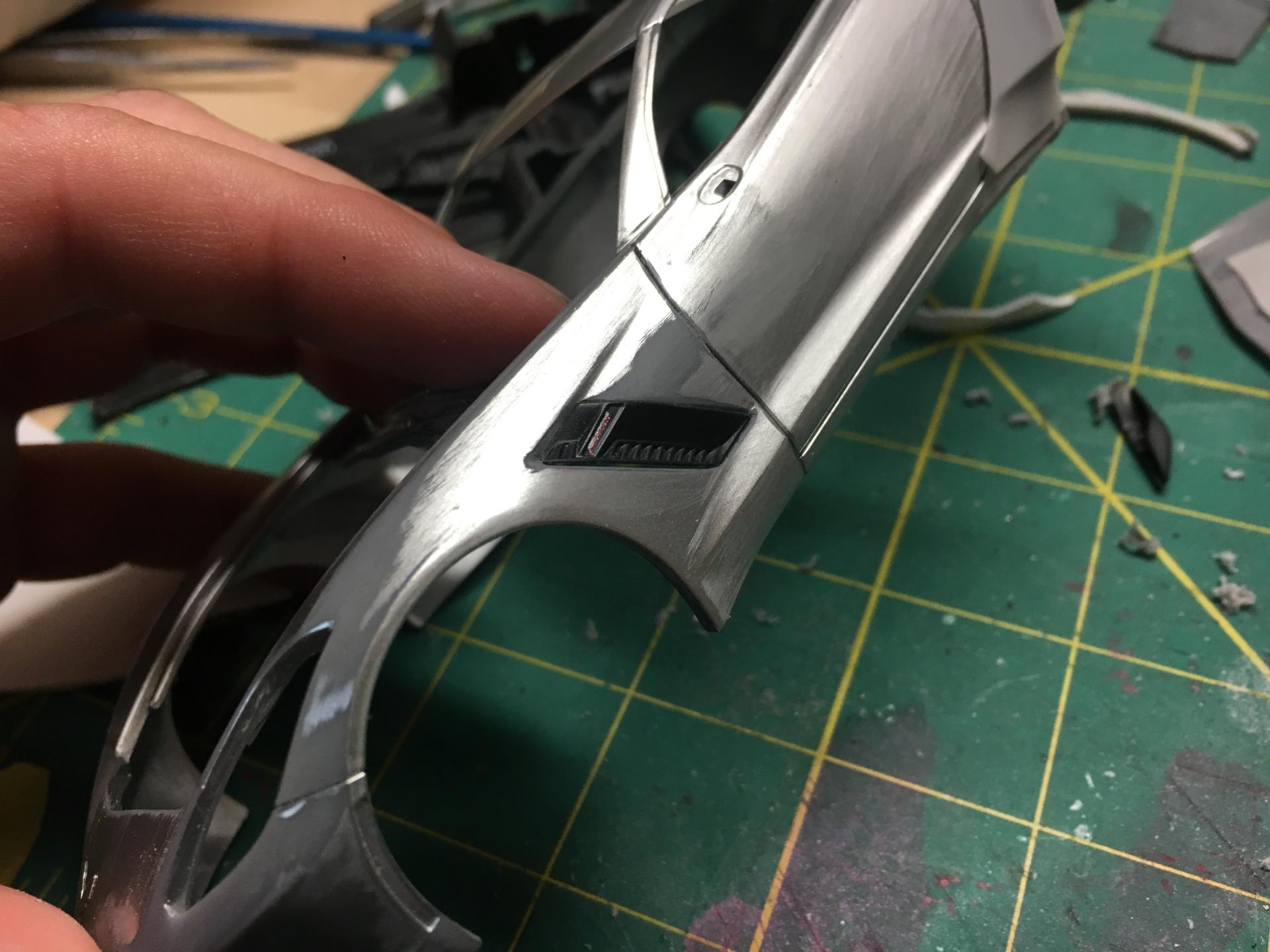

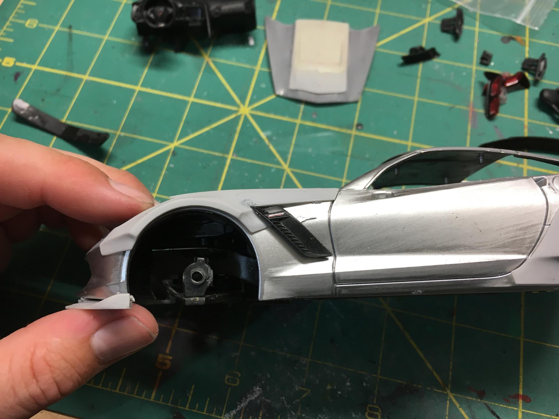

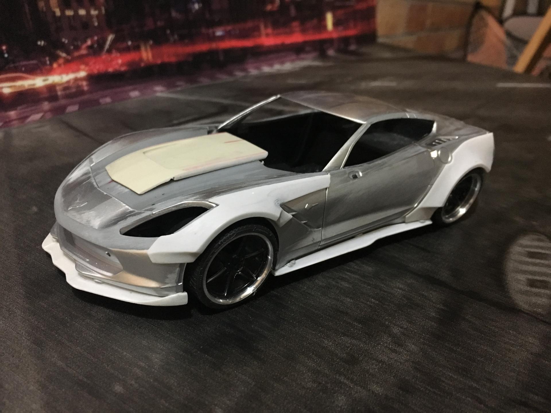

Been making some slow progress over the last few night. All the Z06 parts have been made to fit the body, vents opened etc. I've also started mounting the fenders & nearly done with modifying the bonnet!
These fender vents took 2 hrs each to fit, lots of careful sanding & test fitting, didn't want the straight line vent have a curved body line beside it.

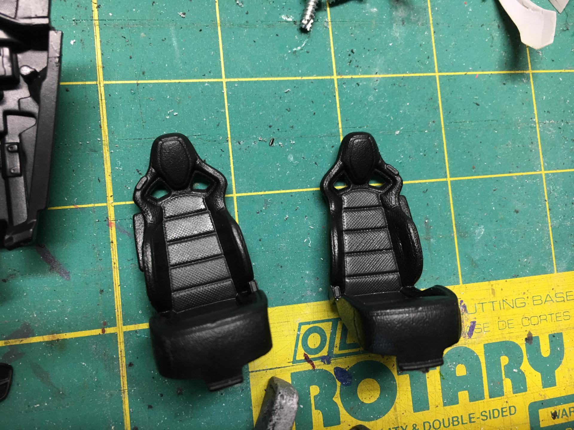

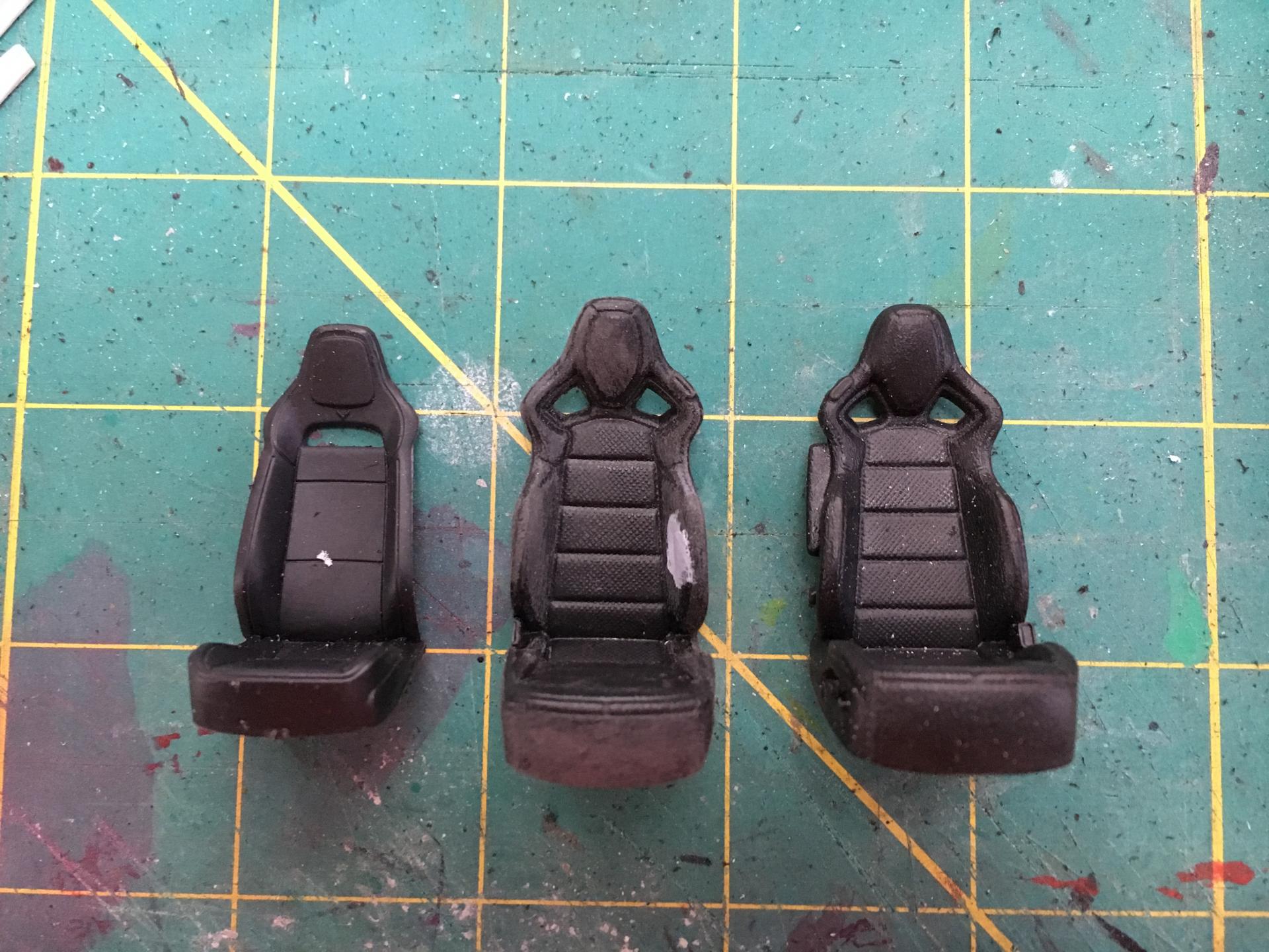

Seats, Left is the kit part, centre is modified Z06 seat & right is Maisto Z06 seat, still lots to do!

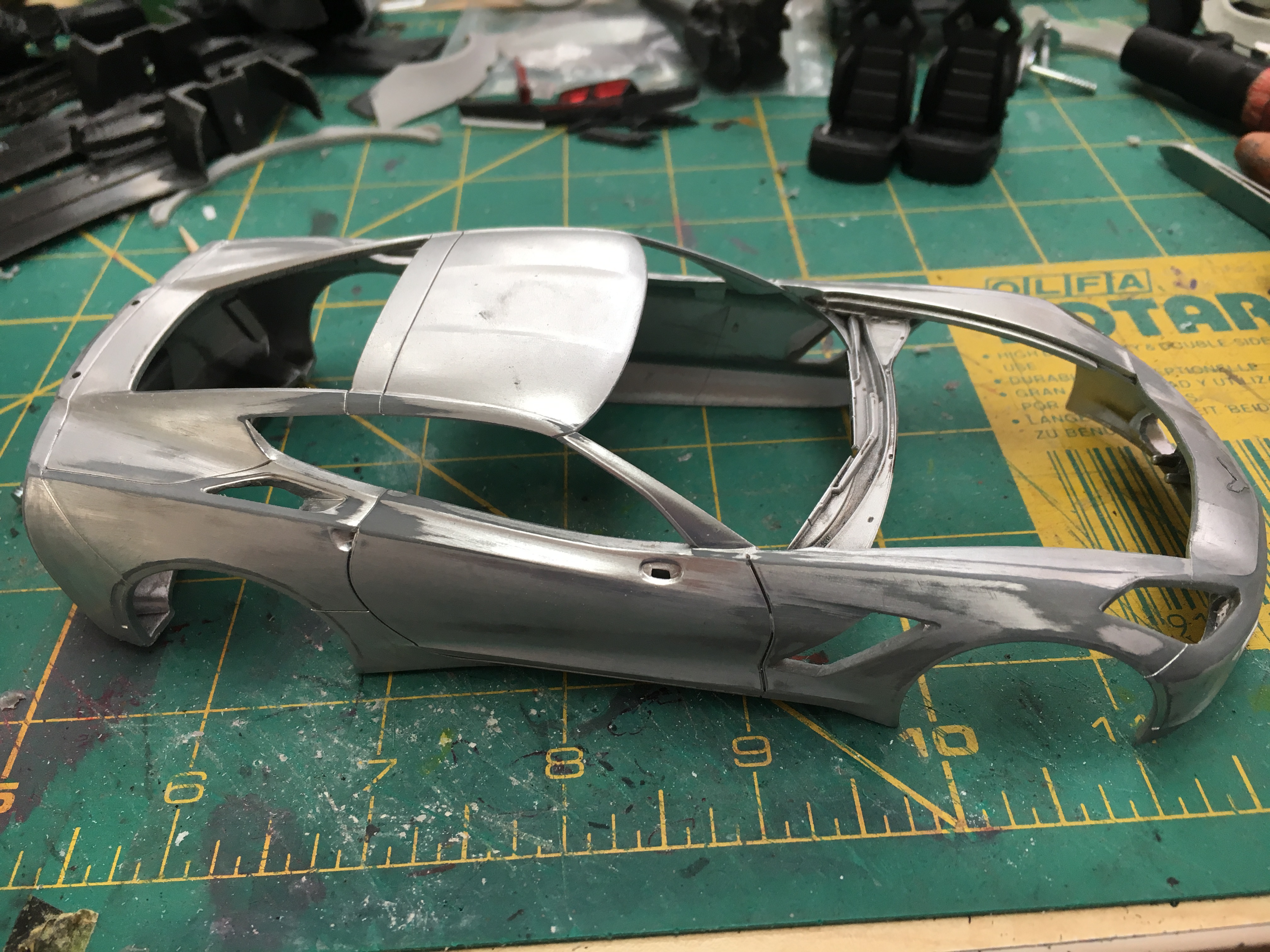

Hey guys.

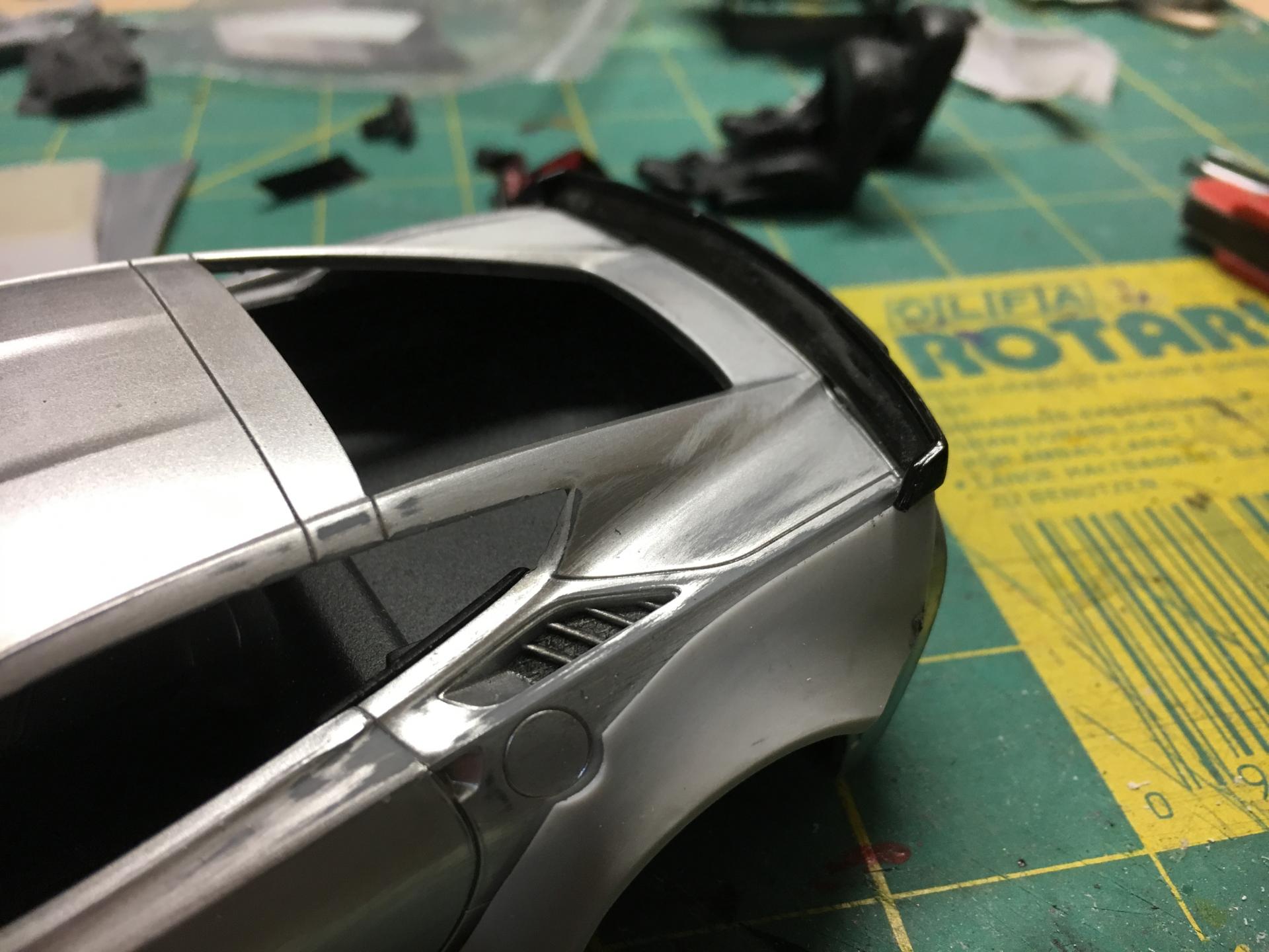

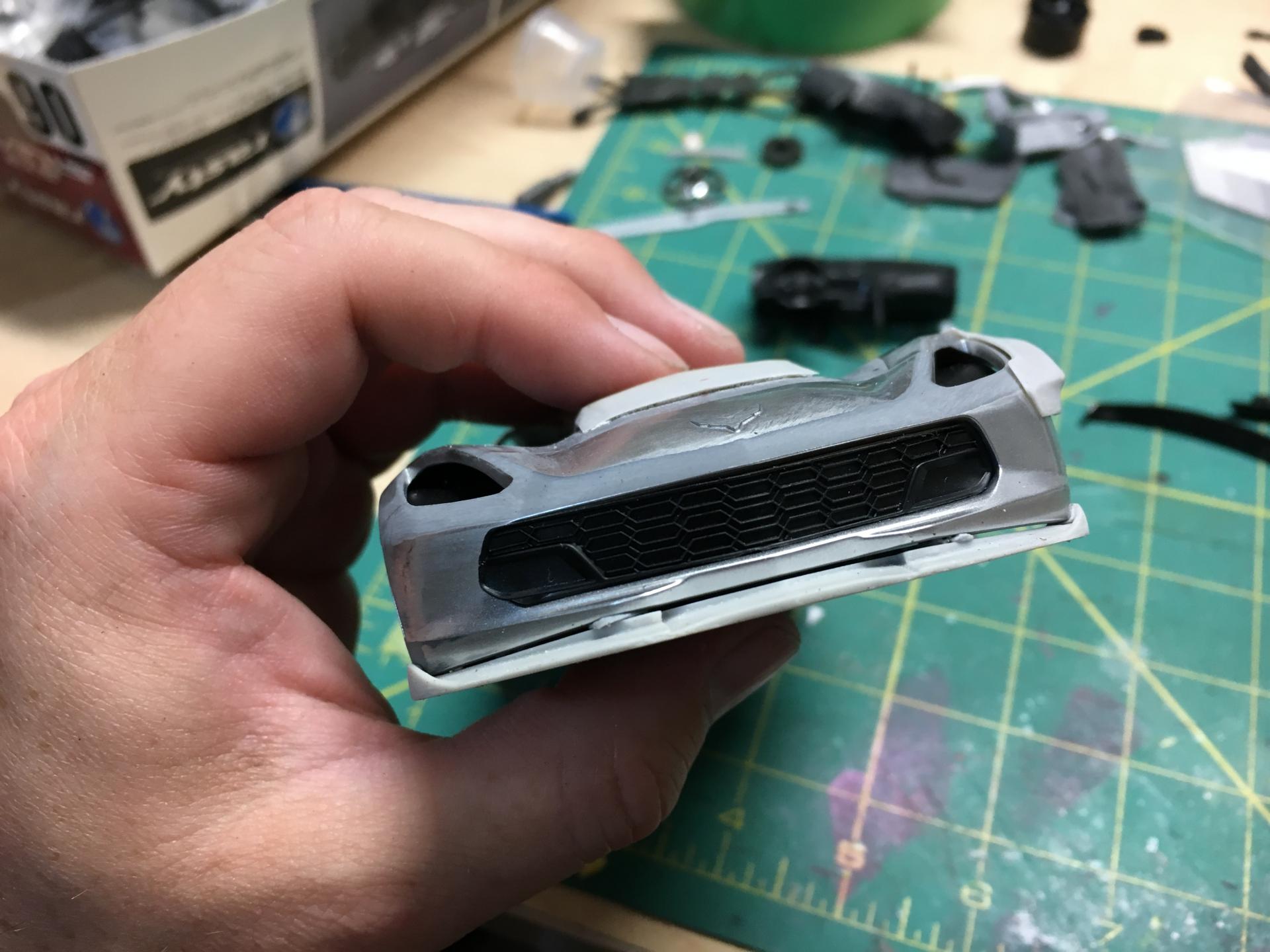

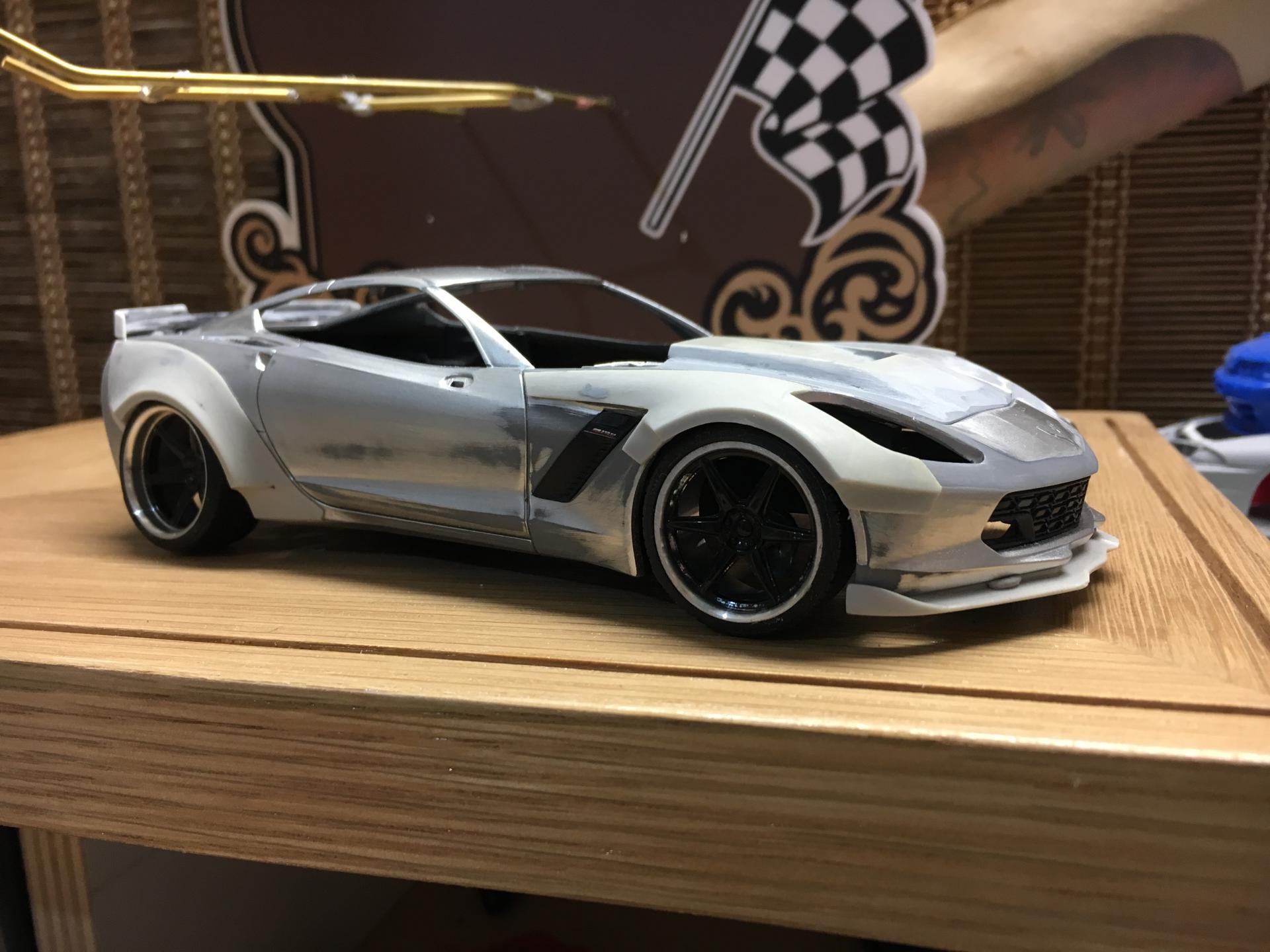

Now shes ready for primer, wasn't happy with the spoiler so modified it to suit & final touches to the body making sure the next pieces fit nicely.

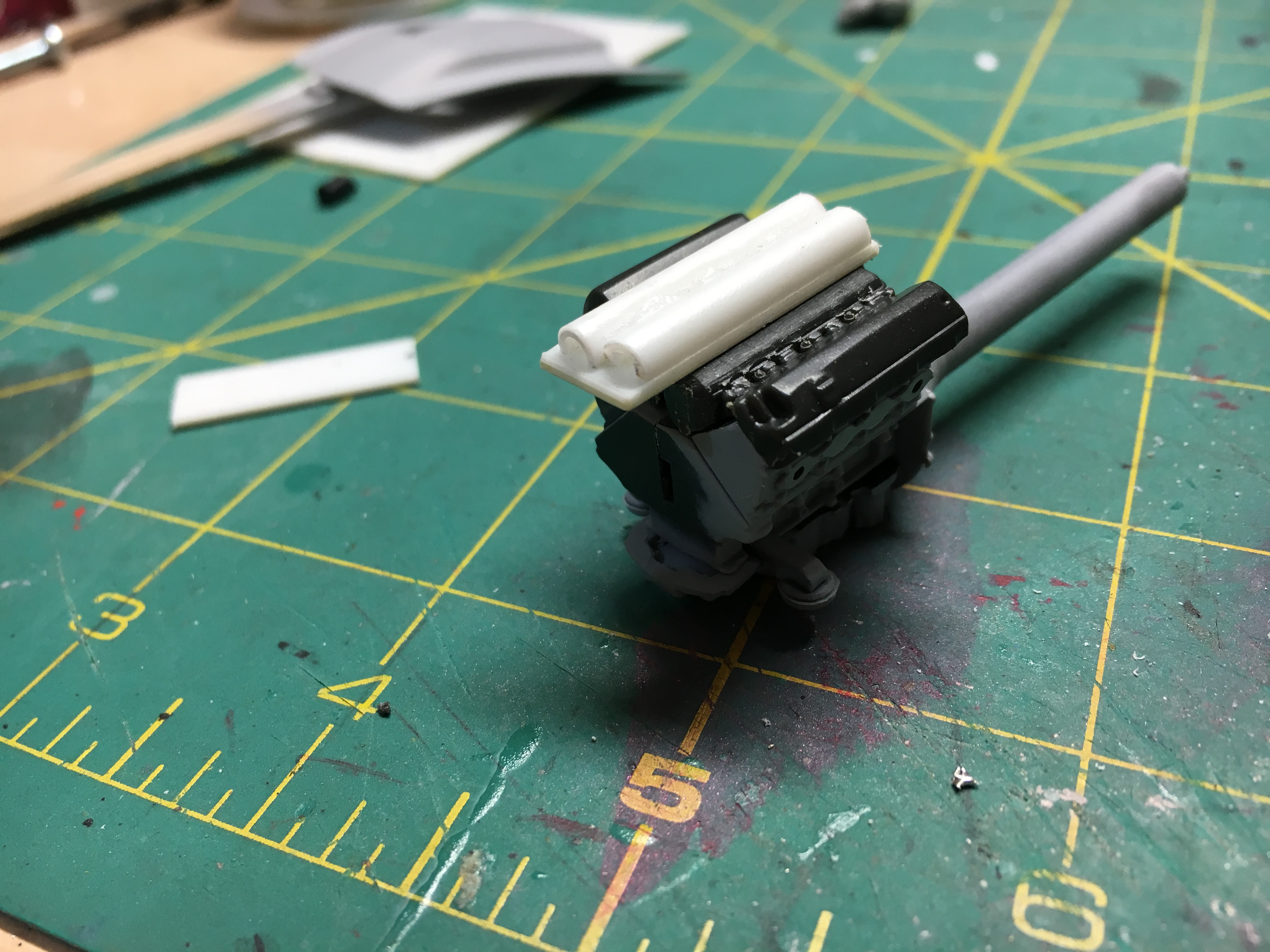

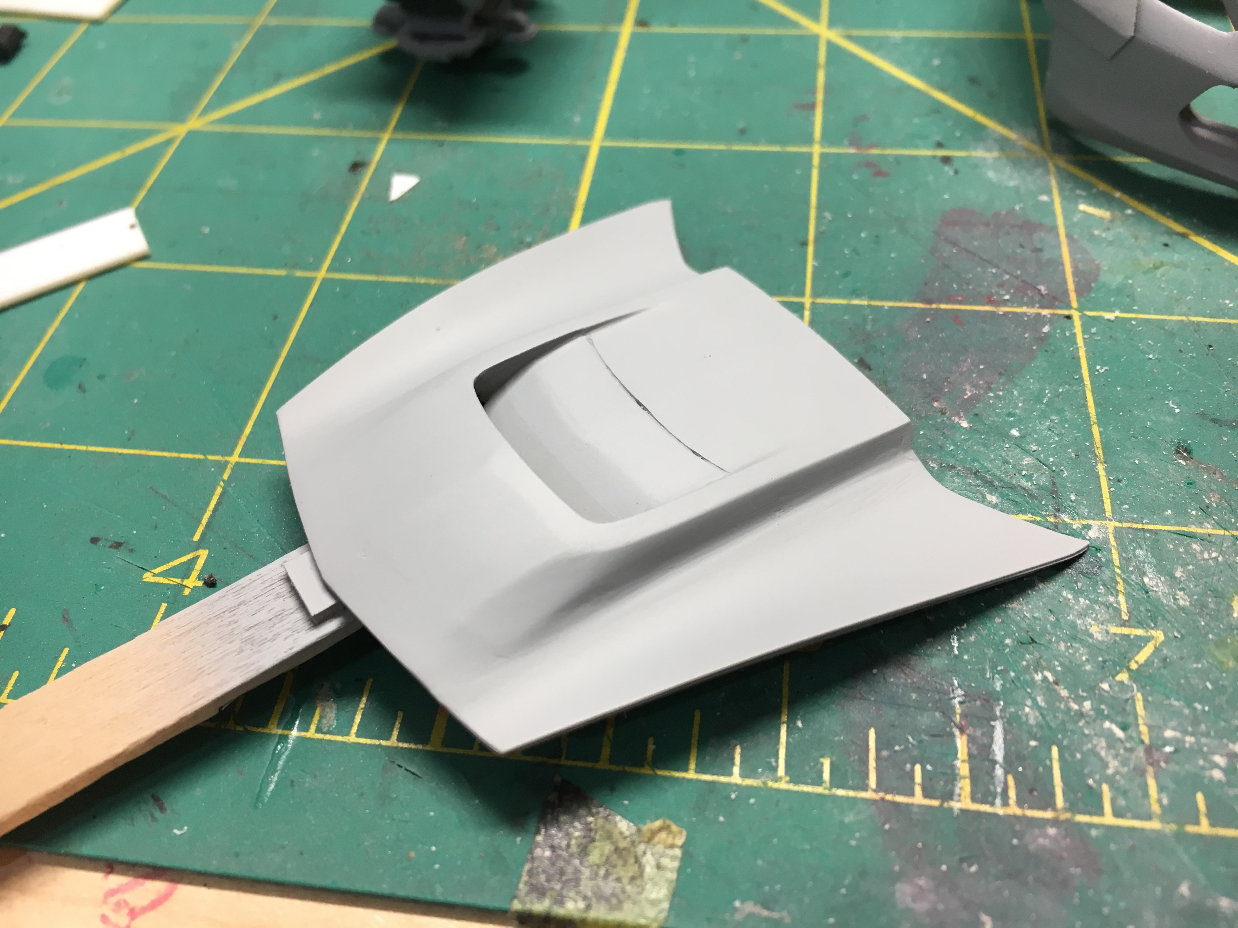

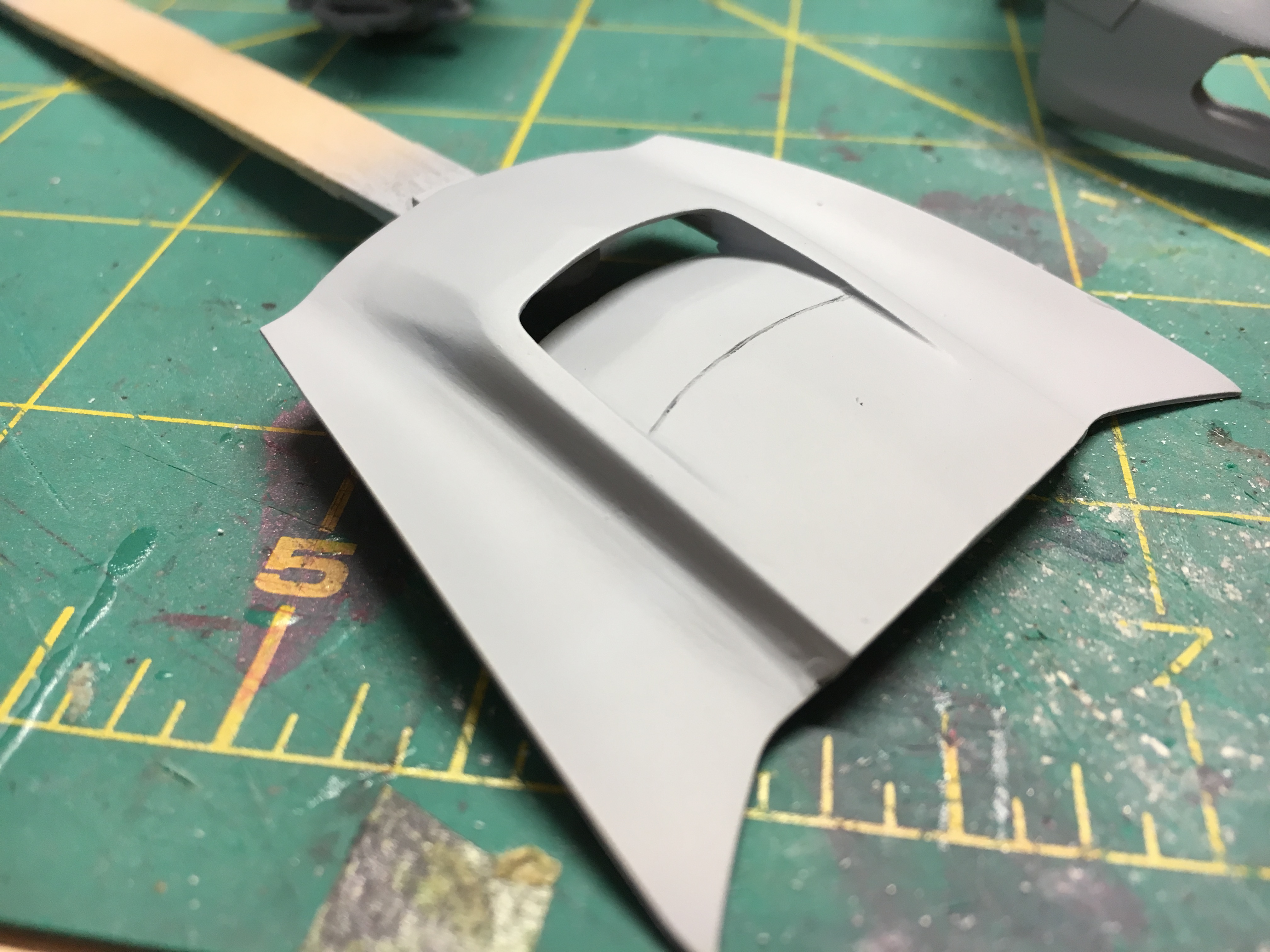

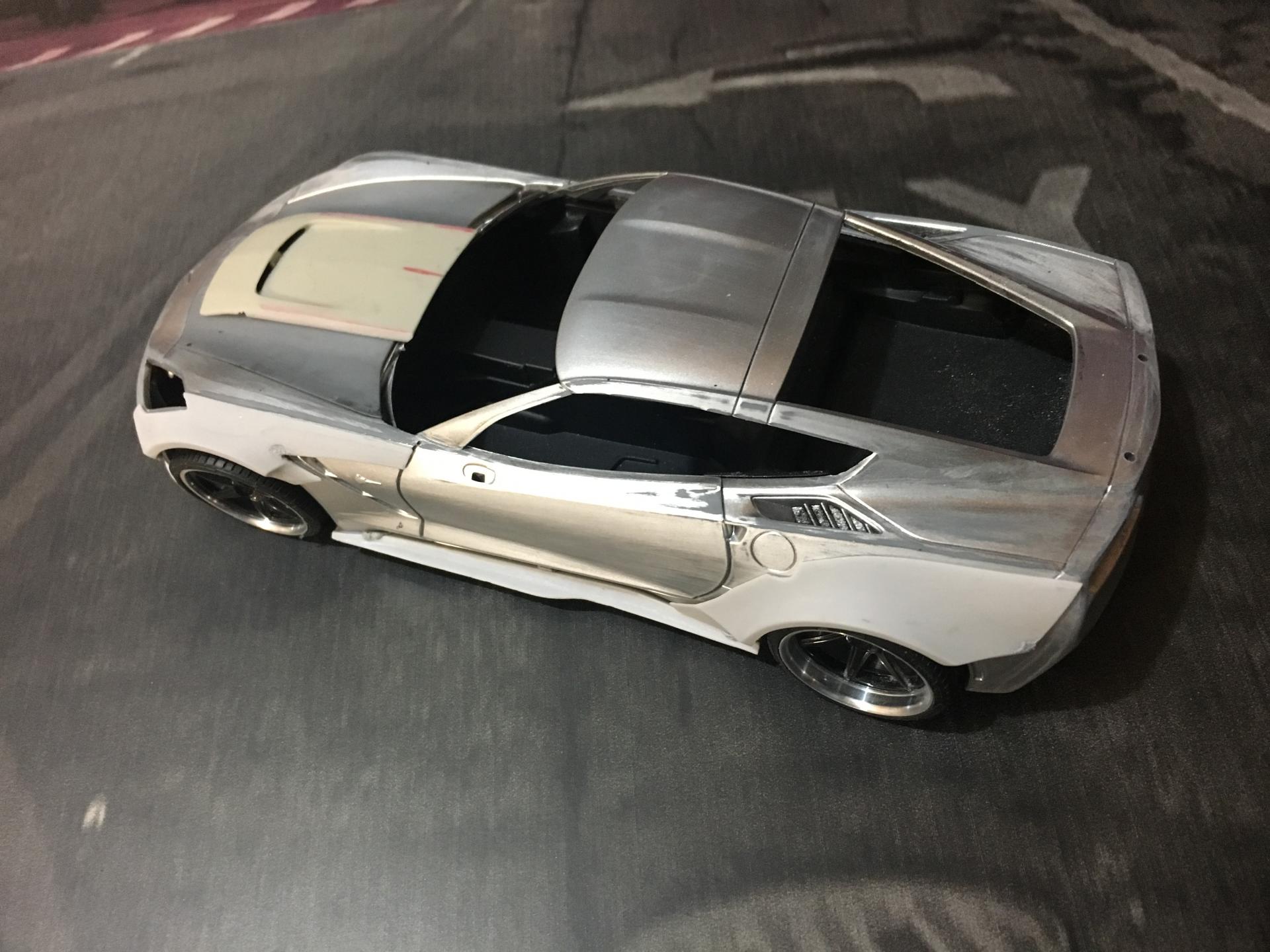

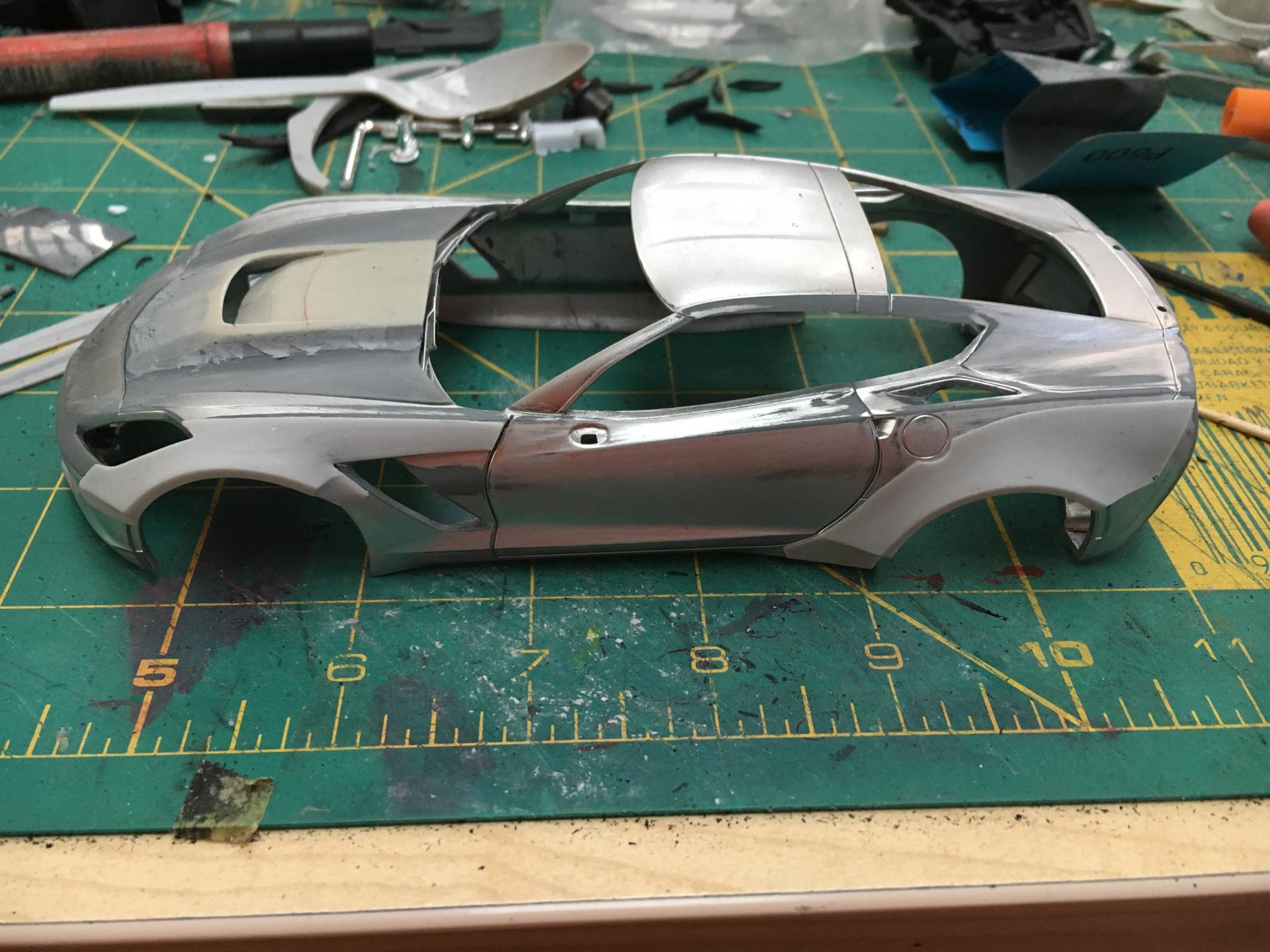

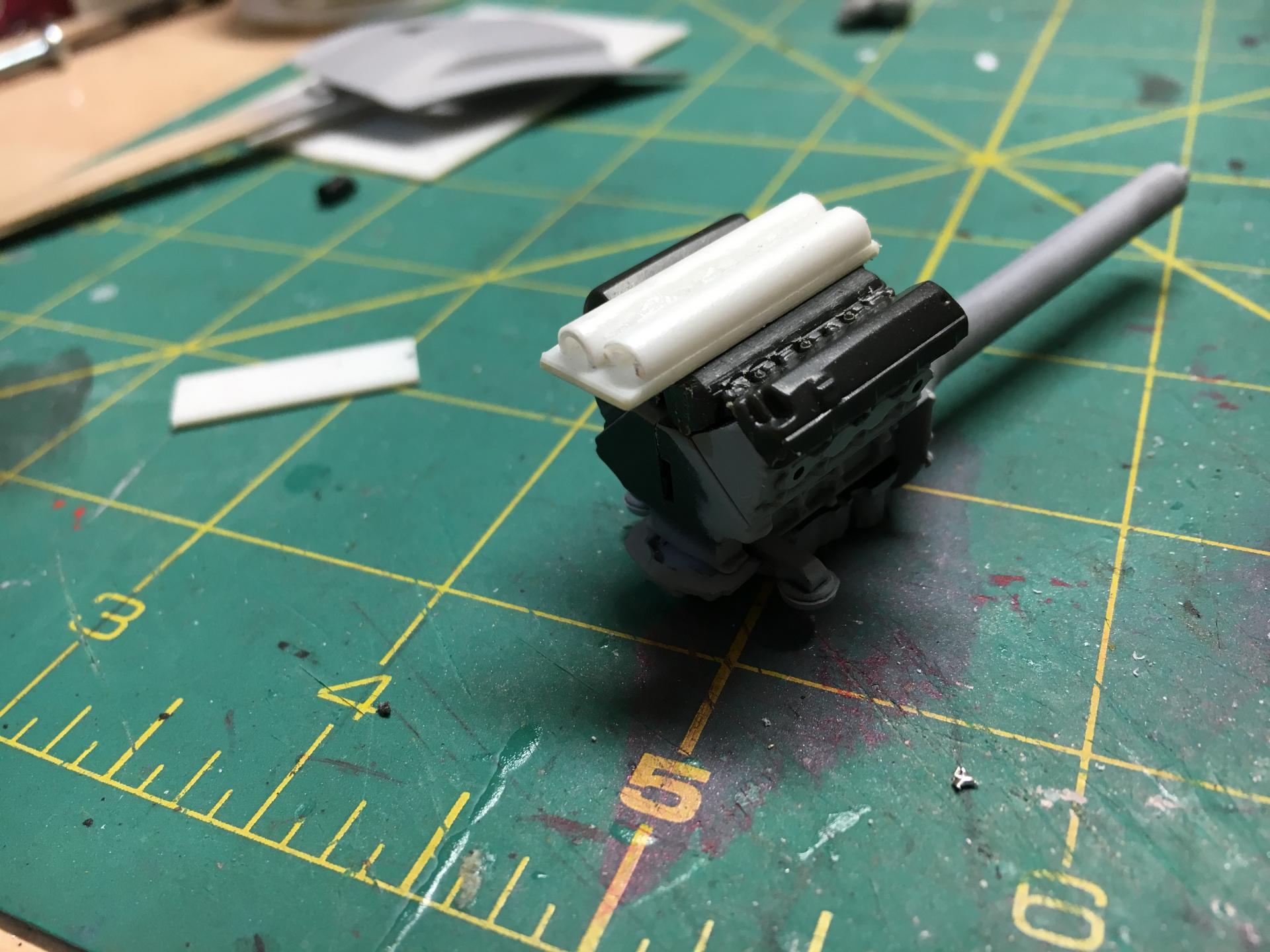

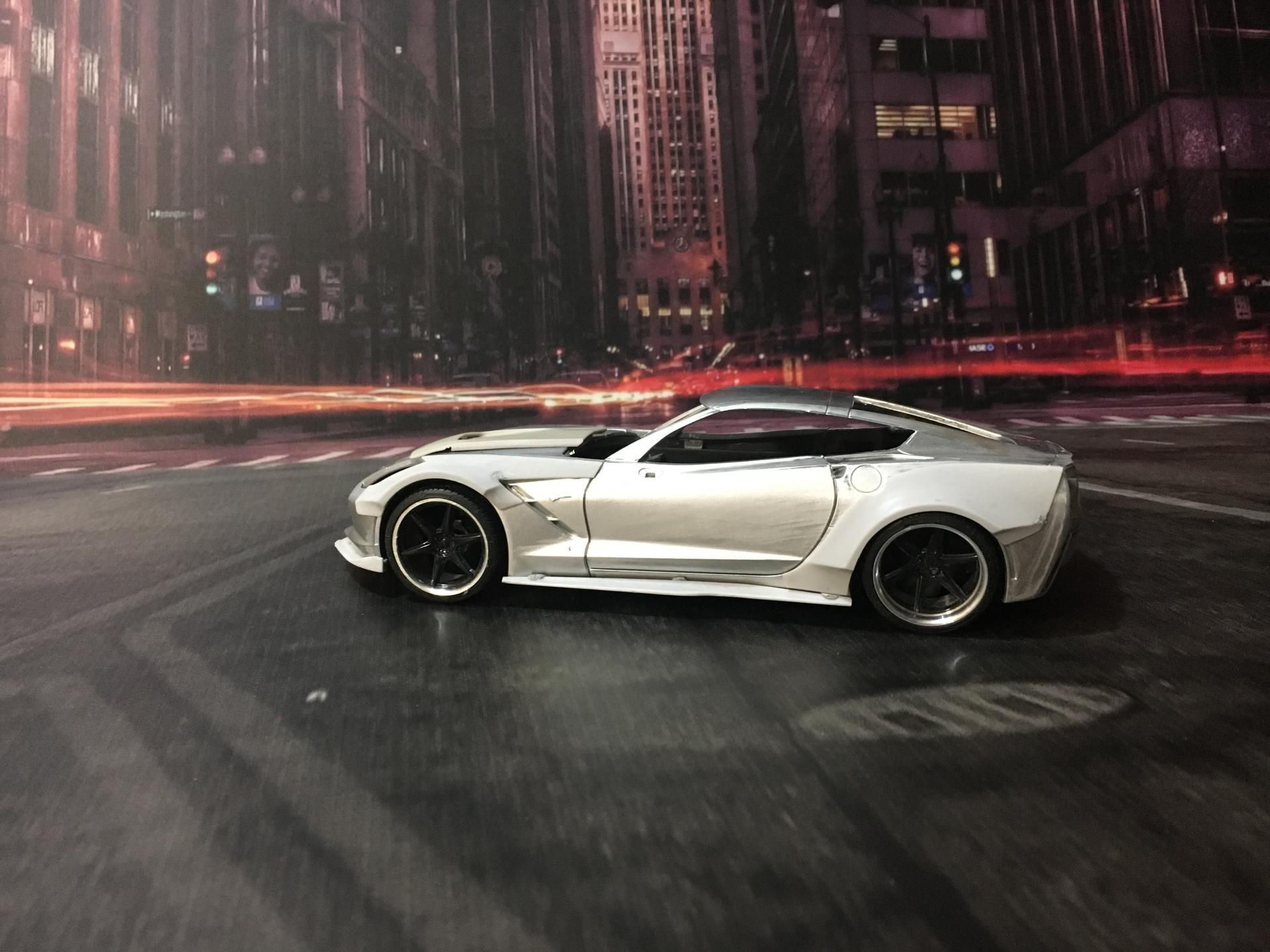

Made some progress recently, body is in primer. Hood is almost ready to go, still some detail to get right. & started on a scratch building a super charger
