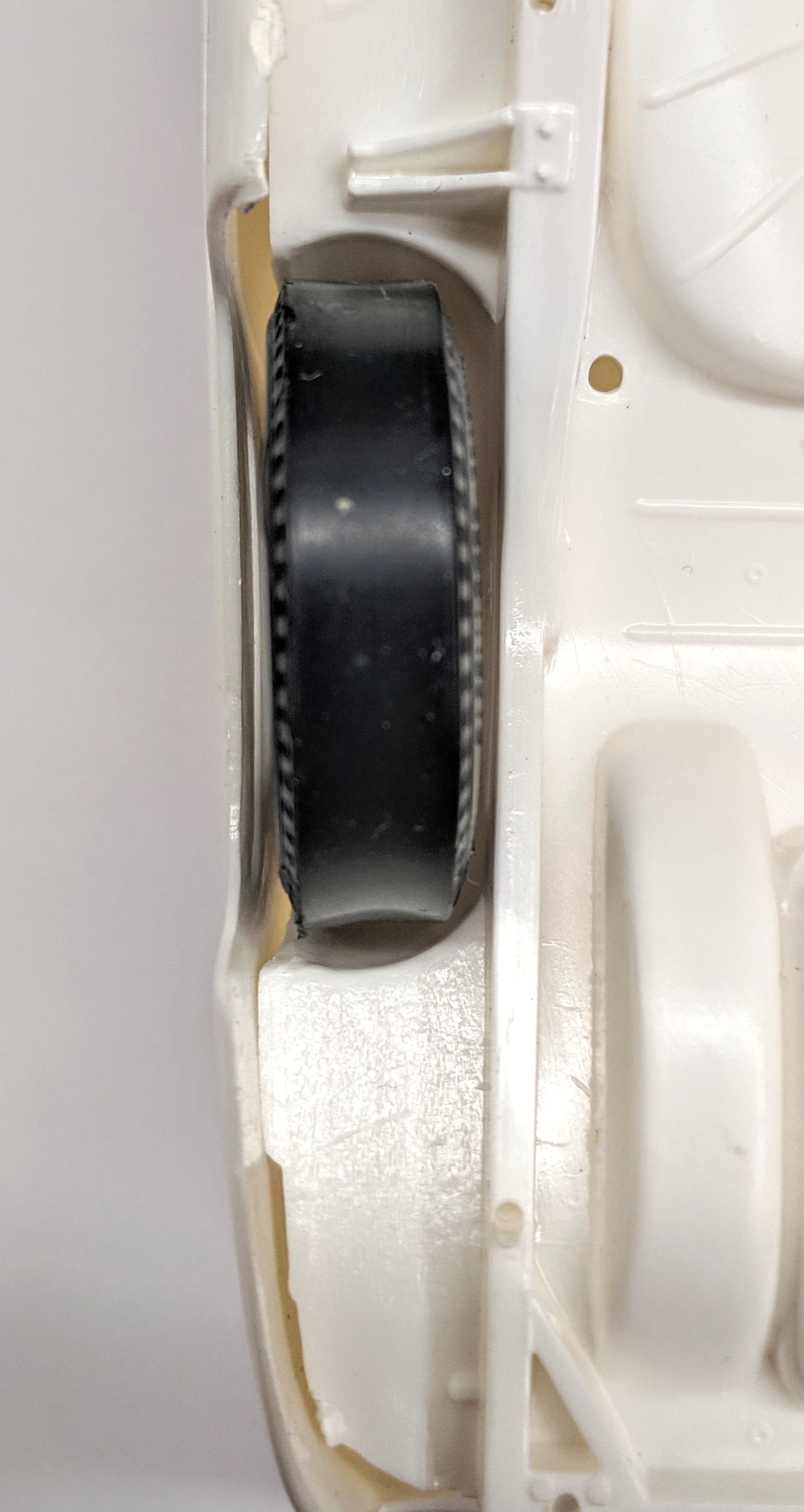

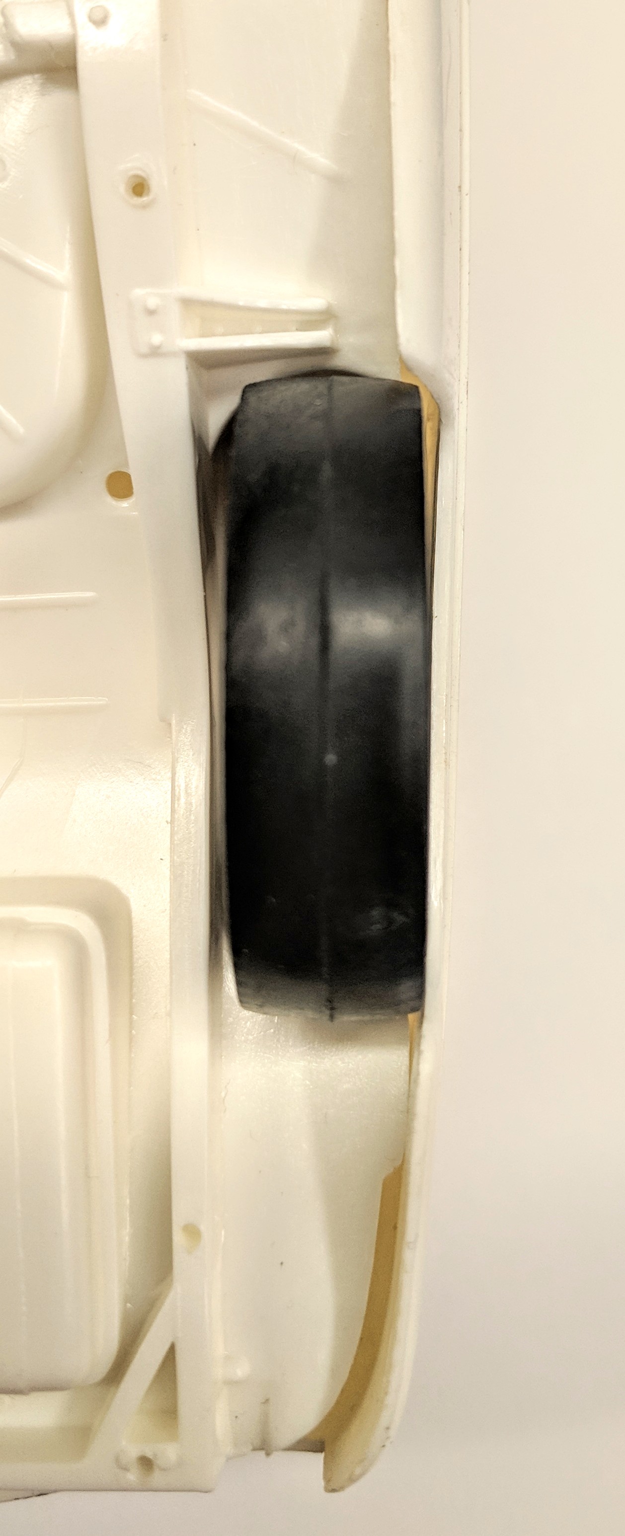

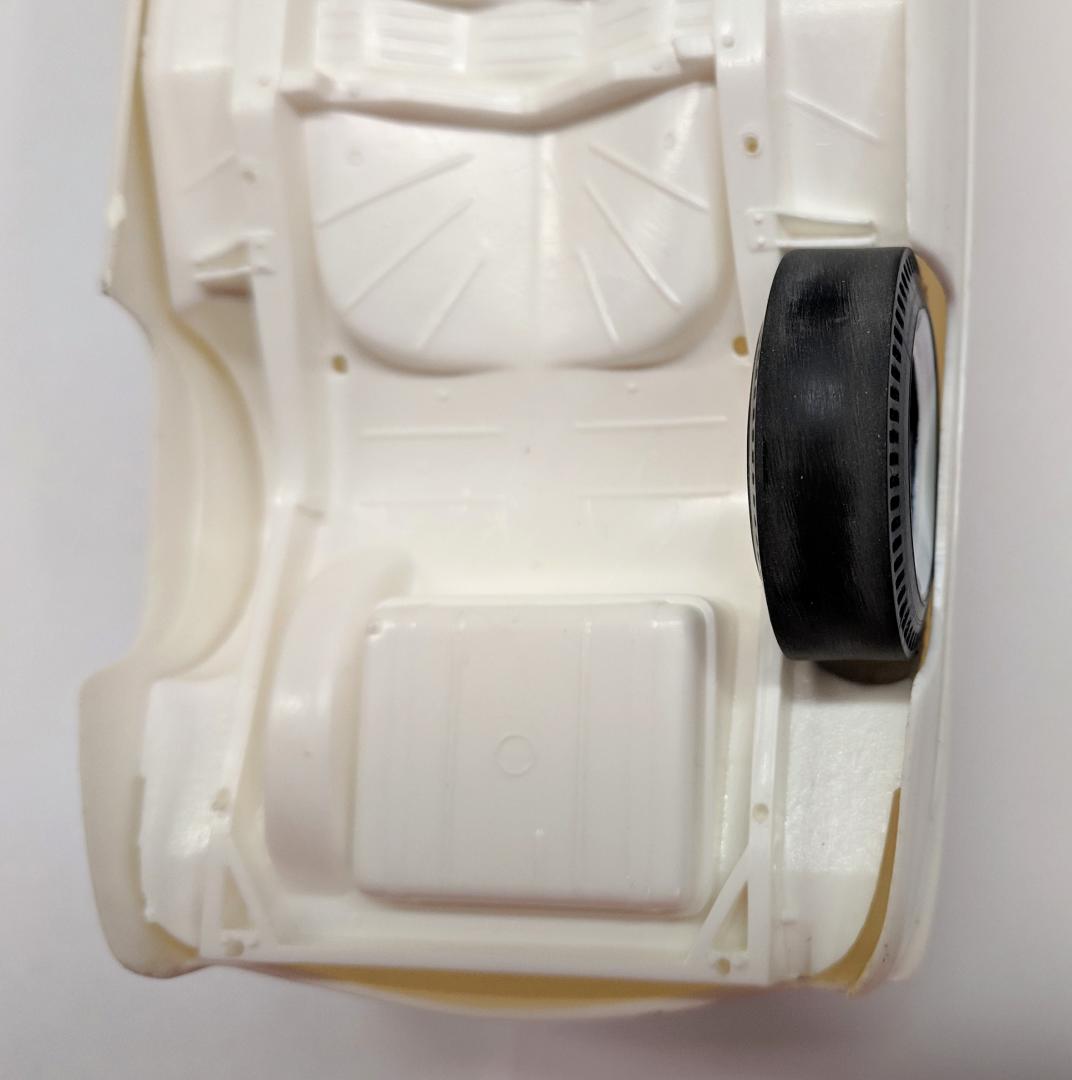

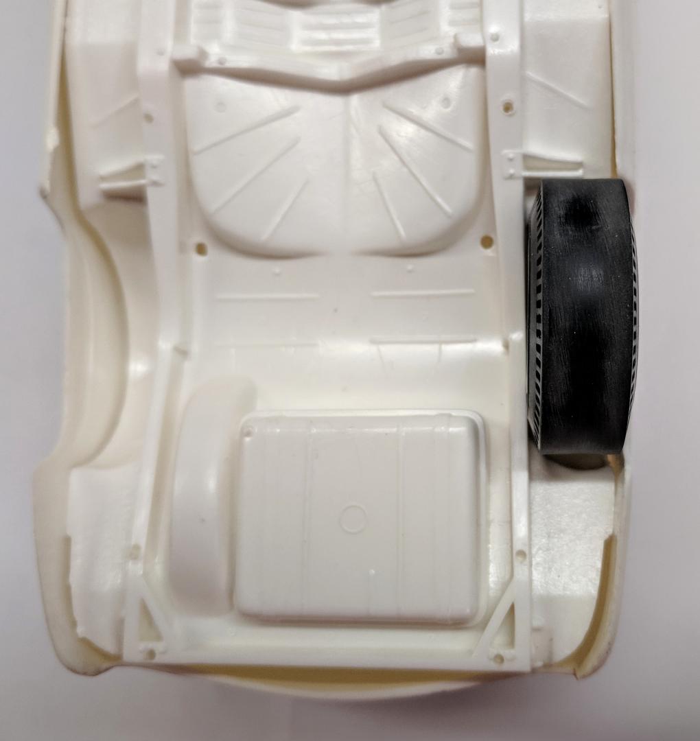

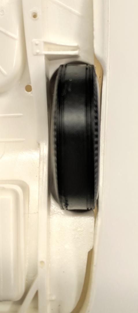

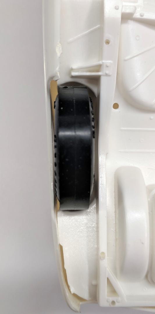

I'm not done. :P Here are a few more options, because I have a good variety of pie crust slicks on hand. #1-#3 are about the same O.D. (1.200"), but #4 has an O.D. of 1.112". Any of the four below will fit properly with a little wiggle room side-to-side. I don't have the kit's rear axle/leaf springs to determine of they'll rub on the top of the wheelhouse or not.
#1 -- AMT Firestone Deluxe Champion 'Gum Dipped' 7.50x15 pie crust slick:
#2 -- AMT newly tooled double-groove pie-crust cheater slick (Barris Surf Buggy, etc.):
#3 -- I believe these are the 'no name' early AMT pie crust slicks Bill mentioned. No sidewall markings whatsoever:
#4 -- M+H Racemaster Dragster 7.10 x 15 pie crust slicks (no idea on the source):
Share this post
Link to post
