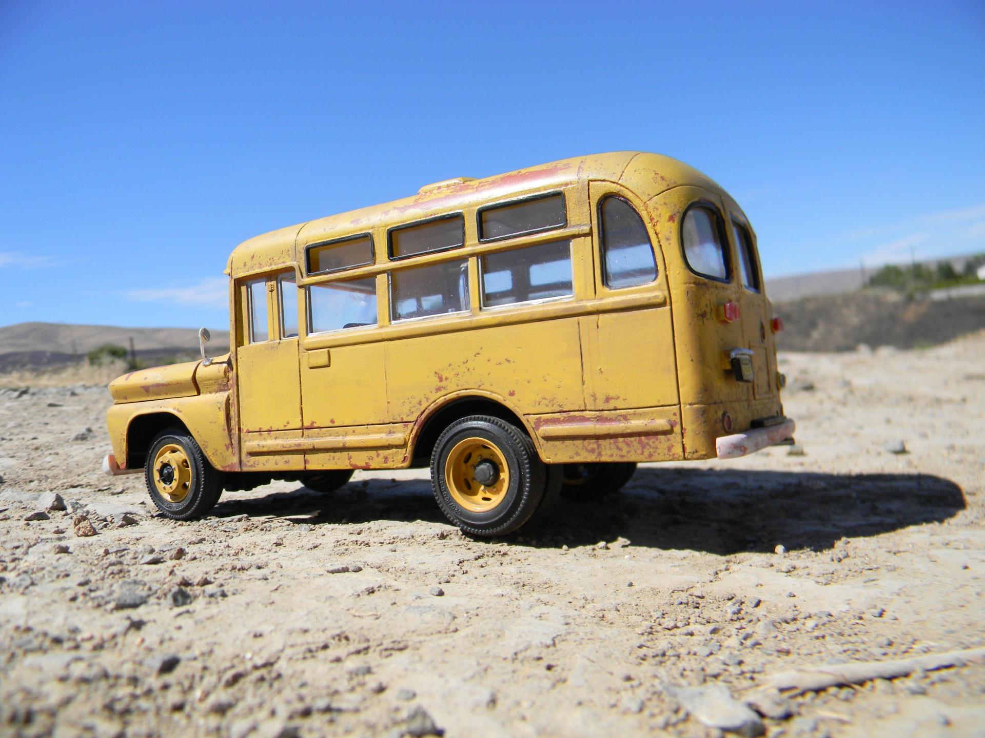

As for the 1:32 Bonnet Bus, it would be OK, but it is a bit too narrow. You would need to buy 2, and section them in the middle. This is what it looks like on a 65 Chevy truck, I did shorten it a lot:
