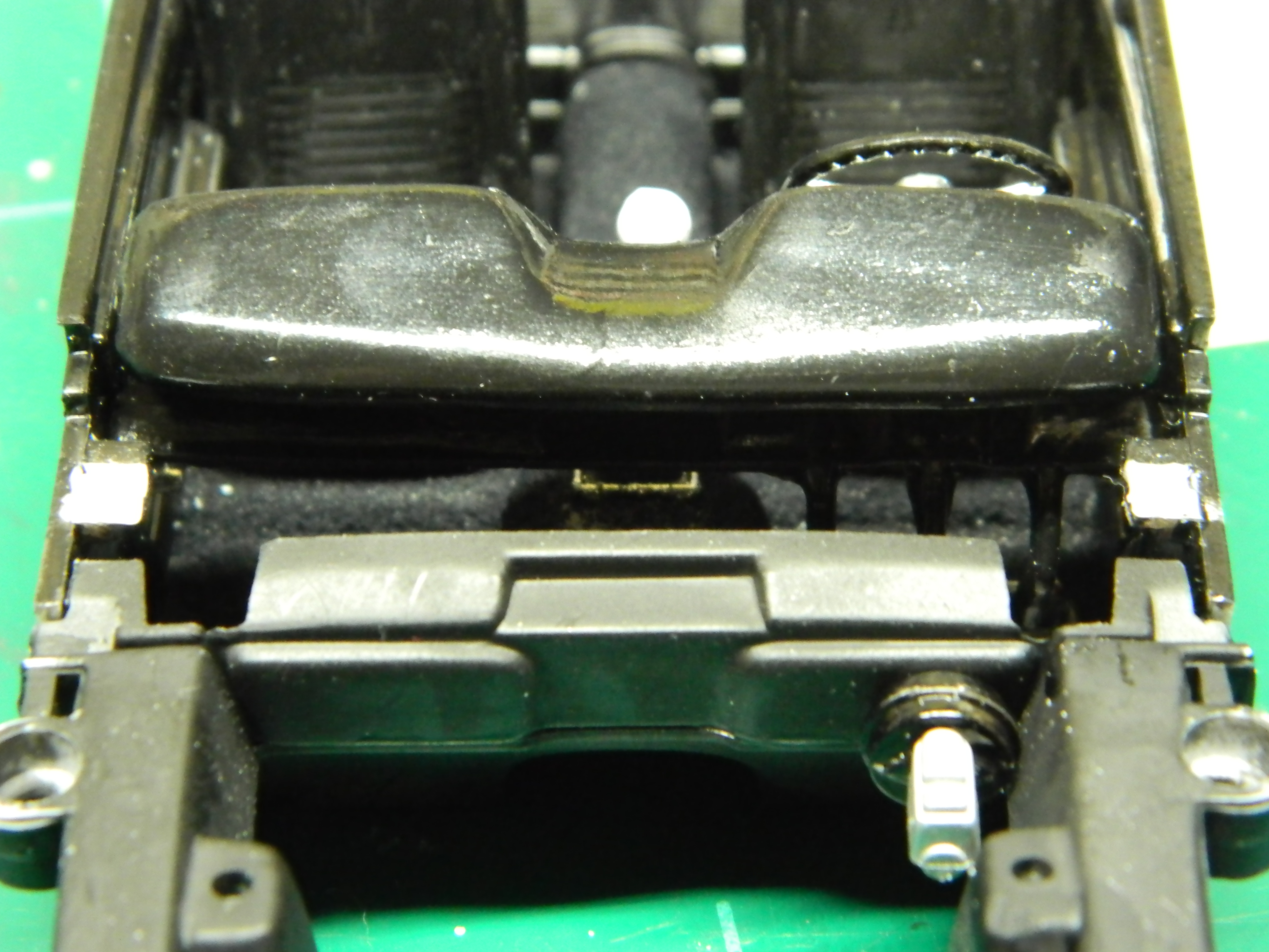

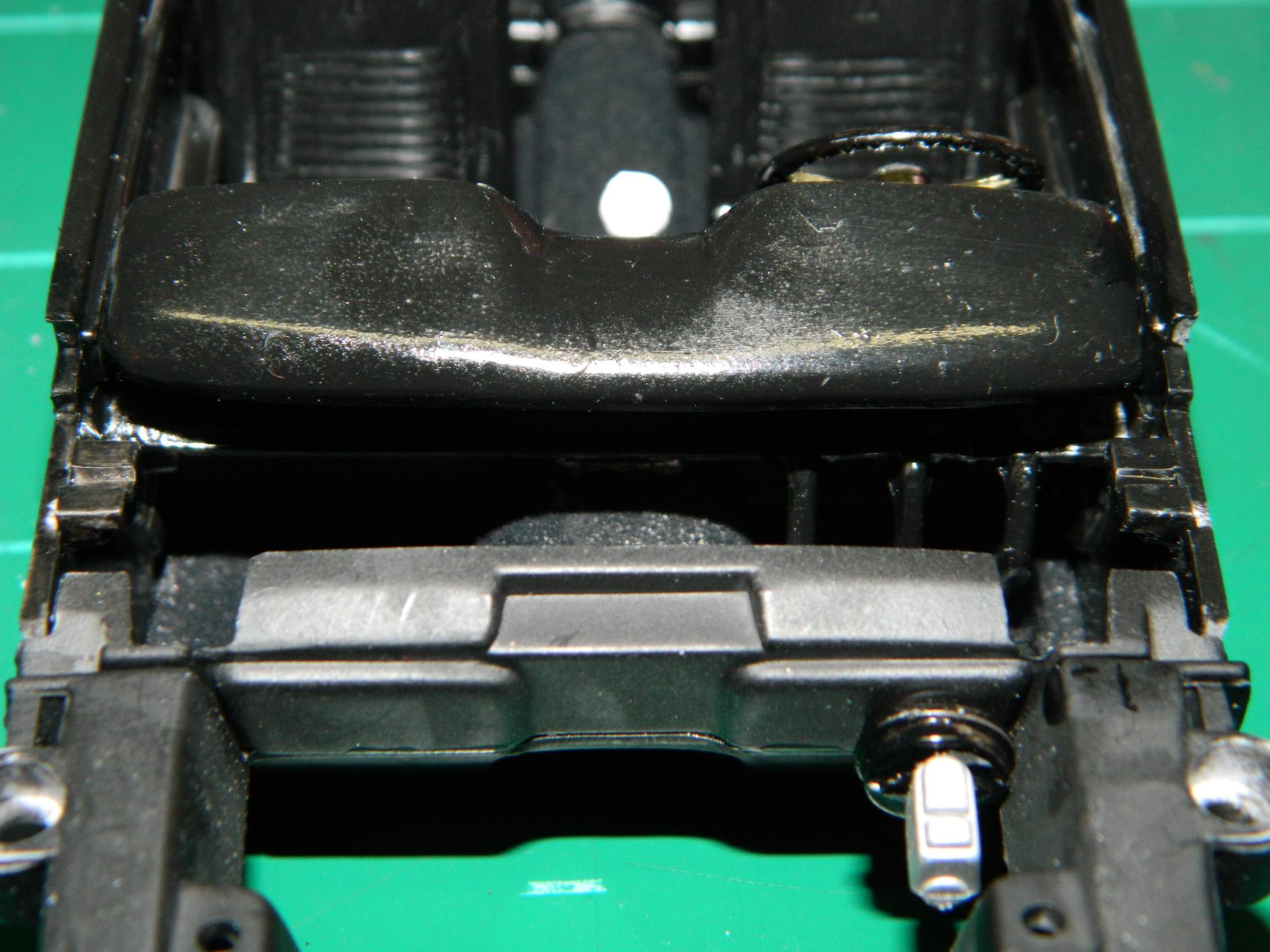

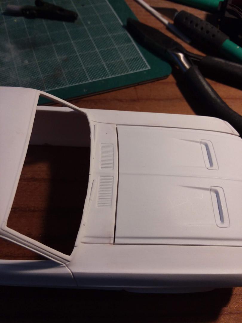

I'm almost finished with the interior, I just need to make some seat belts.   A mockup with the body and hood shows the interior not sitting level and the screw holes have some play in them before the are bottomed out.  I need to modify the hood pin holders on the side panels to allow the interior to sit correctly.  I need to address the rear edge of the hood and the edge of the cowl.  This should be even all the way across from one side to the other.

Yes that cowl needs a little work .

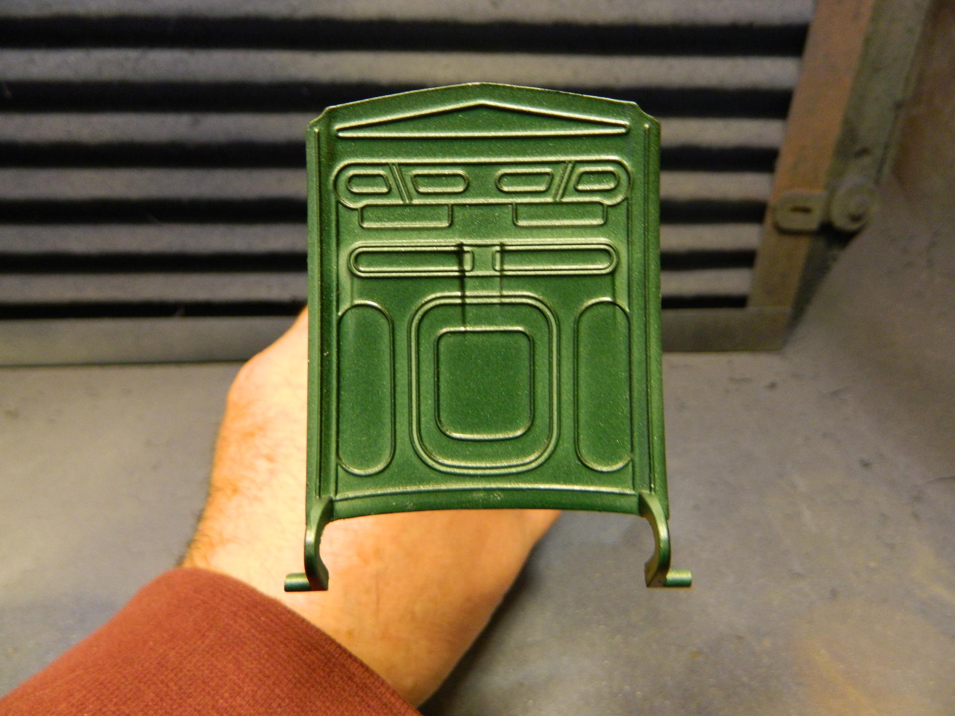

I remove all the screw mounting points and sanded the tops of the inner fenders to get it fitting better.

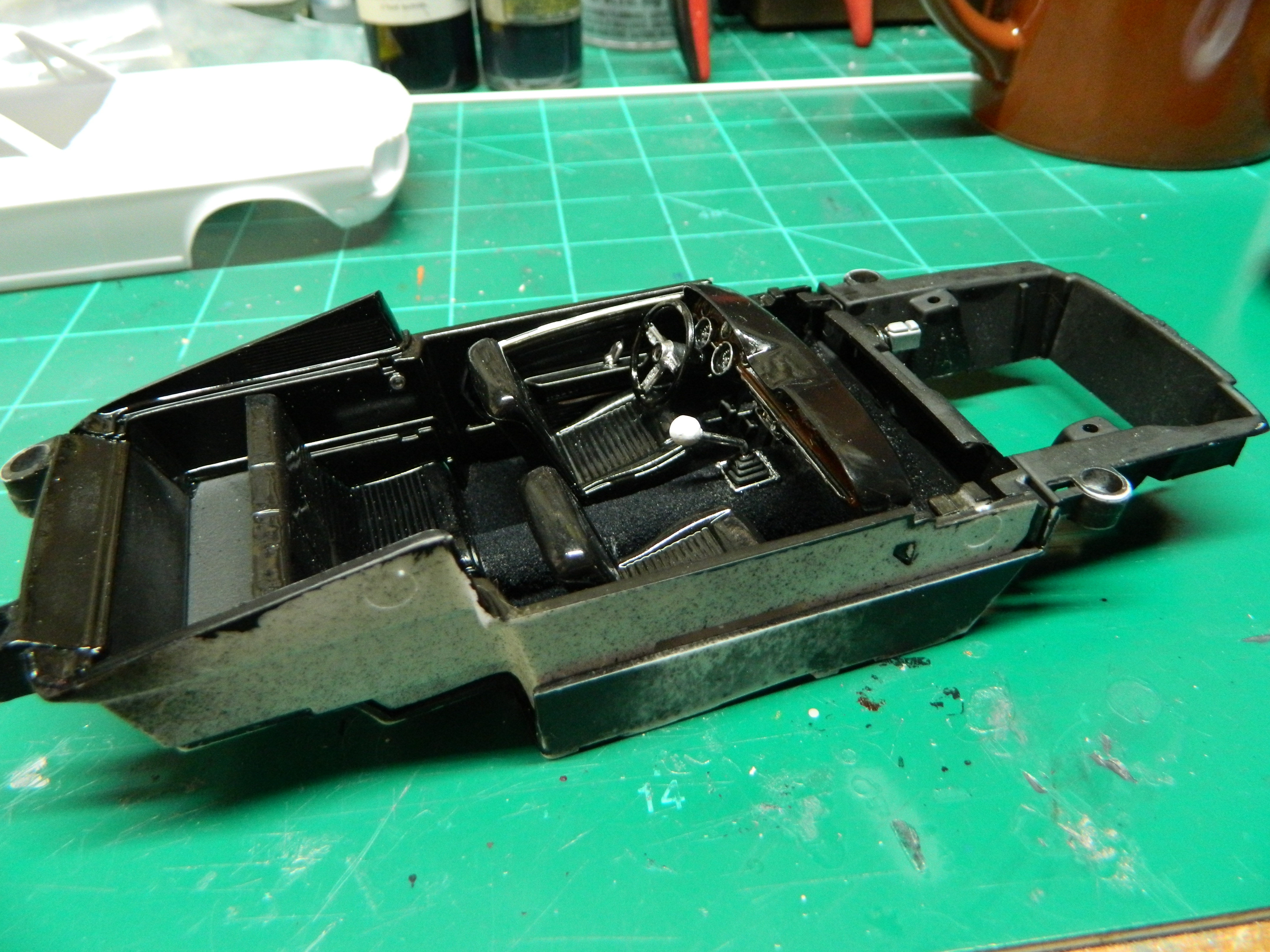

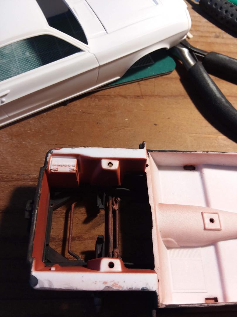

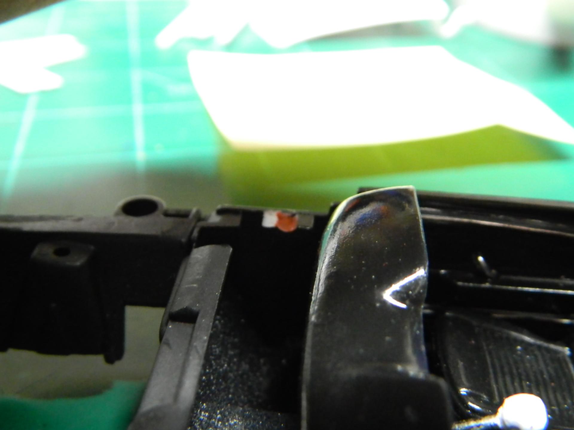

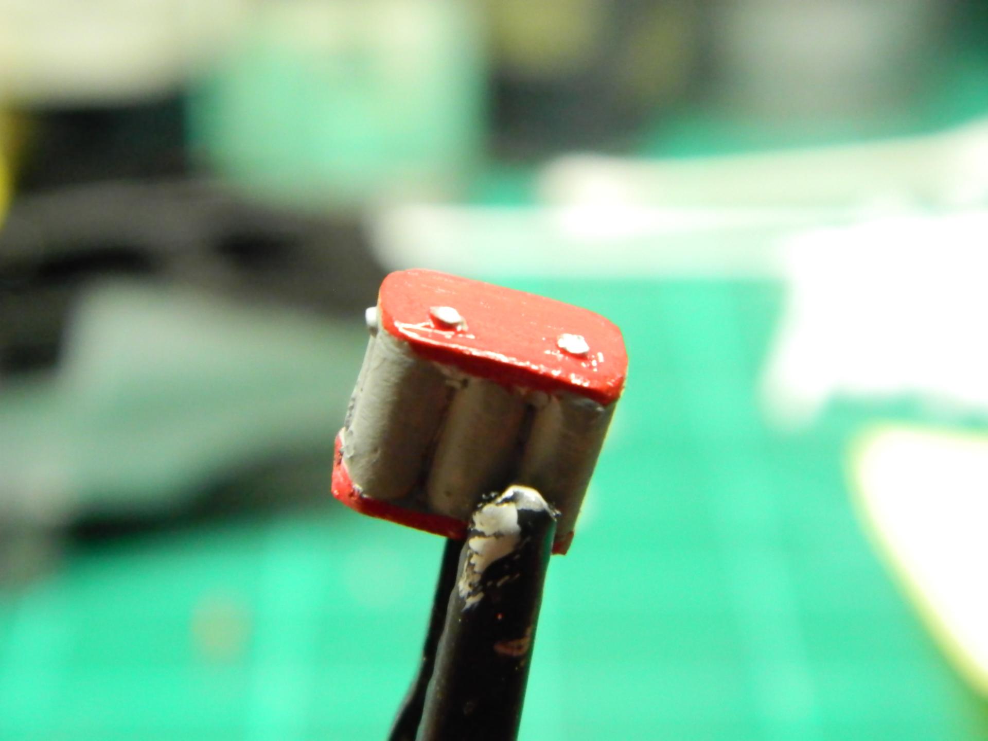

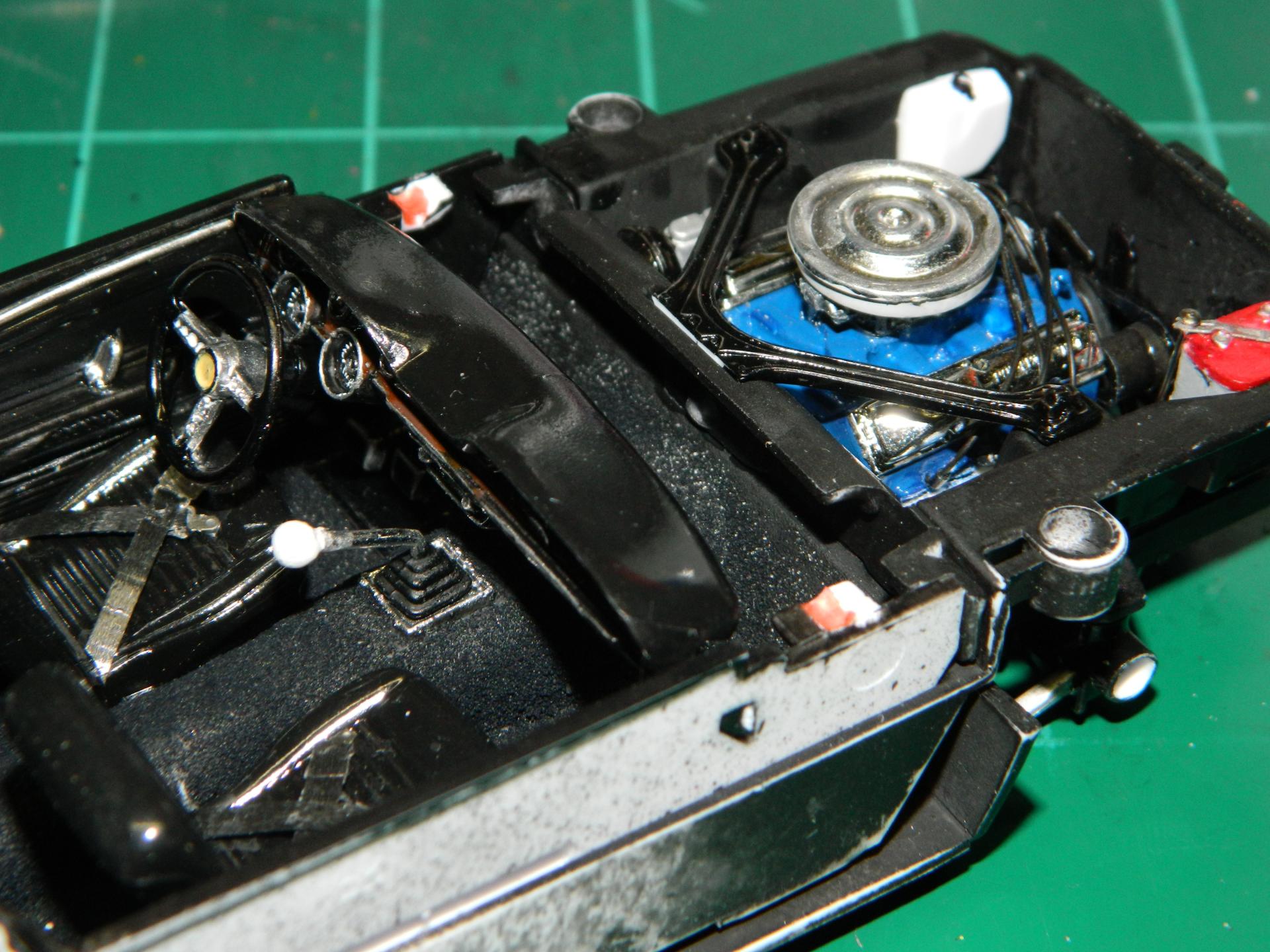

To get the interior to fit better, I removed part of the hood mounts on the interior side panels.  I also deepened the grooves for the hood (highlighted in orange) with a Dremel and a small grinding bit.  This is tight enough so the hood now stays up on it own.  I got the Optima battery painted and now it is ready for the photoetch pieces and mounting.

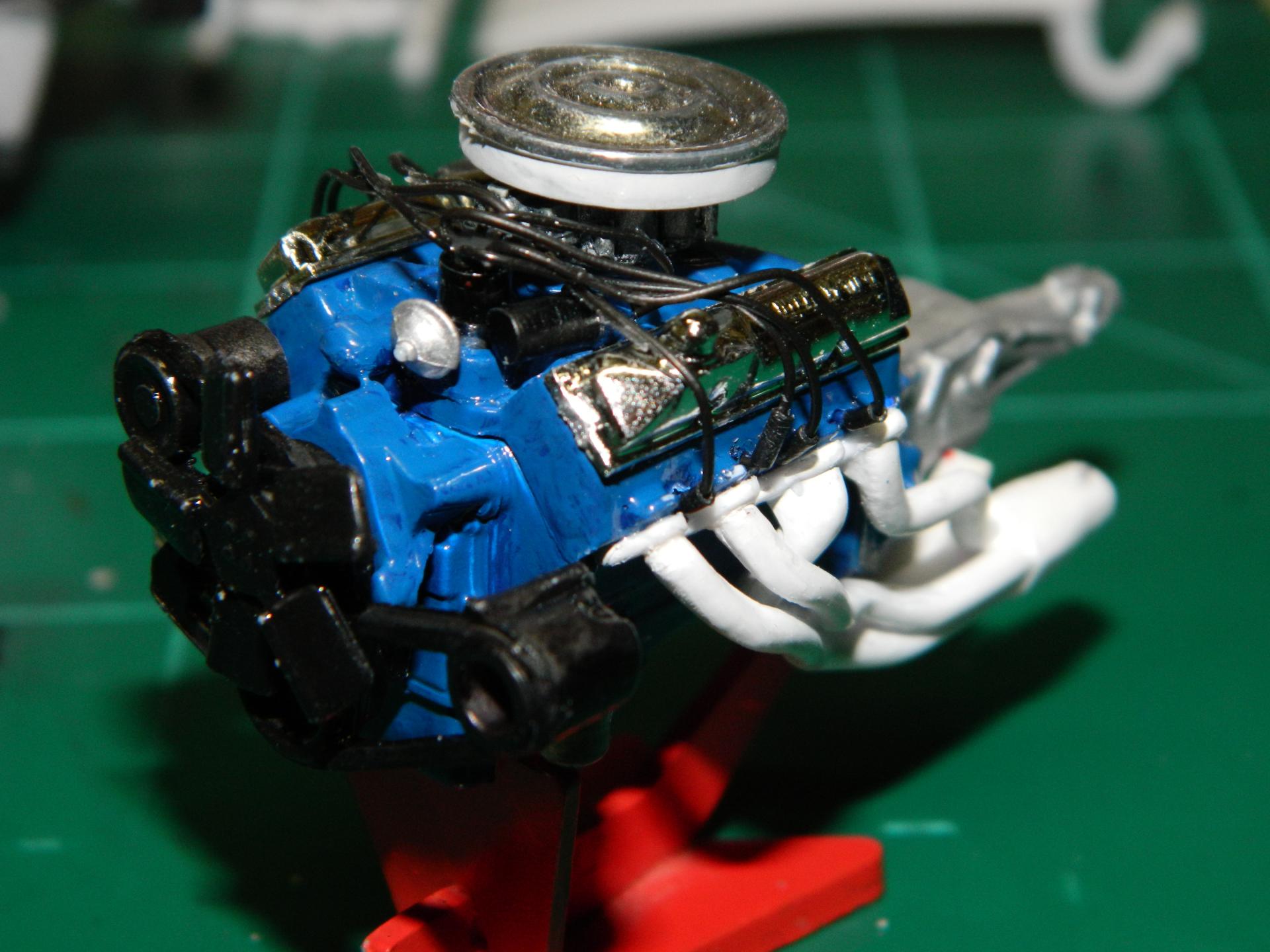

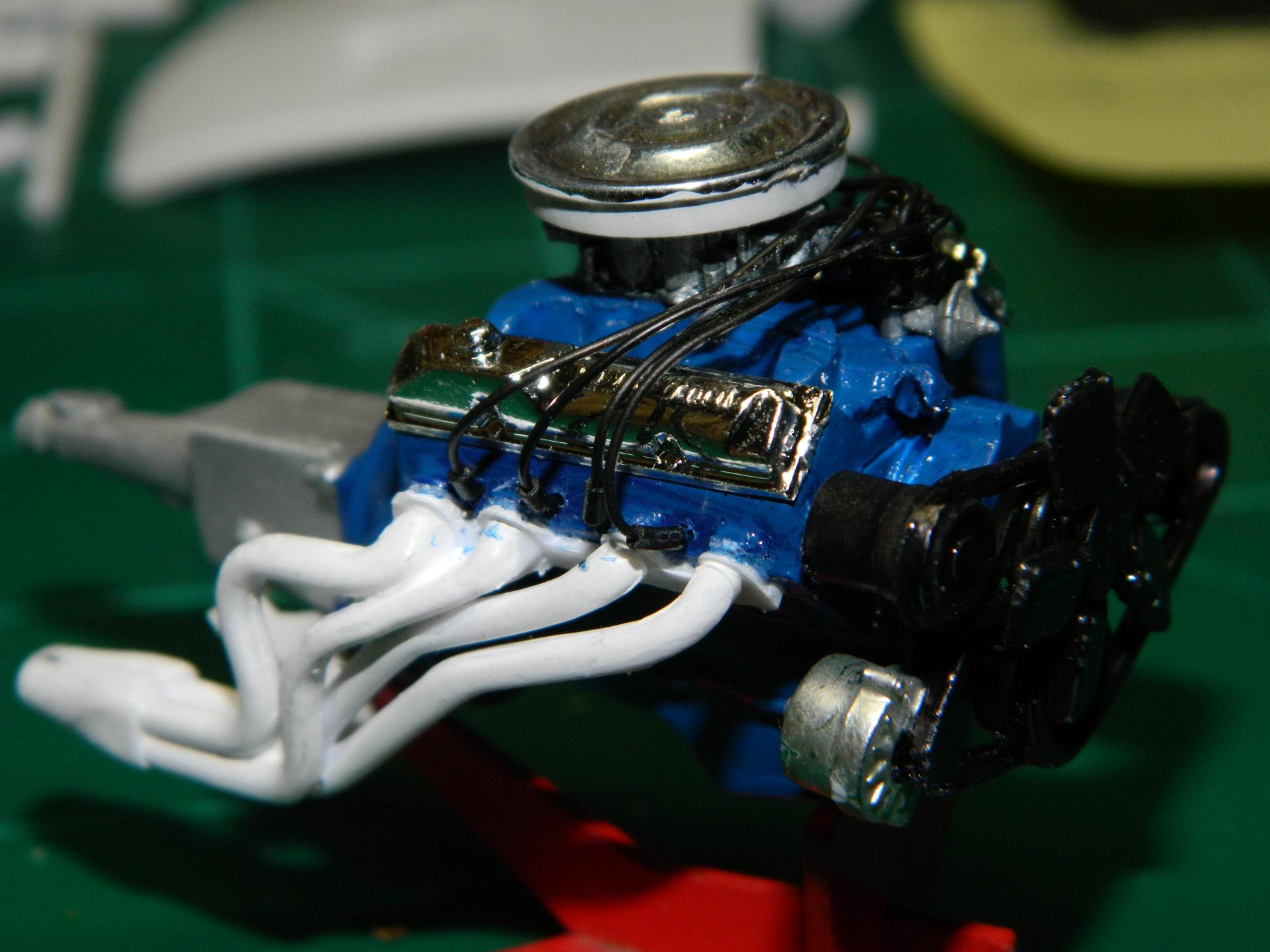

I added some more detail to the 390 CID engine and I may add more.

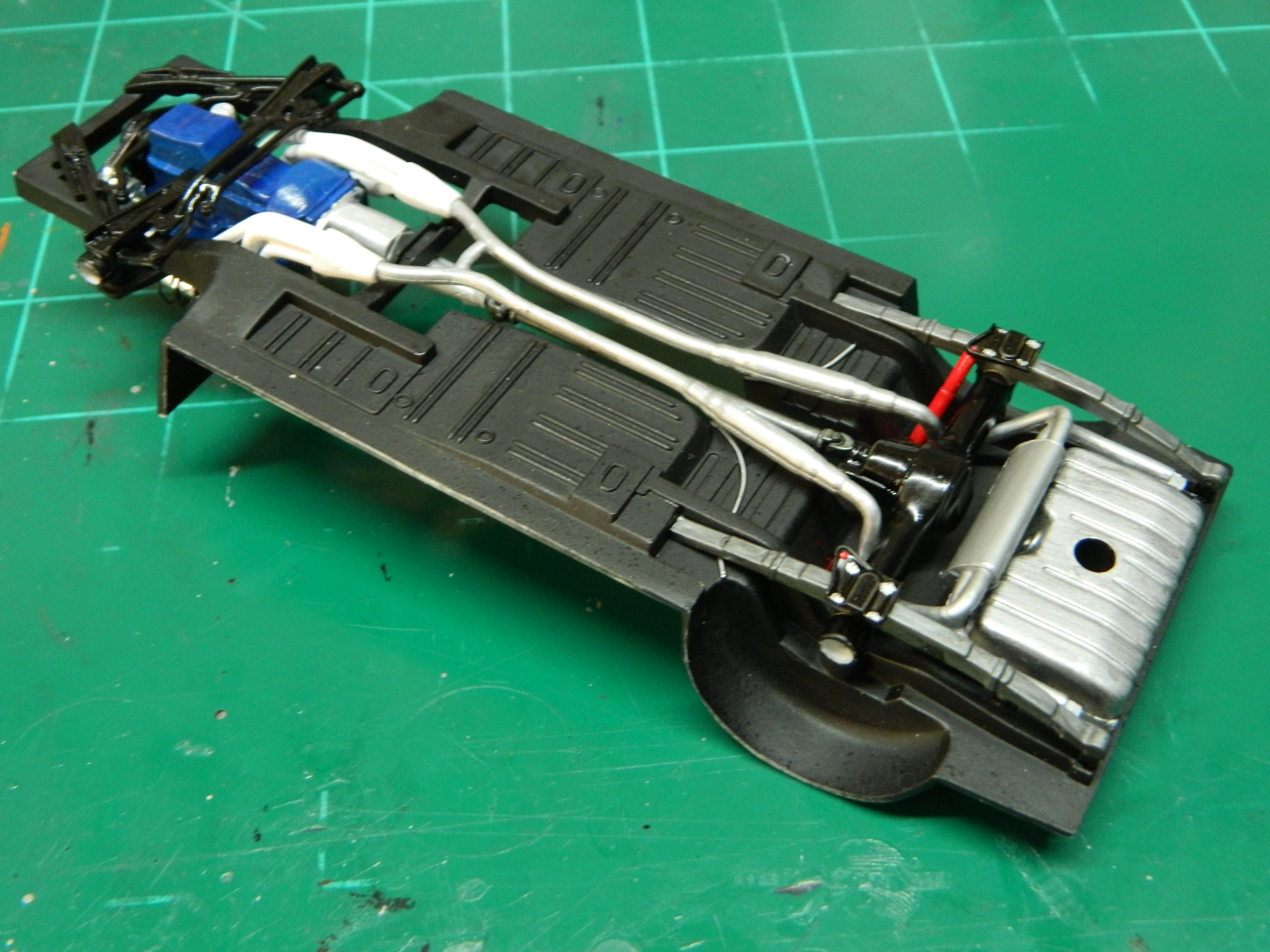

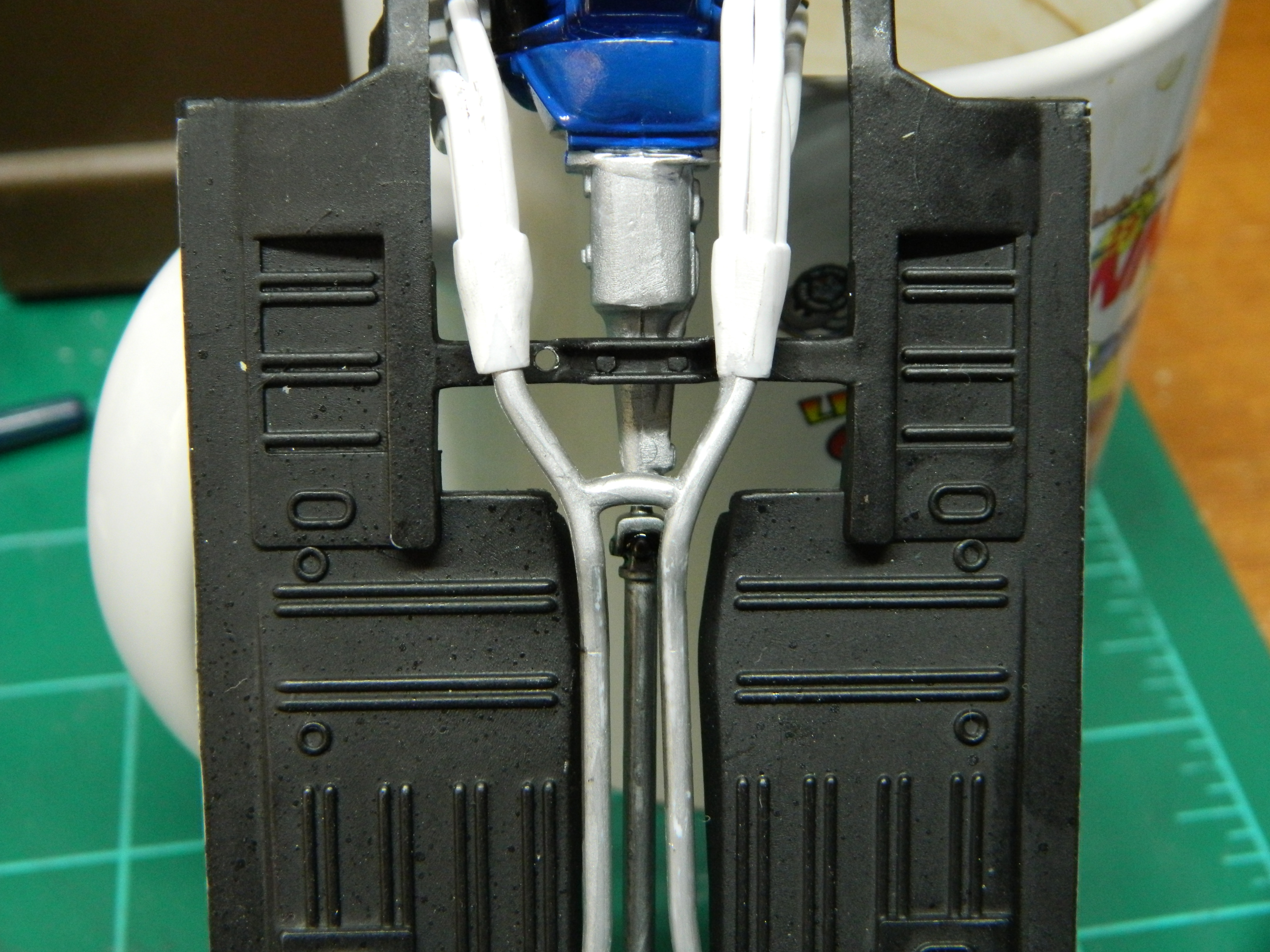

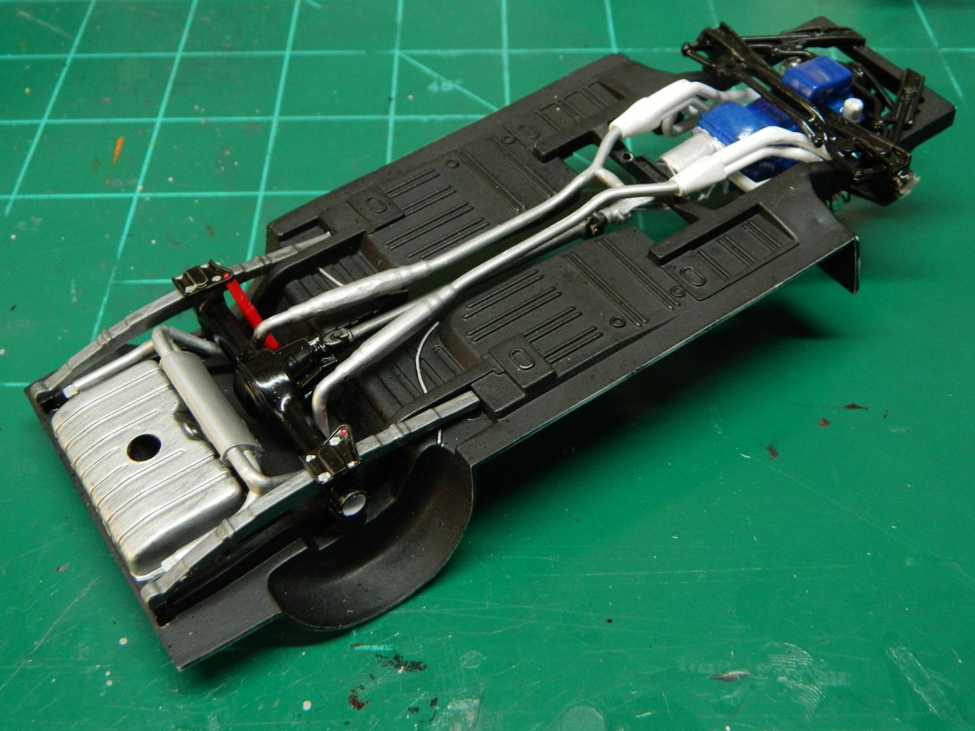

I sprayed the chassis with Tamiya TS-6 matt black and brush painted Tamiya X-18 semi-gloss black bottle paint and Model Master Metalizer Stainless Steel and Aluminium on the suspension.  I highlighted any details with brush paint and a fine brush and I may do more detailing.  I was able to keep the H-pipe that Marcos Cruz deleted from his model.

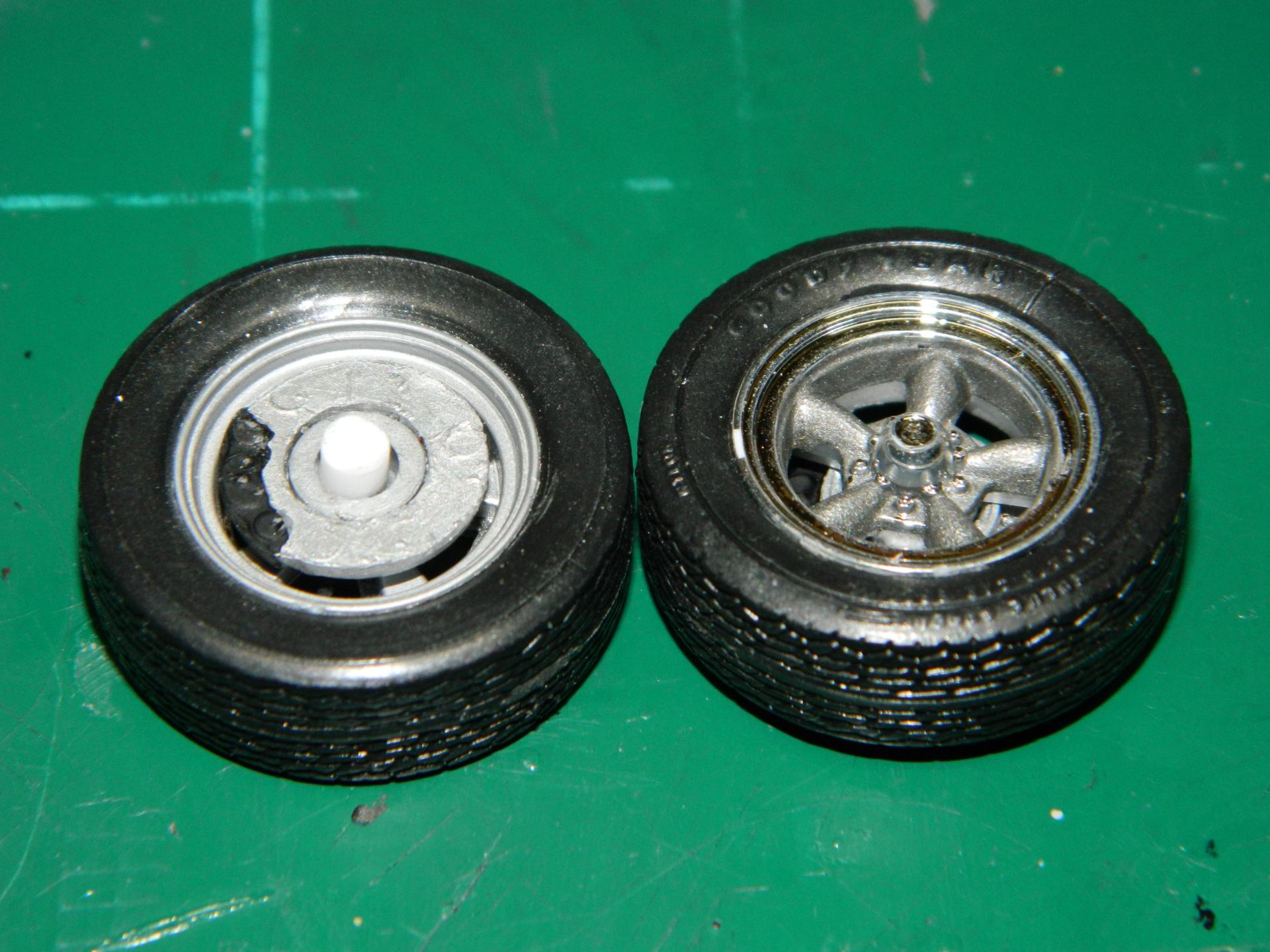

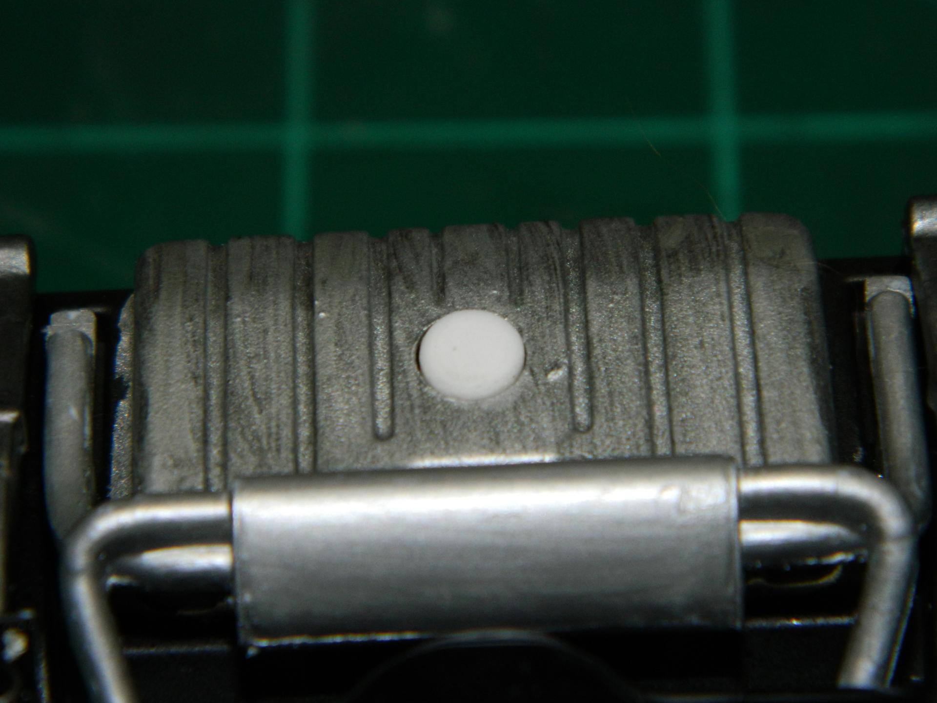

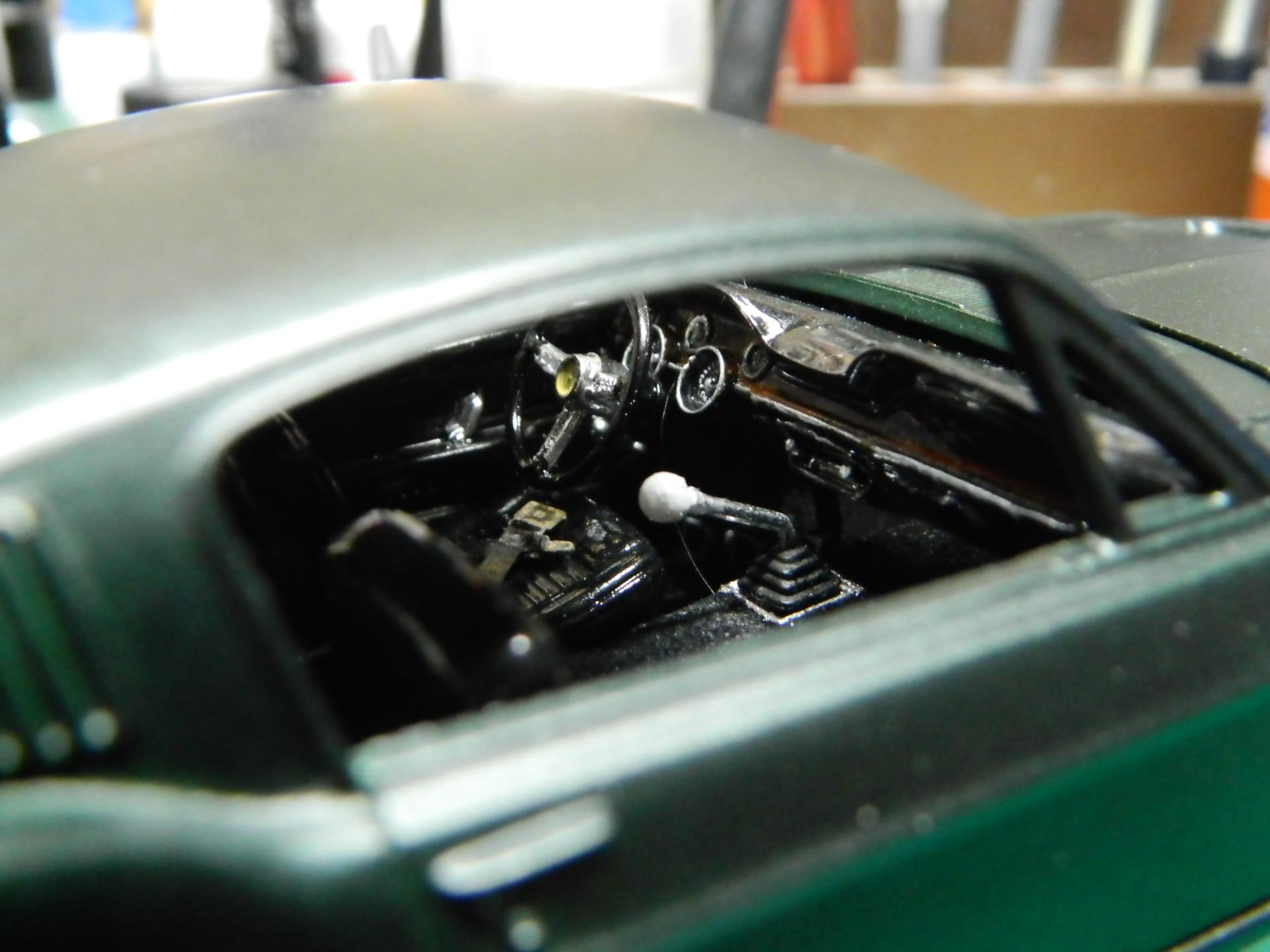

I did some digging around a found a set of wheels and tires from a Revell '32 Ford that would work with this Mustang.  I kept the front disc brakes and painted them aluminium with flat black calipers.  I've been adding detail here and there to the chassis and I made a set of seat belts for the front bucket seats.  One of the things about this chassis that I don't like is the screws used to hold the chassis and the interior in.  I found a piece of round styrene that will fit the screw hole and cover the screw when all is assembled.

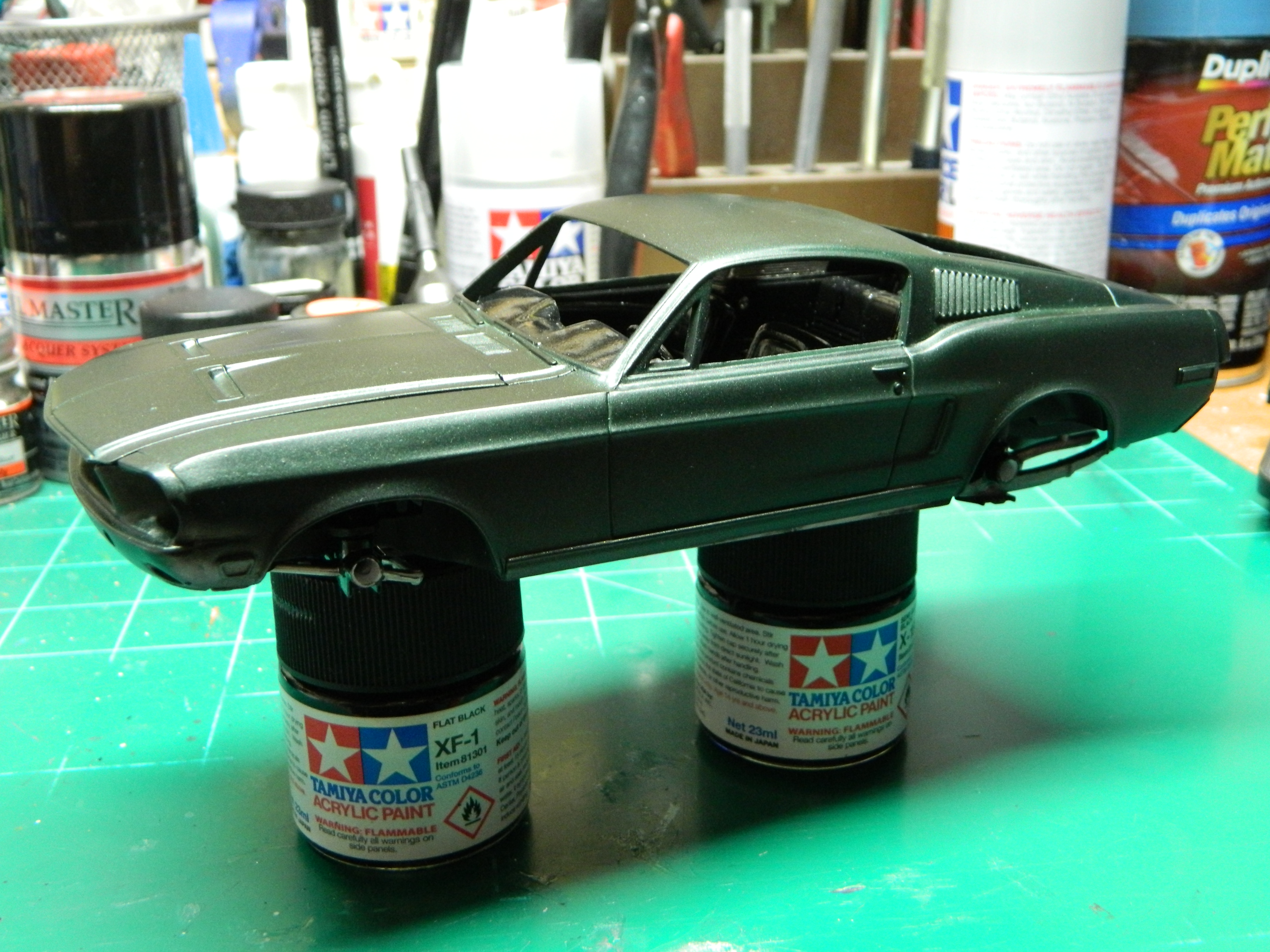

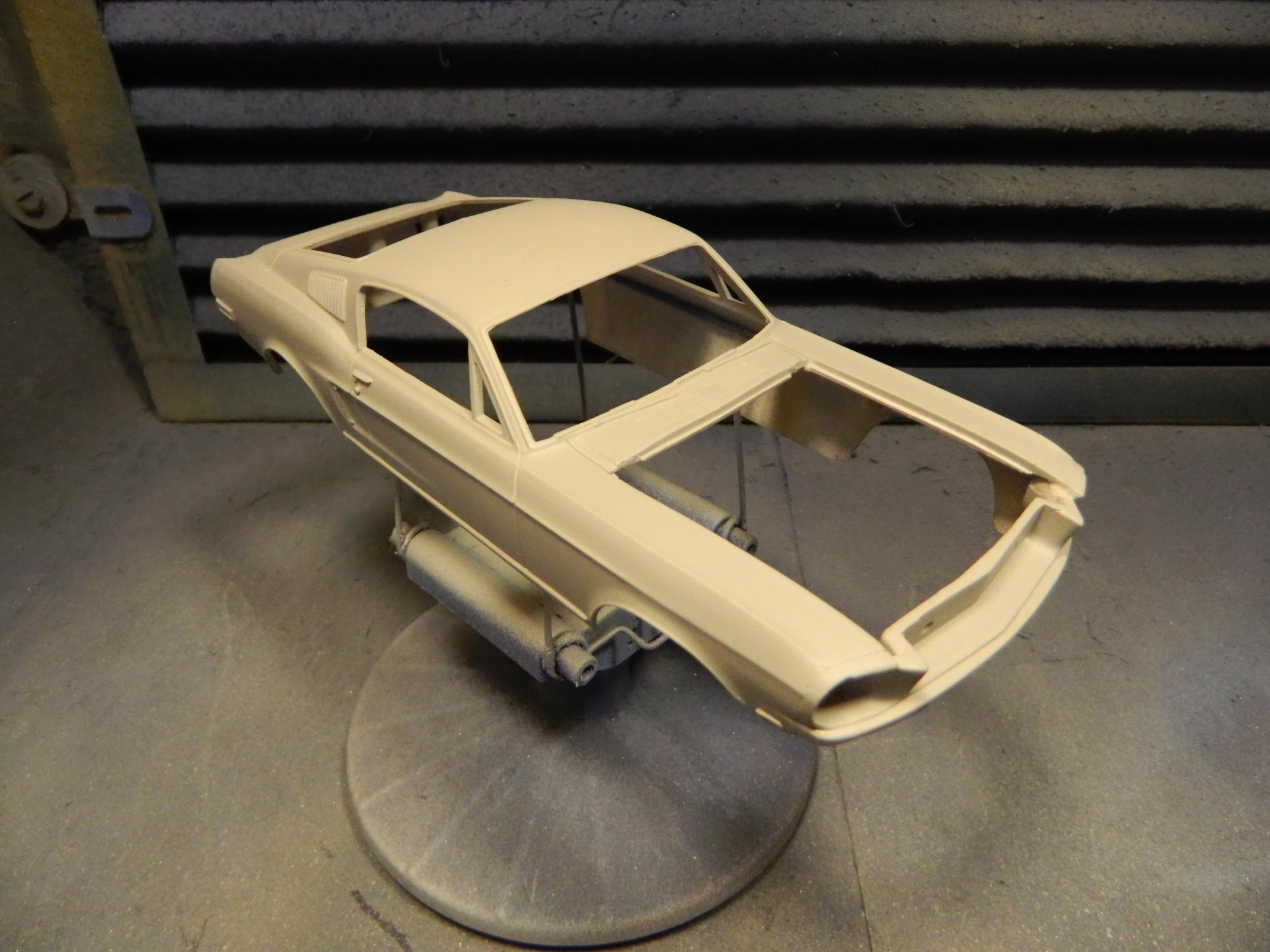

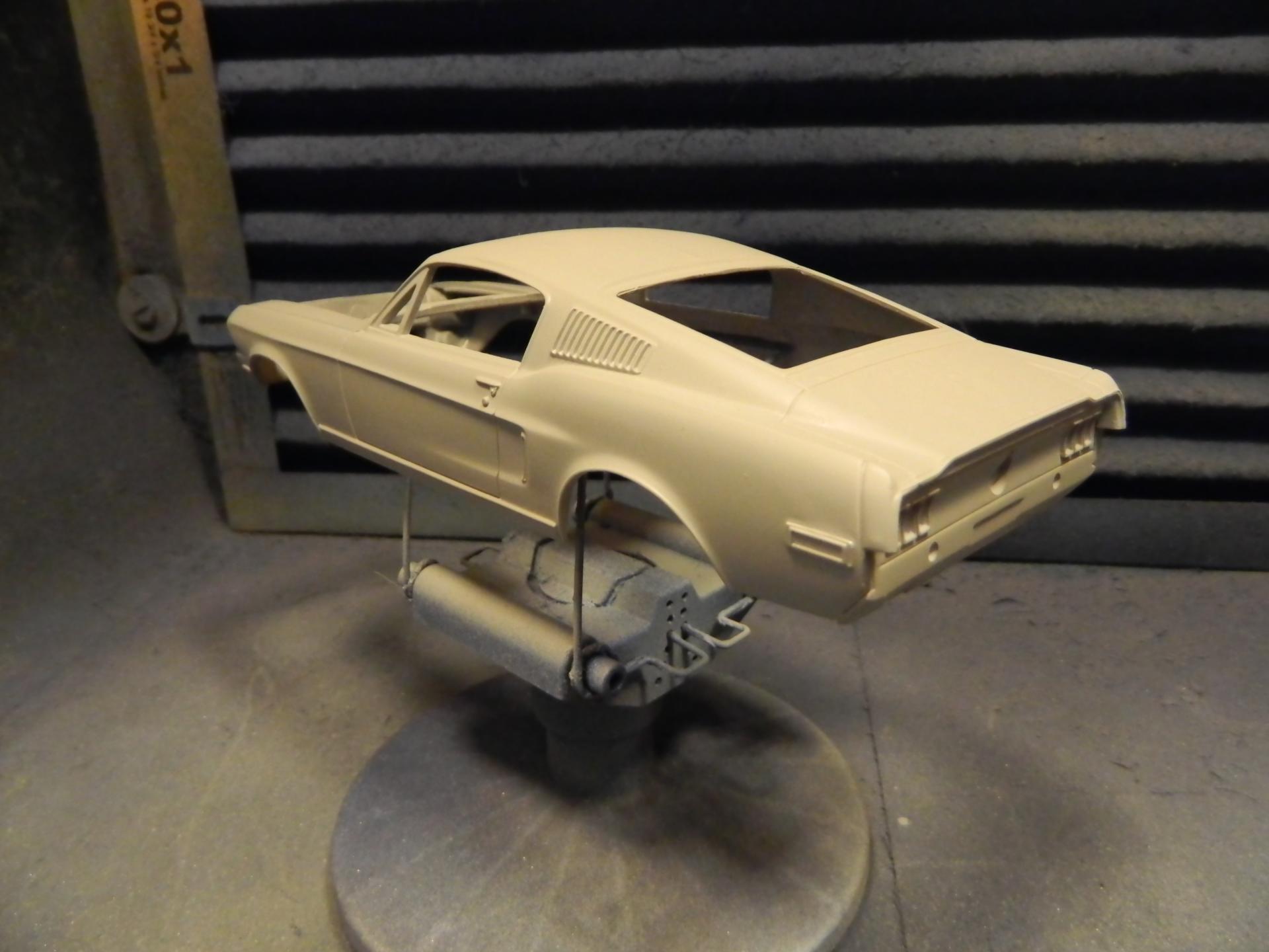

I finally got the Bullitt Mustang into a couple coats of Tamiya Grey Primer.  I have a couple of minor blemishes to sand out.  The hood was also primered and I usually start spraying paint under the hood to see how the paint will react.  This is my first time using Scalefinishes paint and it sprayed out very nicely.  I thought that the color might have been too dark, but this is very close to what I was hoping for.  A couple more coats and the color will be perfect!

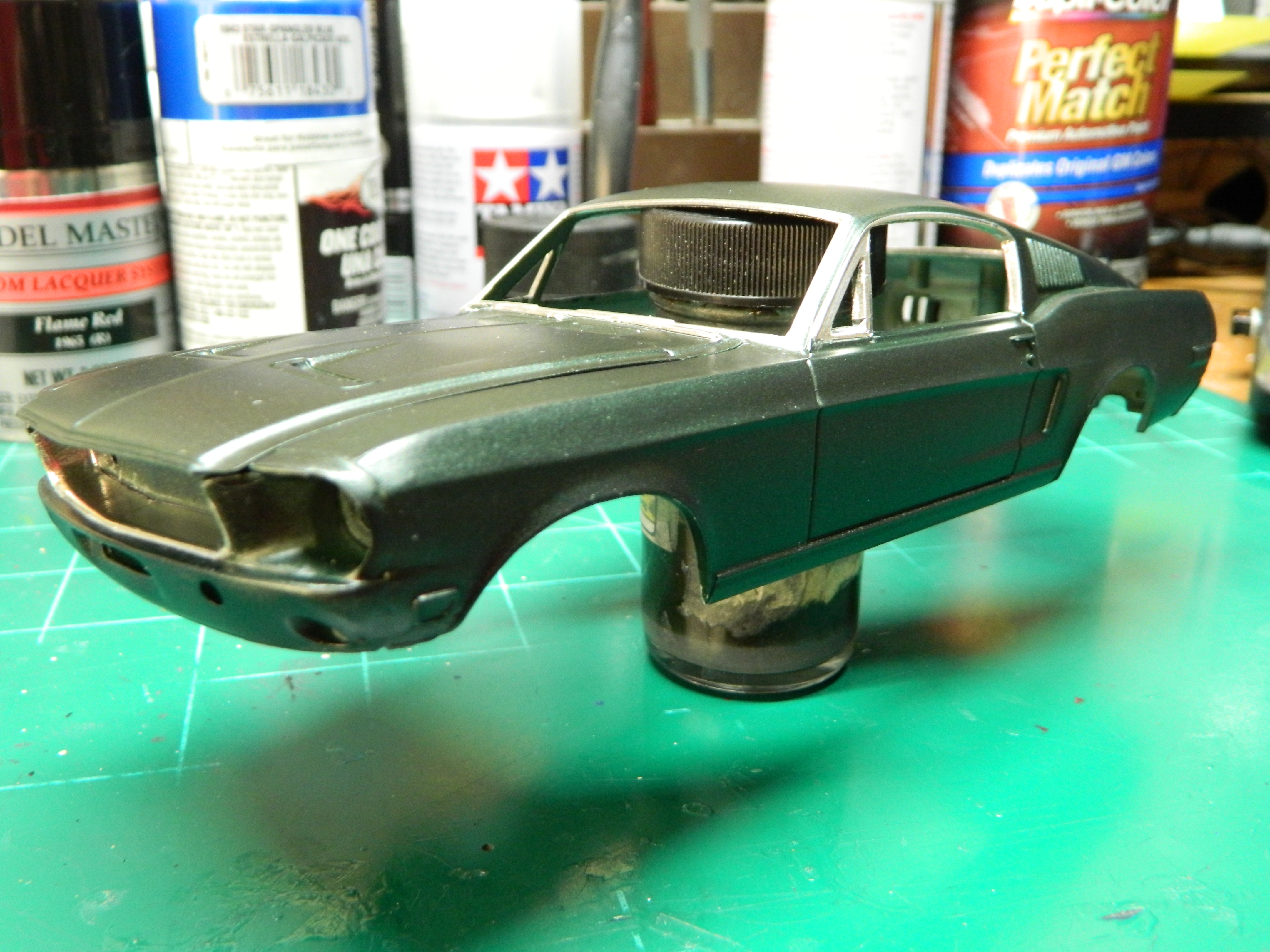

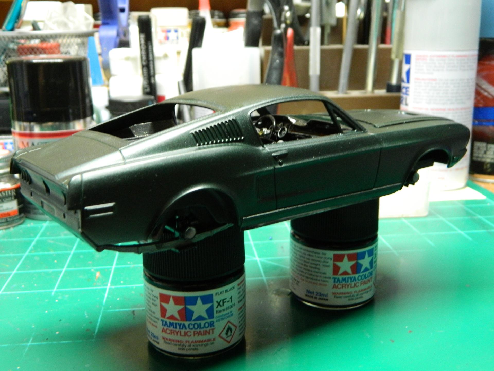

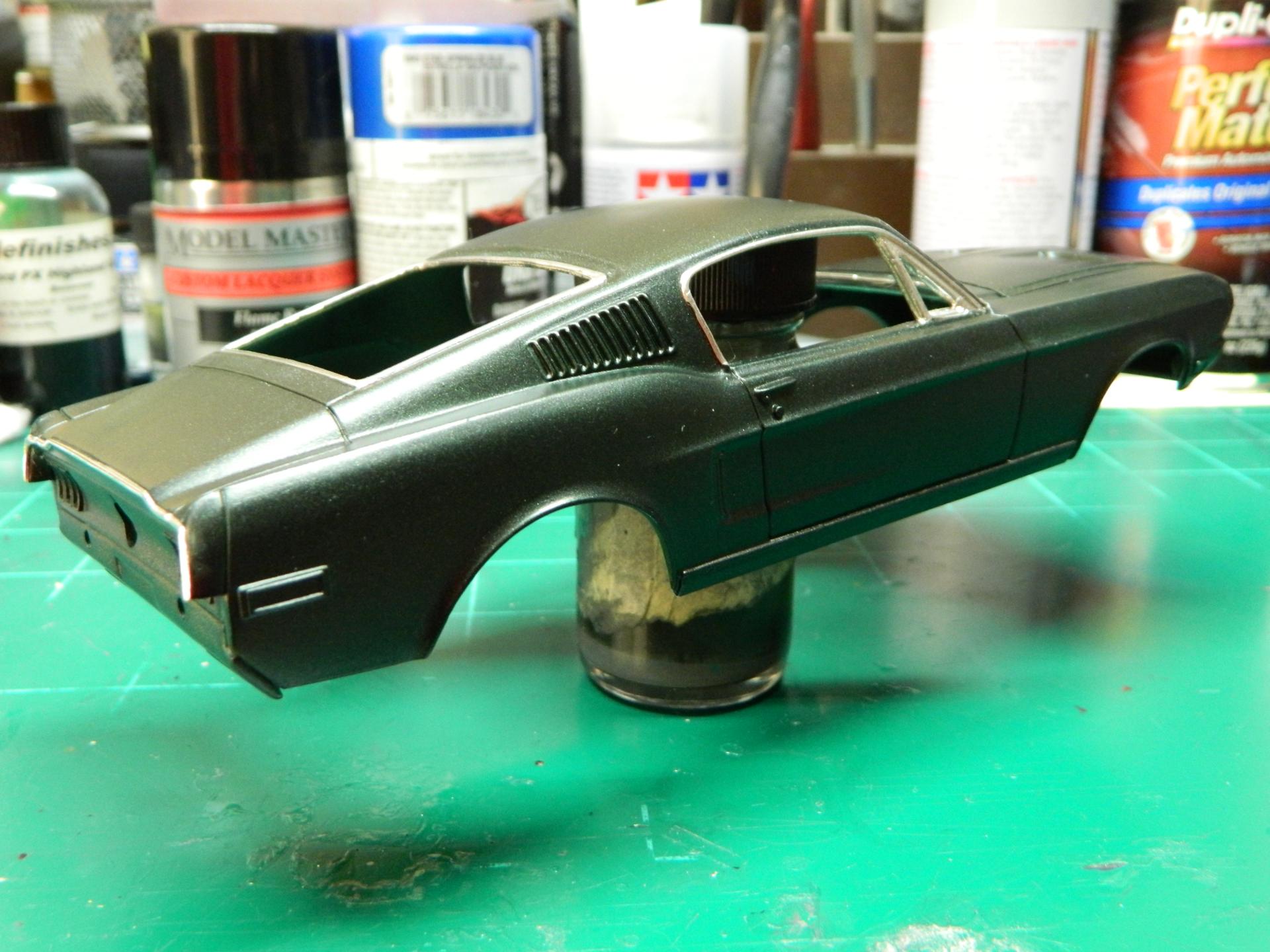

I got the body painted and now for a little cleanup of some trash that found its way into the paint.  If I sand the finish, I'll have to repaint the body.  If I can remove the trash with my fingernail, I may not have to repaint.  We shall see.  A view of the interior.

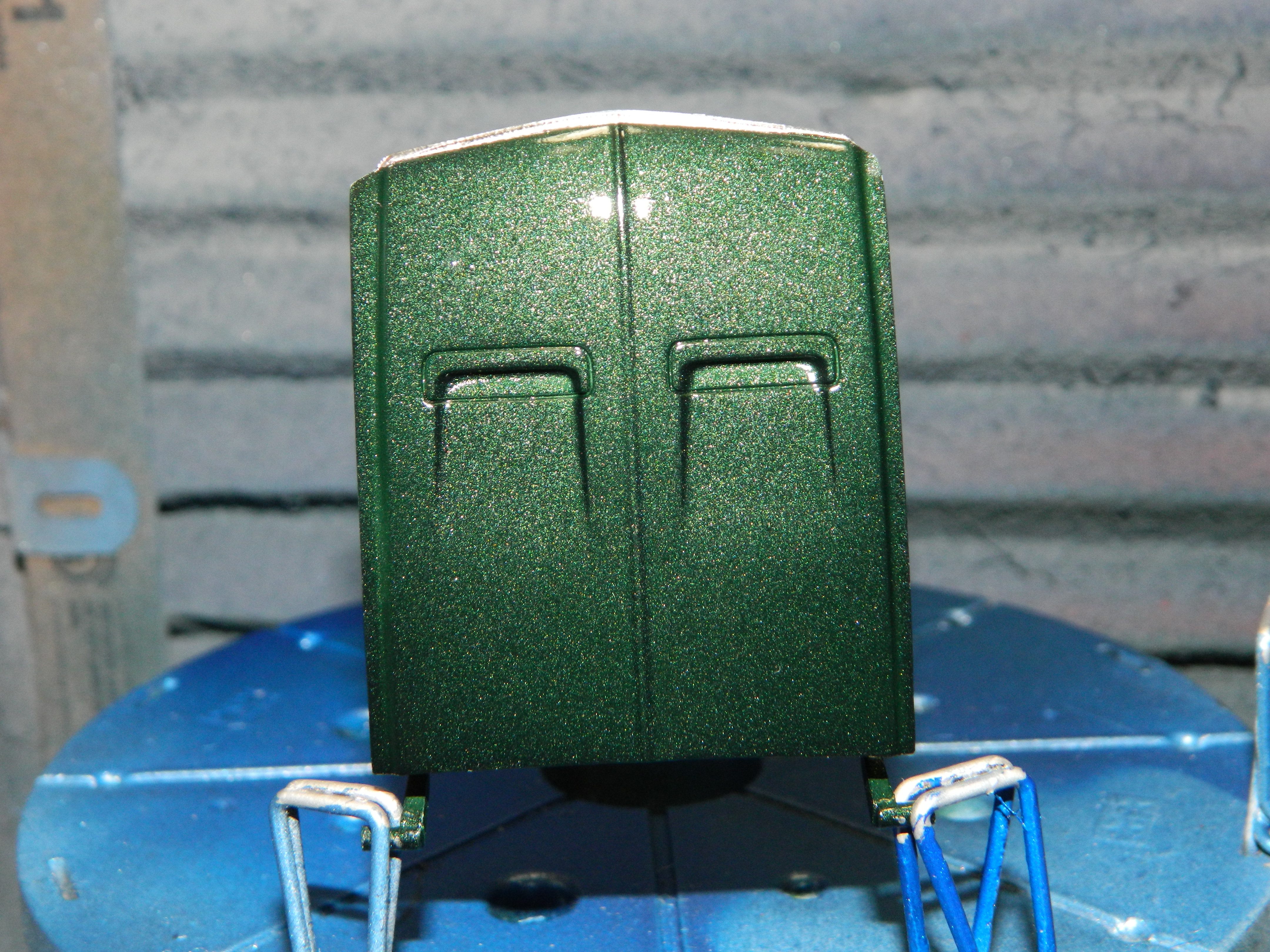

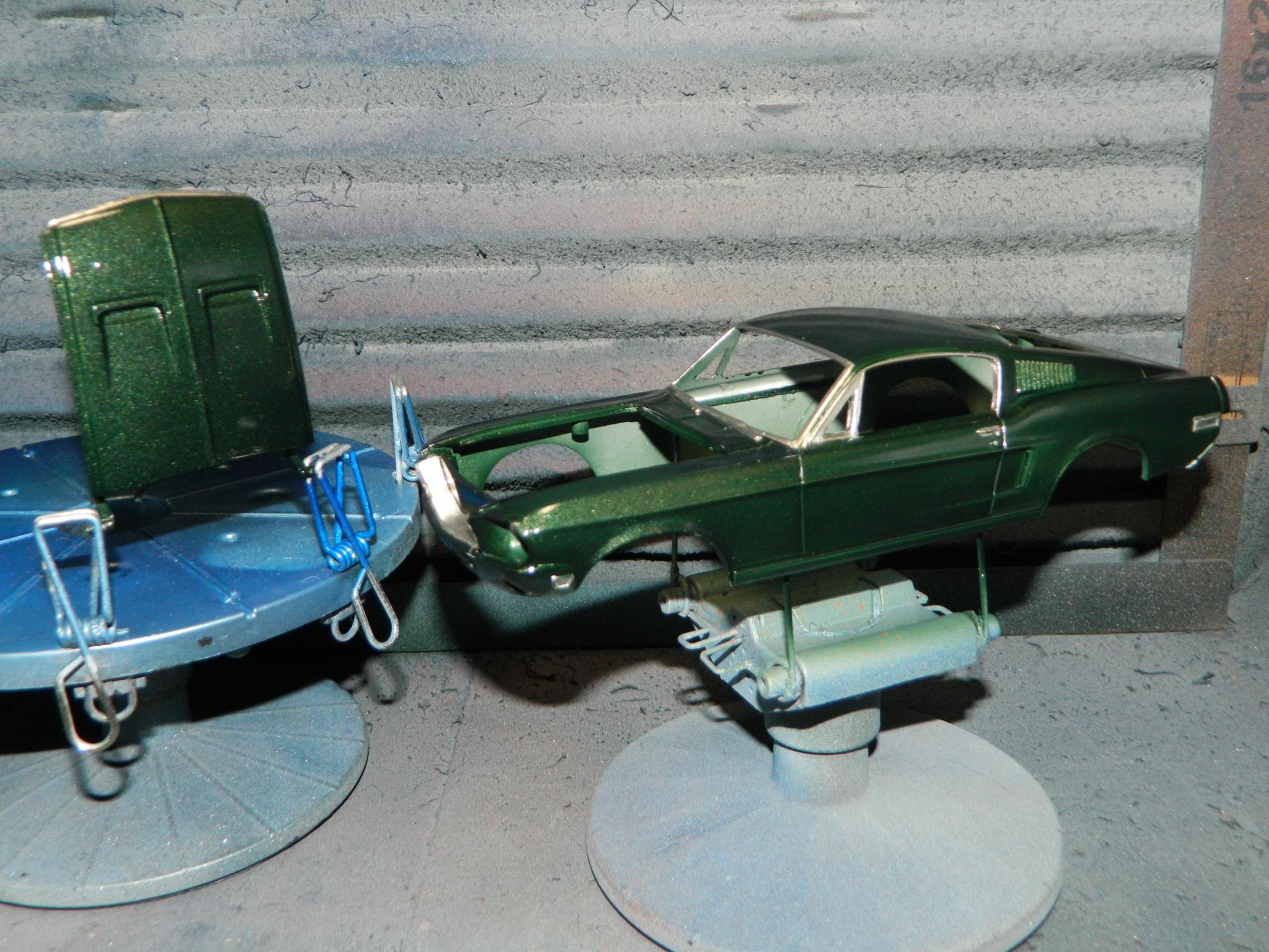

I fired up the paintbooth for some clearcoating this morning.  I got two mist coats, one medium coat and one wet coat of clear on.  These will be going into the dehydrator shortly.

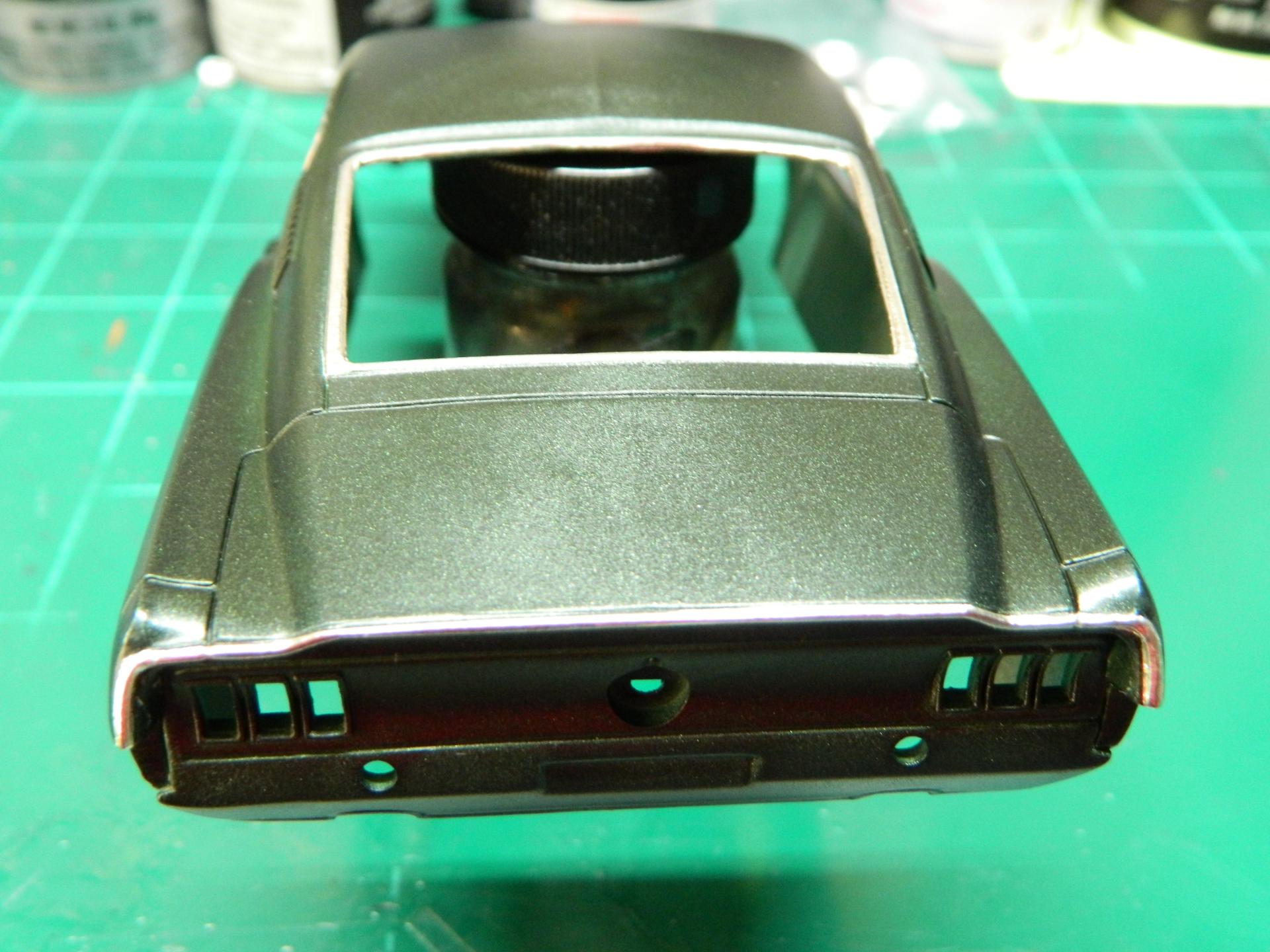

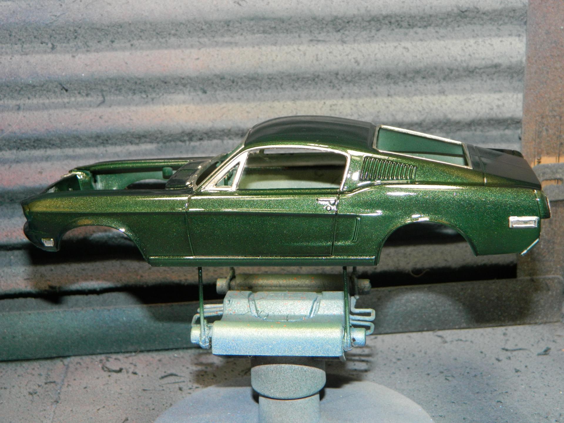

Douglas, I hope you can see that my Bullitt Mustang has been painted with Highland Green Metallic paint from Scalefinishes.  Thanks for the tips!
