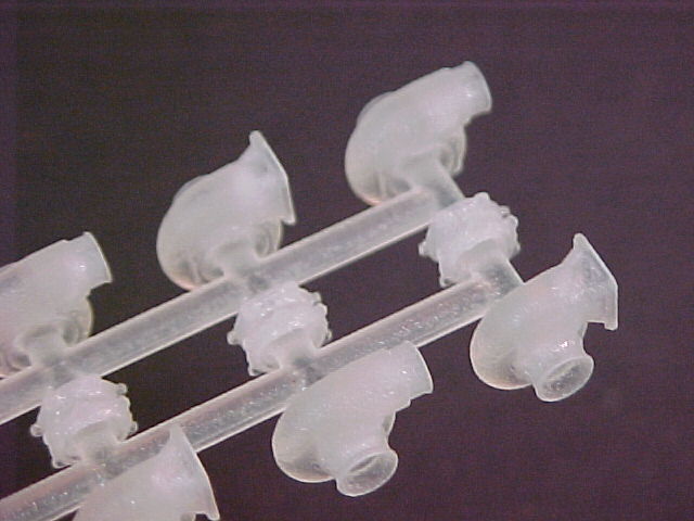

I modeled these in 3D CAD and had Shapeways print them. Need a nice pair of turbos for a Pro Touring project I am bubbling up. I did a set "mirror image" so I can build them symmetrically in the engine compartment. I also made them three pieces so the inlets and outlets can be clocked for easier orientation. to get the pipes pointed in the right directions.
 When I model parts I am going to print for model building I model them full size, 1:1. I can then scale them down to whatever size I want. 1/25th, 1/16th, even 1/12th or 1/8th. The detail starts to go away at the smaller scales but the bigger ones, 1/16th and above will show everything.
Any comments or suggestions are welcome.

Yes Sir. Modeled from a few pics I used for reference. Took me a couple of hours from start to finish. Of course I have been using CAD programs for over 30 years.
Sizes are relative based on the 3 and 4 inch pipe used to plumb the inlets and outlets. I basically just made them look correct. :)

Admirable product . I build Factory Stock . I am not tempted .Impressed , not tempted .  Thanx

  Mark, this stuff looks great!  Those turbos look to be about the
best example of a turbo set up that I have seen so far!!
  But to put them here, and not offer them up for sale!!?!!
Shame on you, that's just mean!   LOL!!
