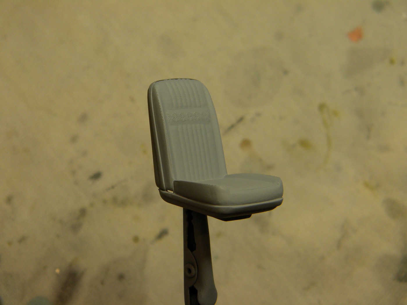

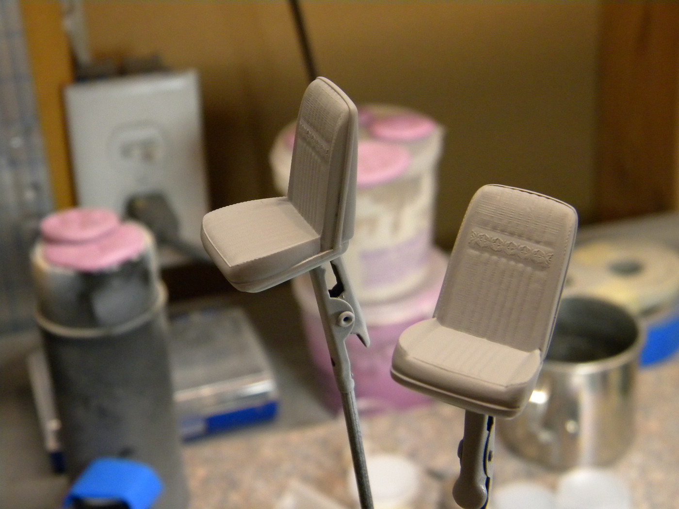

Well, I managed to get the seats done & ready for paint.
I am now in the process of removing the molded in arm rests & window cranks so that they can be replaced.

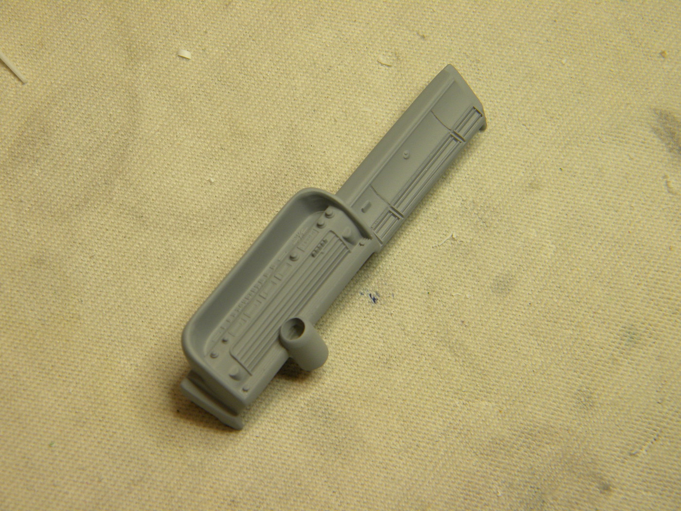

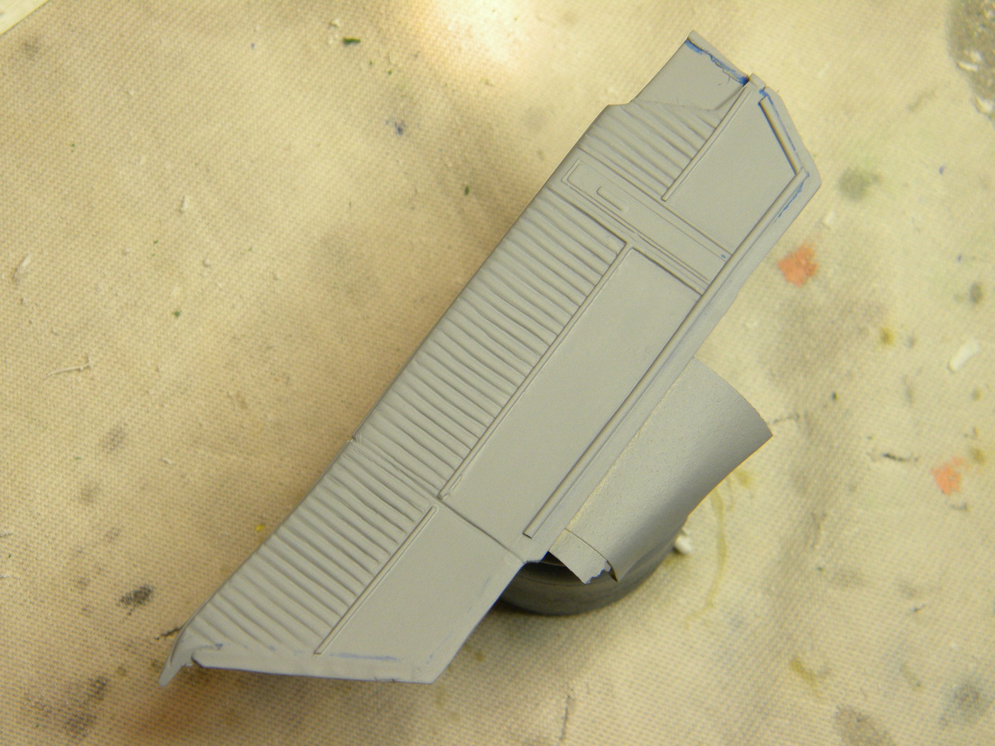

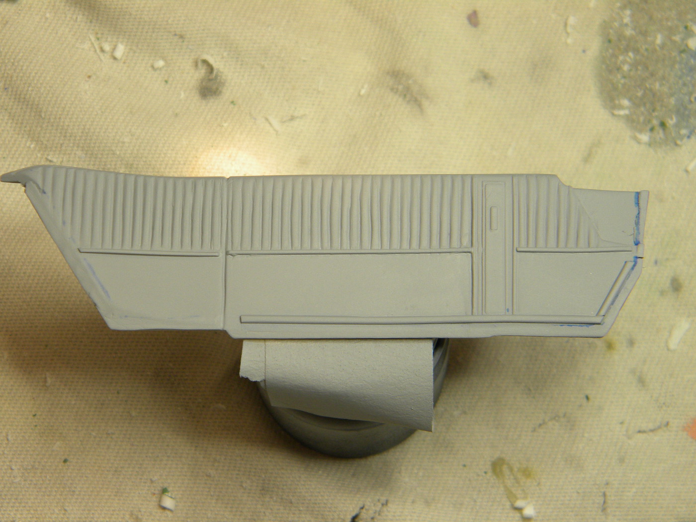

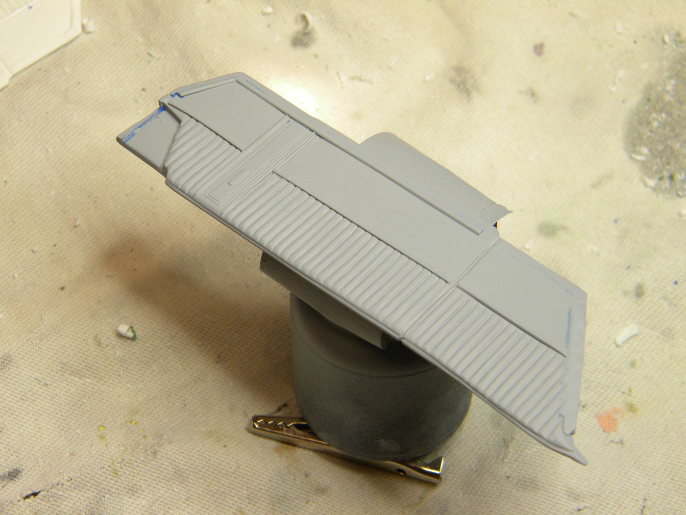

After getting a little frustrated with trying to do some modifications on this interior tub while intact, I decided that I would cut it apart and transform it into a "platform" style interior to make detailing a little easier.
There was a lot more work involved than appears.
First, I had to grind off the obligatory arm rest that runs all of the way to the floor in most of these old kit buckets.
Then the window cranks were removed, which means that the pleats on the door panels needed to be reworked to eliminate all remaining evidence of them.
All of the pleats were re-scribed, deepened & re-shaped for a clean slate.
Then the old trim was removed and replaced with pieces o stretched sprue.
some filling, sanding, scribing and priming yielded a nice fresh panel to be detailed.
I will add a set of arm rests cut from an AMT '67 Cyclone's door panels, a door courtesy light, and a set of window cranks shaved from some other door panels when it's time to finish.
Need to finish the other panel & then a few mods to the dash and steering wheel and they will be ready for paint.

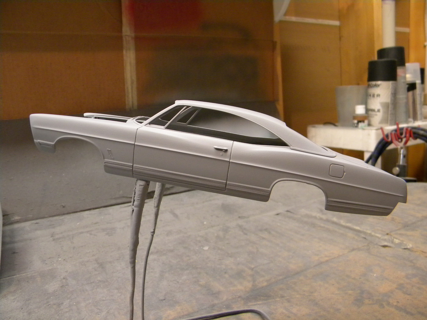

Body has had any modifications basically finished and is about ready for primer.
Steve

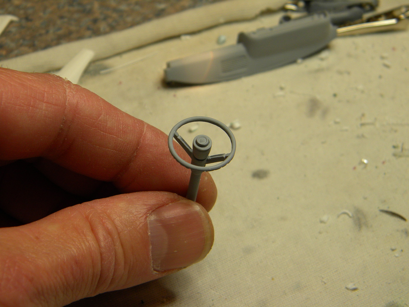

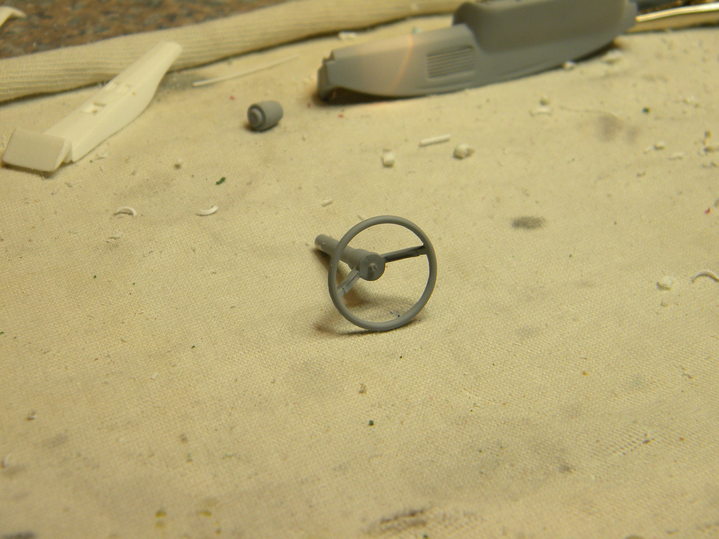

The interior modifications continue.
I made a few changes to the dash board, including a collar for the steering wheel, & I also added defroster vents by scribing them in.
I also cut a hole in the dash top & inserted a piece of an old grille for a speaker grille.

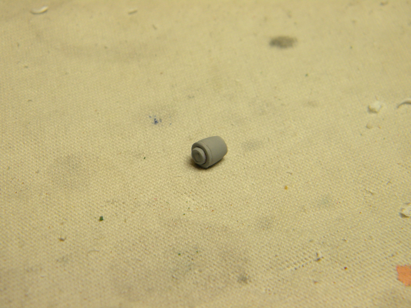

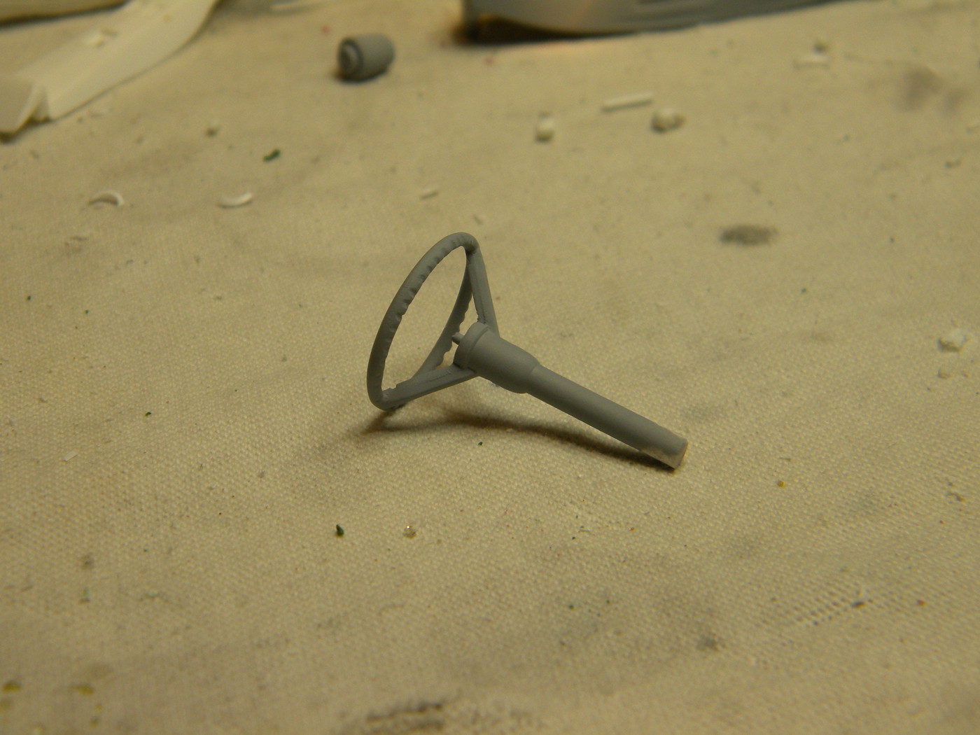

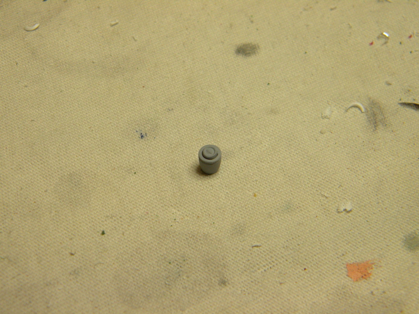

The steering wheel has had a lot more modifications than apparent at first glance.
First I removed the horn ring to be thinned & re-applied later.
Next, I ground out the center cap and added a locator pin to accept the scratch made "flower pot" center cap.
The entire steering wheel rim was thinned down considerably & "grip" detail was cut in.
The flower pot was made with a shaped piece of plastic tubing capped off with the center cap from the AMT '66 Ford Fairlane kit.
I still have one door panel to finish up & then most likely the console will require some tweaking if I decide to use it.
The interior is coming along well.
Steve

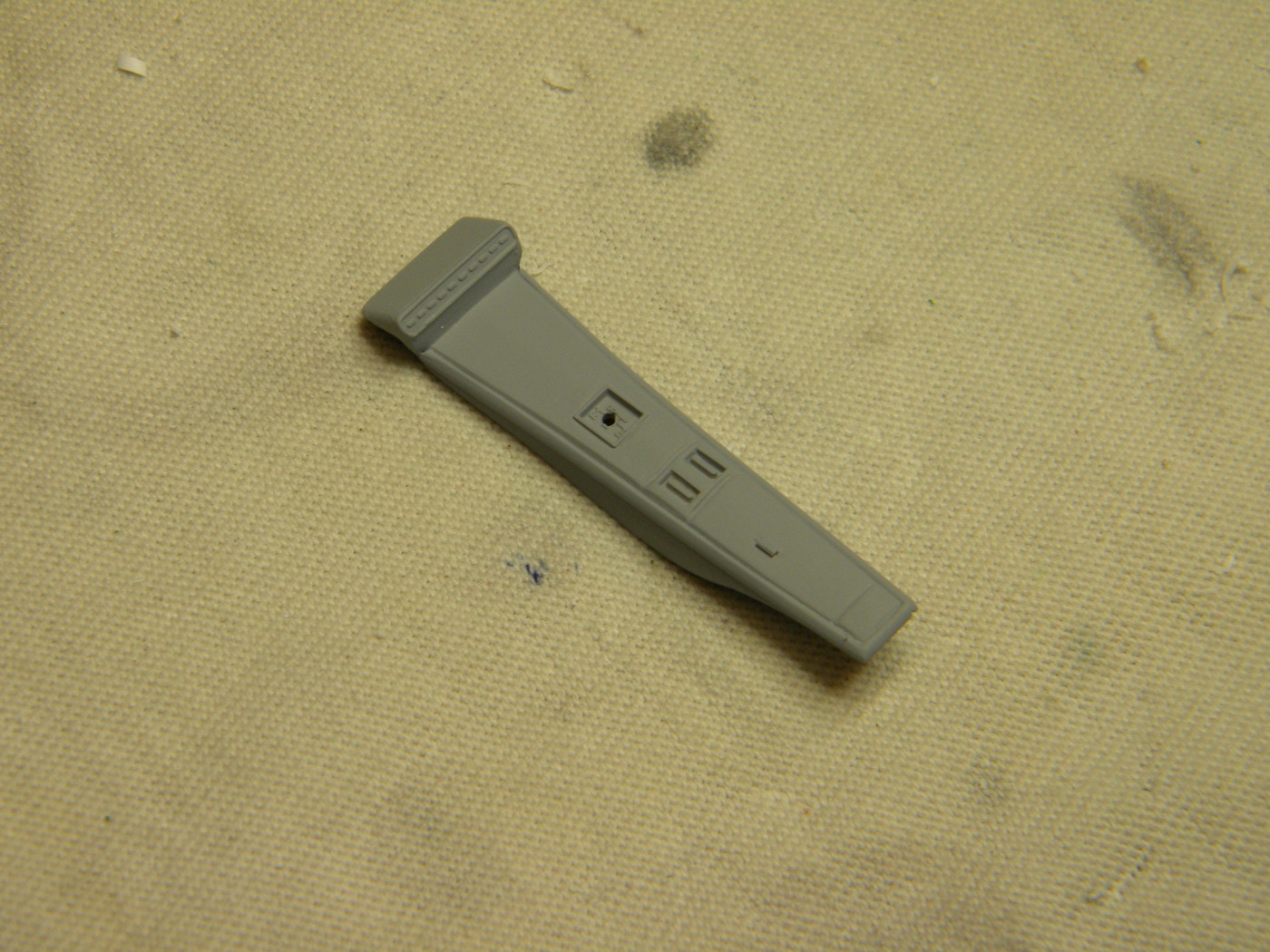

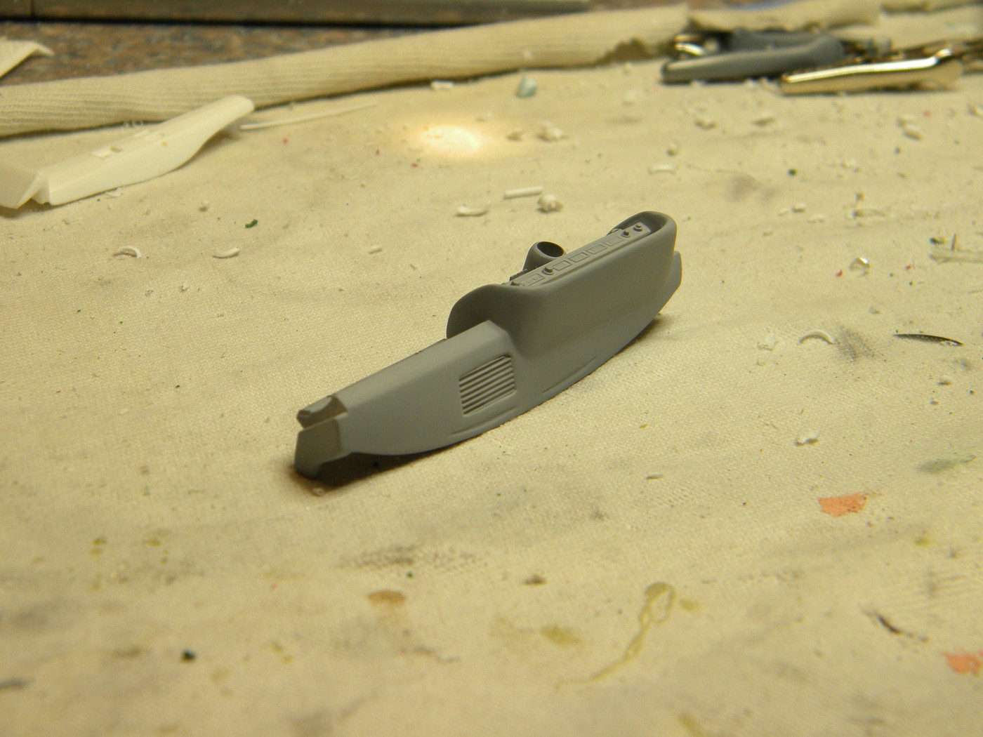

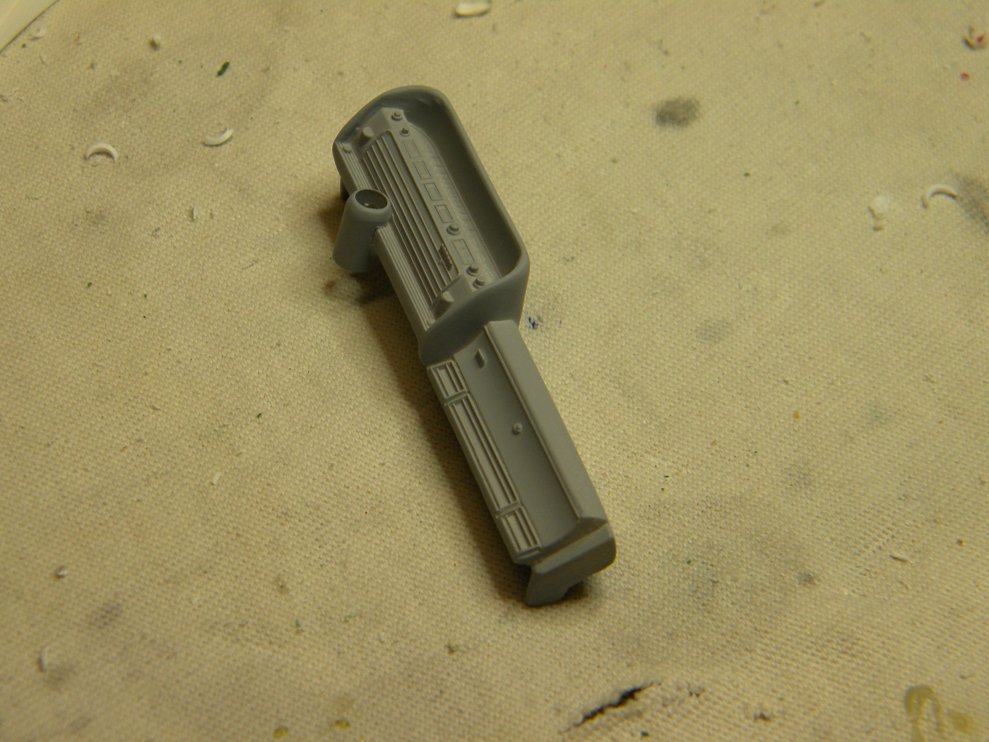

Finished up the modifications on the console today.
The original piece had no chrome molding detail around the perimeter of the console or a glove box "button" so I added them using some Evergreen stock.
I also scribed in the glove box lines.
I realized that I had forgotten the glove box panel lines on the dash, as well as the leading edge of the door panels, so I scribed them in as well.
The interior should be about ready for paint and assembly.
Steve

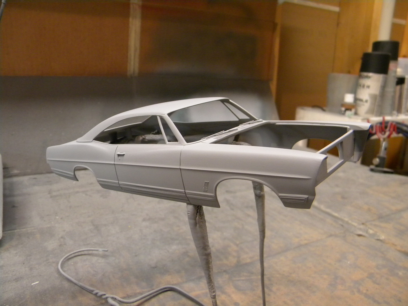

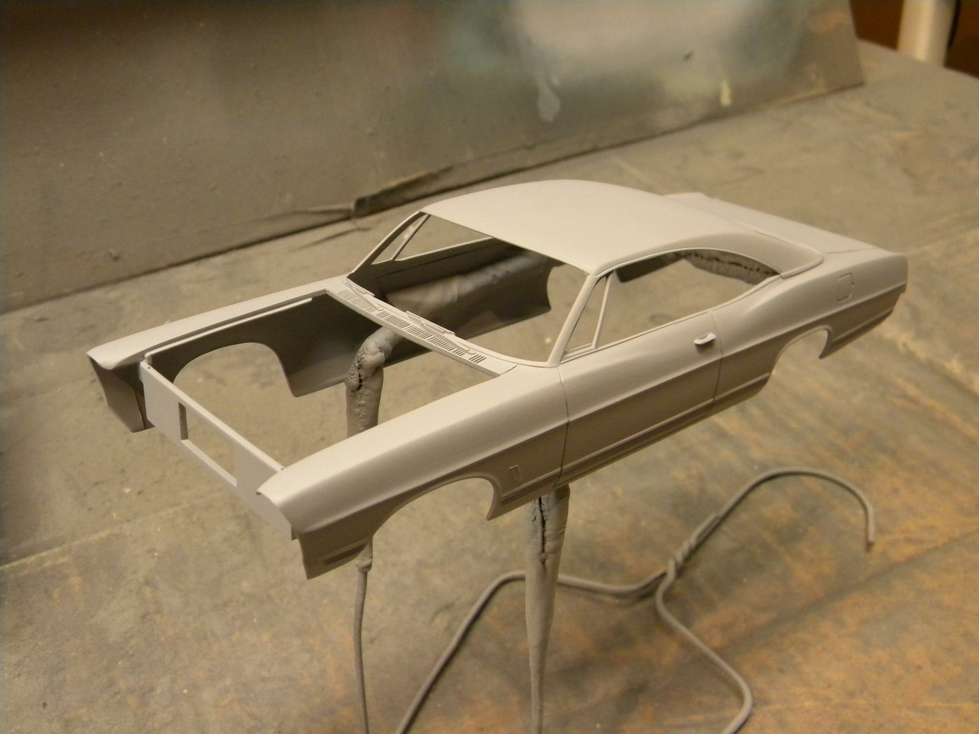

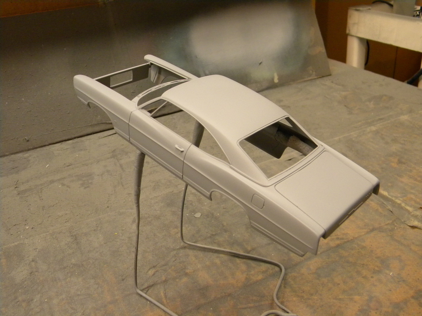

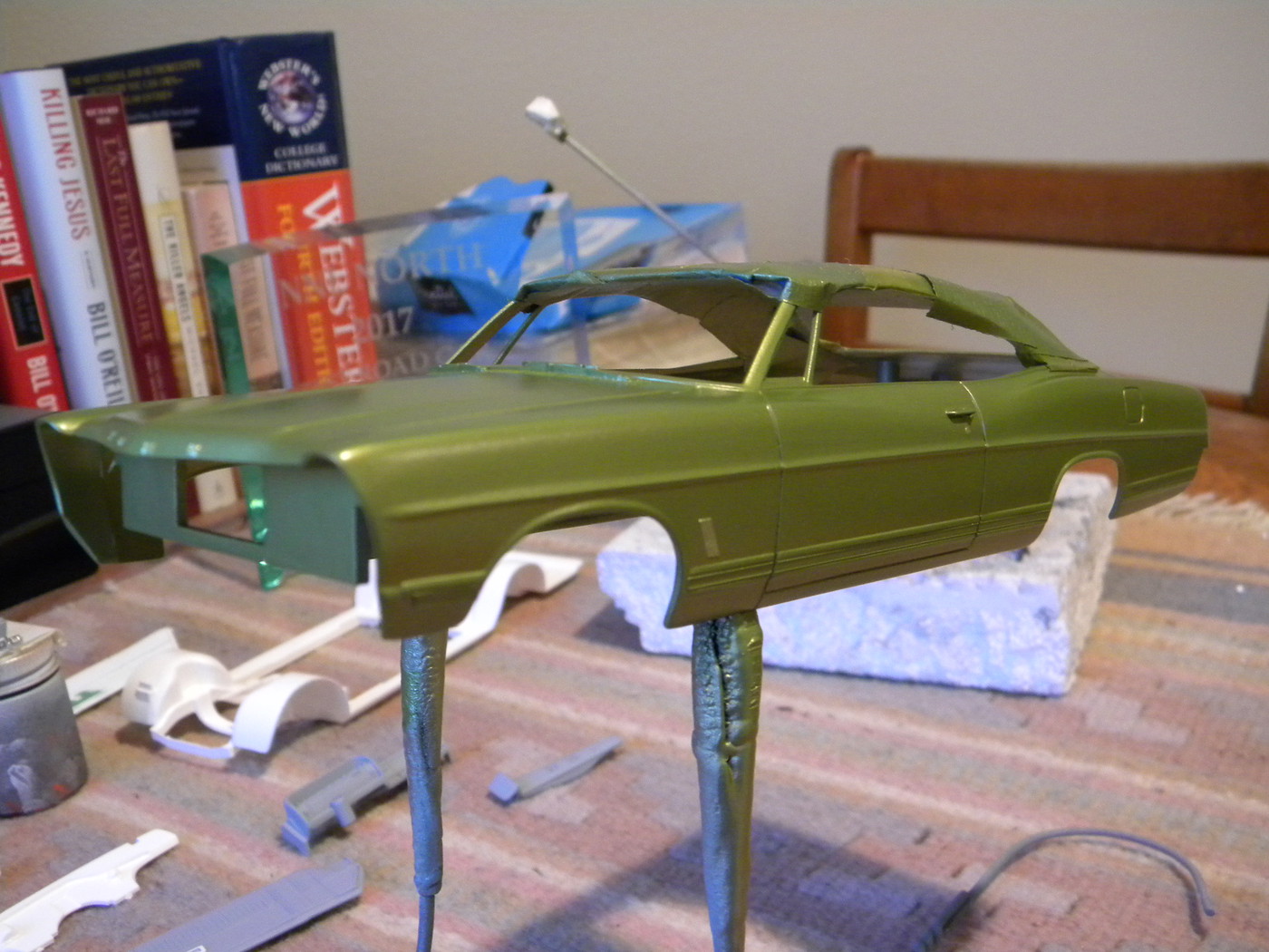

The interior is nearly complete in the modification department, now it's time to move on to paint.
The body has a coat of Testors primer, followed by 4 coats of Duplicolor primer/sealer.
First job will be the black top.
Then I will use a coat or two of Duplicolor gold touch up paint as a base.
Then the Lime Gold.
Hoping all goes well!
Steve

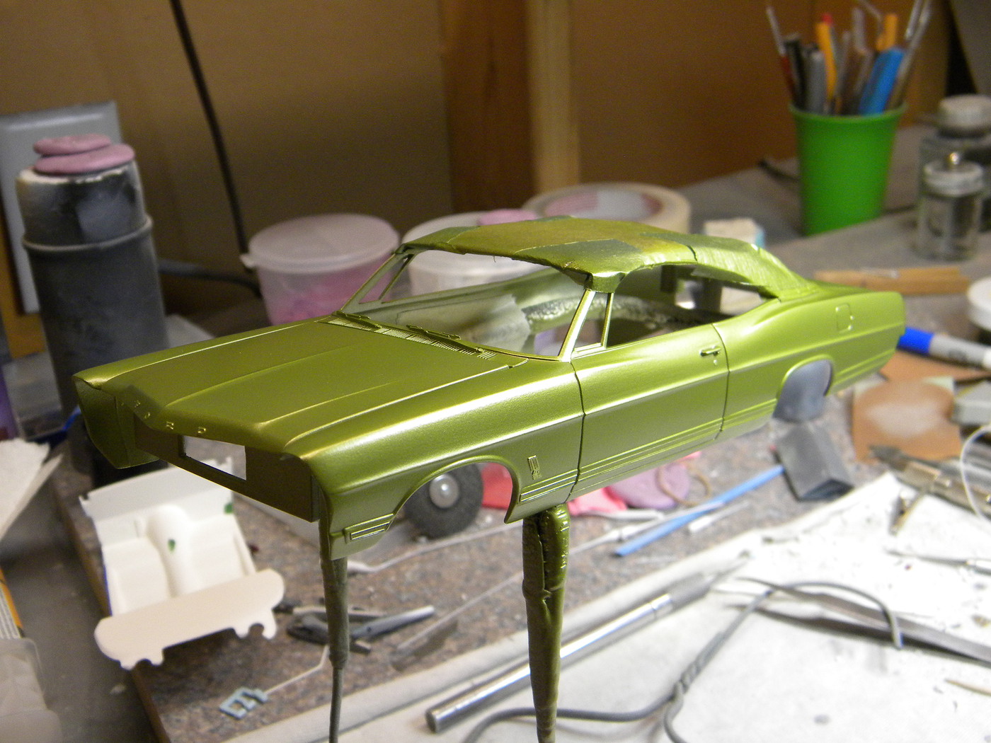

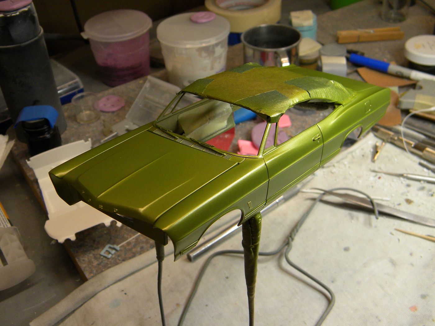

Color is on!
Looks a little bright in the fluorescent light in the first 2 photos.
A little more subdued in the last pic.
I will remove the masking on the roof tonight after the paint dries a bit, and clean the scripts.
Then it should be ready for a little more foil and detailing before clear coats.
Steve
