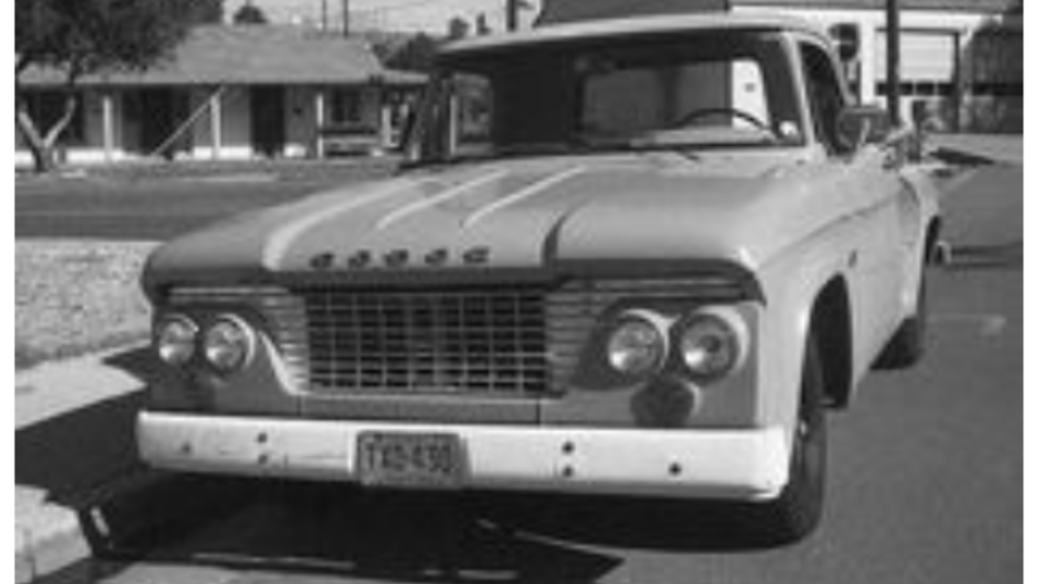

That is some amazing work. I would love to be able to biuld even half as good as he can.
Im just going to point this out that the truck he biult is actually a 62-64 and it look like it was biult as a 4x4 which is a W series not a D series.
this is how a 1961 dodge grill looks.
This is how the 1962-64 grill looks. Which is how the grill looks on his model. 3BF56D6F-59D0-44F7-A1C5-FC2F1ECB3675.png.5e813abb842d1c88c629c9069fa0440a.png
You are correct, but to be fair, I don't think this guy lives in, or has every been to the USA. I think all his info is through the WWW. This is in no way a put down, I think he did a great job and I think most of use would have missed those minor details also.
