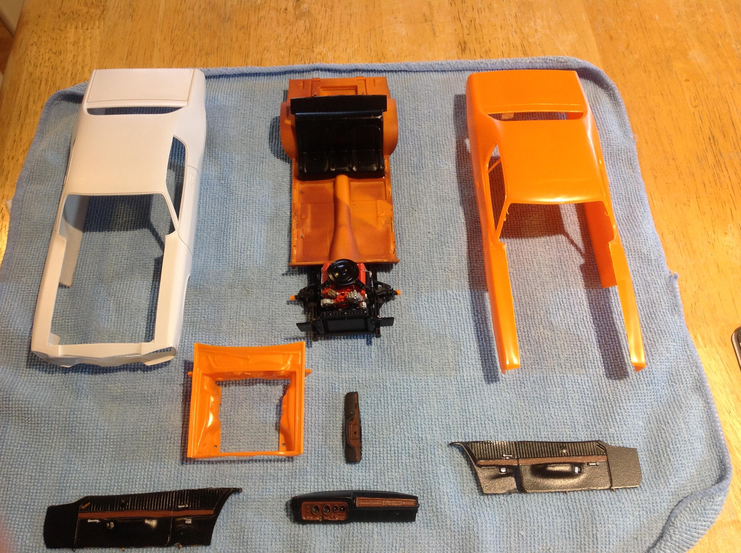

Hey guys, working on the AMT Plymouth GTX and am using the 71 Charger chassis, engine and dash. My question is should I use the interior tub from the GTX kit or will the built up interior from the Charger kit work?  If anyone here has done this conversion could you shed some light on how you went about it? This is a first for me so any advice would be appreciated.
Heres a pic of the GTX KIT.........

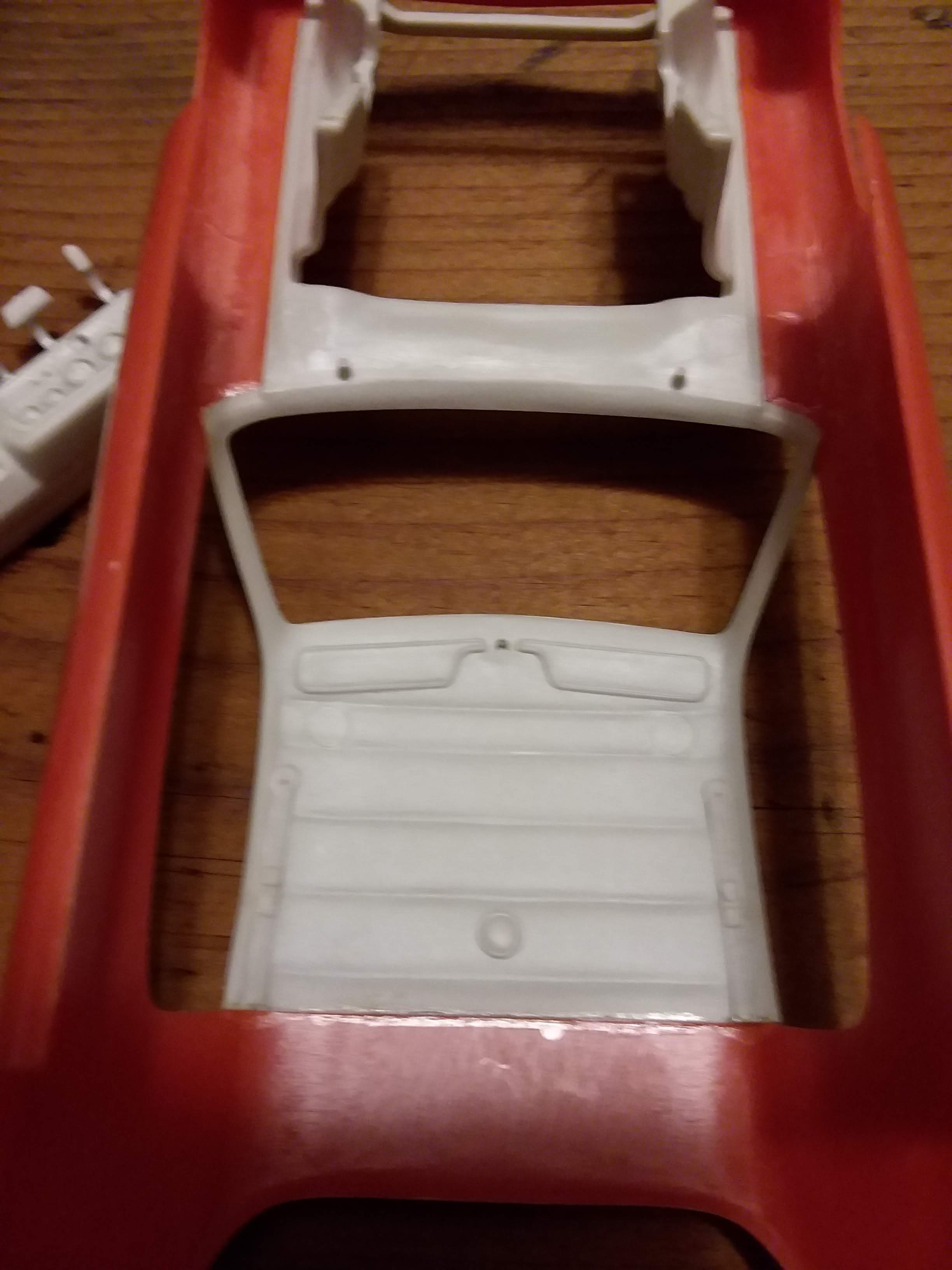

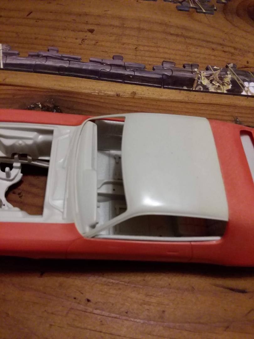

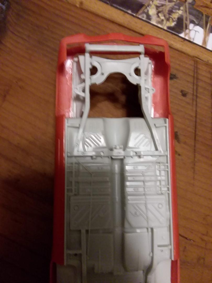

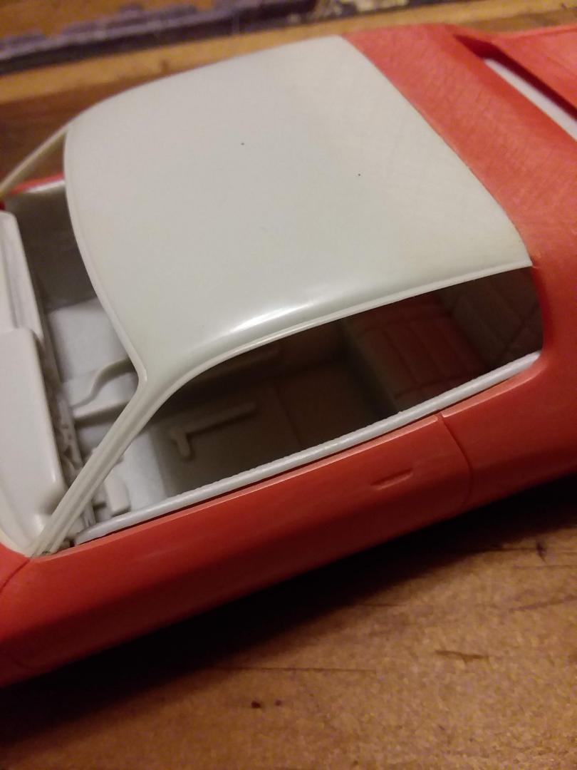

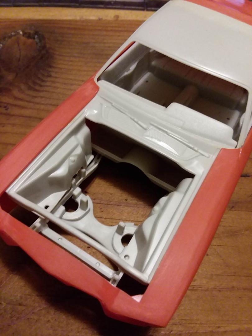

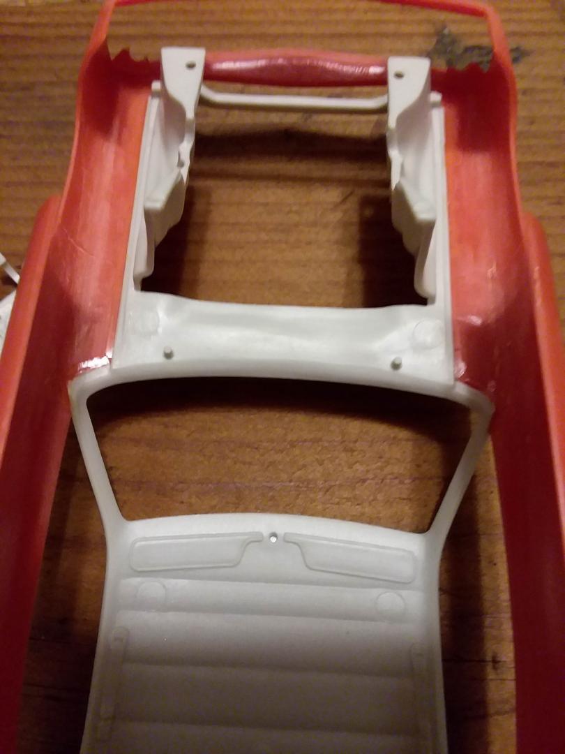

Not at home to get a picture, but I cut the Chargers inner fender, cowl , a pillars and part of the roof all out in one piece.  Then trimmed the Road Runner body for it all to fit . The interior and chassis pan fit real good . The front suspension of the Charger is not correct but it will work . The 73-4 had a separate torsion bar mount , mounted on rubber biscuits behind the tranny mount. And the K frame is mounted on big rubber mounts.  But it is still a hundred times better than the old chassis.
Share this post
Link to post

Sorry  fogot about taking a picture. The Charger interior will fit with a little sanding . I was planning on making new ones. The Road Runner interior bucket will still fit too. The shape of the rear quarter window  looks a little off to me it is to straight up and down. I started on this when the Charger kit first came out. Was going to build a replica of my high school car.

Took some quick pictures.
Wow, your doing some serious work there! Is this finished or a WIP? Thanks for posting up your pics.
Share this post
Link to post
This is as far as I got with it.

Nice body work mash-up. Thanks for showing your method here. I'm going to try the 74 Road Runner/Charger kitbash some day. Did you use the forward part of the Charger roof because it (or the windscreen) has better shape than the Road Runner parts, or was this simply the most straight forward way ahead?
 Thanks. It makes the a pillars look better by being inside of the door and fenders instead of on top of then . The window trim  and window shield are better on the Charger and it just makes it stronger.
