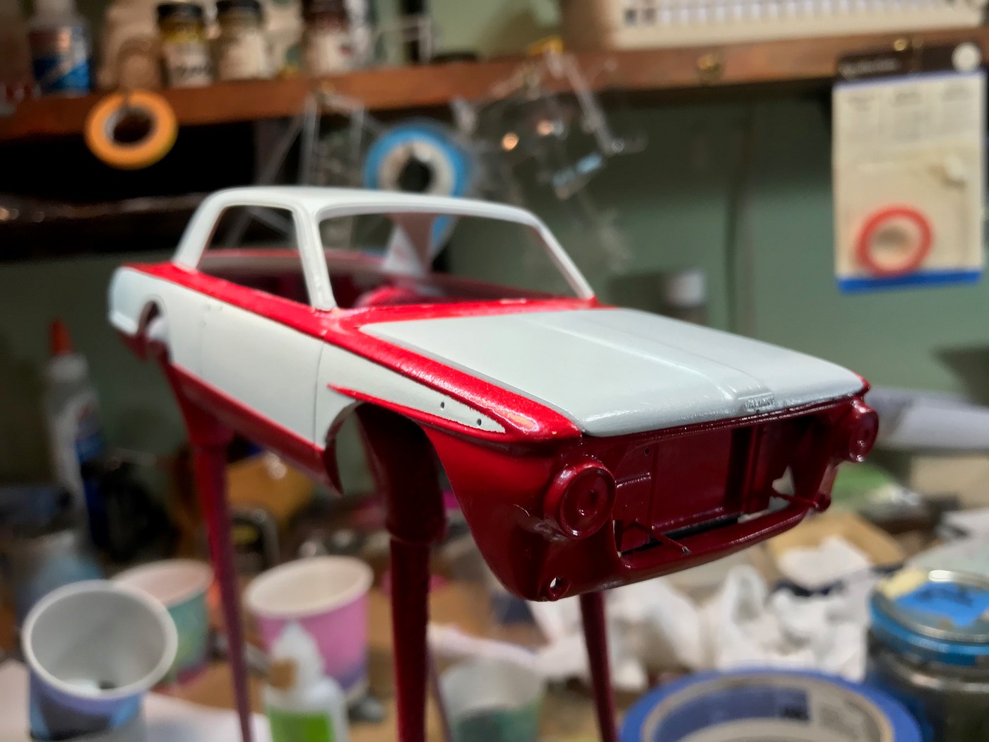

And agreeing with Bill on using Tamiya Tape and BMF for your fine edge.  Lately I've been using the Tamiya tape for my two tones. It gives a great edge!  It is a bit expensive so you can use it just for the edge, then mask off the rest of the car with painters blue tape.
IMG 0521small
Here's an example-  In the top photo that's the Tamiya tape. The part above the tape line on the C Panel was then just covered with Painter's Blue tape.
IMG 0534
And the results. Notice that even that little detail on the fender came out right!
