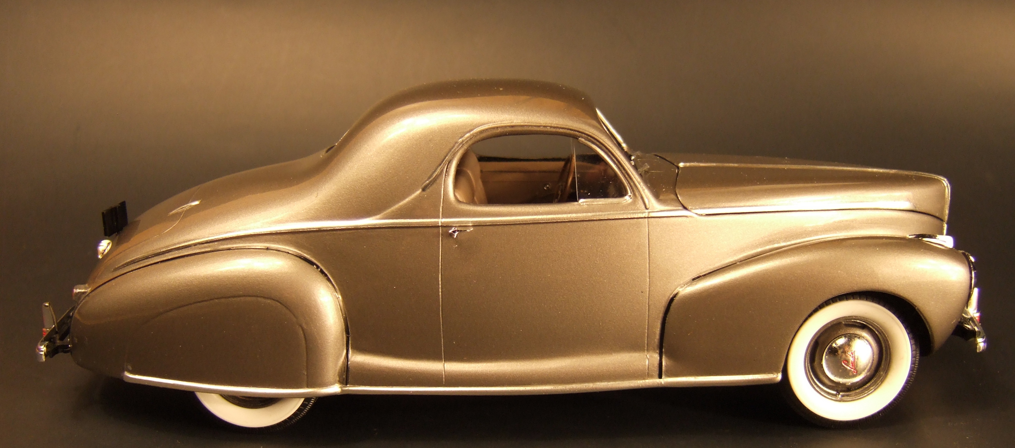

Here's Lincoln Zephyr. Built from a resin kit. Over 40 hours in body corrections alone but It came out ok.

Thank you for the positive comments. I will post more builds soon. Been a while since the build so I have probably forgotten some things.
The hood was waay to big, had to be shortened and narrowed.
The cowl was a mess.
the upper portion of the doors were sunk way in. Beyond the warm water straitening method.
Where the lower "rocker panel" area met the fenders was very messy.
Had to rework the area from below the C pillars along the top of the rear fender all the way to the bumper.
the roof was waay to thick. lots of grinding.
Share this post
Link to post
all lines rescribed, new drip rails over the doors and all new side moldings were made.
new windshield and rear window moldings (countersunk, that was fun) were made.
The sad thing is, is that the basic shape of the body was excellent, with more time spent on the master it could have been an awesome kit.
It came from Air Trax of Finland.
