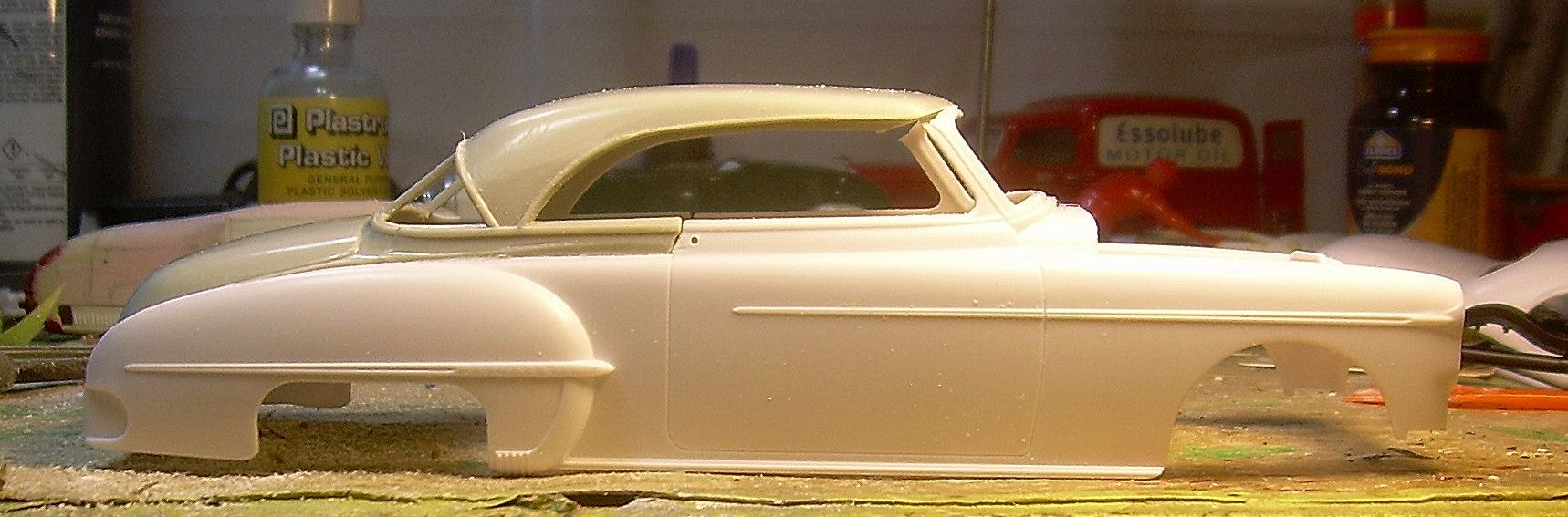

My suggestion would be to simply graft the complete sedan roof and partial trunk area from the AMT 55 to the far superior Revell 55. Better yet, use the roof from the newer Revell 56 sedan, as they were both from the same master, so dimensions should be about the same.
Share this post
Link to post
^^^  That sounds like an intelligent approach. Getting a front clip from one manufacturer to fit a body from another manufacturer opens innumerable worm-filled cans, not the least of which is the seeming inability of kit-design teams to all come up with the same numbers when they measure something...even within the SAME manufacturer during the SAME time period.
Grafting a roof, however, eliminates many possible sources of throw-it-against-the-wall frustration...and the resulting seams should definitely be easier to fill / hide / disguise.
The key is careful advance measuring and evaluation of where to make the cuts...preferably where the factory dimensions are the closest to each other.
In general, the roof-swap idea, even from two different manufacturers, has worked very well for me on several projects.

Well, I don't want to hack up a Revell '56 Del Ray body, as that kit's a little hard to find at the moment and who knows when/if it will be reissued again. So that's out.
As far as grafting the AMT 2DS roof onto the Revell body, I'd have to go much farther down than the roof, as the hardtop/convertible doors and quarters are different from the 2DS. I'd have to go a third or halfway down onto the body, and then I might as well drop the cut line aft of the rear wheel openings and just take the whole lower quarters and trunk/rear panel too. Now I have to fight not only possible body width problems, but door length as well. (I'm removing the side trim, so at least I don't have THAT to worry about.) Not that it COULDN'T be done,  but I'd think it would be a lot easier to either swap the whole front clip, or just the front inch or so of the front end. Here too, I'm taking off the front fender trim so that's not a problem.
1 hour ago, Ace-Garageguy said:
PS. Another easier way out of dealing with a misshapen front clip is to just make it into a gasser with a flip-up nose, representing a fiberglass race part that's not particularly accurate.  :D
Not an option for this particular build. Definitely a stock steel front end.
Think I'll keep my eye open for a Revell '55 glue bomb at the next local toy show in a couple weeks.  Hmmmmmm....B)

7 minutes ago, Snake45 said:
...I'd think it would be a lot easier to either swap the whole front clip, or just the front inch or so of the front end. Here too, I'm taking off the front fender trim so that's not a problem....
That seems like the best option then. Maybe only the first 1/2 inch, if you can get away with that. Definitely probably easier and less grief than trying to get an entire clip to fit at the door lines, and the hood line at the cowl.
If the widths are within a few millimeters of each other, it should fly quite nicely with very careful measuring and cutting. And most of your original hood would fit everywhere but the very front...easy enough to trim or shim as required.
