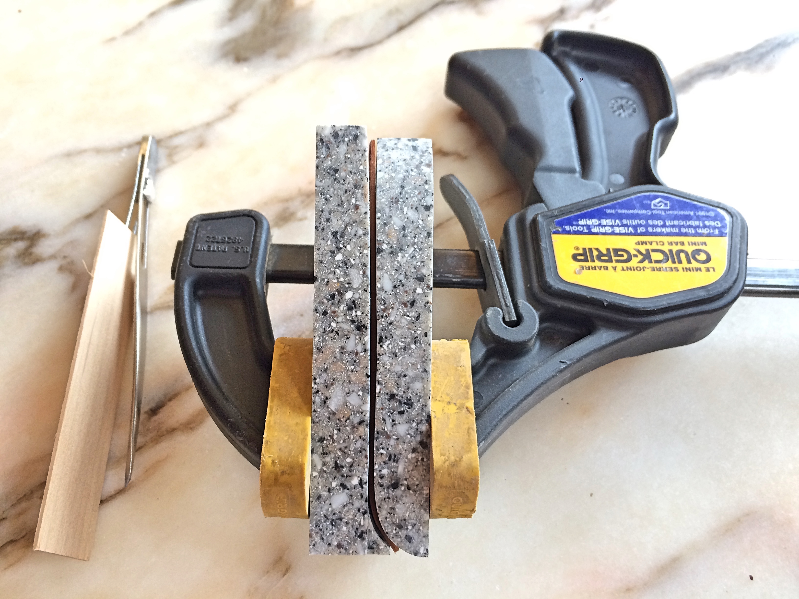

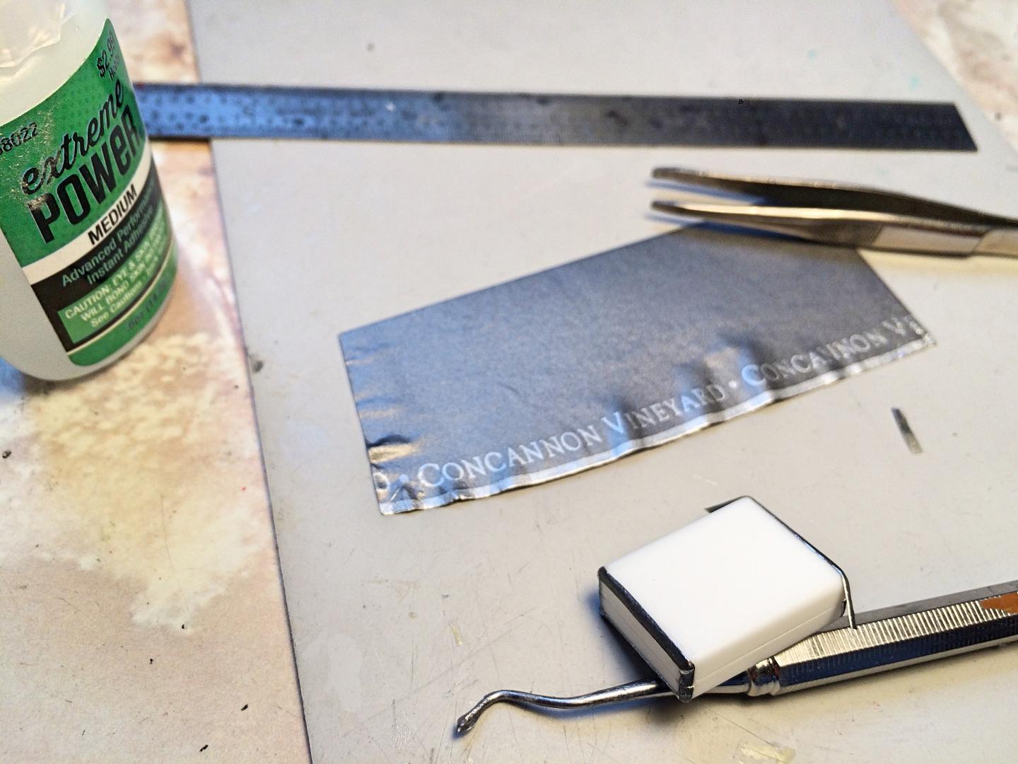

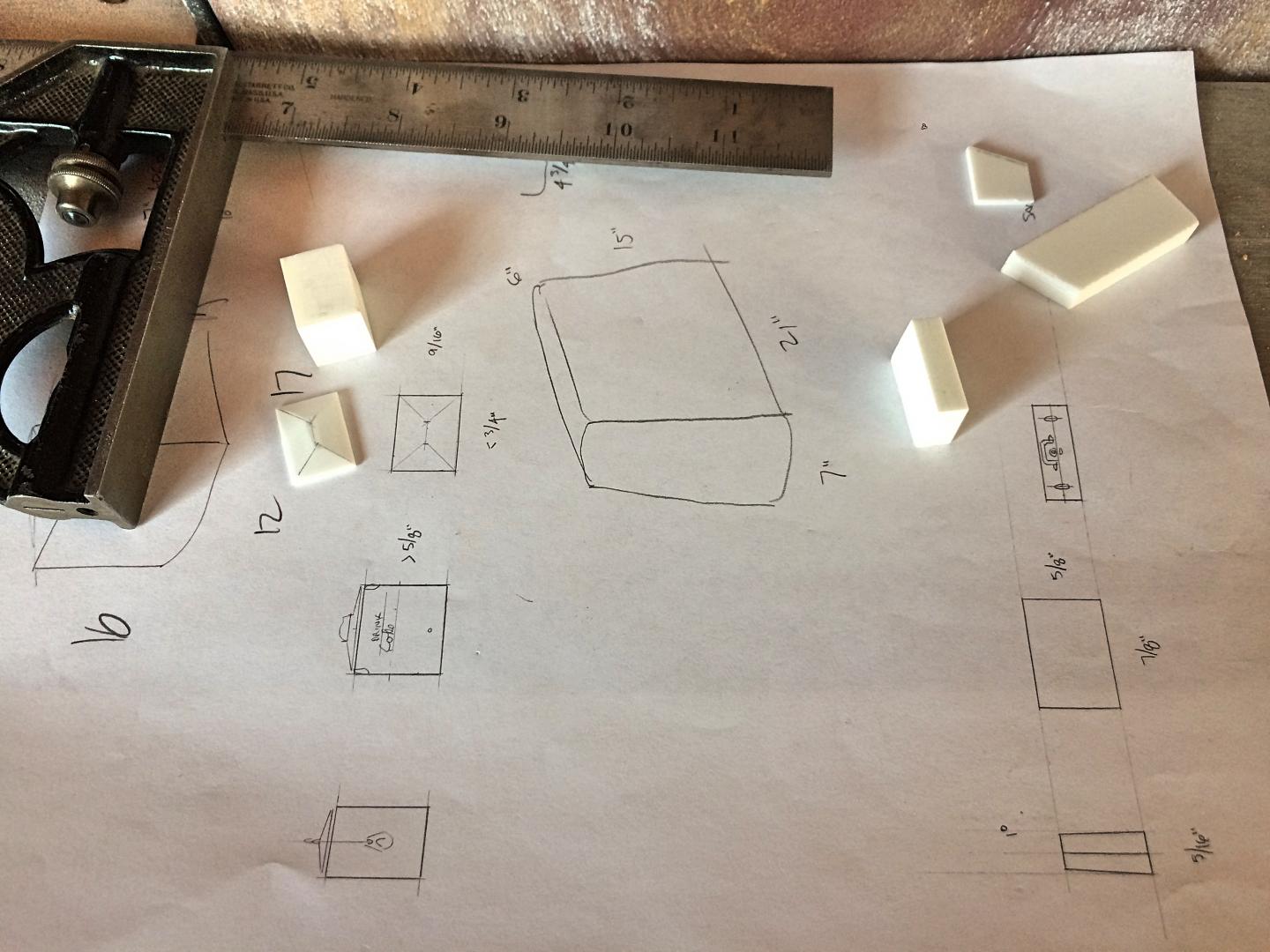

Started on the accessory parts.  I love to use Corian (kitchen countertop).
Cut to size with the table saw and cross cut saw, and got to basic shape with the bench disk sander.
I used this wine bottle foil because it's like lead foil, to make the edges.

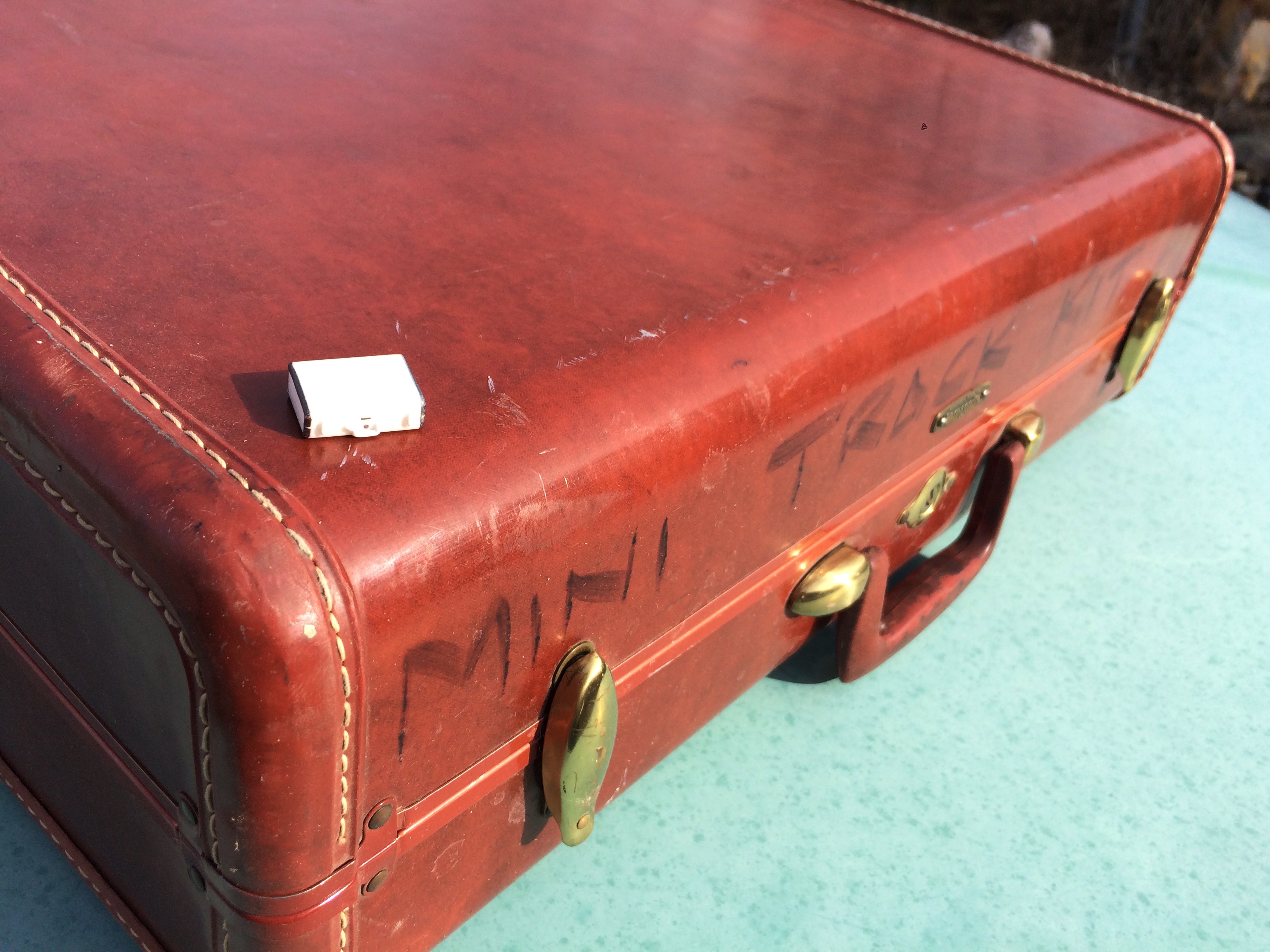

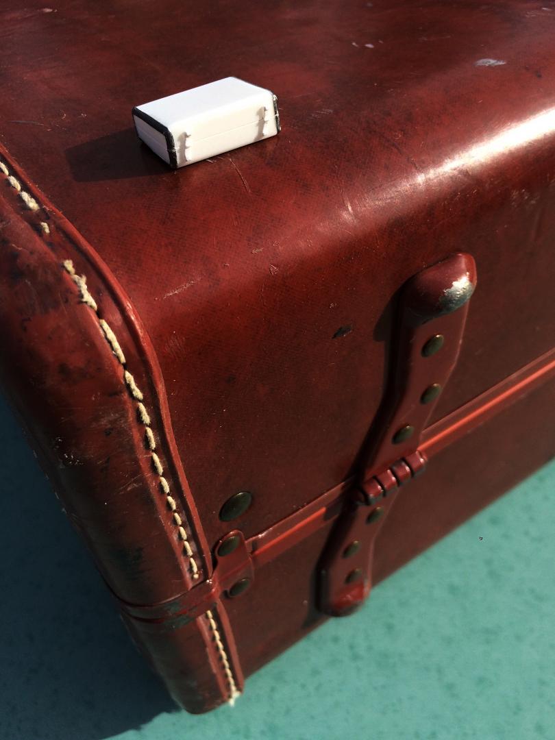

I still have the Samsonite suitcase my parents had, used for reference.

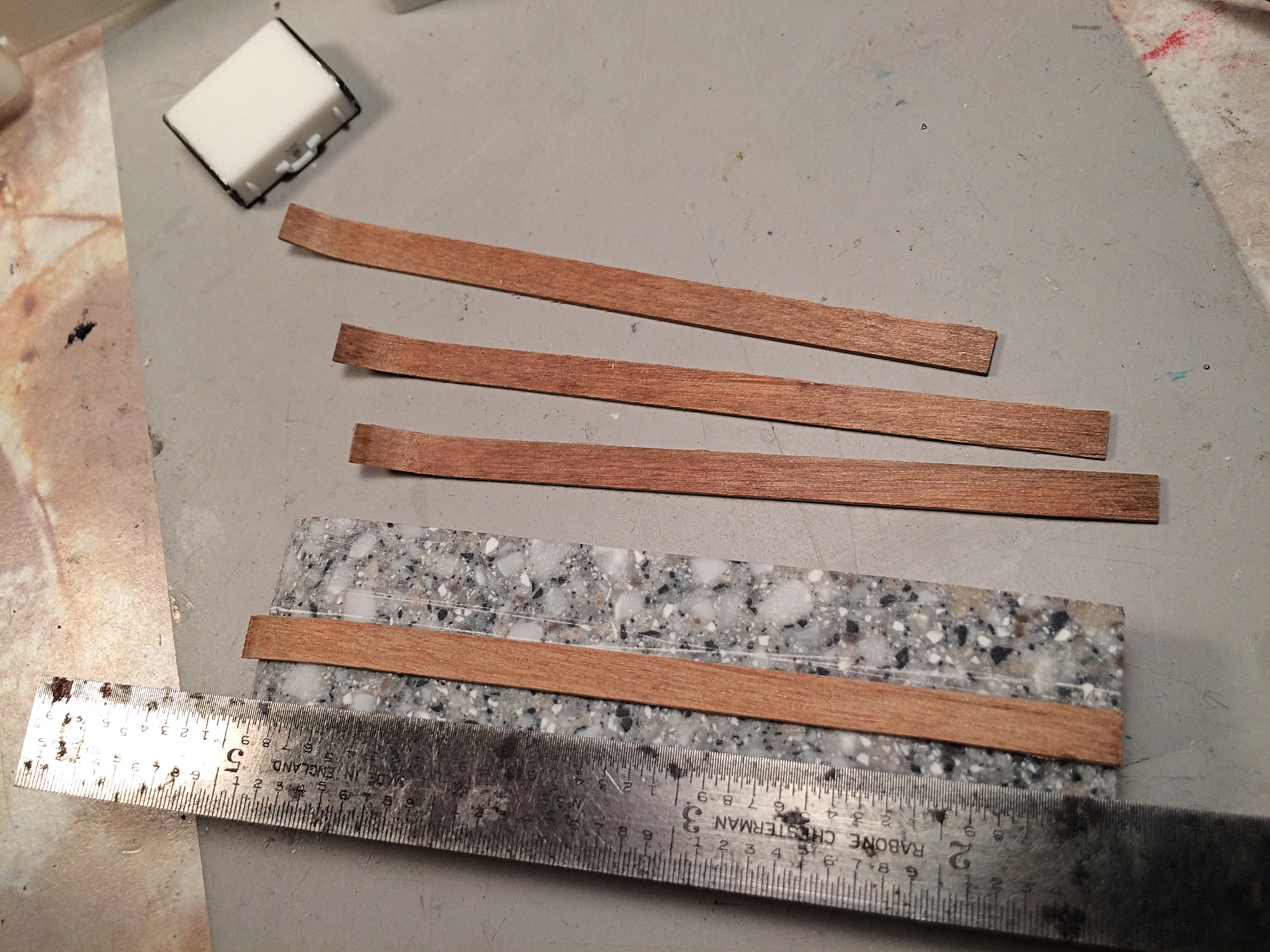

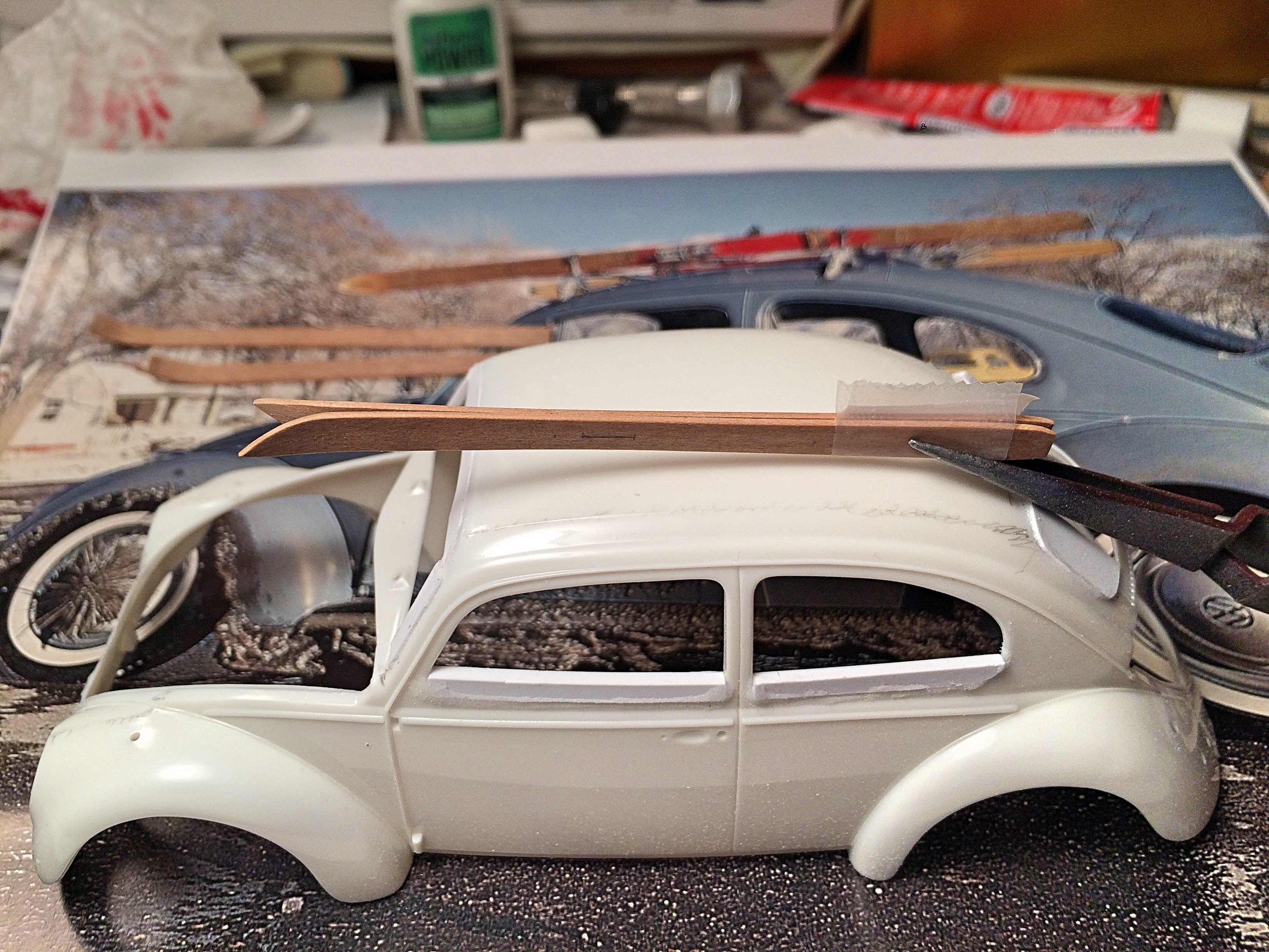

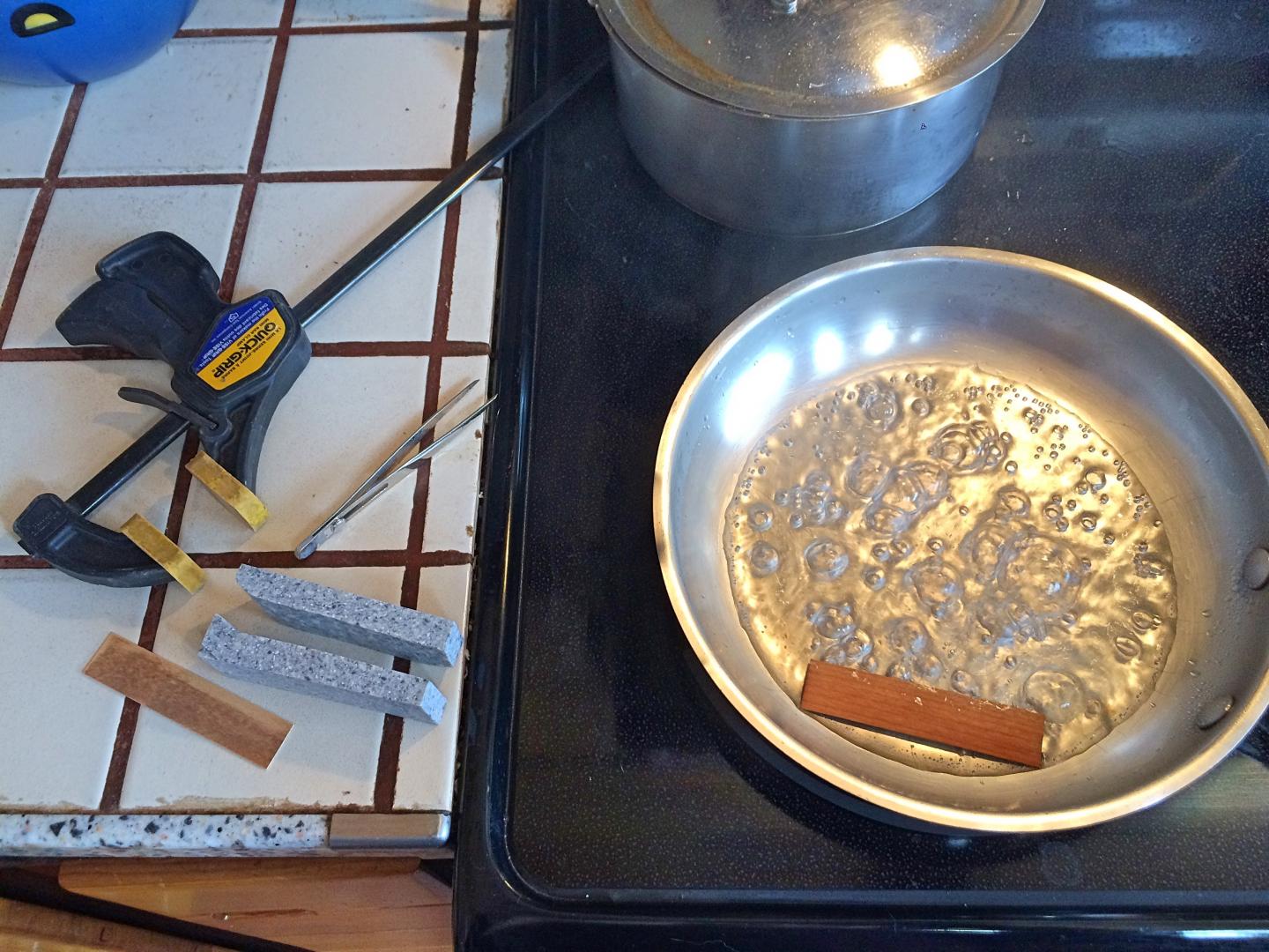

I wanted to use real wood for the skis, think this is Cherry from my stash which has no obvious grain.  Again, Corian is used for the form.  Usually wood is steamed, I boiled it.
Then clamped.  At this time, I'm not thrilled with the result, so who knows.

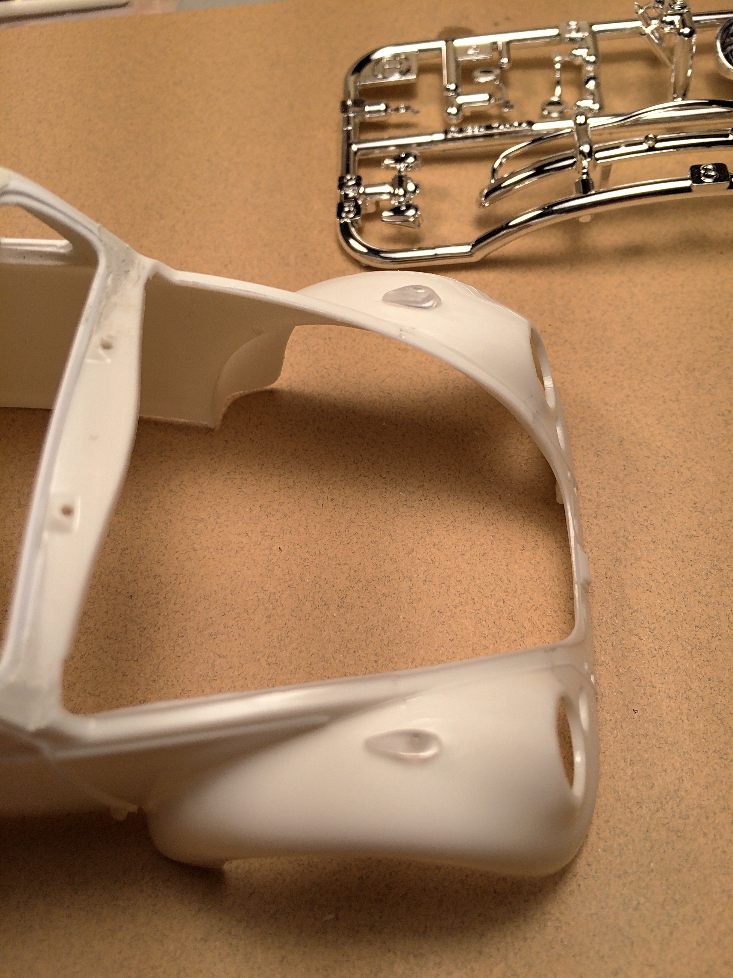

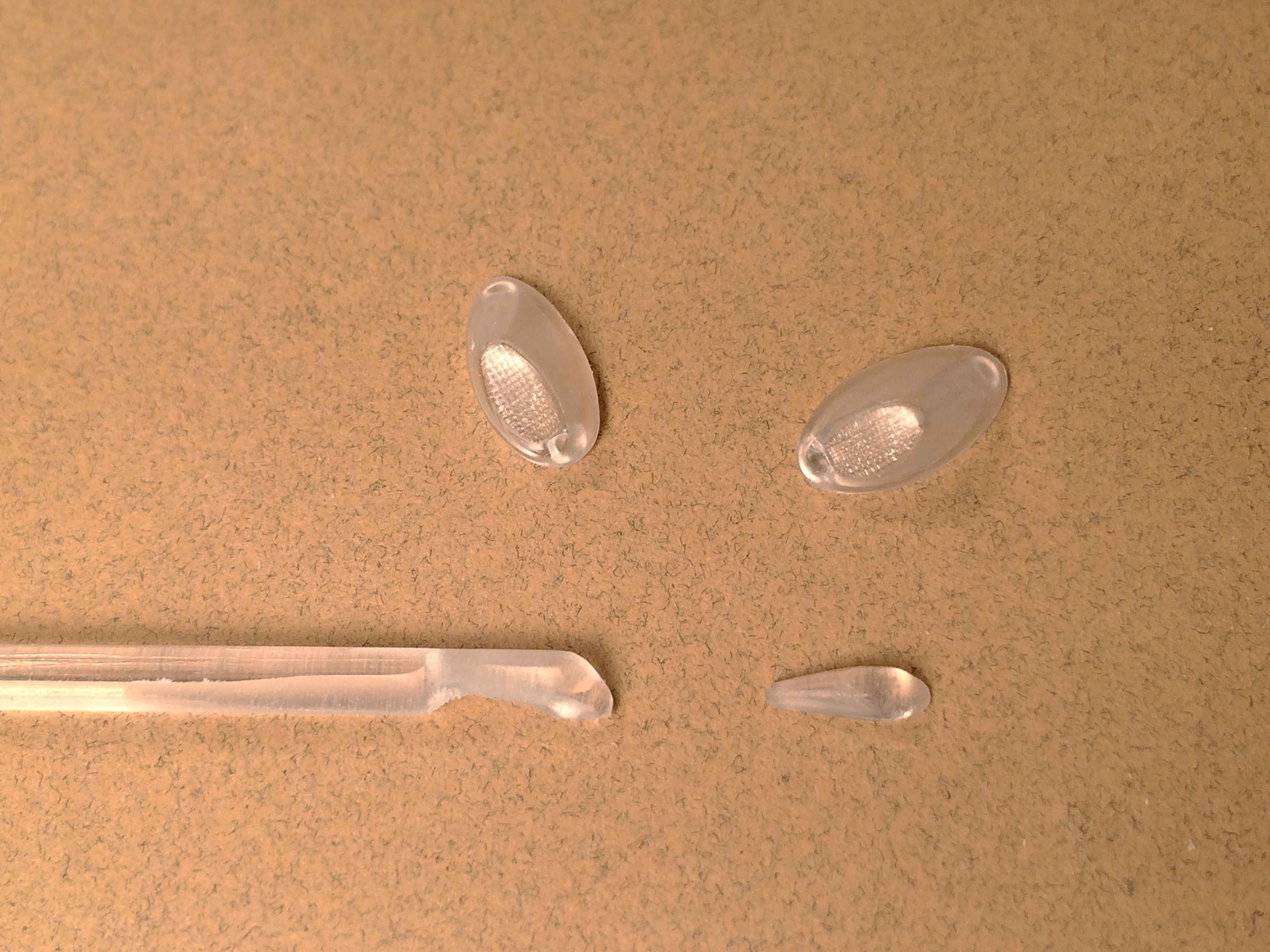

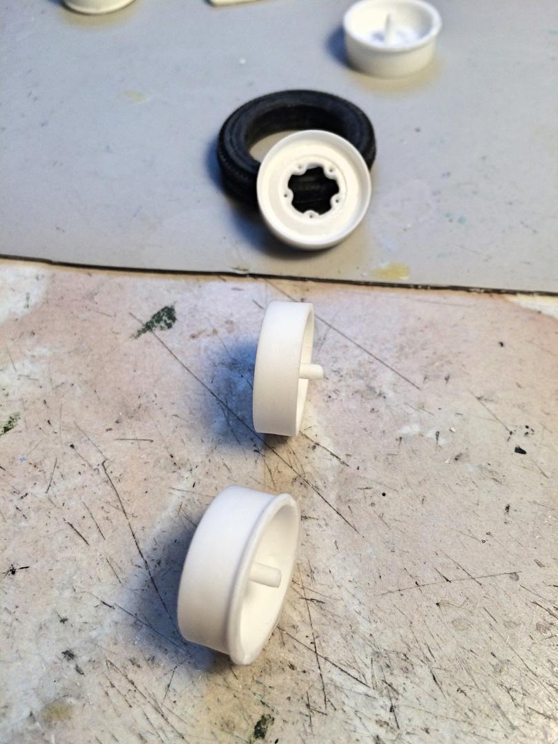

Pet peeve of mine, the giant lip on the back of the wheels, *had to* grind/file/sand off to a realistic width.  I do this on every Tamiya, Fujimi, Hasegawa, and Aoshima model.  These are resin from Best Model Car Parts, think they are copies of the Hasegawa '57 kit.

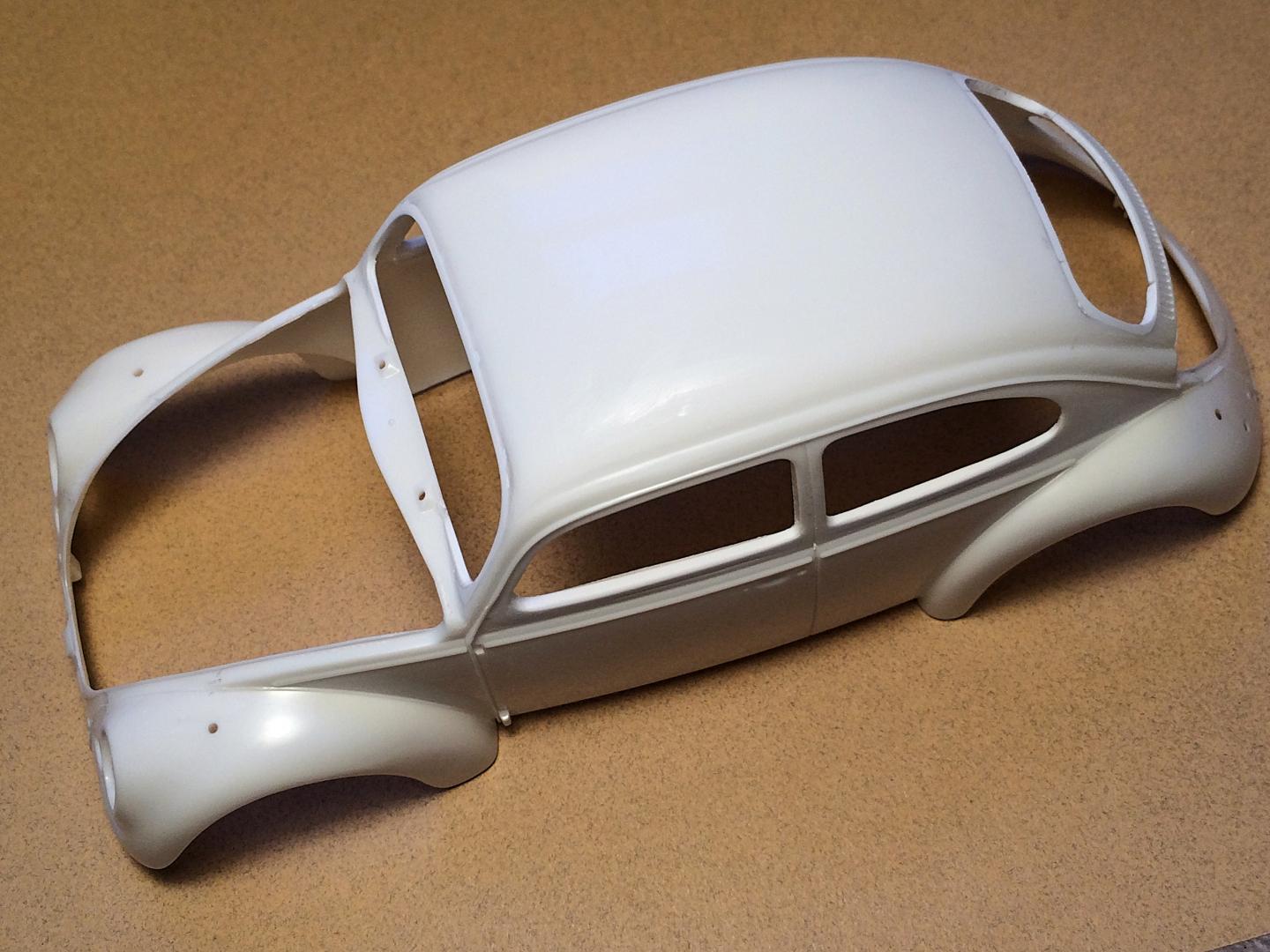

Have begun the ruin-a-pefectly-good-model stage, by backdating the windows as discussed prior.  I use super glue because the edges are so thin, didn't want model glue to melt the plastic, and shrink over time.  I also use baking soda to quicken curing, and basically do for filler, but I know the risk is when the body is washed, little chunks of baking soda dissolve and leave tiny voids, just need to really look and putty before painting.  My plan is to file/sand to contour of the body, then make the opening size, then add moulding strips by making a solid blank and glue in, then cut the opening.  I think..... :huh:

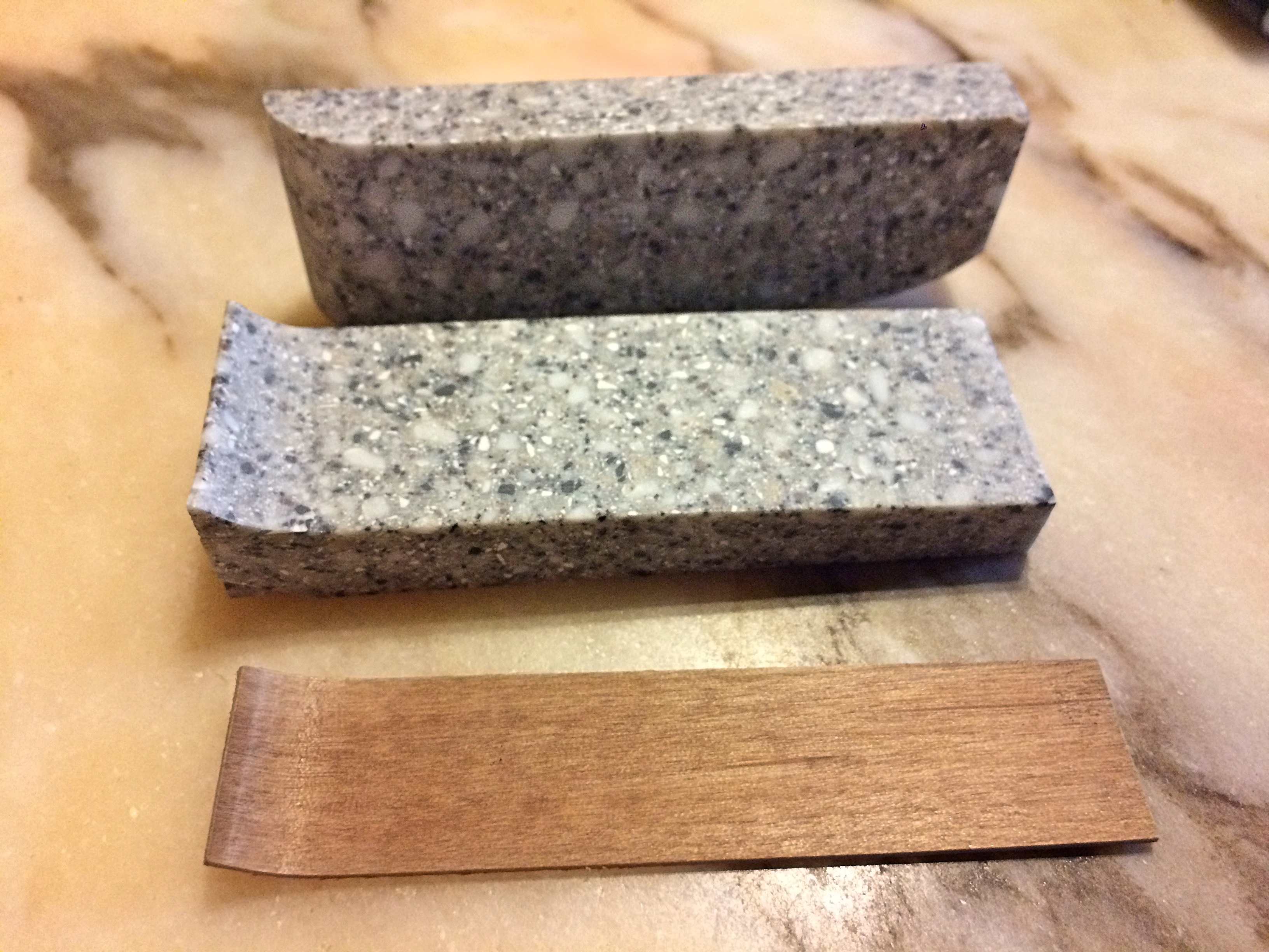

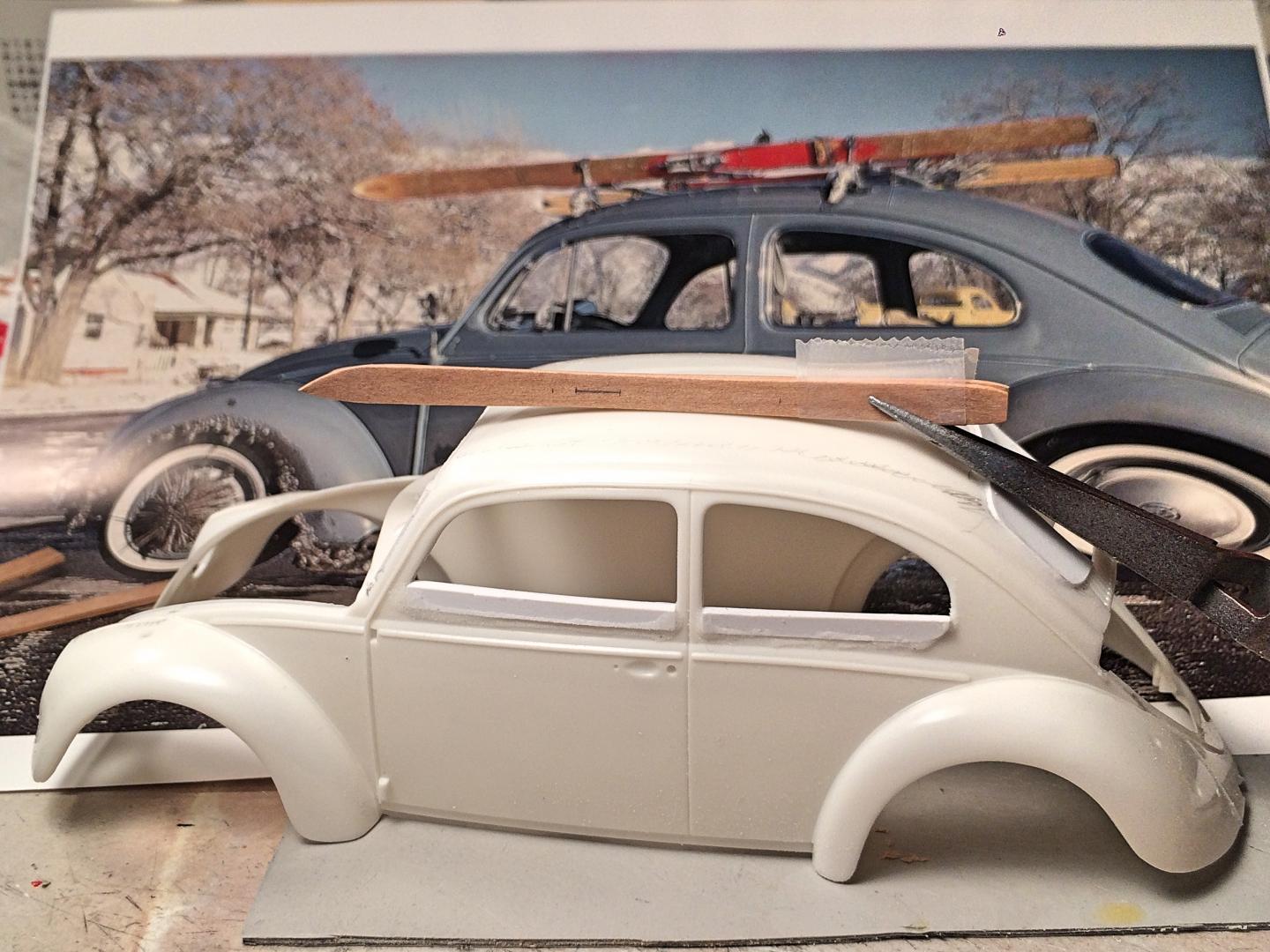

Couldn't go to bed until I knew the ski idea works!  Had to keep the wood clamped for about half the day.
Looks like a toboggan.  LOL
Divided into quarters, made several passes with the knife.
Sanded to shape with nail sanding sticks.  Taped together to double check the profiles.
Think this is close, but am going to make them narrower now that I see how it looks.

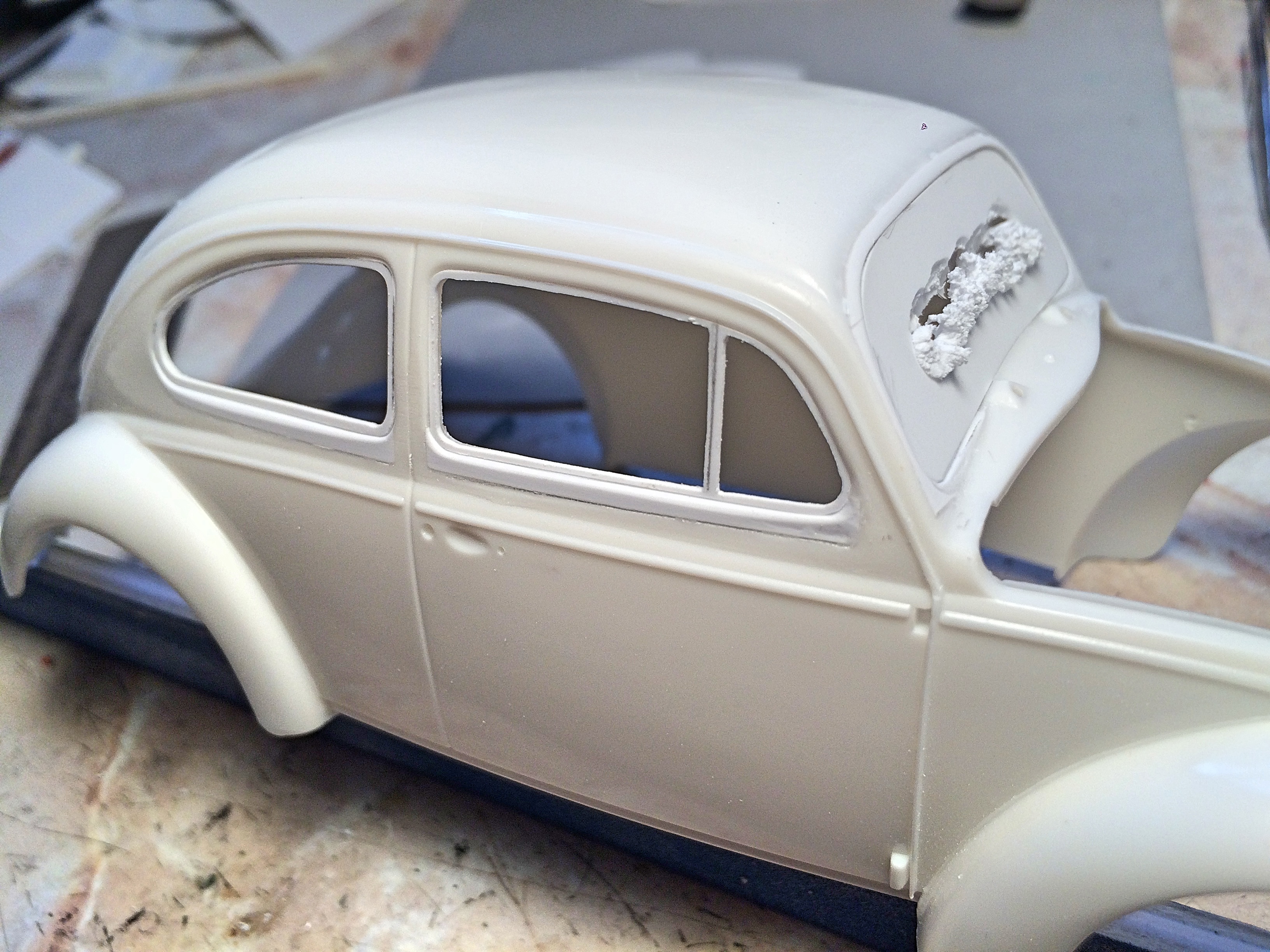

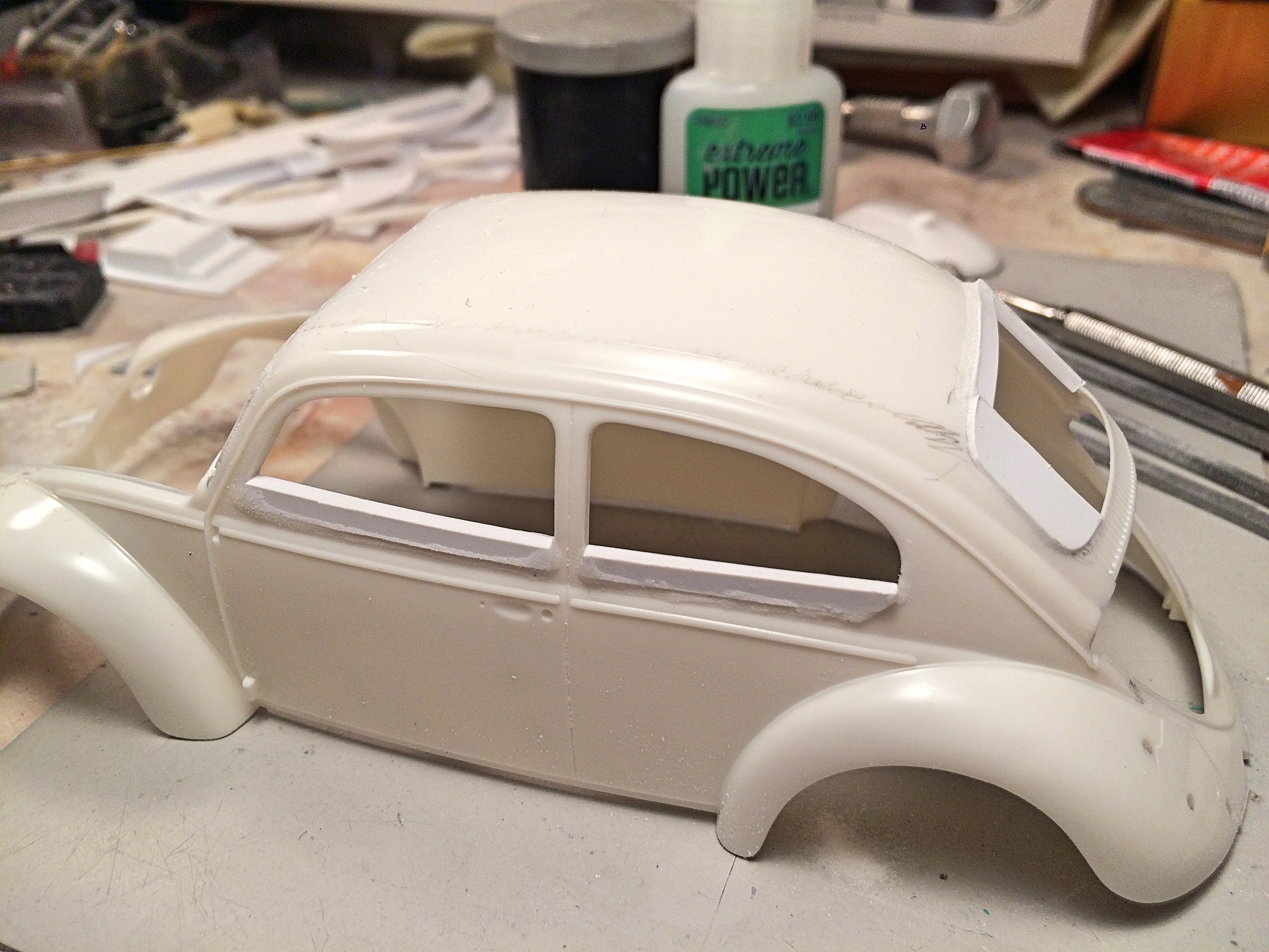

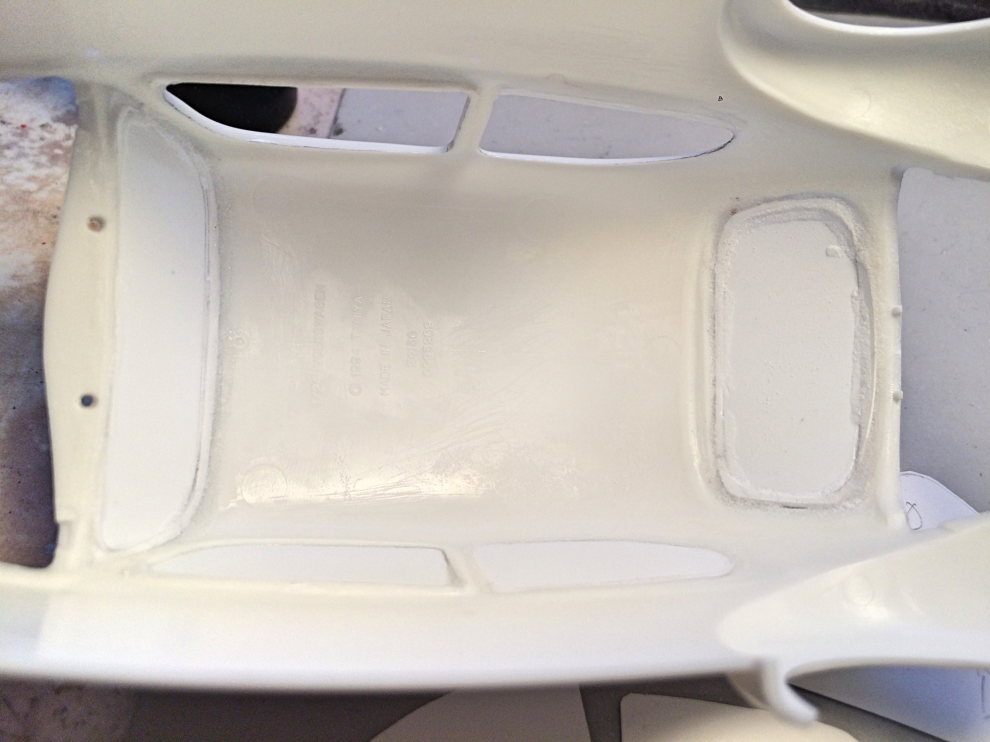

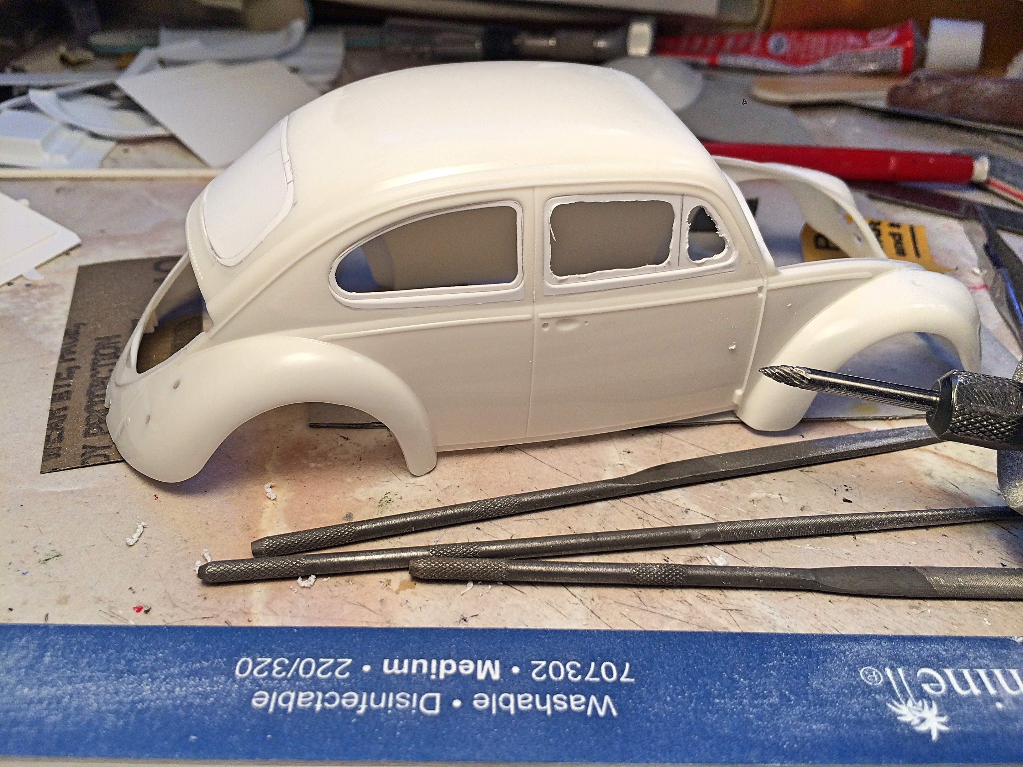

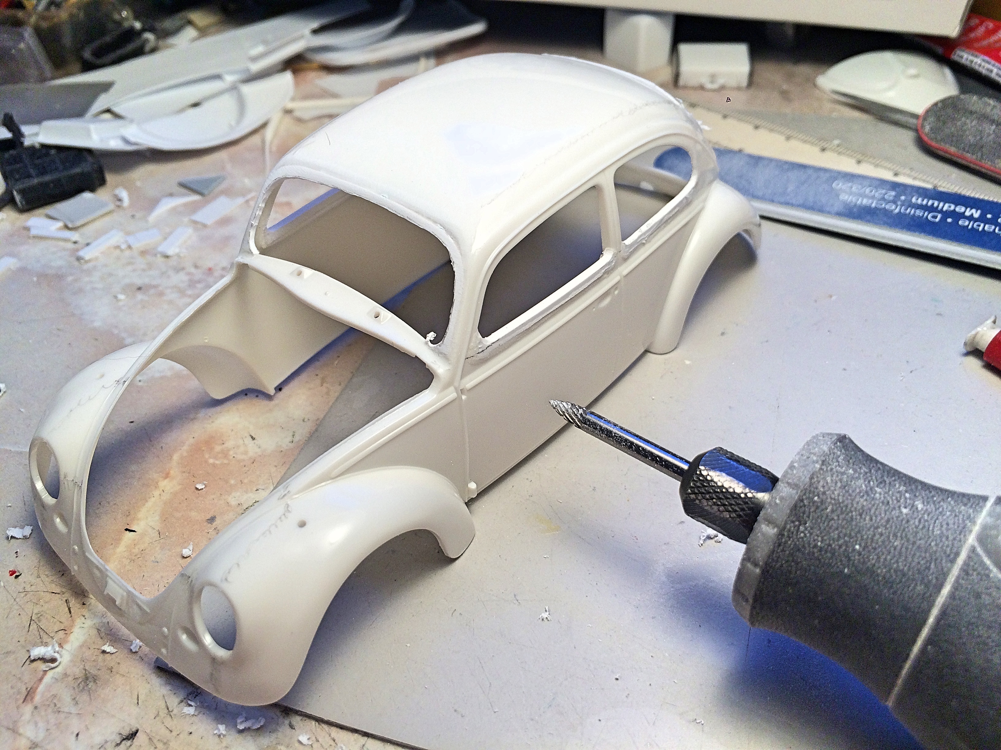

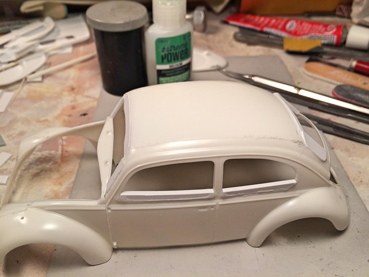

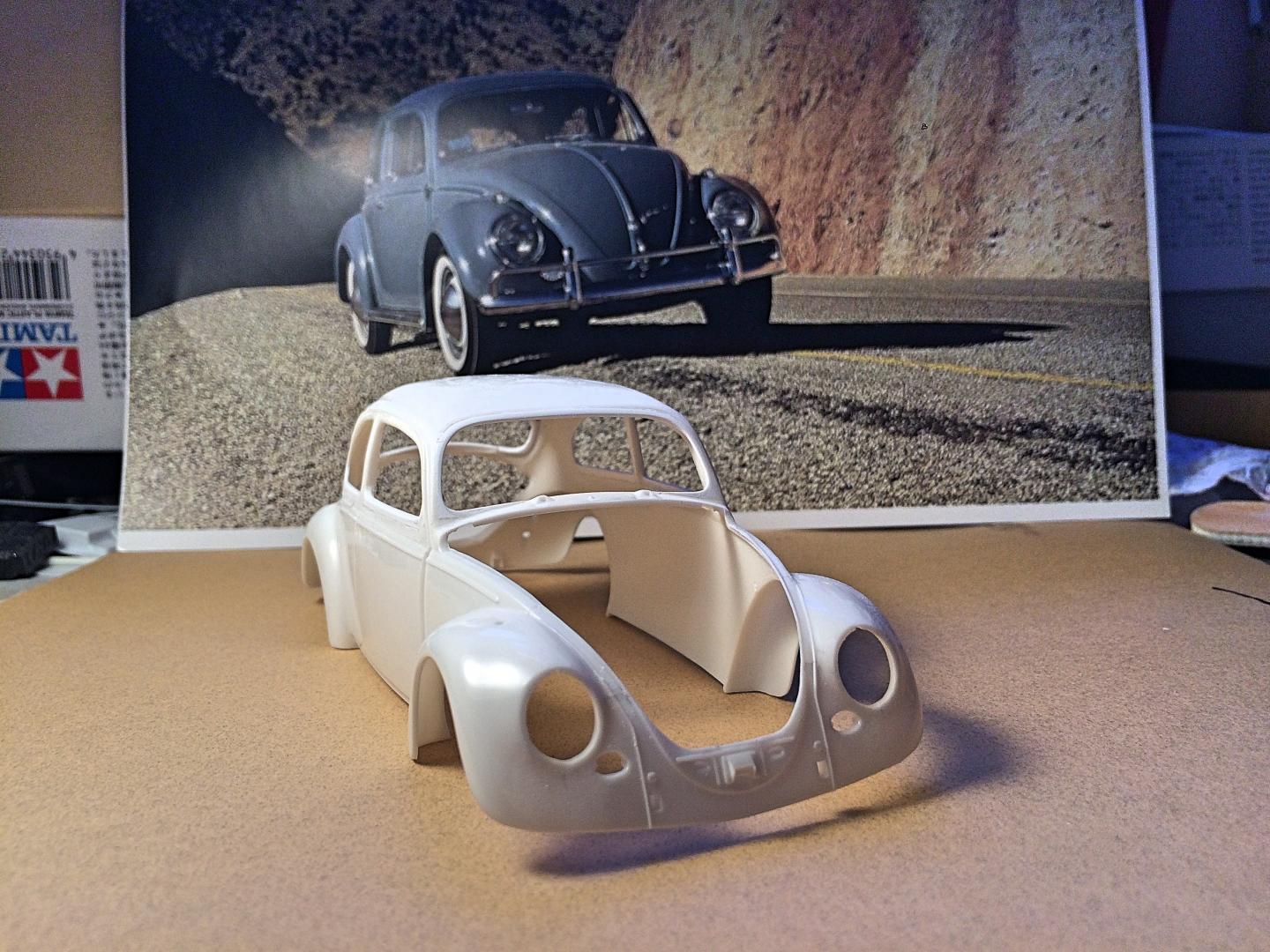

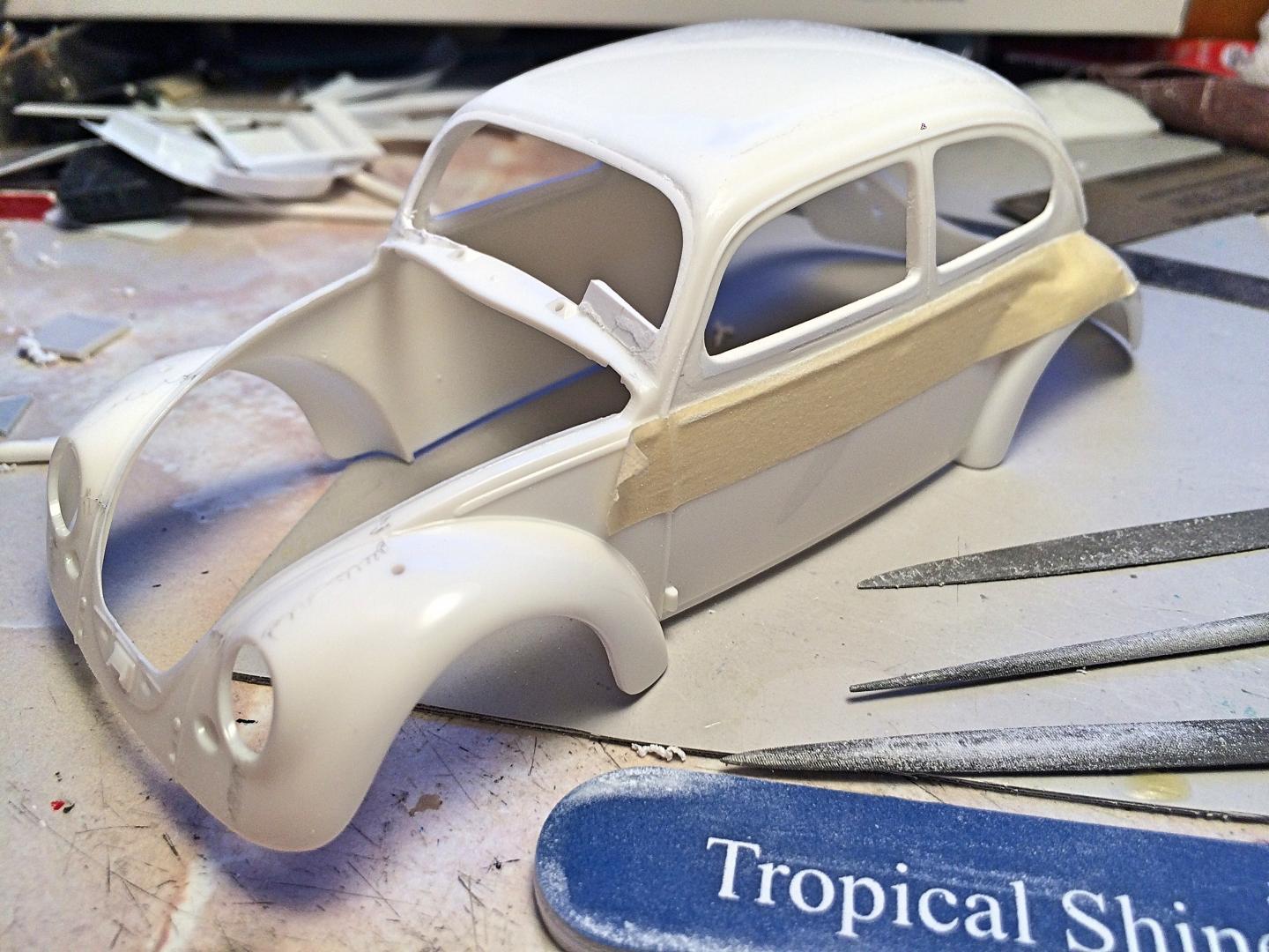

Major work today, backdated the body to 1960.  So glad superglue exists, using model glue would have been a PITA.  Seems like I did a bunch of work that made little difference, but the rivet counter in me is happy.
First step was grinding the openings to a very rough shape, leaving 1-2 MM to remove later.

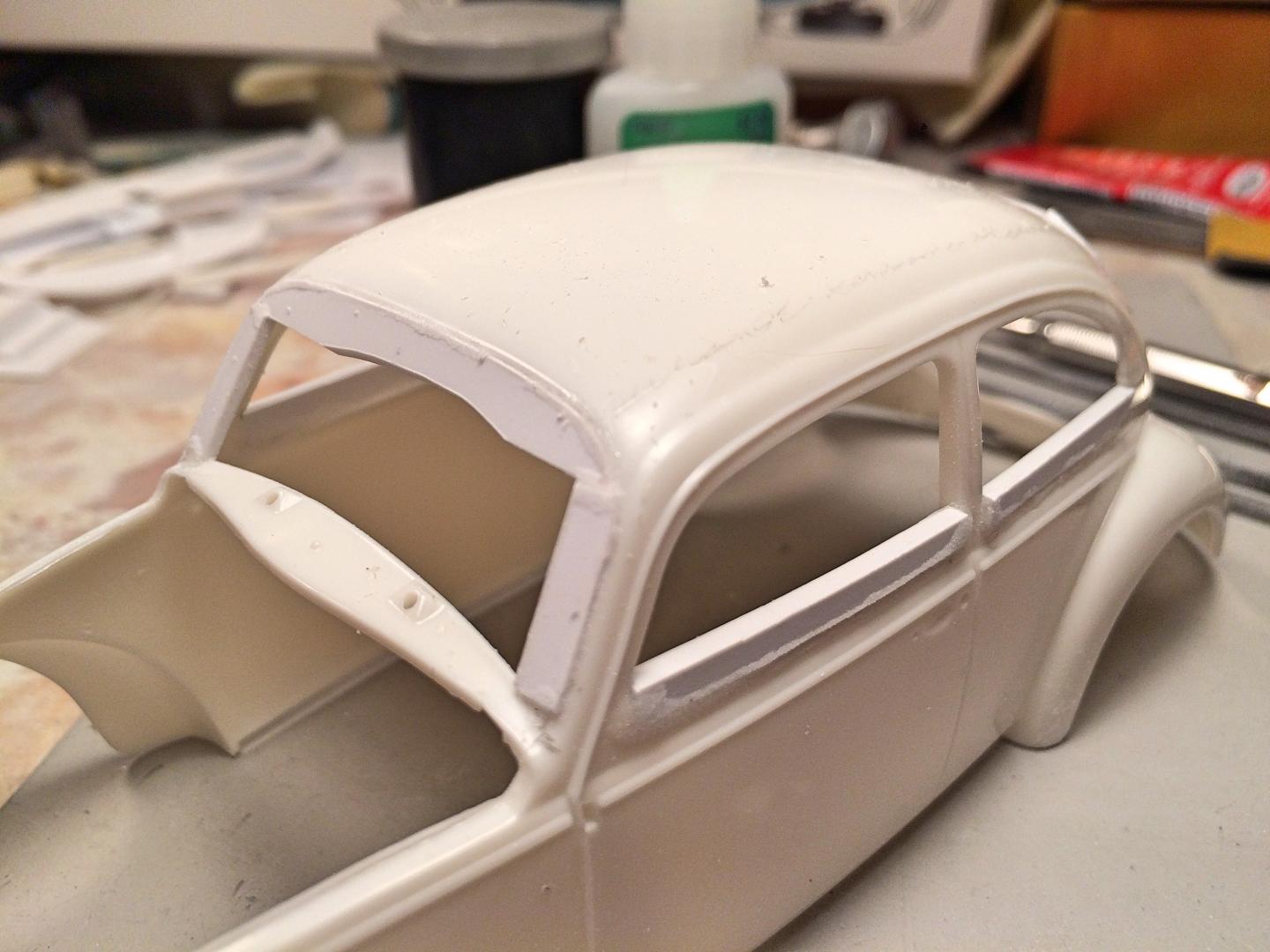

Then I used the new sanding stick to get the new plastic flush.  Thought I better put masking tape below so I wouldn't make more work for myself.  I also saw something needed revision.

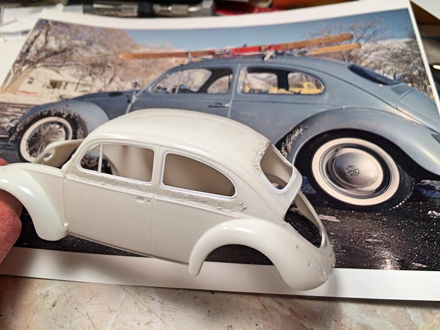

First stage is done.

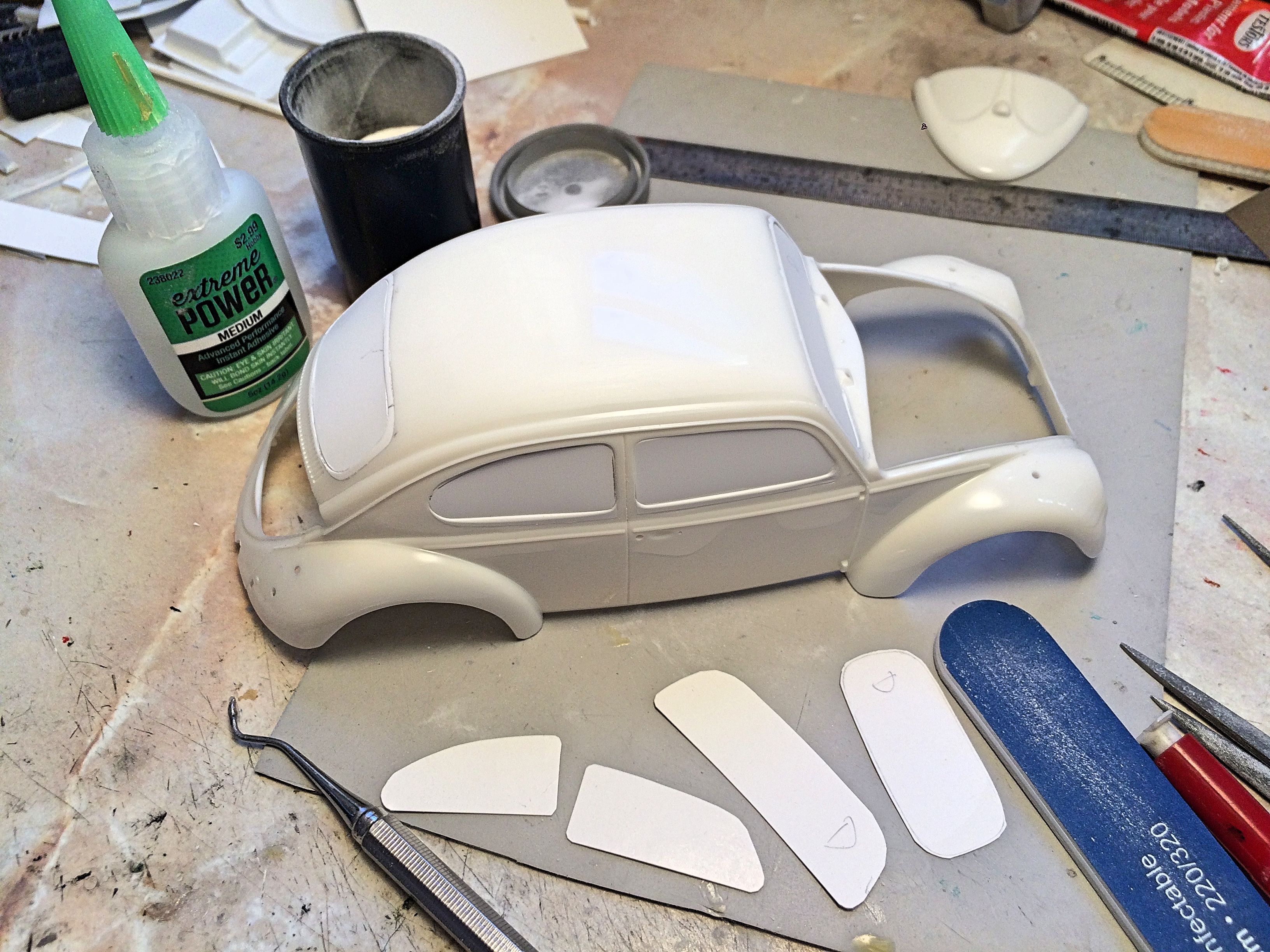

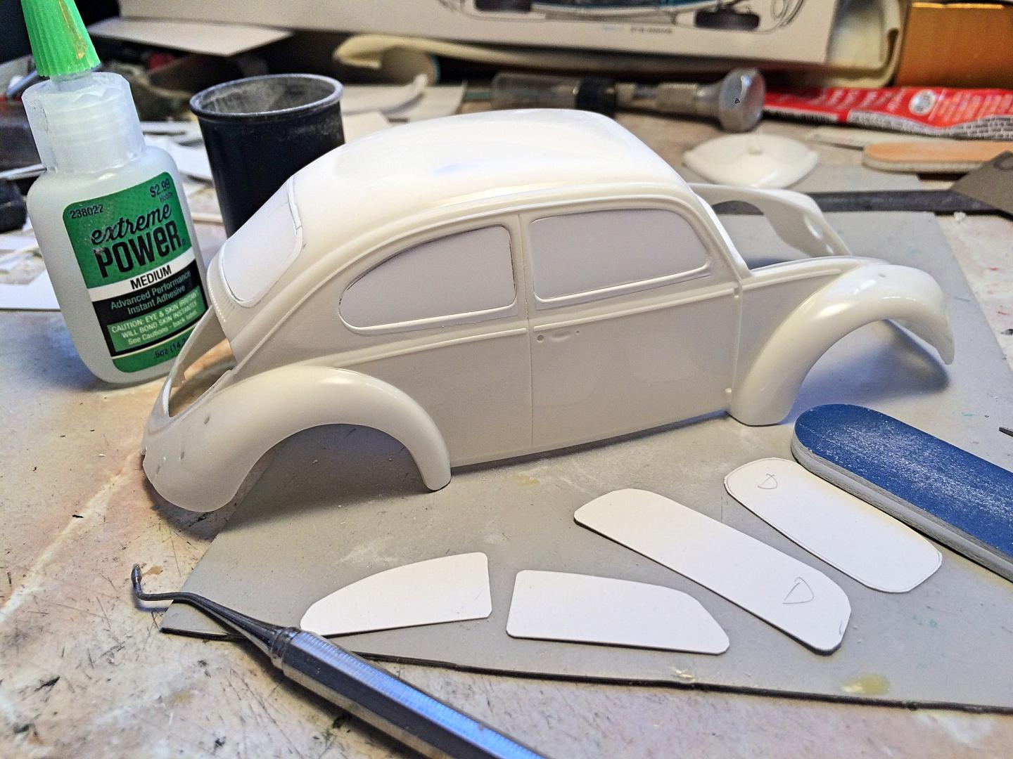

Nice thing about flat glass designs, easy to create the molding.  I made thick paper patterns first, then cut out the .02" plastic a bit bigger all around, then did a lot of trial fitting and sanding to get as perfect a fit a possible.  I got each panel to friction fit, then dabbed superglue on the inside, starting at the corners, then gooping it all along the seam, then I dumped on baking soda, very lightly spreading with my finger.  Paper patterns will be used for the new "glass".
Used the Dremel to cut into the center, then went around within 1 MM of the finish profile.  If I have any good advice, that spiral bit is the most useful one you can use on plastic, the more common ones melt the plastic and gum up.  Then I used the sanding stick if it fit, and files, and little sandpaper.
The '60 vent window divider is different than the '66 too, so that was carefully cut around.  You can see the first plunge into the windshield.

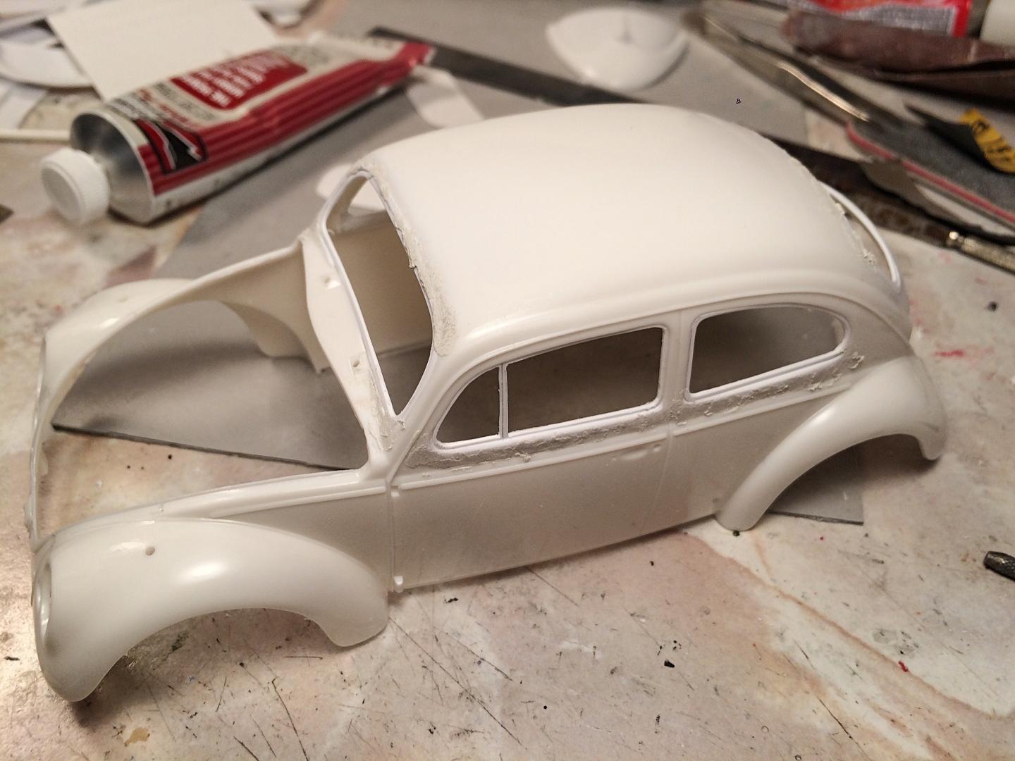

Mostly done sanding, then I washed the body so any baking soda that is exposed, dissolves.  Added putty to finish up.

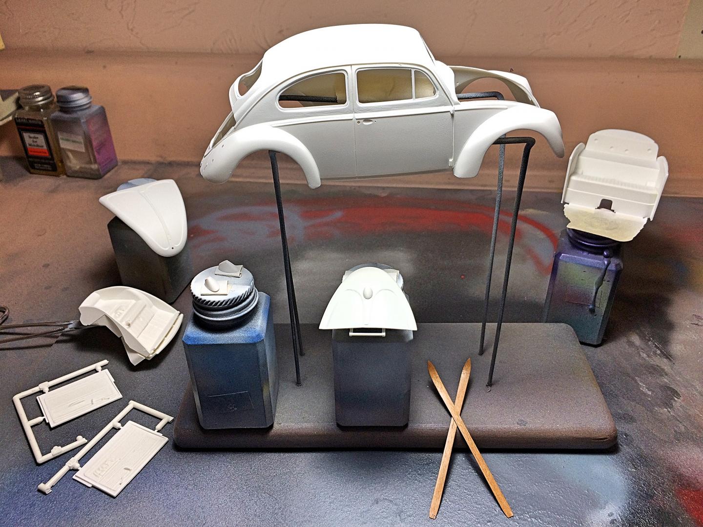

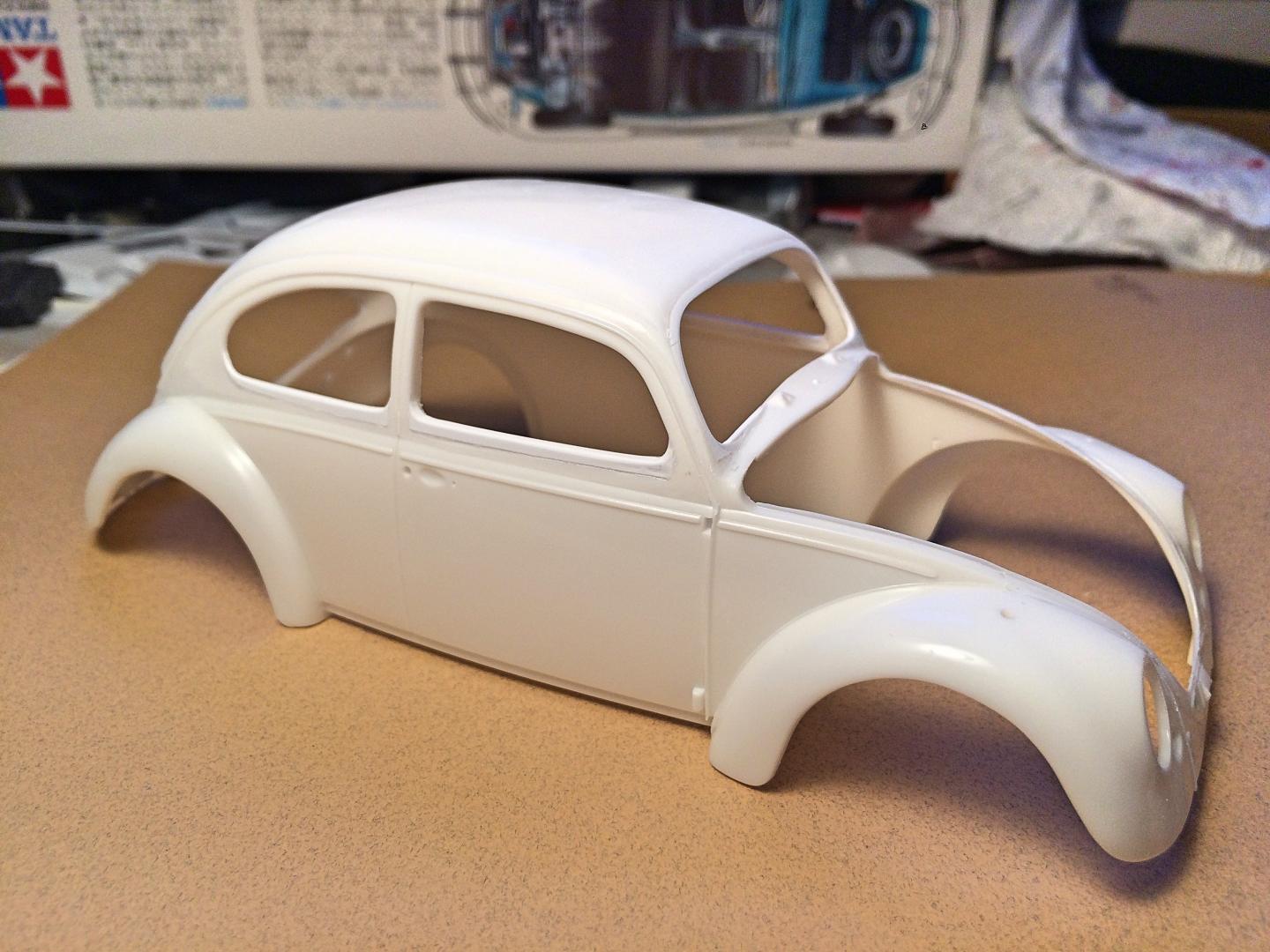

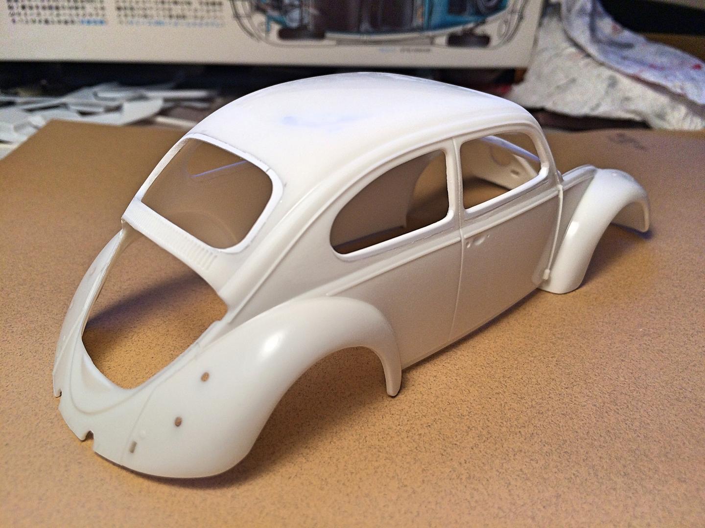

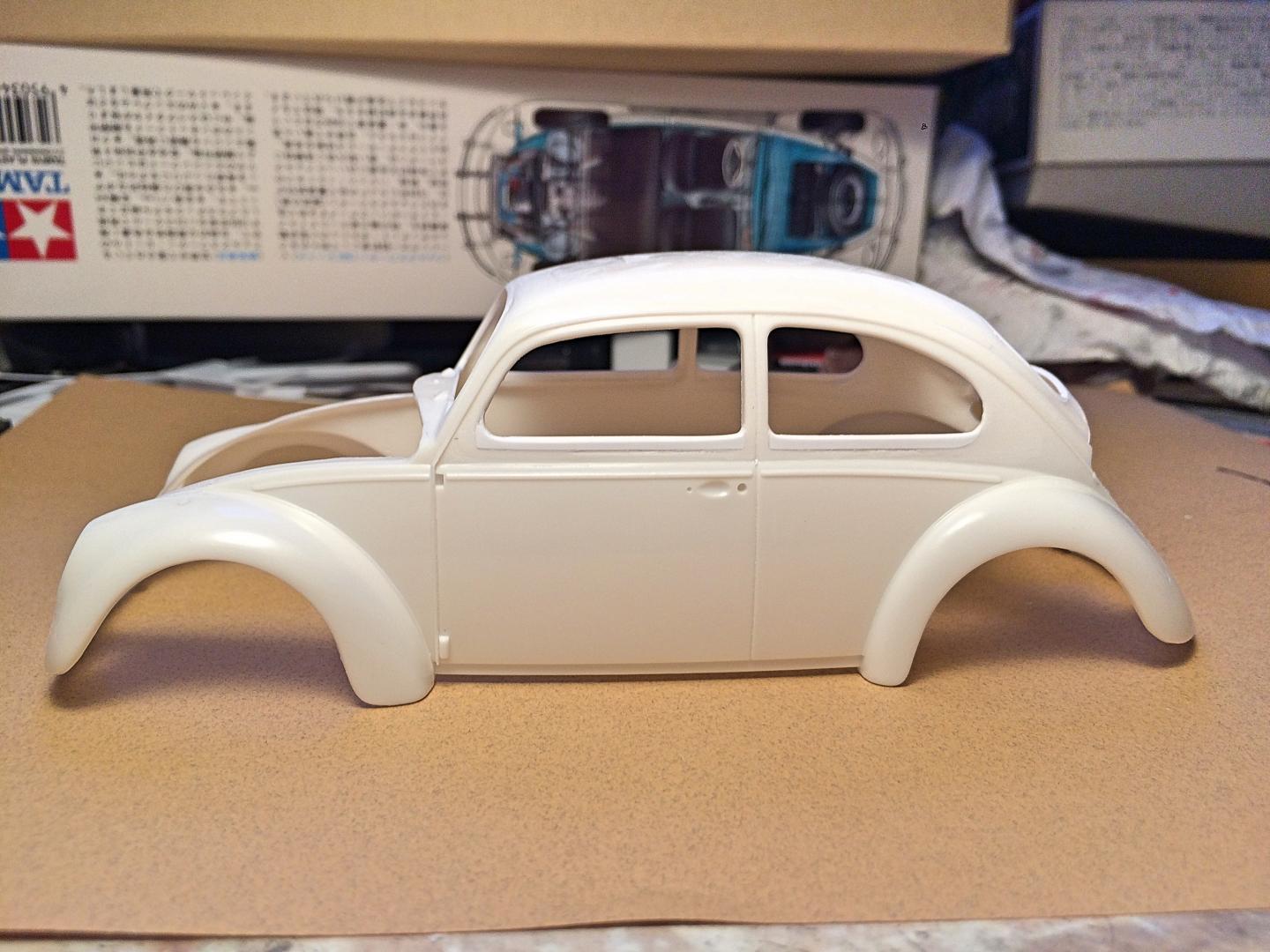

Final touches, and I thought this was all I needed to do when I started this project.  :blink:  It also tested my dexterity with holding onto tiny round parts, and when I dropped them to find them.  The taillights only needed to be profile sanded to remove the lens/housing line, and the face of the lens to remove screw and divider line.  Made the turn signals from the clear sprue (why didn't Tamiya make them also clear?), they are smaller than the '66.  I polished the lens surfaces by burnishing on a paper towel.
Share this post
Link to post
On 1/15/2019 at 5:53 PM, Oldmopars said:
I don't know how set you are on making it accurate, but one thing to keep in mind is that the size of the side and rear glass changed in 1965. [...]  Carefully compare the size and shape of the windows.  [...]
Thanks for talking me into doing this!  It took about 8 hours total, most of today, but I'm sure it will be the only accurate 1960 Bug at a contest.  B)  But every time I read that Volkswagen Beetle Spotter's Guide, I see something else to address.  :unsure:

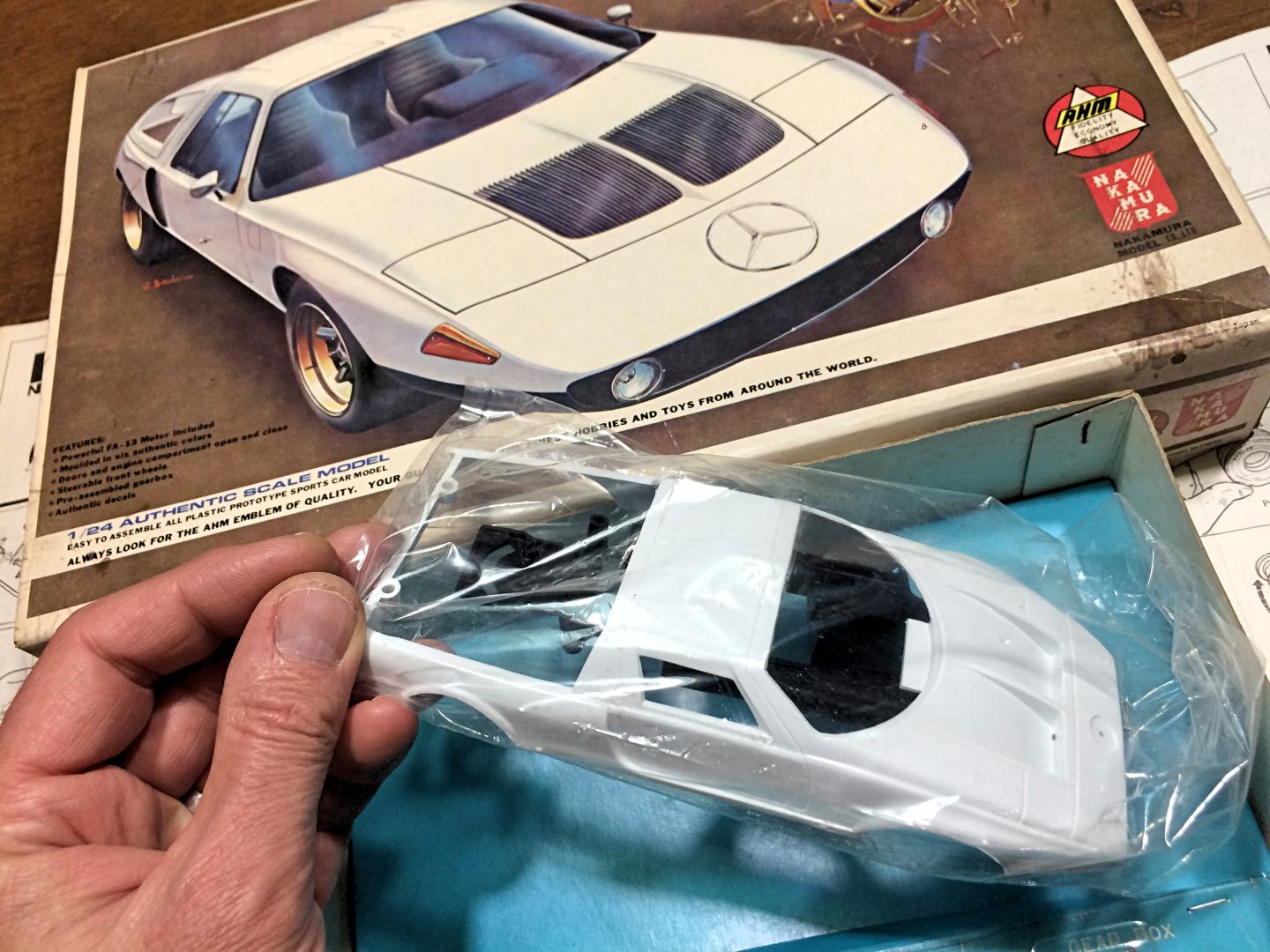

Thank you for the encouragement!  I've dealt with fixing lousy kits before.  A someday project is going to require massive fixing to look good, because no other kit exists.

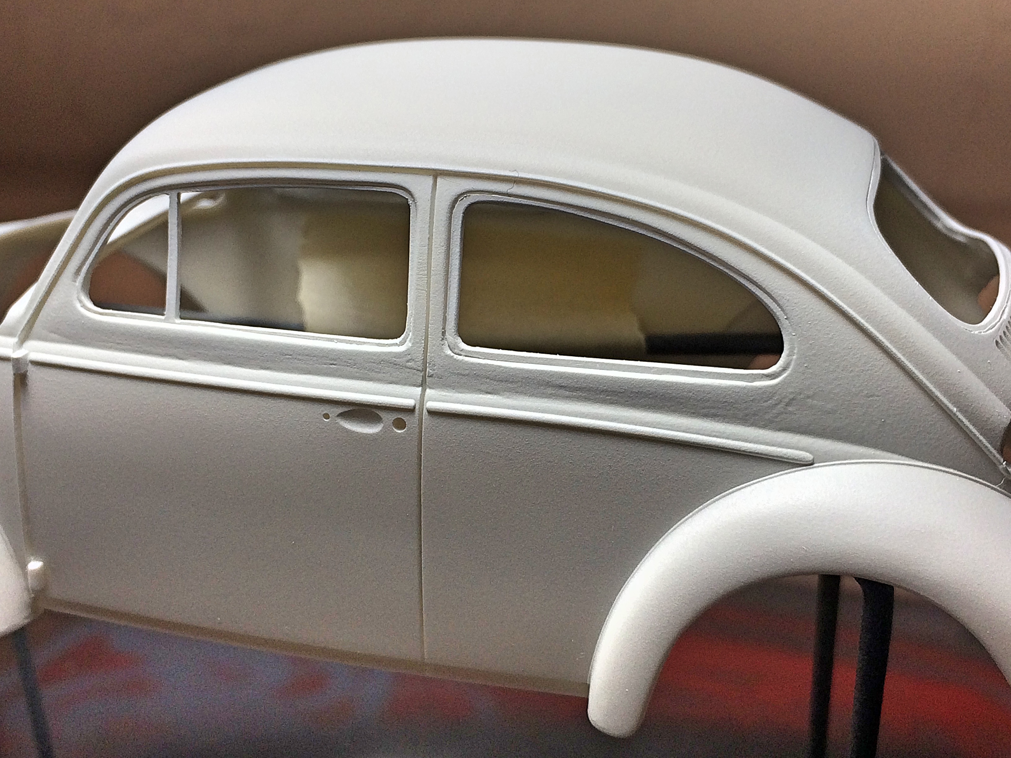

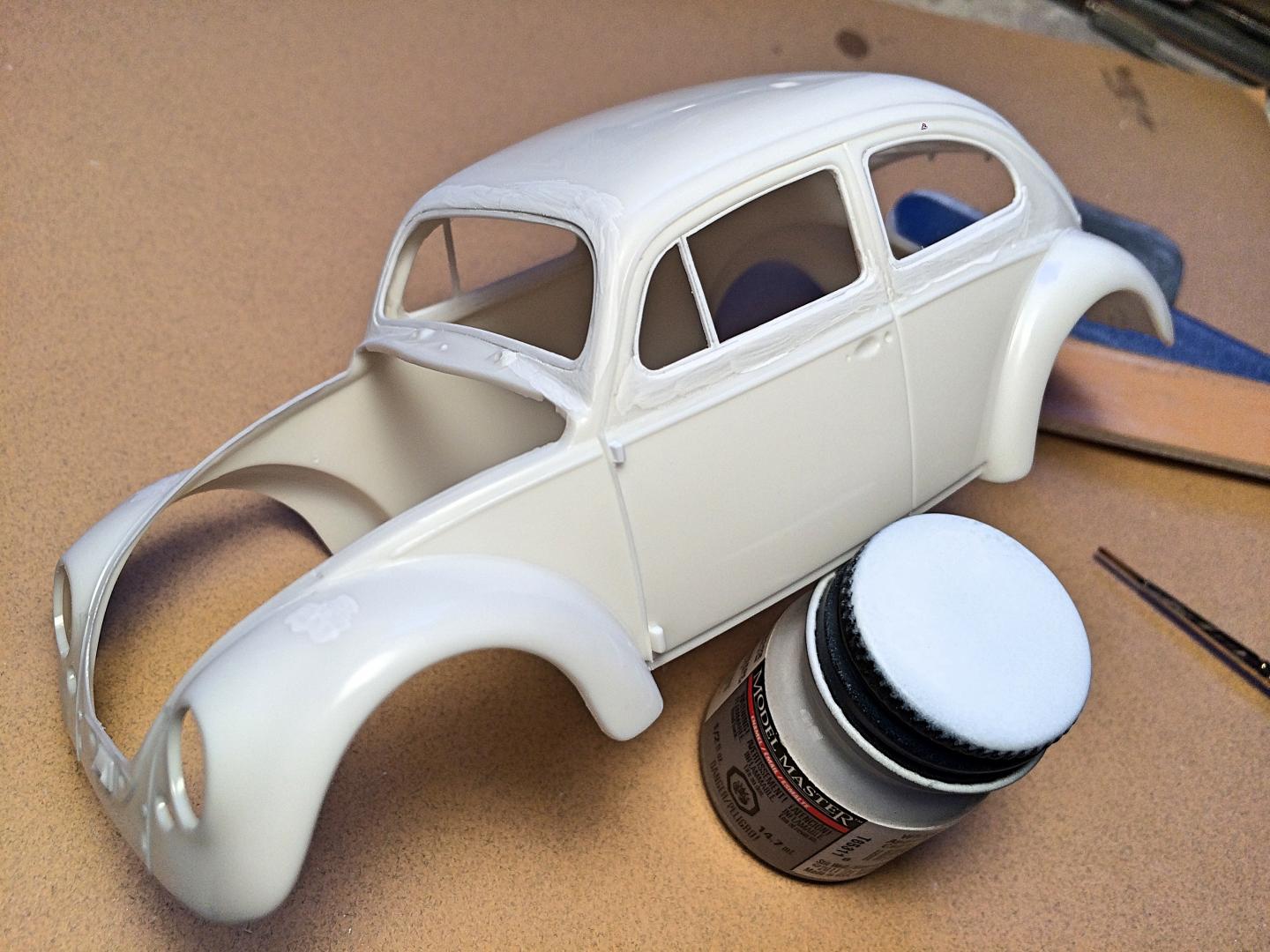

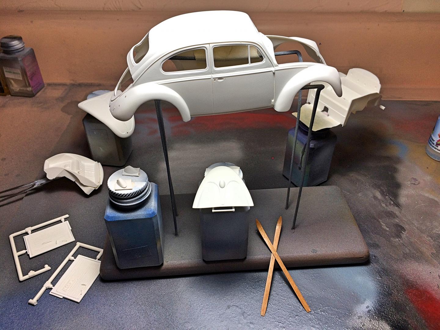

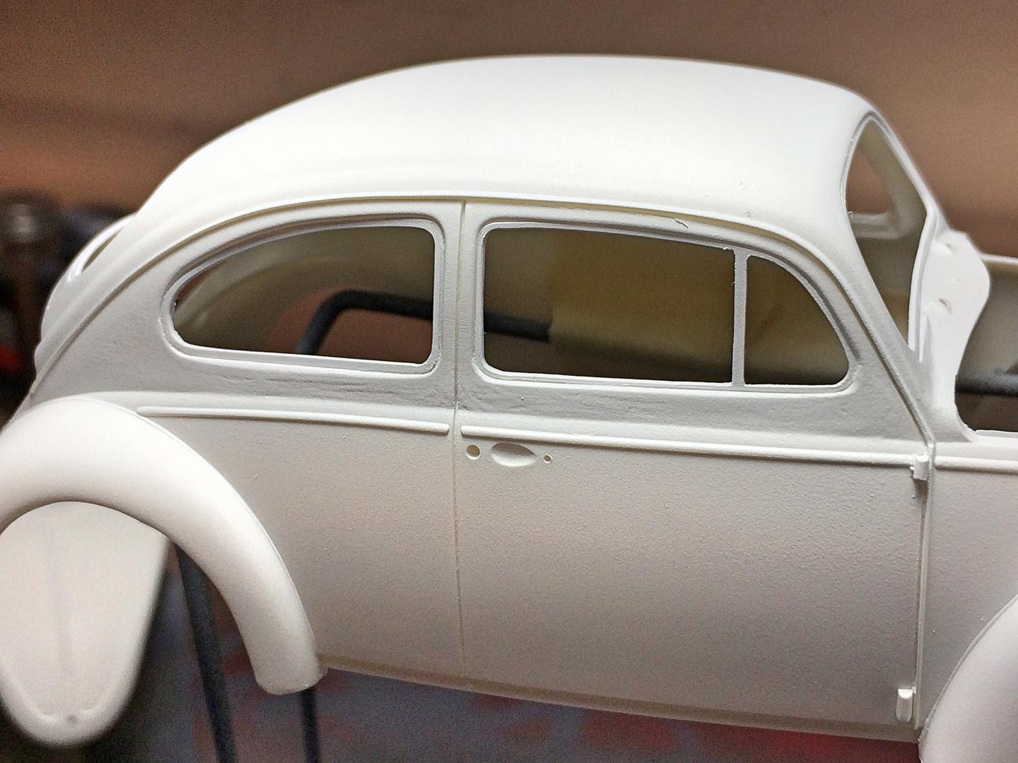

GRRrrrr.... :angry:  A little embarrassed to show this, but here goes.  I know if putty isn't treated first with either superglue (not this time) or paint, it absorbs paint and shows up.  So I brush painted primer, then sanded before airbrushing.
 No matter what, it's difficult to see how bad it is, until I spray primer, then it jumps out at me.  :wacko:  But I did narrow the skis, and varnished, so far so good there.
Not happy with this!  Thinking about making special tiny sanding blocks with new sandpaper.
Share this post
Link to post
Kurt, if it were me doing those mods on the body, I'd be using a barrier coat of some sort before any kind of painting. I had the same thing happen to my stillborn '55 Ford Victoria, but it didn't rear its ugly head till later on with the color coats.
More work, but in the long run less headaches!
