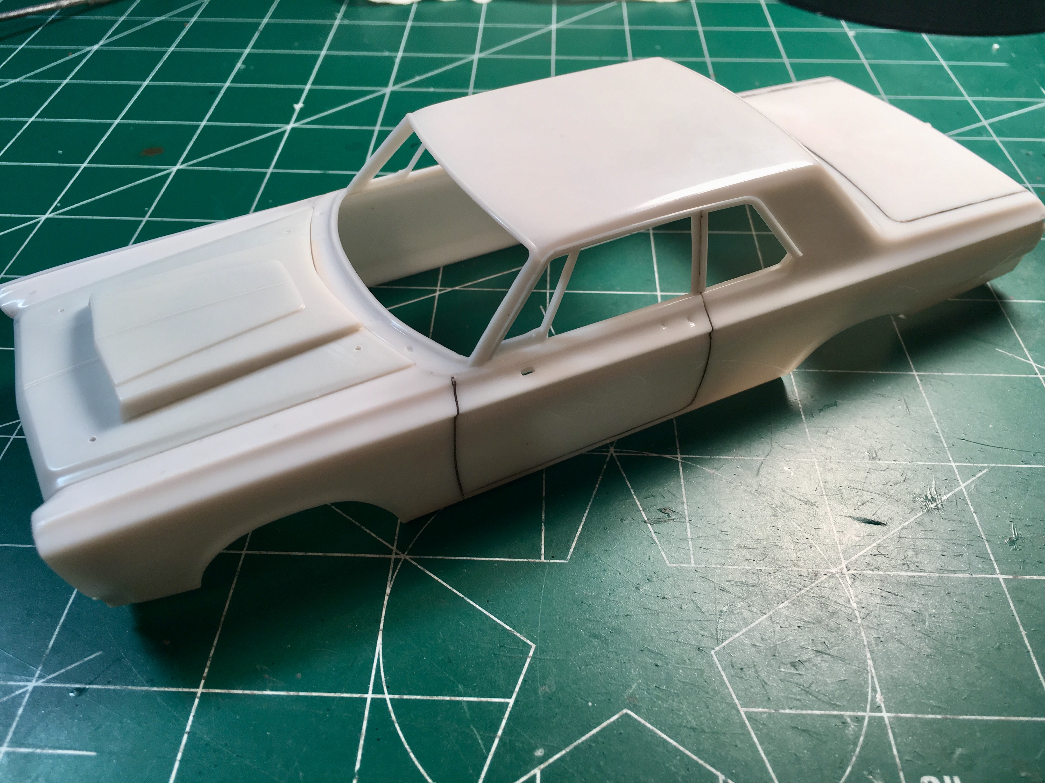

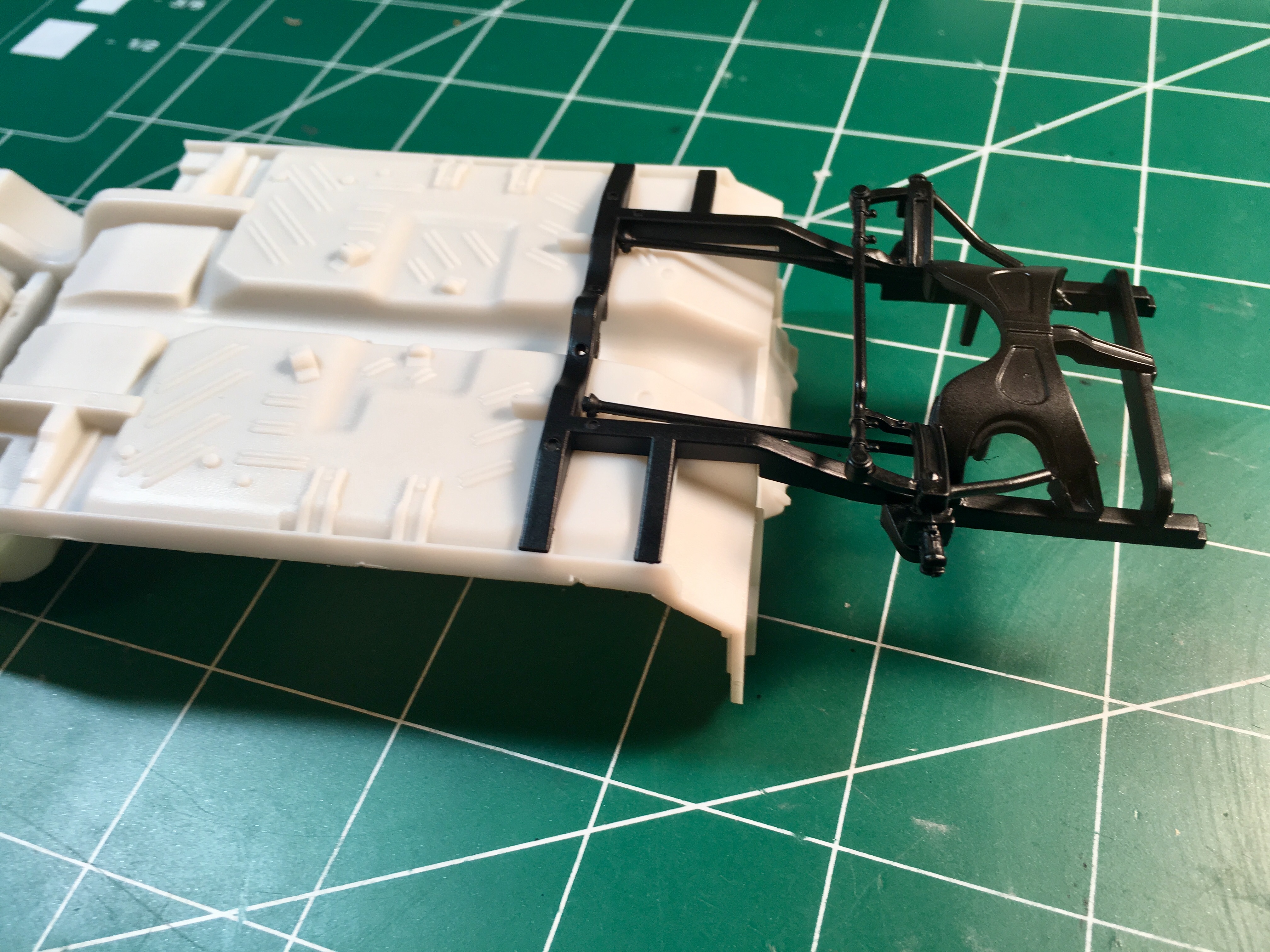

Brutalform Posted January 15, 2019 Share Posted January 15, 2019 Time to start the 65 Plymouth drag car. I’m not interested in building the Leal car, but just a “plain Jane” factory racer. The exterior will be Racing White, and Champagne Gold for the interior. Started to work on the car last night. This is where I’m at now. Quote Link to comment Share on other sites More sharing options...

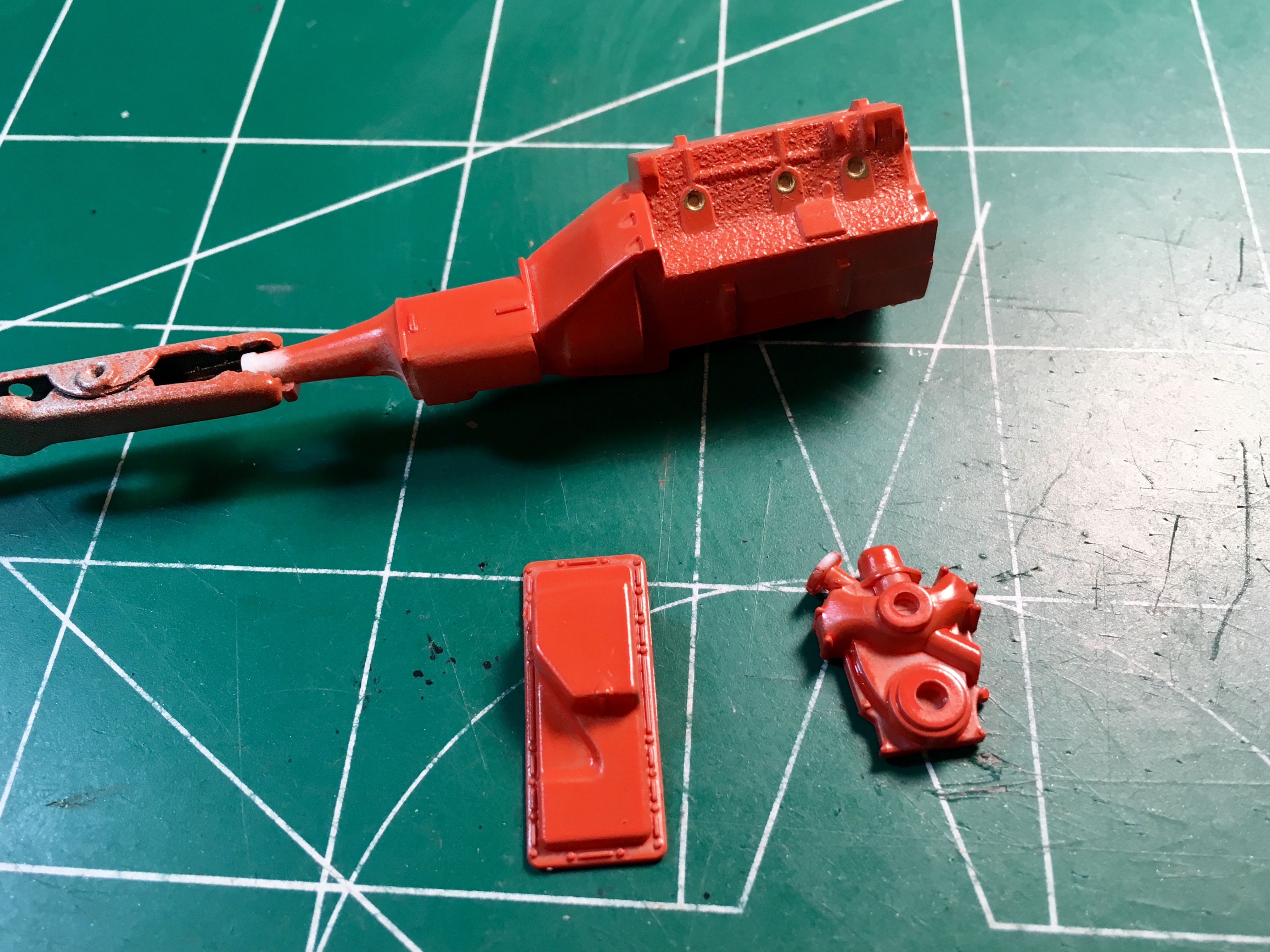

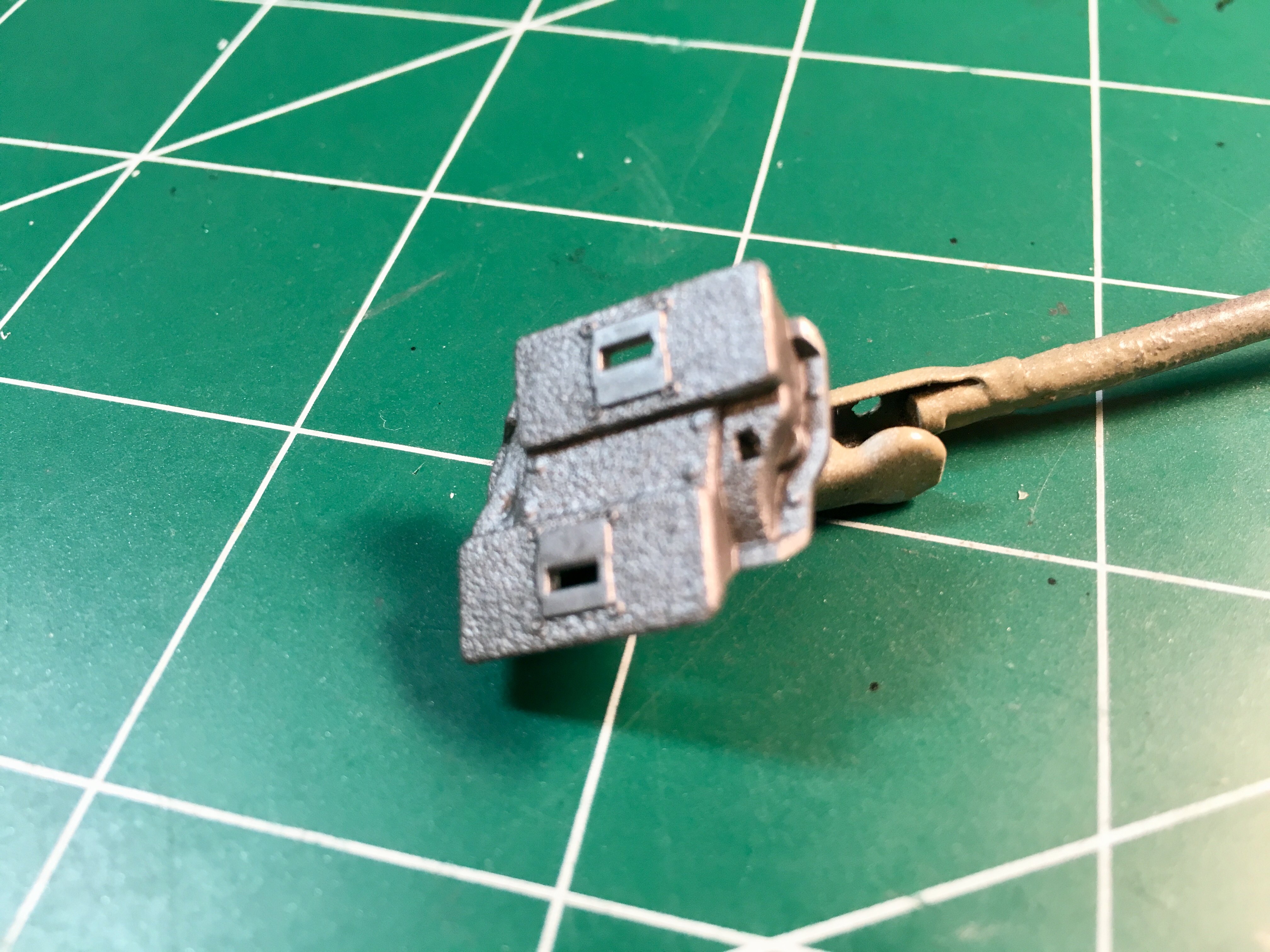

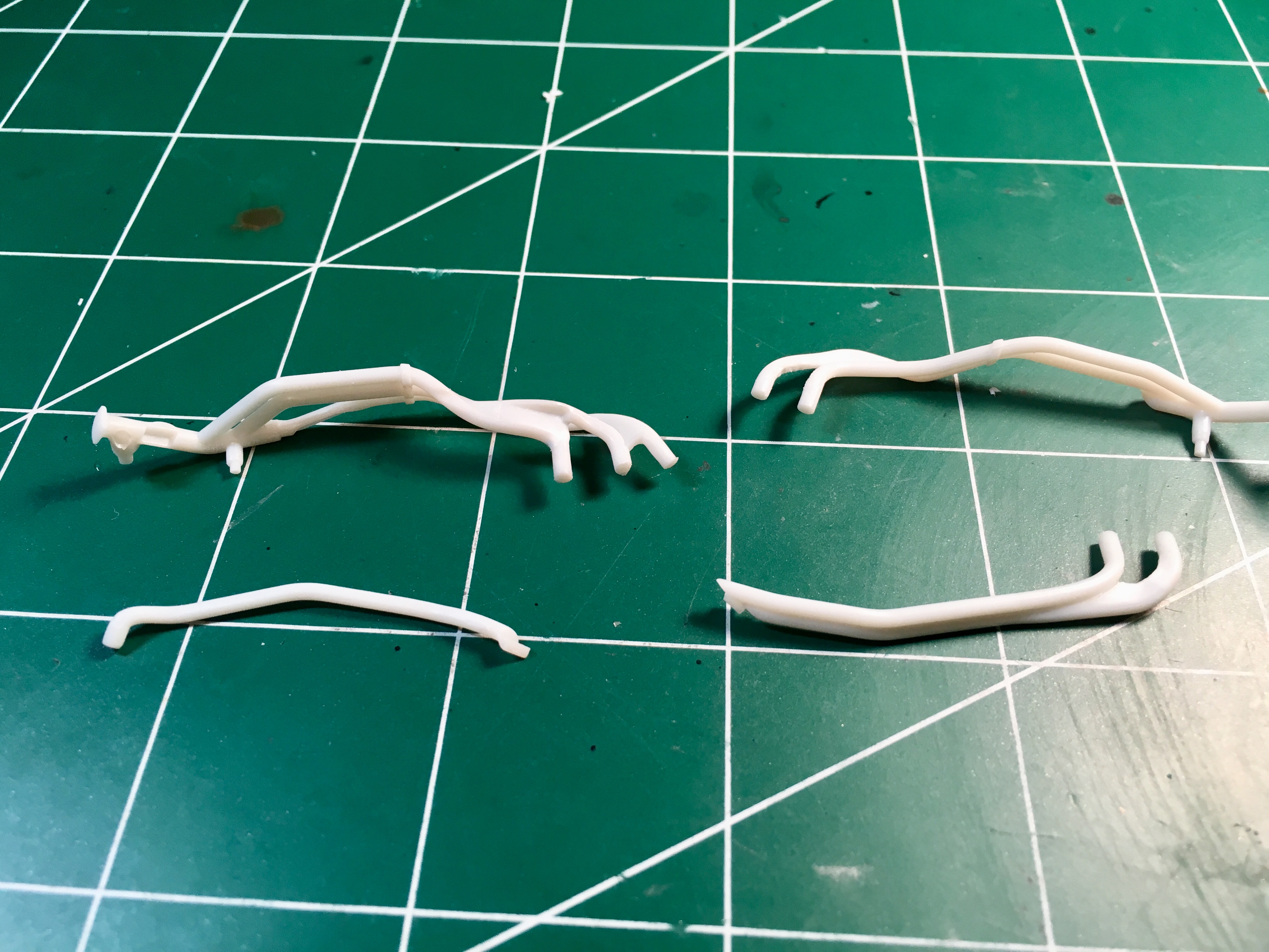

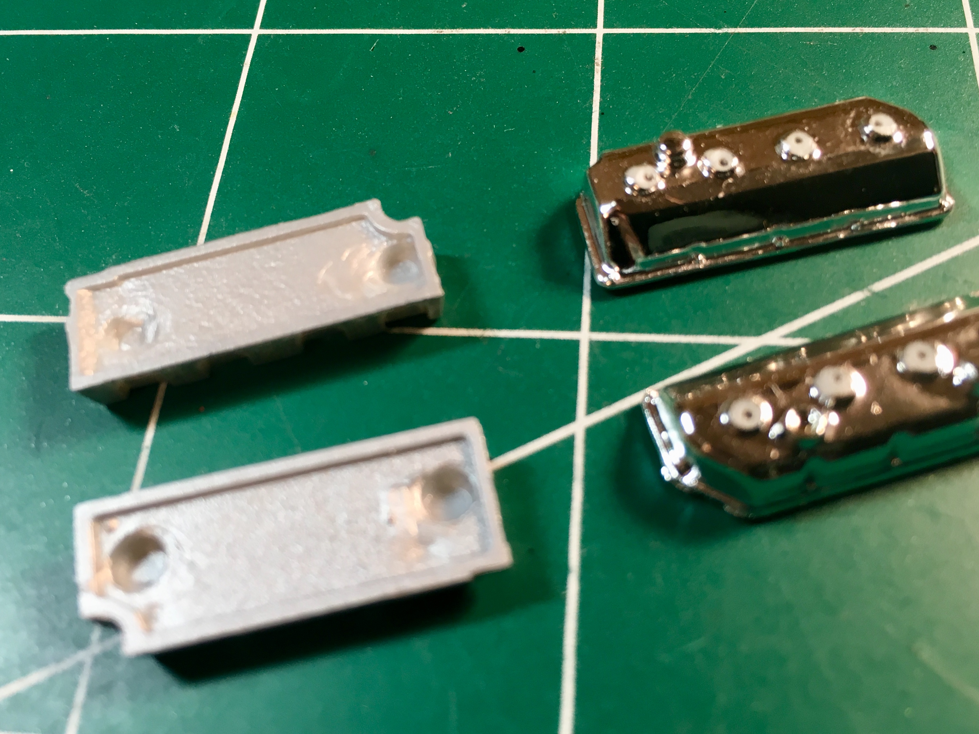

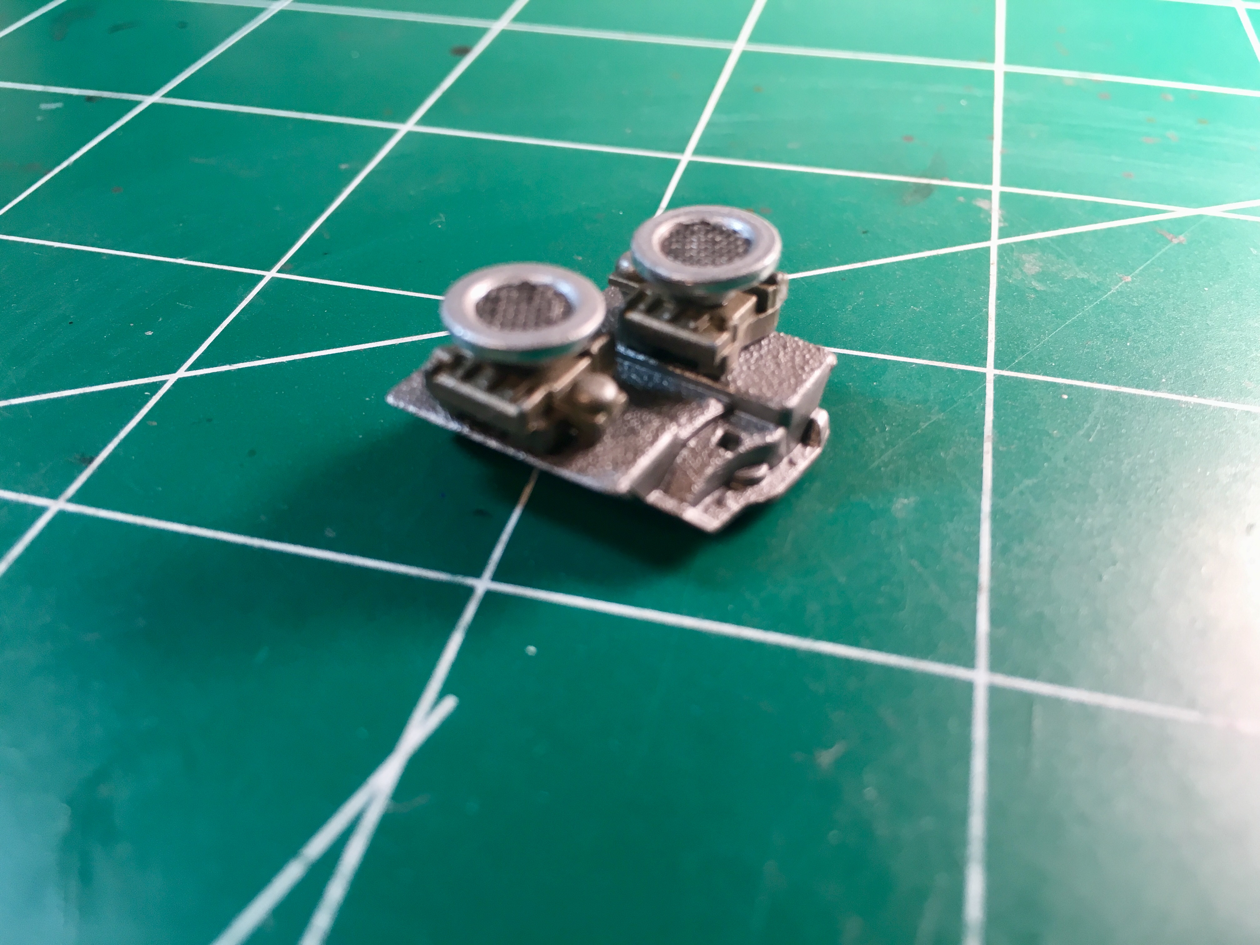

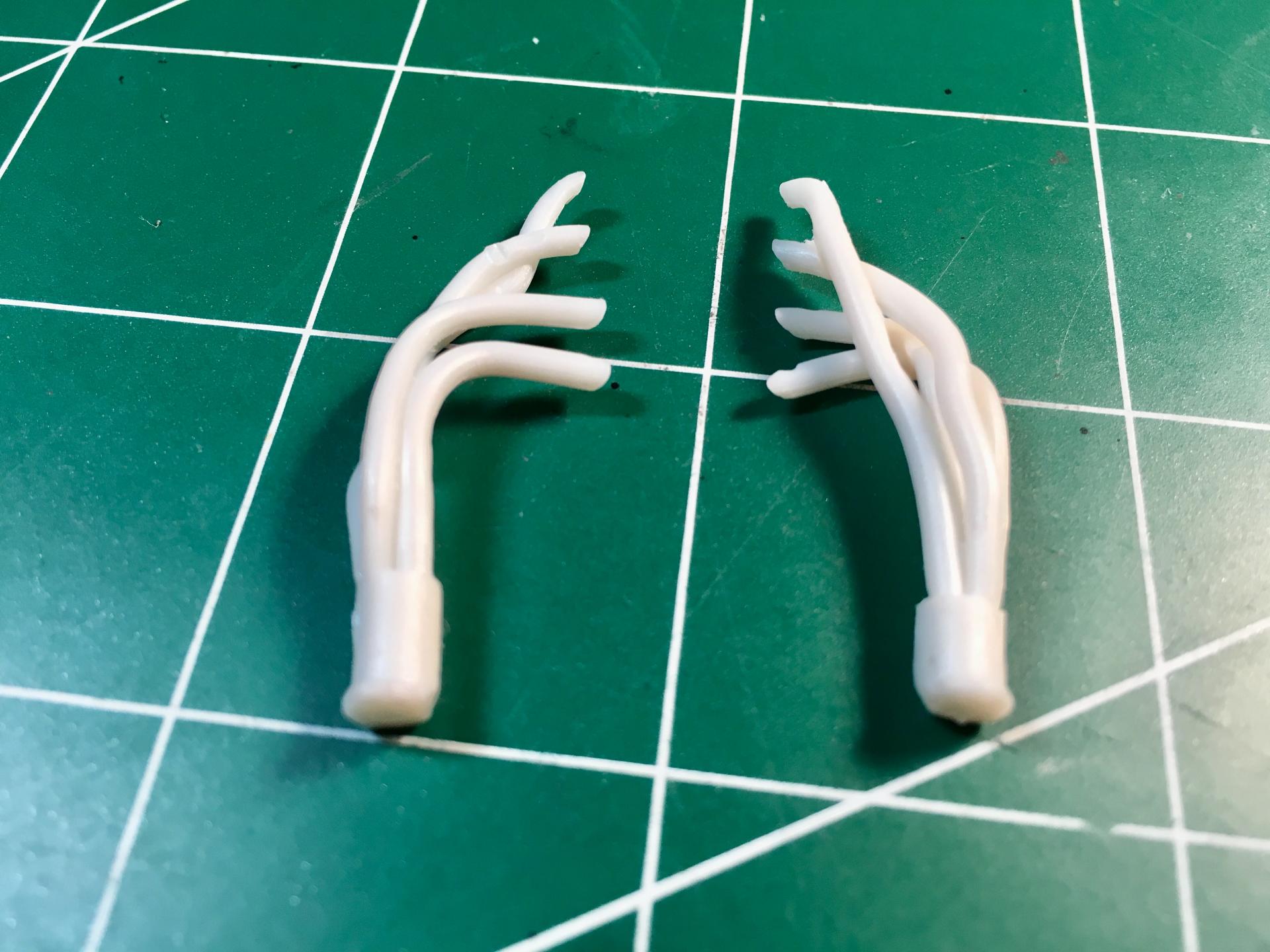

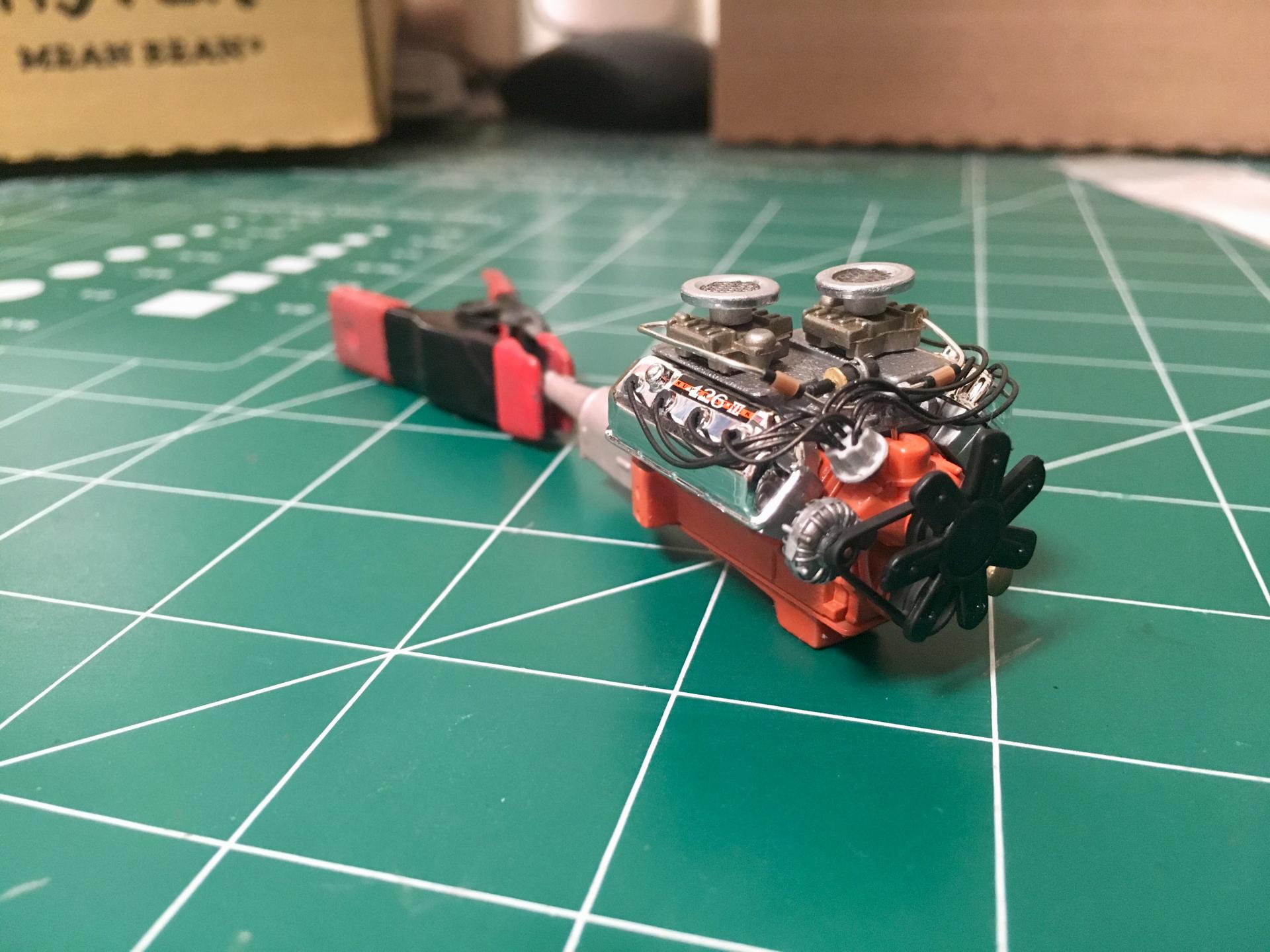

Brutalform Posted January 15, 2019 Author Share Posted January 15, 2019 Decided to have the magnesium intake manifold, and aluminum cylinder heads. I thought the Hemi came out decent with Tamiya Orange, as long as gray primer is under it. Im not very knowledgeable with Mopars, so maybe someone can chime in about the headers to use. Which set would you find on this kind of car? Quote Link to comment Share on other sites More sharing options...

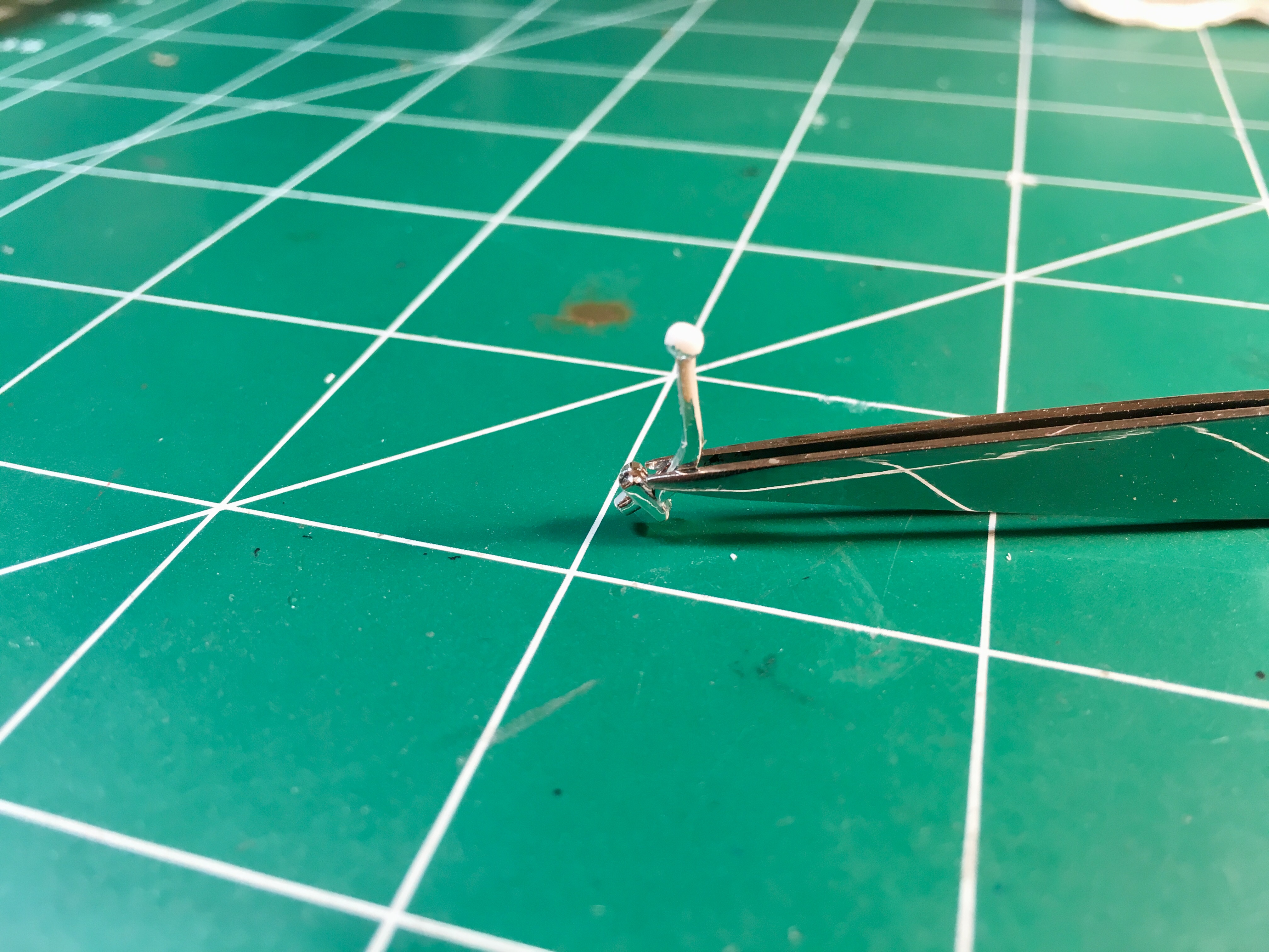

Brutalform Posted January 15, 2019 Author Share Posted January 15, 2019 I also made a heater and radio delete plates for the dash. The four speed shifter knob was ridiculously too large. It would be the size of a softball on the 1:1 car, so I added a smaller knob. Quote Link to comment Share on other sites More sharing options...

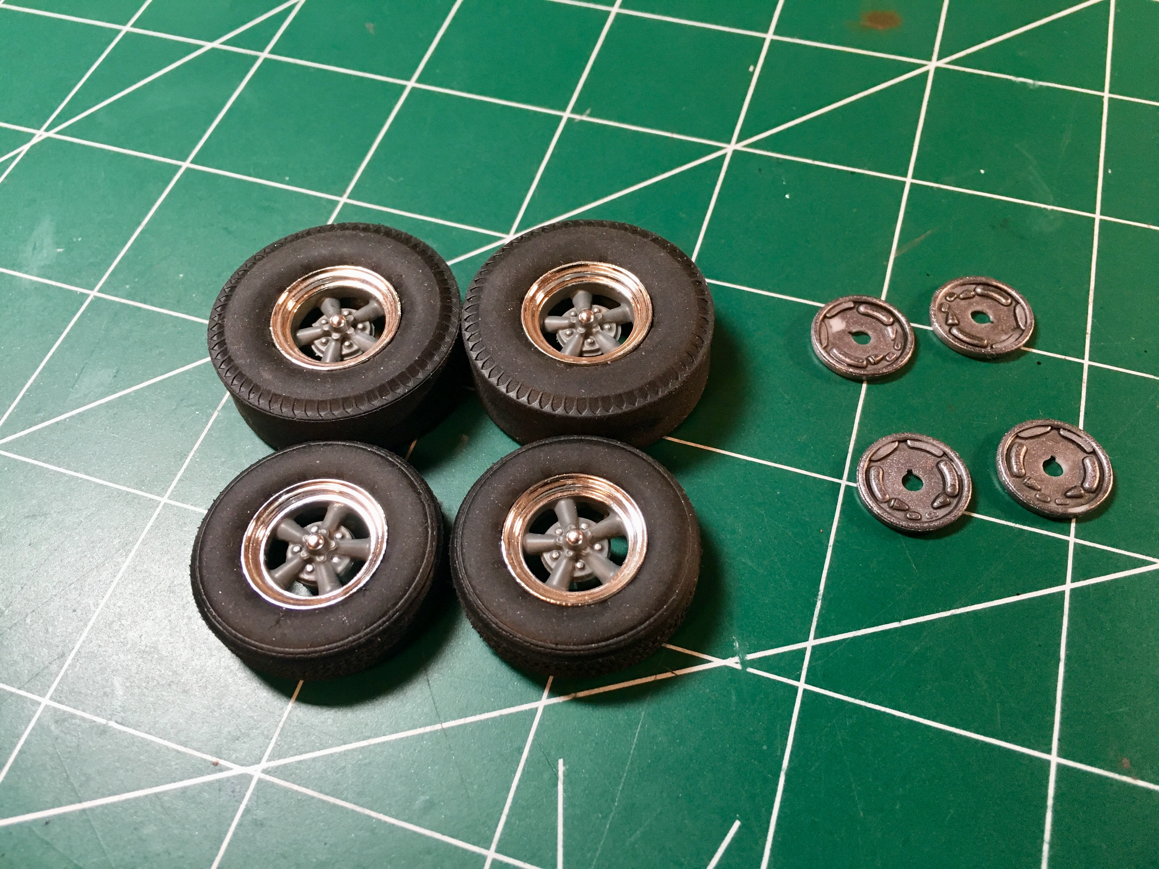

Brutalform Posted January 15, 2019 Author Share Posted January 15, 2019 The wheels and tires.... Quote Link to comment Share on other sites More sharing options...

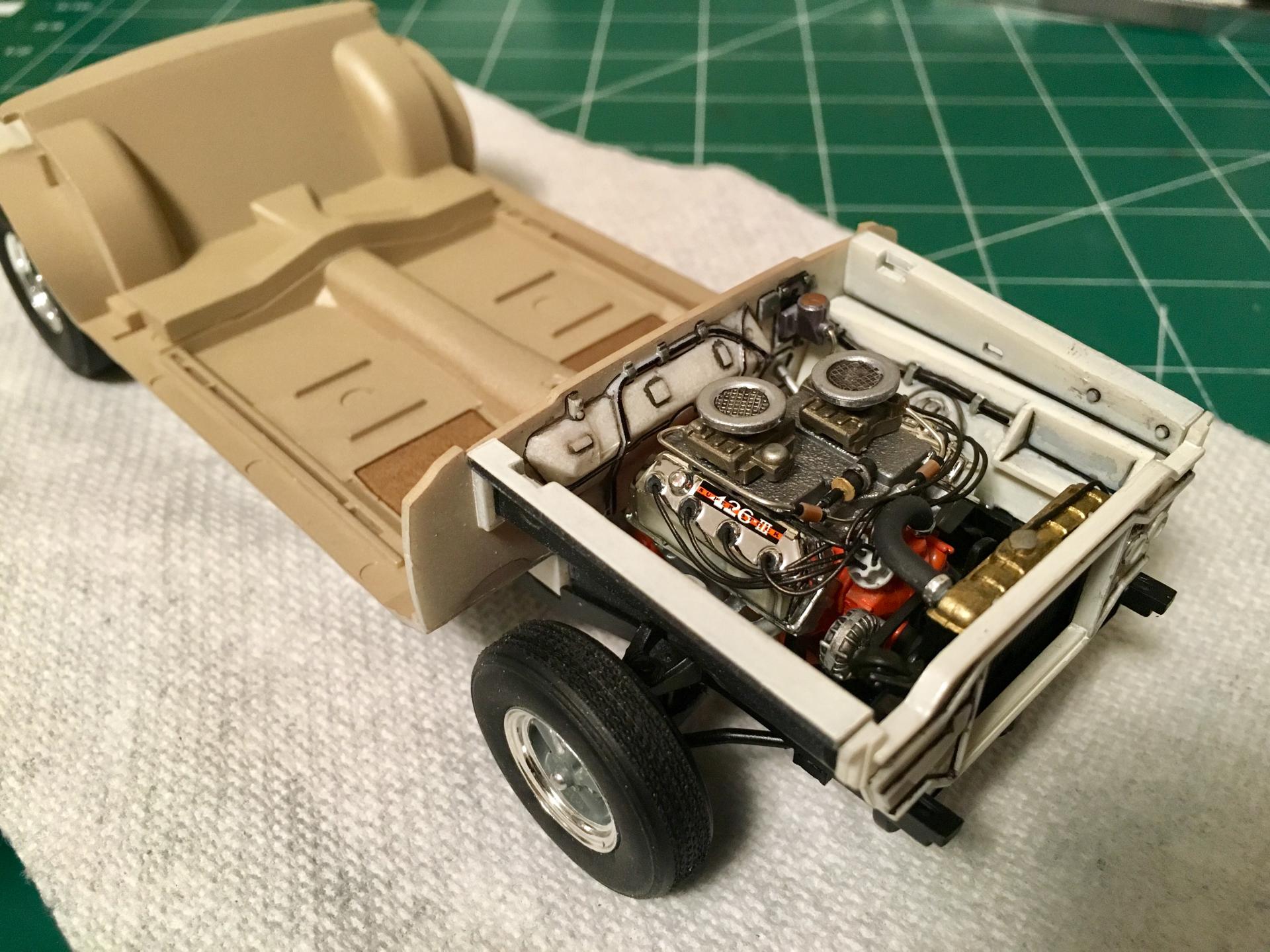

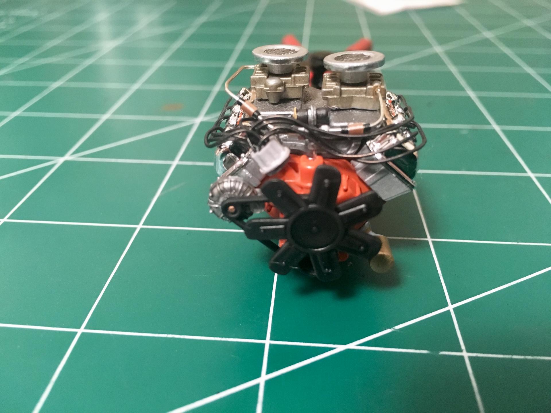

Brutalform Posted January 16, 2019 Author Share Posted January 16, 2019 Got the Hemi put together, and added some wires and fuel lines and filters. Quote Link to comment Share on other sites More sharing options...

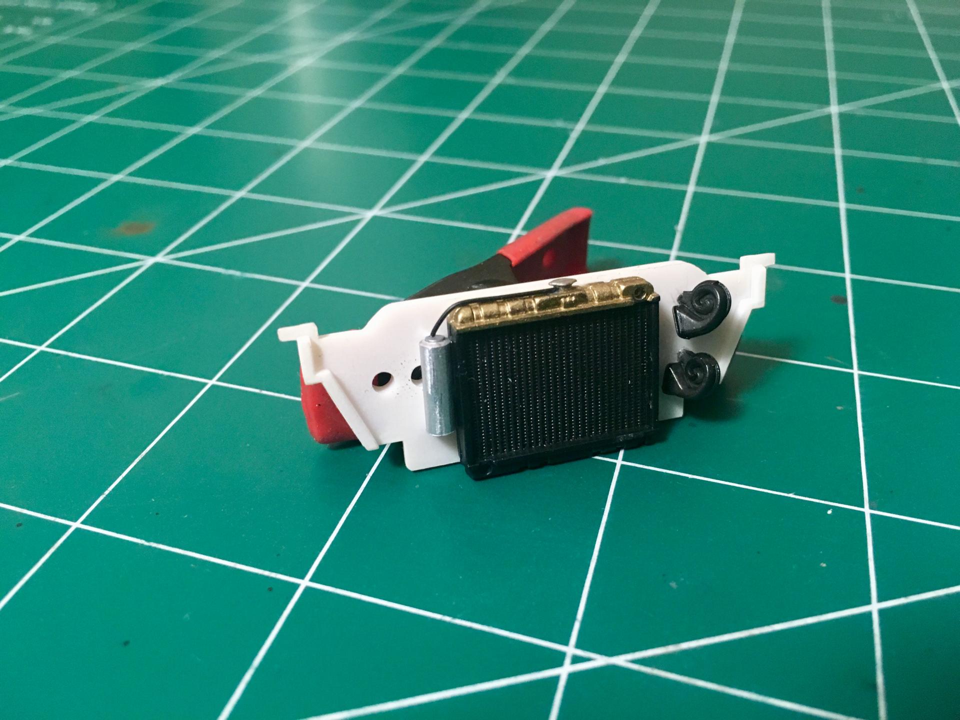

Brutalform Posted January 16, 2019 Author Share Posted January 16, 2019 And made a little over flow can for the radiator. Quote Link to comment Share on other sites More sharing options...

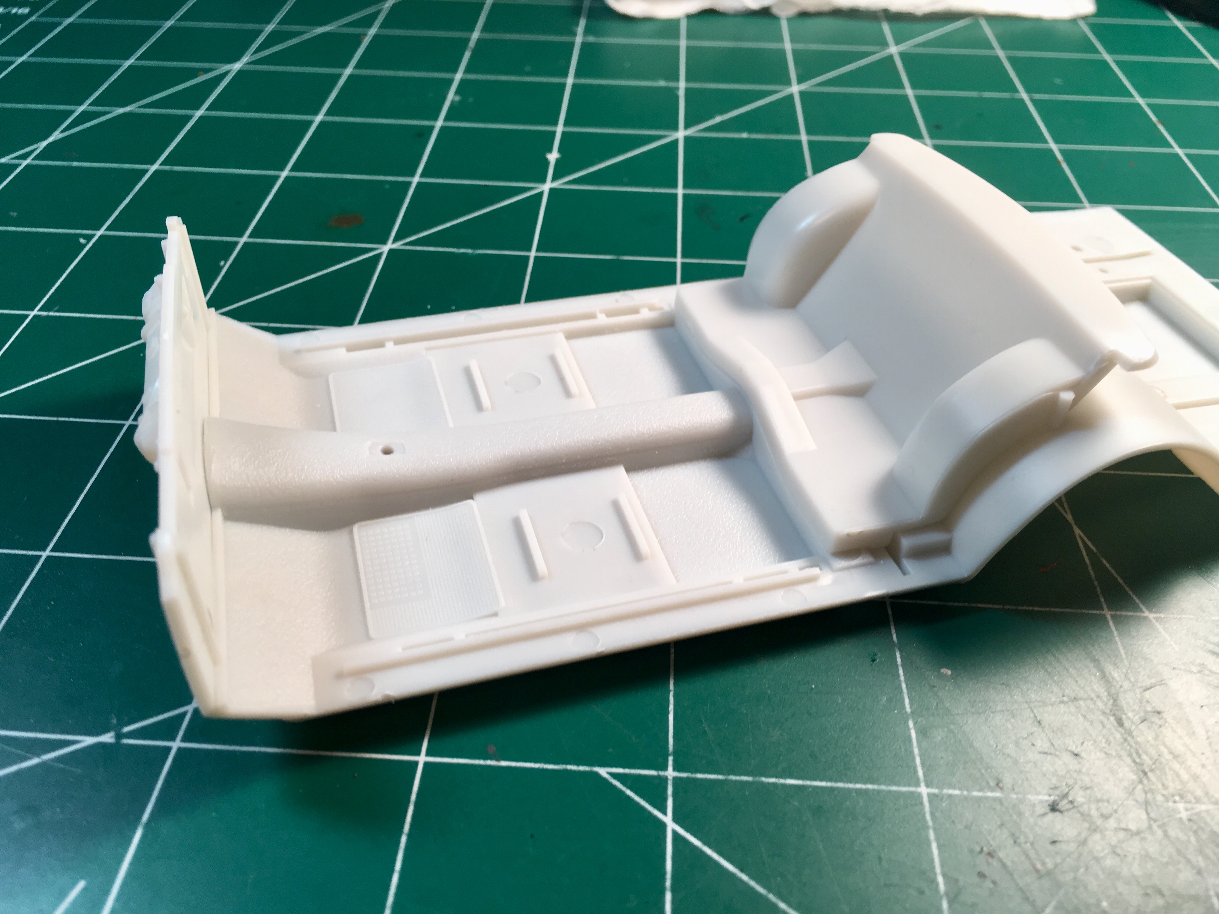

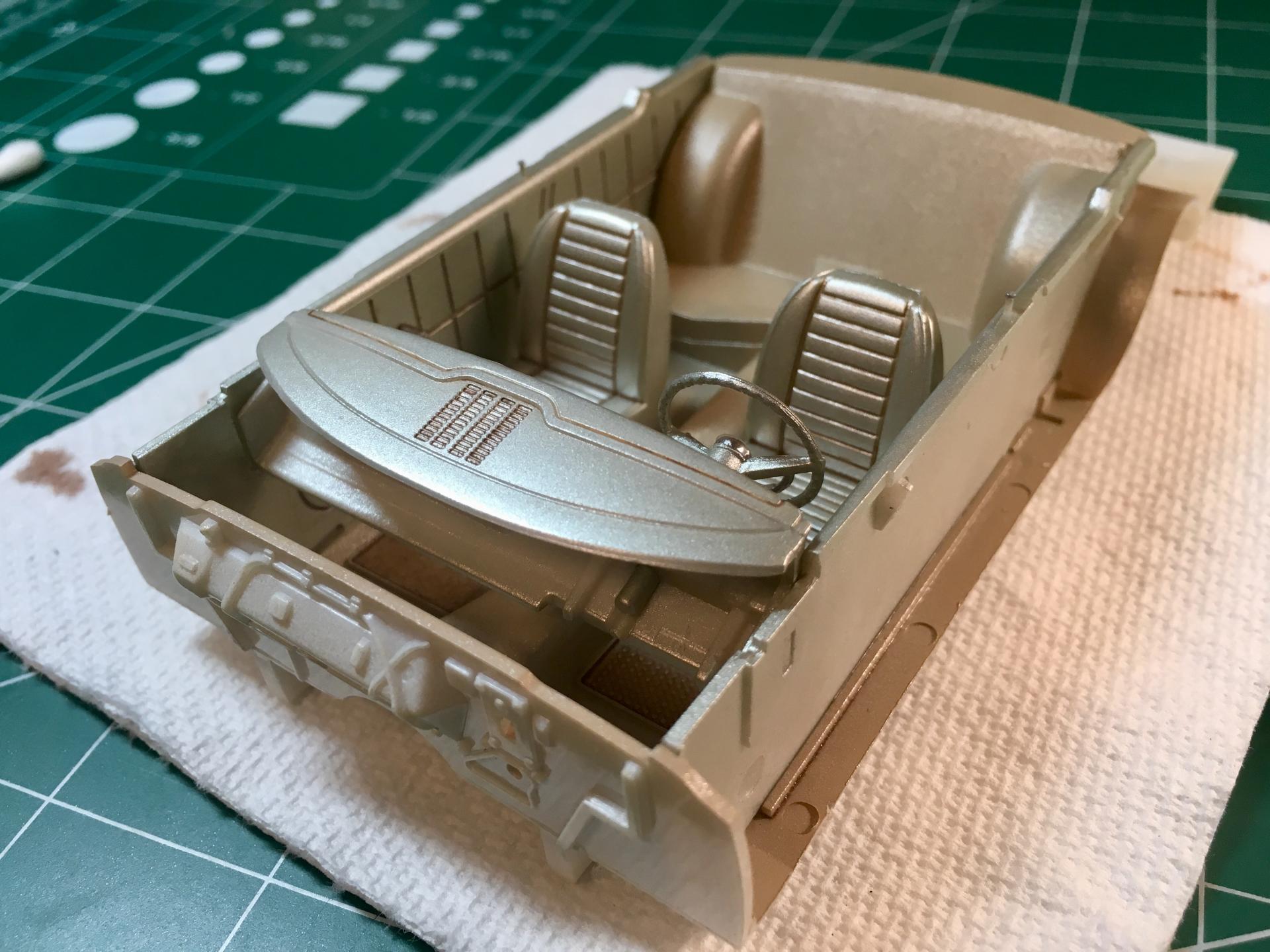

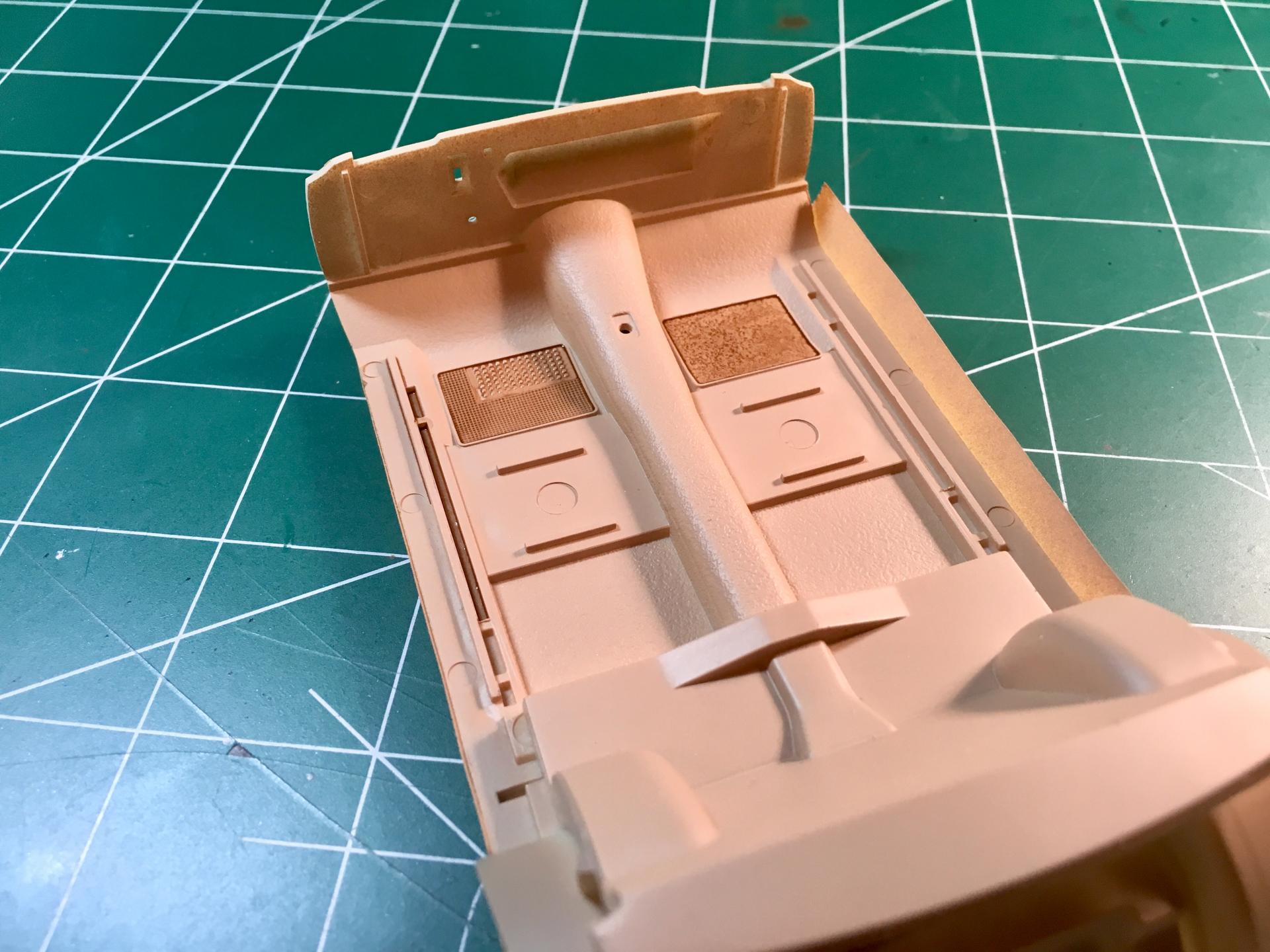

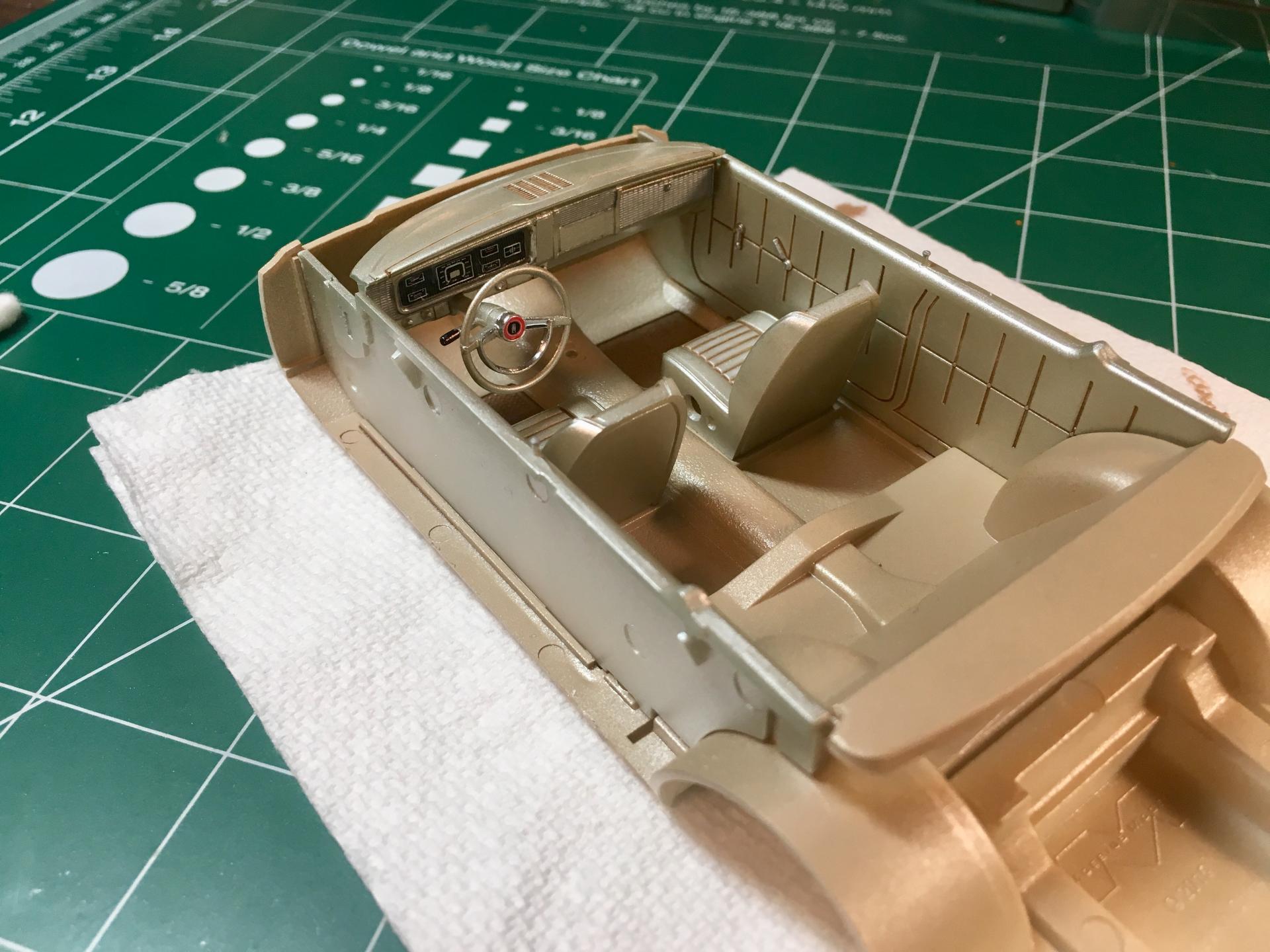

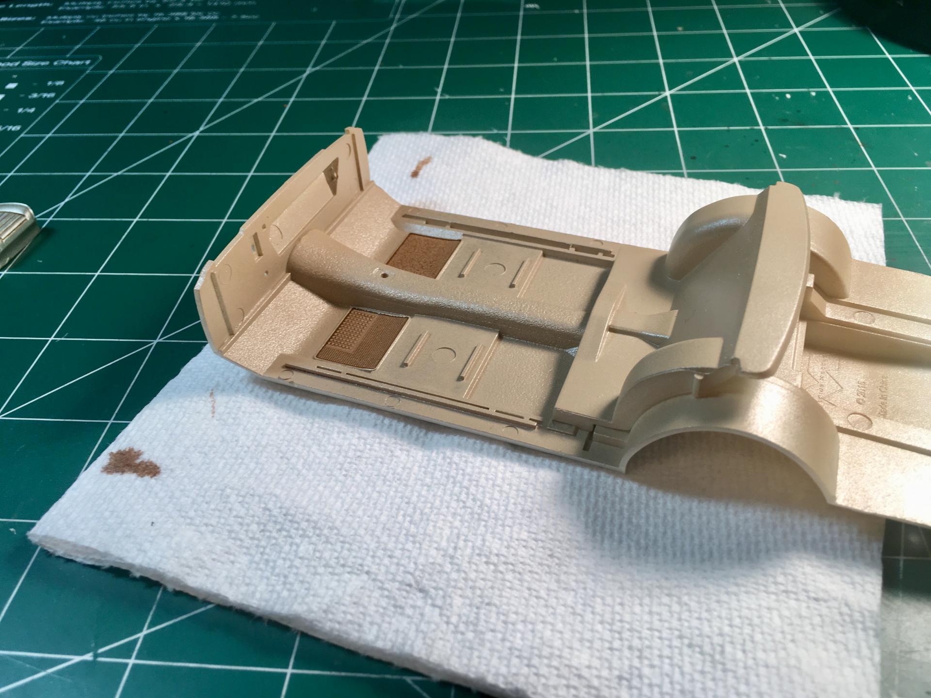

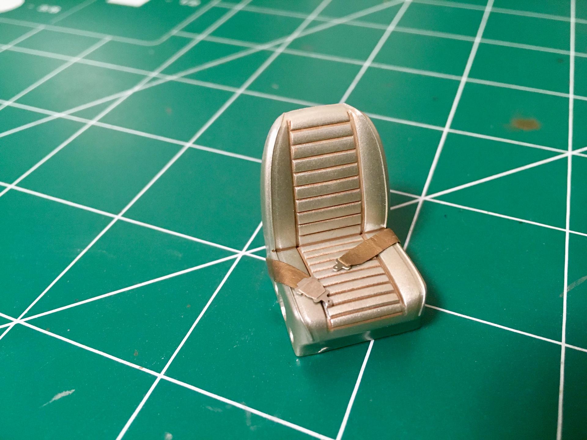

Brutalform Posted January 16, 2019 Author Share Posted January 16, 2019 Mocked up the interior just to see how the colors look. I plan on adding a lap seatbelt, and adding some dull cote to the floor so it’s not too shiny. Quote Link to comment Share on other sites More sharing options...

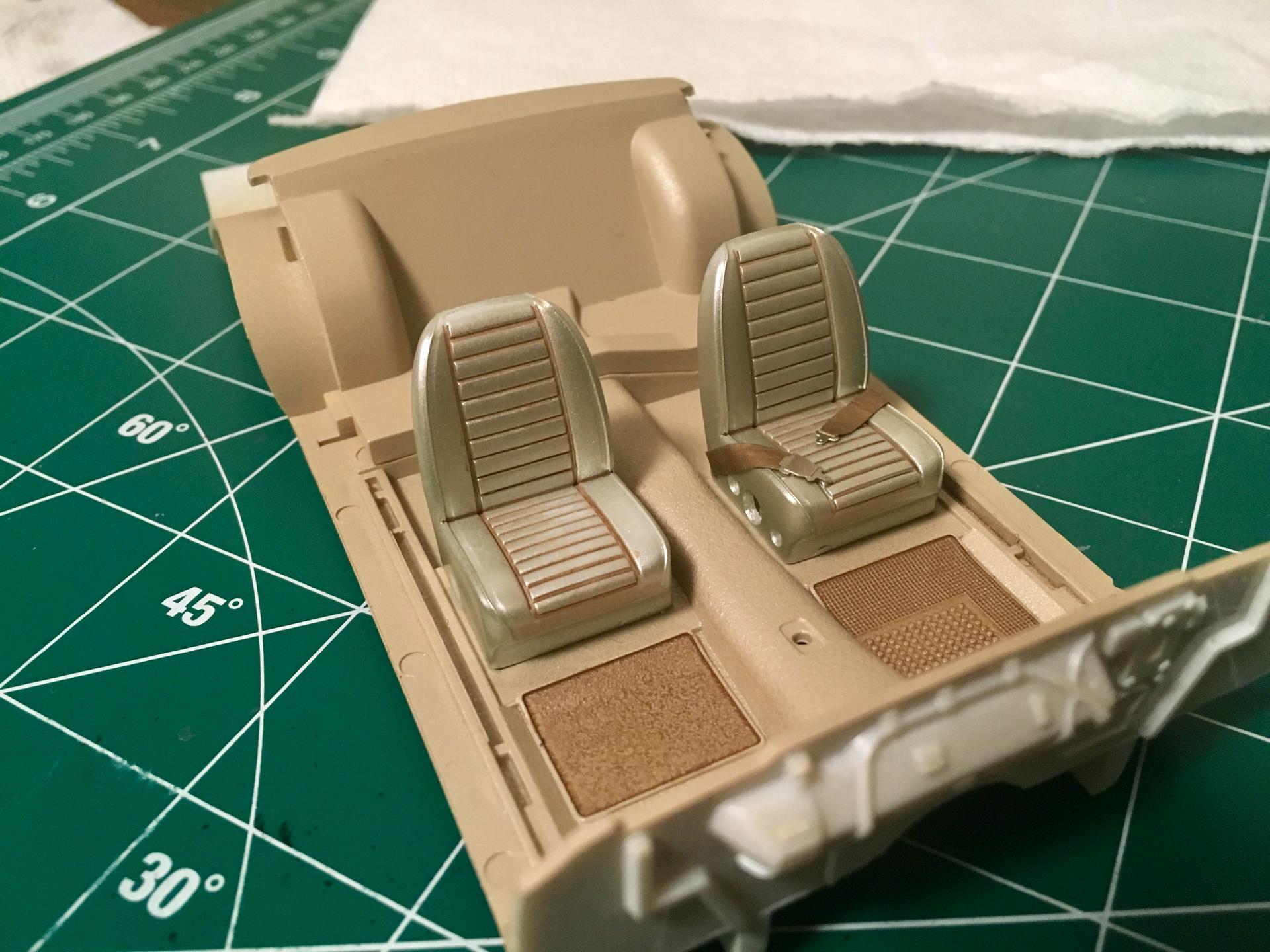

Brutalform Posted January 16, 2019 Author Share Posted January 16, 2019 Added a belt and the dull cote definitely looks better on the floor. Quote Link to comment Share on other sites More sharing options...

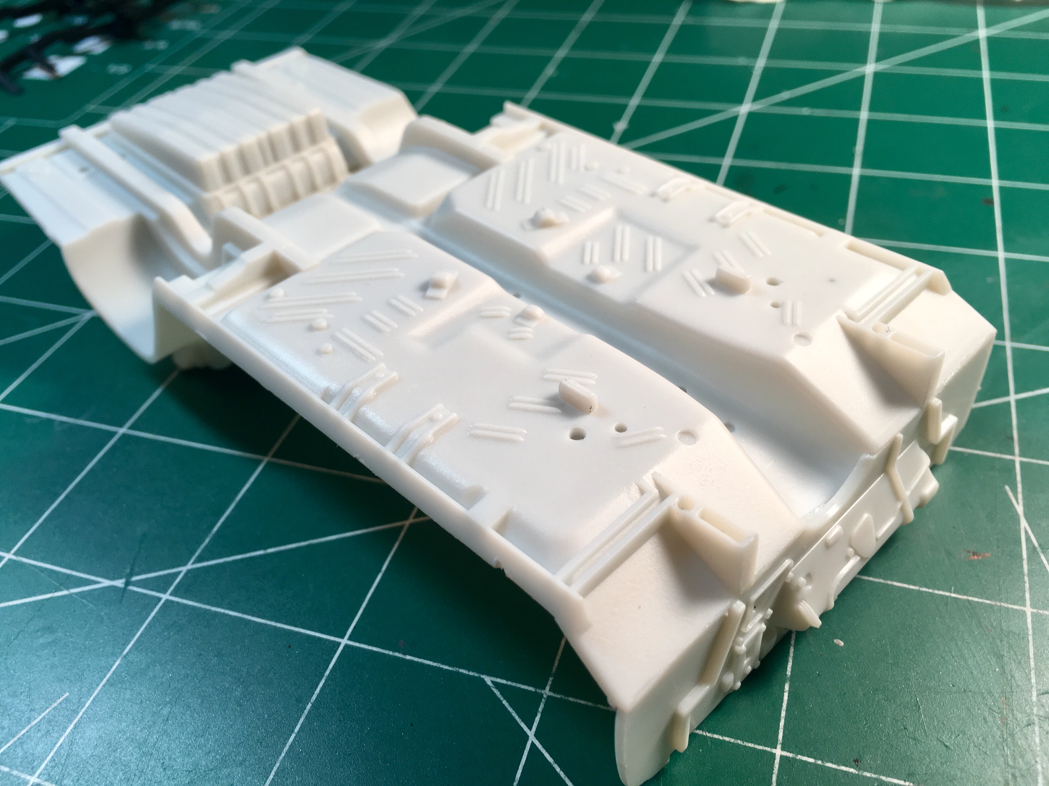

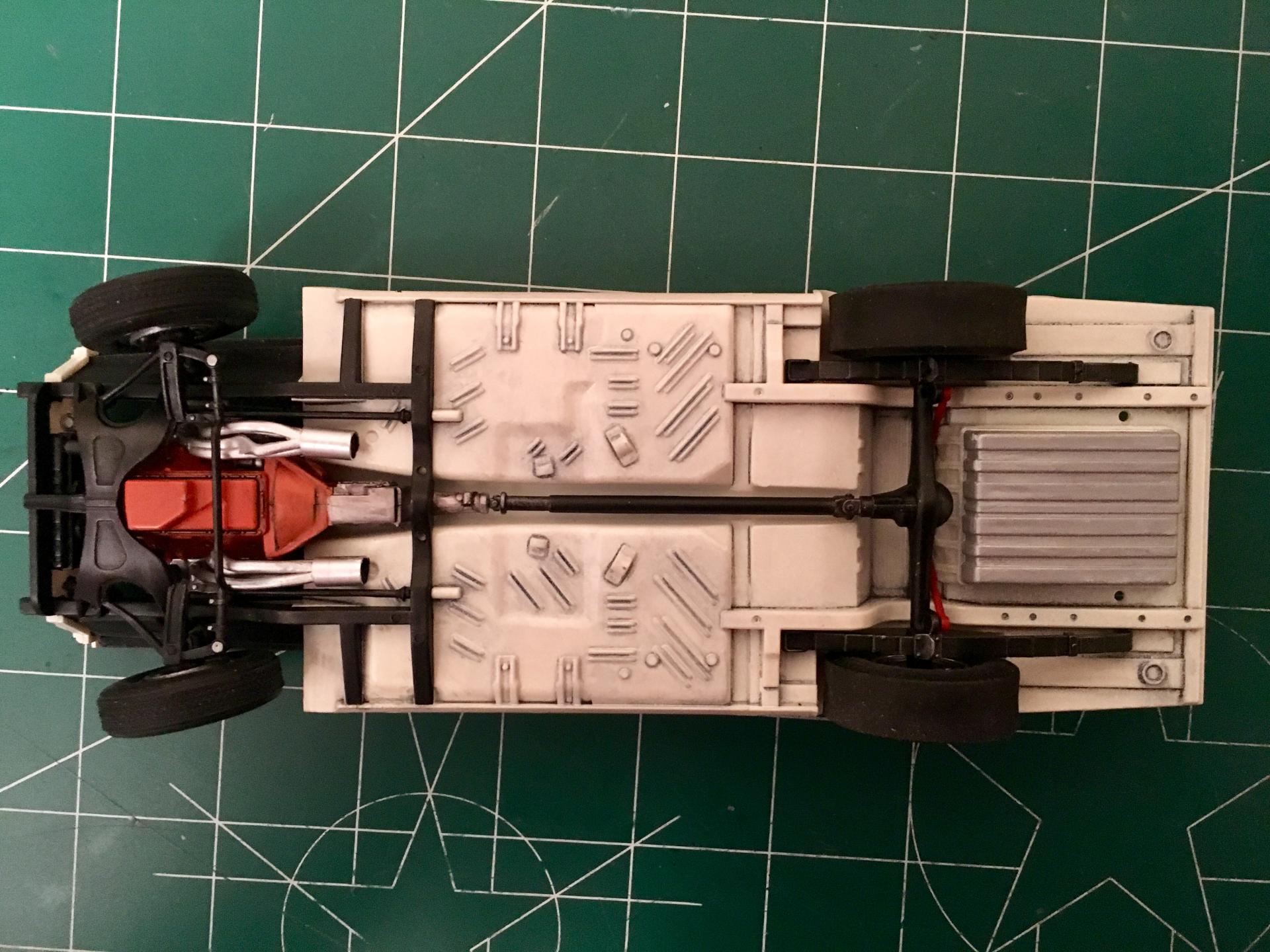

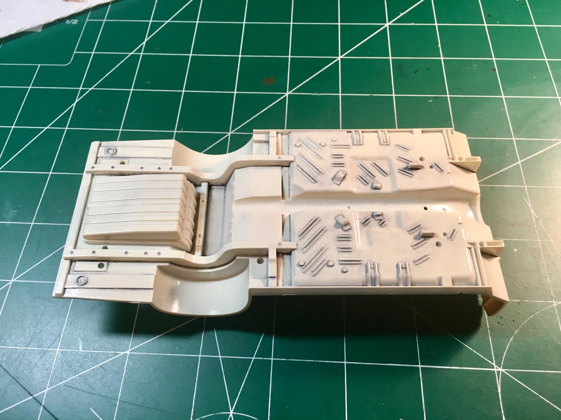

Brutalform Posted January 16, 2019 Author Share Posted January 16, 2019 (edited) I tried to add some grime to the underside of the floor pan. I still want to dry brush some highlights onto the rear and driveshaft, and the K member assembly, and paint the fuel tank. Edited January 16, 2019 by Brutalform Quote Link to comment Share on other sites More sharing options...
fivesuns Posted January 17, 2019 Share Posted January 17, 2019 Interior is gorgeous! Were those mats purchased? Quote Link to comment Share on other sites More sharing options...
Brutalform Posted January 17, 2019 Author Share Posted January 17, 2019 22 minutes ago, fivesuns said: Interior is gorgeous! Were those mats purchased? Thanks... No, they are the mats cast into the floor. I just added Tamiya panel line accent (brown) to darken them. Quote Link to comment Share on other sites More sharing options...
moparfarmer Posted January 17, 2019 Share Posted January 17, 2019 6 hours ago, Brutalform said: Mocked up the interior just to see how the colors look. I plan on adding a lap seatbelt, and adding some dull cote to the floor so it’s not too shiny. How did you float the darker color onto the lighter color on the interior...Sure looks good.. Quote Link to comment Share on other sites More sharing options...

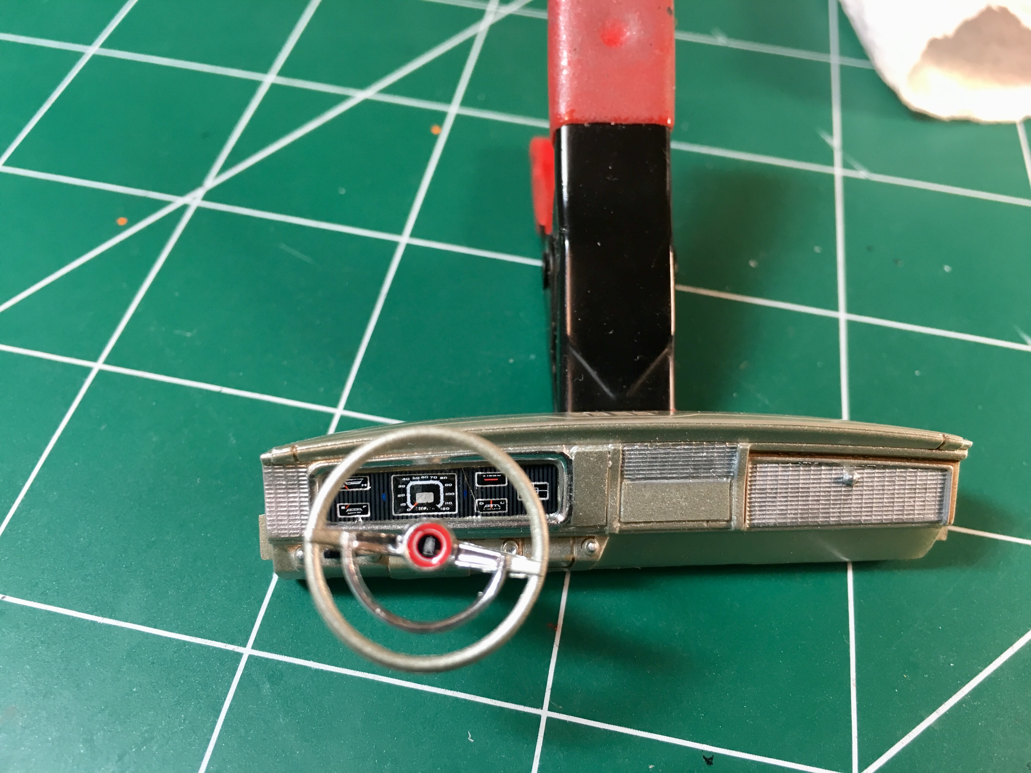

Brutalform Posted January 17, 2019 Author Share Posted January 17, 2019 (edited) 16 minutes ago, moparfarmer said: How did you float the darker color onto the lighter color on the interior...Sure looks good.. Thanks. First I sprayed Tamiya Wooden Deck Tan (pic) on the bare plastic. Then coated it very lightly with Tamiya Champagne Gold (pic). Not heavy, but just enough so it doesn’t look totally tan. Then sprayed with Dull Cote. The seats, dash and door panels are Champagne Gold on the plastic. All the lines and floor mats are detailed with Tamiya panel line accent. Edited January 17, 2019 by Brutalform 1 Quote Link to comment Share on other sites More sharing options...

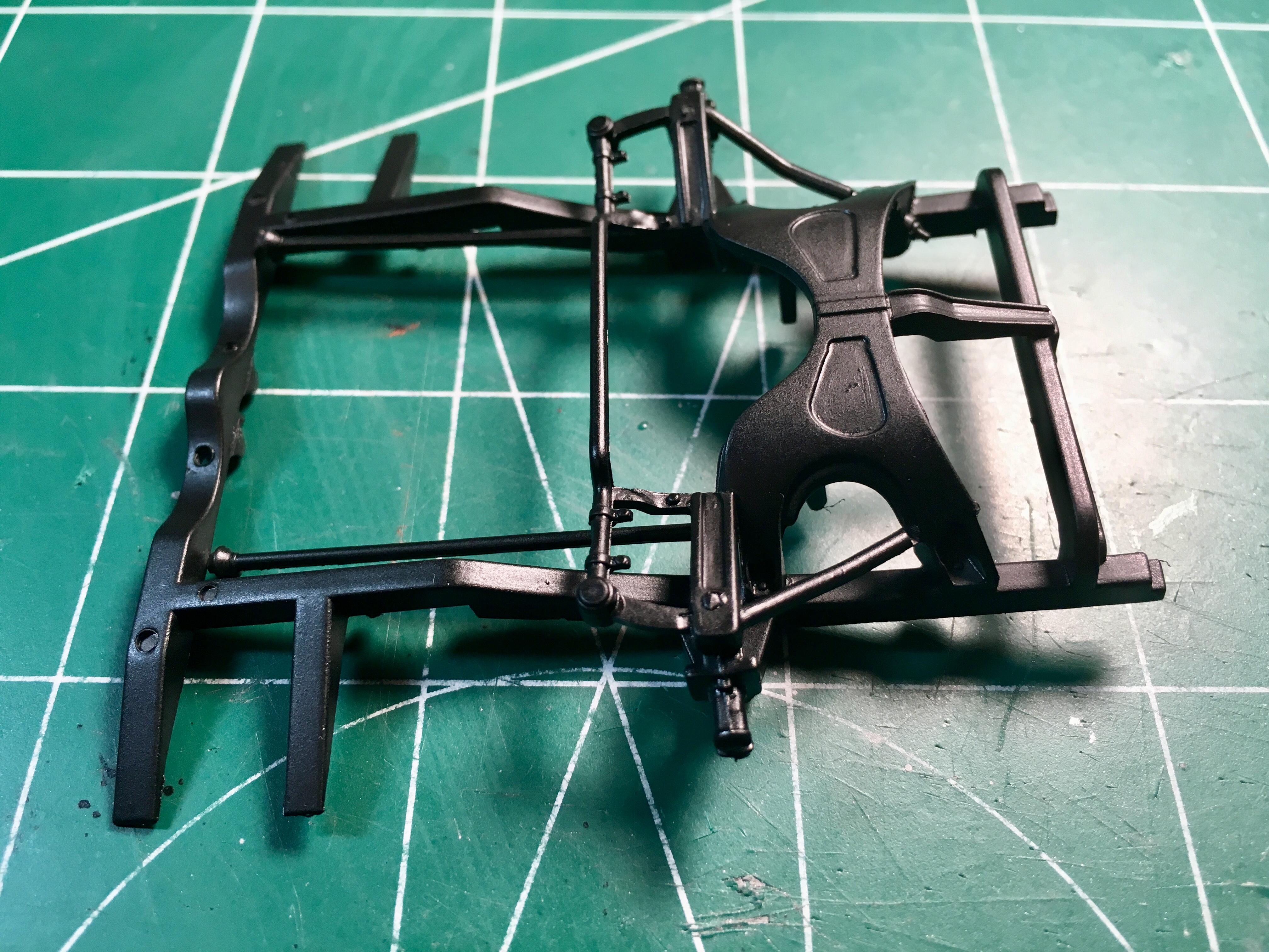

dodgefever Posted January 17, 2019 Share Posted January 17, 2019 On 15/01/2019 at 8:01 PM, Brutalform said: Time to start the 65 Plymouth drag car. I’m not interested in building the Leal car, but just a “plain Jane” factory racer. The exterior will be Racing White, and Champagne Gold for the interior. Started to work on the car last night. This is where I’m at now. Nice clean work, but before you get too far - that piece is not a separate subframe on the 1:1, it's part of the body structure. Only the K member and the trans mount would be painted black. Most of the suspension and steering parts were unfinished steel, except the lower control arms which had a coating of Cosmoline, giving them a gold tinge. Quote Link to comment Share on other sites More sharing options...

Brutalform Posted January 17, 2019 Author Share Posted January 17, 2019 (edited) 6 hours ago, dodgefever said: Nice clean work, but before you get too far - that piece is not a separate subframe on the 1:1, it's part of the body structure. Only the K member and the trans mount would be painted black. Most of the suspension and steering parts were unfinished steel, except the lower control arms which had a coating of Cosmoline, giving them a gold tinge. Thanks Stu. Yea, I realize that. After browsing through the instructions, it seemed easier to assemble these parts, and paint it as a unit. Then realizing later, it was body color. I’m going to leave it this way since I have the engine mounted also. Even if I tried to separate it, I’d most likely beak it. There was a bent mount that I had to straighten and use some extra glue on, and clamps. I’ll keep that in mind with the Melrose Missile, or Golden Commando, sitting in the stash. I just might even buy another one of these kits too, since I’d like to do the Leal version. Beautiful kit Moebius gave us. Edited January 17, 2019 by Brutalform Quote Link to comment Share on other sites More sharing options...

Brutalform Posted January 18, 2019 Author Share Posted January 18, 2019 (edited) Worked on the Plymouth for a few hours today. Now it’s a rolling chassis. One recommendation to anyone that hasn’t built this kit yet, put the backing plates onto the rear axle and front spindles BEFORE they are installed. Especially the spindles. Don’t follow the instructions on this part. I thought for sure I would snap one but I was lucky. I had to hone out the little sleeves with a round file. I’m just happy they didn’t snap Tommorow the interior, and a trip to the LHS for some paint, to get the body finished. The next one I build I will definitely paint that sub frame body color. Edited January 18, 2019 by Brutalform Quote Link to comment Share on other sites More sharing options...

W-409 Posted January 18, 2019 Share Posted January 18, 2019 This is coming together very nicely, I have several of these different '65 Plymouth kits on my stash so I'll be bookmarking this thread for future reference. Everything is looking very good so far. Especially that light weathering looks fantastic. Did you use the Panel Line Accent Color for the firewall and chassis, too? They look very good. Quote Link to comment Share on other sites More sharing options...
dodgefever Posted January 18, 2019 Share Posted January 18, 2019 Nice detailing in the engine bay. Thanks for taking the constructive criticism the way it was intended - I wasn't picking on you about the black paint, I usually mention it when I see it on a build thread. Quote Link to comment Share on other sites More sharing options...

Brutalform Posted January 18, 2019 Author Share Posted January 18, 2019 5 hours ago, W-409 said: This is coming together very nicely, I have several of these different '65 Plymouth kits on my stash so I'll be bookmarking this thread for future reference. Everything is looking very good so far. Especially that light weathering looks fantastic. Did you use the Panel Line Accent Color for the firewall and chassis, too? They look very good. Thanks Niko!! Yes it is the Tamiya accent. It’s pretty new to me. I discovered another tool to add to my builds. I bought black, brown, and gray. I should have went a tad lighter on the fender wells, but there is always next time. I’d like to buy some weathering powder soon too. I recently just started dry brushing parts. You really can learn a lot on these boards. Quote Link to comment Share on other sites More sharing options...
