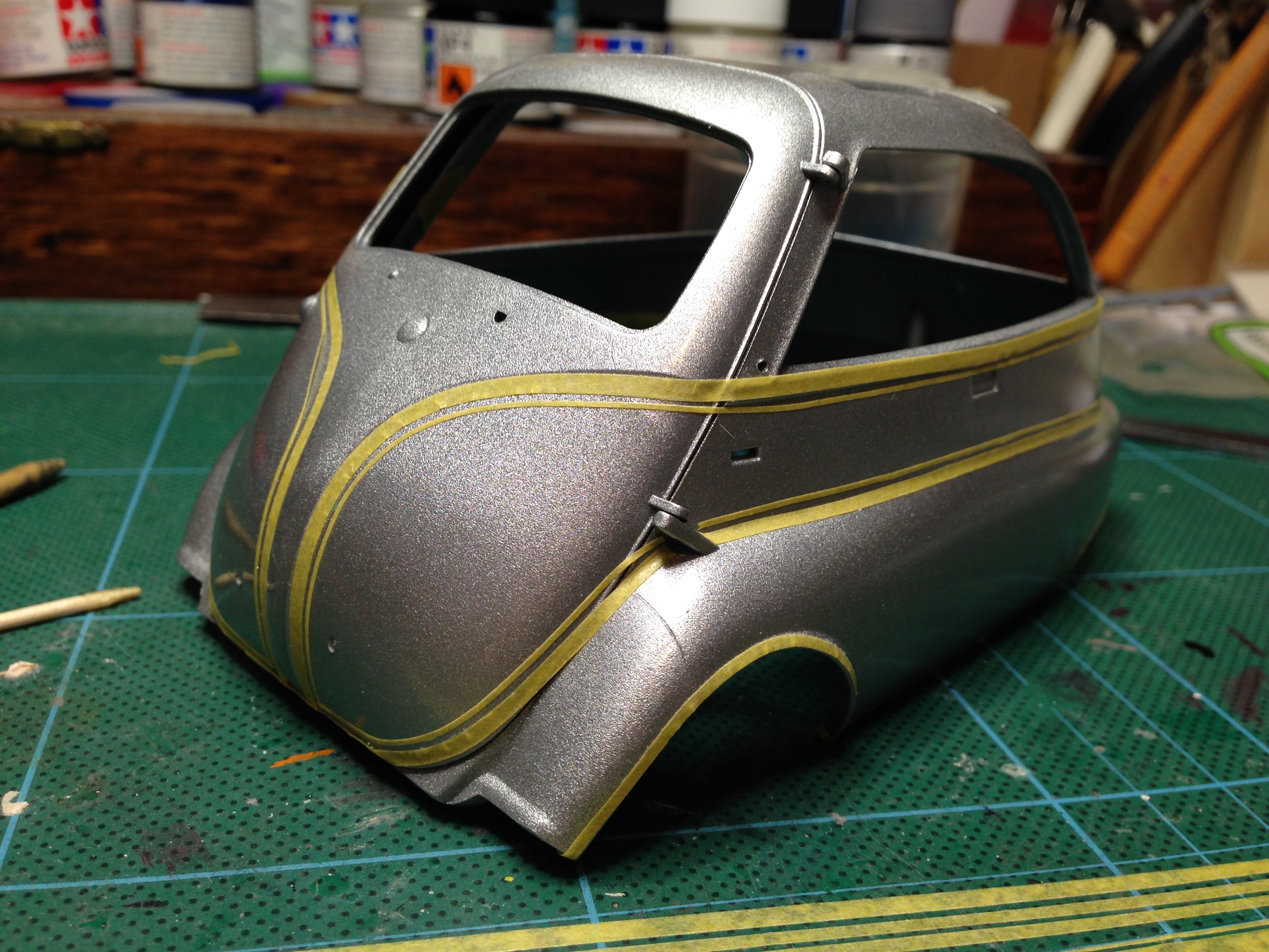

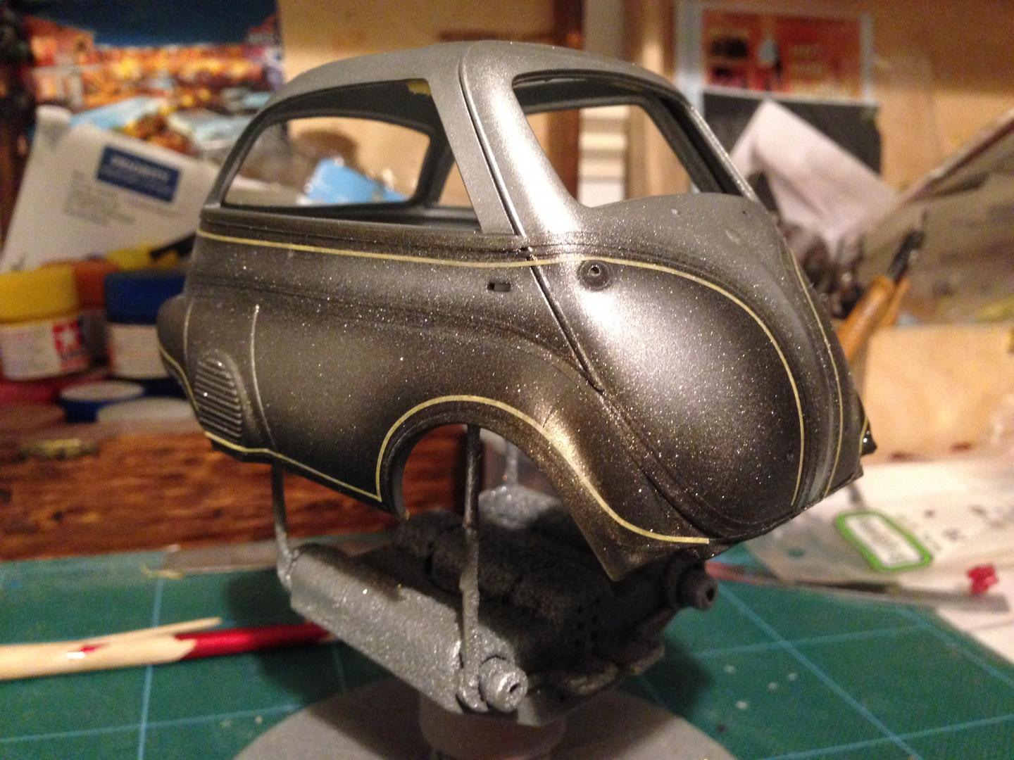

Silver base first, then some tape lines:

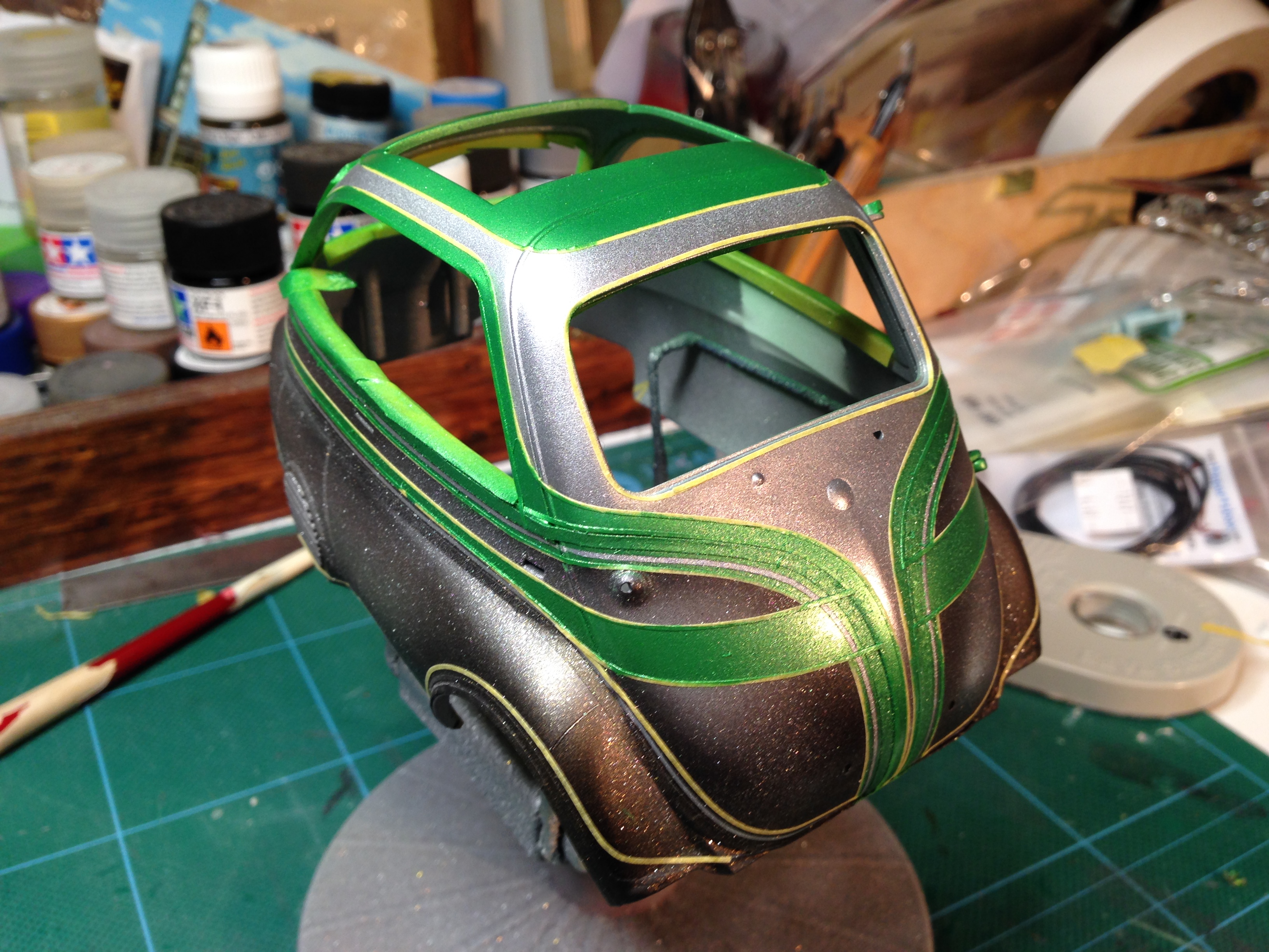

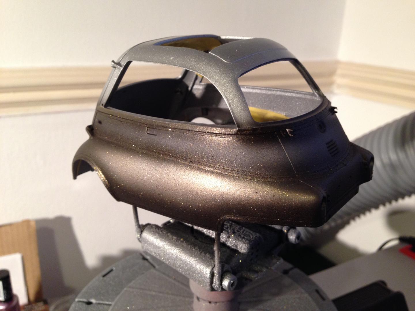

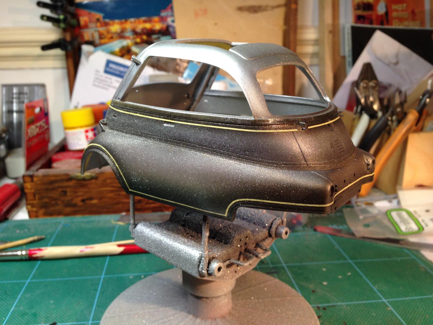

Shot some black over the tape lines, then faded-in some black/gold flake nail polish.
some parts will be finished with candy green on top. The roof will be silver flake with some candy green lines (haven't decided the exact design yet)

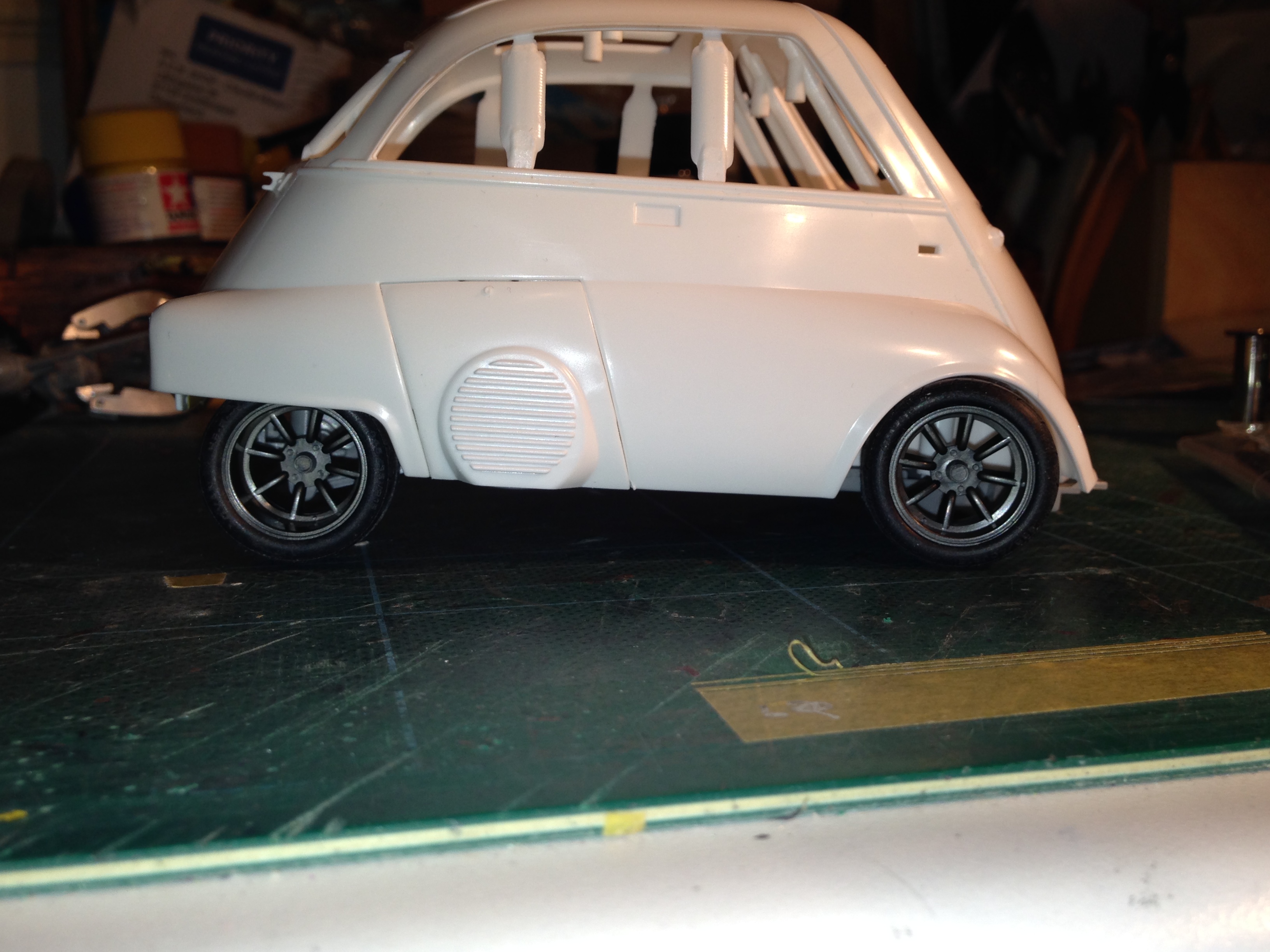

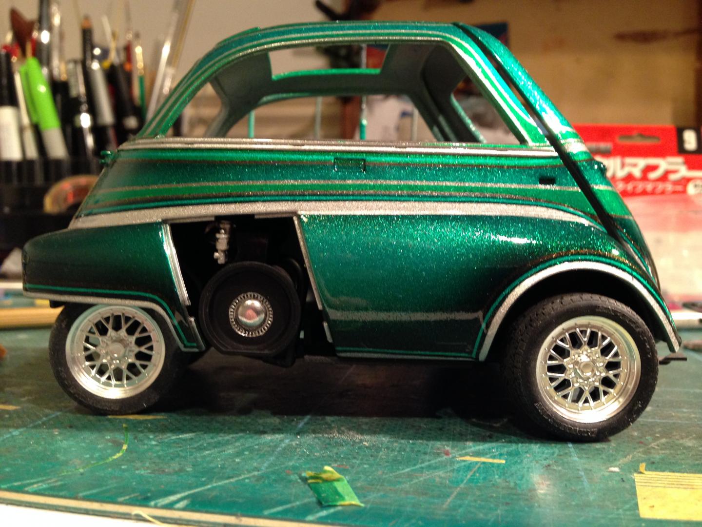

 I've got some 17" BBS wheels on order from Japan. As they're 1/24, they should lower the ride height a bit, without looking like go-kart wheels.
 I tried 14 & 15", but they looked a tad small:

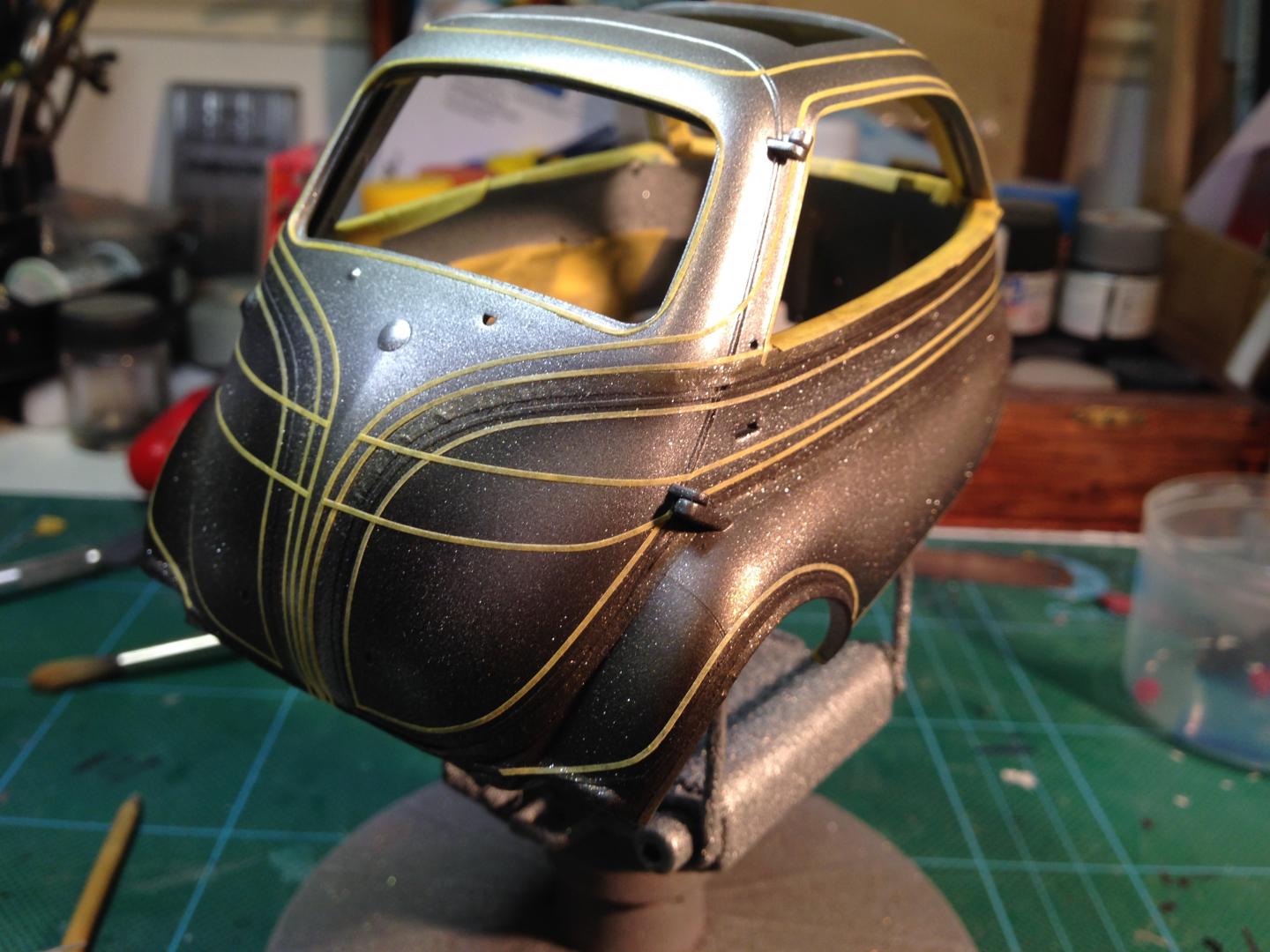

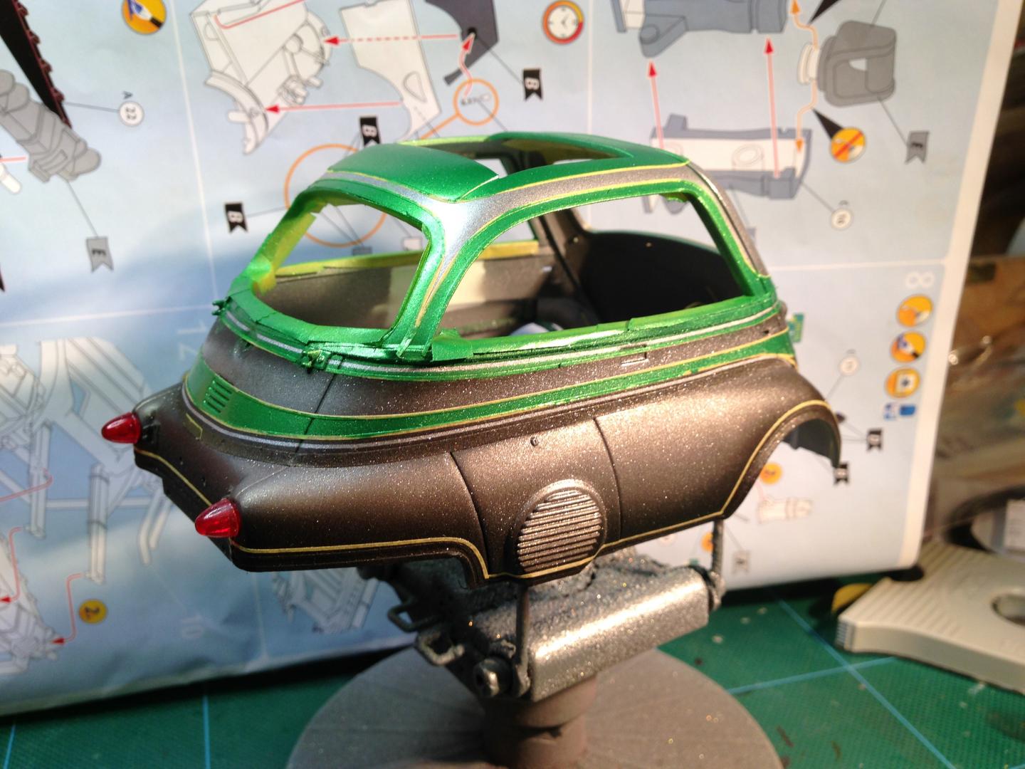

 I got a bit more masking and paint on today. I'm hoping the green, silver and the fade will go as I imagine, under the green candy. I'll do that tomorrow night after work.
oh, I also found some bullet tail lights that I'll make some chrome bezels for. They give it a more 'Jetsons' look.

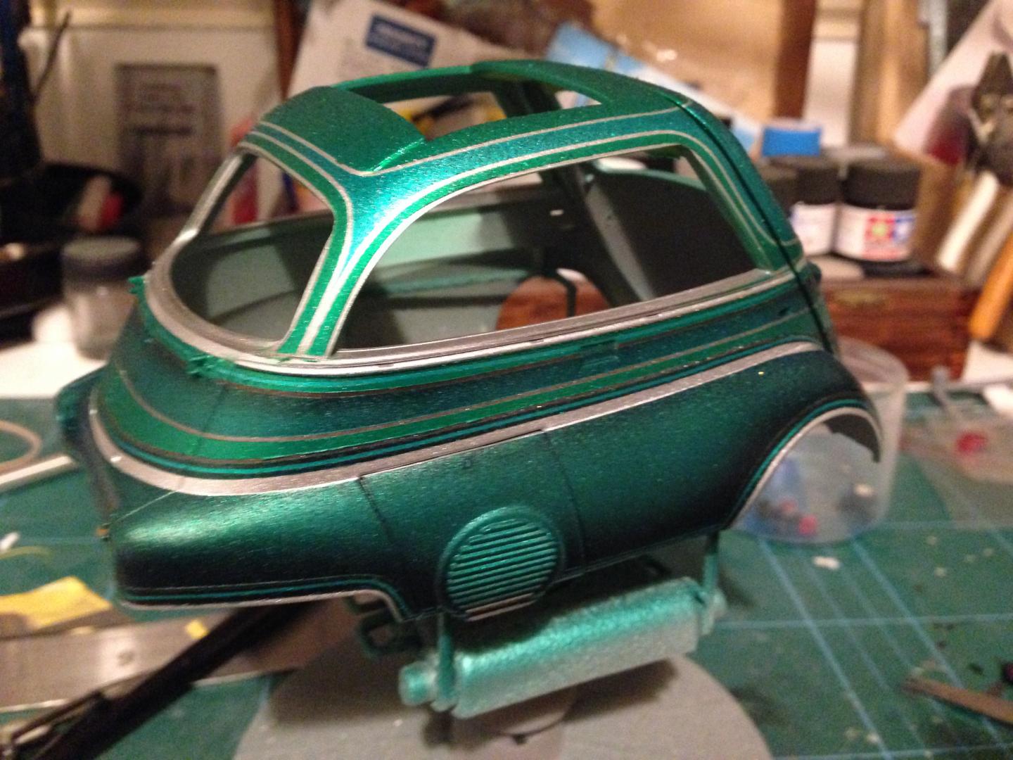

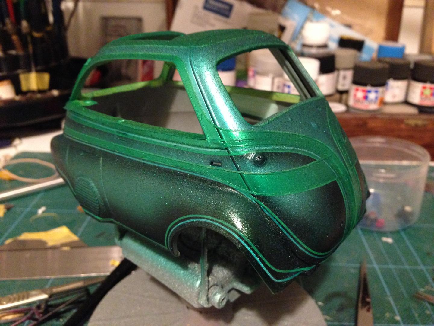

got the candy green on, this evening..
Share this post
Link to post

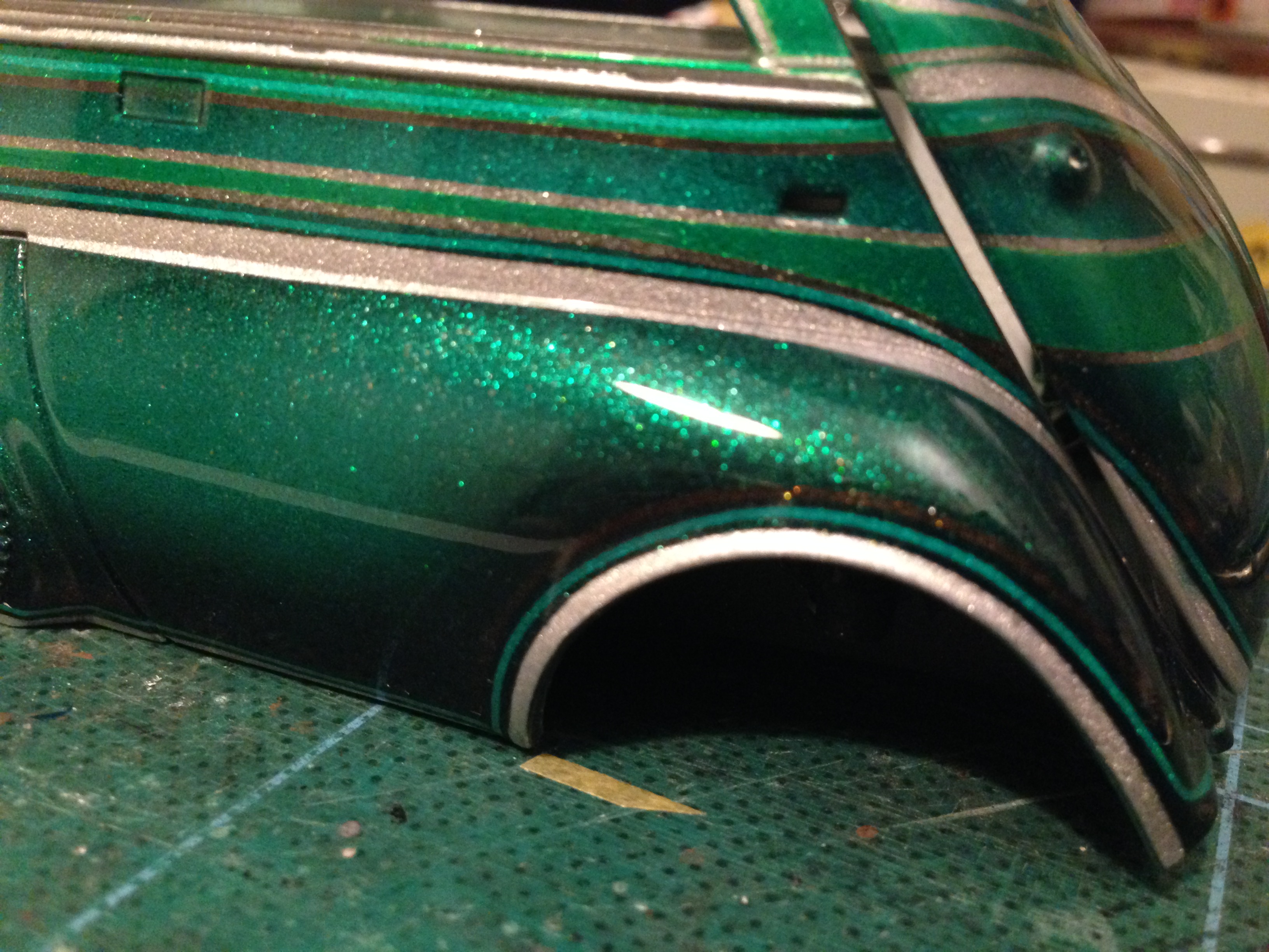

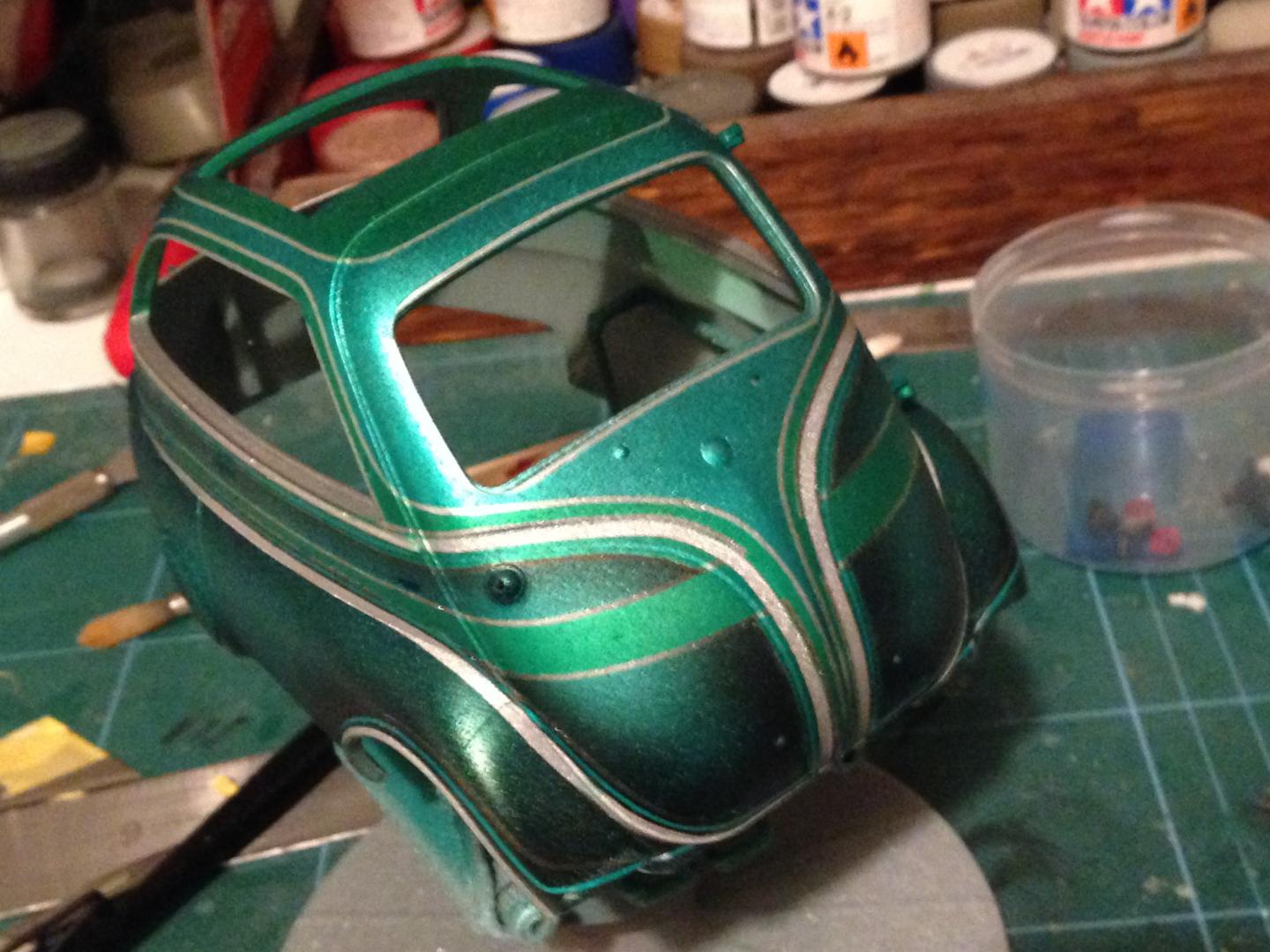

As soon as the candy green was touch dry, I removed the tape. I love this part!
it's important to remember that it's not a case of getting a glossy finish with the candy. The clearcoat will take care of the gleam 😉

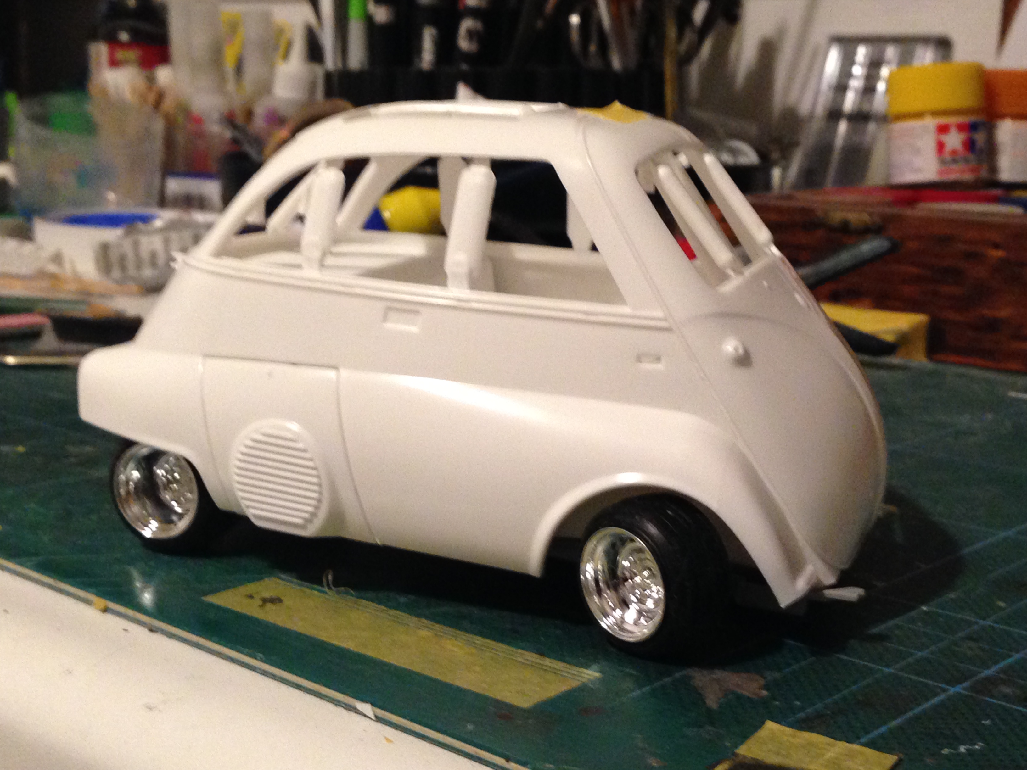

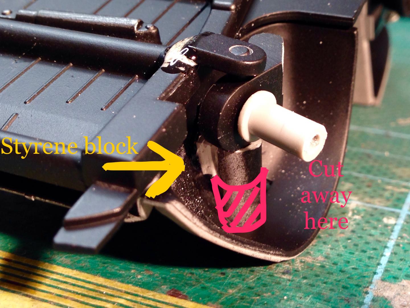

the wheels arrived from Japan yesterday. I'll need to modify the front suspension to get the ride height like the mock-up photo.
Share this post
Link to post

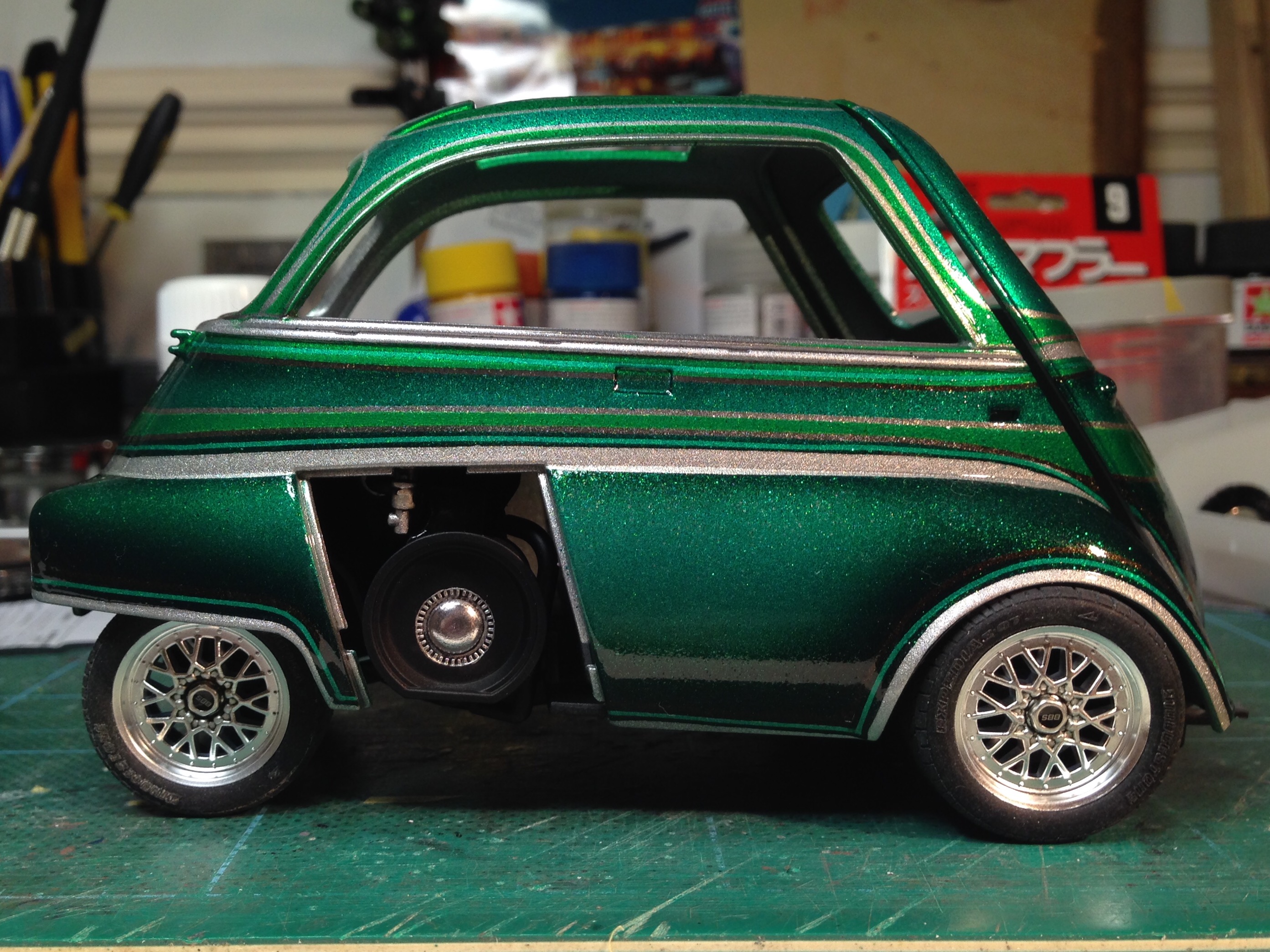

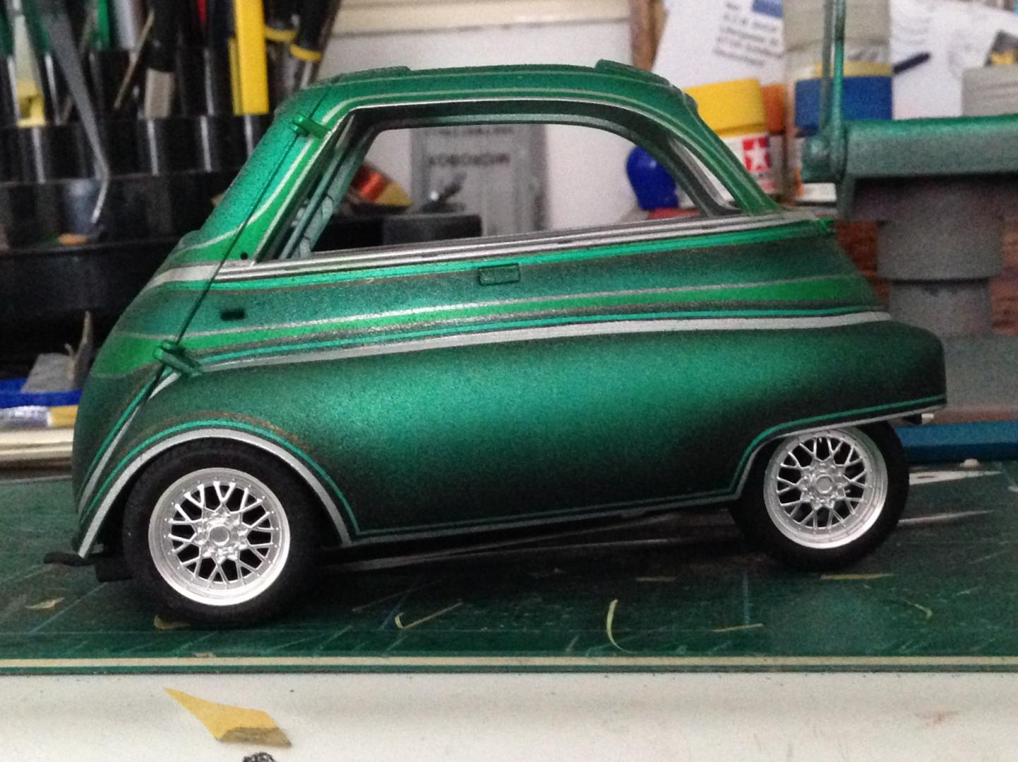

Got the clearcoat on, yesterday. Had to bury the flake a bit. It was a rough finish. I'm always pleased with how a clearcoat transforms paint. I do love a bit of sparkle 😎
I've just chopped off the lower suspension arms and taken a bit out of the upper supports. To get wheel clearance, I'll need to remove the upper section of this support. So I added styrene blocks to the insides of these and epoxied them to the arches. When I chop out the tops with a Dremel, the epoxied blocks should hold the remaining part of the support in place.
Then I'll be able to sit the nose lower and tuck the wheels in, a bit.

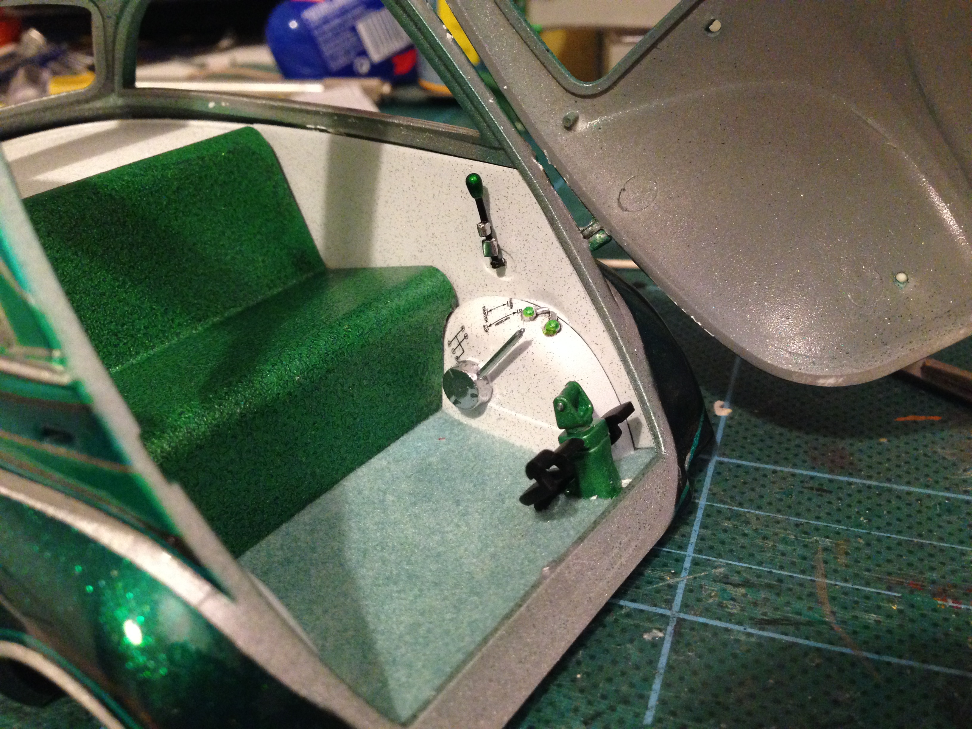

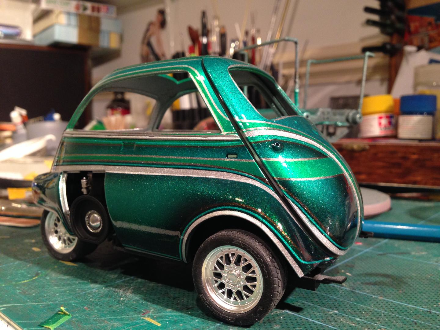

Got the carpet flocked and some of the interior gubbins fitted.
also spent all of Saturday polishing the paint down to 8000 grit, followed by Tamiya polishing compound, waxed and polished with detailer spray. Got a wet-look finish 👍
