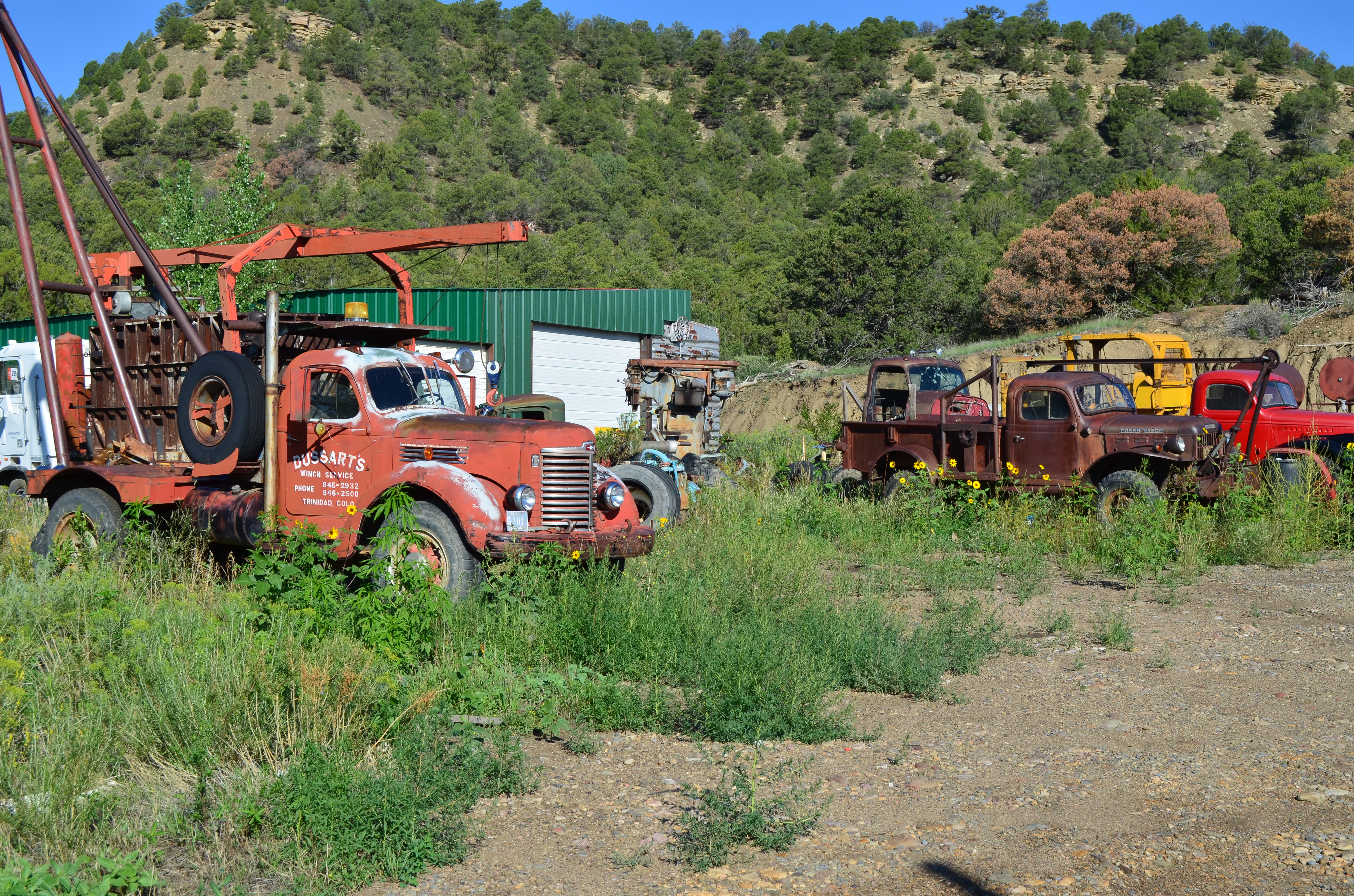

I was at first going to suggest vehicles seldom get completely paint-free rusty, but looking at this Powerwagon proves me otherwise.  As Paul suggested above, research!  I found this yard on a trip, I'm always looking for such places, annoys my passenger(s) when I come to a screeching stop and u-turn.  One thing that bugs me about creating rust, don't build up the paint, the real thing does not get really rough.  I suggest wet-sanding that, which will add a mottled look.  I also recommend adding dents, they can be small.
You made a great start on the diorama, I've seen too many that are sterile and too clean.  I would suggest looking for various sizes of small pebbles.
Most important, have fun!
