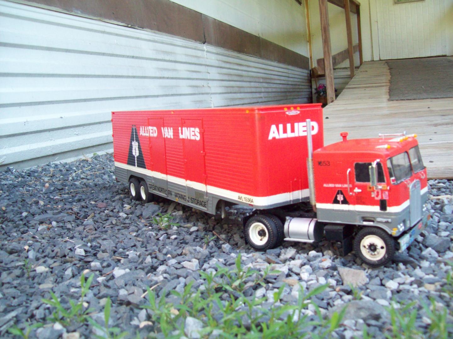

SpreadAxle Posted February 22, 2019 Author Share Posted February 22, 2019 3 hours ago, Sam I Am said: Can I ask just what you do to make them into a moving van? I have a few of these myself and only plan on building one of them into a race hauler. Thanks That's easy. It already is a Trailmobile moving van. Literally all you need is different decals. These trailers are the same kit as the Allied, Mayflower, and north American trailers released during the 1970s. Set aside everything that is meant for the interior like the tools and any racing equipment, as well as the wheel covers that come with these trailers. Add some moving company decals and you have your moving van. My Allied van shown here is an ebay rebuild. It was the Bill Elliott/Coors transporter.The KW and Allied van have been stripped and are being rebuilt because the paint job and decals(1970s decals with another set applied on top of them) were awful and it always bothered me. I have to get some more of these Allied decals. I have some decals from modeltruckin.com for Neptune Van Lines that will be going on this unit. Quote Link to comment Share on other sites More sharing options...

Sam I Am Posted February 22, 2019 Share Posted February 22, 2019 1 hour ago, SpreadAxle said: That's easy. It already is a Trailmobile moving van. Literally all you need is different decals. These trailers are the same kit as the Allied, Mayflower, and north American trailers released during the 1970s. Set aside everything that is meant for the interior like the tools and any racing equipment, as well as the wheel covers that come with these trailers. Add some moving company decals and you have your moving van. My Allied van shown here is an ebay rebuild. It was the Bill Elliott/Coors transporter.The KW and Allied van have been stripped and are being rebuilt because the paint job and decals(1970s decals with another set applied on top of them) were awful and it always bothered me. I have to get some more of these Allied decals. I have some decals from modeltruckin.com for Neptune Van Lines that will be going on this unit. I did not know that about the hauler. Thanks for the info. I see a couple of mine being turned into moving vans. Quote Link to comment Share on other sites More sharing options...

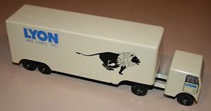

Oldmopars Posted February 22, 2019 Share Posted February 22, 2019 (edited) When I was a kid a family friend worked for Lyon Van lines, moving and storage company. He gave me a truck like the one in the picture. I wish I still had it. I would like to build one like it someday so this is good info. Anyone happen to may these decals? Edited February 22, 2019 by Oldmopars Quote Link to comment Share on other sites More sharing options...
SpreadAxle Posted February 28, 2019 Author Share Posted February 28, 2019 Check with Jerry at modeltruckin.com. What he doesn't have he will often make. Quote Link to comment Share on other sites More sharing options...
