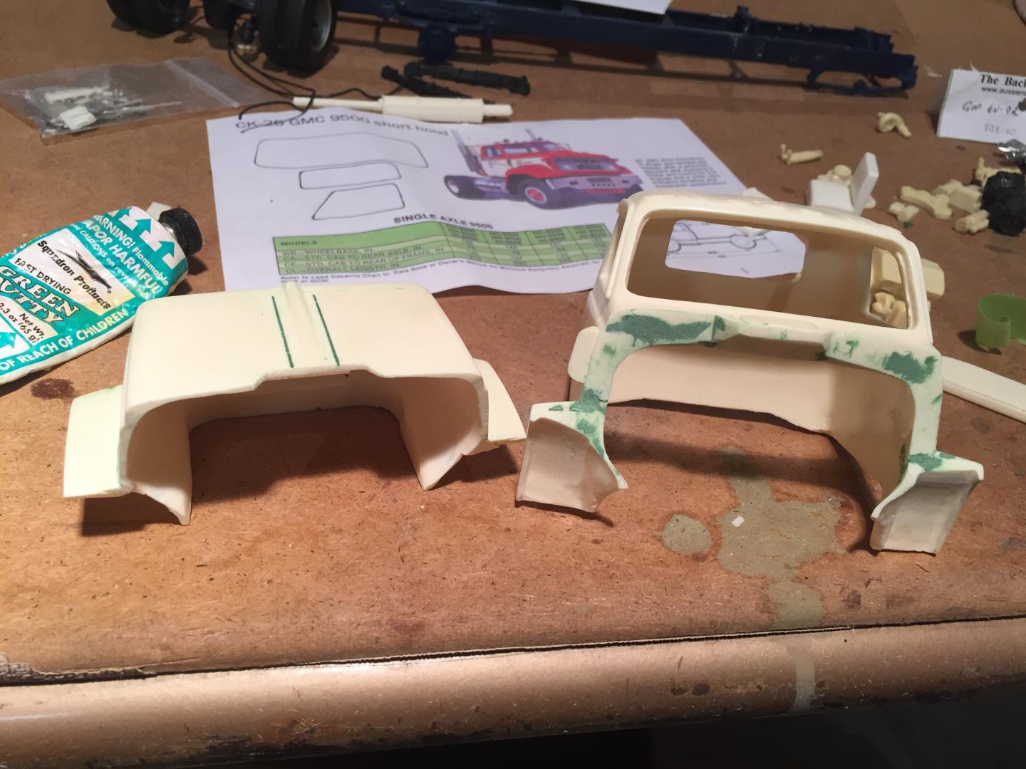

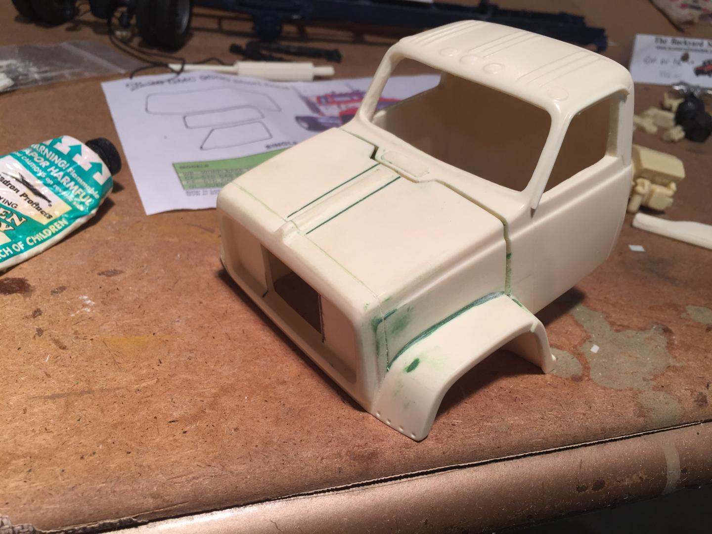

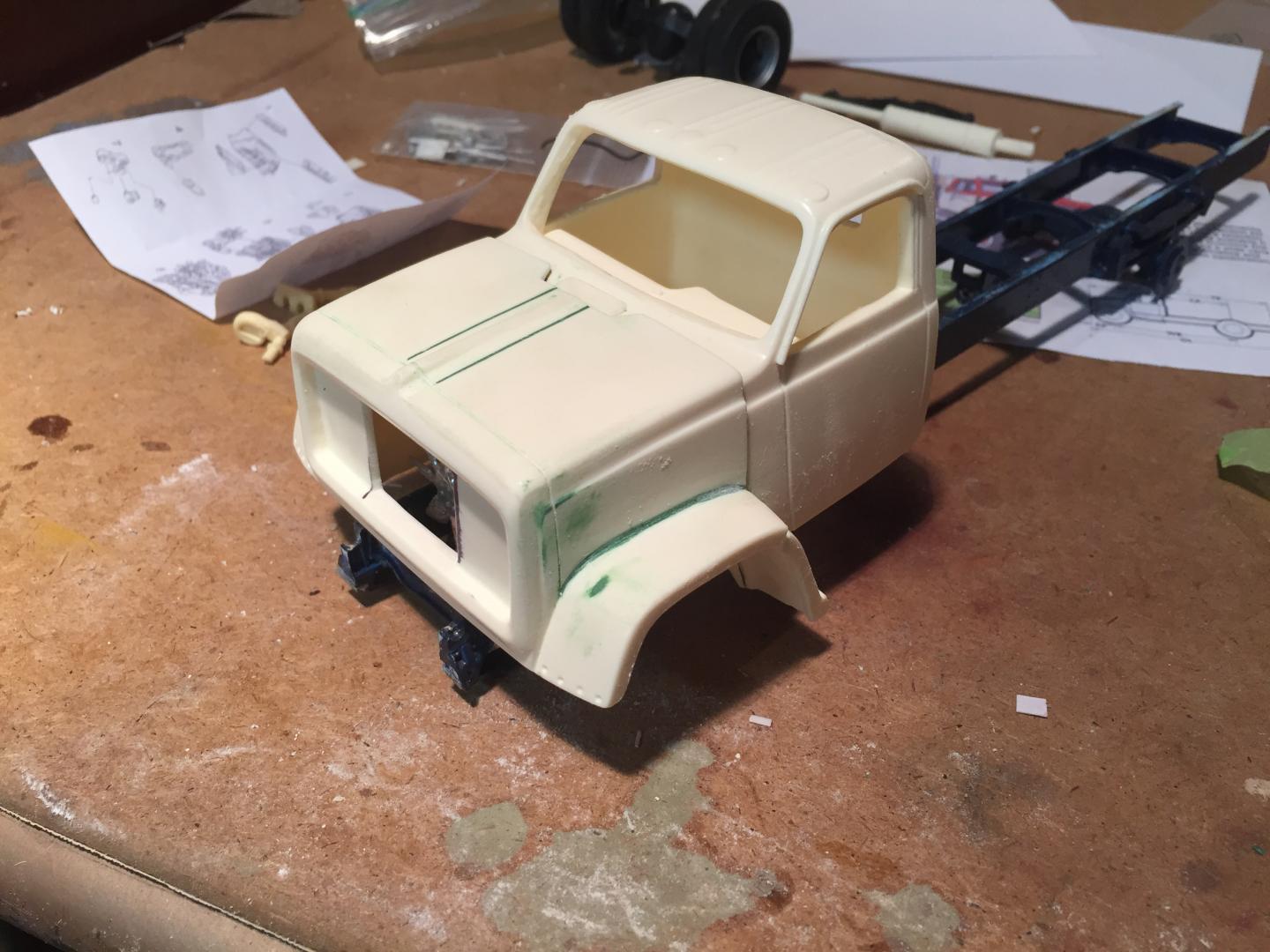

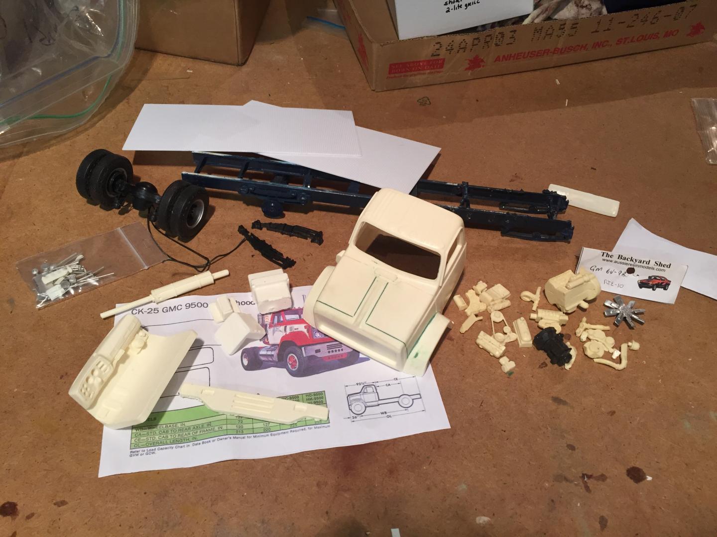

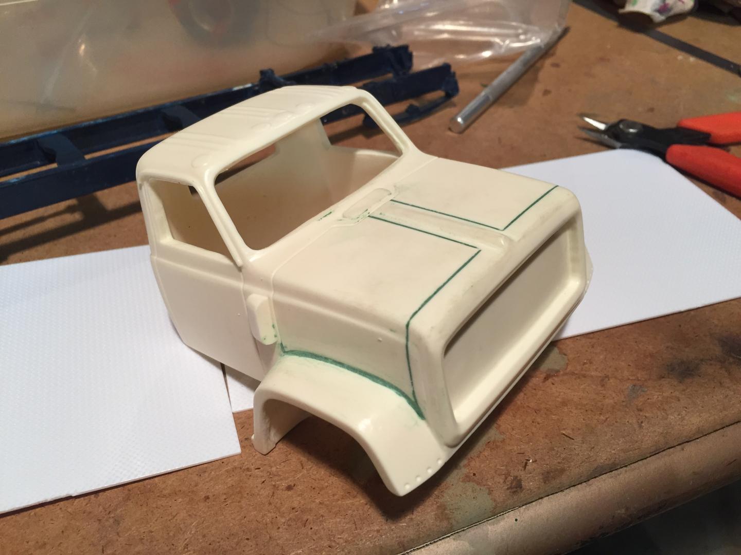

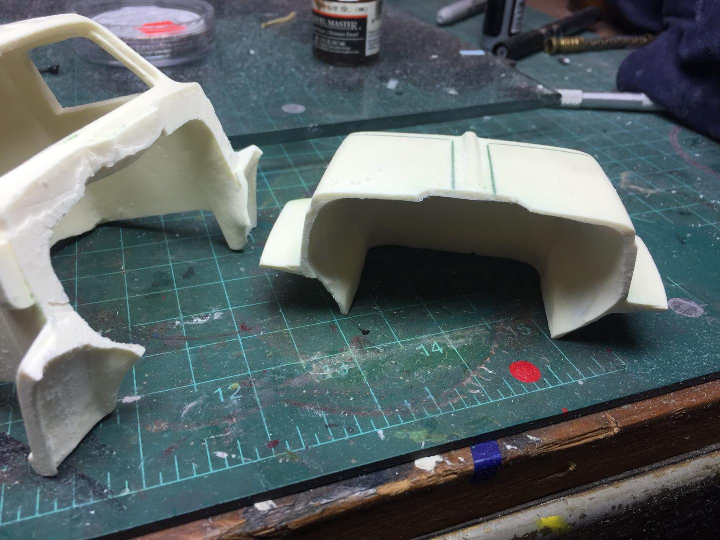

Time to start a new project.  This will be a GMC 9500 with a 22' equipment body.  I had a 1980 version of this back in the mid 90's that served me well. Unfortunately no photos of her can be found so this is a by-memory build! It starts with an AITM cab kit. It will use a set of frame rails and suspension from the parts box. It will have a Detroit 6V92 engine and a 5x2 driveline. I am changing the resin cab hood from a butterfly to a tilt and am going to cut it open to hinge it. Thought about doing this for the BRBO but at the speed I build at I wouldn't see it done in time for NEXT years buildoff!

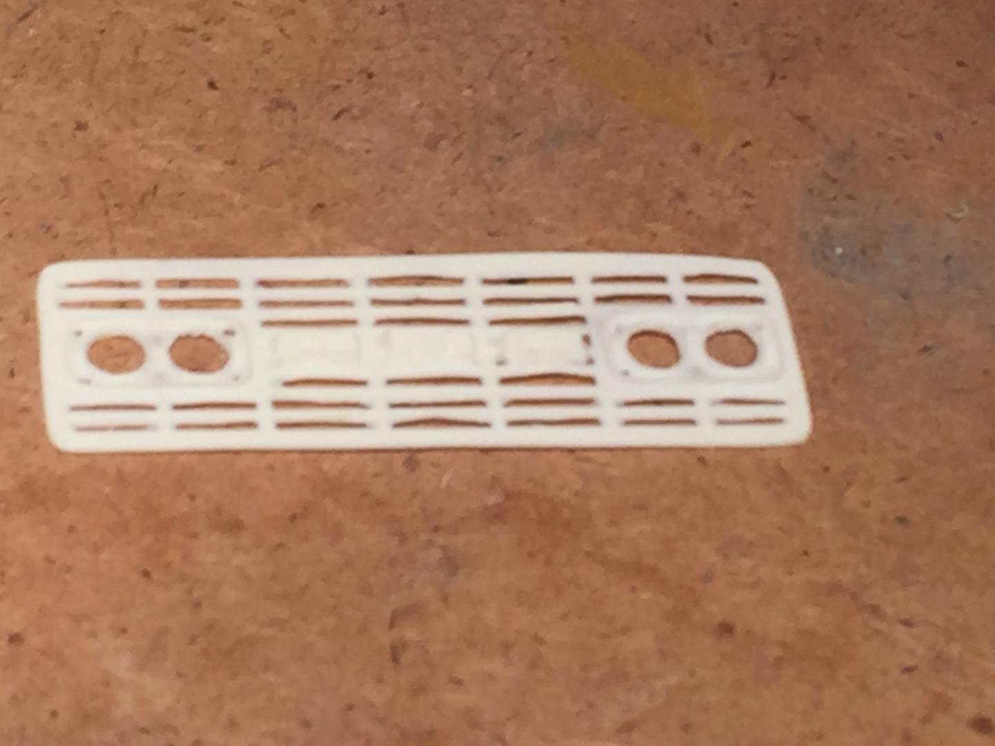

Are you using the two headlight grill like in the photo or the four?

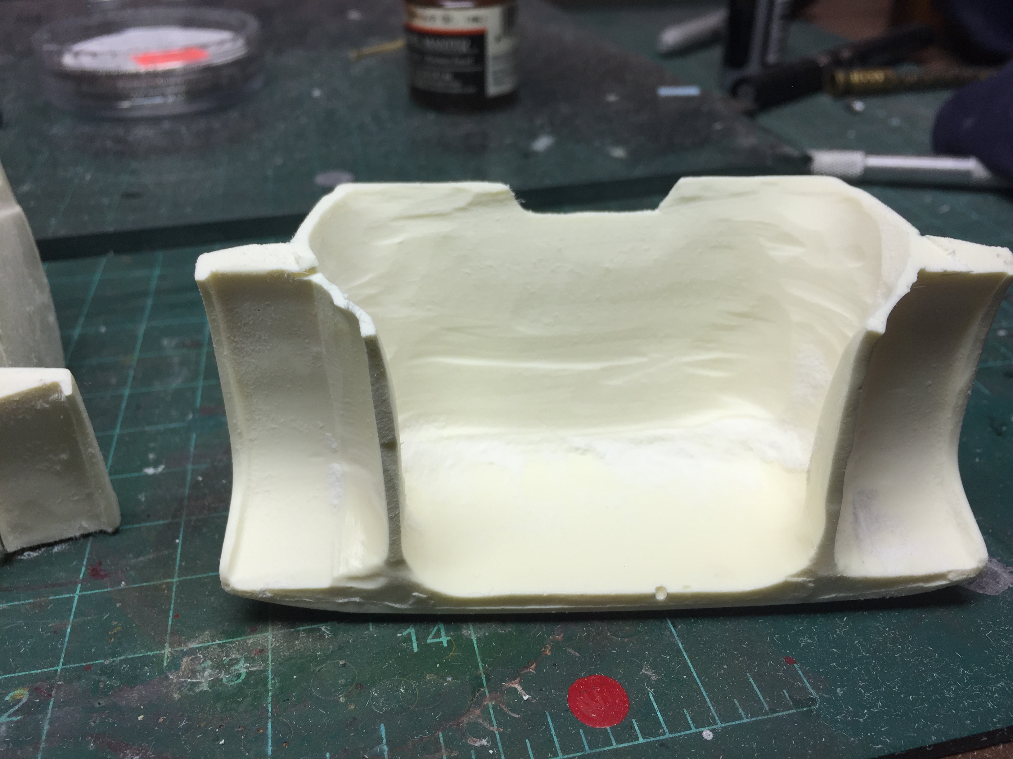

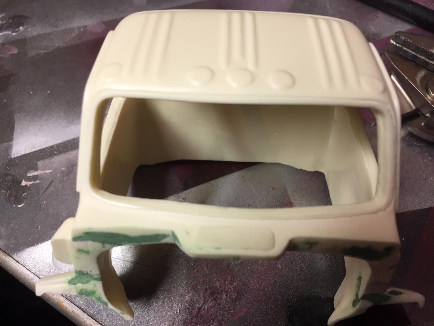

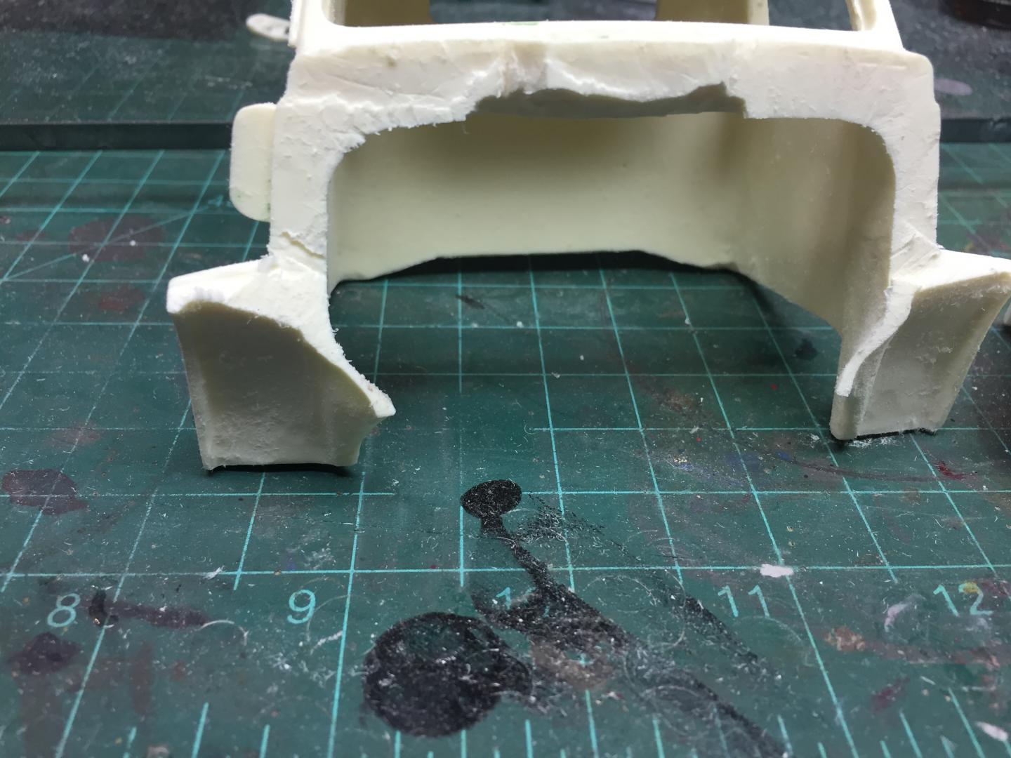

Am going to make the correct dash and use the four light grille as that is what mine was.  Got the nose cut off tonite and thinning started.  VERY thick resin on this one! The roll back body was all steel with a diamond plate surface.  Will be trying to duplicate the whole thing as best as I can.  I have to search through a bunch of old floppy disks to see if I have any photos left.  Hoping I do!

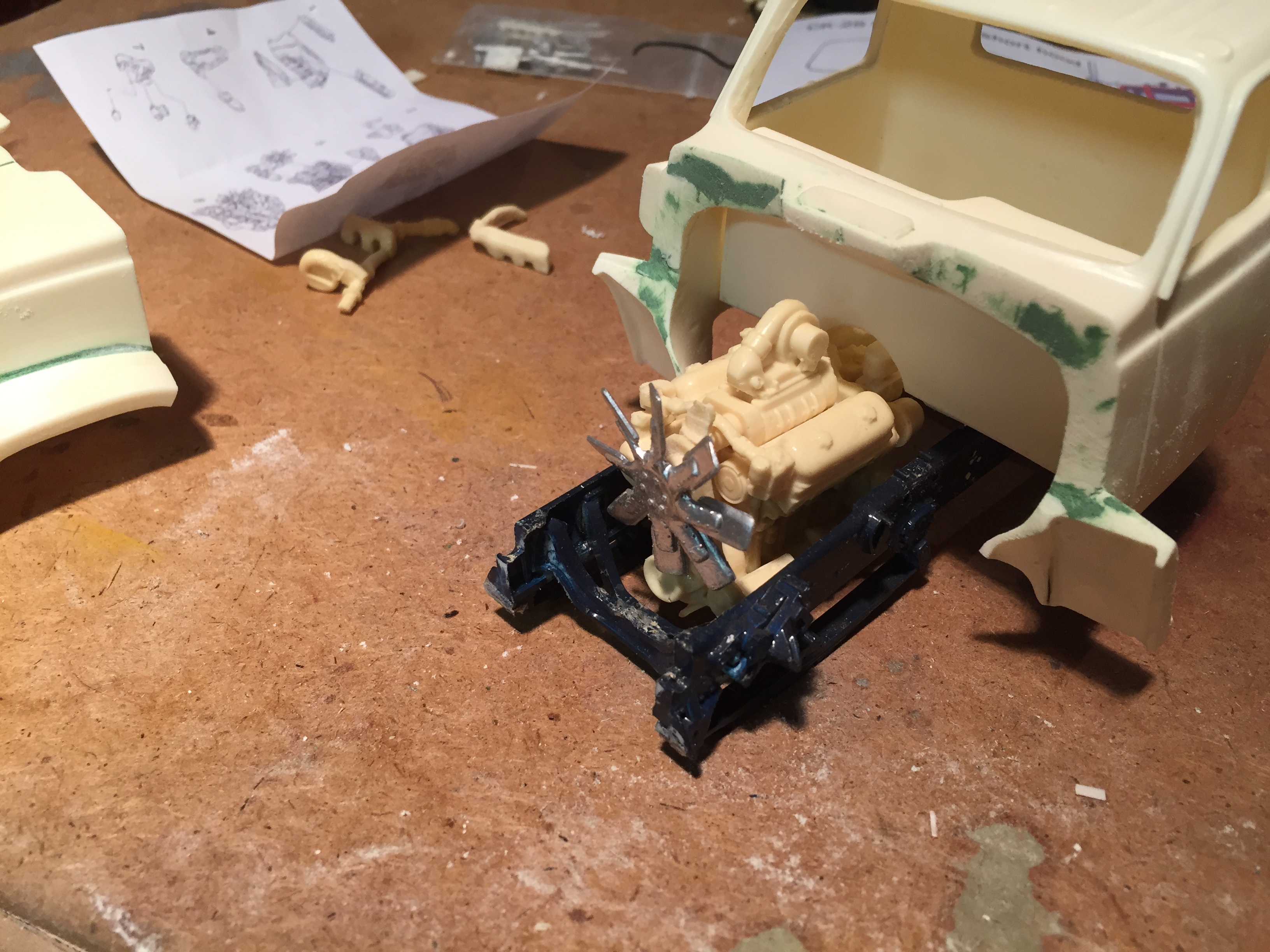

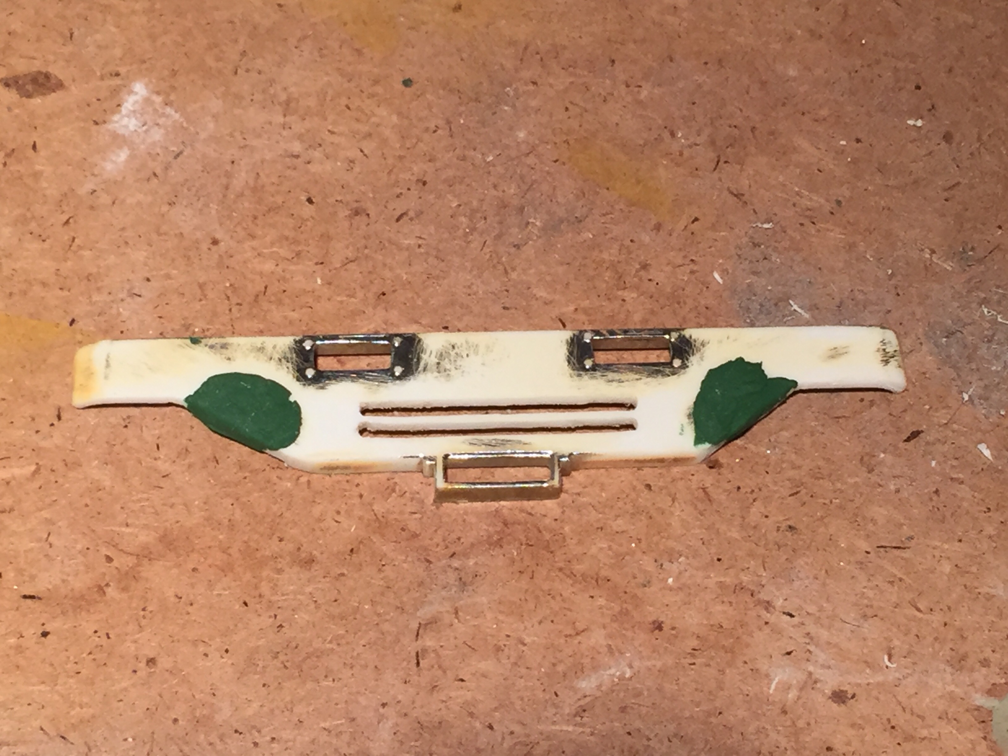

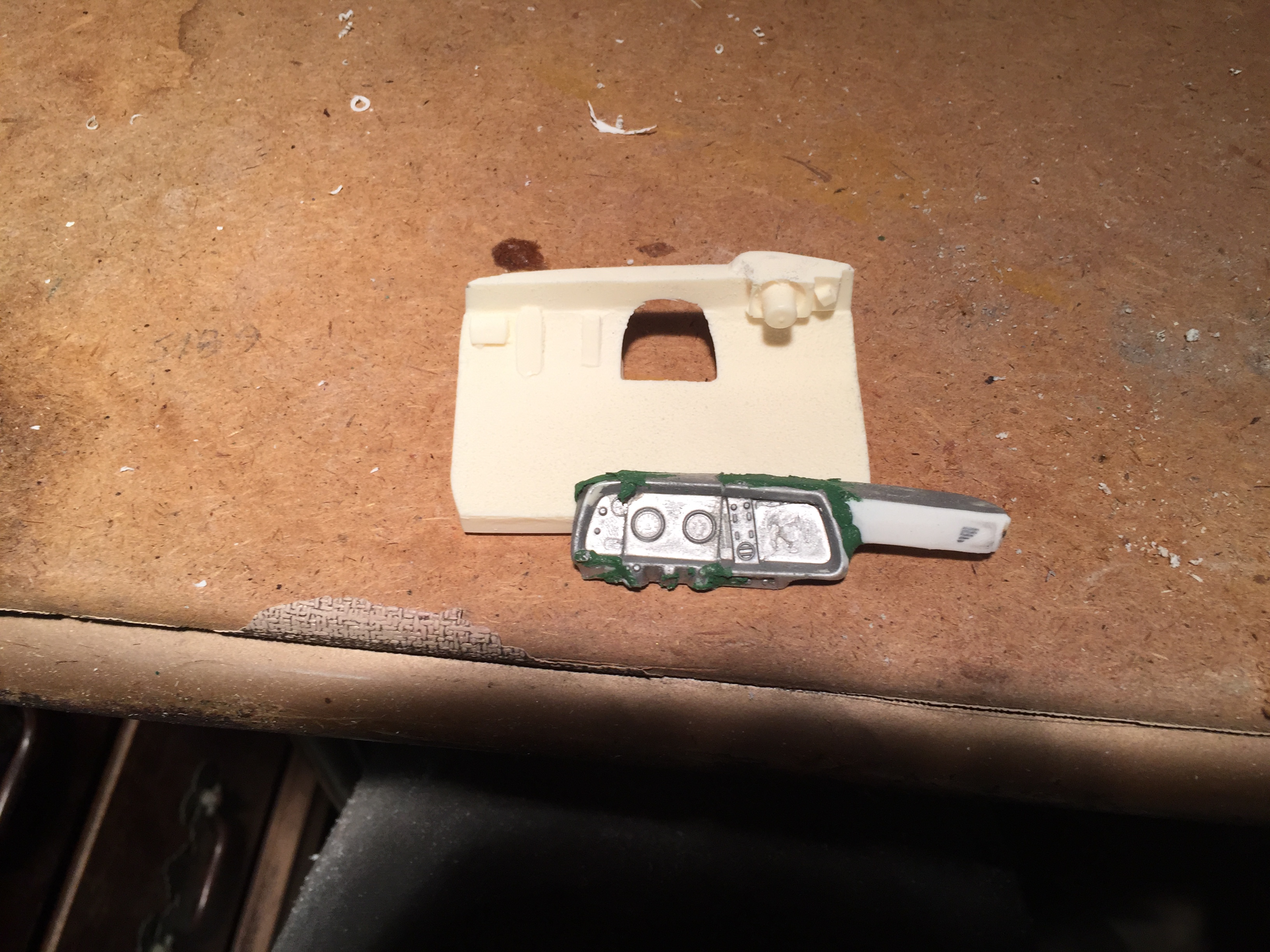

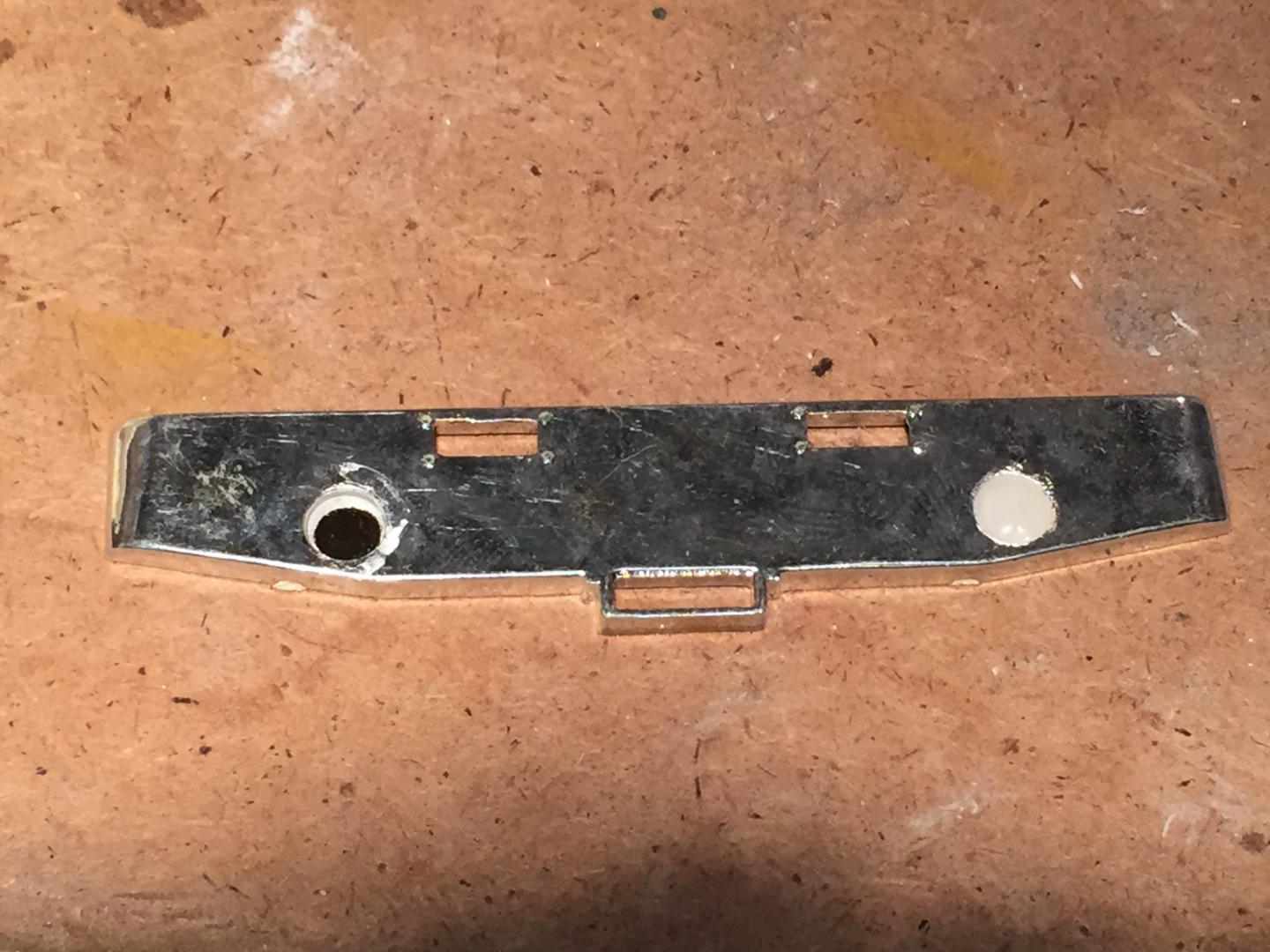

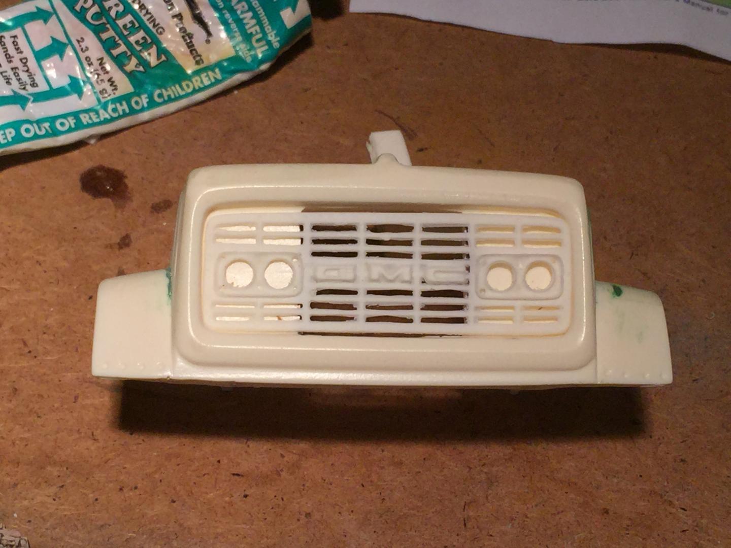

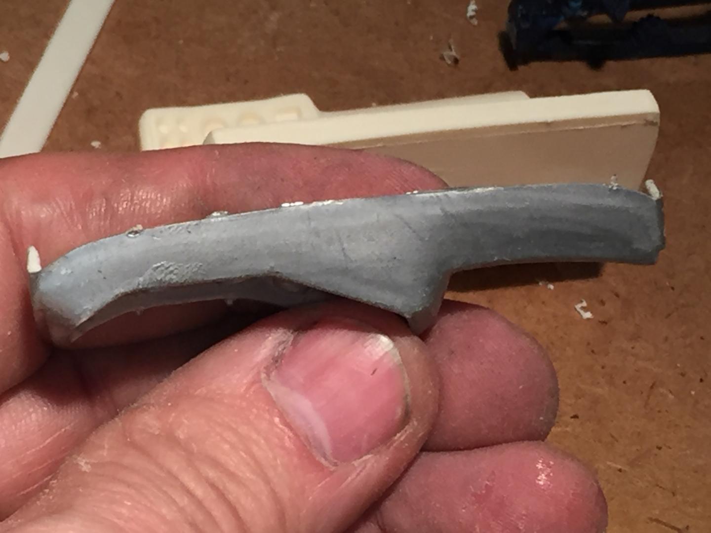

Finished thinning the hood and trimmed the cab to hood surface.  Cut the doghouse into the floor pan and assembled the engine. Thinned the grille to open up the cooling holes and converted a parts box bumper to fit.  One step at a time!IMG_8075.JPG

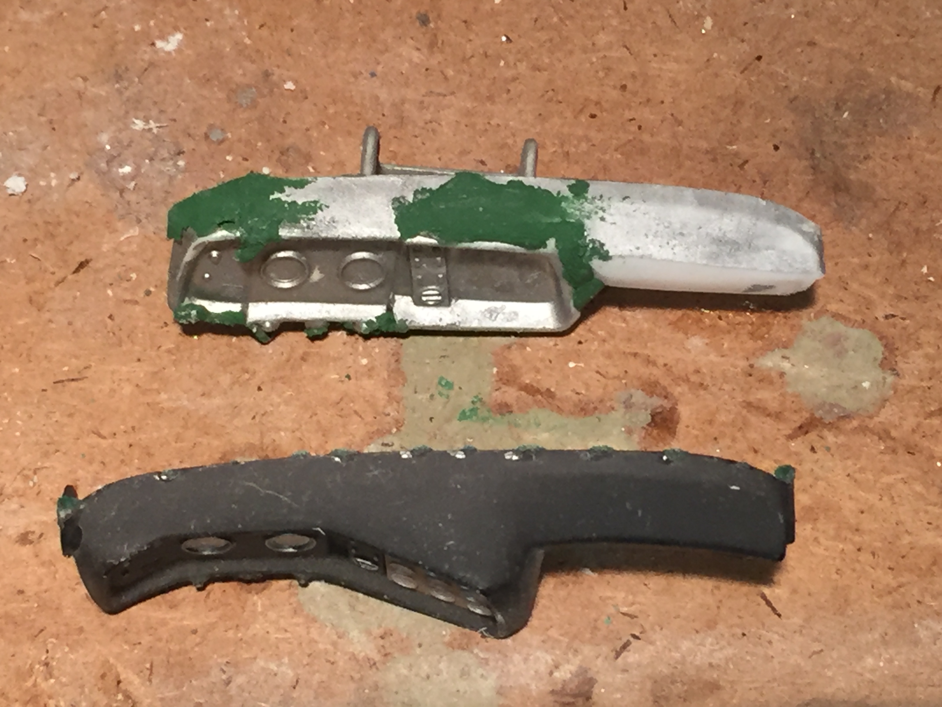

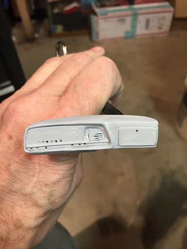

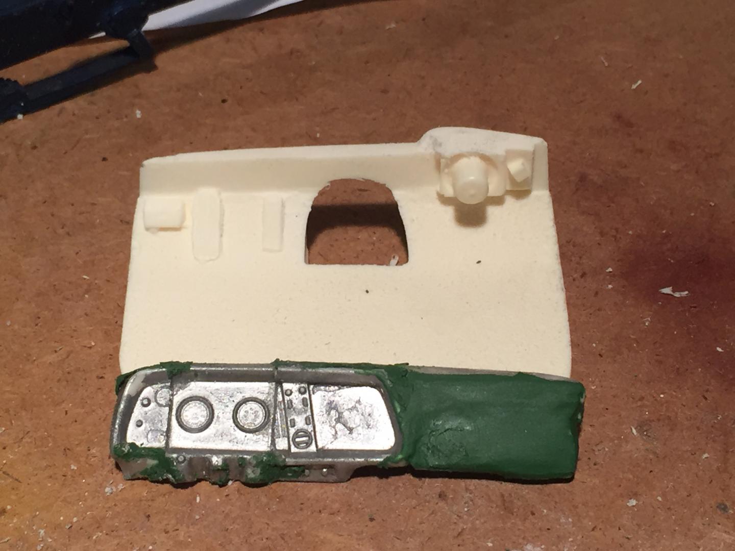

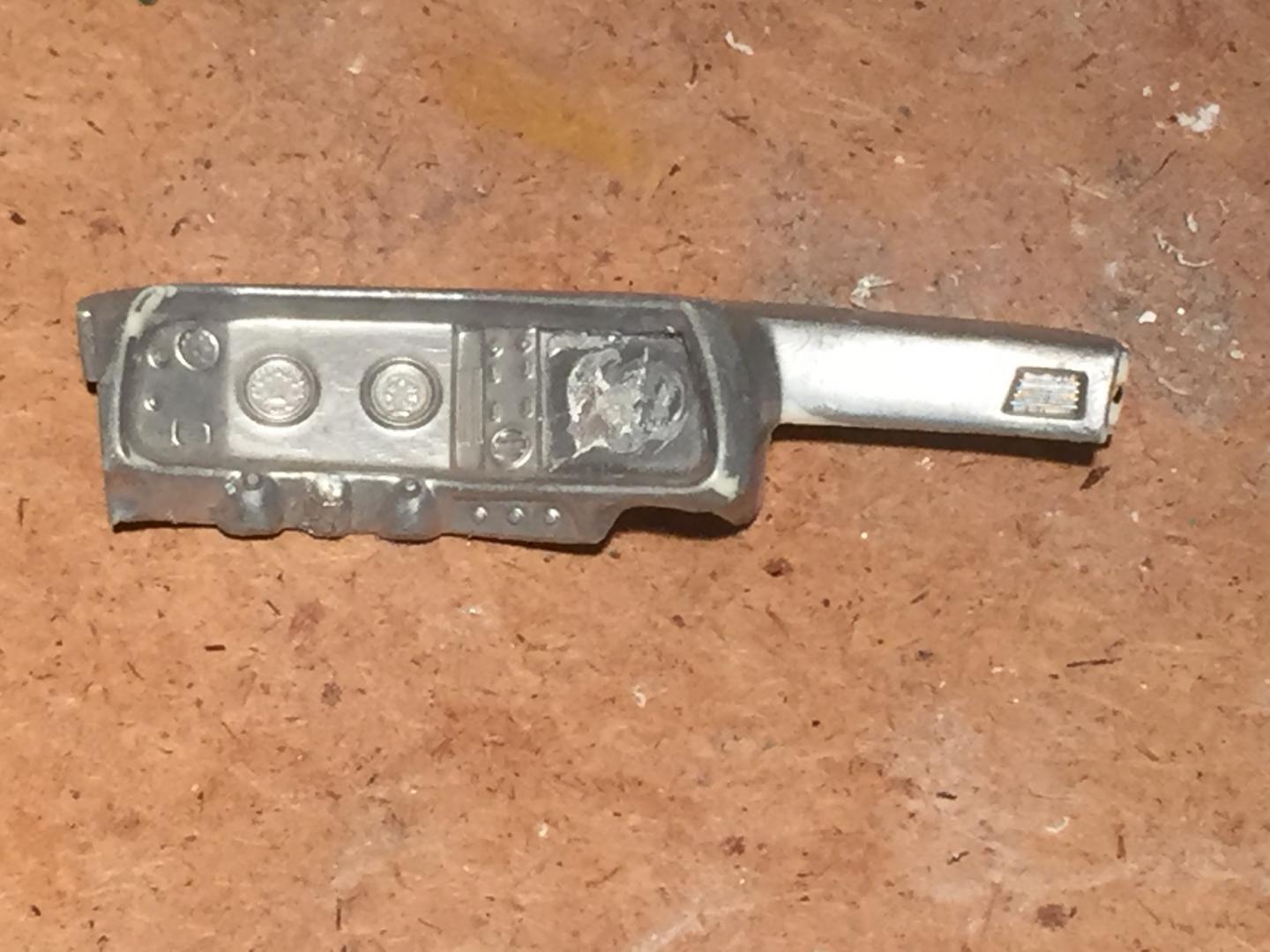

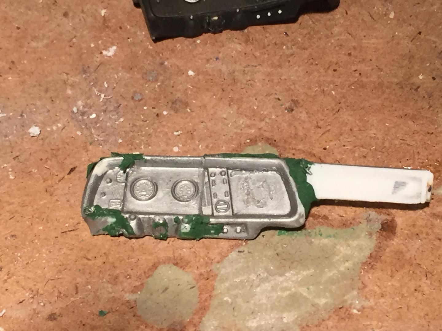

Decided to use a Ford Louisville dashboard to convert to the GMC model.  Cut it down, reshaped, and will redo the gauges after it dries.

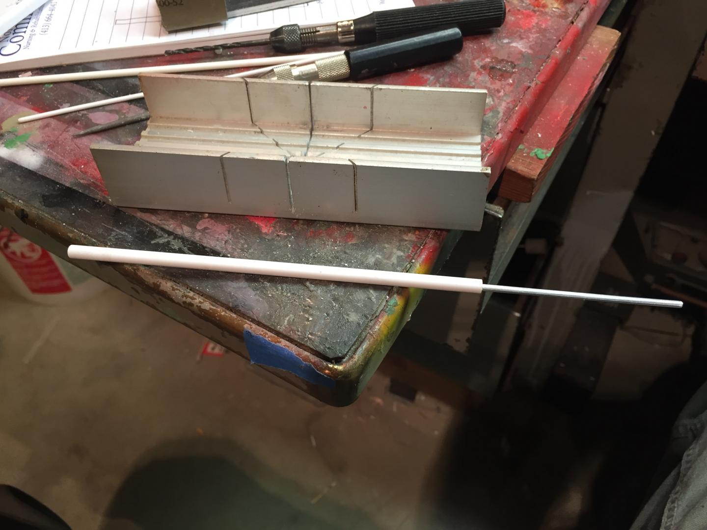

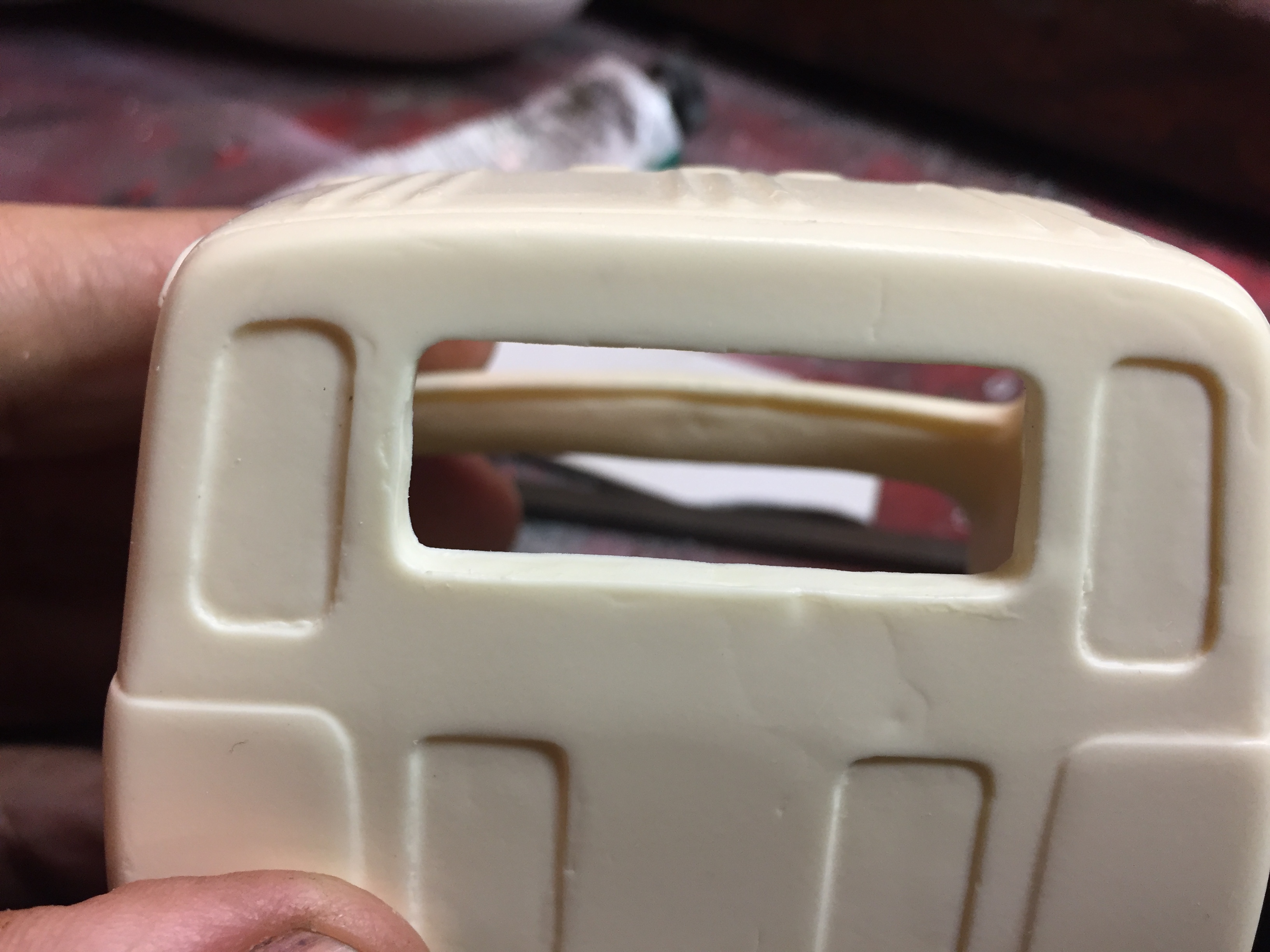

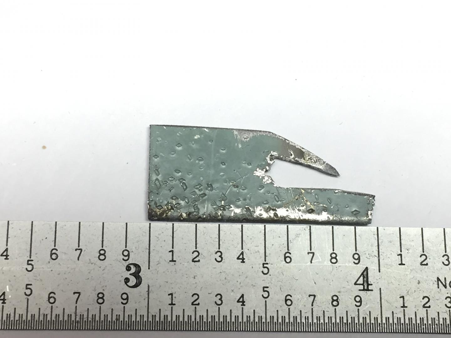

The AITM cab does not have the surround line around the windshield and the rear window that delineates the rubber gasket. And I do NOT have the steady hand to scribe it into place. So, I devised a tiny tool to run around the inside perimeter of the window opening to make a consistent rubber gasket groove.  Worked perfectly! Made it from a piece of sheet metal with a hack saw and a file. Woke up at three in the morning thinking about it and the miracle is I remembered it when I got up! Before and after photos of the windows are shown as well as the tool. Will cut the grooves around the inside later to install the glass, with a Dremel tool.

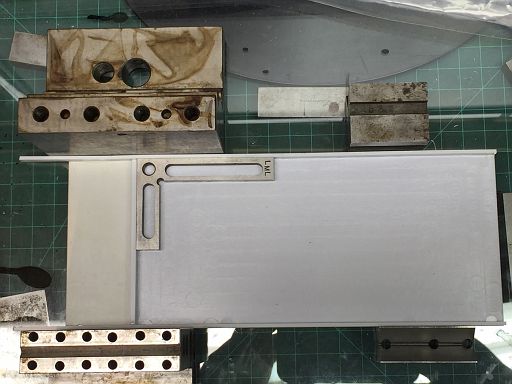

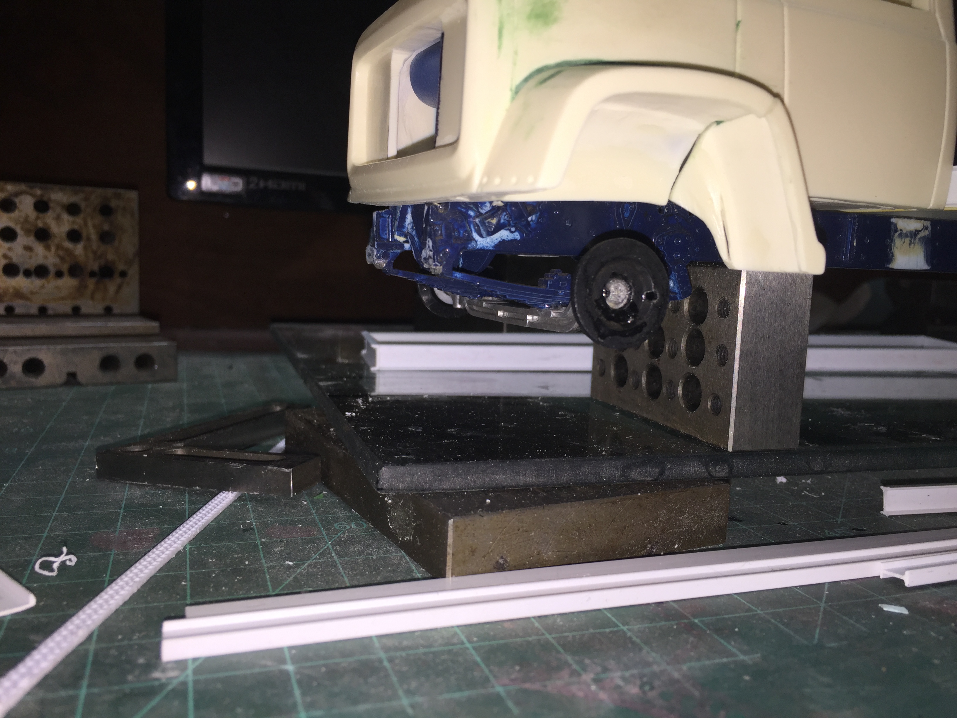

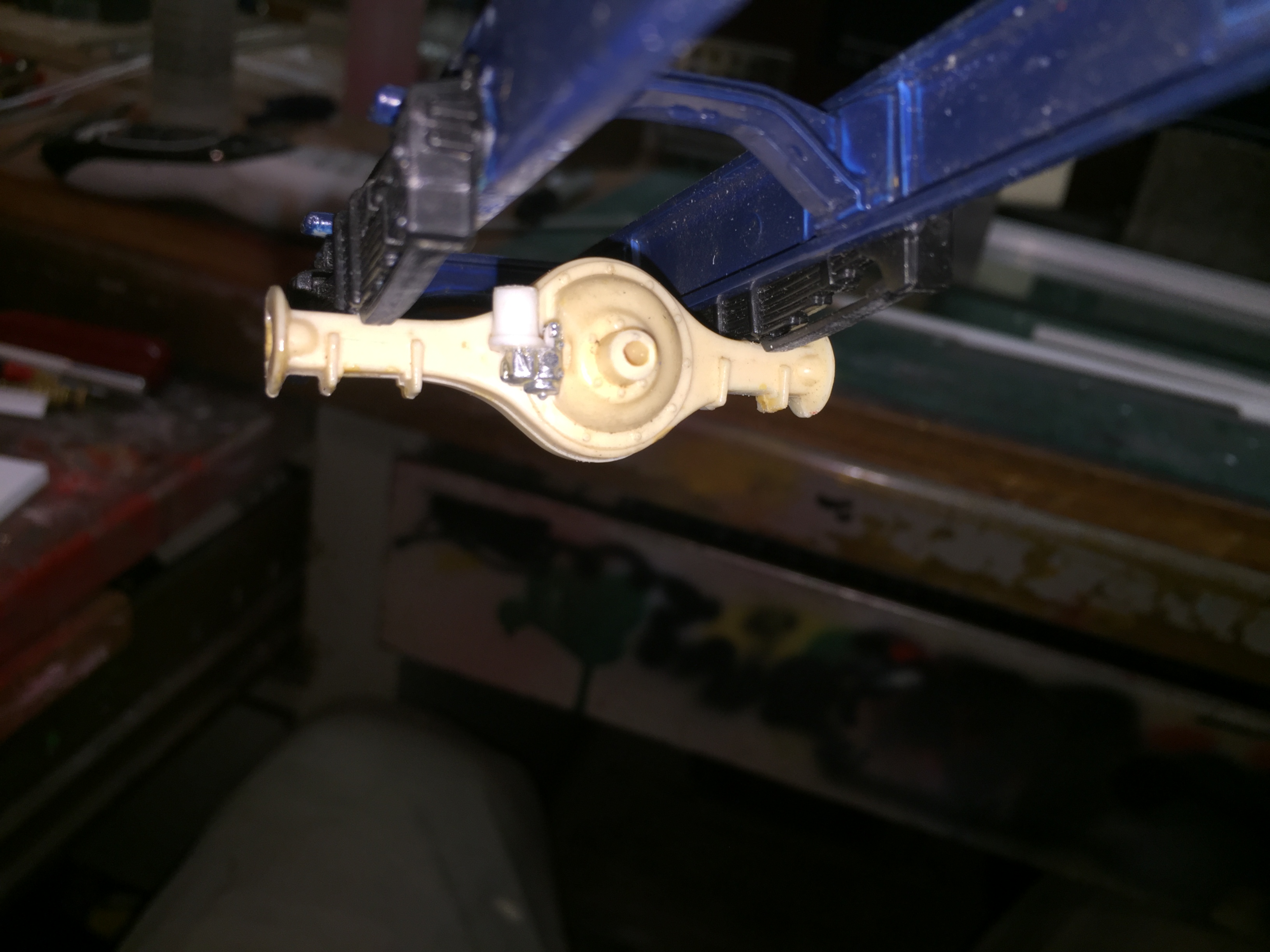

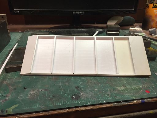

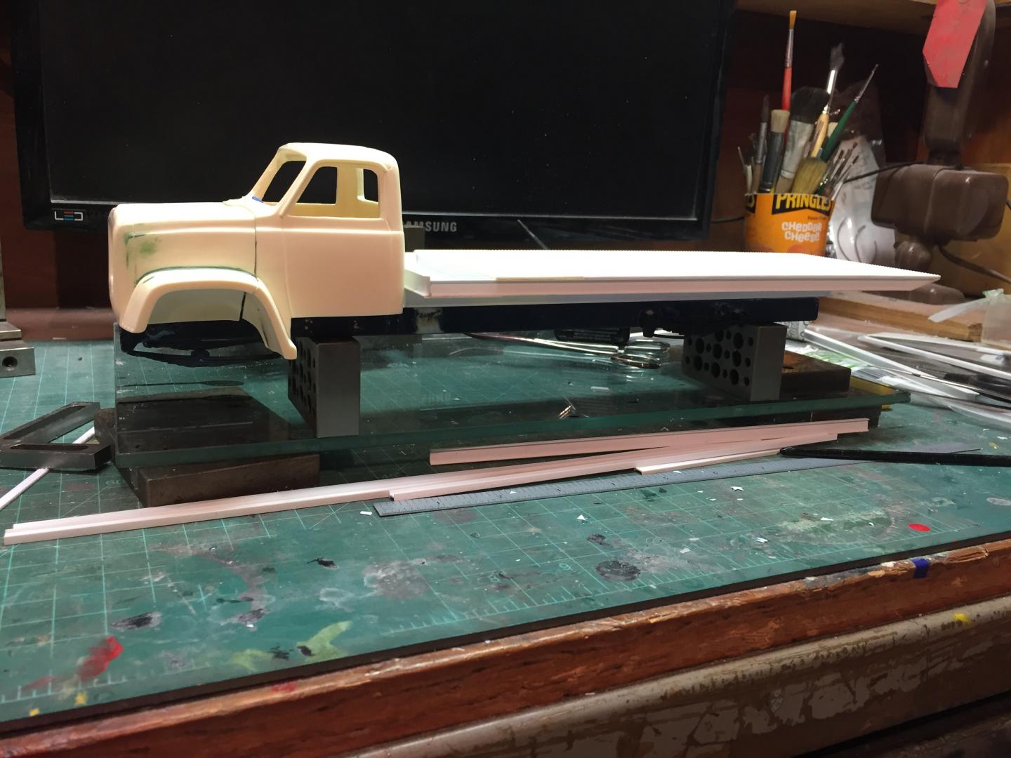

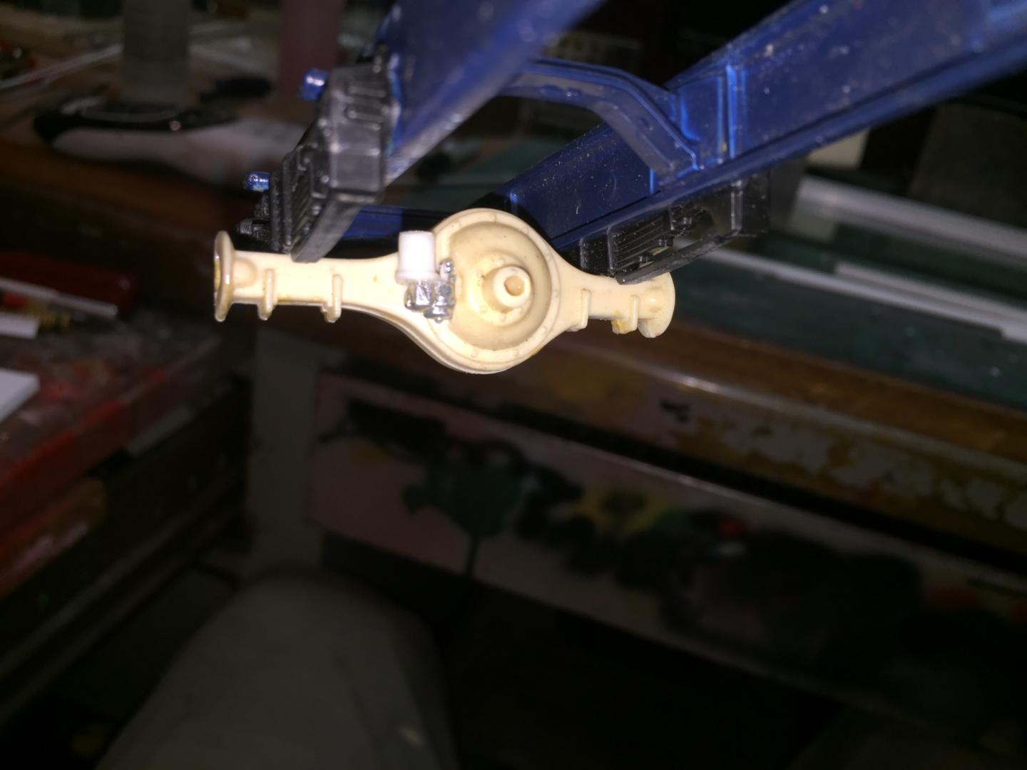

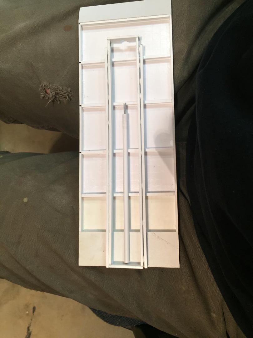

Got the rollback body started today............diamond plate bed and Evergreen structure. Got the dashboard shaped and painted, and the gauges installed. Now on to the subframe and extension cylinder frame for the body. Slowly getting a box full of parts for this build assembled! The dash is made from a Ford Louisville dash with a LOT of reshaping. After a bunch of figuring out what to do, this is what I ended up with. Used gauge decals from Slixx, and gauge bezels made from aluminum tubing and gauge faces. Now have to add the knobs and various switches and fabricate the rollback subframe and hoist and extension cylinders. Installed the front and rear axles, and made the rear axle into a two speed version

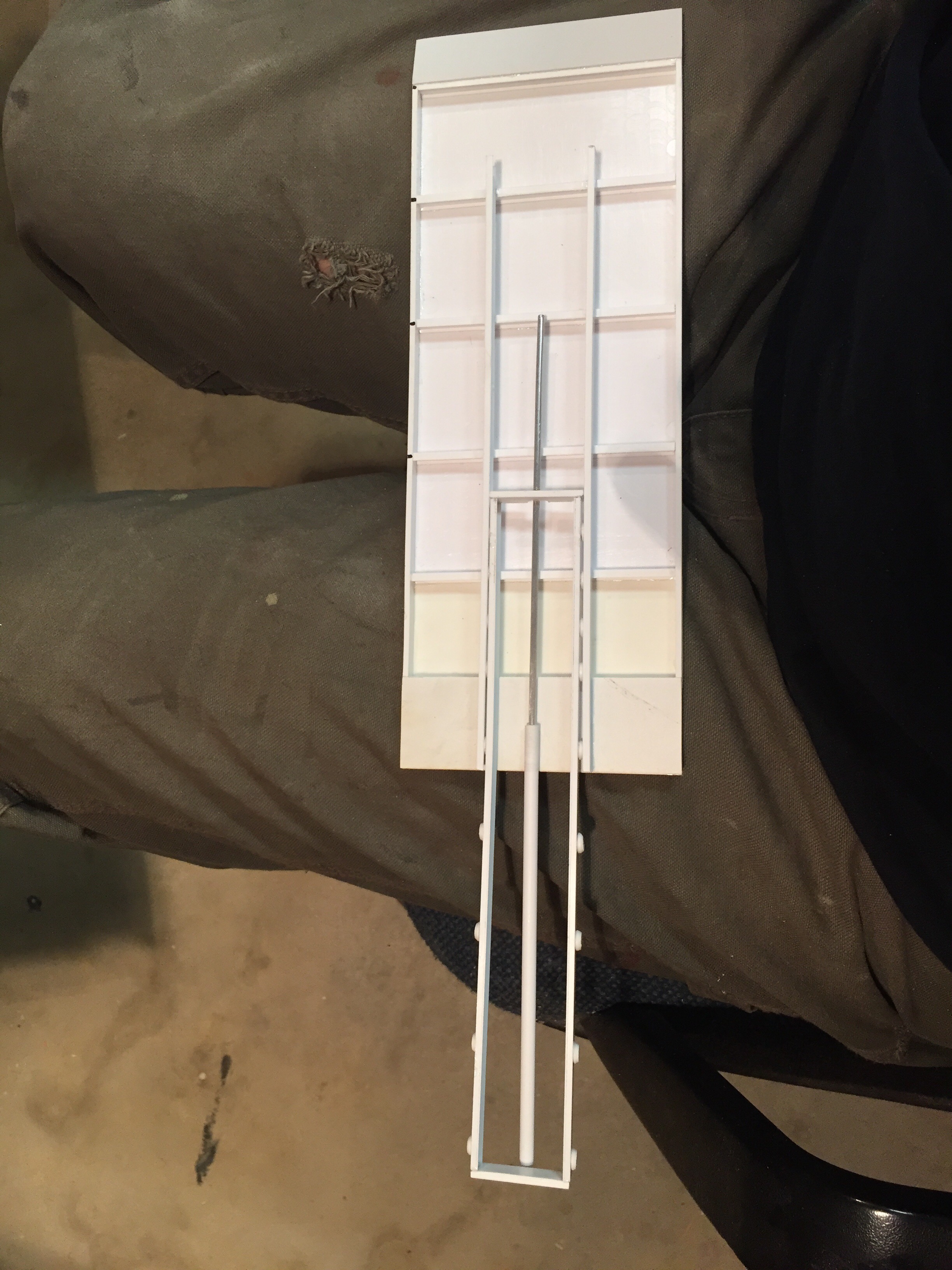

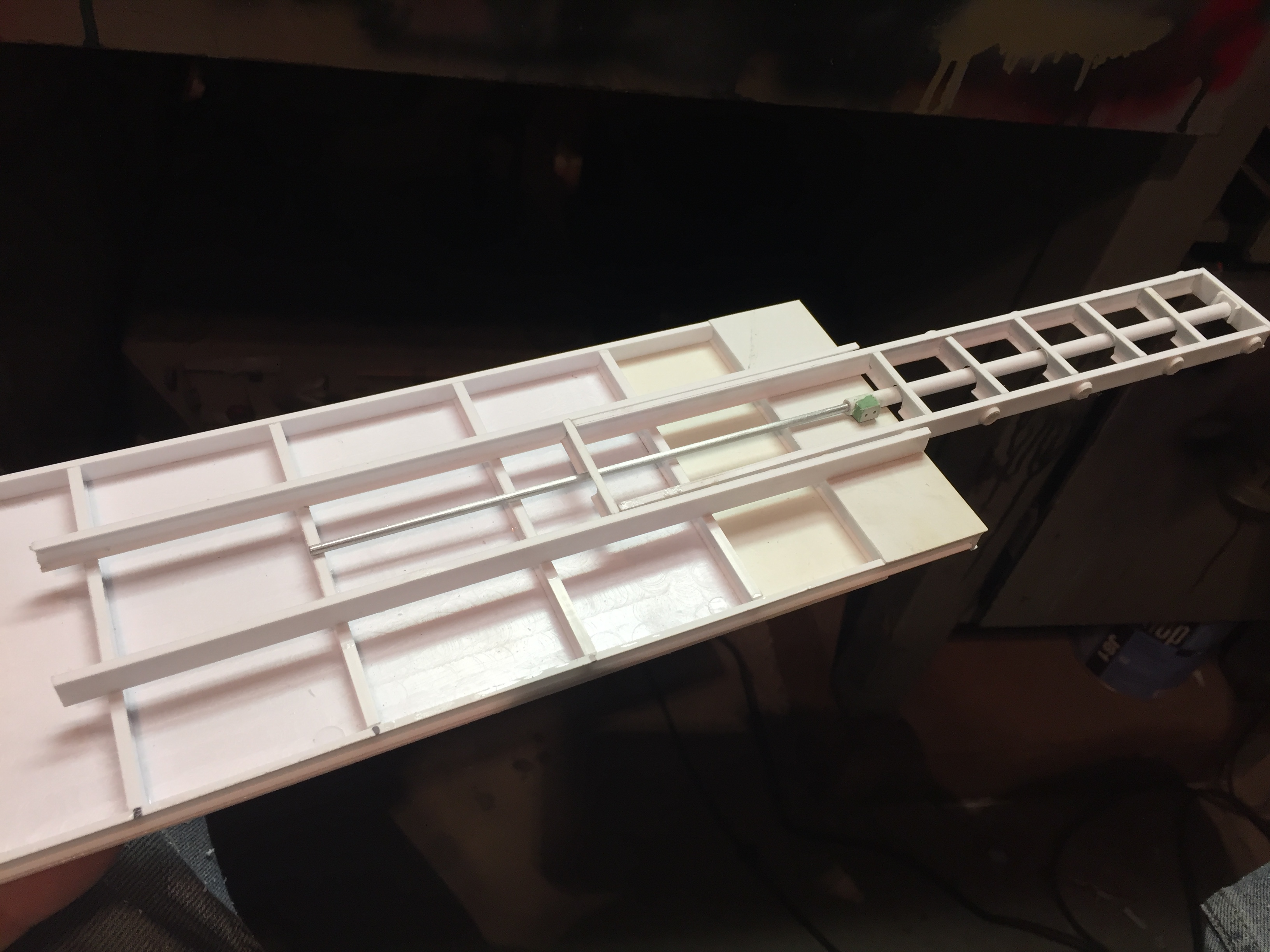

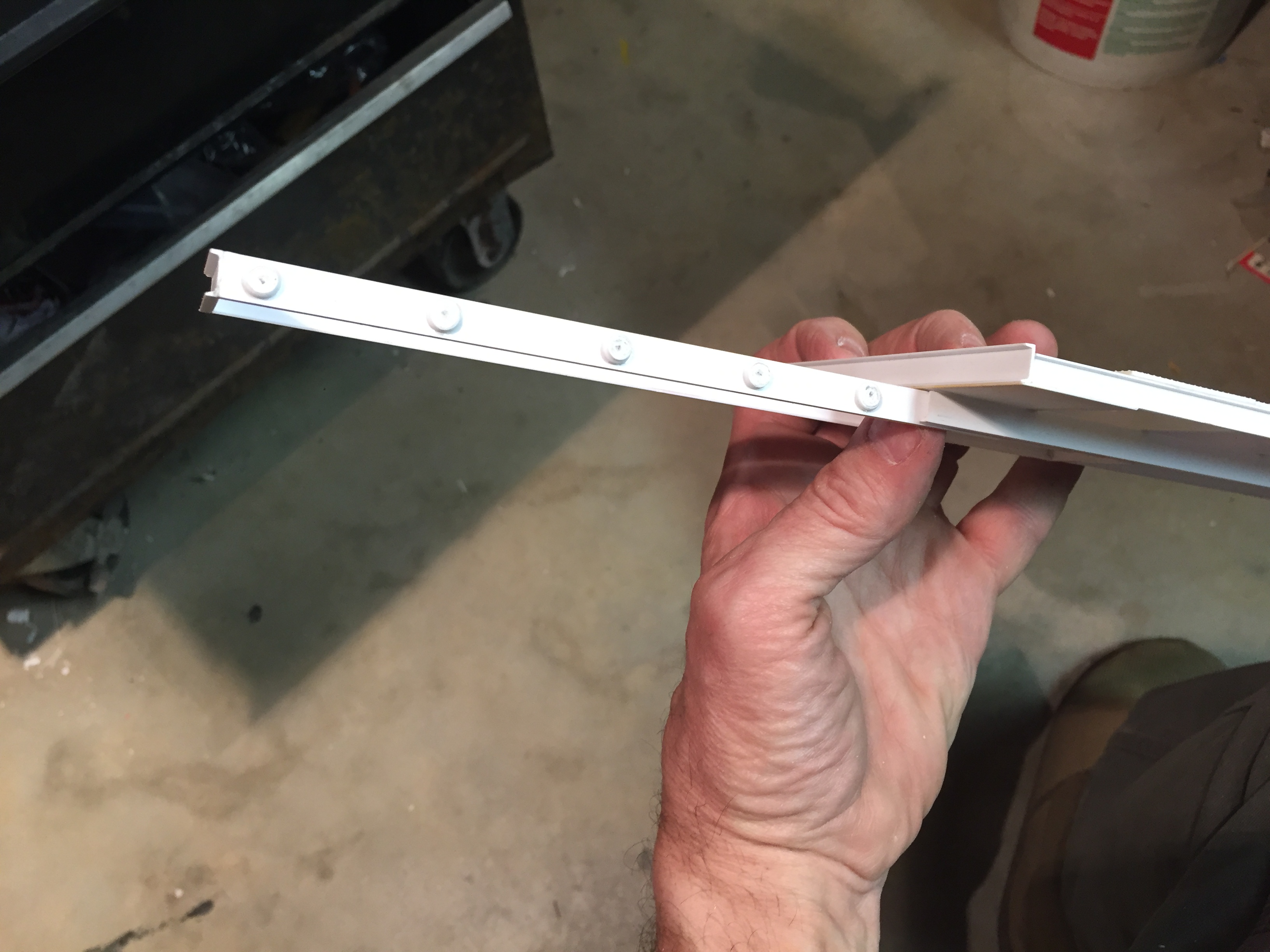

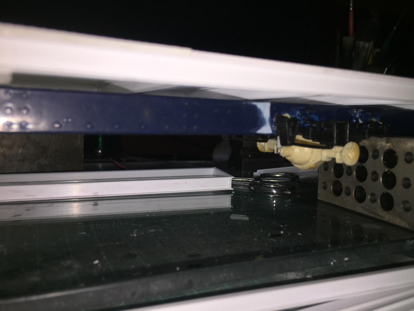

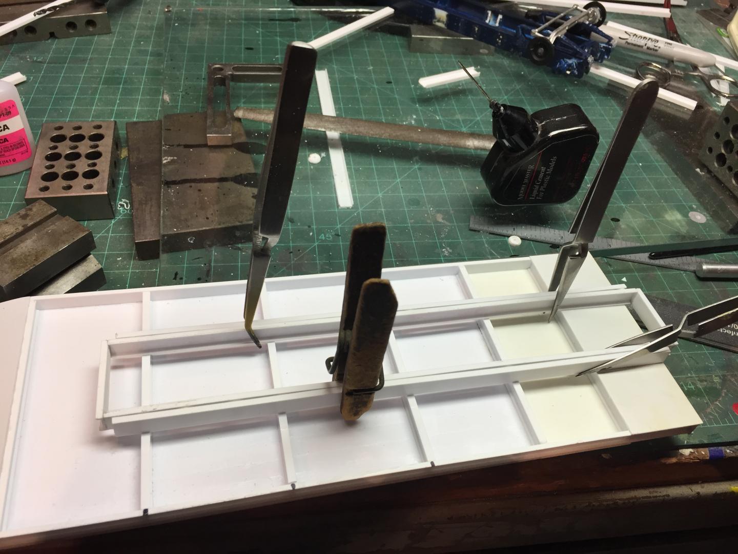

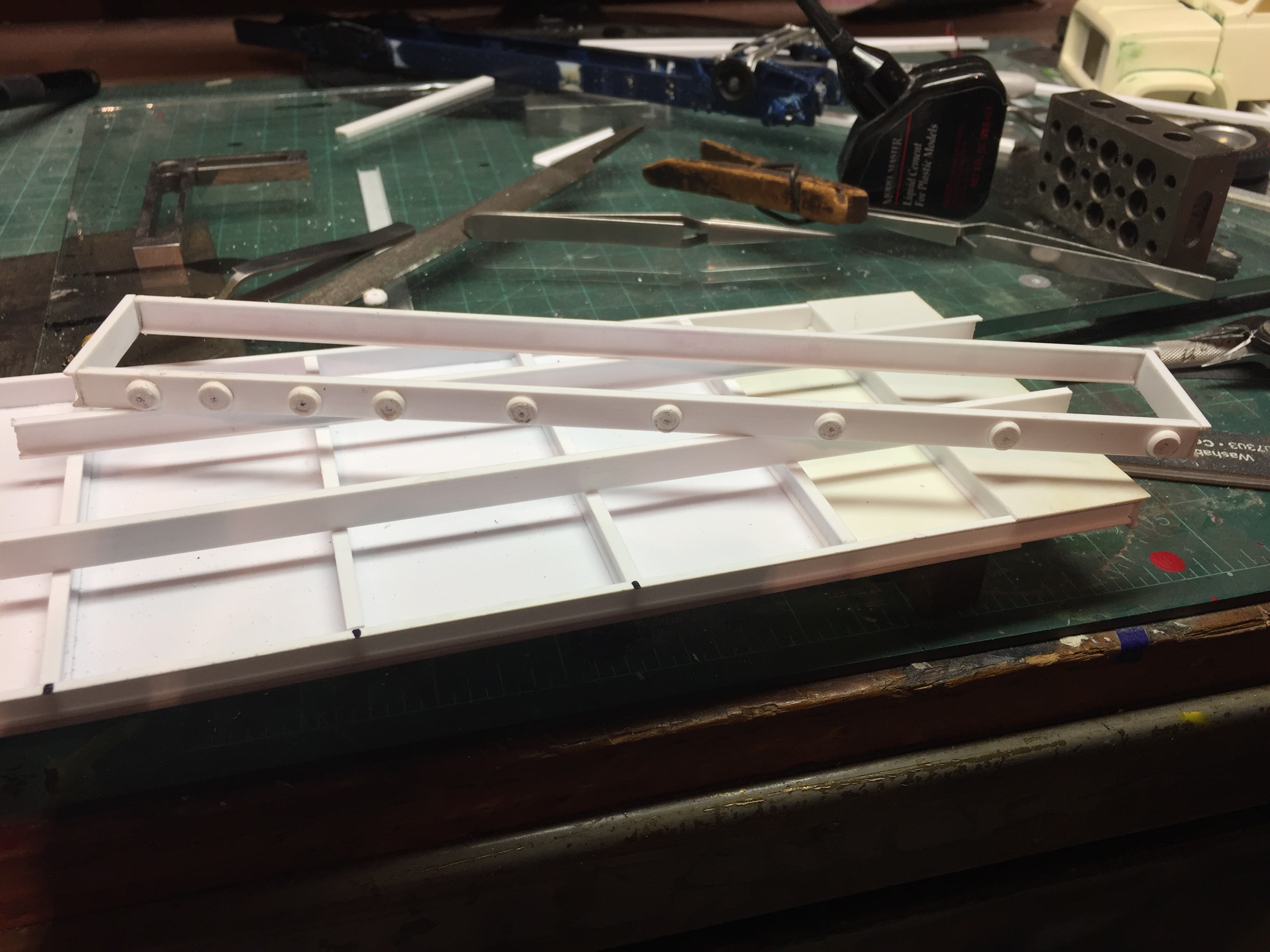

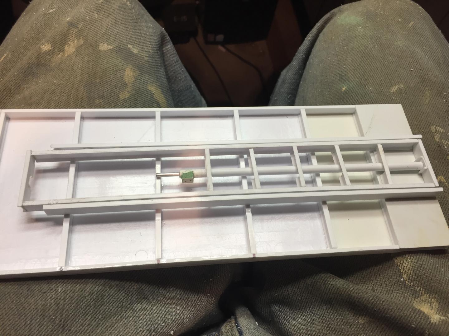

Got the subframe built with all of the tapered rollers added to it.  Attached the slider frame to the body.  Made the 12 foot extension cylinder from Evergreen and aluminum tubing.  Still have to install the cylinder to the subframe and attach it to the body, and make and install the subframe cross braces. Then need to make the hoist cylinders and their frame mounts and the body pivot.   Lots of little details but it's coming along.

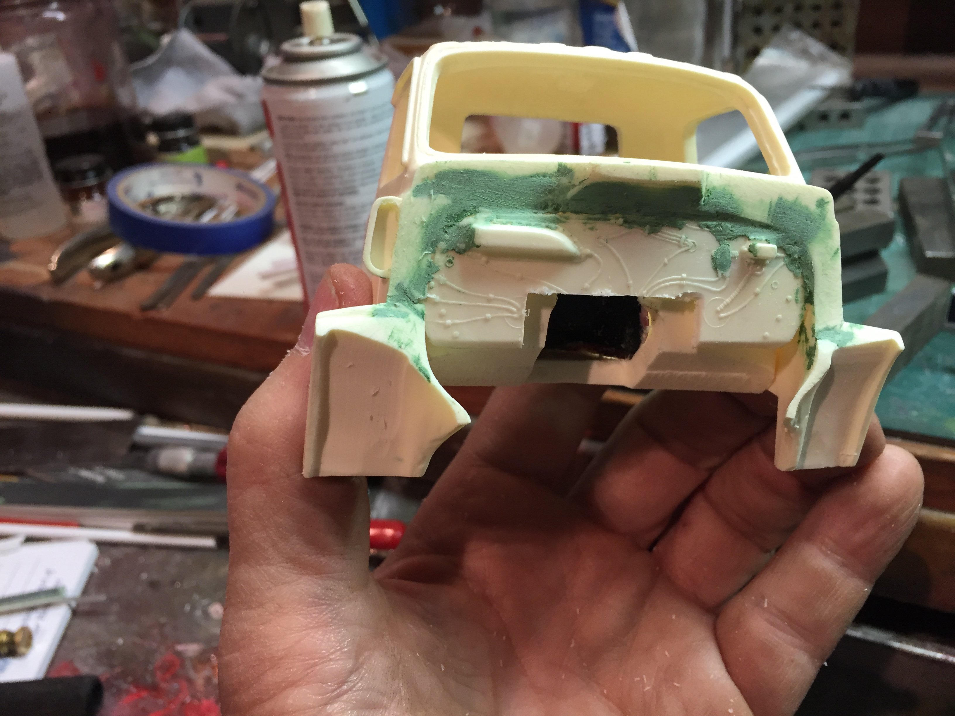

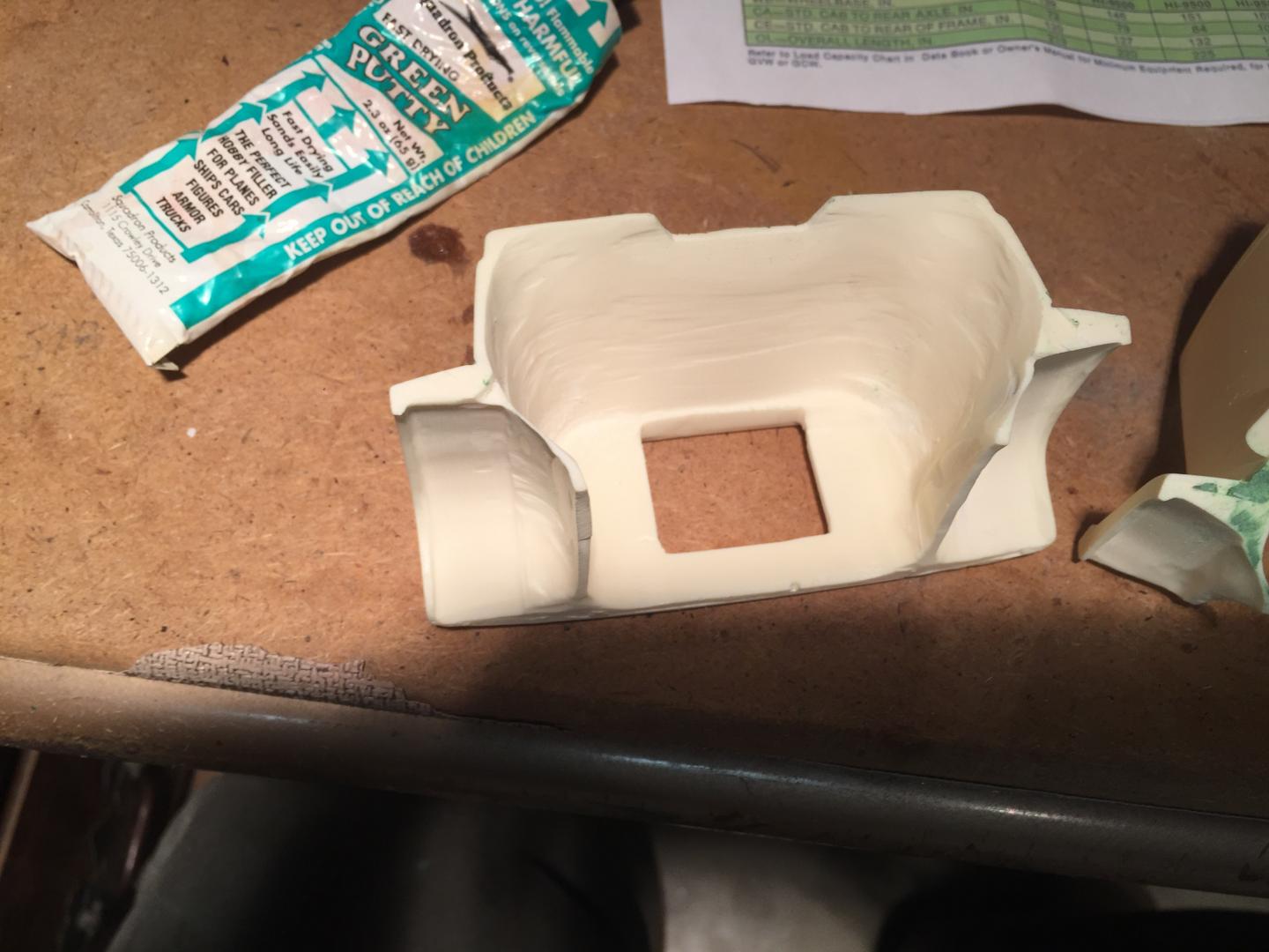

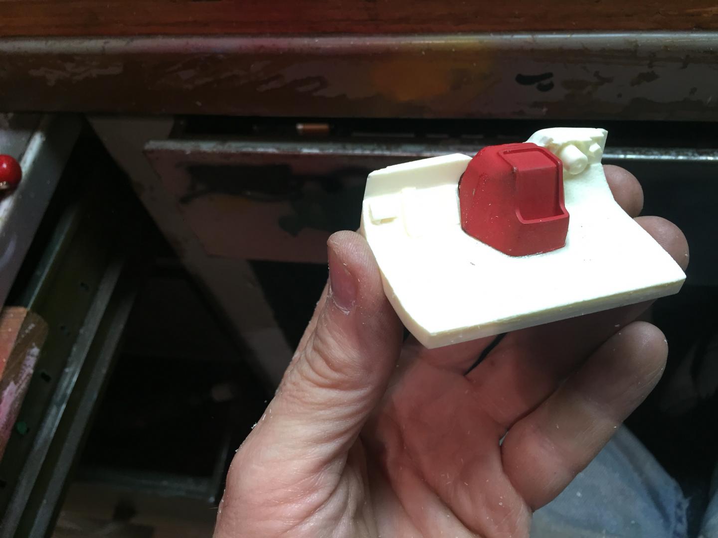

Installed a firewall from the parts box, cut the doghouse opening to the right size and found a doghouse cover from an old Chevy van that will do the job. Filled a bunch of gaps to finish when dry.  Got the subframe partly done and the extension cylinder installed.
