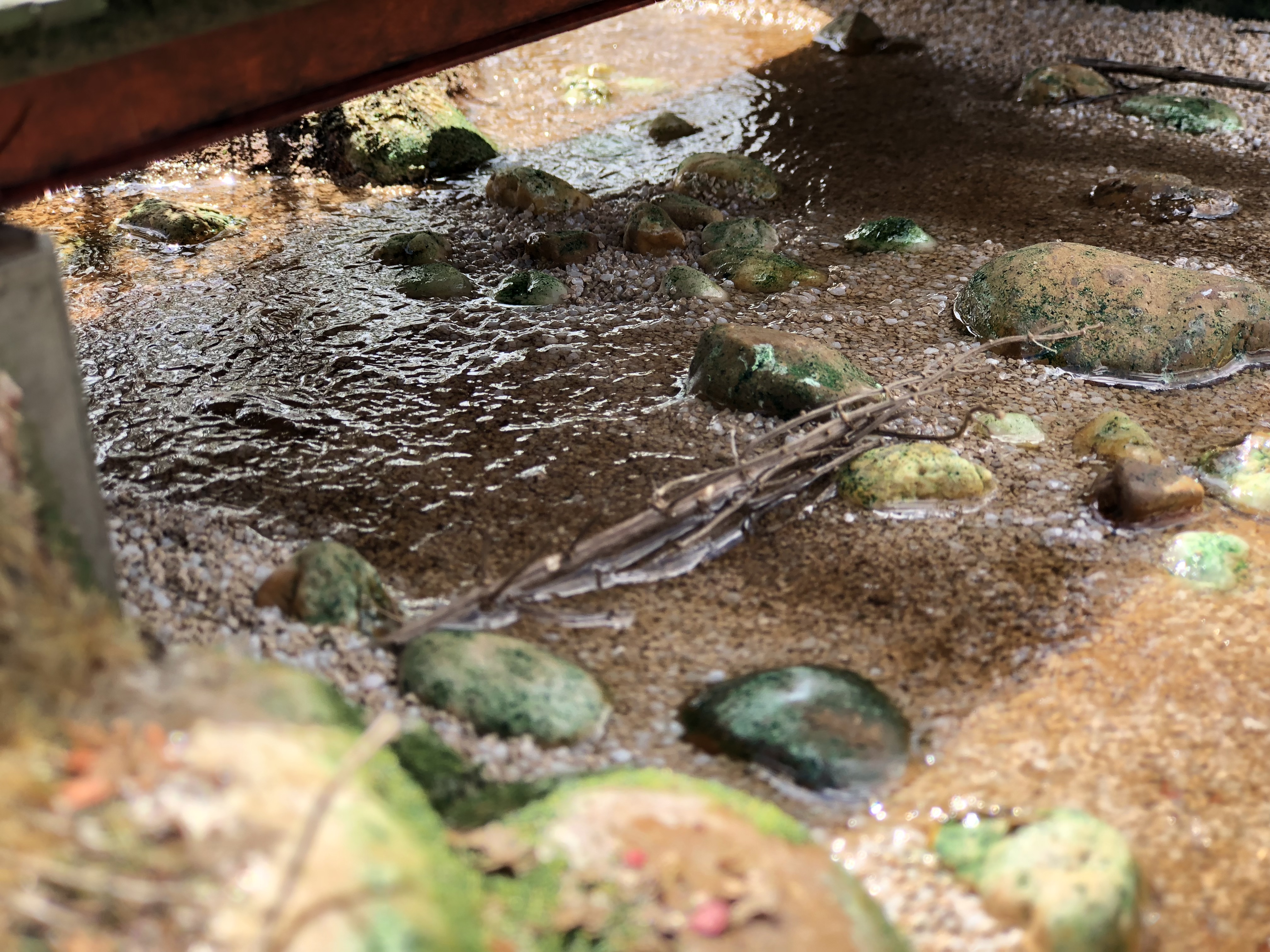

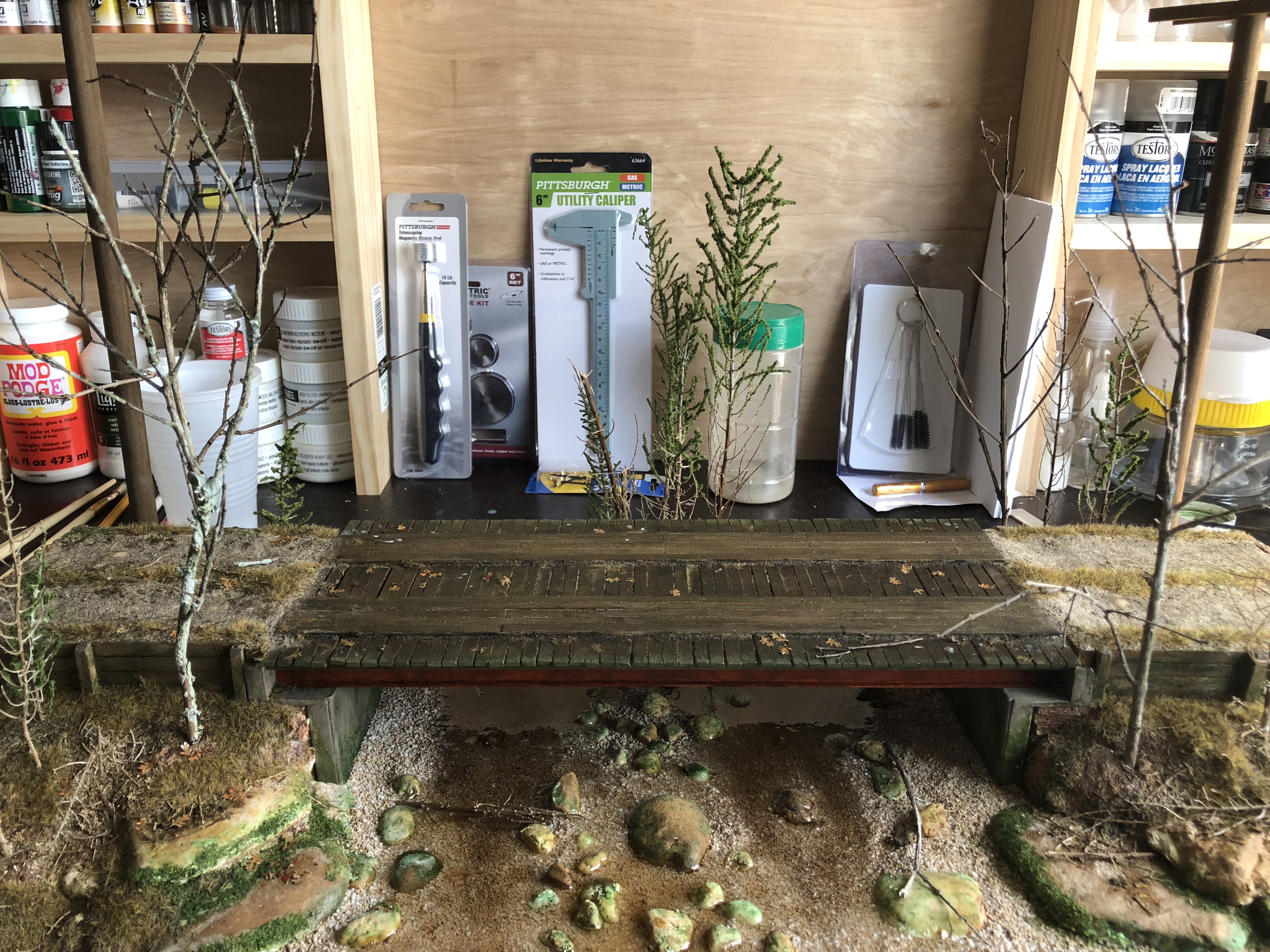

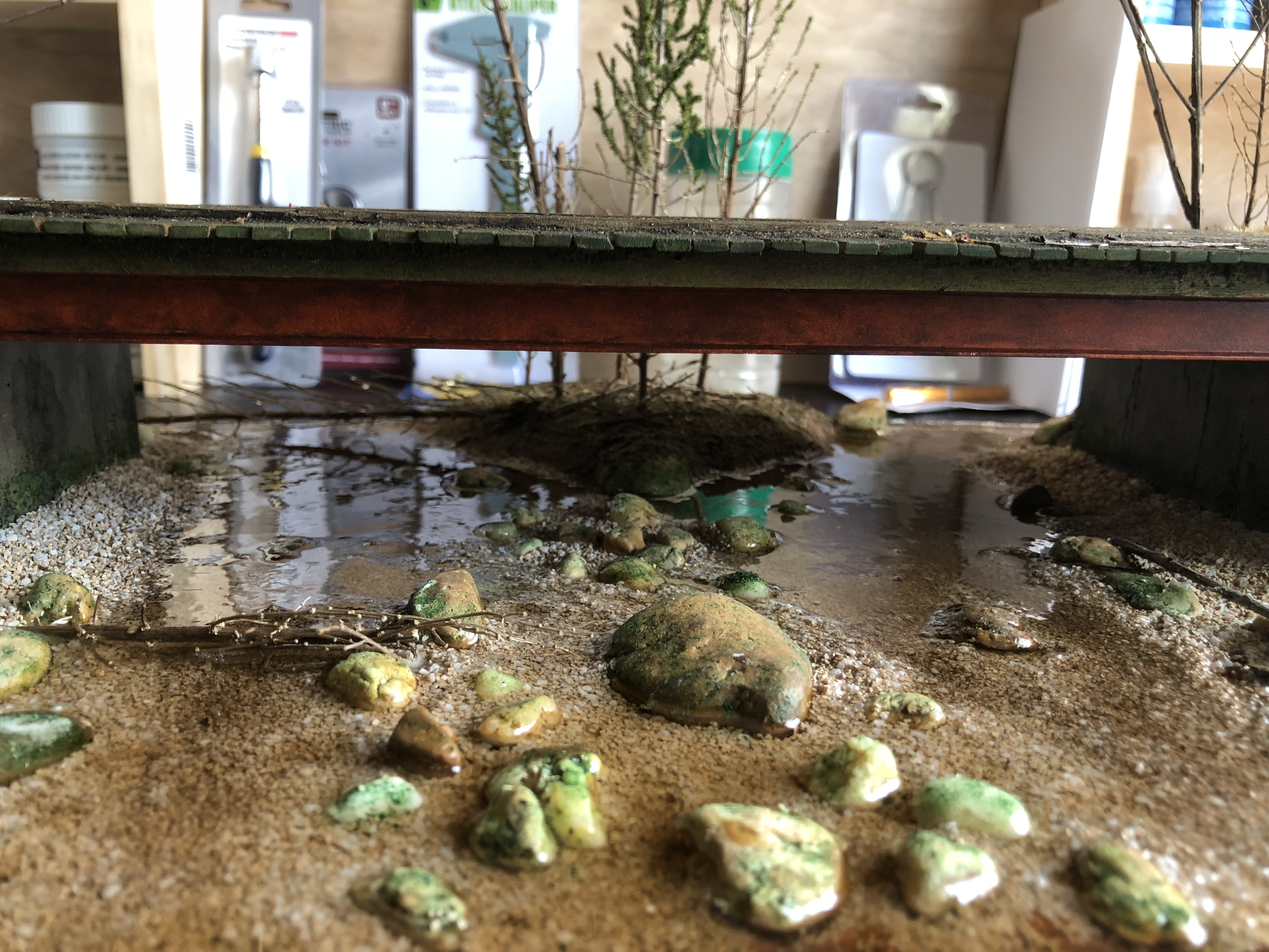

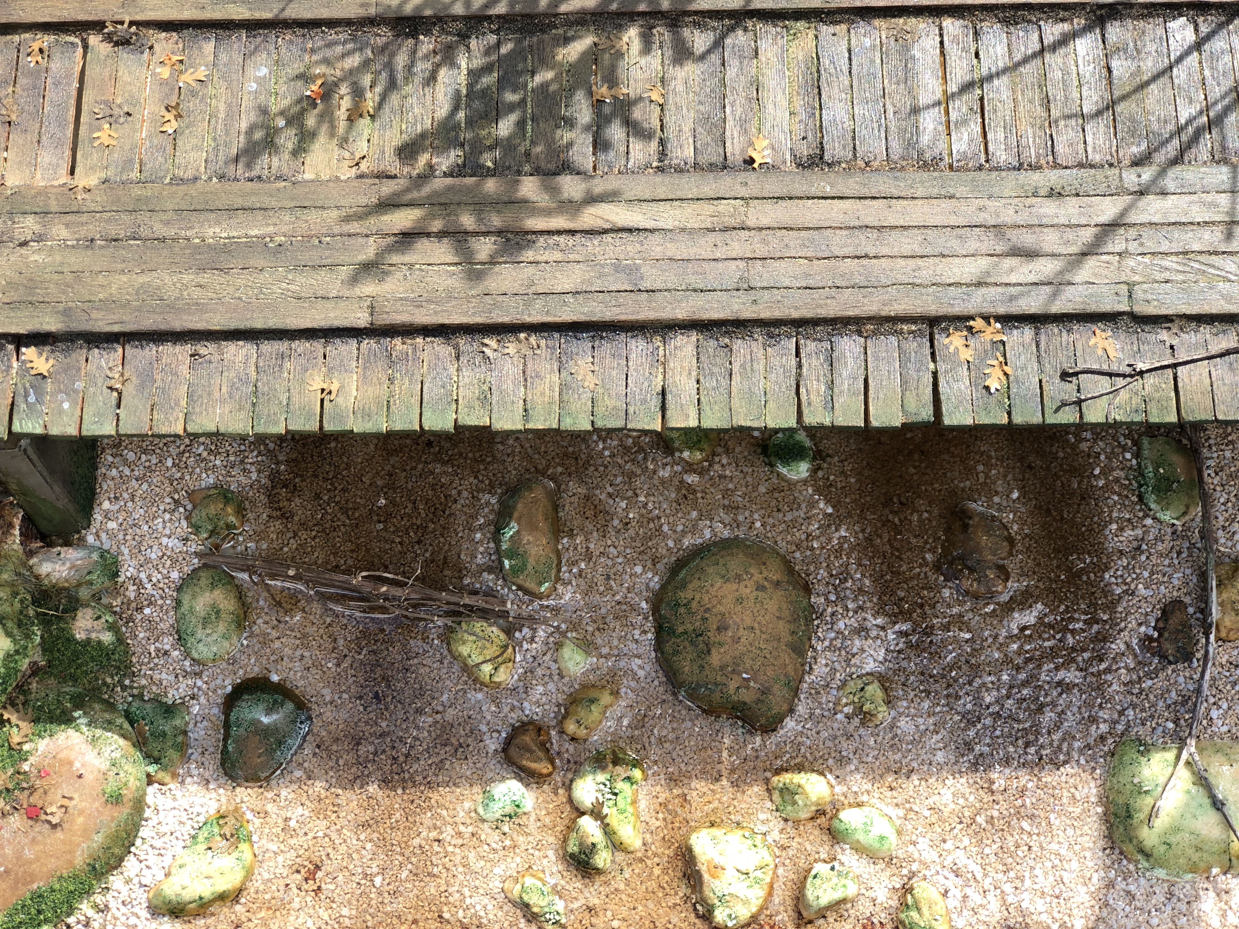

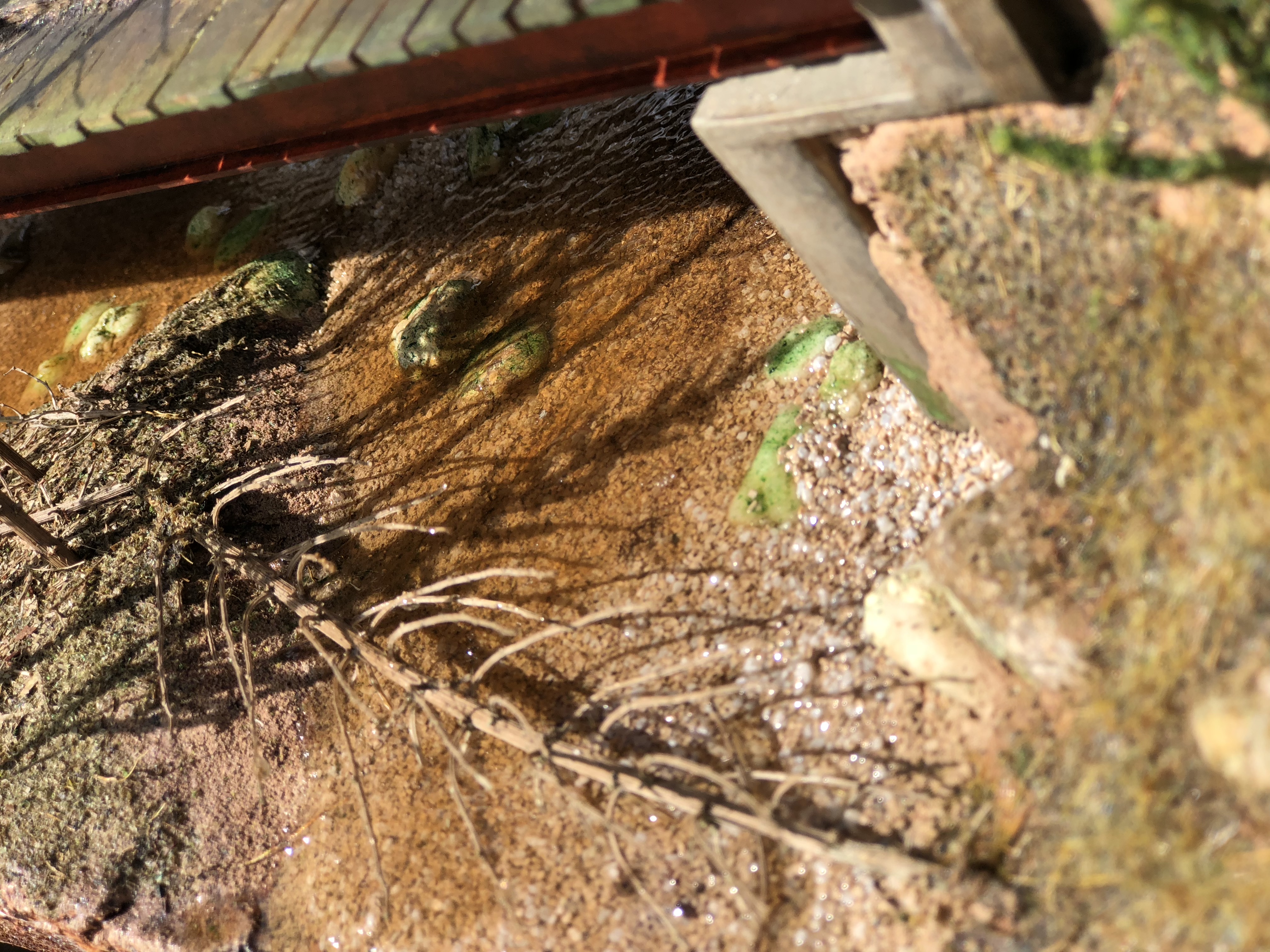

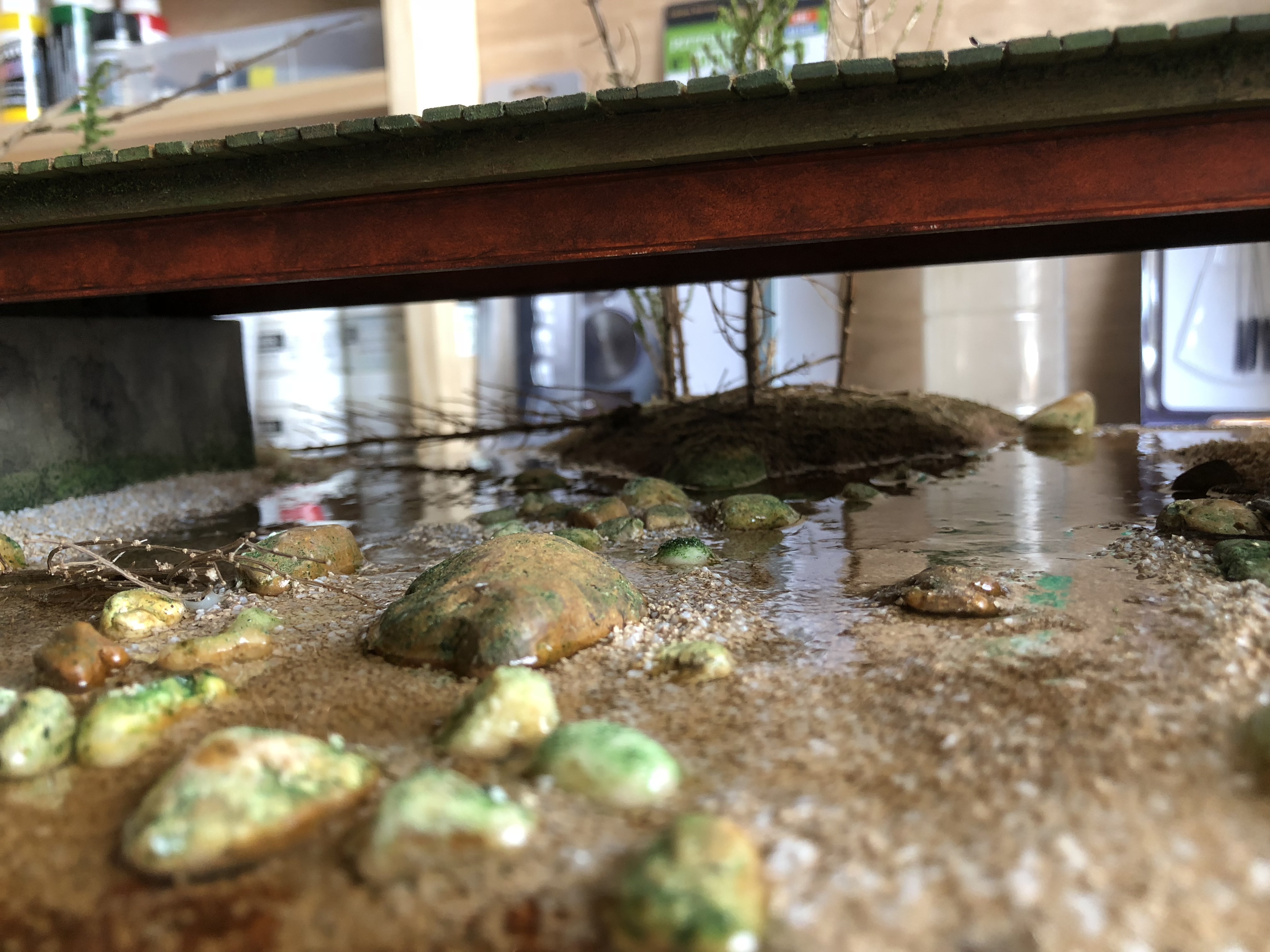

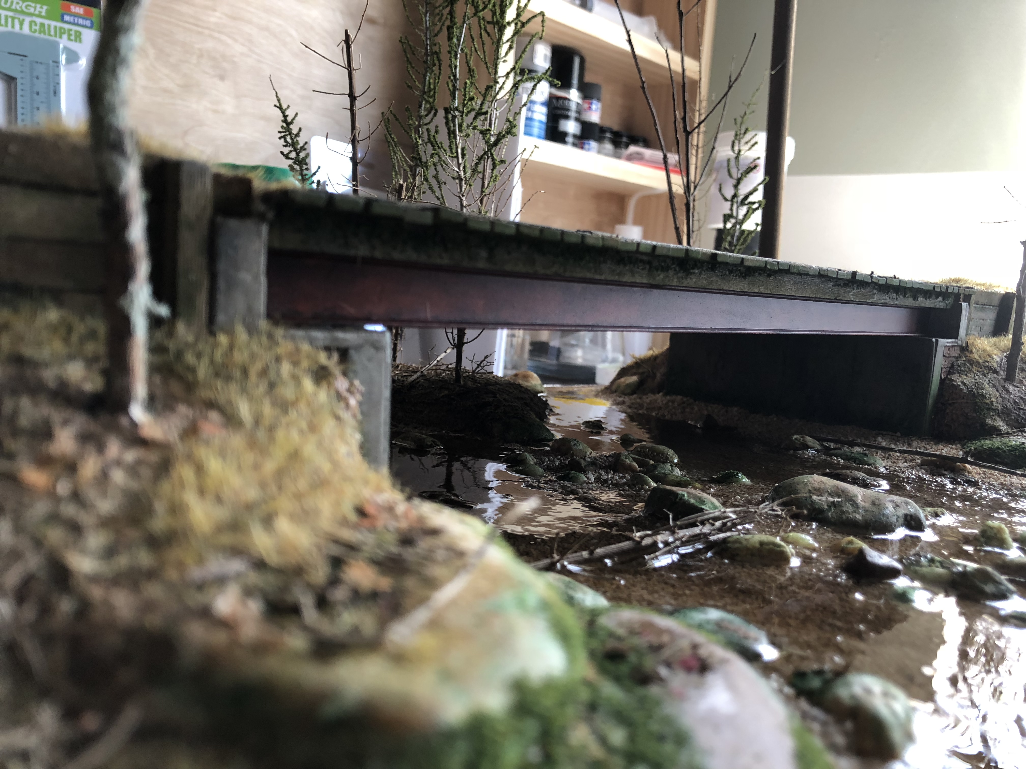

I pour the resin for the creek water. I made the mistake of gluing the beige before pouring it, so it was a little challenging. It was a scary process, since it was my first time making faux water and did not want to ruin my diorama. I just need to give some final touches, such as some small ripples (to show some small water movement). I also added some random bird drops on the bridge, as suggested here in the forum (I need more practice on this. LOL). Then I need to patch some areas around the bridge and abutment, where the layers of cork are still seen.

The water looks great Yordon.

Thank you. I didn’t want deep water, just a stream that looked natural.

I think you hit the mark with the water.  Looks very realistic.

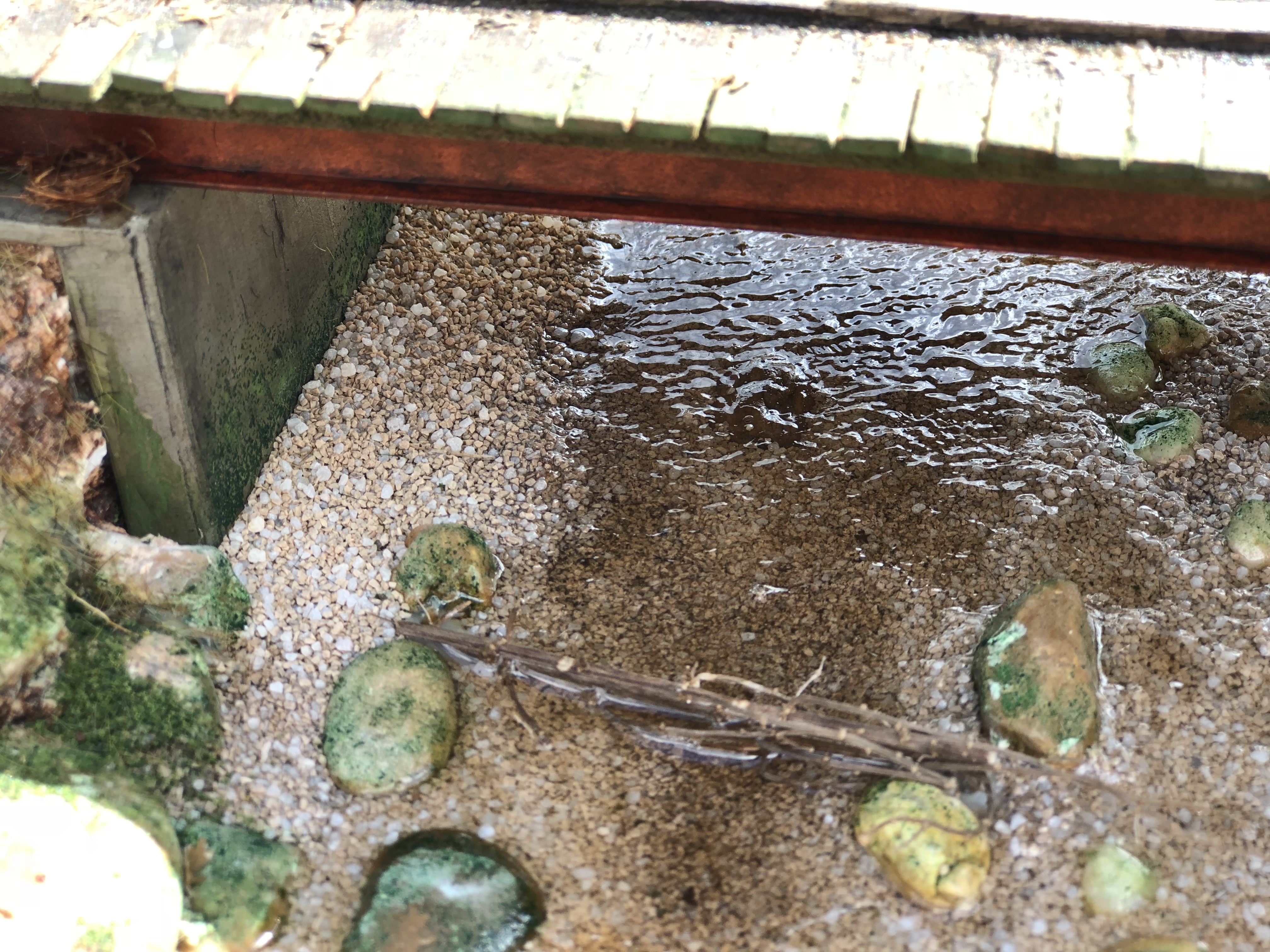

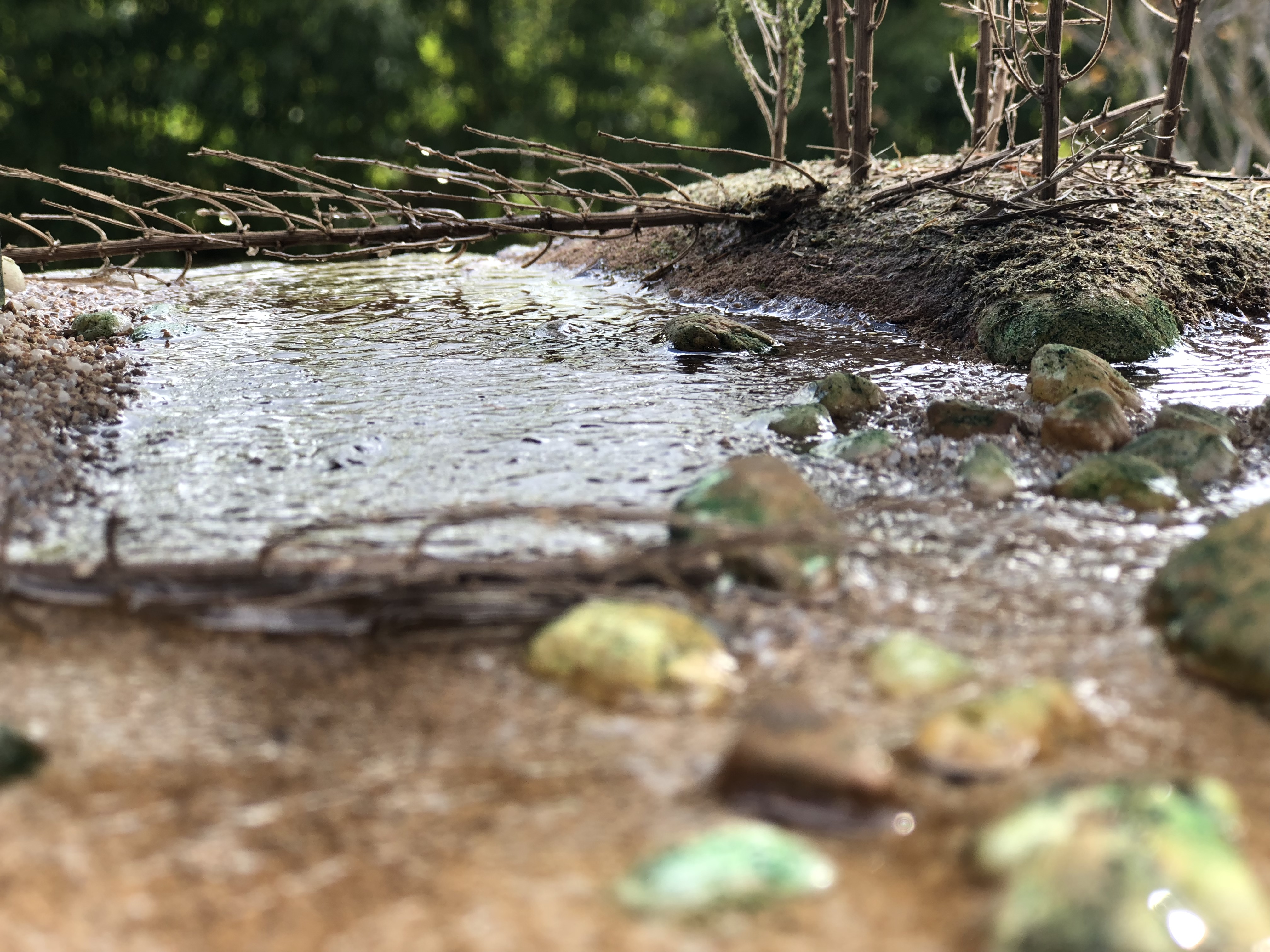

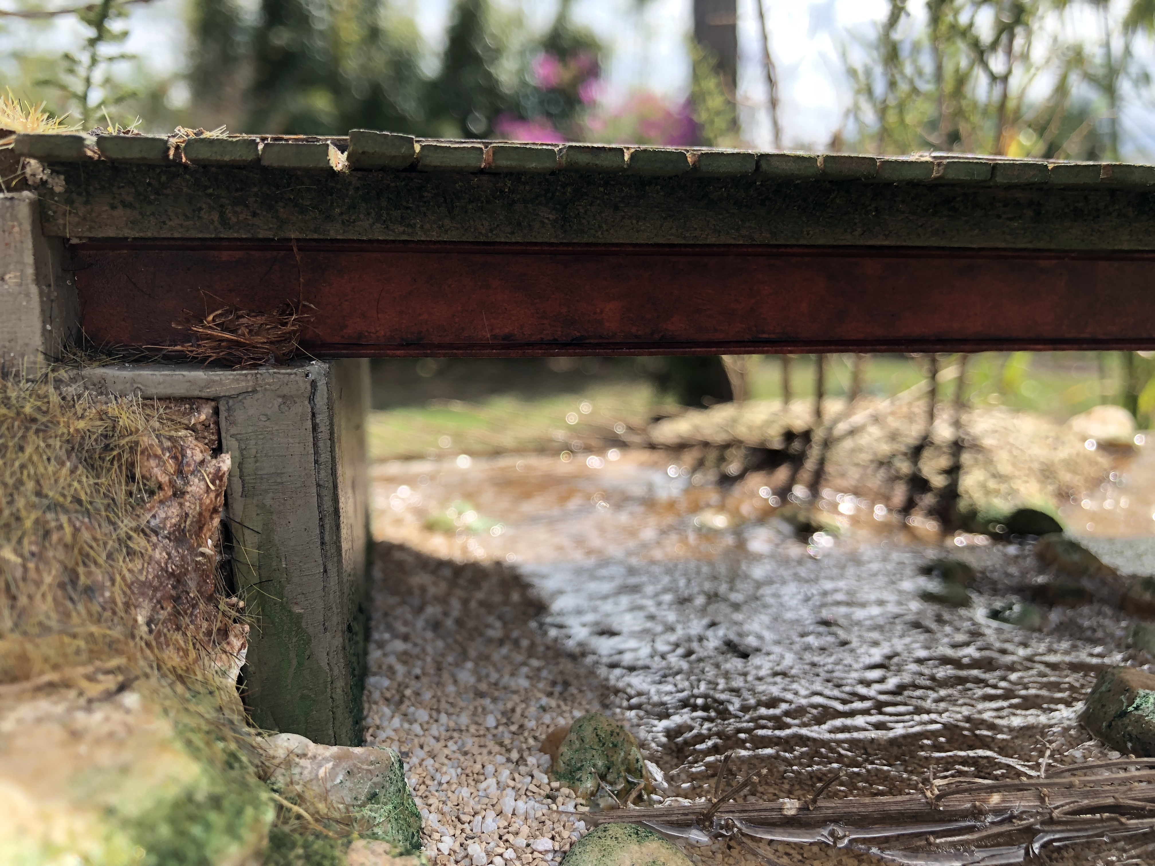

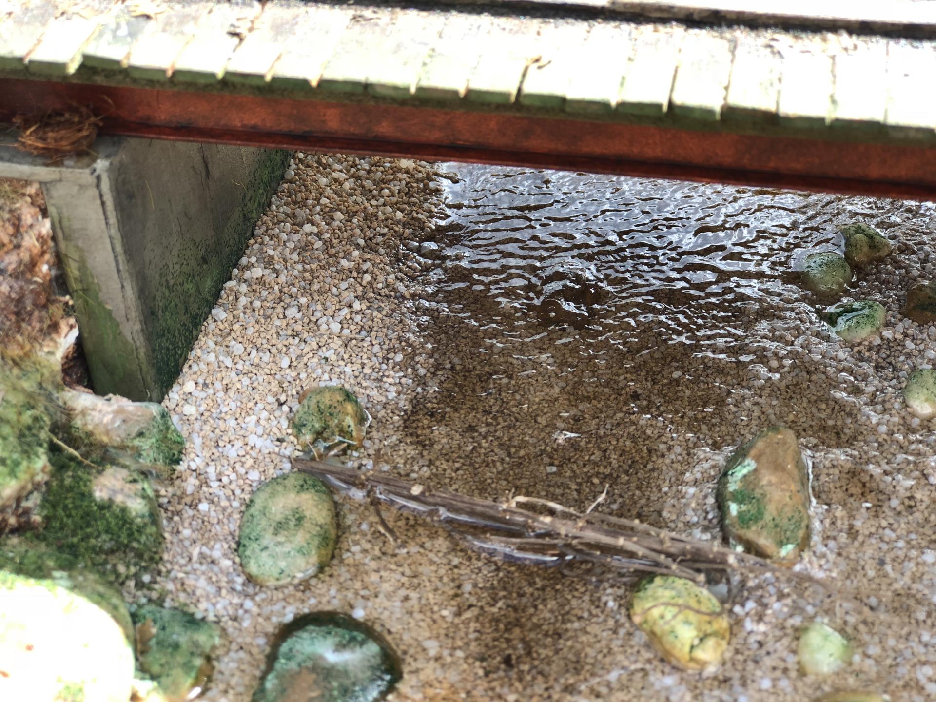

Ripples added to the water. Also, notice the birds nest on the the top of the left abutment (thank you, Raymond, for the suggestion) I used some fibers from a palm tree to make it. Im sure there are better methods but this one looked natural.

You must be really pleased with those ripples, Yordan..... and I didn't realise that you added the ripples after the resin water had already dried? I assumed that you would have to add the ripple effect while the water resin was still wet.
The bird's nest looks just right, as does all of this diorama setting. You are giving me some serious competition here Yordan!
David

Just noticed the bird's nest on the beam under the bridge.  Very nice touch.
David
Thank you David. The ripples were added after the resin was dried. I used Gloss Mod  Podge and a brush to create it. Just load the brush with the product and tap over the surface. The smaller the texture you give the smaller ripples. You can create bigger ones by layering. It’s white when applied by clear when dried.
Thank you. It was a recommendation from a member of this forum and it fits well. I take note from any criticism and ideas to make my dioramas better and I love the challenges.

Thank you. It was my first attempt and a very scary one. I thought I was going to ruin the diorama because I attached the bridge before adding the resin. It was a challenge and I had to be extremely careful.
