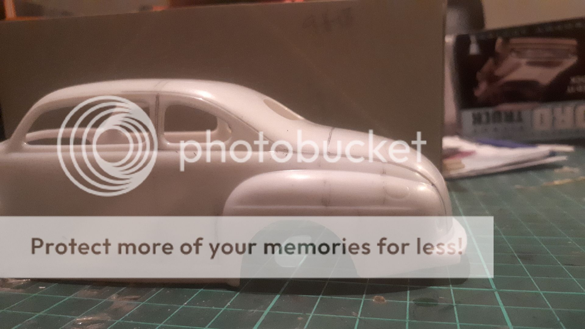

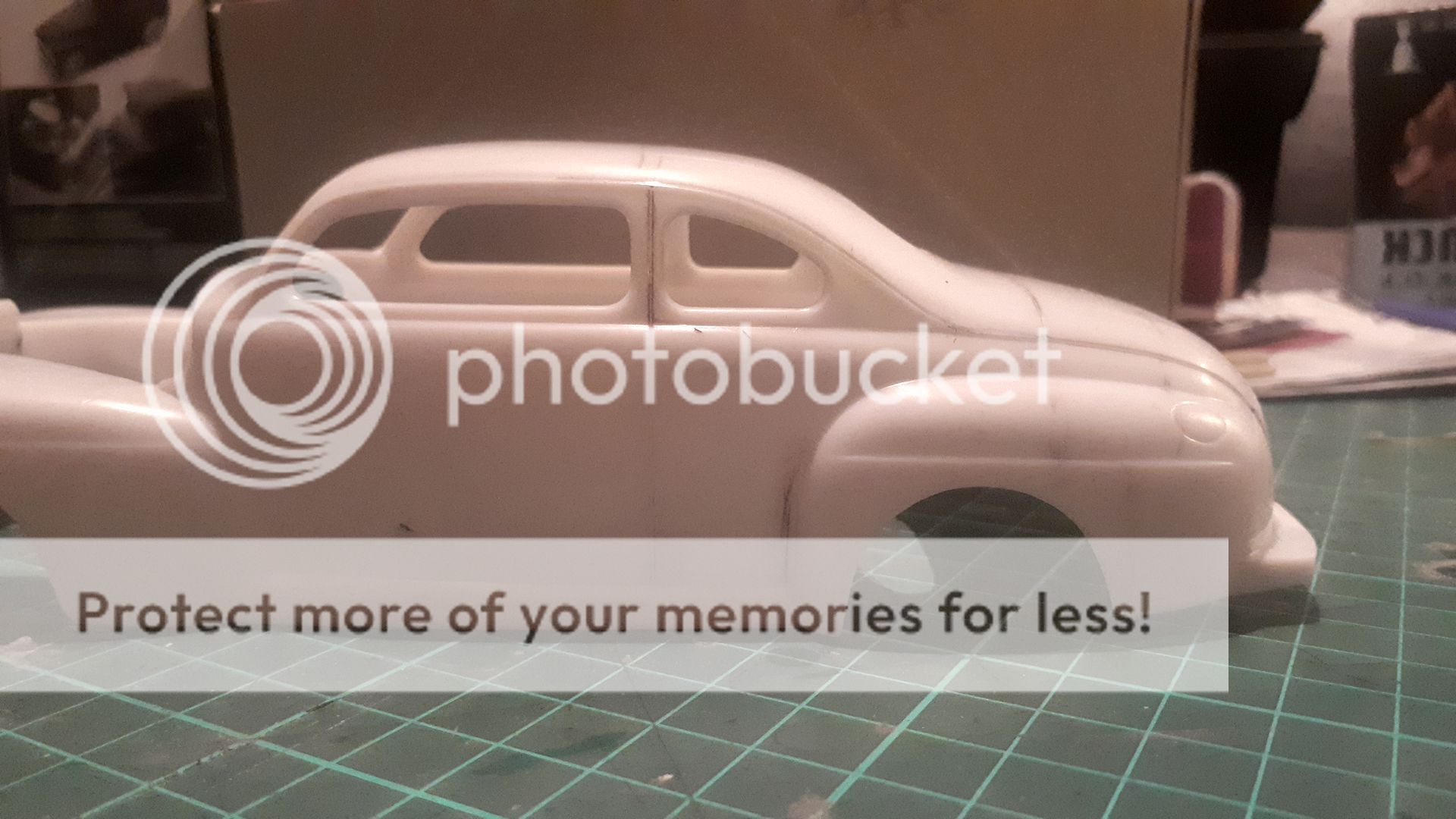

Next step is to change the angle of the rear window and change the deck lid.   Pics in this step are a little limited so i posted a stock body to show the changes.     I cut thhis panel out in one pieace.   I did this by cutting just before where the roof starts to slope downwards,   I didn't cut all the way across the body.   I left the widows as and left the sides of the roof in place.   Sounds odd and wish i had a photo of this step but i don't.  When   I Glued this pieace back in i changed the angle of the rear window and lowered the deck lid height.  In a way pie cutting the deck lid.   As i moved the window back it created a gap which i filled and added putty to reshape this area.
ff1b2ef6-1a35-4338-82d1-82236549fe07-ori
2321839e-057f-44ba-a2c7-cc1d648de0ab-ori
End result in primer
