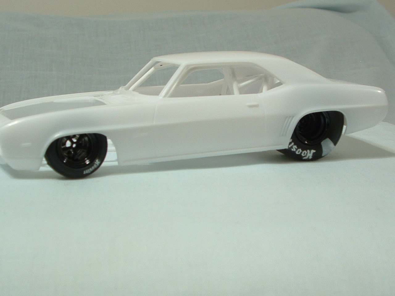

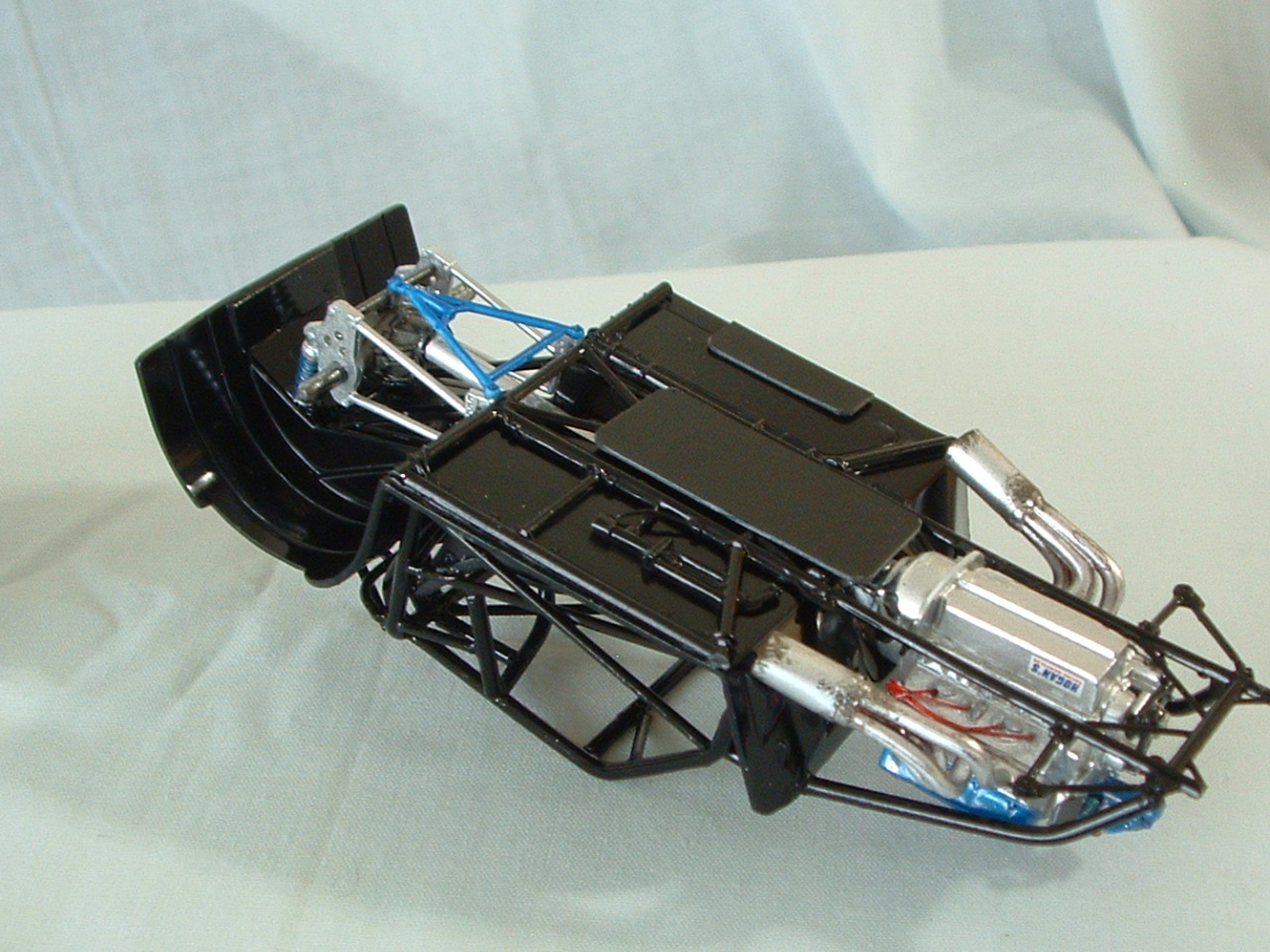

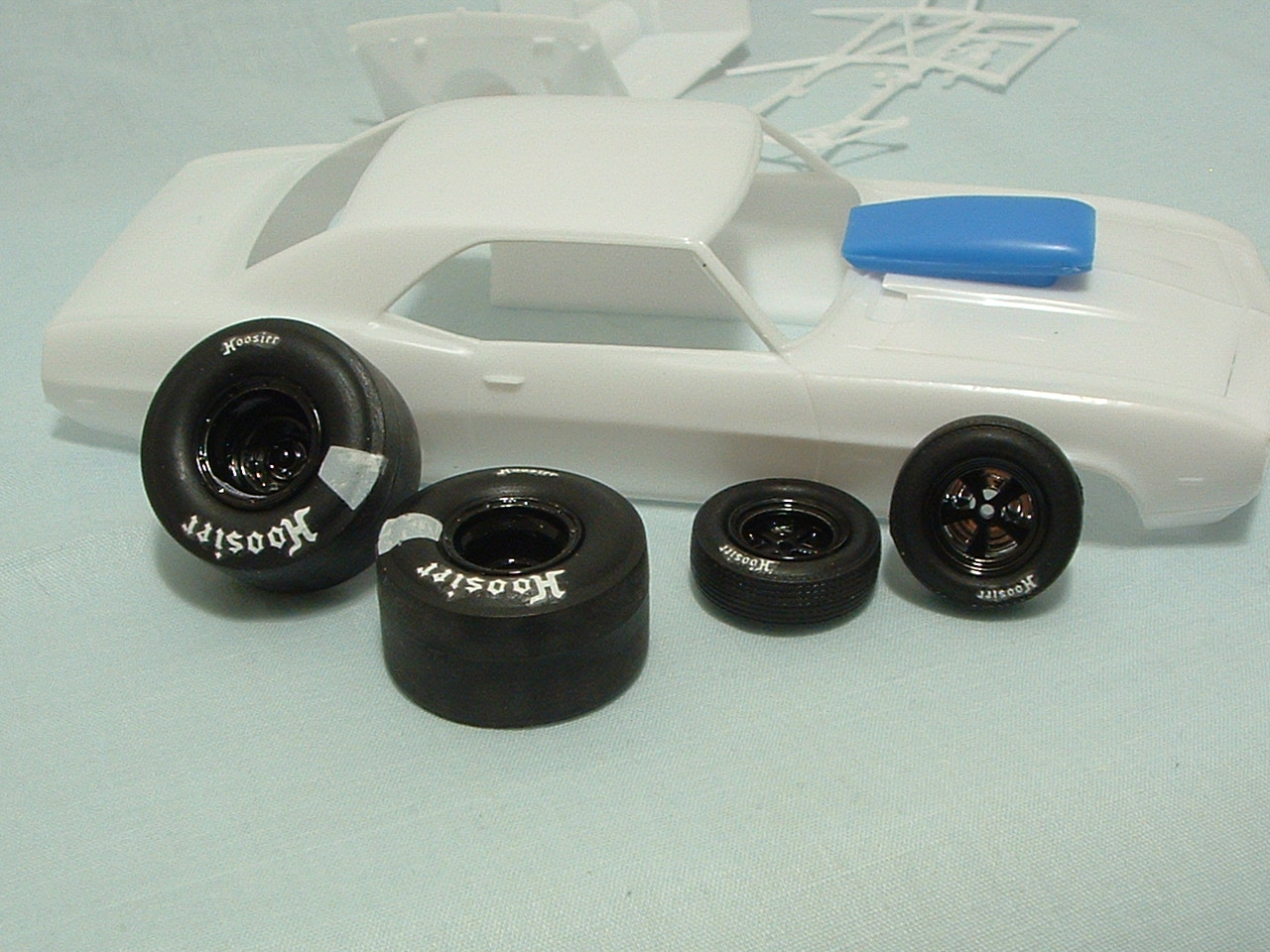

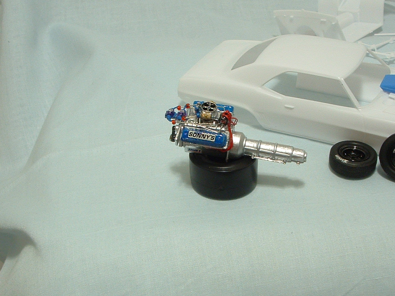

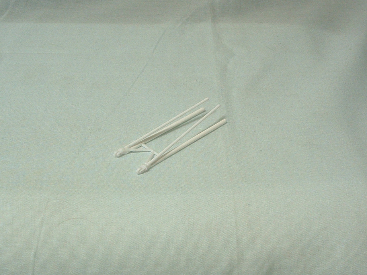

Mister Twister Posted February 14, 2019 Here is the beginning of a Top Sportsman Camaro. I'll use a modified Revell chassis pan and a heavily modified tube chassis. Very little will be left of the original tube chassis as I will scratch build a new one including coil over shocks. I have just a few small sub assemblies started as you can see in the pics. I expect this to take a little while to complete. I've been searching the web for some ideas on graphics that I have seen lately. I haven't built a detailed P/M type car in awhile. I'm still contemplating cutting every thing open. Quote Share this post Link to post Share on other sites

Scott8950 Posted February 14, 2019 nice work on that engine it looks good. Quote Share this post Link to post Share on other sites

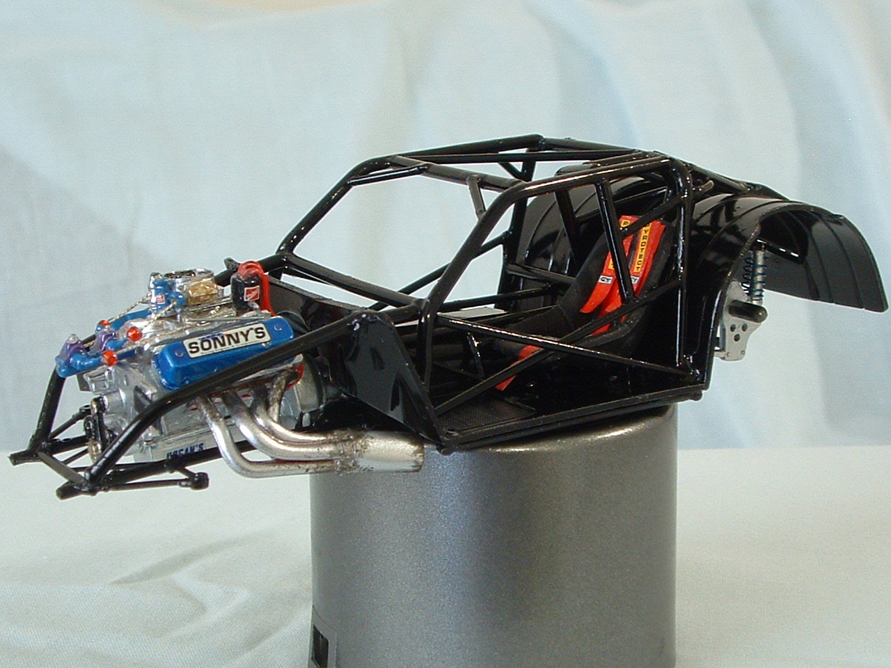

Mister Twister Posted February 21, 2019 Thanks fellas......a simple update. I did some work on the roll cage with just a couple of pieces left to put in and some wheelie bars. Quote Share this post Link to post Share on other sites

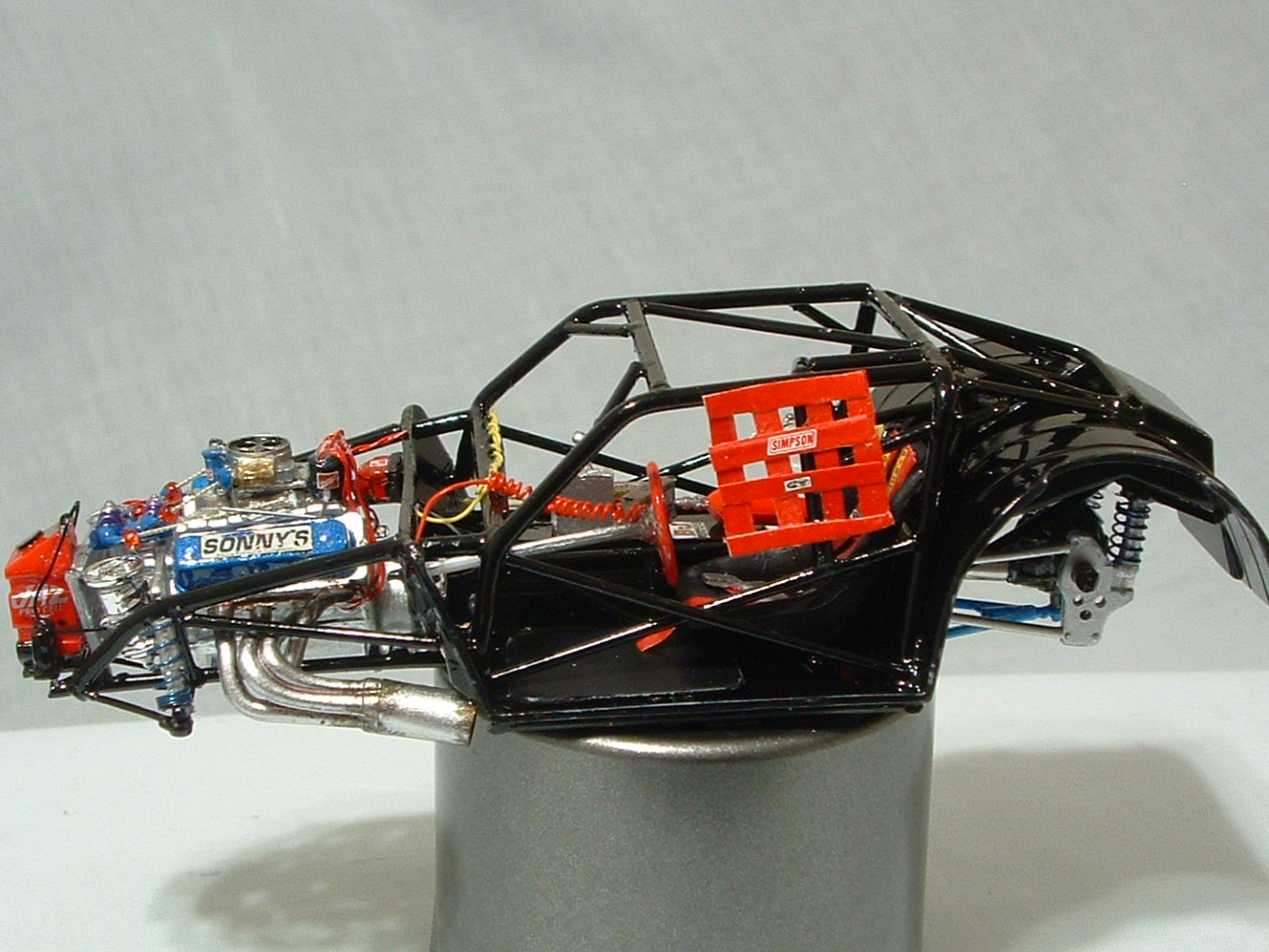

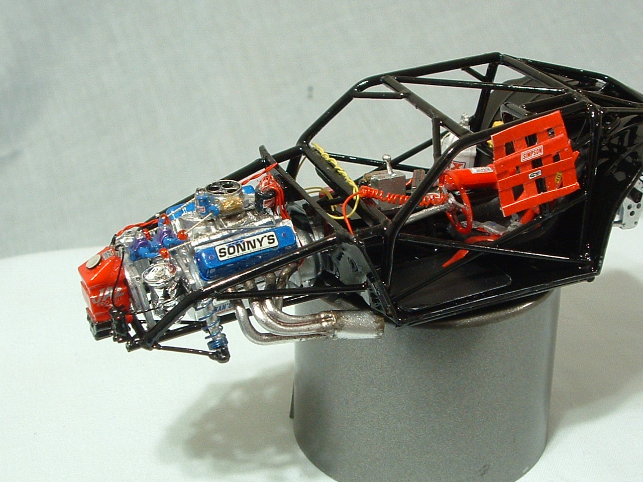

Mister Twister Posted February 22, 2019 (edited) Thanks fellas.....A small update. I painted the chassis pan and roll cage in a high gloss black. I installed the engine, rear end assembly and dropped in the seat. There is still plenty to do with four more bars to be installed on the front truss bars, radiator, fuel cell, all the interior components and so on. So stay tuned....more to come. Edited February 25, 2019 by Mister Twister Quote Share this post Link to post Share on other sites
R.D.F. Posted February 22, 2019 (edited) A few questions. Did you have the wheels and tires ? Or did buy them from a vendor. Did you make the headers ? Edited February 22, 2019 by R.D.F. Quote Share this post Link to post Share on other sites
Mister Twister Posted February 22, 2019 32 minutes ago, R.D.F. said: A few questions. Did you have the wheels and tires ? Or did buy them from a vendor. Did you make the headers ? The wheels and tires are from my spare parts box. The rear wheels were Drag Lites and I punched out the center and added the center from a Convo Pro. The front wheels are reversed torq thrust type wheels with a trim ring added. The headers are parts box items from a past kit that I built. The collecters were very small and short so I added a piece of tube plastic to each header to make them larger. Quote Share this post Link to post Share on other sites

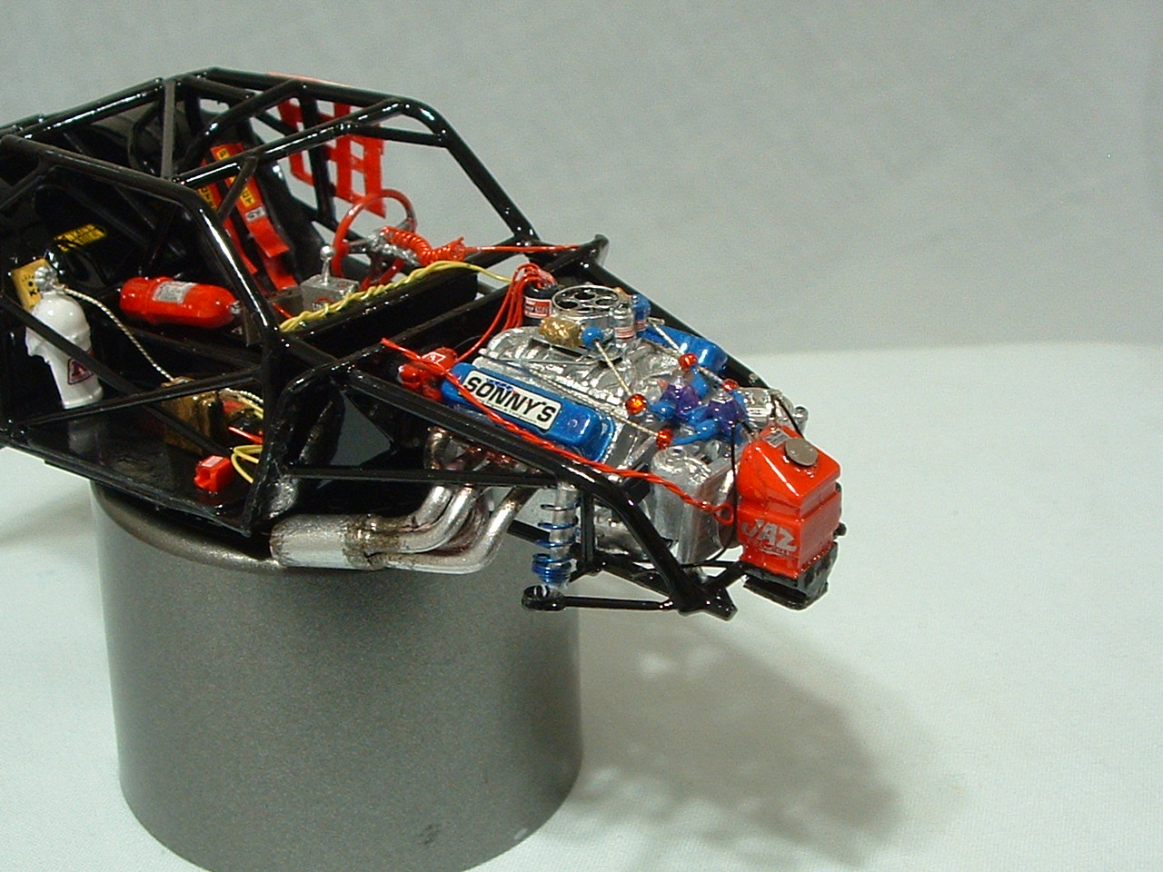

gtx6970 Posted February 22, 2019 Just curious, why is the carb on sideways. 'Is that something they do today ? ( Sorry, I dont follow modern drag cars very close ) Quote Share this post Link to post Share on other sites
Mister Twister Posted February 22, 2019 5 minutes ago, gtx6970 said: Just curious, why is the carb on sideways. 'Is that something they do today ? ( Sorry, I dont follow modern drag cars very close ) I don't know if its modern or not but especially on dual carbed engines it takes less space than carbs that are end to end. Quote Share this post Link to post Share on other sites

Mister Twister Posted February 25, 2019 Quite a bit accomplished over the weekend such as adding the shifter, delay box, shock adjustor, nitrous bottle, fire bottle, fuel cell, assorted wiring and plumbing and so on. I added some clear also to the various sub assemblies. I will move on now to work on the graphics and some other small assemblies. Thanks. Quote Share this post Link to post Share on other sites

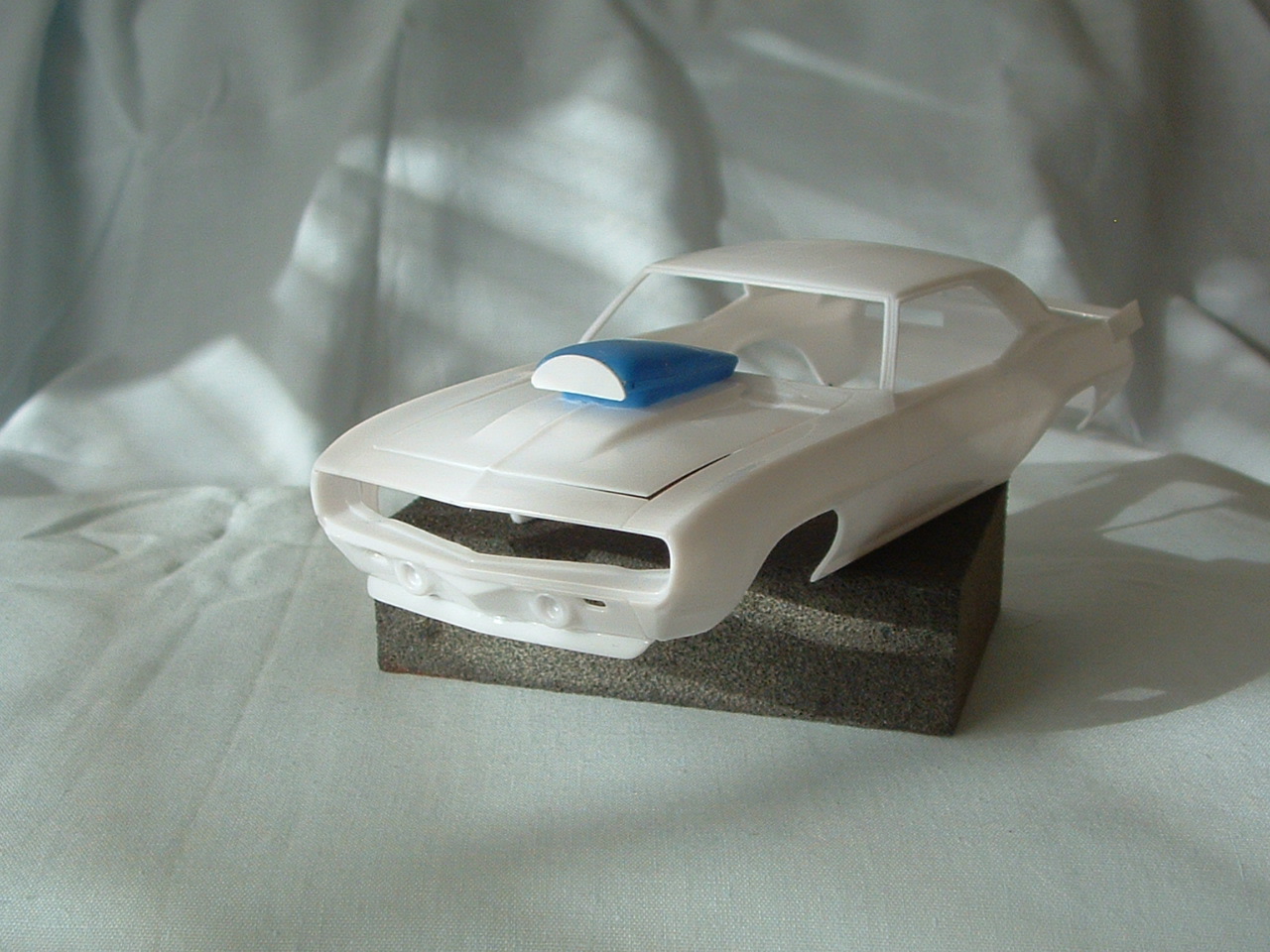

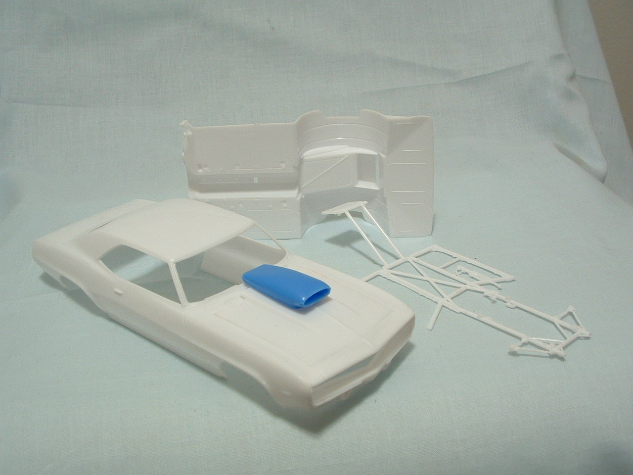

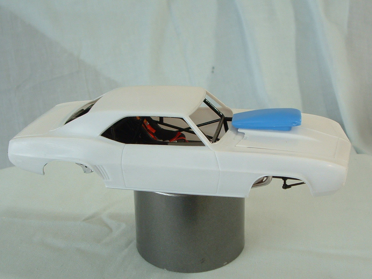

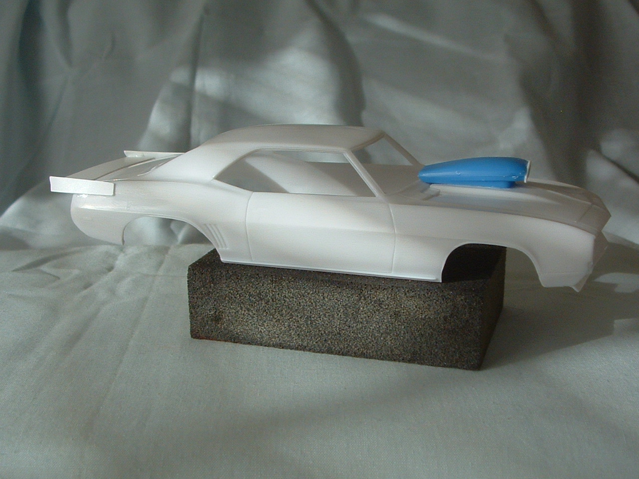

Mister Twister Posted February 25, 2019 Thanks fellas.....A little more late night work done. I've removed all emblems, marker lights, door handles and smoothed the body. I got the hood to fit better and made a plug for the scoop . I scratched out a rear wing and enlarged the rear wheel openings. Paint and graphics are coming soon. Quote Share this post Link to post Share on other sites

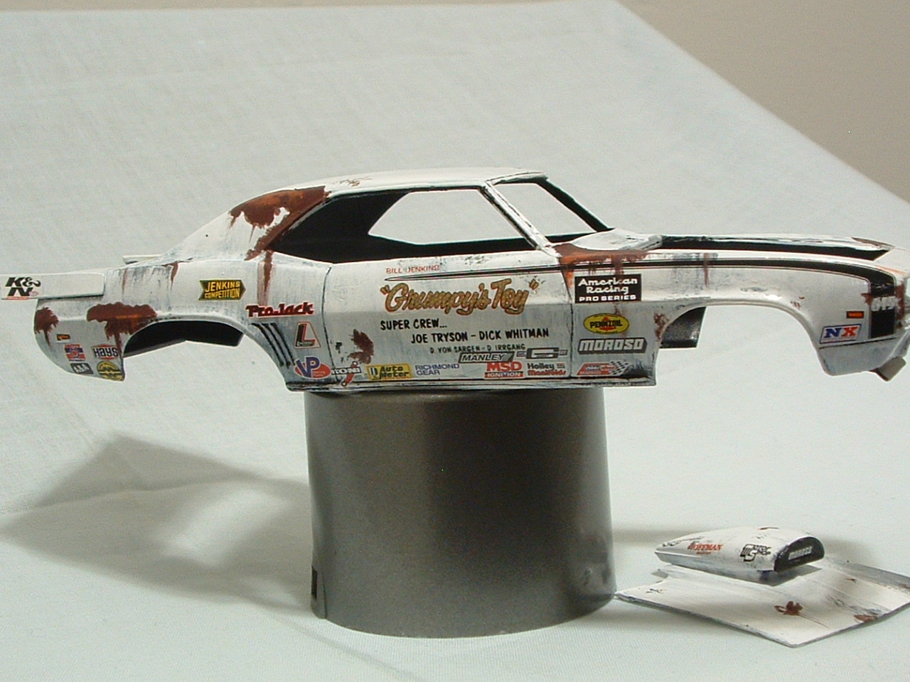

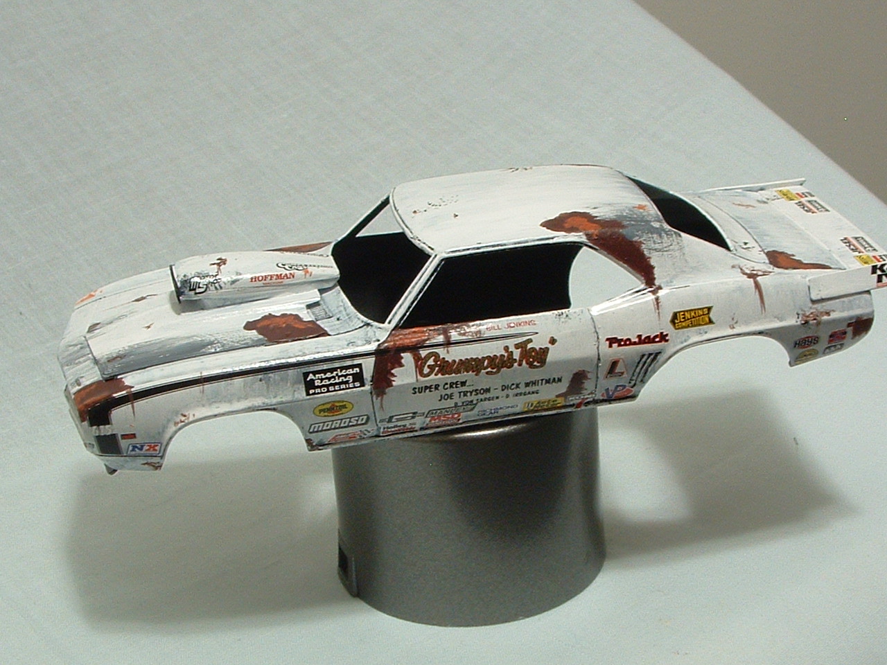

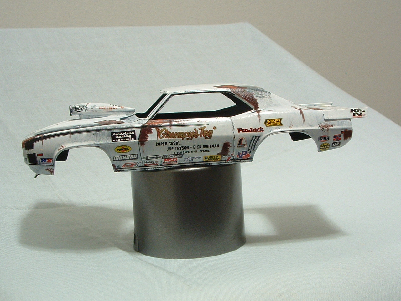

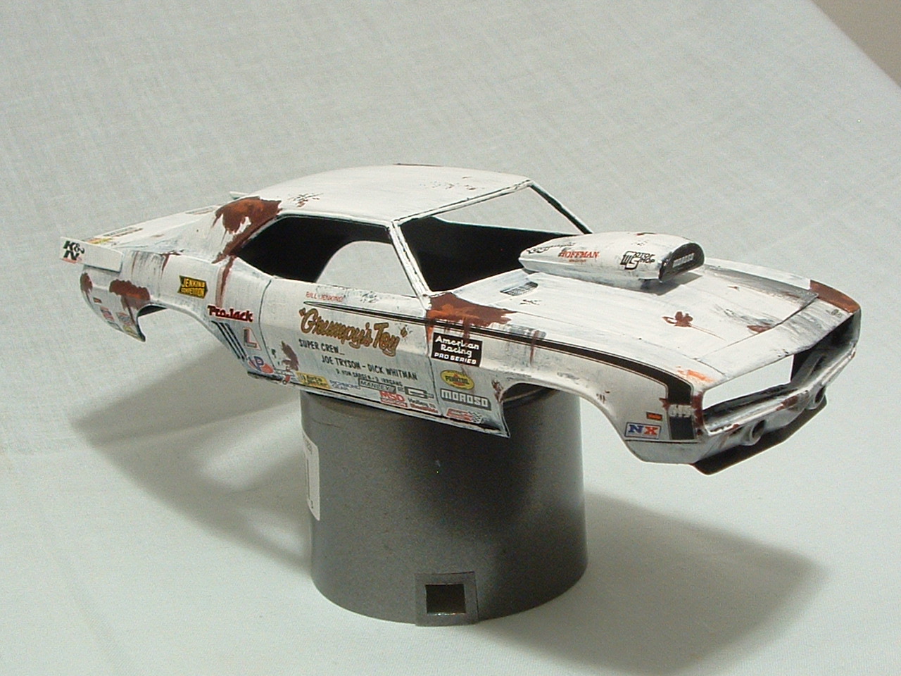

Mister Twister Posted February 26, 2019 I've come along way in just a couple of weeks with this build. I spent the better part of today with this graphic/paint scheme from primer and base coats to a light clear (mid coat) so that the decals can be applied to the flat white base coat without silvering. Still many thing to do including clear and polishing to gain a brilliant shine for this rust wrap inspired scheme. More later...…. Quote Share this post Link to post Share on other sites
